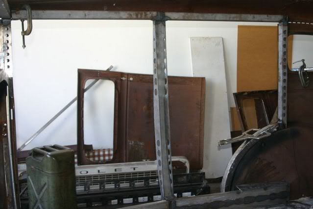

    After finishing the B-pillar fabrication I fit it up to the upper subframe pieces and tacked it all together. I then removed the whole side subframe so I could weld it all up. Here's a pic of the upper side frame ***embly tacked and removed from the car for finished welding.
    I used 1.5 inch square tubing for the other pieces of the subframe just because they seemed to fit the areas that were left by where the wood used to be. Here's a pic of the subframe ***embly welded and placed back into the car.
    Here's the driver's side.

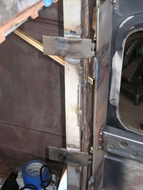

    I now have a four door !:) Did a bunch of work to get all the doors hung and operational on the car over the past few weeks. Here are some pics:
    The bolts were so rusted in the front doors I had to drill out the bolts to remove the hinges. Not being the world's straightest driller I needed to rehab the threads. Spent some time at the lathe machining some threaed round stock pieces to weld into the old hinges.
    The back doors didn't have any hinges so I purchased some from Speedway. I clamped them in place and used a long piece of round stock to get them in line.
    With the hinges positioned where I wanted them I tacked them in place. Checked everything and welded them to the vertical member of the rear subframe.

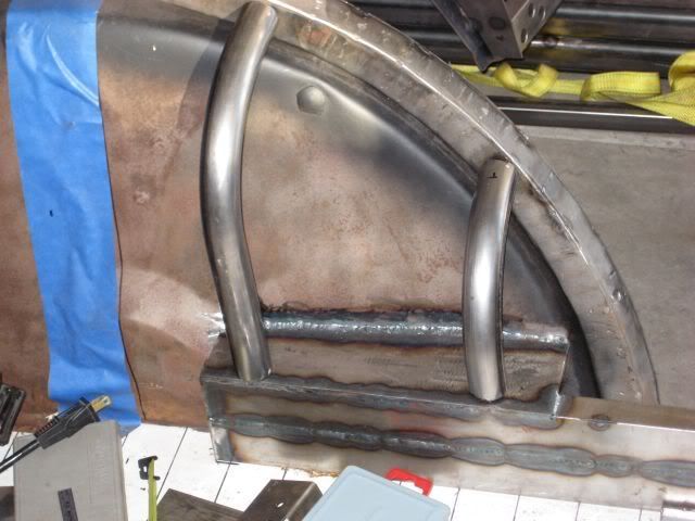

    A short post on the continuing subsframe wood to steel conversion for the Fordor Sedan. I needed a way to tie the lower subframe to the the upper. So what did I do? :confused: Exactly, I visited Dodgerodders thread and reproduced what he had done :D
    Bent some 1.25 dia. tube with my recently finished tube bender (JD2 style). The tubes are tacked to the 3/16" plate that lays on top of the two pieces of 2x1x.06 rectangular tube that run from the cowl to the rear of the car. The other end of the tubes is tacked to the 1.5" x .12" square tube that was cut and shaped to run along the fenderwell. Both sides were done to match. The steel work is producing the desired results the body is really stiffening up nicely. It sure does take a long time though:eek: Here is another shot from a different angle:
