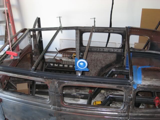

    Here is a post showing my new roof bows. I may add to this later depending what I decide to do with the roof :confused:.
    I welded in 3 roof bows made from 1" square tube x .06" wall. They are spaced 18.5 " apart, which makes them evenly spaced from front to back of the car. I chamfered the ends of the tubes to clear the roof sheetmetal. I then capped the ends with some .06" plate. Here are a couple pics showing the overall layout:
    Here is a closeup of the tube end showing how it was welded to the uppersubframe tube:
  2. scootermcrad
    Joined: Sep 20, 2005
    Posts: 12,383
    scootermcrad
    WOW! That is going to be SUPER strong!!!

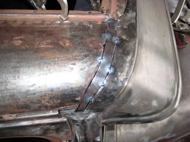

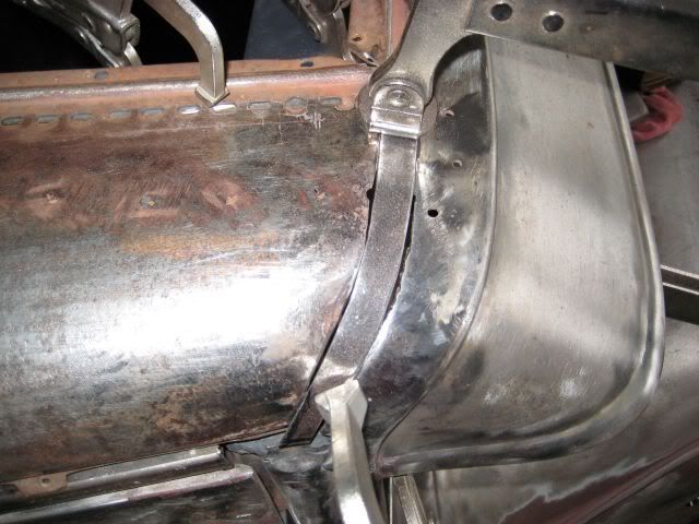

    So what do you do after you get your roof bows in???? Re-attach the roof you cut off to put the bows in ;). Here is post highlighting what I did to get the roof back on the car.
    First I sanded and primed the underside of the roof panels. This was a simple task with the roof laying flat on the bench. Here is a pic of the roof panel primed and ready for install:
    Then it was time to weld them into the car. The p***enger side was the biggest problem. It was a hair short so I trimmed it back and created a filler piece. The filler piece is bigger than the original gap so I could have a piece of metal large enough to form and handle. Here is a pic of the gap where the filler metal will be added:
    Here is pic with the formed metal fitted in the gap:
    I just recycled sheetmetal from the chop. I'm trying to keep this build eco-friendly :D
    I then tacked the sheetmetal filler in place a shown in the pic below:
    With the metal tacked in place it was time to finish weld it in. I welded and beat on it with a hammer and dolly alternating back and forth.
    The drivers side was much simpler. Just trimmed and welded in place. Here is pic of how it ended up:
    I'll get some pics of the overall car with the roof re-installed. I notice I forgot to take any while I was re-attaching the roof.
  4. chaddilac
    Joined: Mar 21, 2006
    Posts: 14,085
    chaddilac
    Why was the gap bigger on one side than the other, is it not square?
  5. mosimpson
    Joined: May 29, 2006
    Posts: 271
    mosimpson
    I measured and re-measured. I guess QA @ Henry's wasn't as good as Simpson's garage :D

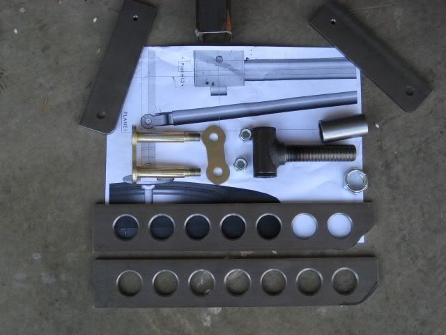

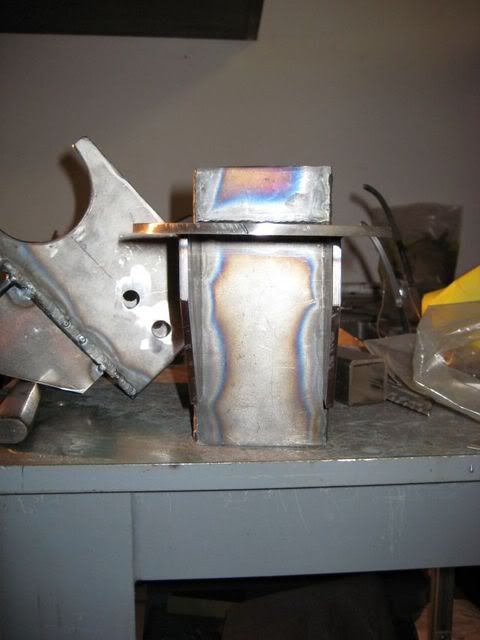

    I needed to make a bunch of brackets for hanging the rearend. I started by making drawings of the brackets I would be building. I printed copies of the individual pieces full scale to make patterns from. I also offfset the outside profile half the plasma cutter nozzle diameter. I cut the patterns out on this line so when I drug the plasma cutter around the pattern I would trace out the actual size I wanted.
    Here is a pic that sums all this up:
    I used the negative pattern to layout all the pieces I would be cutting on my steel plate. This was mainly to make the plasma cutting go as fast as possible and to minimize waste. Here is a pic of the steel with all the pieces laid out:
    I made wood patterns to have something to trace the plasma cutter nozzle against. This allowed me to make clean repeatable cuts, resulting in an accurate set of parts to fabricate the brackets from. Here is a pic showing some of the patterns laying on the steel:
    Here is a pic of some of the pieces after plasma cutting and bead blasting:
    And finally here is a pic of the 3/16" steel plate after all the plasma cutting was complete:

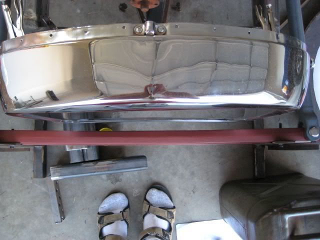

    One of the first tasks was to get the radiator shell placed. This was critical for me because I wanted to minimize any empty space between the radiator shell and the axle. Here is a picture of the shell/radiator brackets I fabbed up. I used a couple pieces of .25" plate 3.5" wide x 9" long.
    The next step was to fab some frame mounts for the wishbones. I used some .50" plate here and cut some angles on the ends to match the front "z". I bought some bungs and bored a hole in the plate to weld the bung into. Here are two pics one from the outside and one from the inside of the car:
    I took about 2.5" off the stock wishbones to move the axle up close to the radiator. My stupid mistake here was I had already welded bungs into the ends of the wishbones :mad:. So I had to buy another pair for the shortened version of the wishbones. Here is picture of my wishbone s****s:
    Here are a couple pics showing the radiator and axle positioning. The gap between the axle and shell is .75". No wasted space here :)

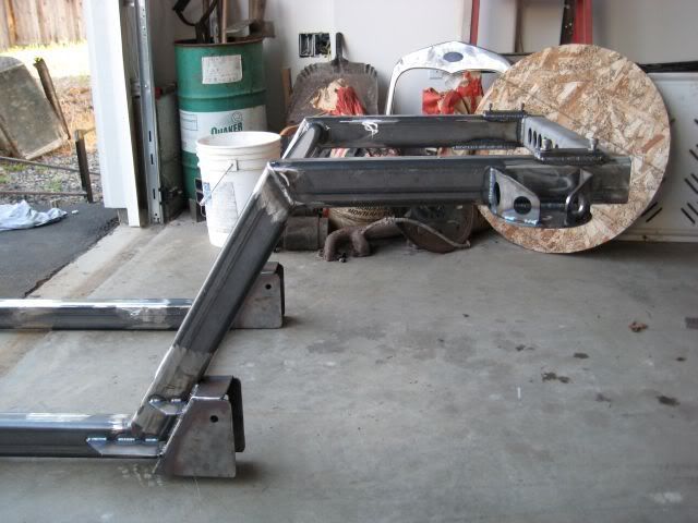

    I spent all day today working on my rearend. The object is to get the rearend suspended in the frame. I don't have the pic's from today's work downloaded yet, so this post will highlight all the pieces that were built in preparation of the rearend hanging.
    The rearend will be situated with a 3 link system. The lower bars attach to the rearend with these custom brackets:
    These brackets also serve as the lower bag mount for the rearend airbags. To stiffen the plate that the bag mounts to I added two triangular gussets to bracket:
    Here is a head on view of the bracket with the gussets taked in place:
    Here are a few shots of the brackets mocked into position with the rearend:

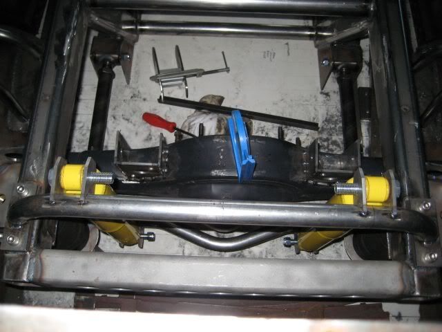

    I decided to bend up a piece of 1.25" dia. tube for the lower shock mount. The bar will span between both brackets to allow a feature to mount the lower end of the shocks to. I bored holes through both gussets to stuff the bar through. To clear the rearend housing we bent a "v" in the bar. Here are some pic's that show the arrangement:
    Here is one with the shock in place to give you the idea of how it will be mounted:
    To mount the upper end of the rear shocks we bent another piece of 1.25" dia. tube. Welded some pads on the ends that will allow this piece to be bolted/unbolted to the top of the frame. The tube has two sets of tabs where the shocks will be bolted. Here is a pic:
    I will get the pics of the finished rearend up as soon as I get them downloaded. Now its bedtime ;)

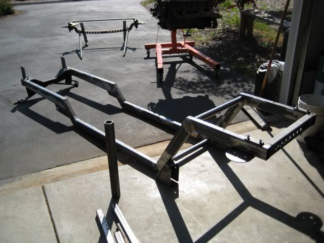

    After tacking a lot of "bracketry" in place it was time to tear things out and get them to the welding table. I had the rear bag brackets, the lower bar brackets, upper wishbone brackets and the upper and lower rear shock mounts to weld.
    Here is an overall shot of the frame showing the brackets in place:
    And a closeup of the rear portion of the frame:
    Another shot of the frame from another angle:
    Here is a shot of the 9" Ford rear housing with the bag/lower bar brackets and lower shock tube welded in:
    Here is a shot of the rearend on the welding bench with the upper wishbone brackets tacked to the housing:
    Finally here are a couple shots of everything stuffed back into the car. I even bolted the rear shocks in place with the upper shock hoop:
    I've fallen off my timeline to be a roller :mad:, but I'm getting closer and closer every week :).
