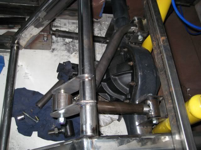

    Last of the fab on the rearend is to make and attach the wishbone 3rd link. I bought a you fab your own wishbone kit from Suicidedoors.com. I got the kit with the superpivot. Here are a few pic's fabbing up the bracket for the superpivot:
    I haven't got all my parts from suicidedoors.com. Brown Santa should be visiting the house tomorrow :D. Then I can fab the actual wishbone!

    Are the screws that hold the upper shock hoop strong enough?

    The shock hoop is bolted to the frame by four 3/8-16 SHCS. The stress area for a 3/8-16 bolt is A=.077 sqin. ***uming the car weighs 2500 lbs and this weight is distributed evenly front to back results is 1250 lbs at the rear axle should the car undergo a 1g drop. Ignoring the effects of the shocks (***ume everything is rigid), the bolts must account for this 1250 lbs. The force in each bolt would be 1250 lbf/4 =312.5 lbf. The resulting stress in the bolts would be 312.5lbf/.077 sqin = 4058 psi. The yield strength for steel is 36kpsi. This results in a factor of safety of 8.8. Yes I think they will be fine. :)

    Suicide doors finally came through with all the stuff I needed to build my wishbone for the rearend. I originally bought the unwelded wishbone kit with the super pivot. I wanted to have adjustibility of the rearend angle so I added on some extra parts to the original kit. I got the big threaded stud (1.125 -12 UNC) to weld to the super pivot. I also bought a 18" long piece of their 1.5 tube that is threaded at one end to accomodate the threaded stud. Suicide doors also custom bent a piece of the 1.5" tube at a 60 degree angle for the other leg of my pivot. I coped all the tube and tacked things together. Here is what it looks like:
    The big question now is weather the wishobone will clear the pumpkin when the rear bags are aired out. We'll know as soon as I get it up on all fours :confused:

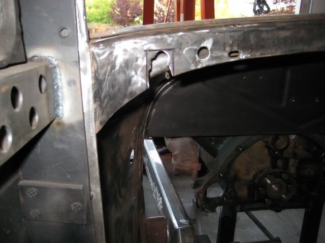

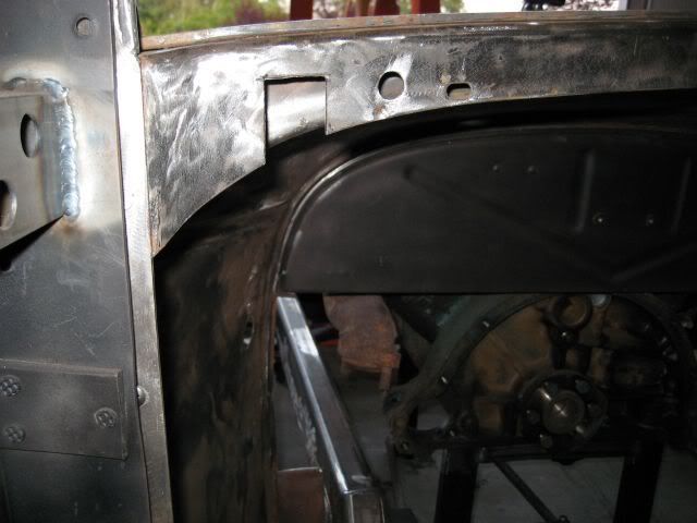

    Here are some pic's of a patch job I did to the substructure under the dash. Somebody had carved a hole to mount something in the stock dash. I couldn't take staring at it any longer so I patched the hole. First I cut the hole to a nice rectangle. Then I made a patch the same size as the rectangle cutout. Here are a few pictures as I went through the steps:
    I don't have a final pic that shows it, but I did shape the bottom edge to match the curve of the dash. The welded area still needs additional metal finishing, but it sure beats the ugly hole that was there.
