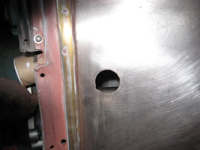

    In keeping with my hole patching theme here is another little repair I did to the cowl area. Both the driver and p***enger side of the cowl have a round hole, I think they were for marker lights on the stock model A's. I didn't need them so I decided to patch them. Here is a picture of the hole:

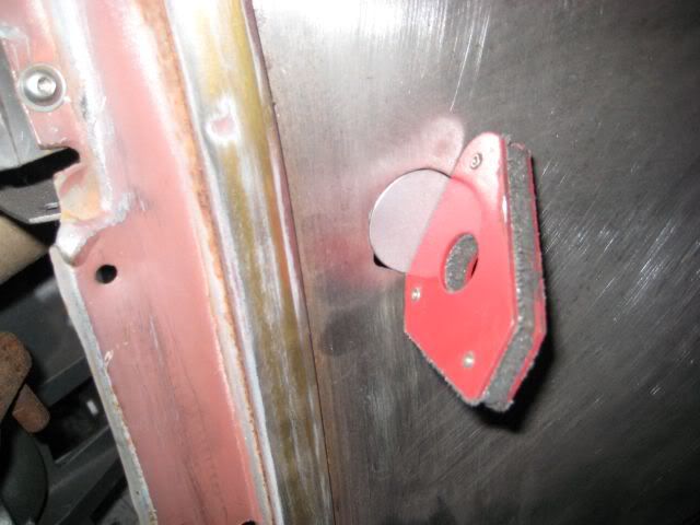

    I used a hole saw to cut a round disk from some s**** sheetmetal. The metal was actually taken out of the car when the top was chopped 6". In a stroke of great fortune the ID of the hole saw was the perfect size for the existing hole!!
    I used a magnet to hold the disk flush with the outer surface of the cowl:
    Now the procedure was as follows; tack, hammer and dolly, tack, hammer and dolly, etc. I hammer and dolly each tack, this stretches the weld and insures the edges are in the same plane so you get a perfect match. Here are a few pic's illustrating the progress:
    Once I get to this point I weld up the gaps between the tacks, hammering out each section as I go. I also skip around to allow hot areas to cool while I work on a different area. After all that is done it and you hit it with the grinder to knock down the weld it looks something like this:

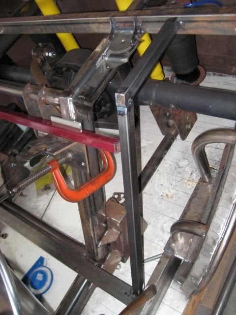

    Here is the buildup of my cowl steering sub-***embly. The basic structure is 1.25 dia x .090 wall steel tubing. The bends were done with a mechanical tube bender (like JD2). This first pic shows the basic tube structure:
    I plasma cut a piece of 3/16" plate to make a mount for the BMW steering box. I made some standoffs to weld in the plate the plate wouldn't interfere with the steering box. Here is a pic of the plate mounted to the stucture:
    With the steering box location fixed it was time to come up with a pedal mounting scheme. I made a pedal mounting bracket for the Wildwood hanging pedals that would mount at the front of the cowl hoop stucture. Again the pedal bracket is 3/16" plate with some .50" x 1.25" flat bar between them with tapped holes for the pedal ***embly. Here are some pic's of the pedal bracket:
    I wanted to use the pedal bracket as a mounting point for the column too. So with the pedal ***embly clamped to the hoop stucture I used a straight edge to give me a rough location of where the steering shaft from the steering box was going to intersect the pedal bracket. I then unclamped the pedal bracket and bored 1.9" dia. holes in each of the plates. The holes were bored on the Bridgeport in one setup so they are concentric with each other. I then made an alignment tube from PVC. The tube had a 1.9" O.D. thant fit snuggly into the holes bored in the bracket. I made a plastic bushing that would just slip over the steering box shaft. Since I planned on using 1.75" dia. tube for the column I turned down the outide dia. of the PVC alignment tube just in front of the front pedal bracket plate and just behind the rear pedal bracket plate. This allowed me to use the alignment tube to position the column mount rings to the pedal bracket plate. Here are the pic's of the alignment tube and pedal bracket:
    I bought a 1.75" dia split collar for the rear of the pedal bracket to hold the tail of the column. I welded half the split collar to the pedal bracket:
    At the front I made a ring on the lathe with 4 tapped holes that the corresponding ring that is welded to the column will bolt to:
    This alignment tube allowed me to position the pedal bracket to the tube structure in alignment with the steering box and position the rings that hold the column to the pedal bracket. It was so well thought out I had to use a sawzall to remove the PVC alignment tube when I was done tacking parts in place :eek: :D.
    There are quite a few man hours making brackets, alignment fixtures, coping tubing and welding this sub-***embly. Here are the pic's of the finished sub-***embly outside the car:

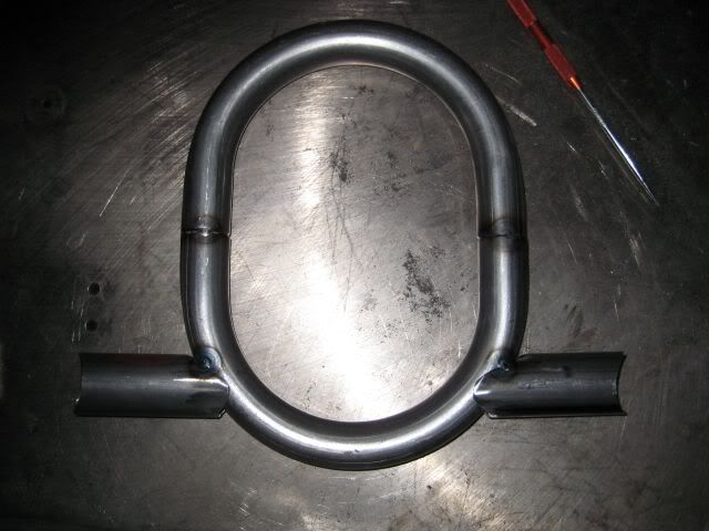

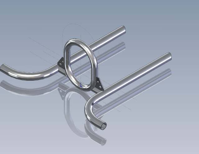

    Before I move on to putting a floor in the car I need to add the frame bracing behind the transmission. With the car being channeled a driveline loop seems to be the perfect solution to tie everything together. I'm thinking about this for the design:
    The main tubes will be 1.25" dia. since that is what I have dies to bend. The loop will be 1" dia. tube so I can maximize space around the transmission hump in the floor. I found some 1" dia. 180* u-bends in Jeg's catalog that I can fab the ****** loop out of.

    Back in post #129 I previewed the design for the frame bracing behind the transmission. Here are some shots to actual fab & install:
    Here is the driveline hoop:

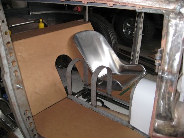

    With the floor substructure taking shape I figured it was a good time for an interior mock up. So I stuck the steering/pedal sub ***embly in the car, dropped in the seat and started cutting up a refrigerator box. Here is what that labor produced:
    It gets a little more complicated at the front in the firewall, front frame "z" area. I'm still working that out. At the rear I'm contemplating some access panels in the area of the rear "z" to get to rear suspension pieces.
