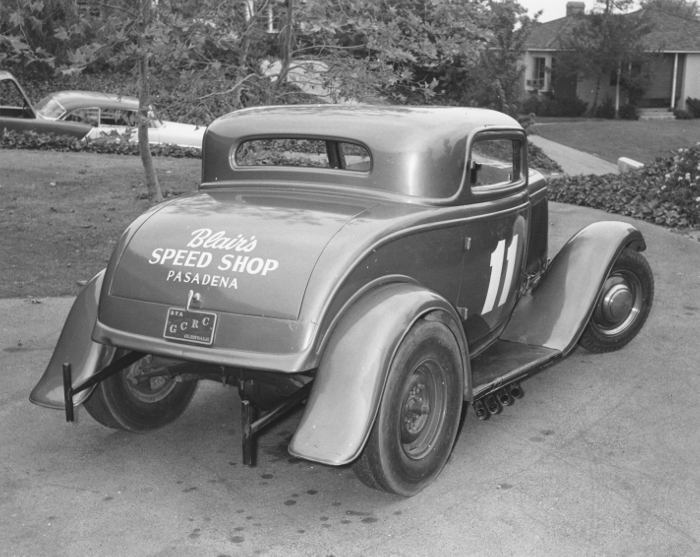

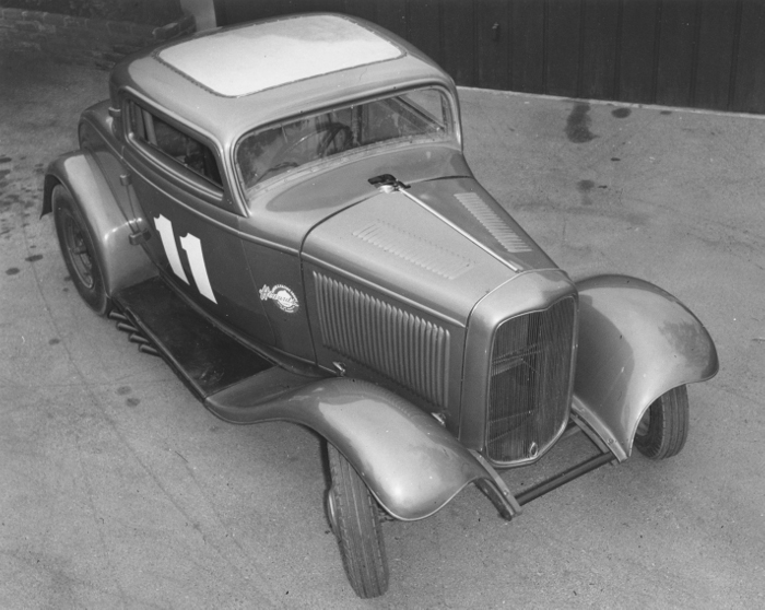

    Here are several pictures of Don Montgomery's "A" fuel coupe from 1956. In my mind his car defines the word "Hot Rod." Don has shown pictures of so many others cars through his books. This is his highly successful car.

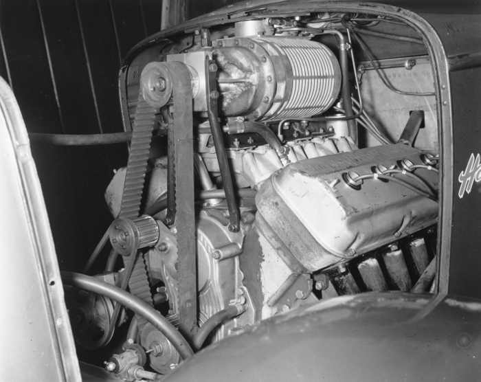

  9. Here are several pictures of Don Montgomery's wicked "A" fuel coupe from 1956
    Those are awesome pics!!!
    But the parts shown arent from 1956- at least a few years later on the Gilmore belt.
    What timing cover is that ?

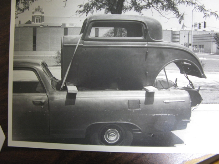

    1992 in the back of my El Camino.

    Attached is a photo of the Chrysler engine on the Cobbs-Hilborn-Engle dyno on April 6, 1956. The Gilmer belt drive used steel industrial pulleys. Unfortunately the small diameters of the pulleys resulted in only a few teeth in contact. The 2" belts were fairly easy to strip teeth. Don Yates had used a Gilmer belt a little earlier. More sucessful use of the Gilmer belts would come several years later when the manufacturers started making bigger diameter aluminum pulleys, the belts were improved and widened. My setup worked well but I had to be careful because the belts were expensive for me.
    The SCOT blower nose broke when the engine was first put on the dyno on March 16, 1956. The SCOT setup used a v-belt drive but that could not take the downward force of the Gilmer drive. The quick fix was to add brackets to the blower nose just behind the pulley. It worked well.
    The front cover (timing chain cover) was made by Howard. I was running Howard cams at the time.

    I really thought that Howard's was only making chain drive covers in the mid- late 50s. (I actually have a hemi blower manifold for chain drive cover.) I've not seen the swing arm mounted to the timing cover like that before.
    I see water lines, is there a water pump involved.
    Man I would love to hear more about all of that. It goes against the popular rhetoric about the drives.

    In late 1955 the local distributor for the SCOT blowers gave up on selling them and wholesaled out his inventory. I bought about 7 of them, one for a Cadillac engine, and the others for flathead Ford engines. I kept the larger Cadillac blower and sold the rest to Don Blair. Although I had very good success with my 12 port GMC engine it was obvious that the big V-8 engines were taking over. So I bought a 331 Chrysler and mated the blower to it. There were no available parts for that then. Phil Weiand gave me a four carb manifold to which I built a steel tube log for the blower to mount over the manifold. Industrial Gilmer pulleys were adapted using a 2" belt. The idler was fabricated to mount on the front cover that Howard had given me. I machined a pair of injectors using a war surplus Evans (deicer pump) to deliver the fuel. The engine was basically stock except for the Howard cam and some porting and valve work. That day on the dyno was done to basically check out the engine setup and get the mixture into the ballpark. I was happy to get a 411 hp @ 5500 rpm recording that day using menthanol. Hot rodding was then in the period before you could dial 1-800 and buy anything you wanted. But it was fun and you could go to the races and see guys trying all kinds of inovations (some were even dumb). As I said, it was a fun time.
