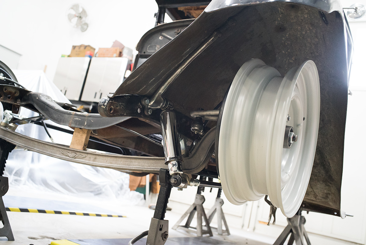

    Getting the brakes on... fitting the fender to figure out shock mount as well as ride height - the idea is for the front fenders to kind of melt over the front rolling stock.

  4. louisb
    Joined: Oct 13, 2008
    Posts: 1,128
    louisb
    I want to see how you do the upper shock mount with the fender support.
    --louis

    Here ya go...

  6. Speedy Canuck
    Joined: Jun 3, 2010
    Posts: 3,926
    Speedy Canuck
    Just to clarify, that's a wing and a stud welded to the fender bracket?

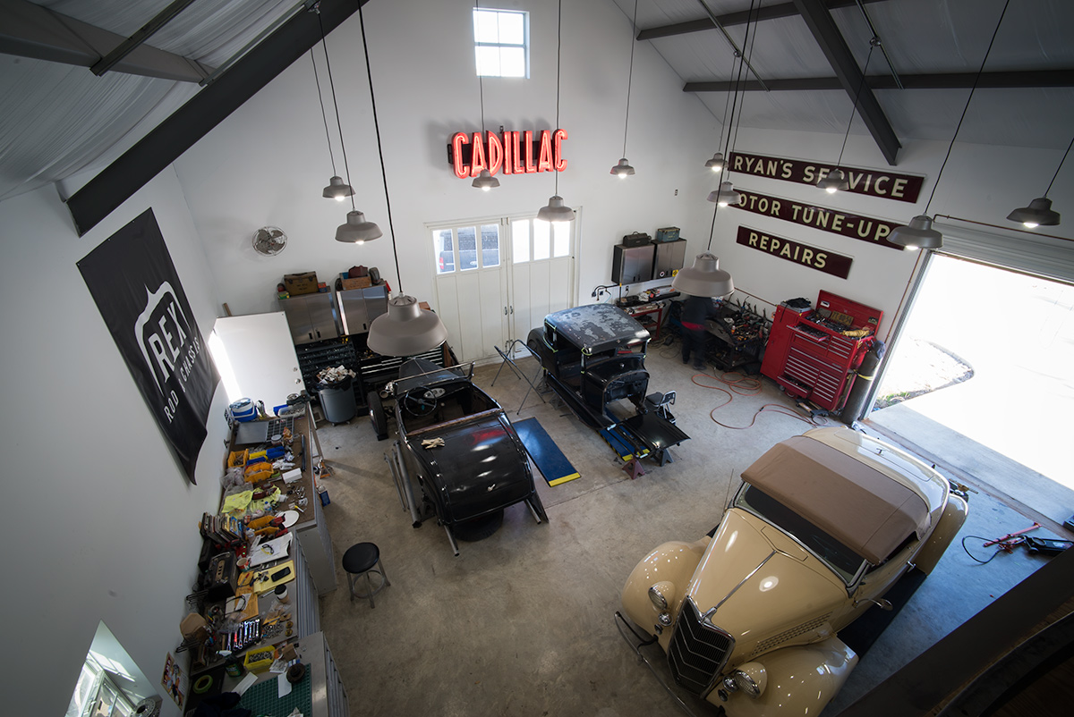

  7. Arominus
    Joined: Feb 2, 2011
    Posts: 394
    Arominus
    Im so jealous, i want a shop to work out of. As it is its working out of the carport on the OT DD and out of the old mans 2 car when i can on the on topic. This is some great work on the car as well, enjoying the thread and looking forward to seeing the finished project.
  8. Tim
    Joined: Mar 2, 2001
    Posts: 21,573
    Tim
    from KCMO
    Cool idea but I take it your not expecting much travel out of it or that's a mock up shock?

  9. Old-Soul
    Joined: Jun 16, 2007
    Posts: 3,807
    Old-Soul
    I think that must be a mock up of the front susp. at full travel? Only one leaf there.
  10. Ryan
    Joined: Jan 2, 1995
    Posts: 23,392
    Ryan
    ADMINISTRATOR
    Yeah, it's just a mockup at this point.

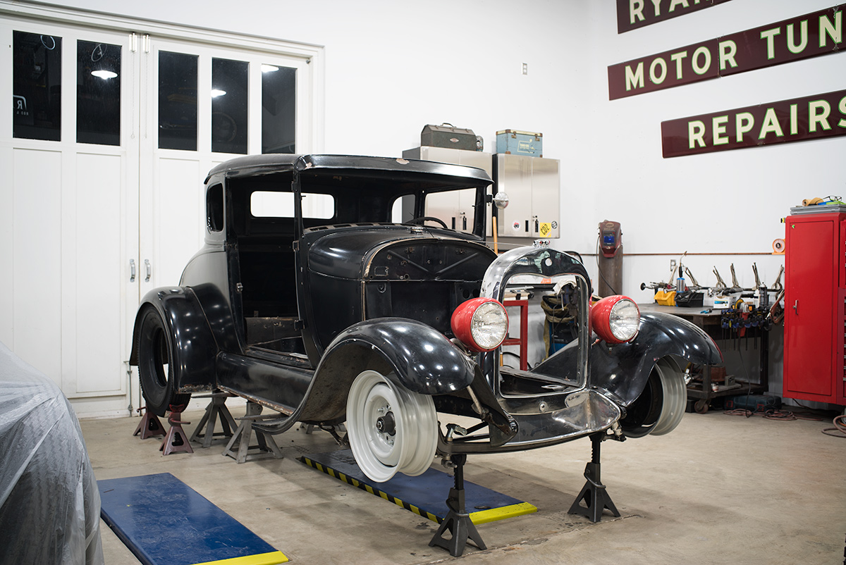

  13. BuiltFerComfort
    Joined: Jan 24, 2007
    Posts: 1,619
    BuiltFerComfort
    If you squint and tilt your head it looks perfect as-is.
    russellmn likes this.

  17. Petejoe
    Joined: Nov 27, 2002
    Posts: 12,783
    Petejoe
    Looks like the coupe had too many beers. Or the installer. I prefer the lower headlight location.

    Not to question your choice on those upper shock mounts, but you might want to reconsider their integration with the fender braces. The steel front fenders on my 29 Coupe move around plenty on their own, especially at higher speeds. I would be leery of introducing any other vibrations into the brace/fender/headlight bar mix.

  24. Arominus
    Joined: Feb 2, 2011
    Posts: 394
    Arominus
    This is the best headlight location, the higher mount was.. too high. Keeping them red? i actually kinda like them like that.
    Tim likes this.

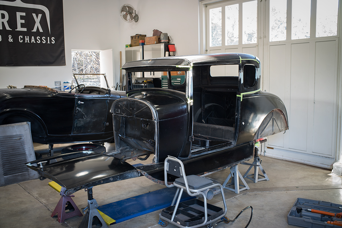

    So, one of the biggest challenges with a survivor car like this is making everything jive from a visual standpoint without getting all stupid with fake patina. The chopped top was handled pretty well with paint, but I was worried about the headlights. We found some cherry 682's, but they were hastily painted red at some point. My thought was to leave them red figuring that they might actually look kind of cool, but Keith was having none of it.
    He got out the aircraft stripper, brushed it on, and then quickly s****ed it off before it was able to penetrate the black paint that was immediately below the red. I'm absolutely shocked it worked:
    Once done, Keith used water and a finger nail to get the little bits off. He then buffed the whole thing out. The result is a headlight that perfectly matches the rest of the car:
    Silly, I know, but **** like this gets me all fired up... I'm falling in love with this little coupe.
