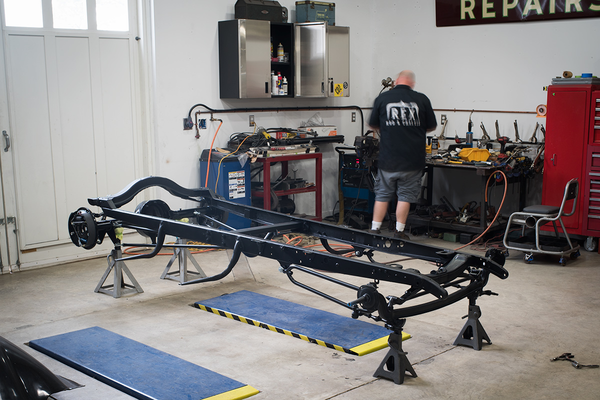

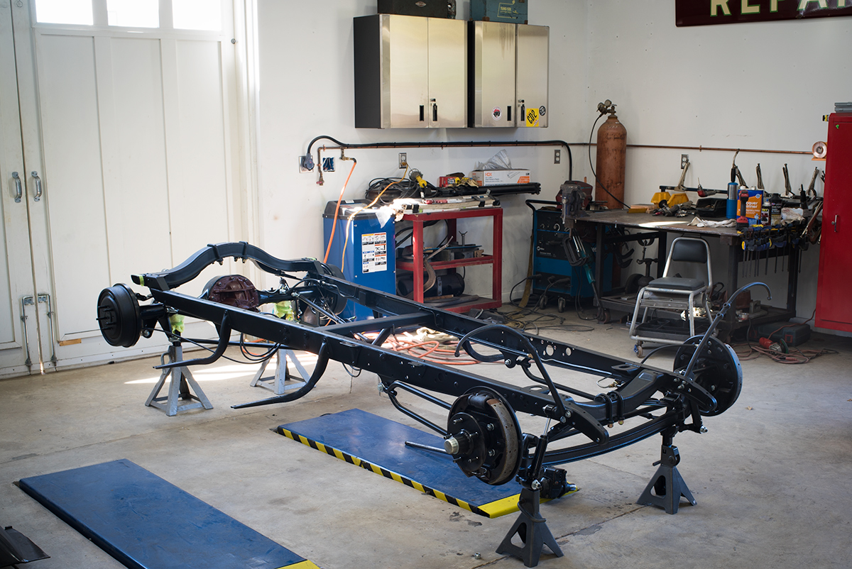

    More progress...

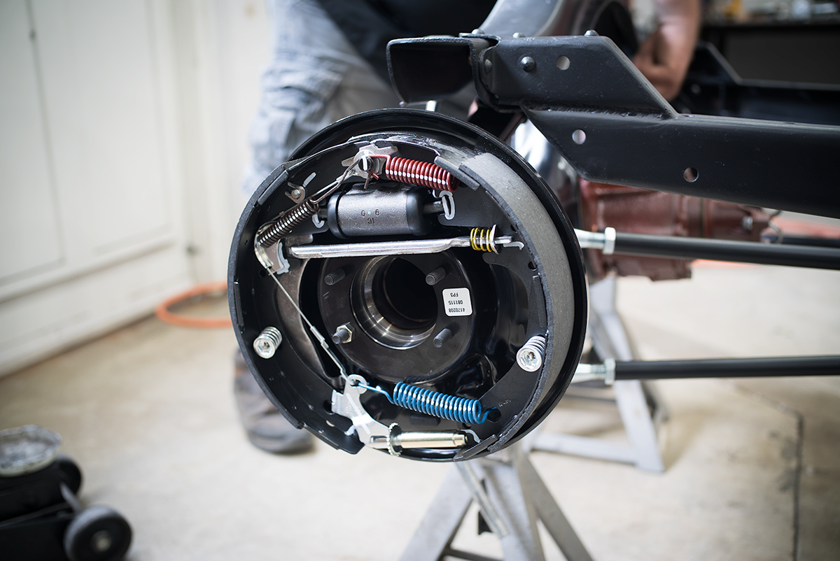

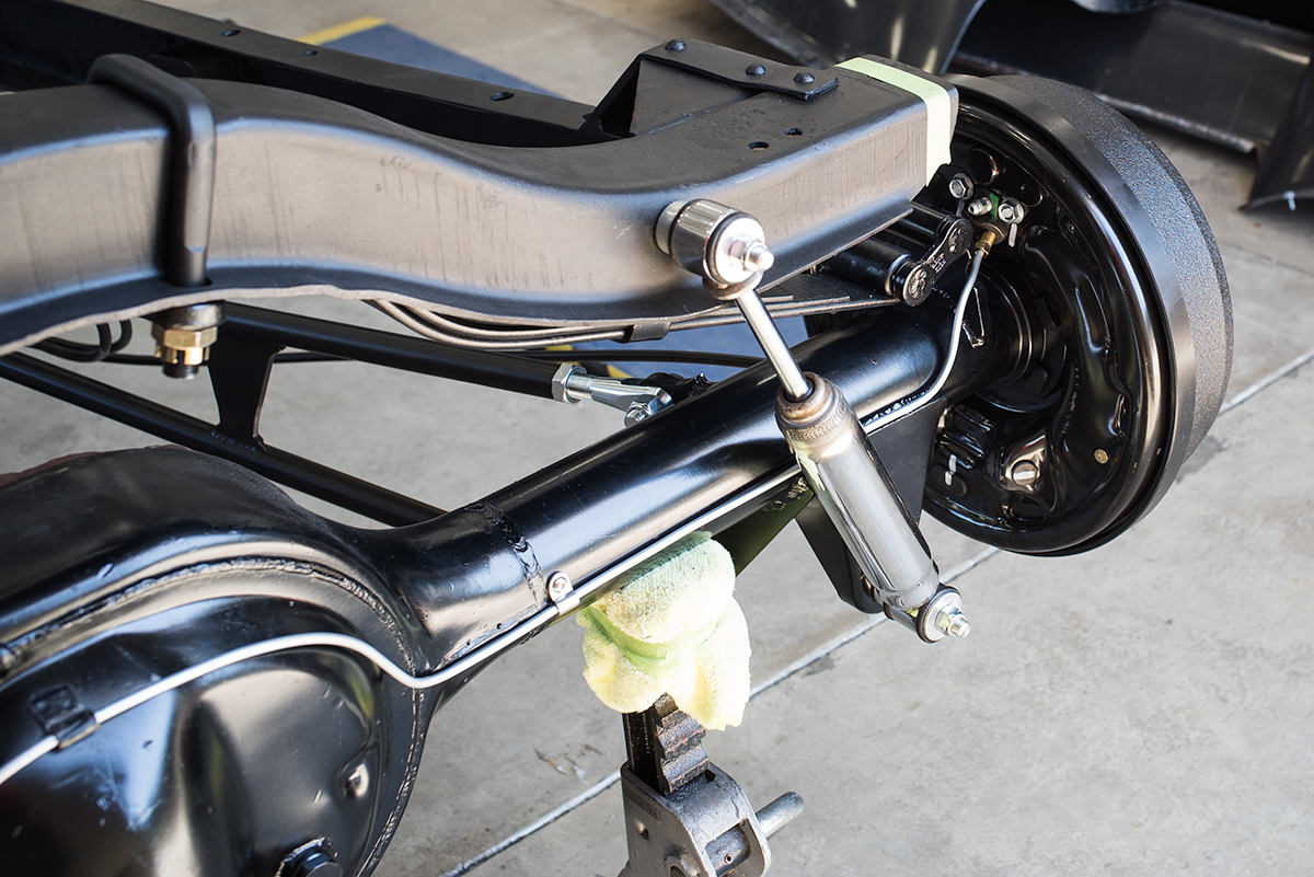

    Minty fresh brakes out back:
    Note smart little notch to aid in brake line clearance:

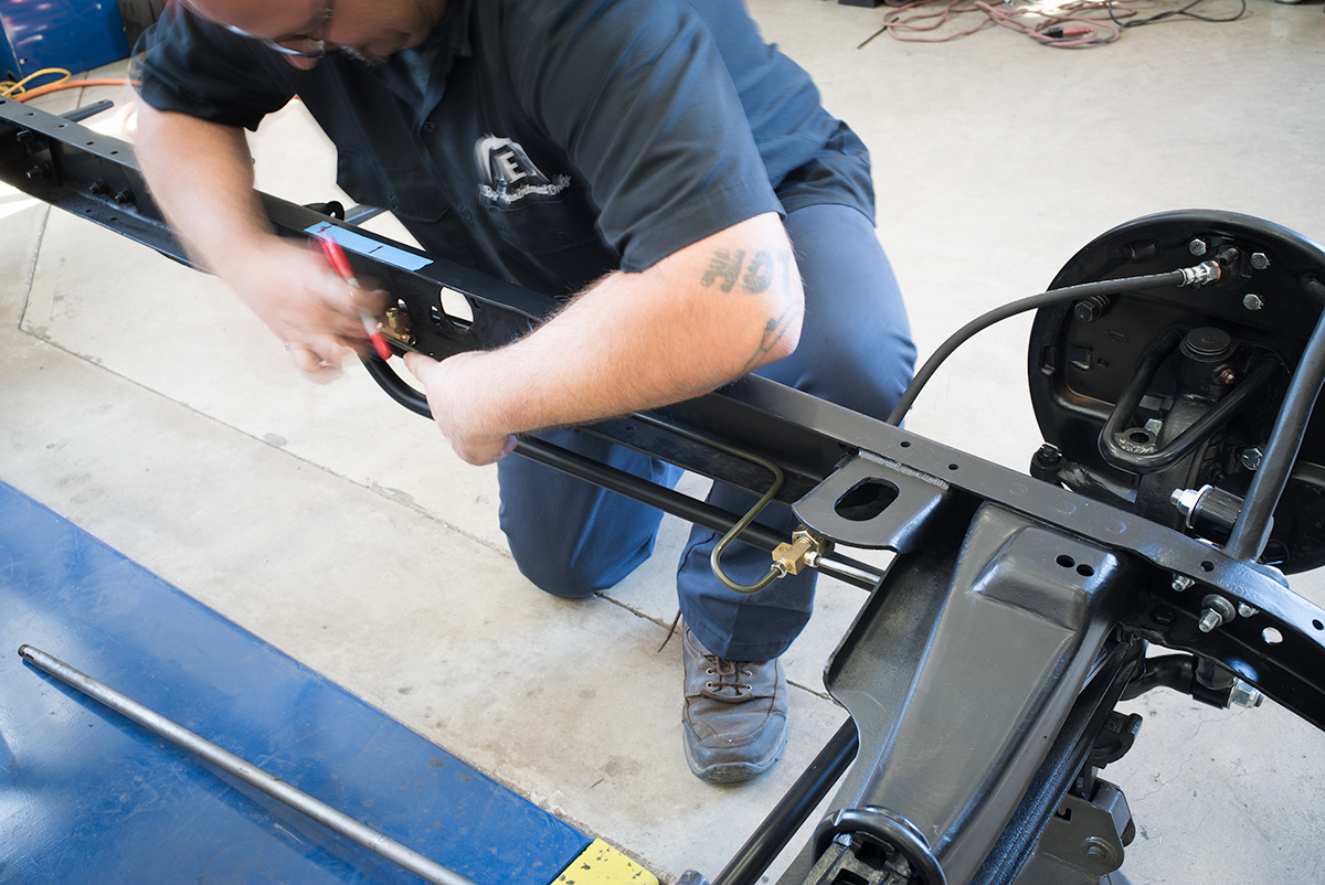

    Today, brake lines....

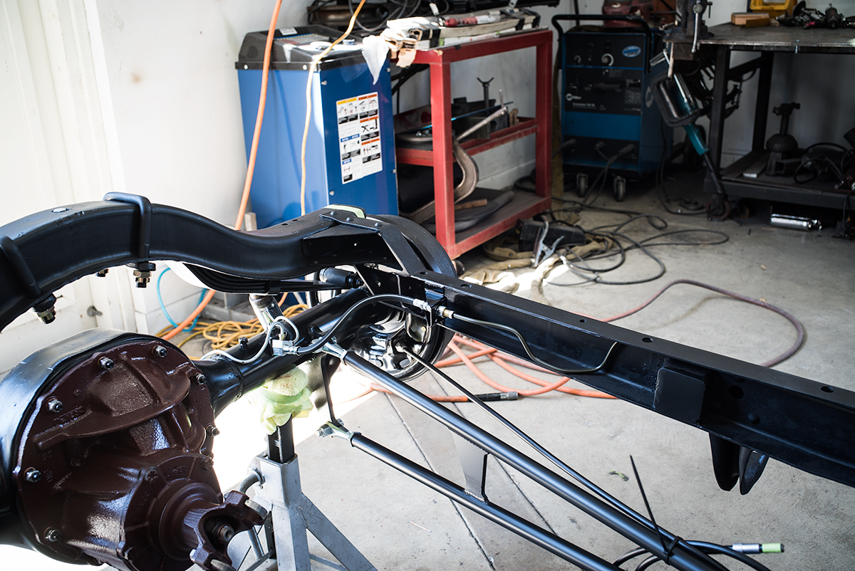

    Brake lines are done!

    Does that hardline from the drivers front to the p***enger front run under the cross member? I'm always curious of how people route hard lines

  25. Ryan
    Joined: Jan 2, 1995
    Posts: 23,390
    Ryan
    ADMINISTRATOR
