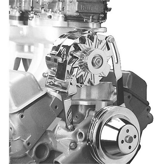

    Here is a similar Alt. Bracket Speedway sells. Used one on a SB several years ago, had to do some shimming to get the belts to line up but it worked good. Not sure how to post a link, so here is a pic of the bracket. Comes plain steel for $50.00.

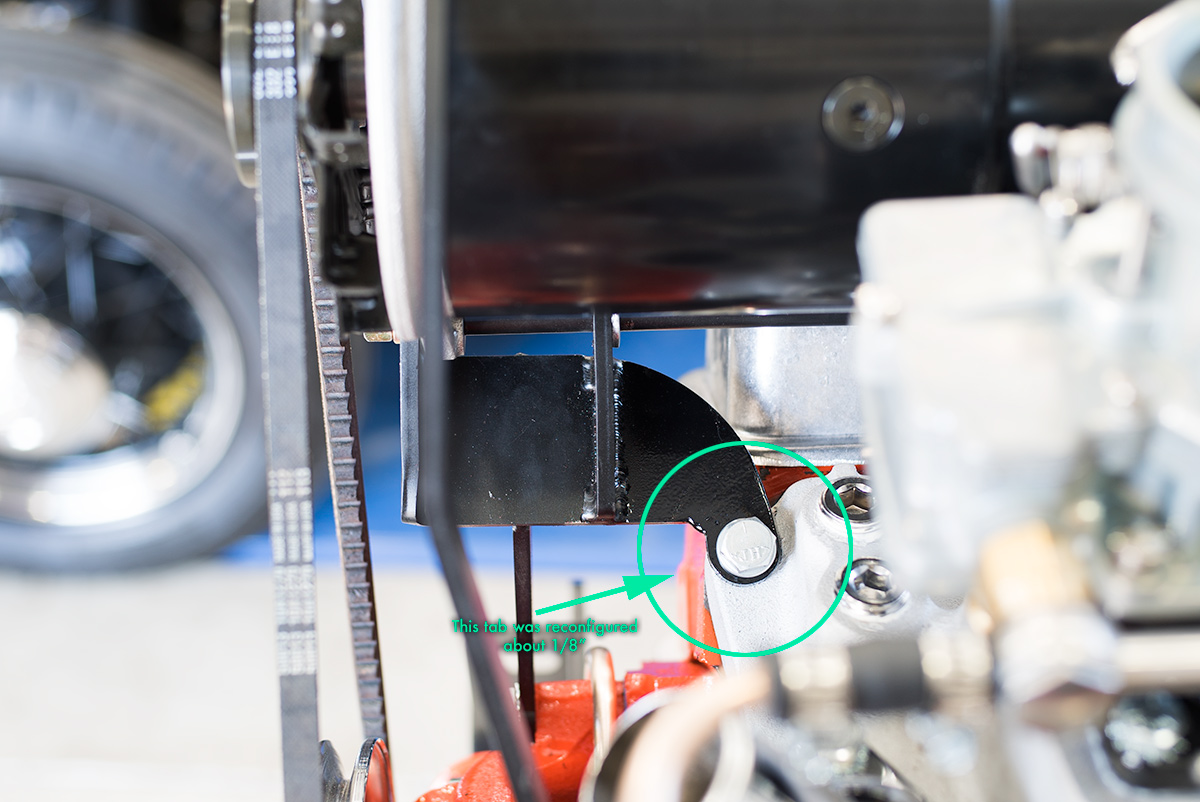

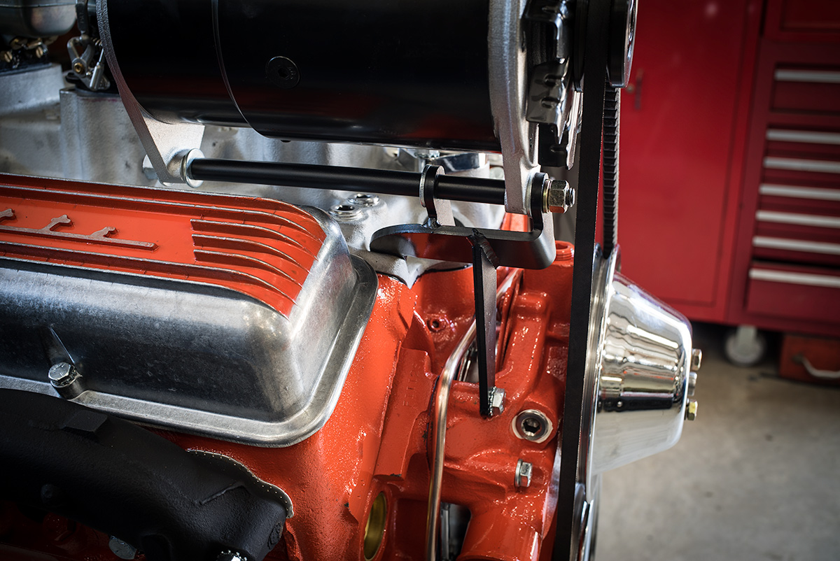

    OK, details on the gen/alt mount... First, buy this thing:
    http://www.est1946.com/so-calalternatorbracket.aspx
    Then, Keith bent and lengthened the top mount:
    Then, he adjusted the tab on the bottom mount so that it once again lined up with the p***enger side front intake bolt:
    Then, he added spacers between all these tabs:
    Final look:
    Keith also mentioned that if you are gonna use a real generator, you are gonna need to figure out support for the extra weight.
