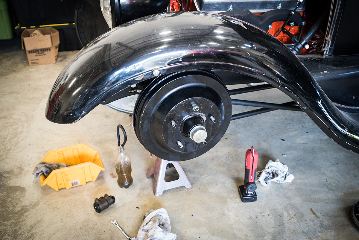

    Late, frustrating night last night... Progress was mounting and then, for the third car in row, brand new wheel cylinders from Macs leaked like mad...

    Do your wheel cylinders have the dreaded "crooked port" disease? Need to make sure the shoes are adjusted all the way out to the drums before putting fluid to them. The old fashioned internal springs in the cylinders help too, if you can find some.

    I did a lot of reading on the brake cylinder problem over the years and a lot of searching. I ended up ordering Raybestos wheel cylinders thru rockauto and have had no problems.

    The plan all along was to have this thing running and driving for the round up without doing some kind of a hurried thrash. Keith and I just don't really believe in thrashing on a car... Sure it can be fun if it's a private car for yourself, but if it's a customer's car it just seems kind of irresponsible.... or, at the very least, a plot for a reality show... I hate reality TV.
    Anyway, this plan was going swimmingly until last night. Keith was ****oning up the car, getting her full of fluid, etc... He fired it to warm up the motor and tune the carbs when he noticed some oil on the ground in front of the car. Further investigation shows what appears to be either a bad front main seal or a bad seal at the front of the oil pan. Whatever the case, the motor has to come out for a proper fix...
    So, rather than thrash we've decided to leave the car at the shop this weekend. **** happens...
