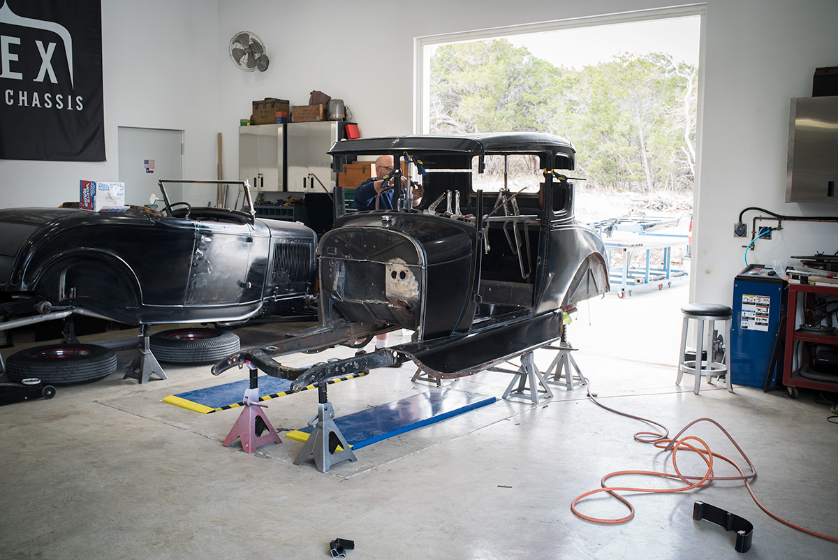

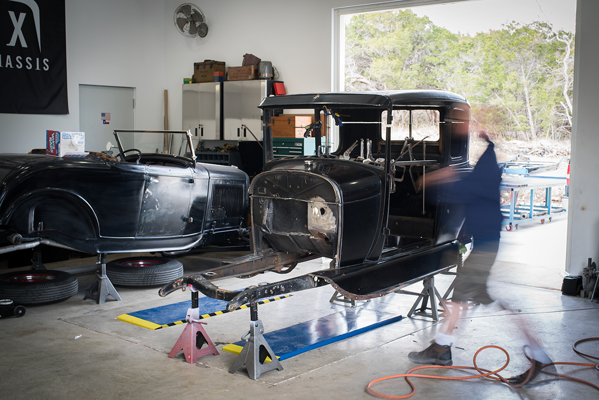

    A live update:
    kiwijeff, AHotRod, Tim and 2 others like this.
  12. Danekejt
    Joined: May 27, 2012
    Posts: 106
    Danekejt
    from Pa
    look at that, he works so fast he's a blur. you need to setup a web cam. well maybe not, then i'd get nothing done at work. seriously yes a webcam so we can watch the flash at work.
  13. Ryan
    Joined: Jan 2, 1995
    Posts: 23,388
    Ryan
    ADMINISTRATOR
    Henry is gonna be pissed.
    kiwijeff, AHotRod and Paul like this.

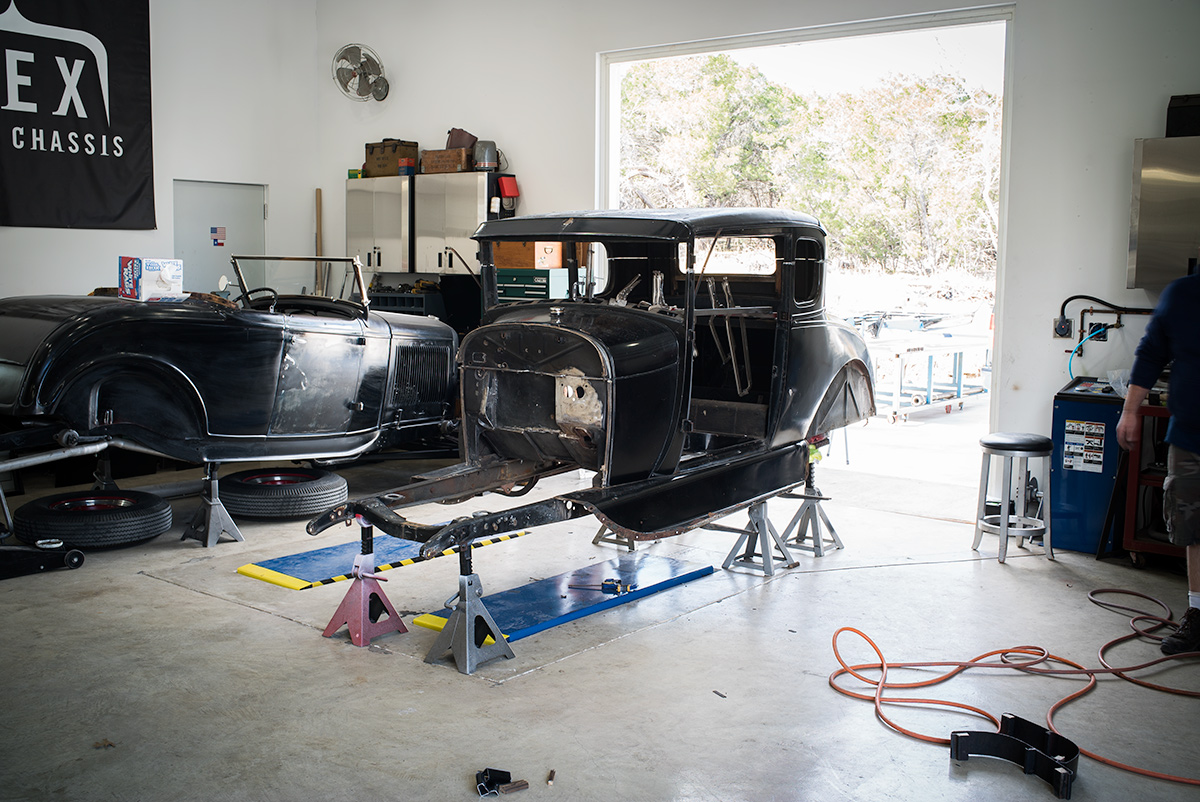

  16. Ryan
    Joined: Jan 2, 1995
    Posts: 23,388
    Ryan
    ADMINISTRATOR

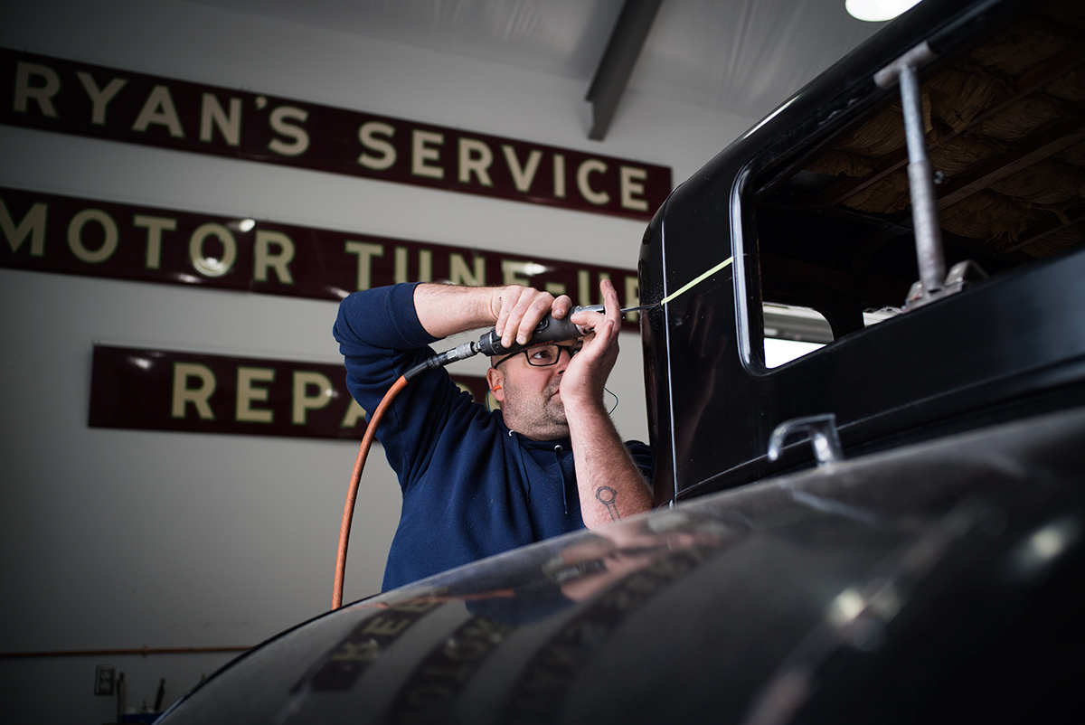

    Picken' em up and puttem' down fellas...
    This just felt right... Three inches... a good odd number...
    catdad49, kiwijeff, AHotRod and 3 others like this.

    ok seriously jealous up here. working on cool cars all day. skills blessed from the hot rod gods and to boot you have the door open showing off green leaves beautiful weather and wearing shorts. :)
  18. louisb
    Joined: Oct 13, 2008
    Posts: 1,128
    louisb
    I am kind of liking that look. Splash guards with no fenders.

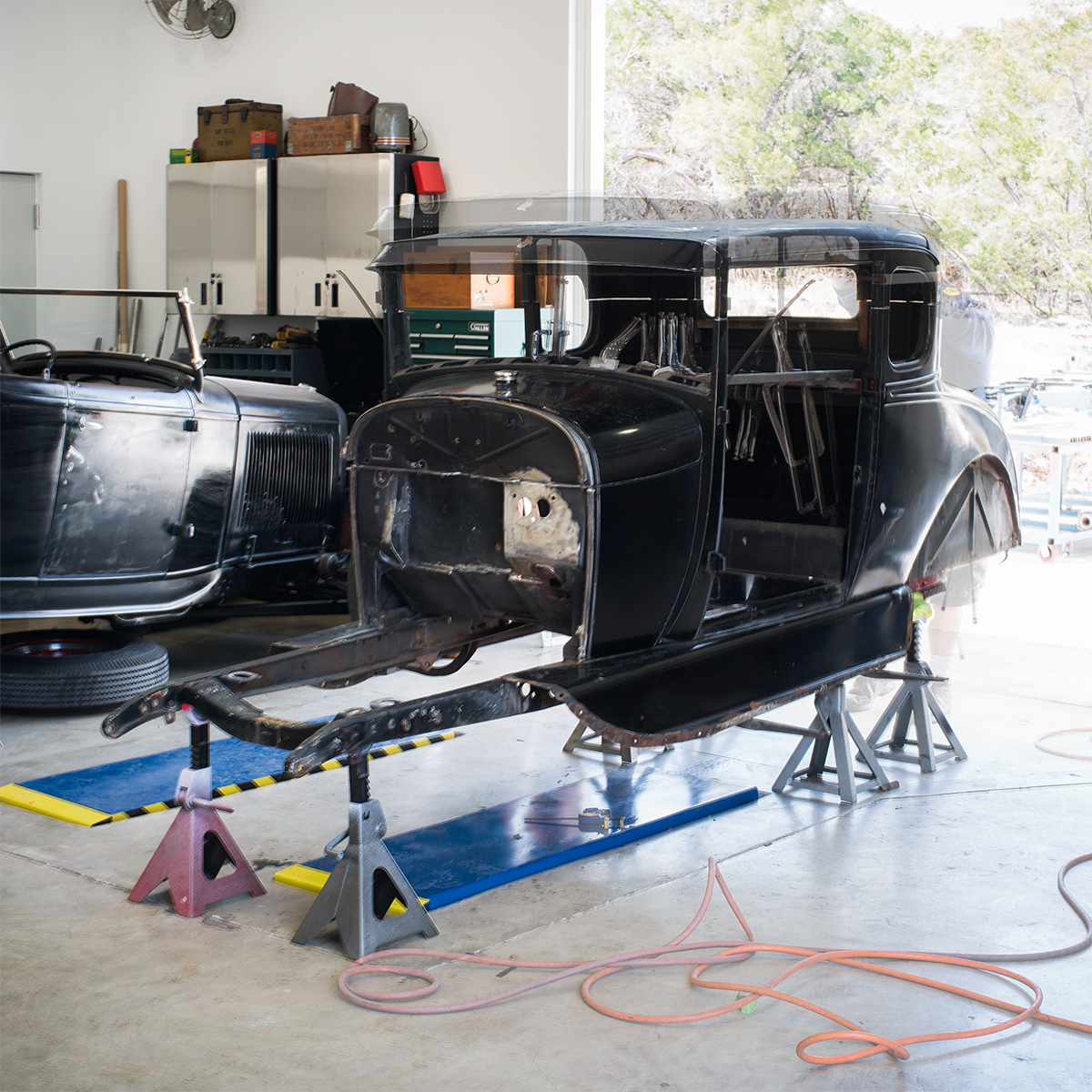

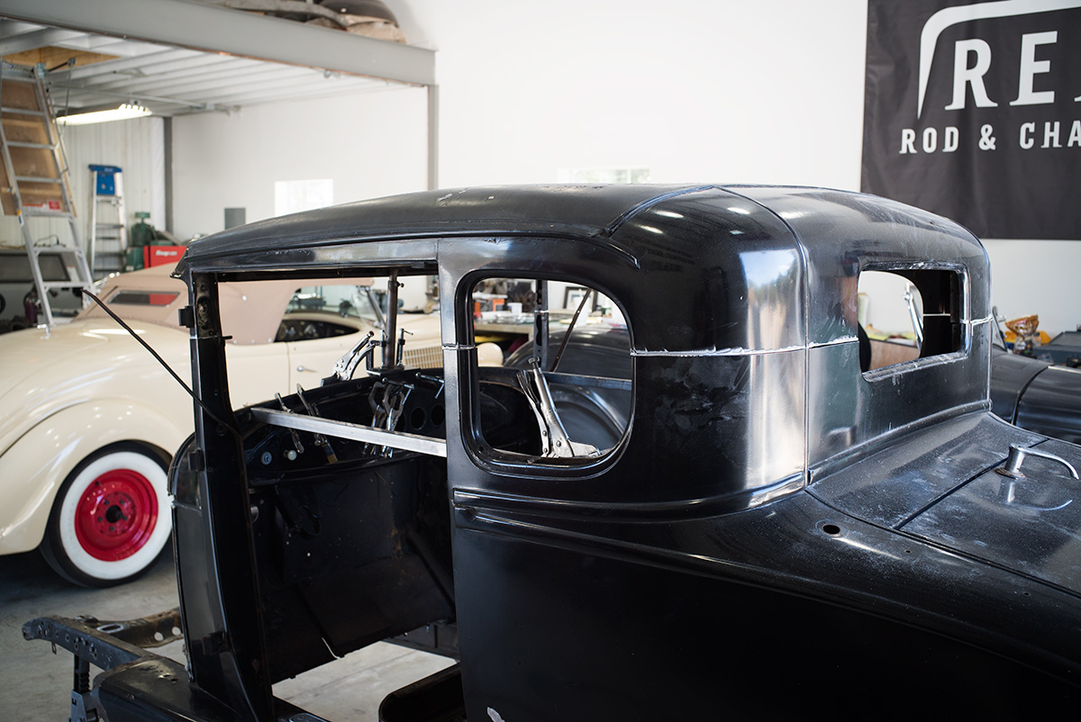

    Upon further review, needs more chop...
    Today I learned that 28/29 coupes are actually taller than their 30/31 brothers.
    kiwijeff, kidcampbell71, Paul and 2 others like this.

  21. Ryan
    Joined: Jan 2, 1995
    Posts: 23,388
    Ryan
    ADMINISTRATOR
    Another real time update before our lunch break... We took another inch or so out of her... As it stands, we are just over a 4" chop now and it's starting to feel a little sinister. The trick here, of course, is to reach the point of "sinistation" without going over and achieving "stupidation." There's a small margin to play with.
    I'm thinking we are in it now.
    Baumi, BradinNC, AHotRod and 8 others like this.

  23. tb33anda3rd
    Joined: Oct 8, 2010
    Posts: 17,595
    tb33anda3rd
    if you go lower, take it out under the rear window.
  24. Hitchhiker
    Joined: May 1, 2008
    Posts: 8,594
    Hitchhiker
    You're using model A parts. That doesn't count
    I was gonna say 3 inches on a 28-29 equals 2 on a 30-31. take another inch out. but you guys already got that covered.
    gwhite likes this.

  27. Tim
    Joined: Mar 2, 2001
    Posts: 21,566
    Tim
    from KCMO

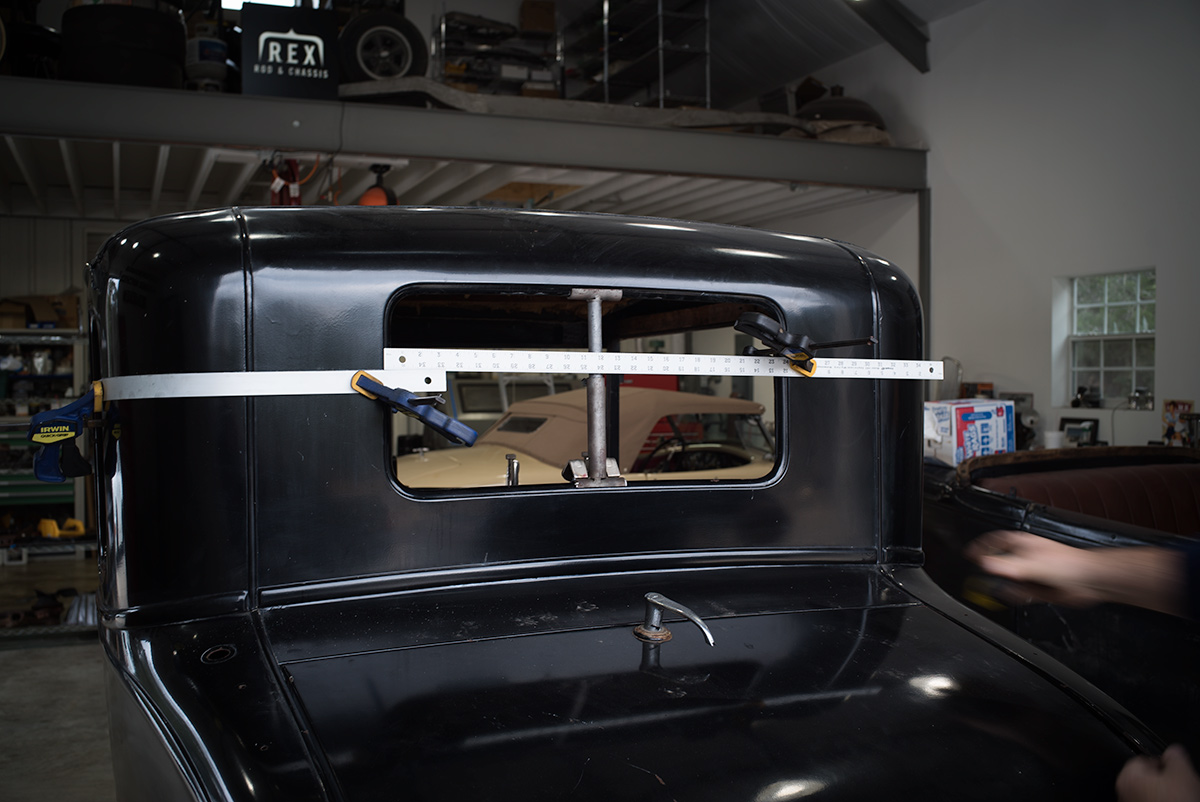

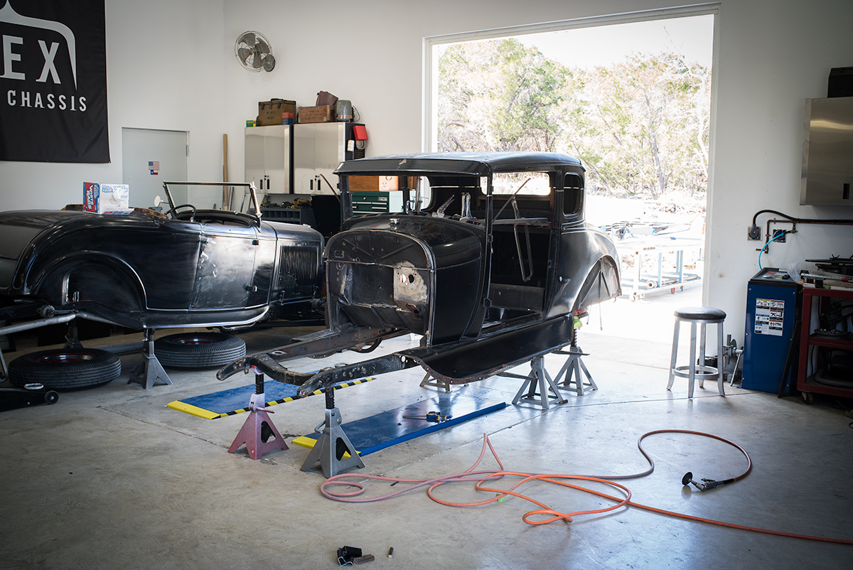

    Gotta say that's the first time I've seen both sides of the chop cut with the top still floating over it!
    Any particular reason you guys did that? With the bracing and the tubes front and back I ***ume you could slide the top down after cutting it for a quick preview to see if it look right or not.
    Seems like all the time messing with the sliding front and back braces and cutting around a top floating there would end up being more than just picking the top back up and taking a look however.

    I am guessing so he can do it without help.

    The extra 1" looks better. Although I am afraid my 6'-2" frame would never be comfy. Great work.
