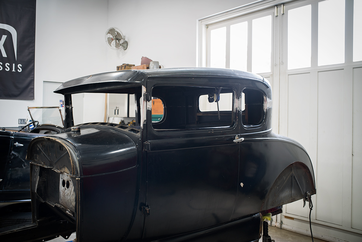

    Earlier, someone asked about the details of slicing and dicing the a-pillars for fitment. Obviously, once you cut the top off, cut out the amount you wanna chop the car, and then set the top back on, you are left with a top that is a hair wider than the bottom. This is most notable at the a-pillars. If you just rough it together and call it a day, then your doors won't gap nicely and you'll be lucky if the windshield frame sits flush with the opening. In other words, the a-pillars have to be square on two planes... Here's what Keith did on the door side of that equation...
    In this shot, you can clearly see that the top of the a-pillar sits proud of the bottom:
    So, Keith made cuts along the pillar and then pried the remaining "flaps" to get them flush:
    Some pry work along with some body hammer work leaves you with a good straight line. Weld it all up and you are left with this:
    Pretty good, right?
    Repeat on the windshield side of the deal and then do the same damn thing on the other a-pillar and you are good to go...

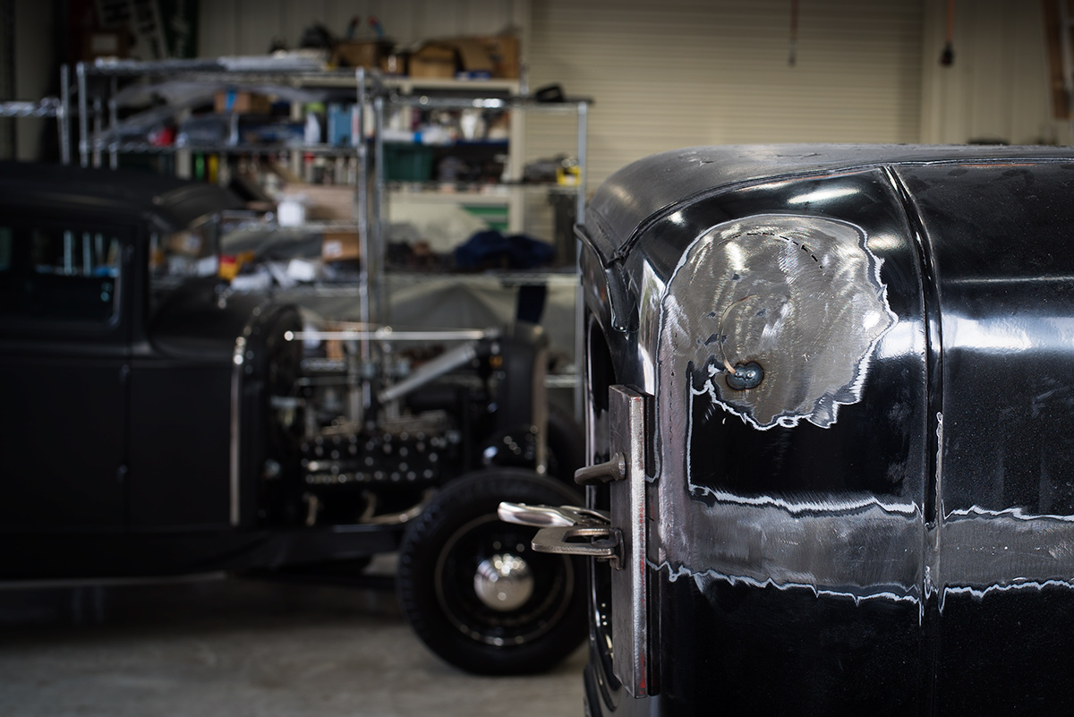

    But what about the *** end of the operation? Typically, you see guys make four or five vertical cuts along the crown of the top - giving them the play that they need to weld everything back together again flush.
    However, at Baileigh last summer @cornfieldcustoms taught me a little trick. According to him, if you make a spring out of the crown of the top (by cutting a curly-q shape), you get the play that you need to fit everything back together again without losing the smooth factory crown. Essentially, it shrinks the area just enough to make it all work.
    Anyway, I told Keith about this and he decided to give it a try:
    It worked beautifully and Keith is now welding it all back up... I'll post some pics when done.

    So the "curly-q" method ended up being more work than expected... but on the plus side, it created a perfect crown. Almost done...
    biggeorge, kiwijeff, waxhead and 4 others like this.

    Hey look, a door!
    Biggest update of the day? Y'all can now shut the hell up about the crate motor. 327 inbound...
