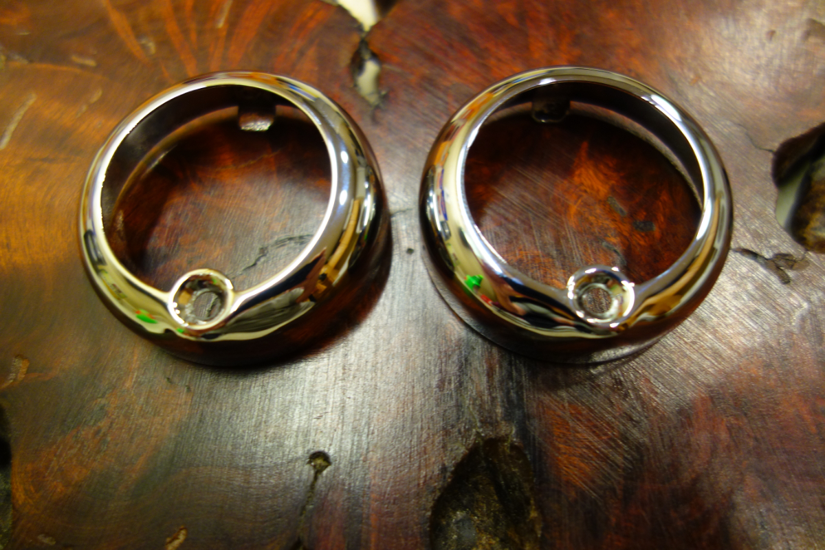

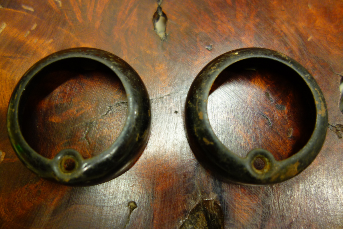

    Another vote for Paul's.....excellent over the years in my case. Last fall sent pics of a couple of pieces to several places, to get a ballpark cost. One was in Salt Lake and recommended on here numerous times.....they sent me a reply of "$250.00". That was extent of their email. Their site didn't say they had a minimum so I'm ***uming they just didn't want to mess with smaller pieces.
    Paul's sent the amount...$90.00, details of what they do, procedure for transit and called me. Took a little less than 3 weeks. DSC00980.JPG DSC00981.JPG
