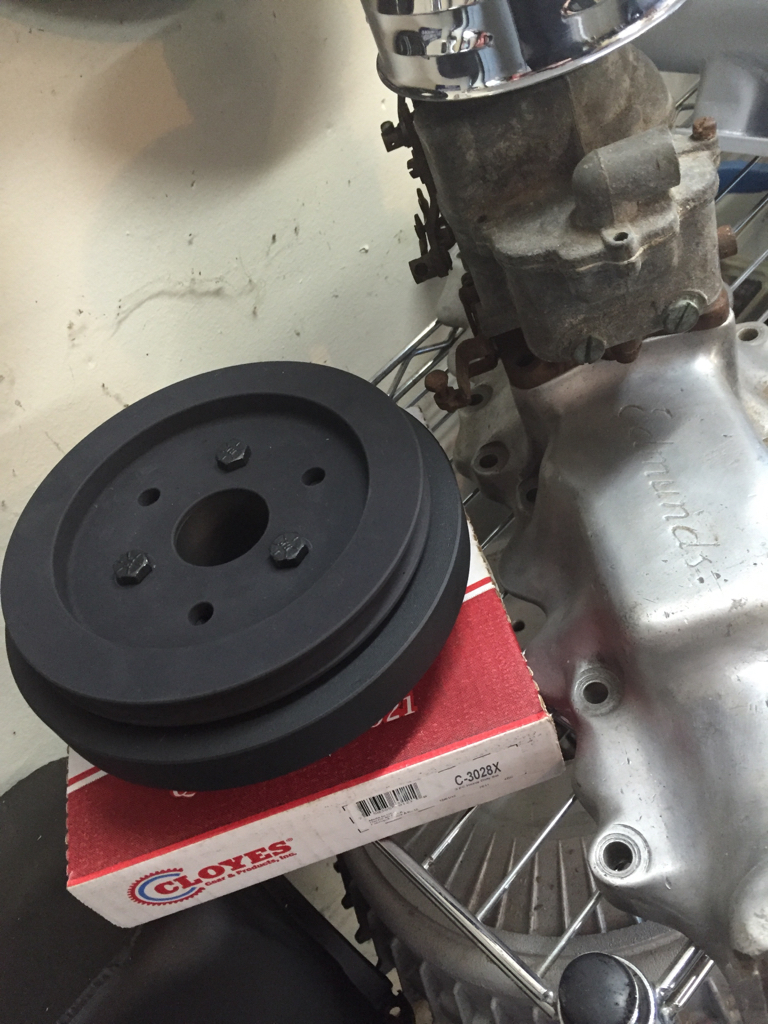

    Another trick, I'll have to get a picture of just how close I cut it, but the distance from pulley to crossmember is stupid tight. Until this little creation came to life I admit I was seriously worried. 340 balancer plus big block Chevy crank pulley machined to fit bought plenty of room.
