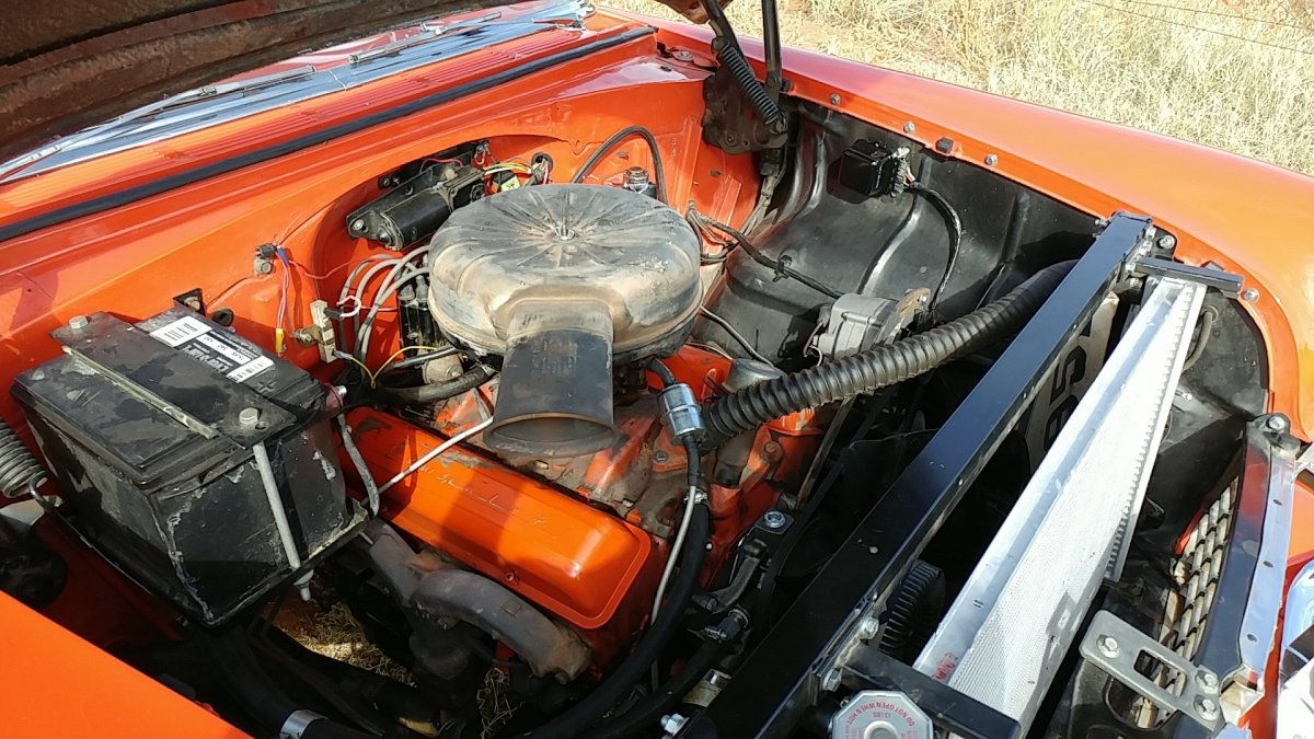

    I’ve got 2 1/2” ram horns on my ‘56. I did what you said and cut off the bracket. I made cut outs behind the front wheels like the old days. I used Danchuk side mounts that move the engine forward a little. With a CPP power steering box everything fits like it came that way.
