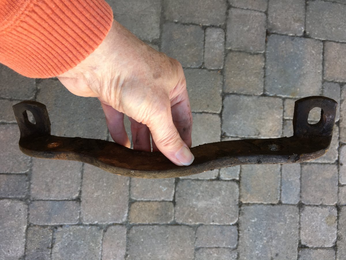

  3. Get a Model B front motor mount and it should all go together, unless I am missing part of the story. In '32 the back of the engine was supported by the transmission. The "B" had antichatter rods which you may need to duplicate. How about some pictures? Do you need a picture of a B motor mount?

  7. Here are couple of pictures. It will bolt right on. The timing cover I show is a Model B but the Model A is the same where it counts. The '33-34 motor mount is similar to the B but wider.

    Thanks for the pictures of the mount. Now I know what to look for. Already got the fuel pump mounted at the back of the frame just ahead of the fuel tank.
