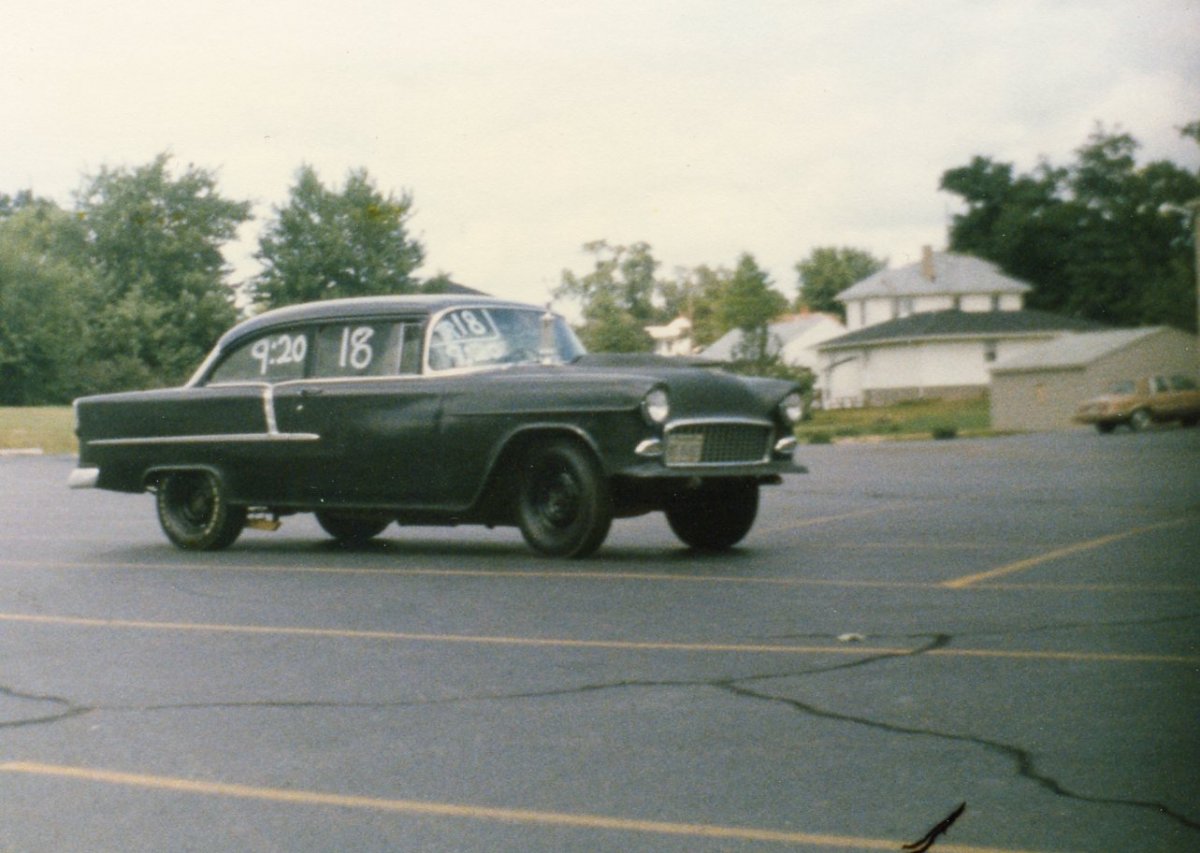

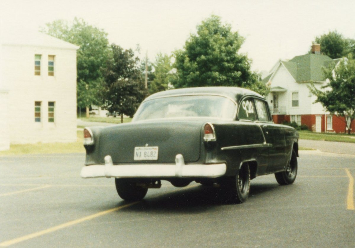

    The stainless parts, (side trim, and the trim around the windows), should clean up well, with either really fine br*** or steel wool. The chromed parts might clean up this way, too....Depending on how rusty, and pitted they are.
    If the chromed parts, (grille, bumpers, etc.), don't clean up very well, try sanding them down....Painting them with silver, and then clear coat them. That's what I did with my 55, when I was in high school, (1978 - 1981). This gave a look similar to the plastic grilles from the 1970's. Couldn't afford new chrome at that time.

    That's a nice looking 55 you have.

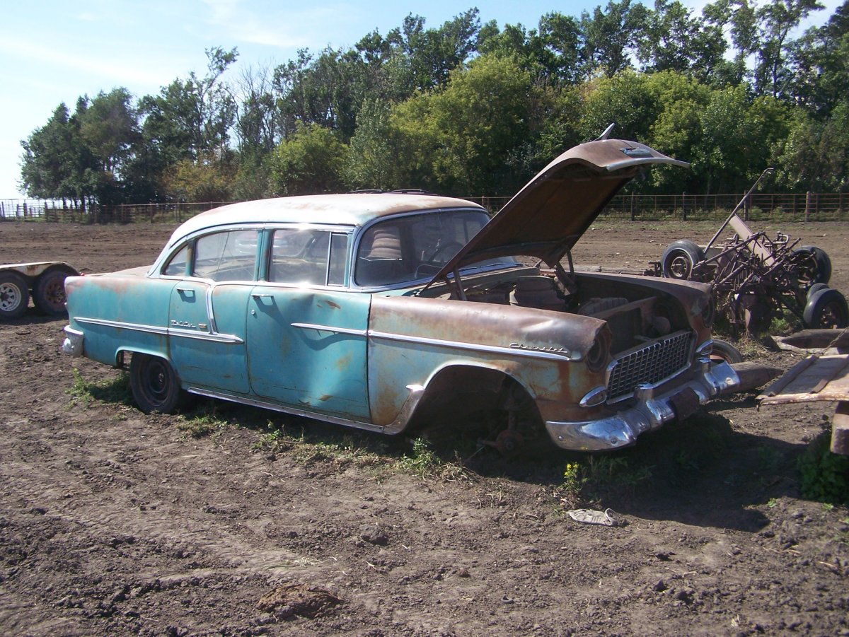

    Congratulations on having a great son who wants to work on old cars, and kudos to you in supporting him. Enjoy this time with him as it goes all too quickly. Maybe this will help motivate him, my sons car he bought just out of high school and a year later (also a 4 door). 55002.jpg 55009.jpg

    Your sons car is awesome,you guys have done s great job on it. I will show mine the pics. And I am sure it will motivate.
