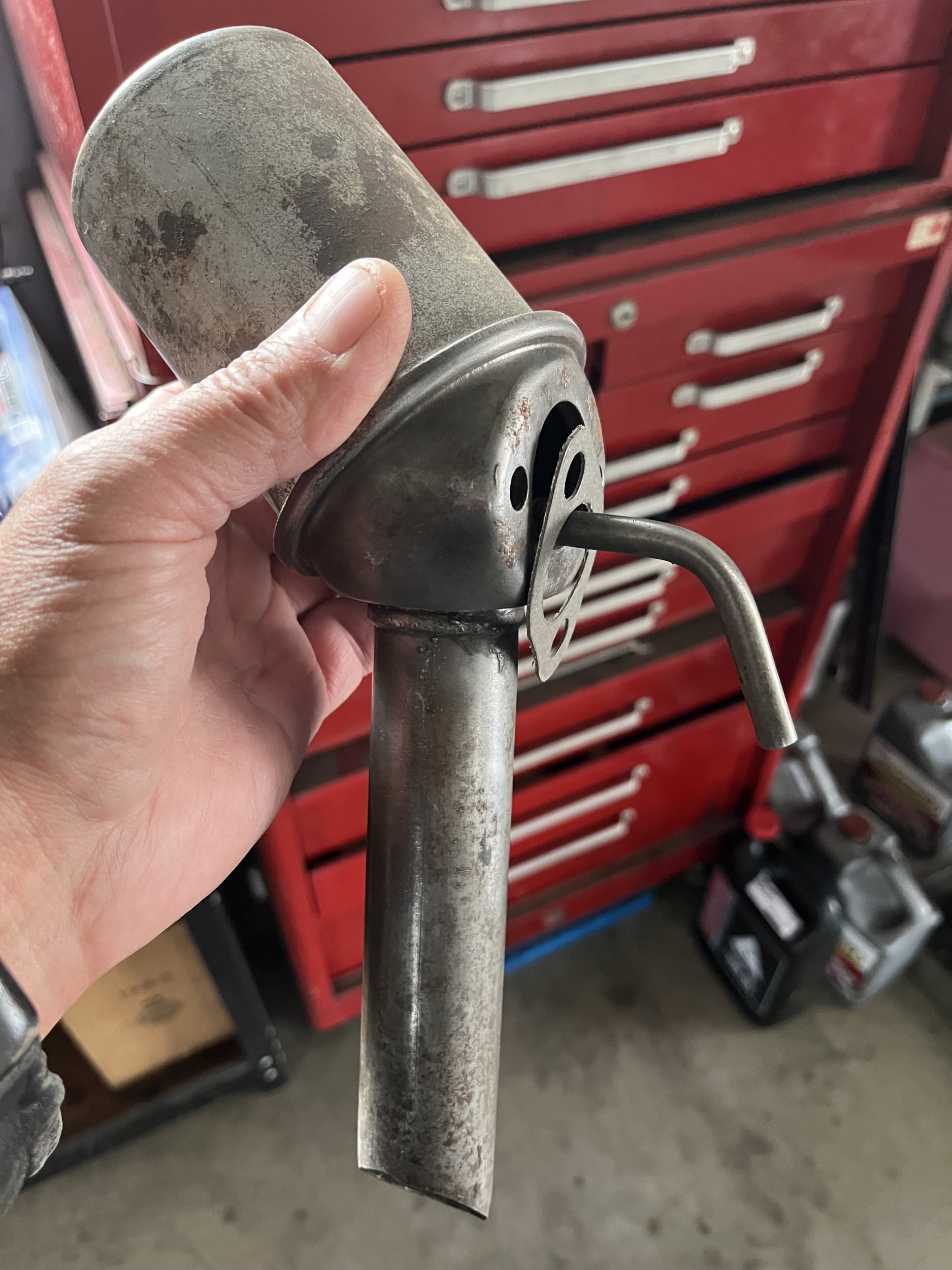

    You might consider pulling the road draft can to check if the drain back line is plugged IMG_2142.jpeg might be the cause of the leakage
  5. ive snaked it a few times... shes just got blowby i think
