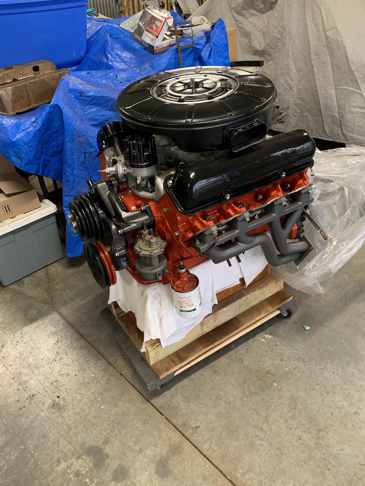

  9. why not a modular, godzilla or LS? the 385 exists after the hamb era, and most importantly doesn't bolt in without serious crossmember modification.
    im going to dress down this engine to look early 60s, sure the block would be a 67 but i can only era correct larp to a point for rarities sake.
    pic via @Jeff Norwell
    also side note: if this is what it is, that accel distributor is leaaaving. im sticking a mallory dual point in it.
    why? cus ive wanted the idea of one thats the only reason.
