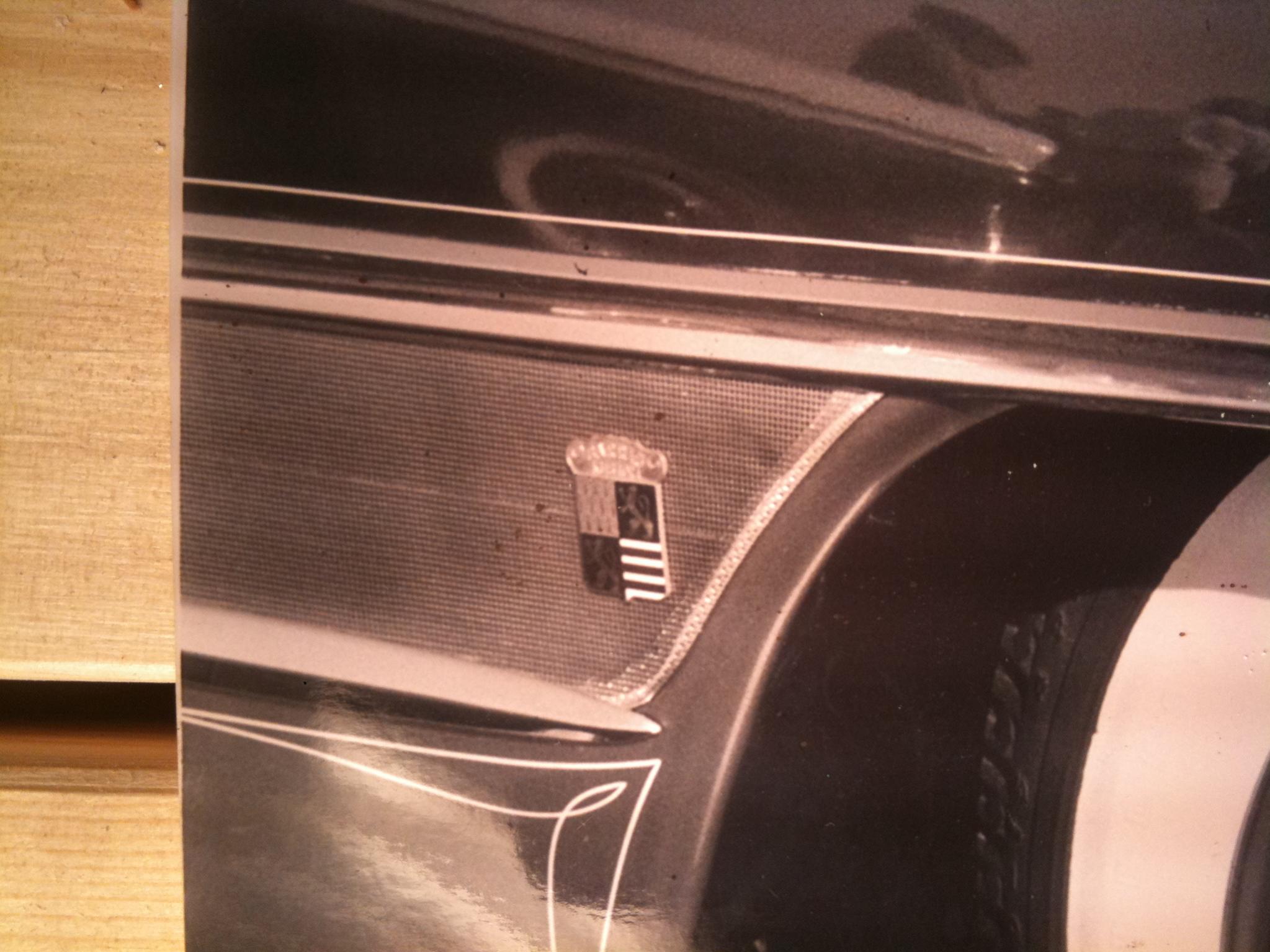

    The vast majority of the pics of this car don't originate with Jr.. Rik Hoving has been working overtime lately rounding them up and putting them on his site. In looking through the ones from Jr's stash I picked out the ones that would help me the most.
    There's a lot going on in this one. I think that George (Barris) took this. You see him in the reflection on the bumper. He has on that beatnik/surfer outfit (hat-shorts-wacky shoes) that he wore at one of the outdoor shows.

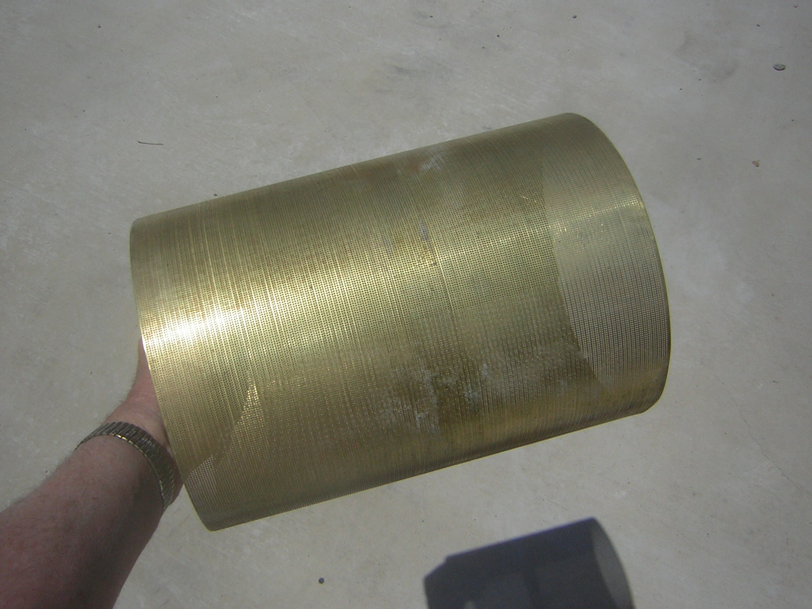

    The thing that impacted me the most was the look at the insert between the mldgs. The blowup revealed that it was perforated br*** sheet with round holes. That enabled me to find it (out there).
    Of course there's also the hub cap (that's for you Gregg), the functional exhaust, and the pin striping. This is the early version of Jr's car. The later version had the chrome reverse wheels (some say the first ones), and the ripple pipes (lakers) that were not functional.

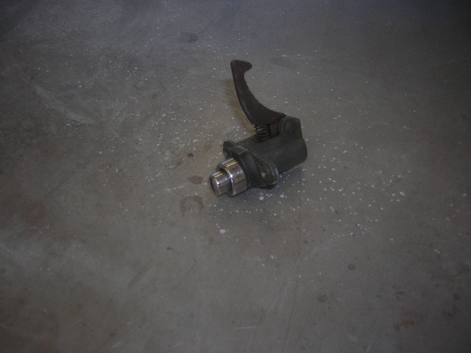

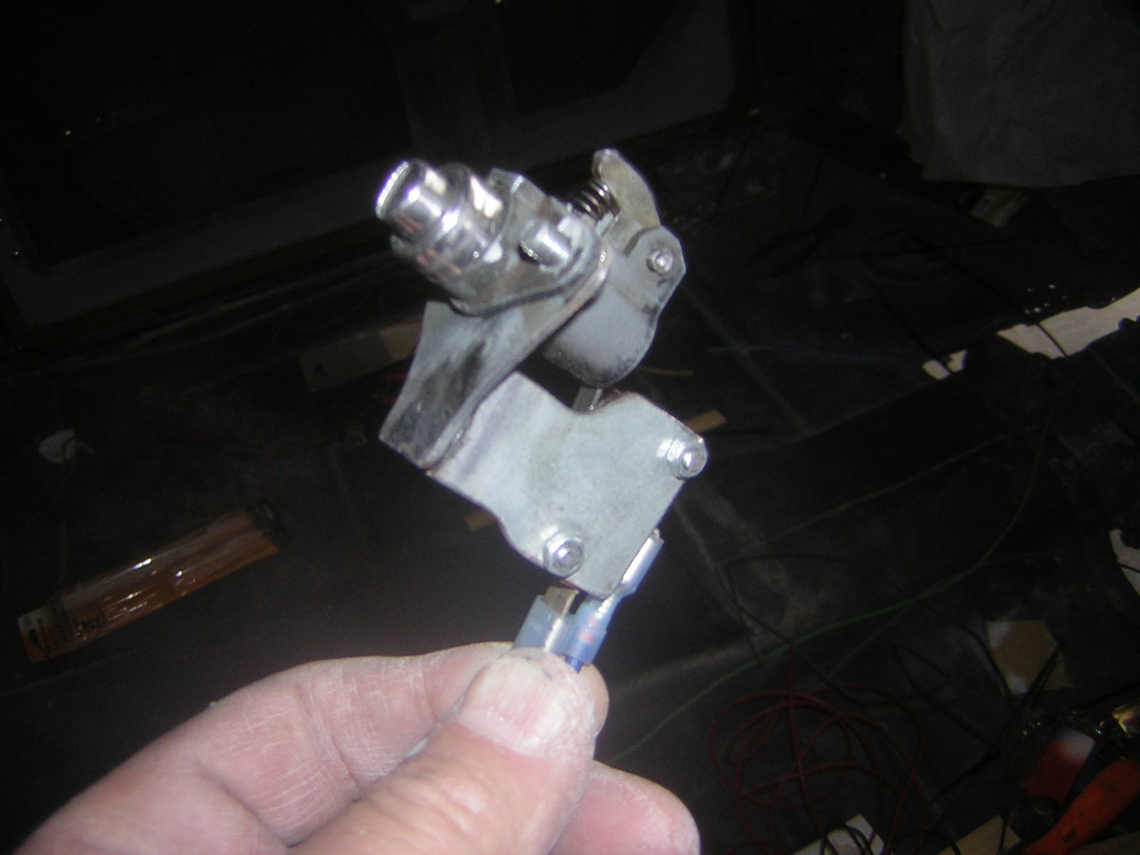

    Sooner or later you become impacted by the fact that doing a clone emmerses you into the particular culture and thinking that represents its time period and location.
    You become surprised by the unexpected. There are things that you would never think of. I always ***umed that those cool door opener ****ons that were located in the most obscure imaginative places that you could think of were part of the lore of custom cars. They were until the lore wore off because of thieves that discovered how to get into your car. So when Jr told me that he had 49-50 Ford glove box door locks in the side trim I was shocked. What right does he have to mess with my custom car ***umptions? With a ****on that has an ugly slot in it! The more I thought about it the more I realized how brilliant it was. You could have shaved door handles and have keyed locks on your car.
    So iv'e said all that to bring us to the door popper technology. We start with this little item.

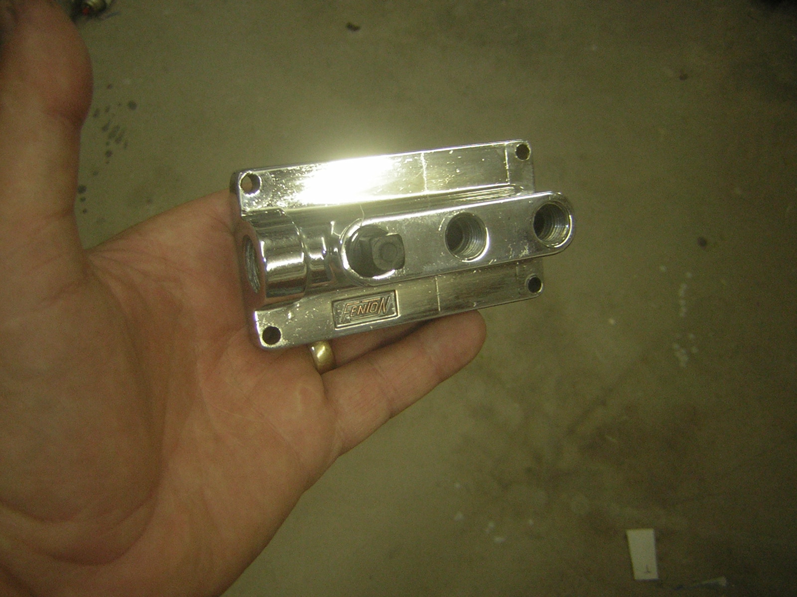

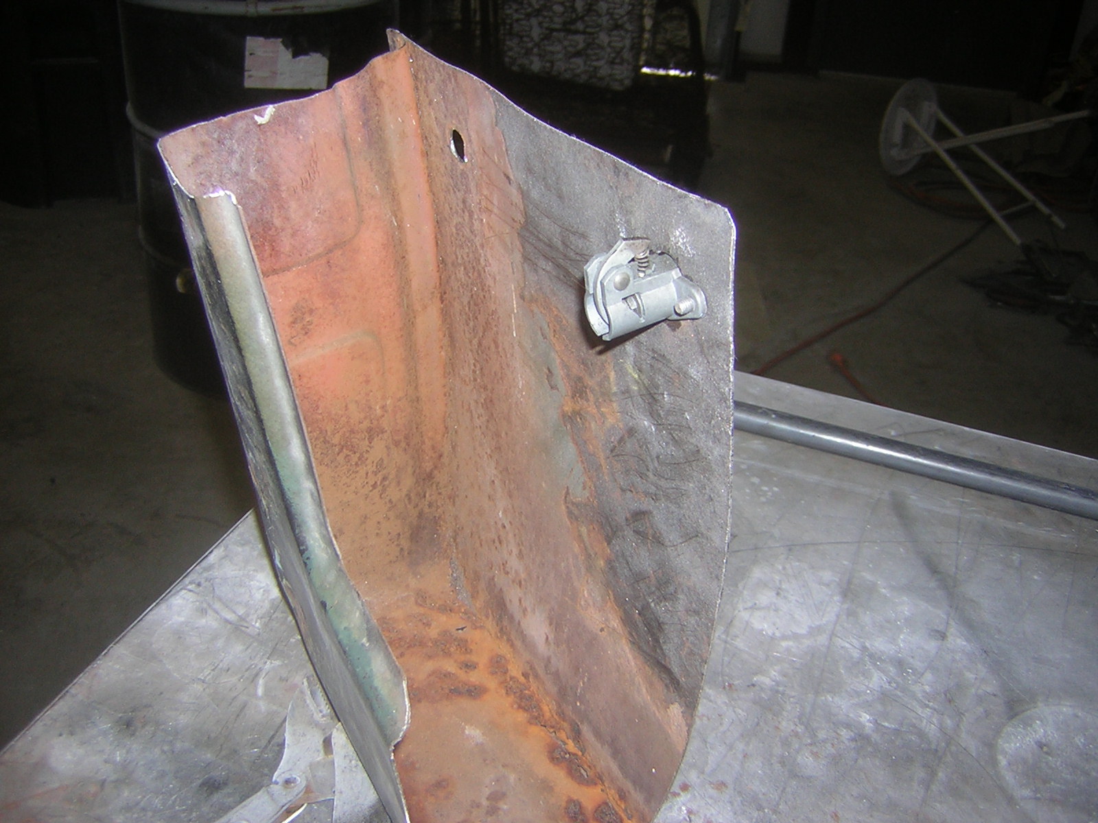

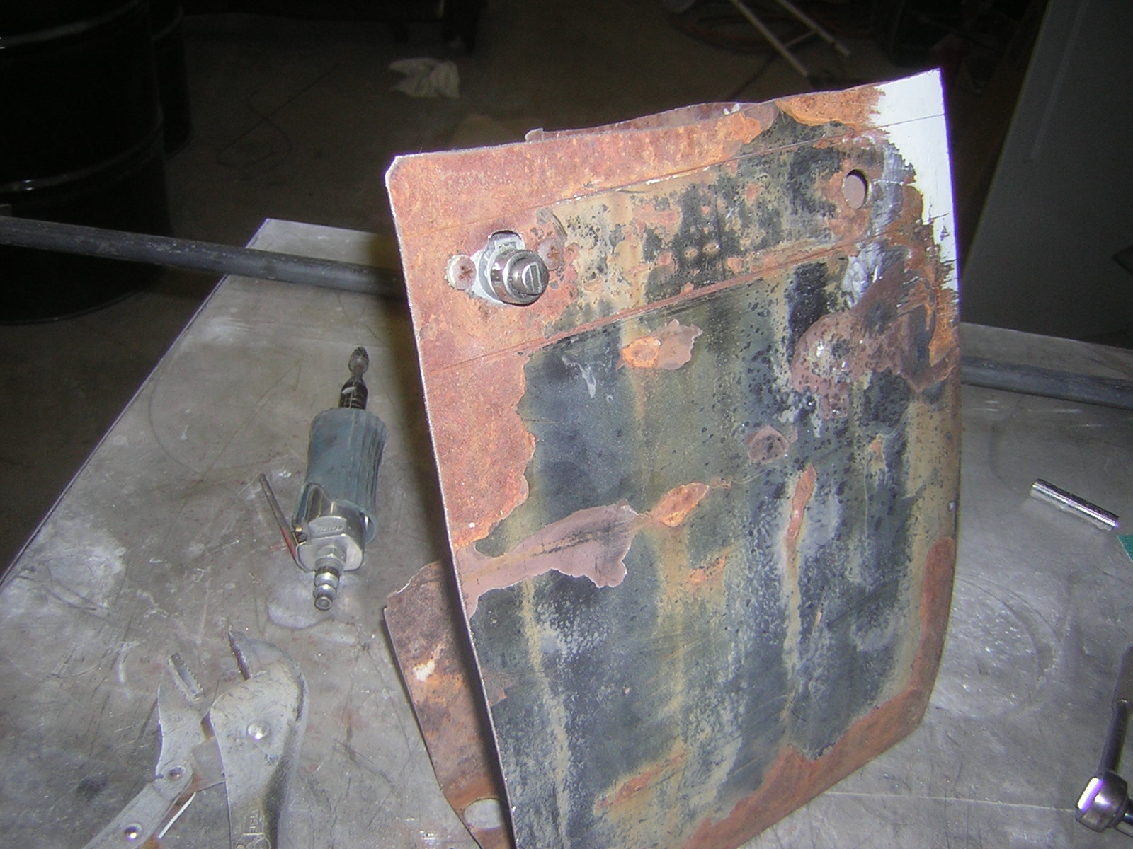

    This shows a mock up using a portion of a rusty door from my parts car. The upper part of the lock lever is removed. There is enough movement at the back of the lock to activate a sensor.

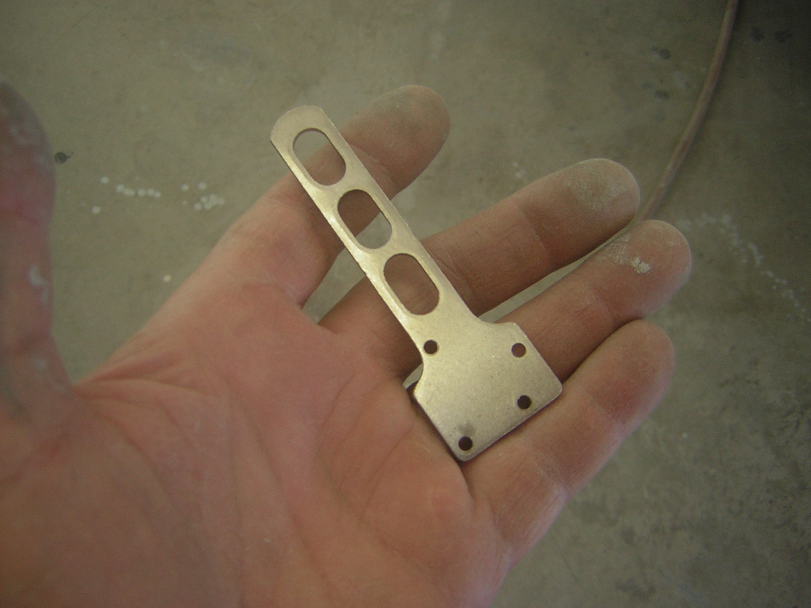

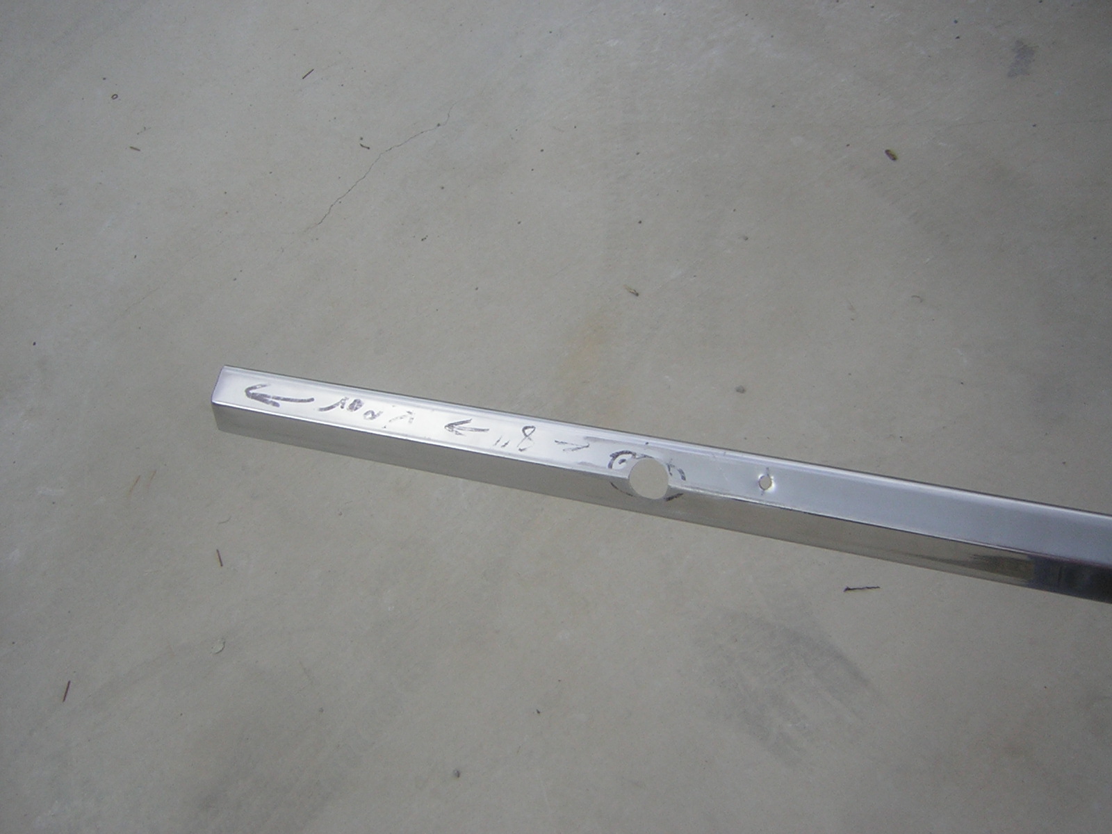

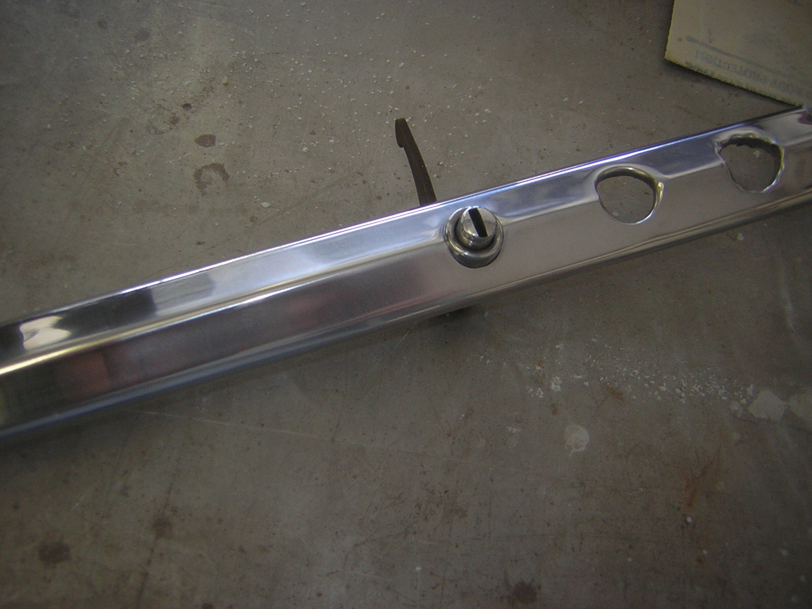

    My stainless guy is struggling to come up to speed (down to speed?). This first pic shows examples of what he thought could be used for the door actuator opening in the lower door mldg. This a surplus piece of mldg. The consideration that constantly hangs over this build is that this is recreating what a 16 y.o. had done in 1955/56. The opening selected is the most simple of the three. The second pic shows the actual mldg that we will use. It has a hole for the 54 Dodge sweep in front of it.

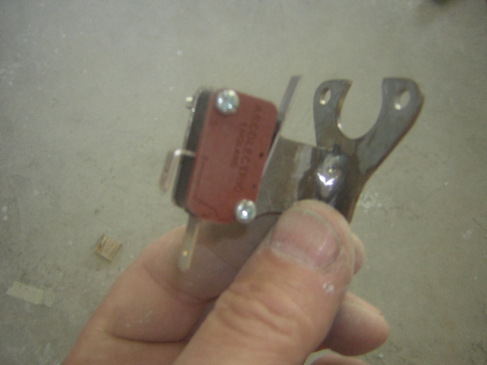

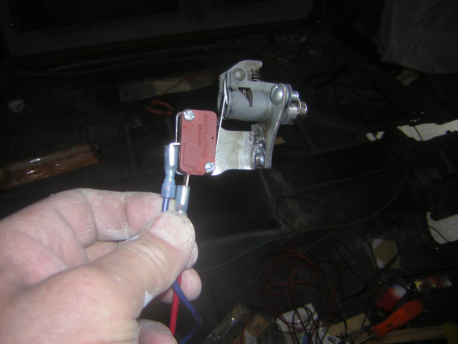

    This will finish up the door popper tech. Here are various looks at the glove box door lock with the sensor attached. There is a bracket that comes with it that we used. I also included the instruction page that shows the I.D. of this sensor. This allows me to fit the stainless trim even though its still pretty rough. It goes back to the stainless shop while we move forward with the last item before paint.

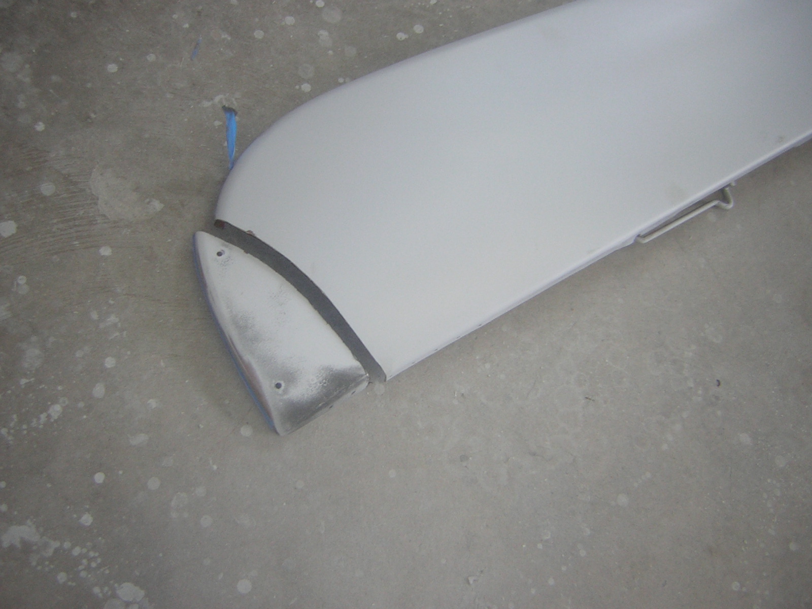

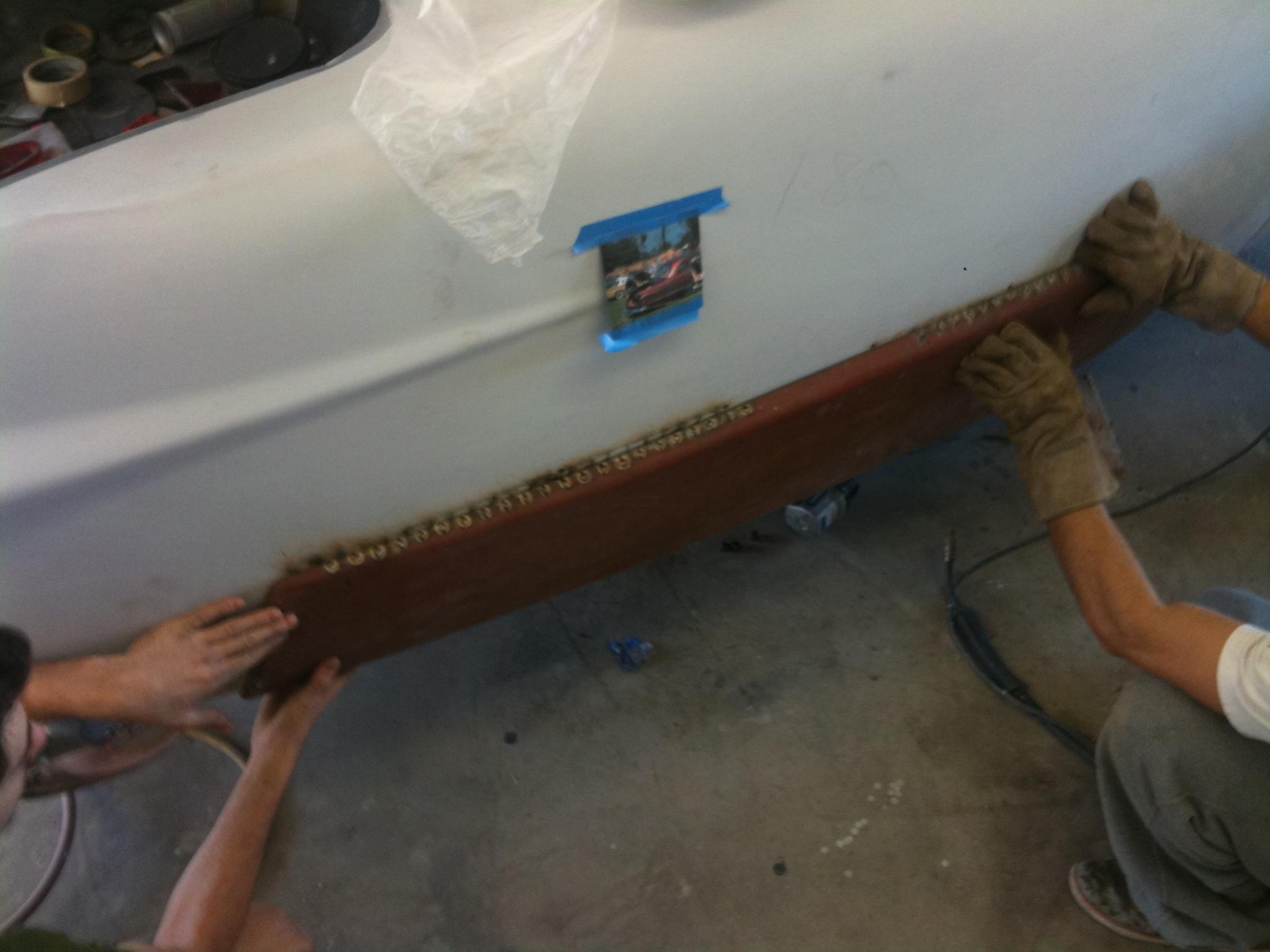

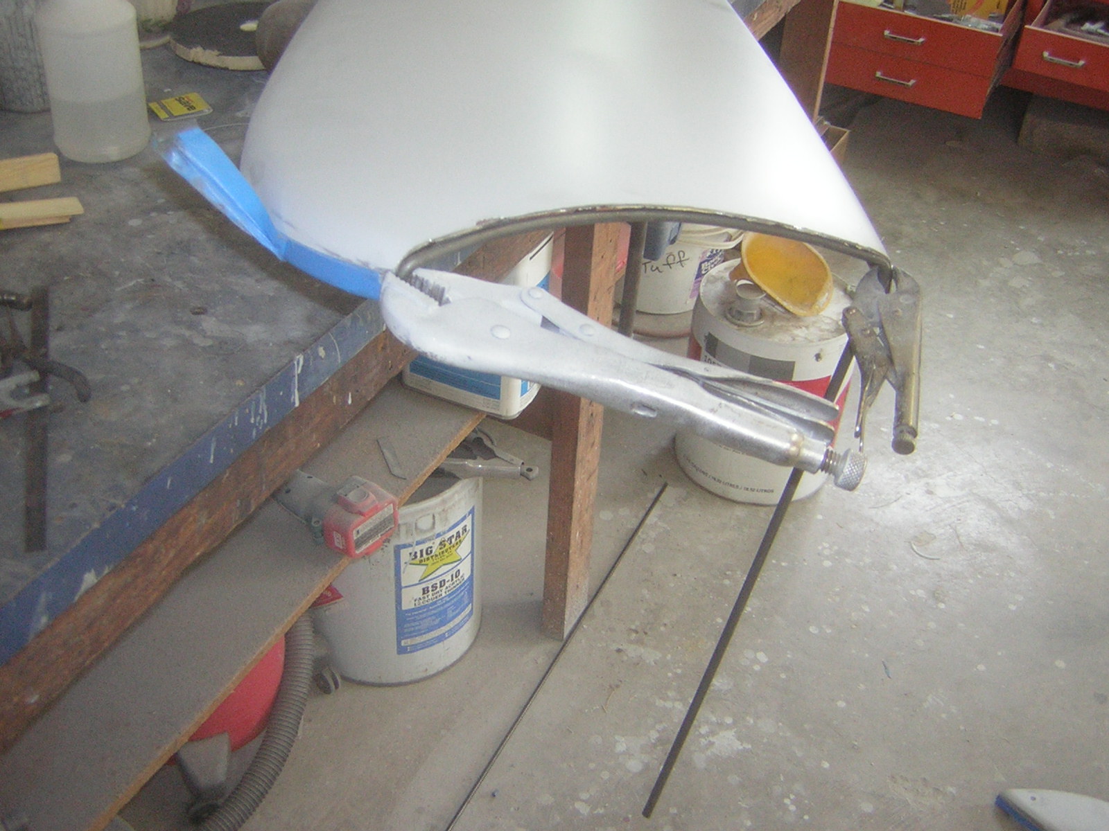

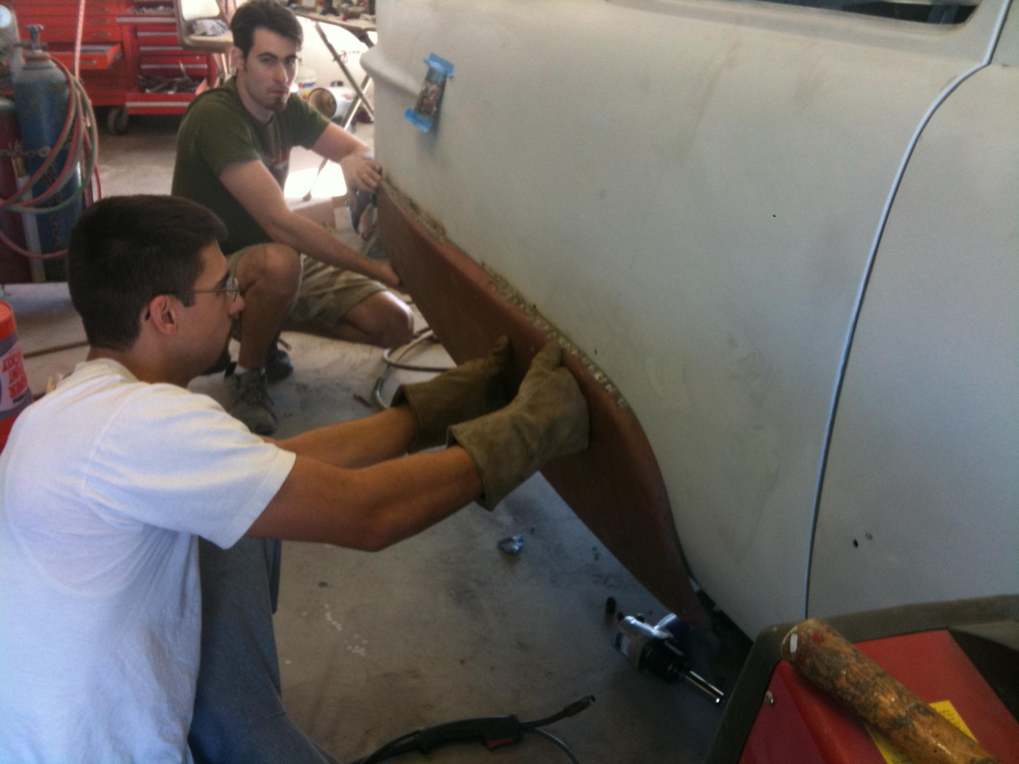

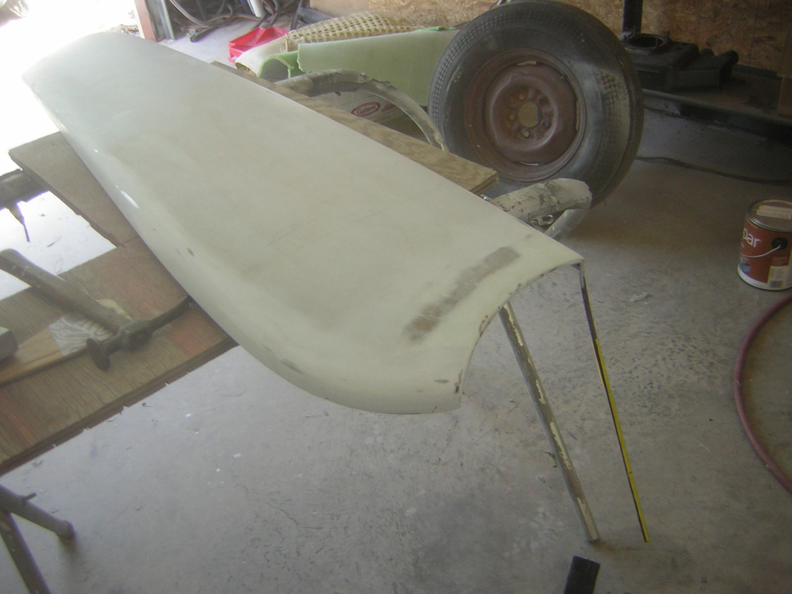

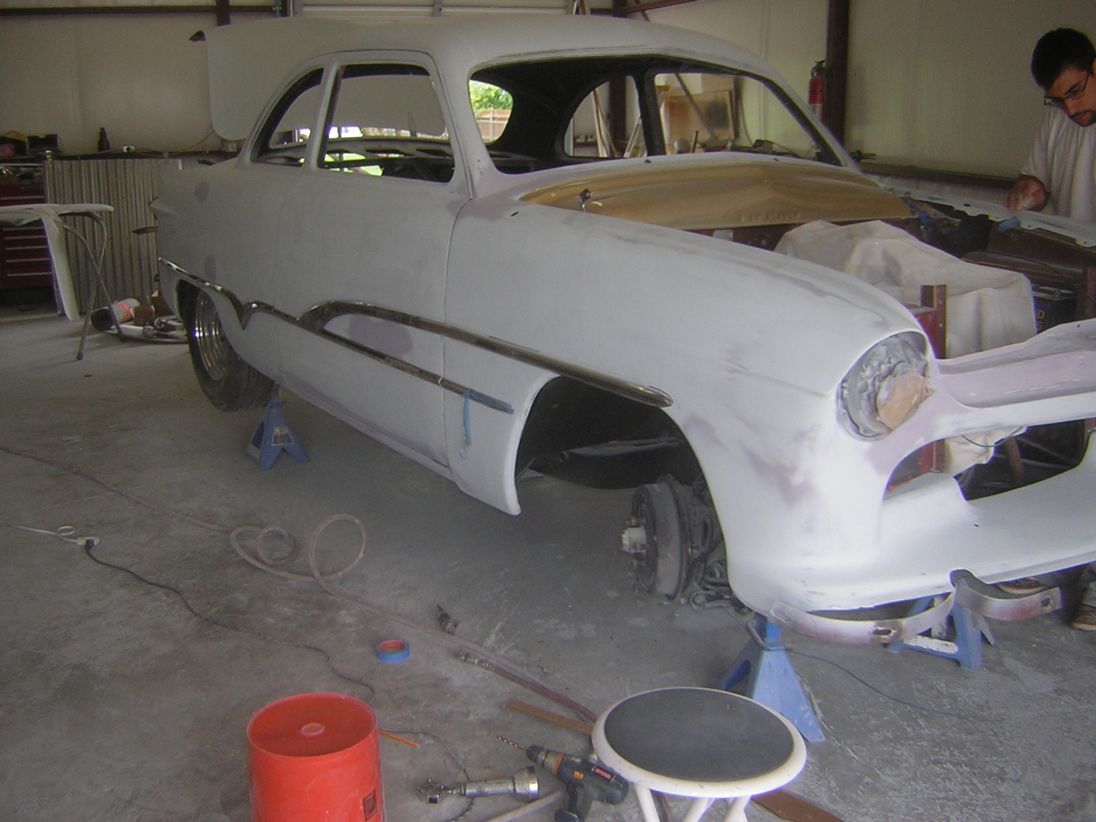

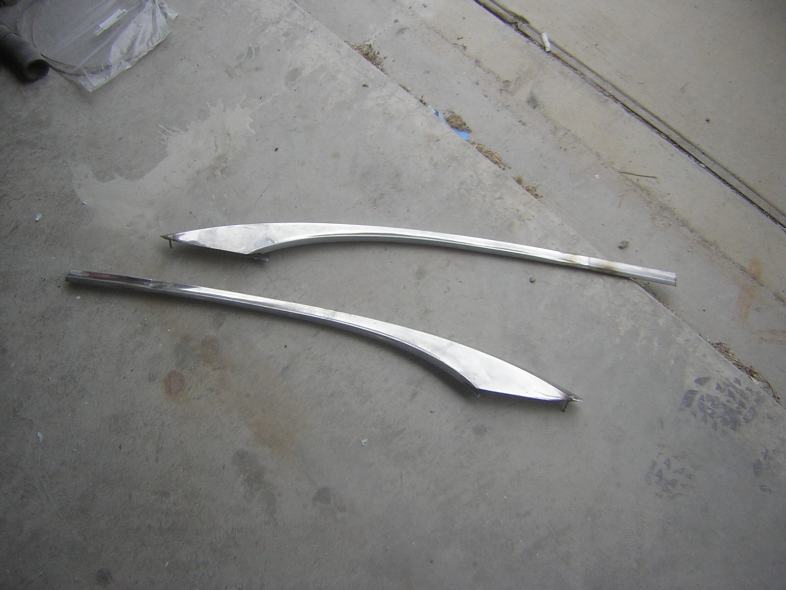

    The last item that must be dealt with before paint are the skirts. Since the focus of this build is the 17 y.o. Jr I asked him what his favorite version was. His reply was, the last one (of course). This represents the final destination of his ;custom dream for his car.
    I got a real nice set of 57 Merc Turnpike Cruiser skirts from 40StudeDude. Thanks Roger, this is where they ended up. They are long and straight. So I hold em up in place to check out the fit. For some reason I'm thinking they might bolt on (?).Noooooooo of course not.
    The pics show the start of the mods that were needed to get these things to fit. The skirts are straight (not anymore). The car has a bulbous shape.

    Randy I need to reply to your post. The micro switch that is used here is a modern day item. Whats interesting is that these door poppers were always a problem as the car aged because of reliability. They would get wet and would eventually become an all around pain in the ***. They were one of the big reasons that these cars lost favor and dissapeared.

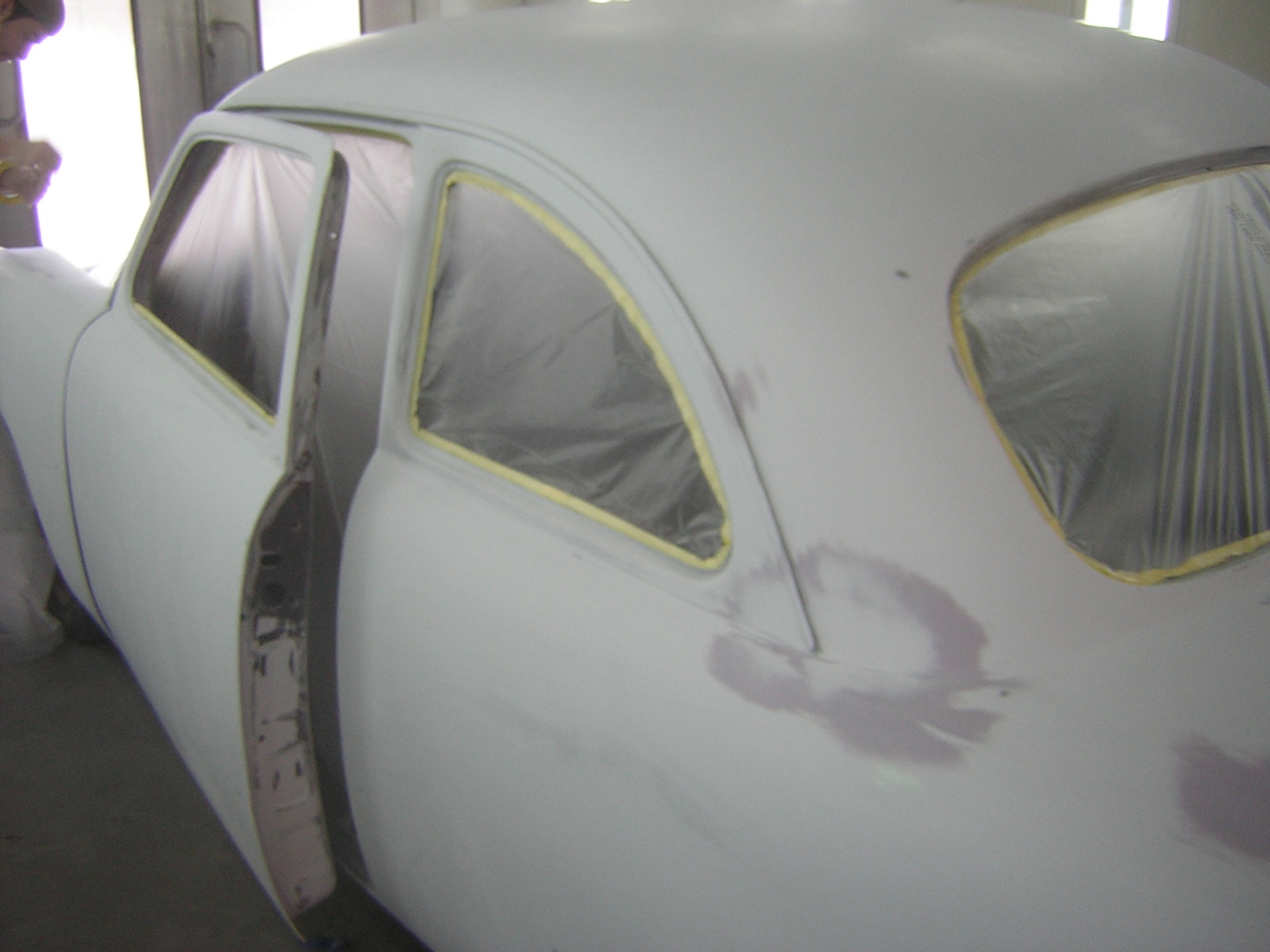

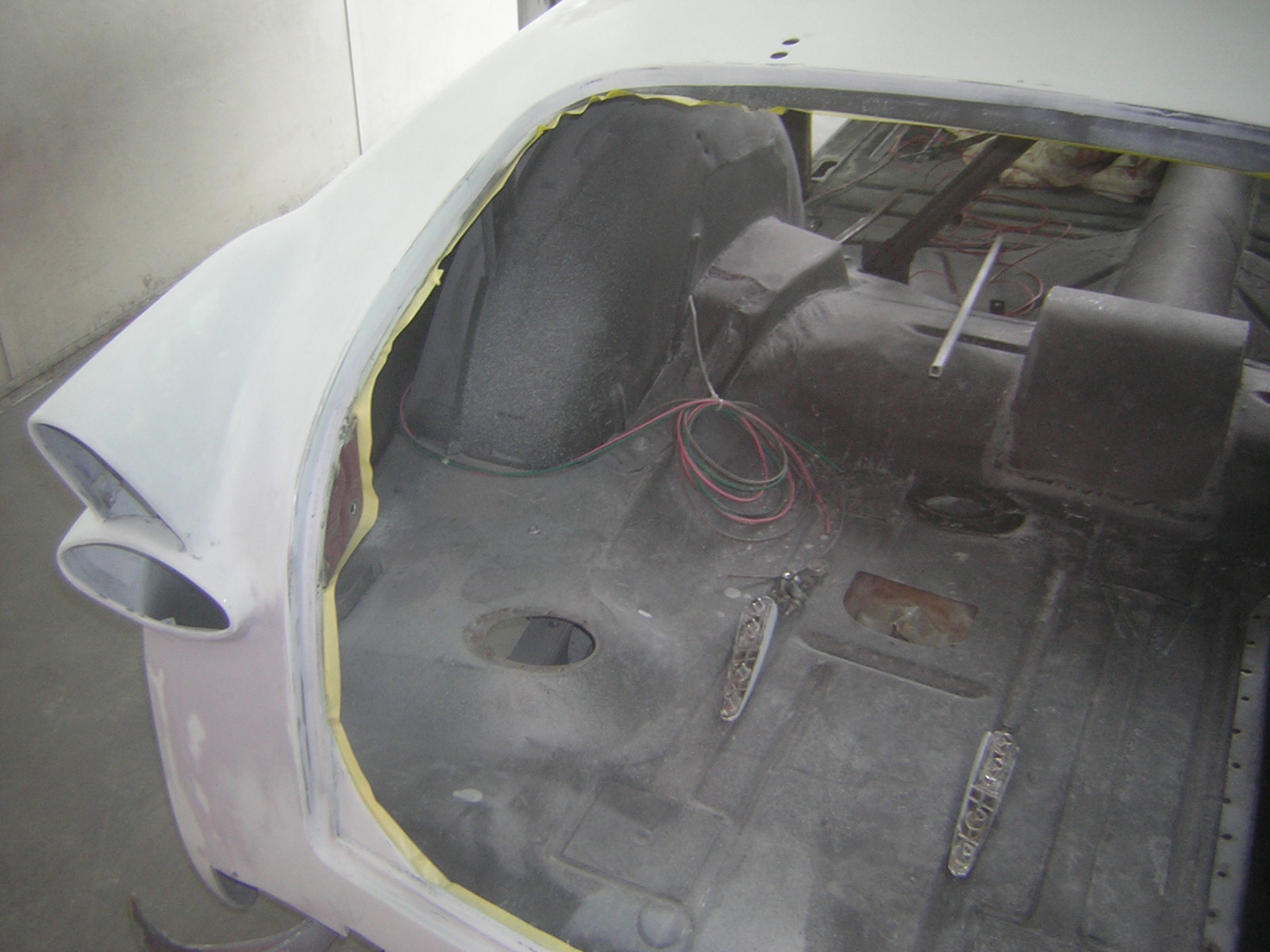

    More onward.

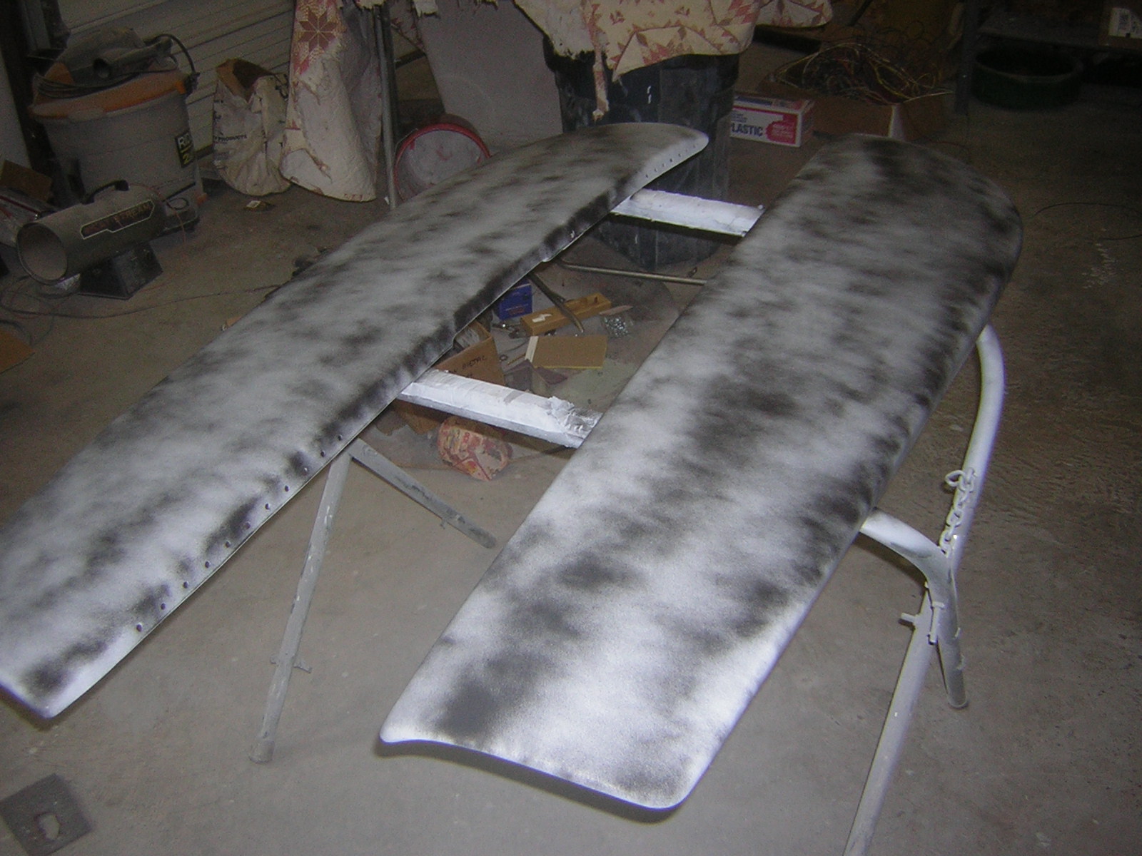

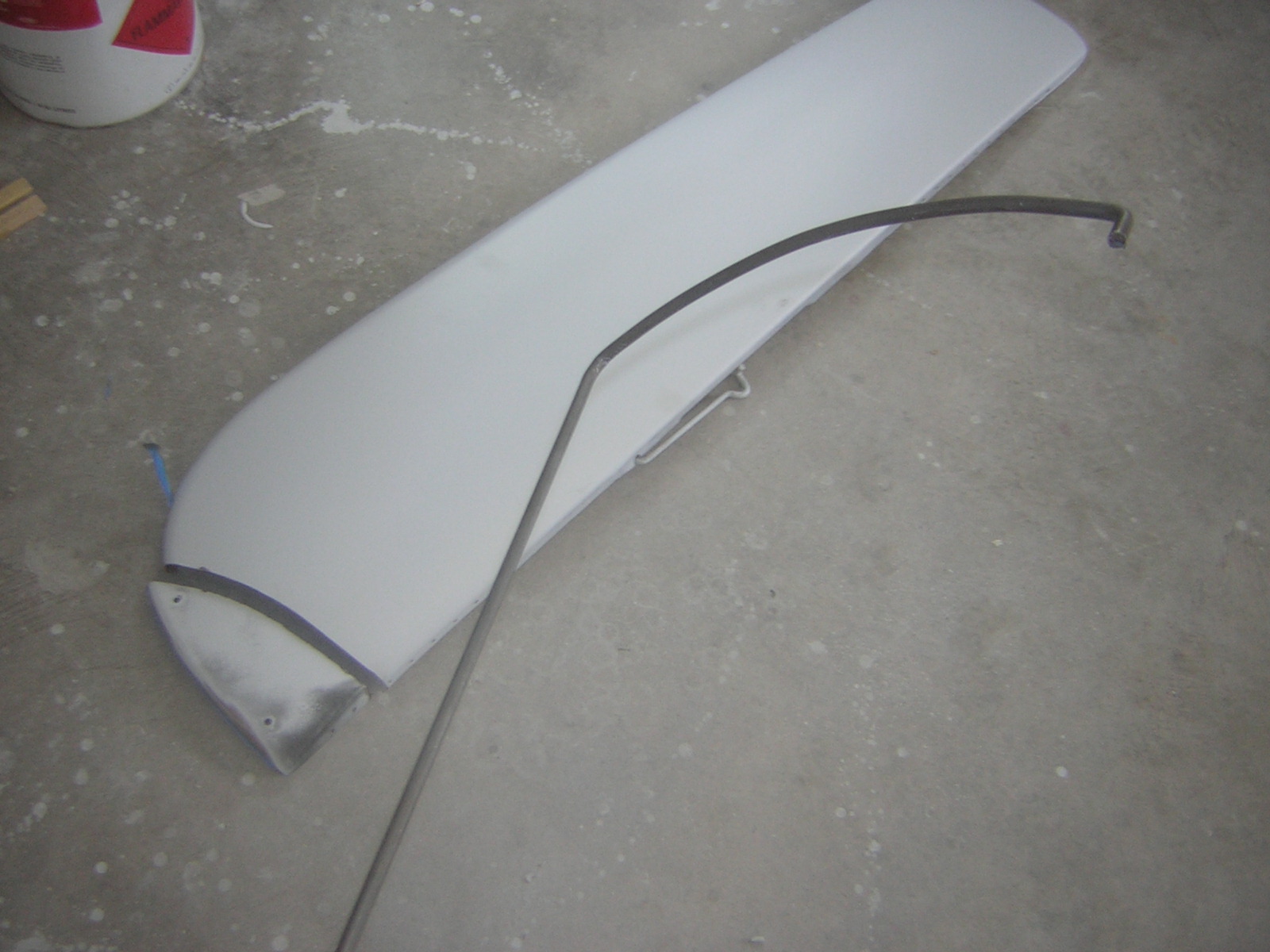

    These pics show the curvature that was needed at the back of the skirts.And some prep work while waiting fo the mldgs to arrive for a fit.

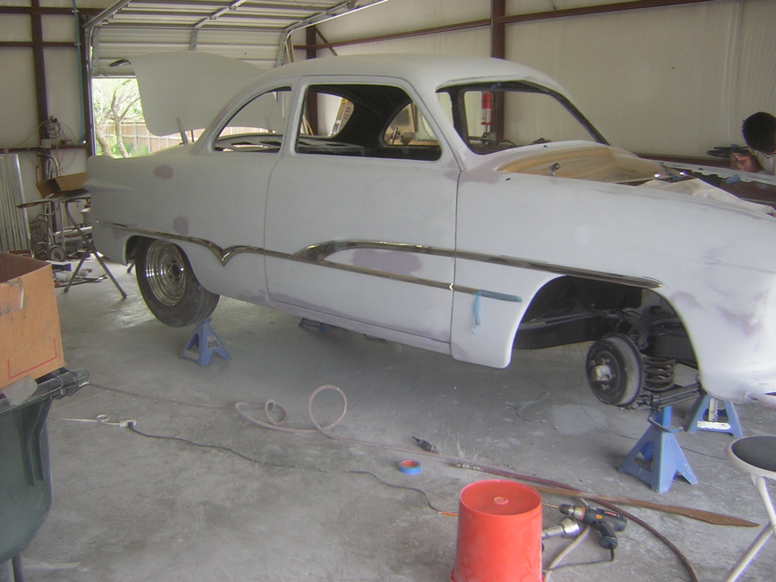

  25. jivin jer
    Joined: Sep 14, 2008
    Posts: 3,494
    jivin jer
    The custom stuff.

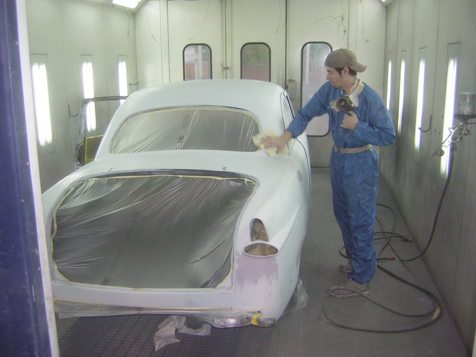

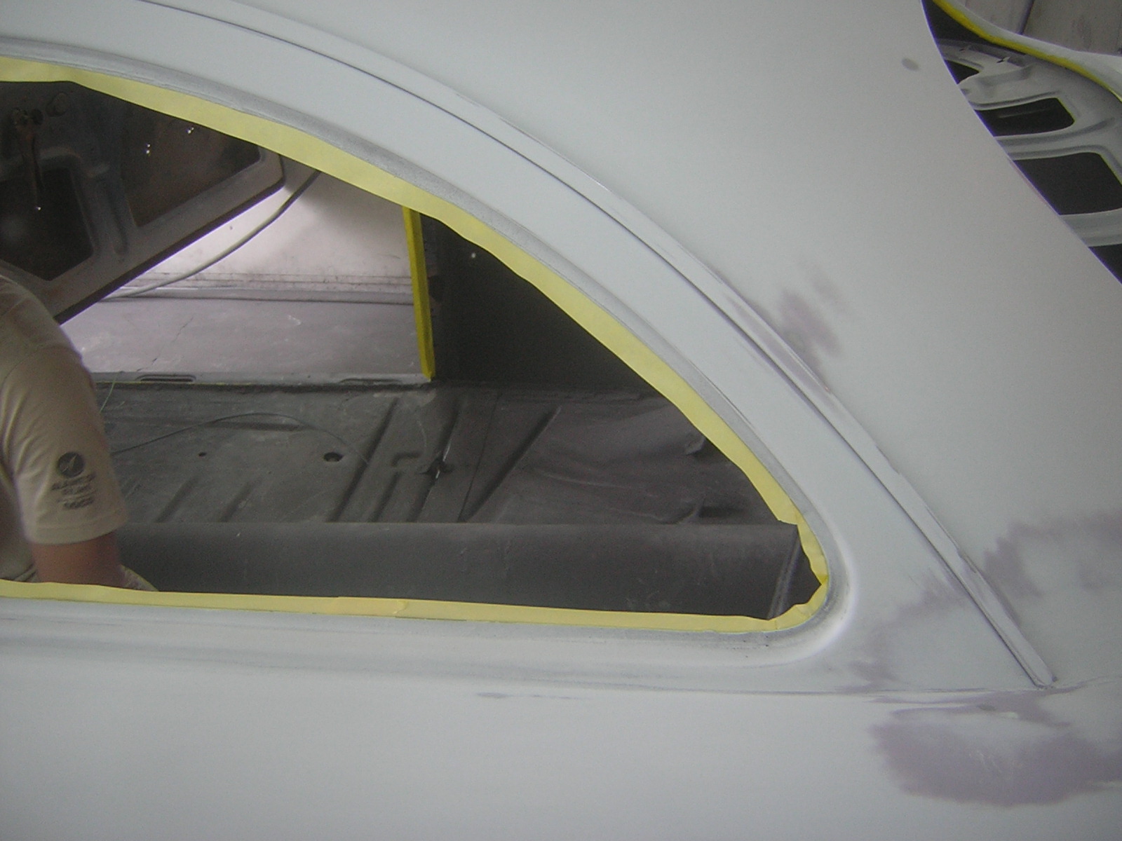

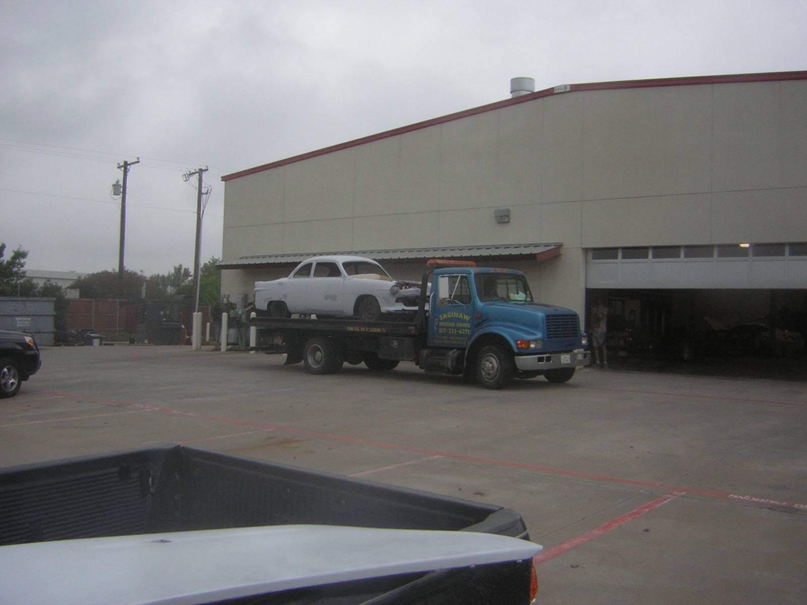

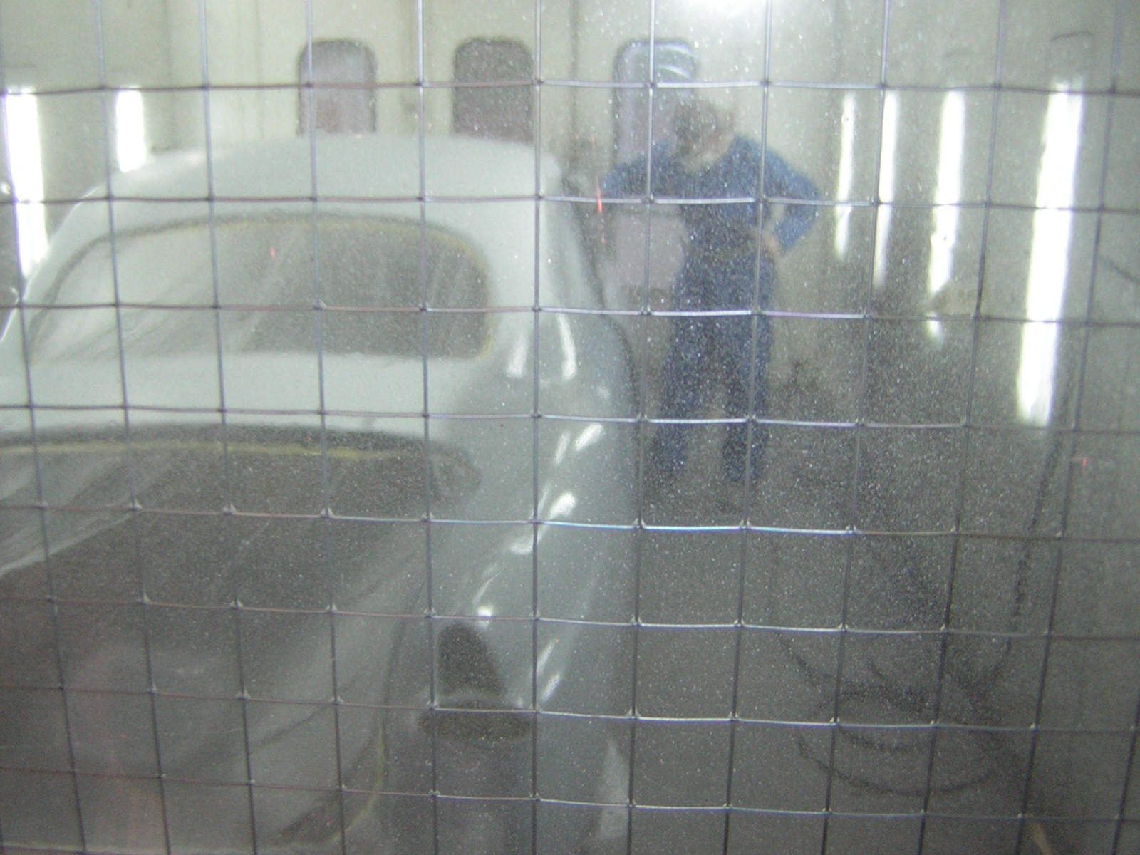

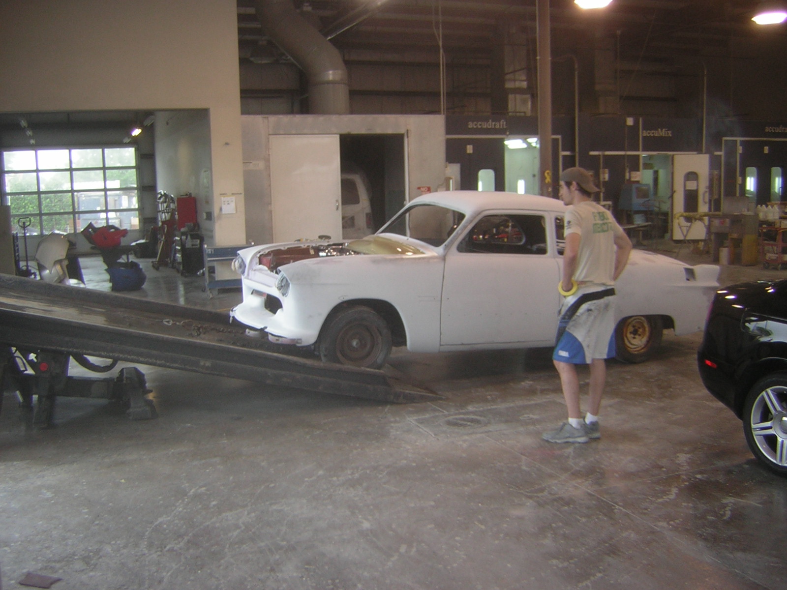

    Just for the record. Clear and catylist $358.00. PPG w (price code) base coat $220.00 a quart.
  29. jivin jer
    Posts: 3,494
    jivin jer

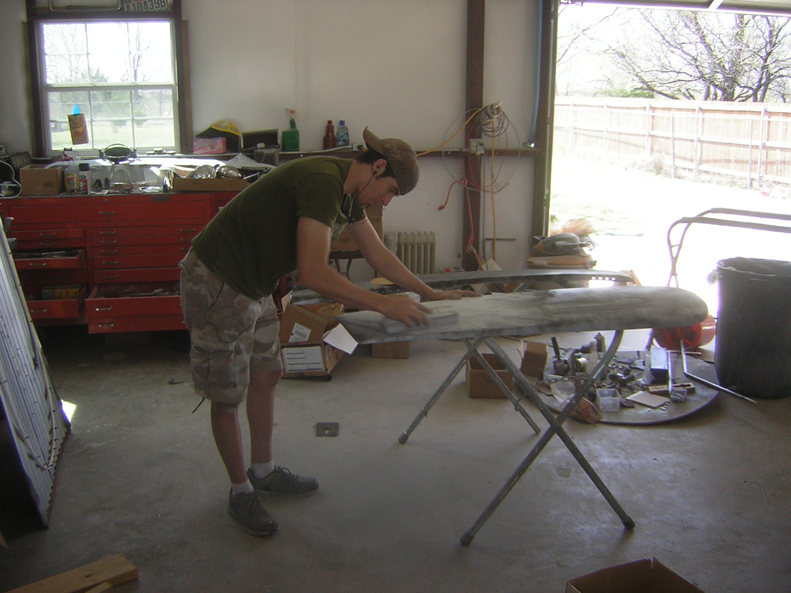

    This was a 15 hour marathon.
