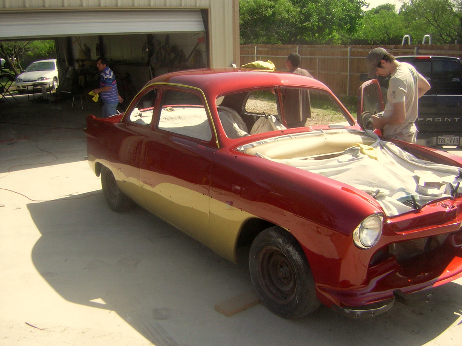

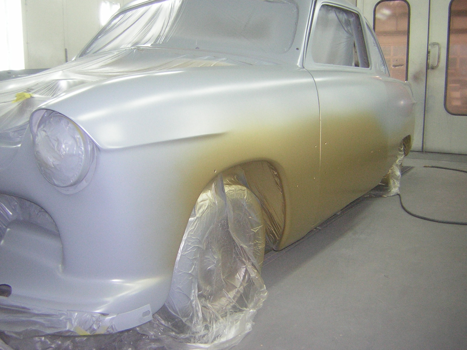

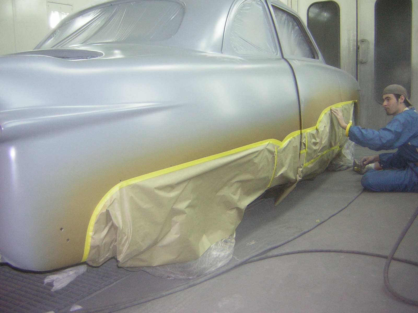

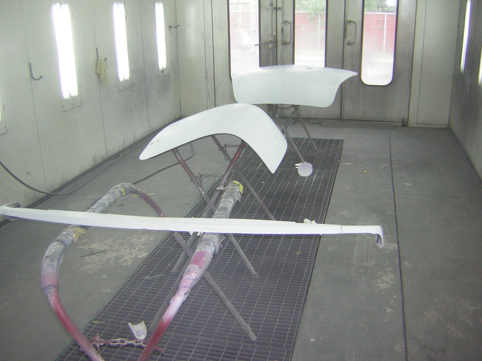

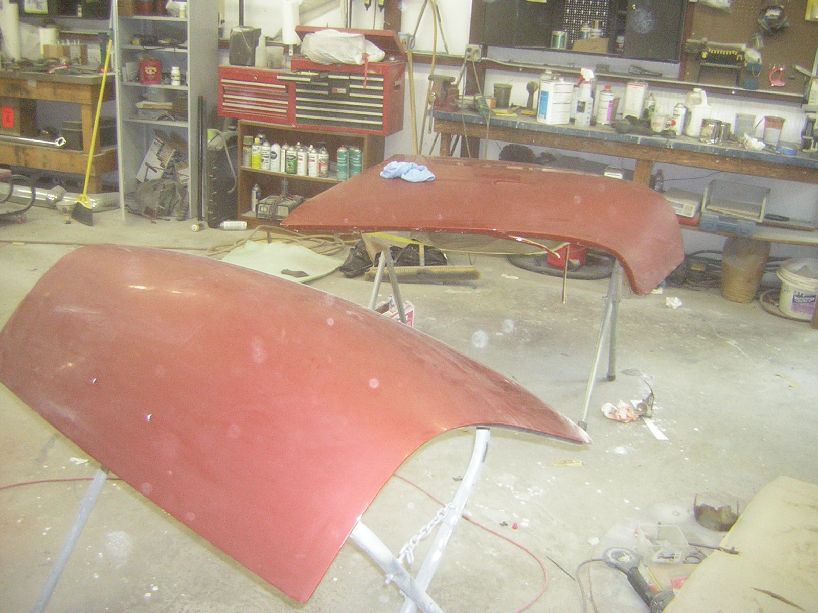

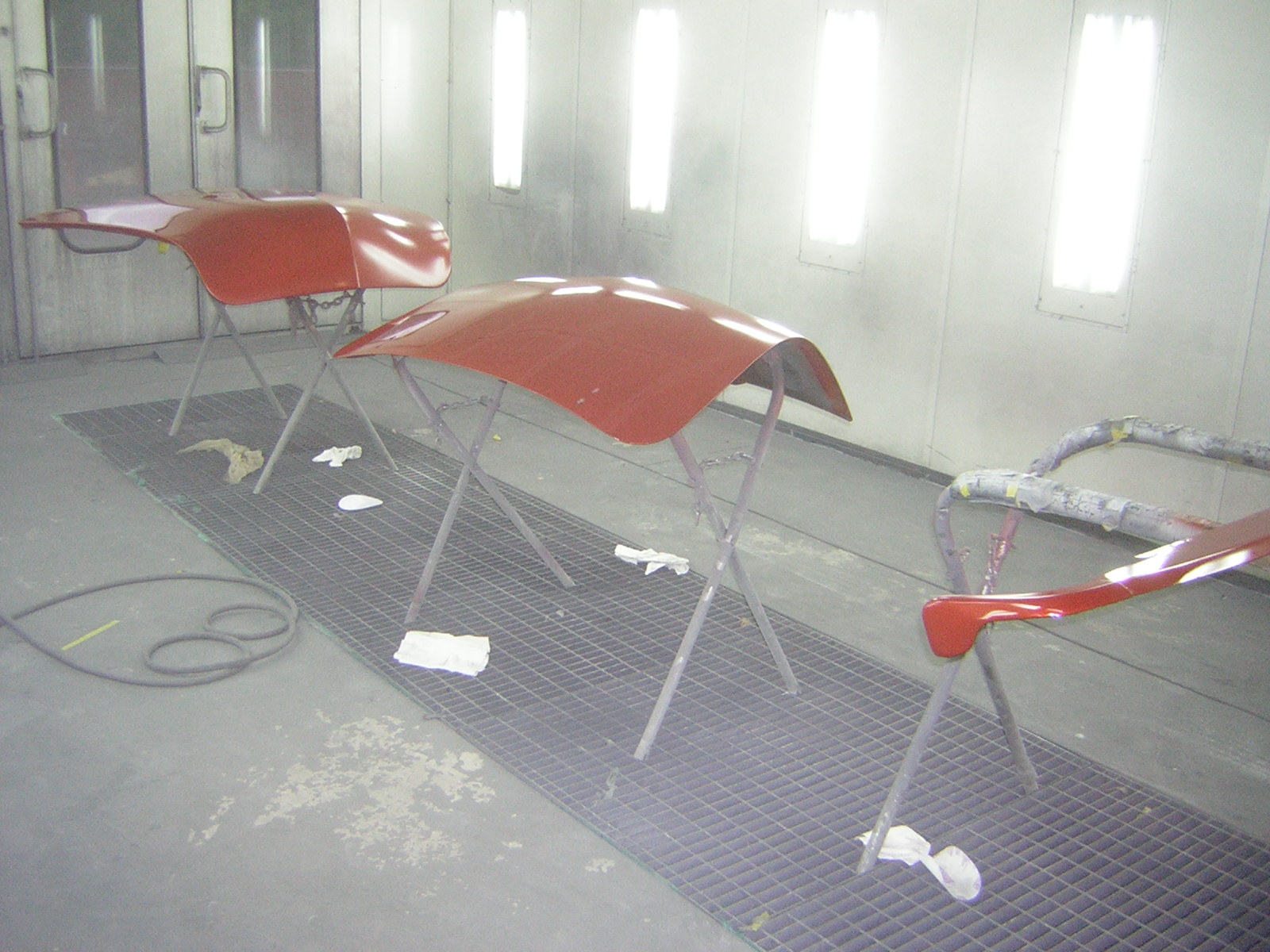

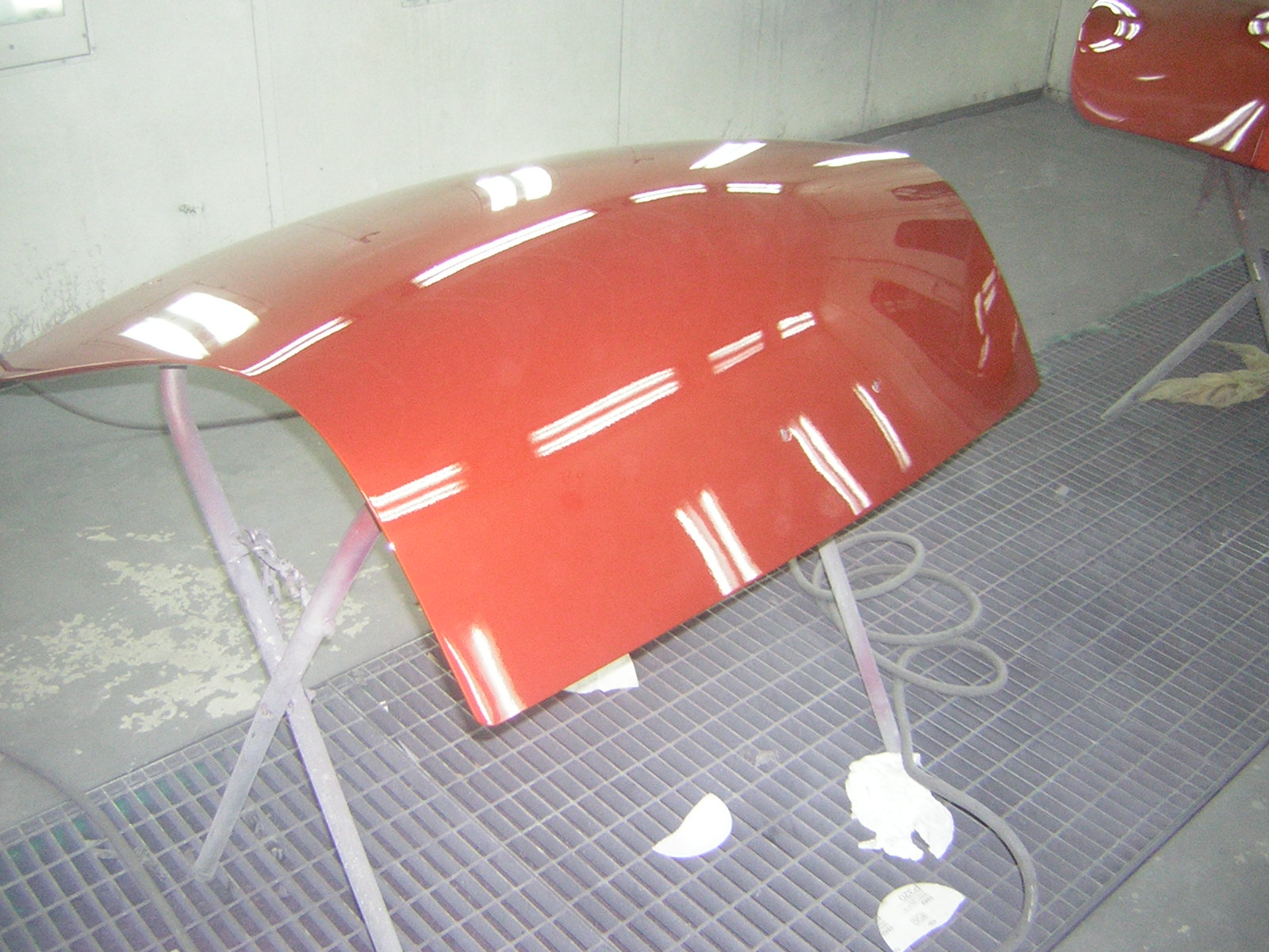

    This could have been done in the shop but, there's a big advantage in being able to bake the different colors.

    Oops. I forgot to include these (in the other booth).

    Sumthin' like this.

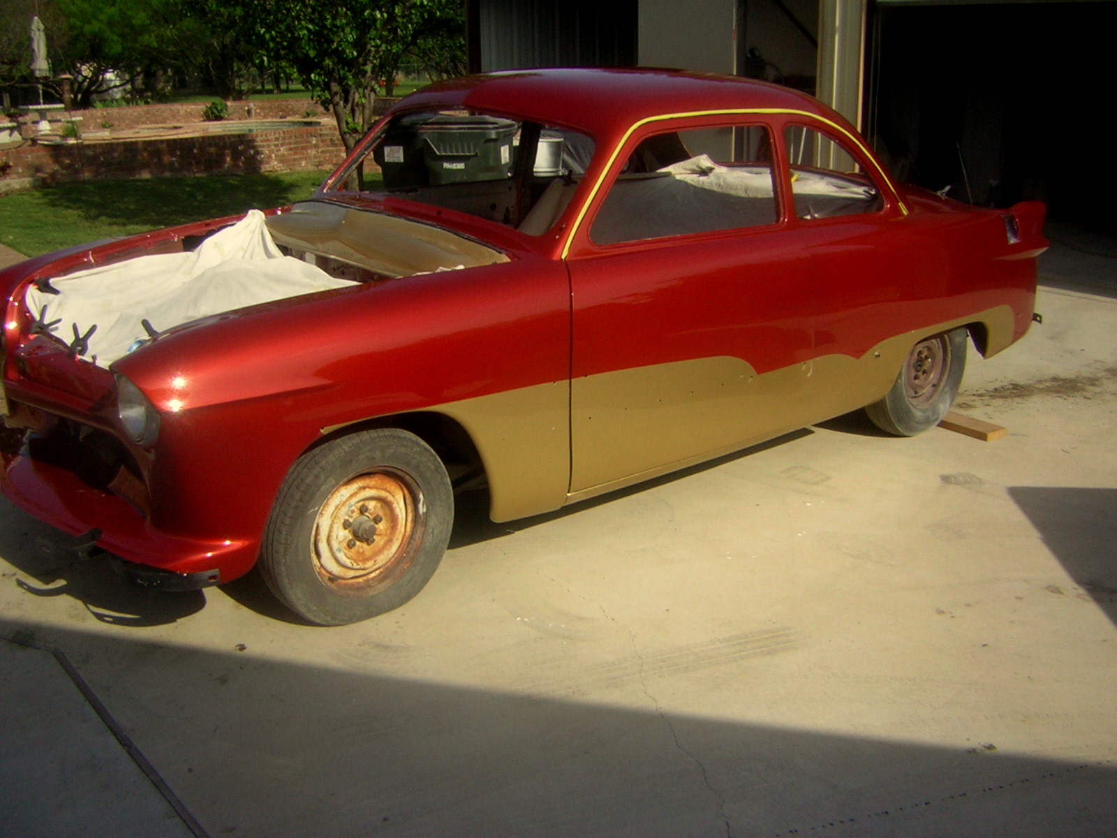

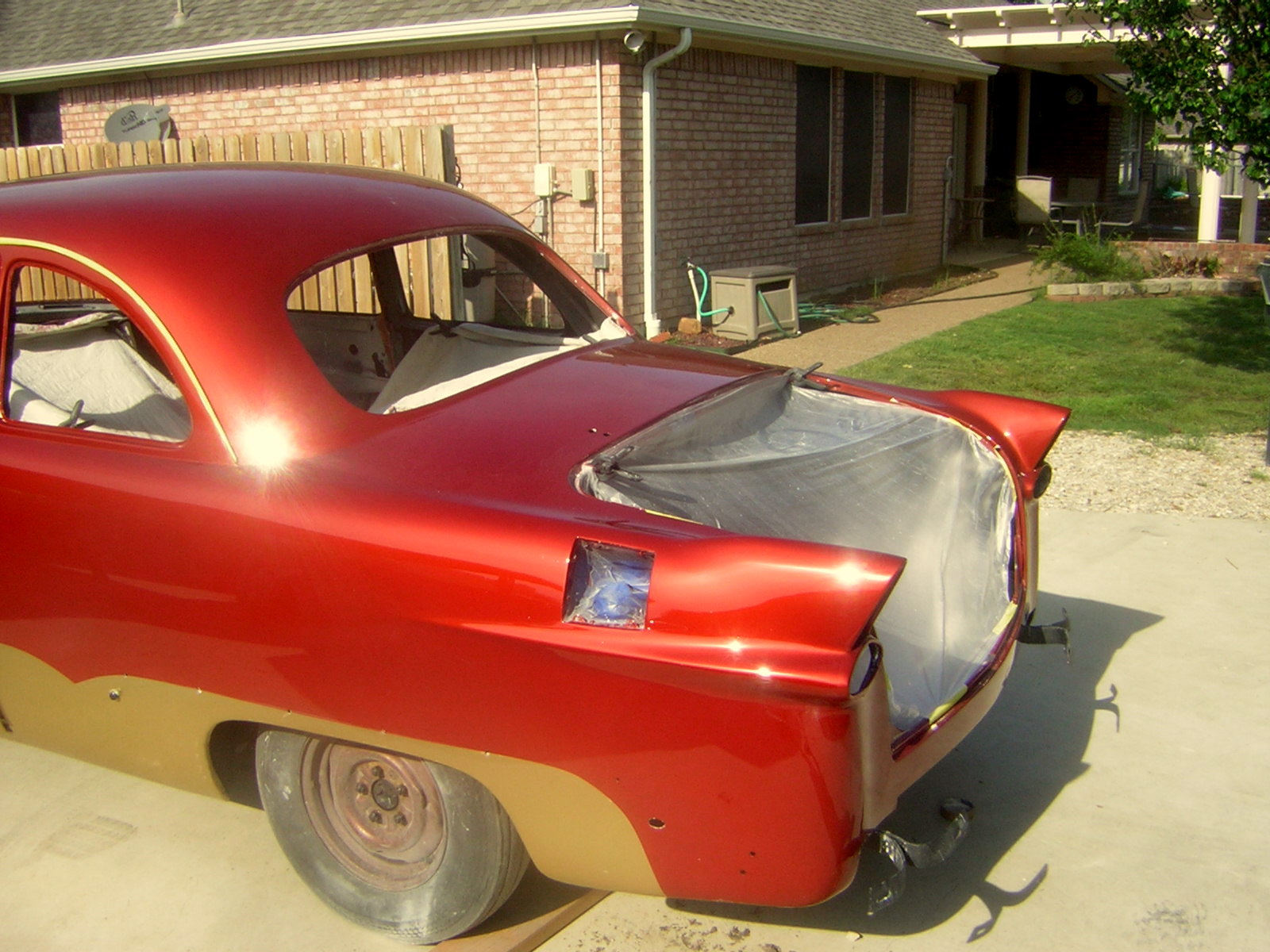

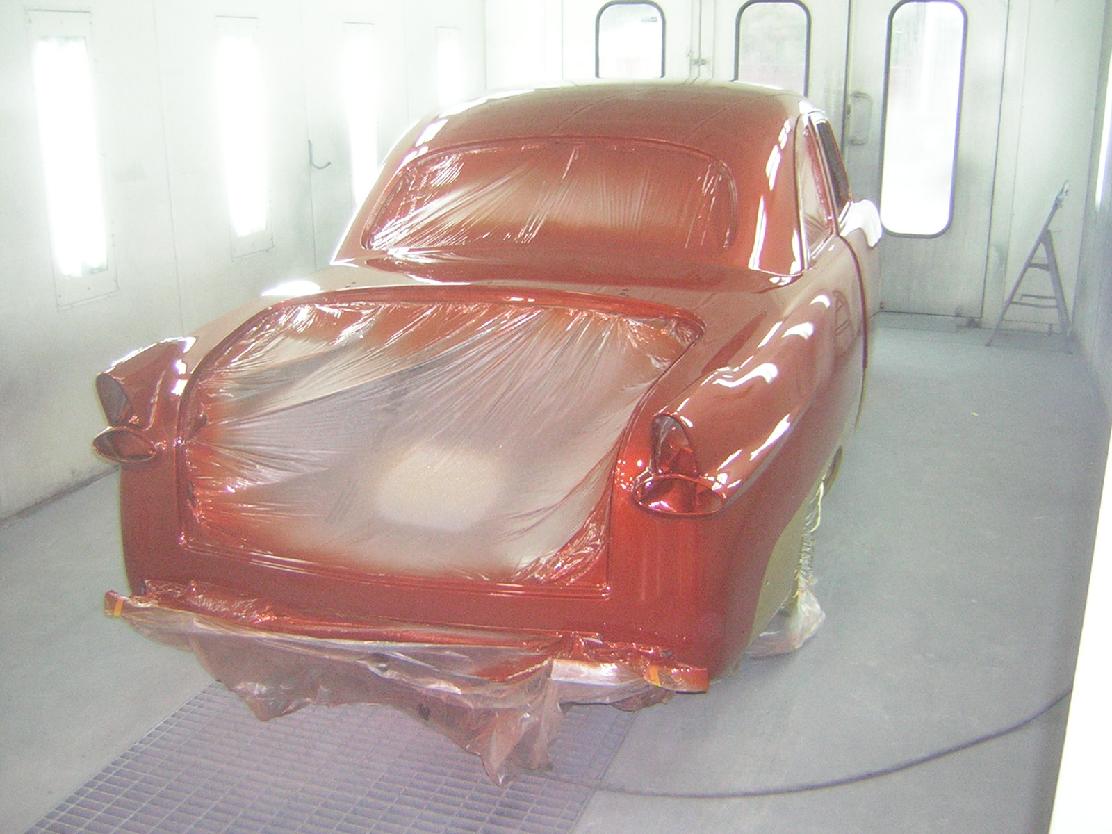

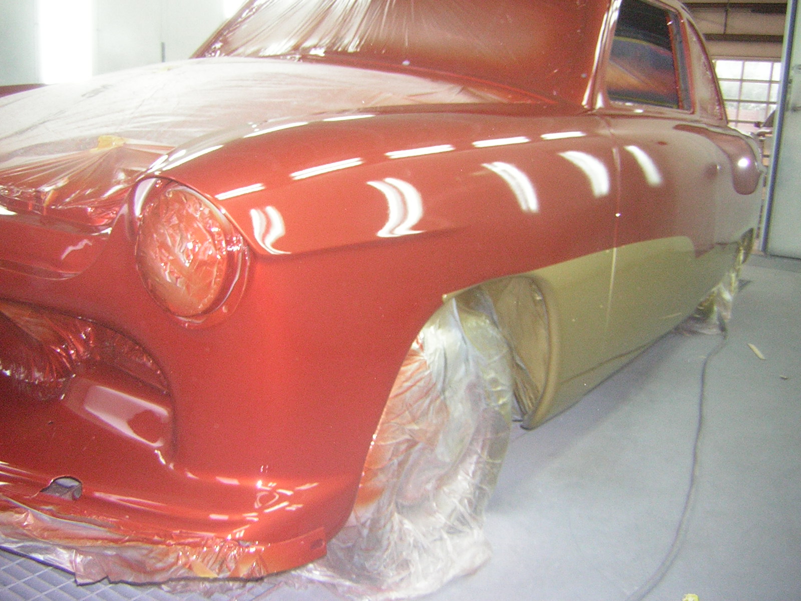

    If we weren't concerned about authenticity we would do the scallops on the hood, fenders and ¼'s during this session. The modern way is to bury everything in clear. Because everything was hard lined back then we will do them after the car is cut and buffed. In doing the dash I discovered that this urethane lays down without much of an edge. I would have loved to see the originals (Ala Kart, Kopper Kart etc) with their hard lines.

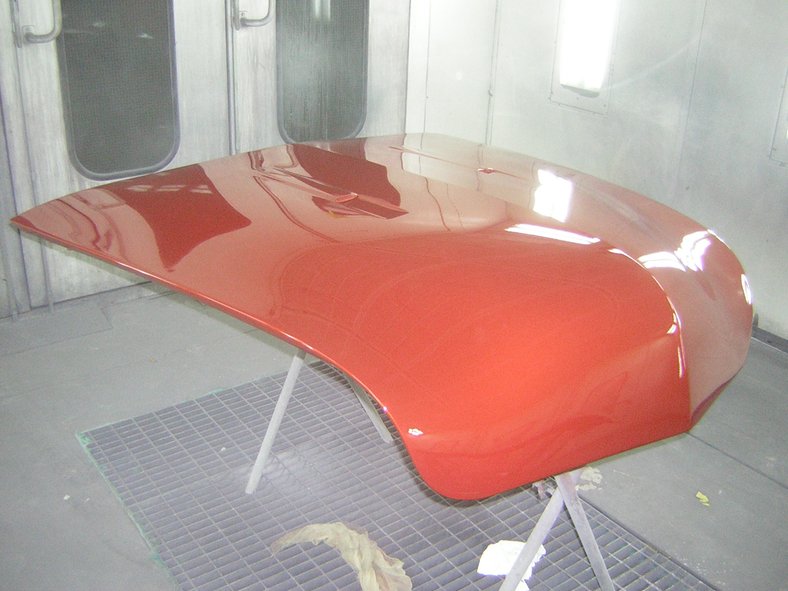

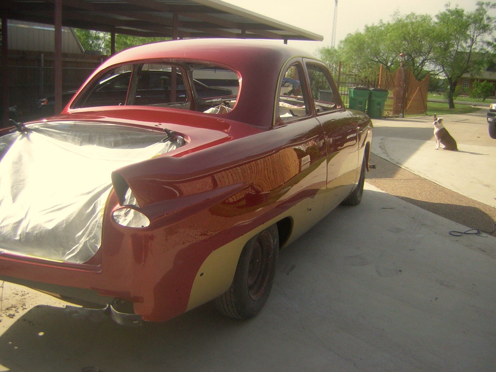

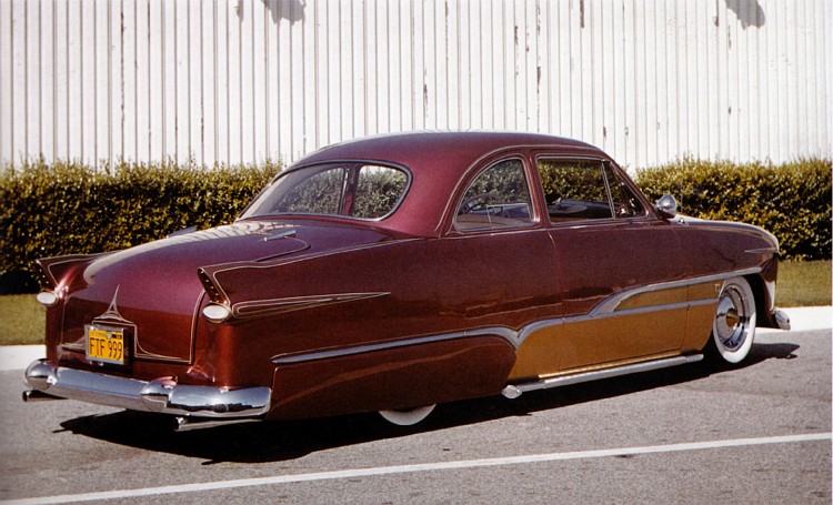

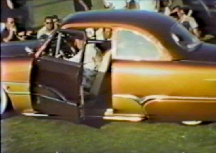

    With the color being probably the one focal point there was a mighty struggle to get it right. I'm showing just some of the examples that you can see, now that there are a lot of pics available, thanks to Rik Hoving. So the problem becomes obvious. But the solution isn't. How can there be so many colors of the same car? The photogs can probably explain this for us.
    At first Jr was reluctant to say much more than Sam Bronze, a copperish marroon. Dan and I thought that pic #4 was the closest because it looked so different (a dirty pink?). Finally Jr gave me ****, peep, Jackson's phone # and that fixed everything (post #74). But even now it's difficult to pick up the copperish part of this color with a pic (#7). It does look the most like pic #1.

    I don't envy you this task at all, Jer. All the visual evidence is third and fourth generation interpretations of the original color.
    Back in the day, color transparency materials were not nearly as precise as the digital images of today. There were two major choices: Kodachrome and Ektachrome.
    Kodachrome favored red/yellow while Ektachrome favored blue/green. Photographers would select the film to enhance the subject matter: Kodachrome made reds and yellows "pop" while Ektachrome made blues and greens deep and rich.
    Your photo #1, the magazine cover, was probably taken with Kodachrome, while Andy Southard's photo #6 was probably shot with Ektachrome.
    This probably explains the radical difference in paint color between the two photographs...but didn't make your job any easier, did it!
    The final color you selected is excellent! The car really jumps, and I think that's probably what Junior had in mind when he selected the color in the first place.
    Can't wait to see it ***embled, trimmed and striped! Outstanding work!

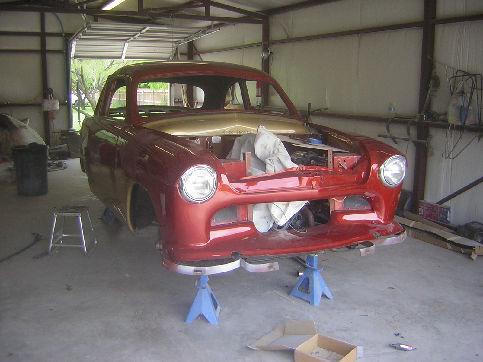

    Well we're back home up on jack stands again. The stainless is being finished. That will have to be installed before the upholstery is installed. The skirts have to be painted. There's a little wiring left to be done and the engine needs to be fired (with the new Fenton equipment). We're going to cut and rub it before it goes to the upholstery shop. Oh, I forgot to add, plus the "misc. stuff".

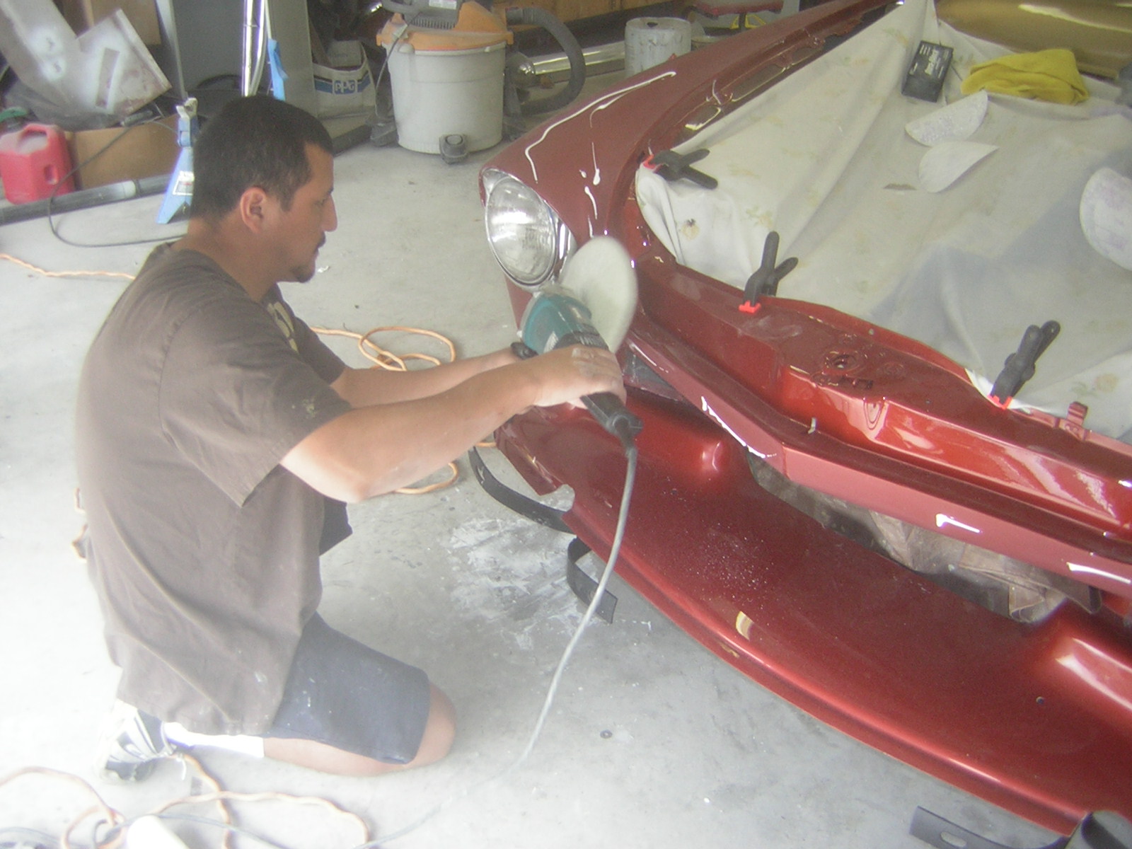

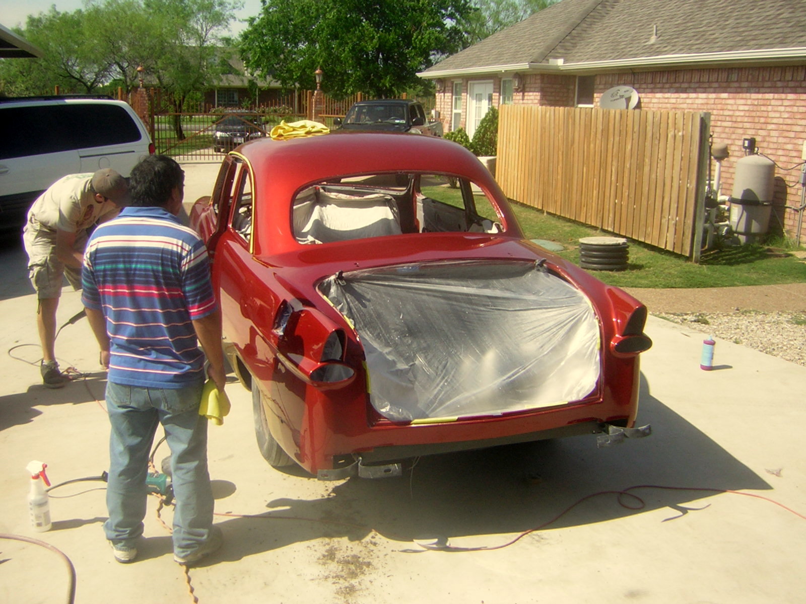

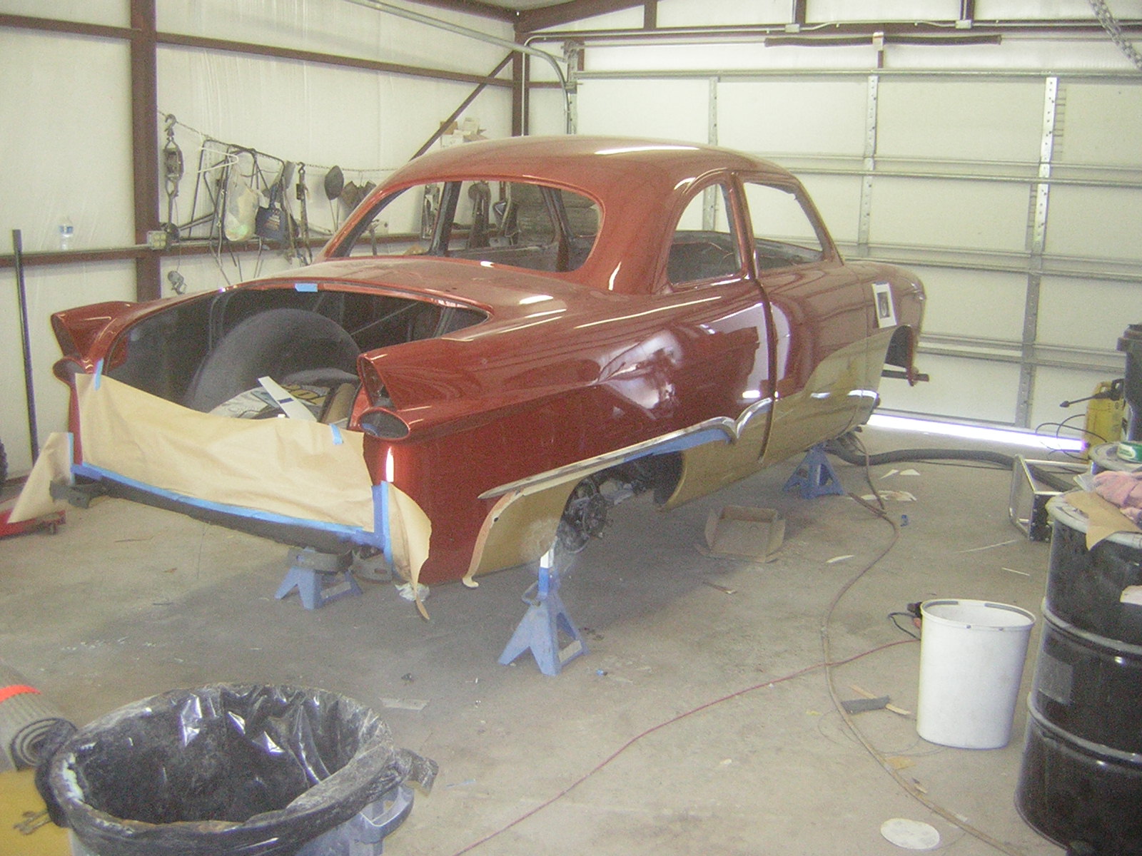

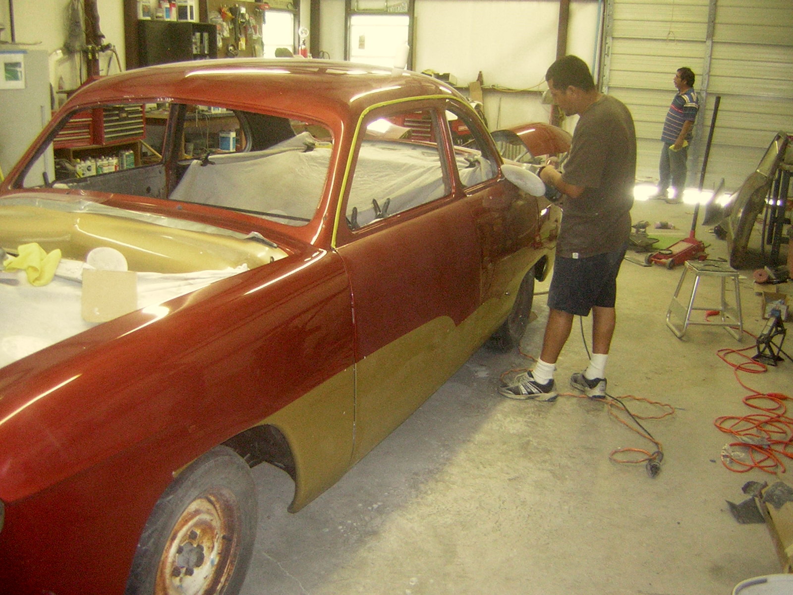

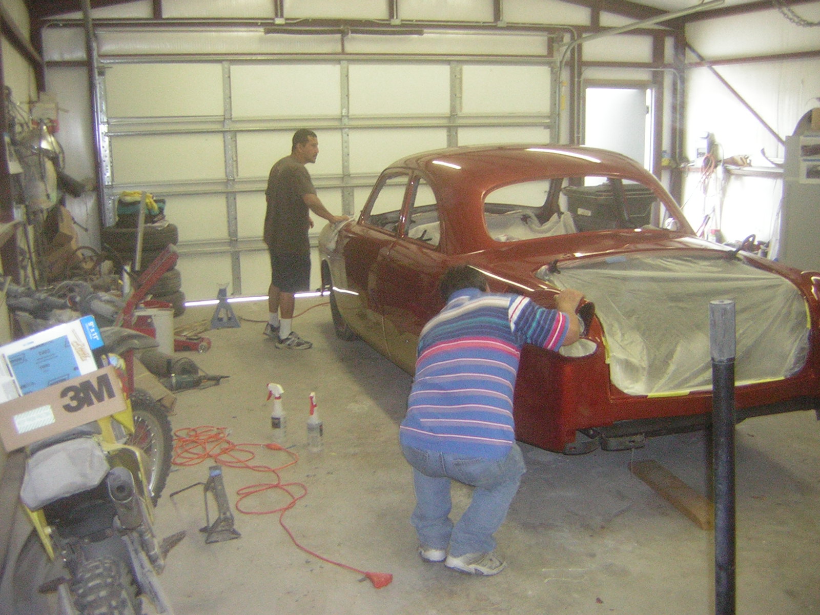

    Back down to earth in preperation for a cut & rub tomorrow.
  23. jivin jer
    Joined: Sep 14, 2008
    Posts: 3,495
    jivin jer

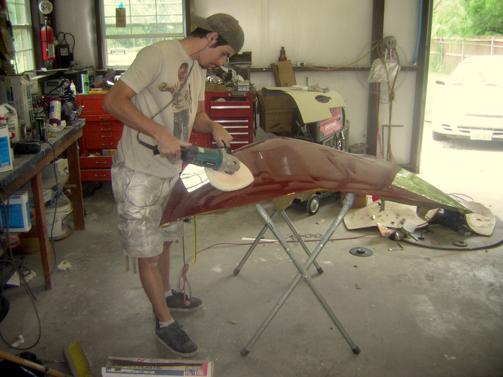

    The crew.
  24. jivin jer
    Posts: 3,495
    jivin jer

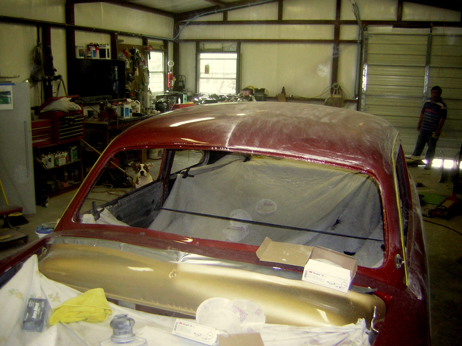

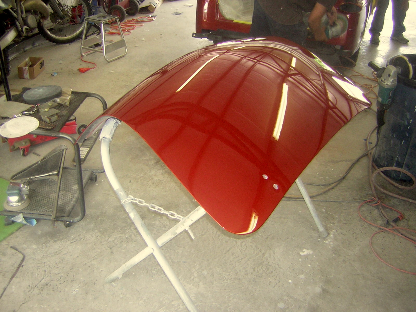

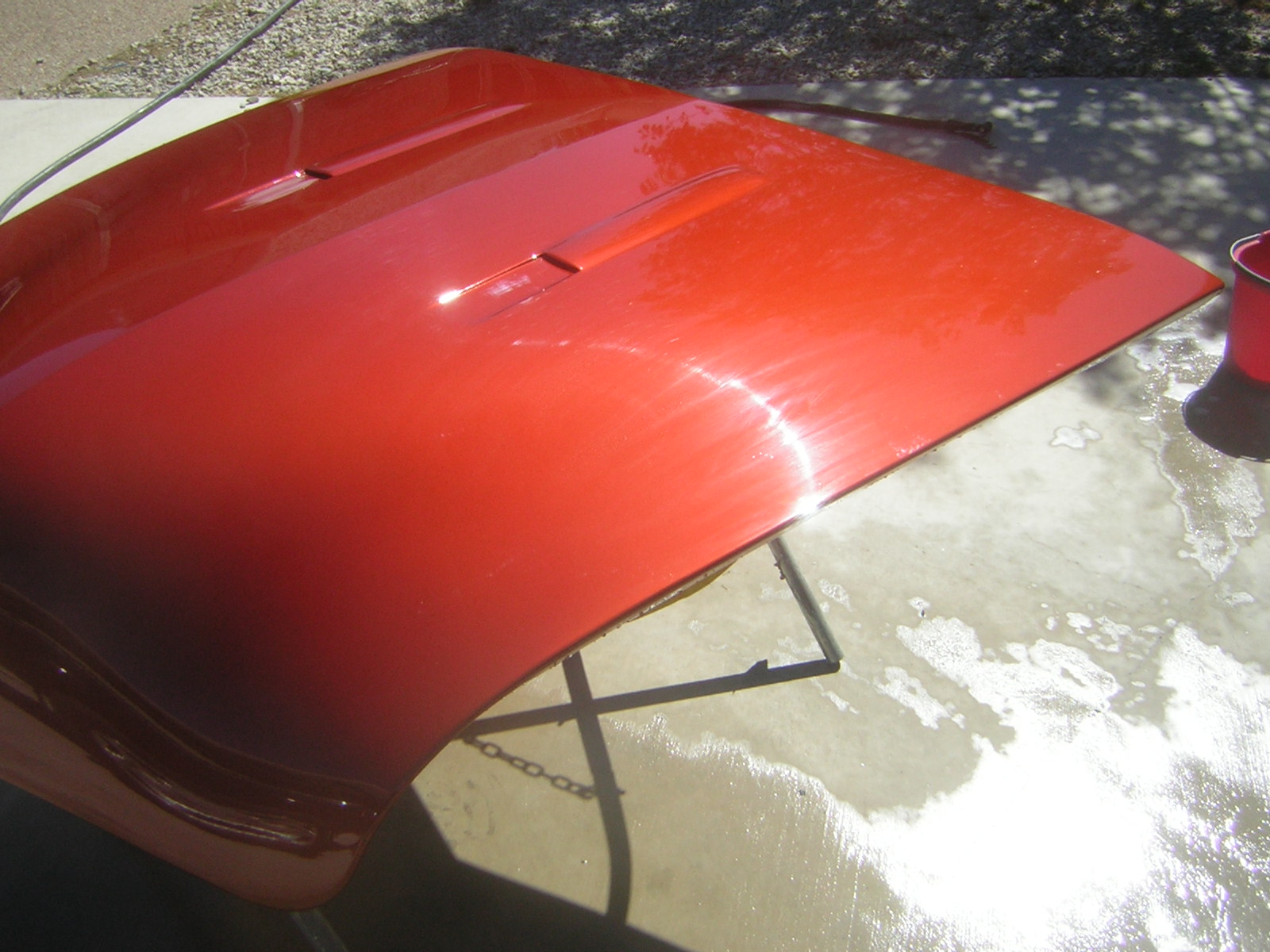

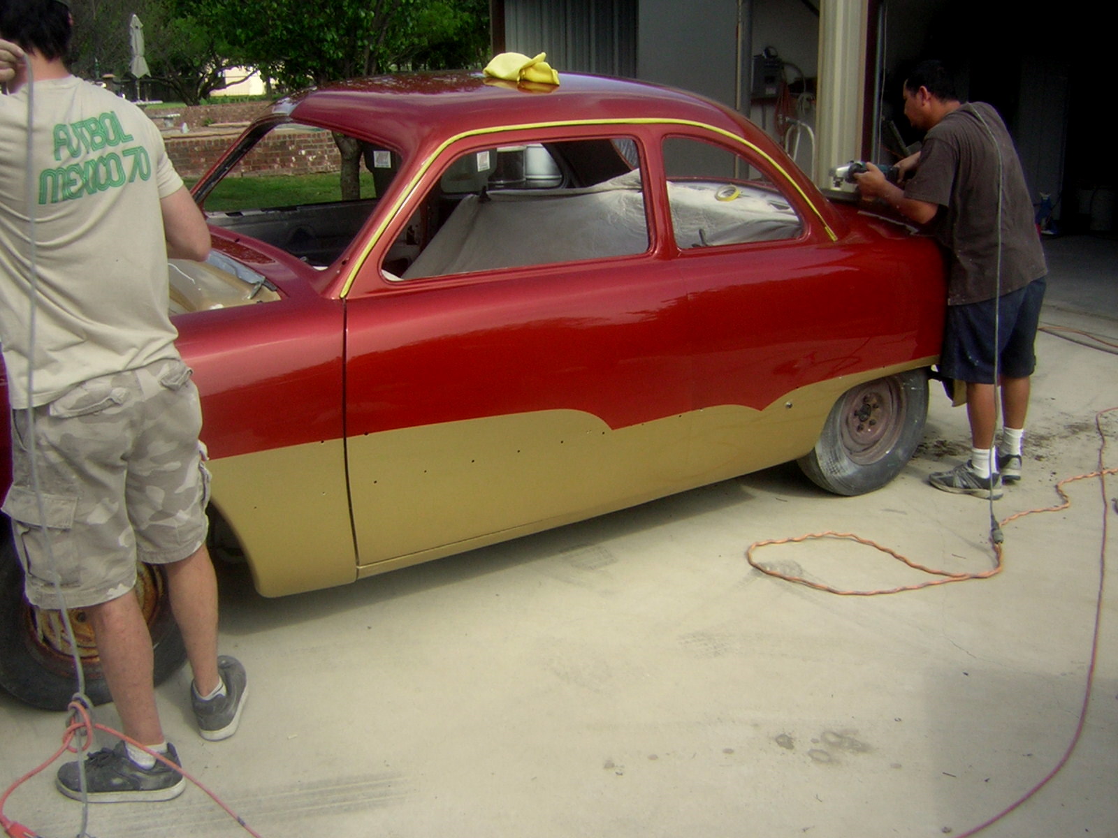

    1000 wet.

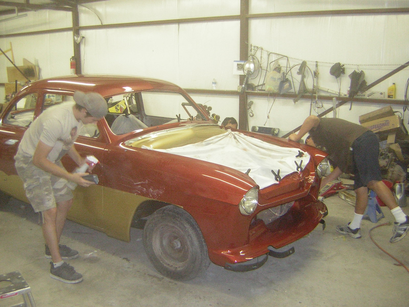

  25. jivin jer
    Posts: 3,495
    jivin jer
    more.

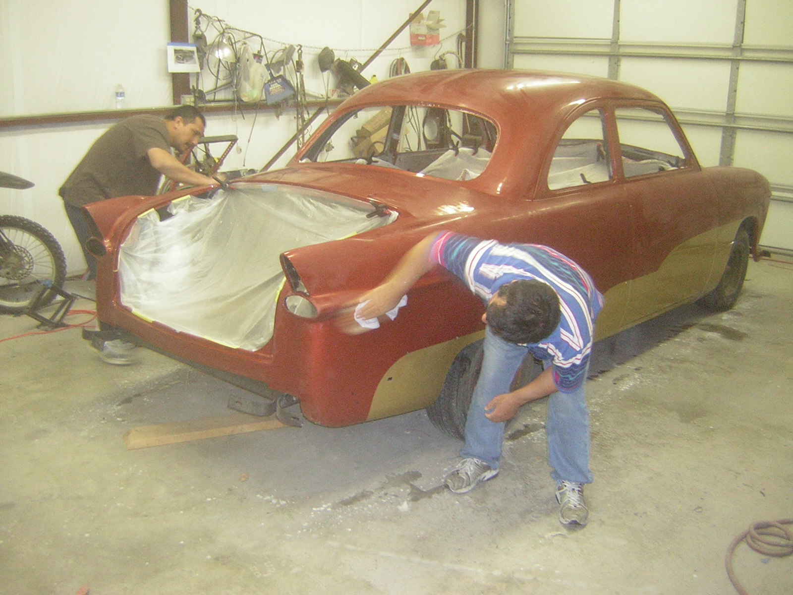

  26. jivin jer
    Posts: 3,495
    jivin jer
    more.
  27. jivin jer
    Posts: 3,495
    jivin jer
    more.

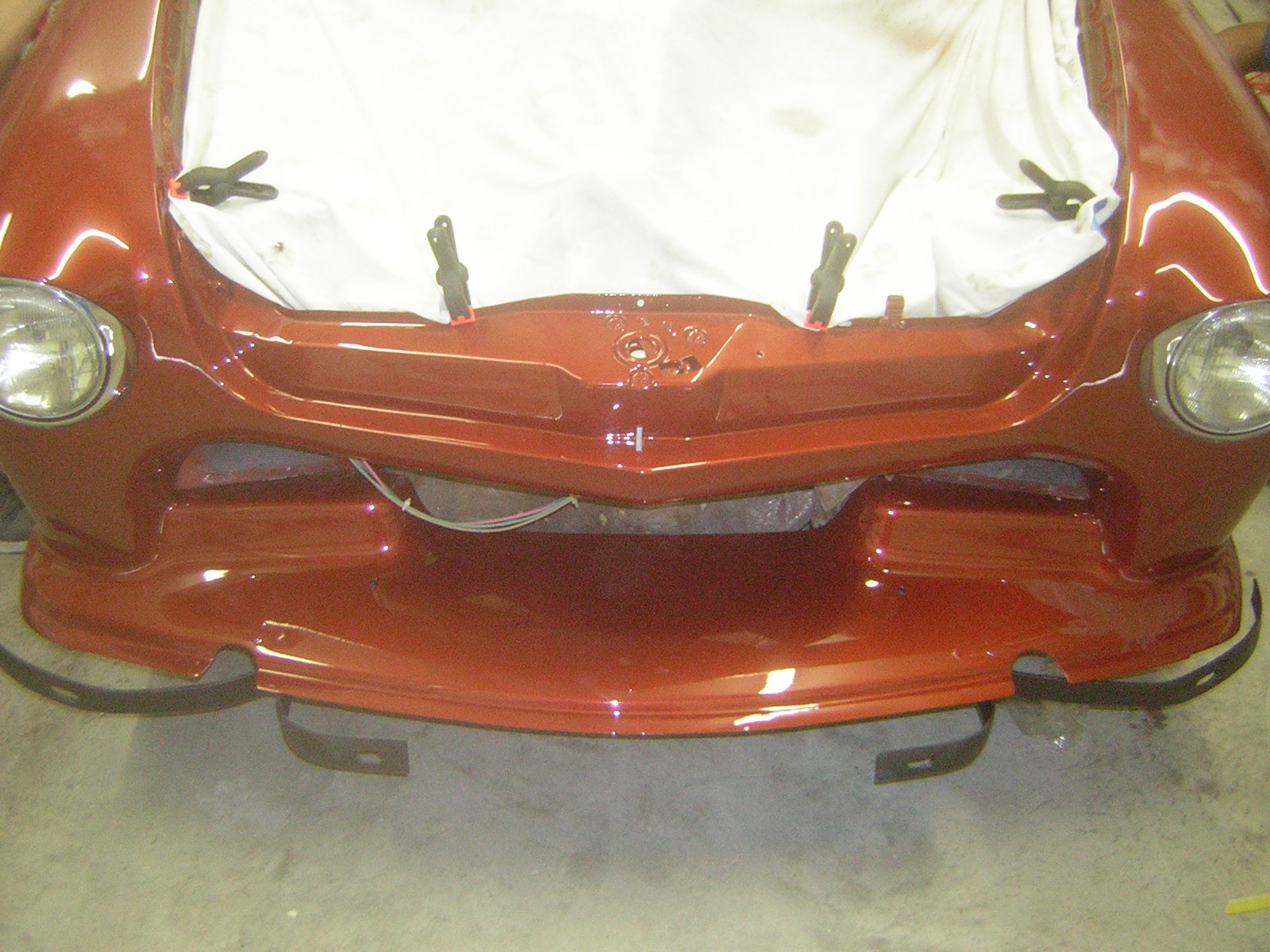

  29. jivin jer
    Posts: 3,495
    jivin jer
    It's a new world.
