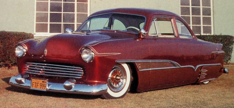

    The cool thing about this car and discussions that surround it is that it gives us a look not only at this car but, Jr reacting to the culture and the culture itself.
    This first pic shows the car just after being completed during the Barris marathon (post #220). This is the car at its lowest. Geo. And Jr were driving by the Lynwood Fire Dept. and Geo. thought it would be a great place for a shot of Jr's car. Jr maneuvered the car onto the gr*** area after they got permission to do so. While the car was setting there during the shoot the tires settled into the gr***. When they left there were two trenches that were dug in the gr*** by the lower a arms. Needless to say there were some unhappy people at the fire dept after that trick.
    The car had flipped uprights. This was before dropped ones. The lower a arms were modified as were the steering components, and chopped coils of course. I think Jr said he had 6" (!) blocks in the back with de arched springs.. As far as having access to the rear tires, forget it.
    If you wanted the ***le to the lowest car around it meant you had to have a way to measure a car that you thought might be a threat. The pan did end up with a hole in it once. The car was all s****ed up underneath. The car drove fine.. Jr says that having a car like this was a sonofa*****, but its what you did back then.
    The last pic is the historical record of Jr's surrender to the forces that be. This was the car at its highest. Jr drove the car like this for about a year before he sold it.

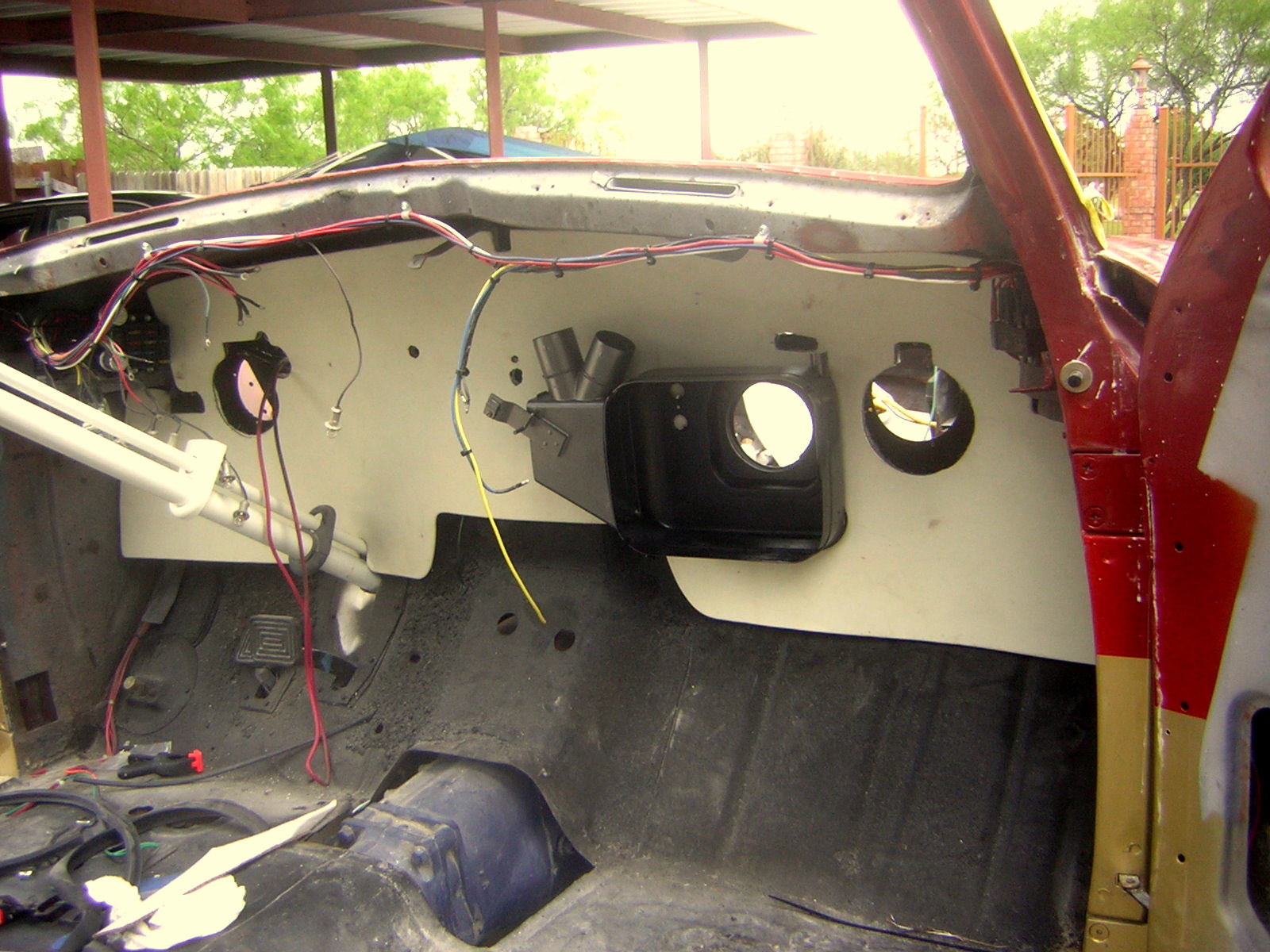

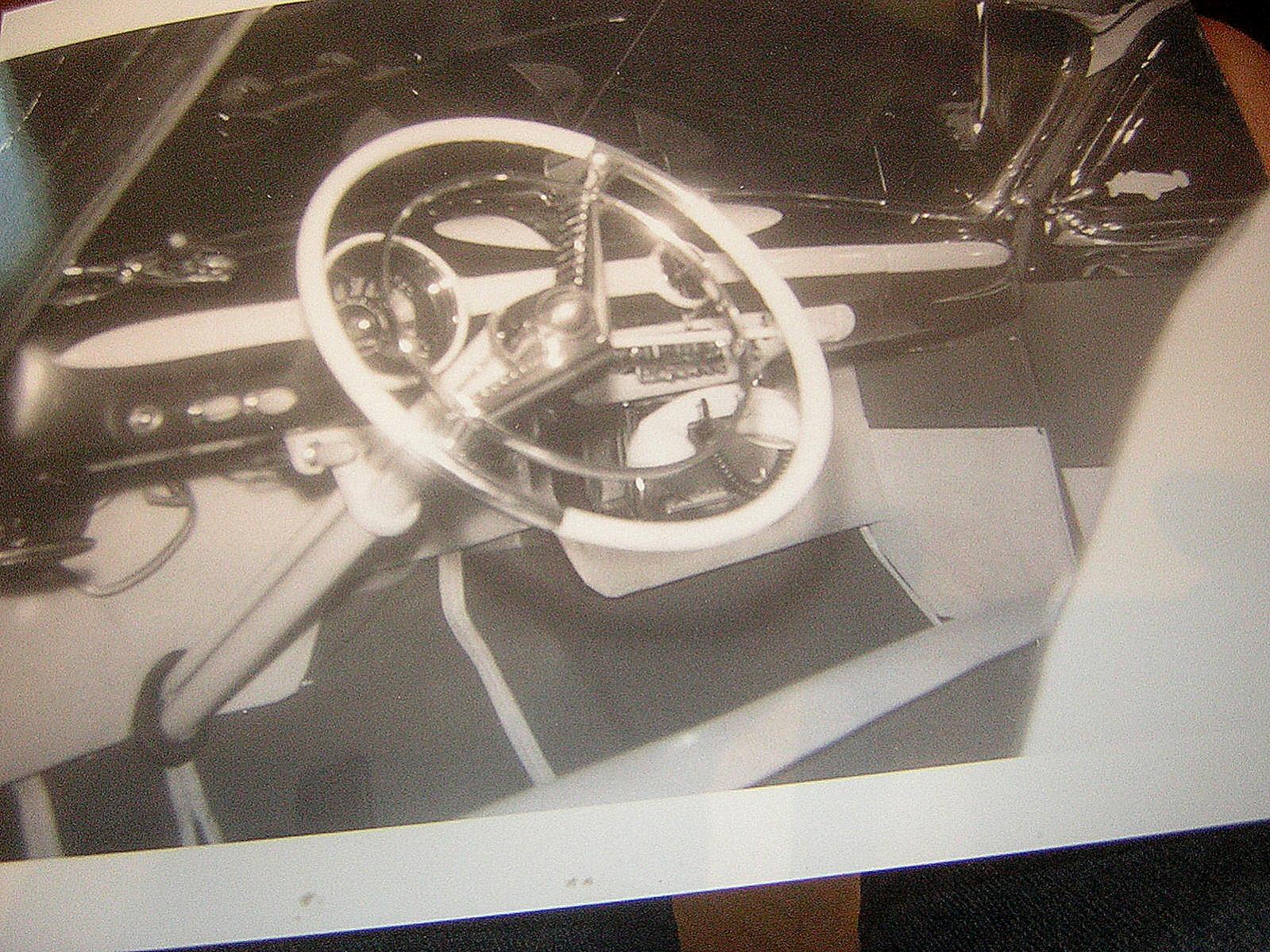

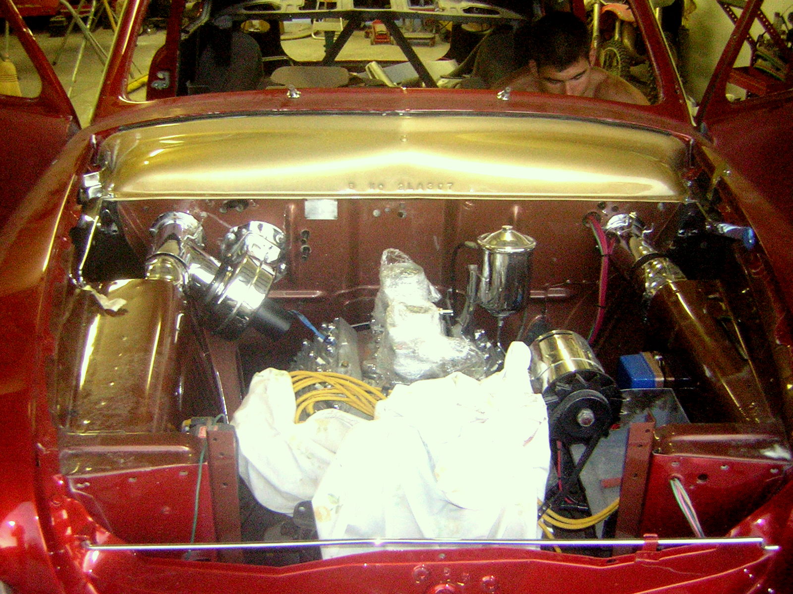

    The ***embly continues as we get the car ready for the upholstery shop. The stainless hasn't arrived yet from my local guy (that's doing a great job). We're concentrating on the firewall in preparation for the final installation of the dash. Jr sent me a fuzzy pic to help with the location/configuration of the phone. This pic shows the correct steering wheel that I have to find. It's a 55 merc accessory wheel. I bought a 56 monterey wheel early on by mistake. It will have to do for now. The little bracket that holds the air vent controls (just below the speedo) was interesting. My car had those controls in a bracket to the left of that location that I had chromed. I had this correct bracket on my parts car. One of the problems I have with this build is thinking Iv'e got everything figured out until the next pic comes out of hiding that reveals something different.
    The car had the unique Gaylord headliner in it when Herb (Jr's brother) bought it in 53. During Herb's ownership Jr paid for the interior to be finished. A mom & pop (Russ & Bess) in Compton did the rest of the interior. Note the kick panels that don't match the door panels. Yes, this must be captured as well. They've taken the rubber lip off the firewall insulator. This trims the bottom and helps keep the carpet tucked in (which isn't in the pic). All this stuff is important if we're going to see the real car.

  24. jivin jer
    Joined: Sep 14, 2008
    Posts: 3,495
    jivin jer

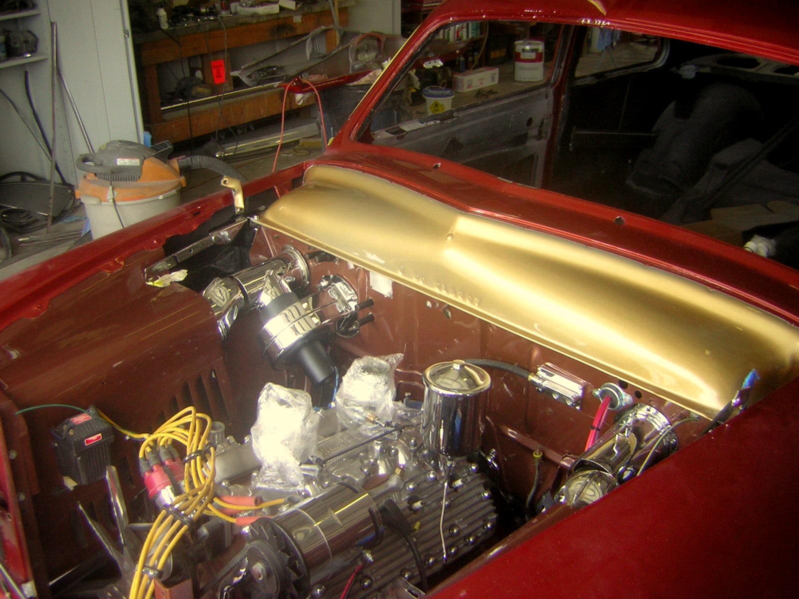

    Lets get this thing together.

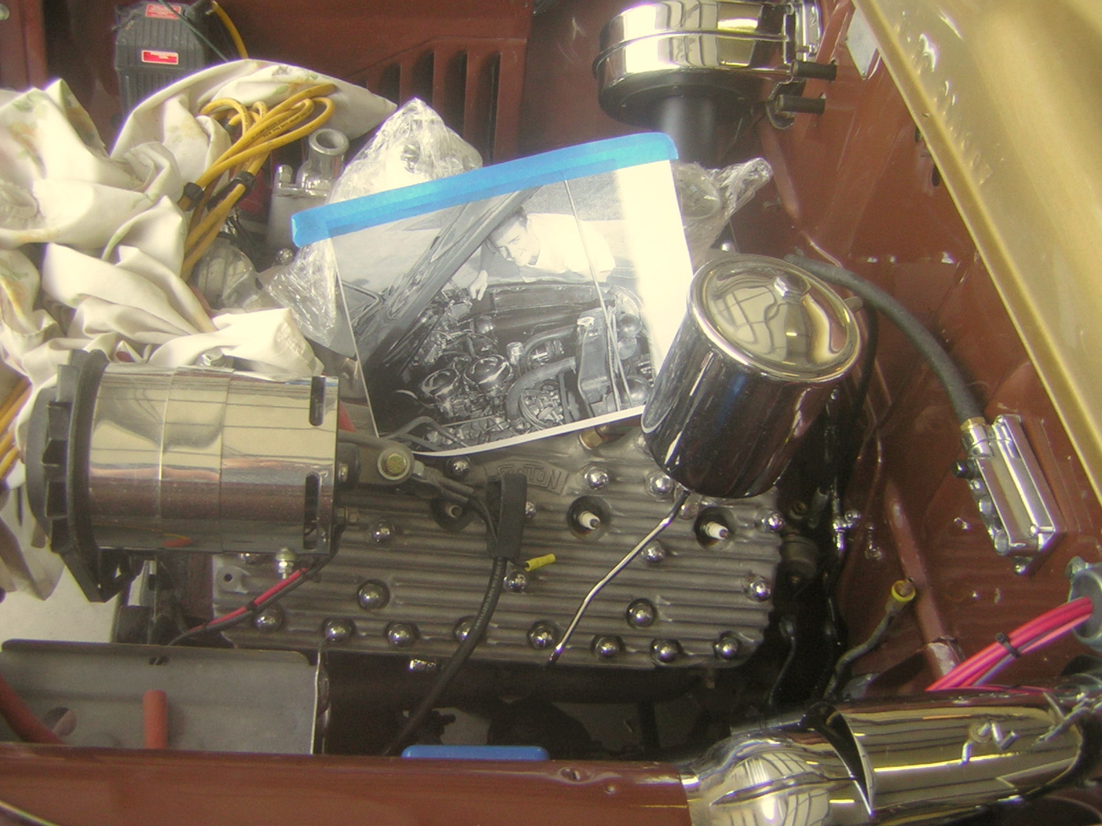

  25. jivin jer
    Posts: 3,495
    jivin jer
    and more.
  26. jivin jer
    Posts: 3,495
    jivin jer
    Still more.
  27. jivin jer
    Posts: 3,495
    jivin jer
    The other side.

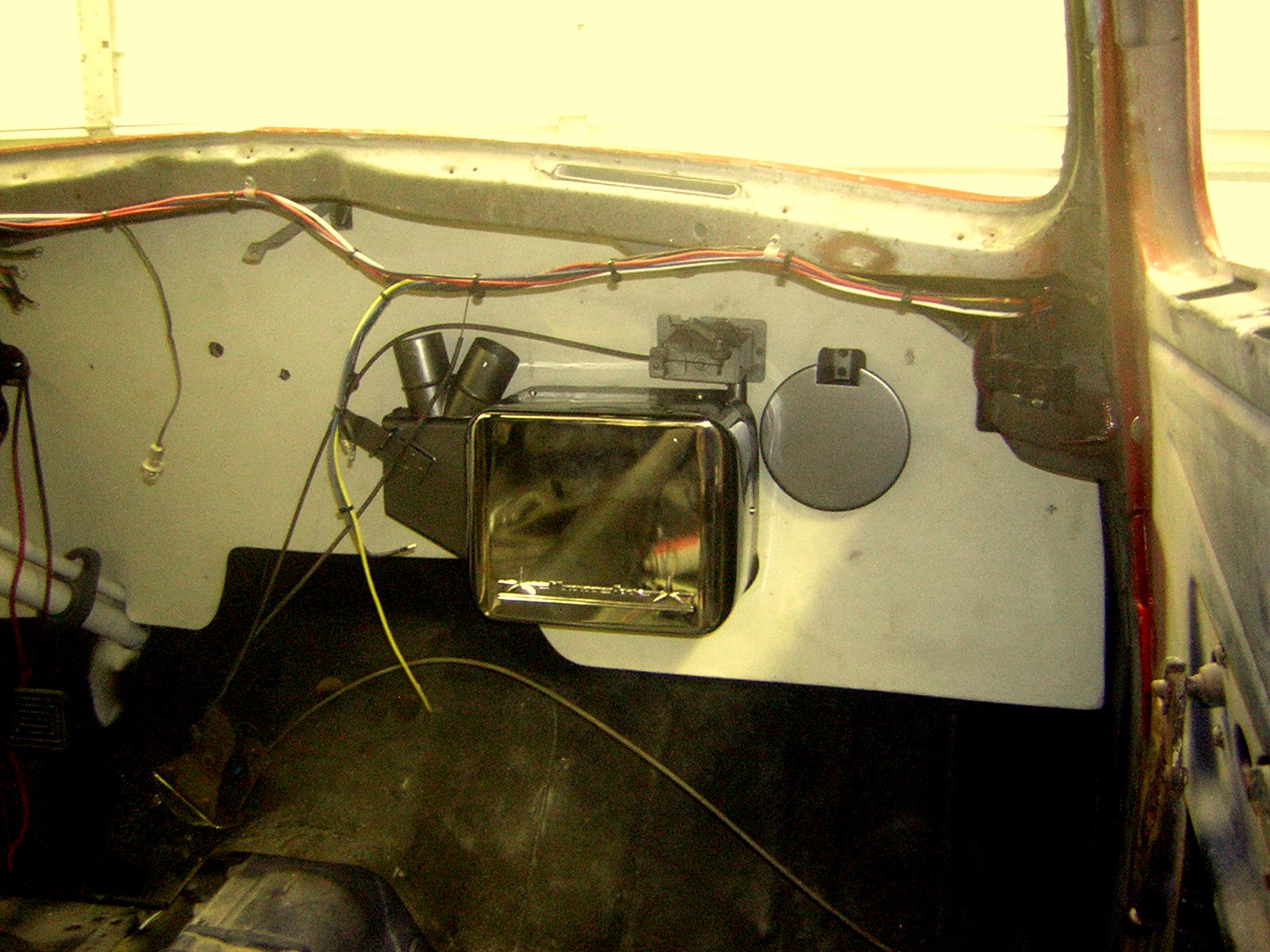

  29. jivin jer
    Posts: 3,495
    jivin jer

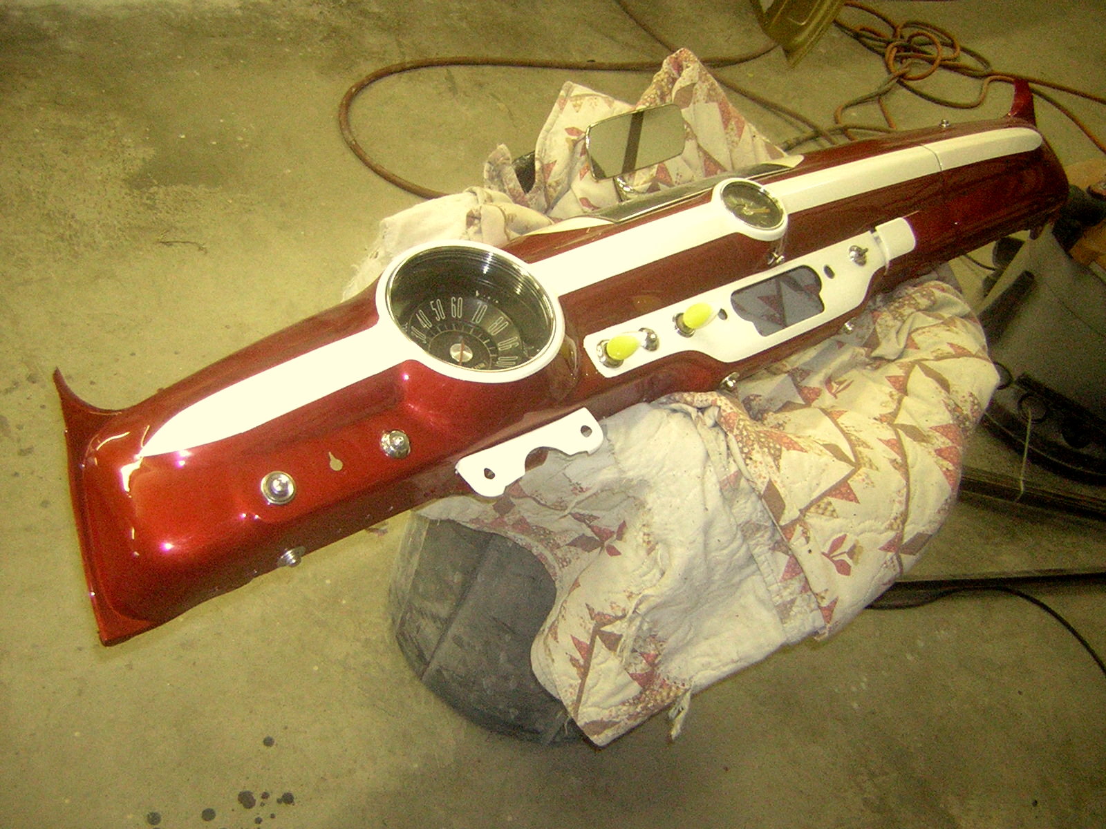

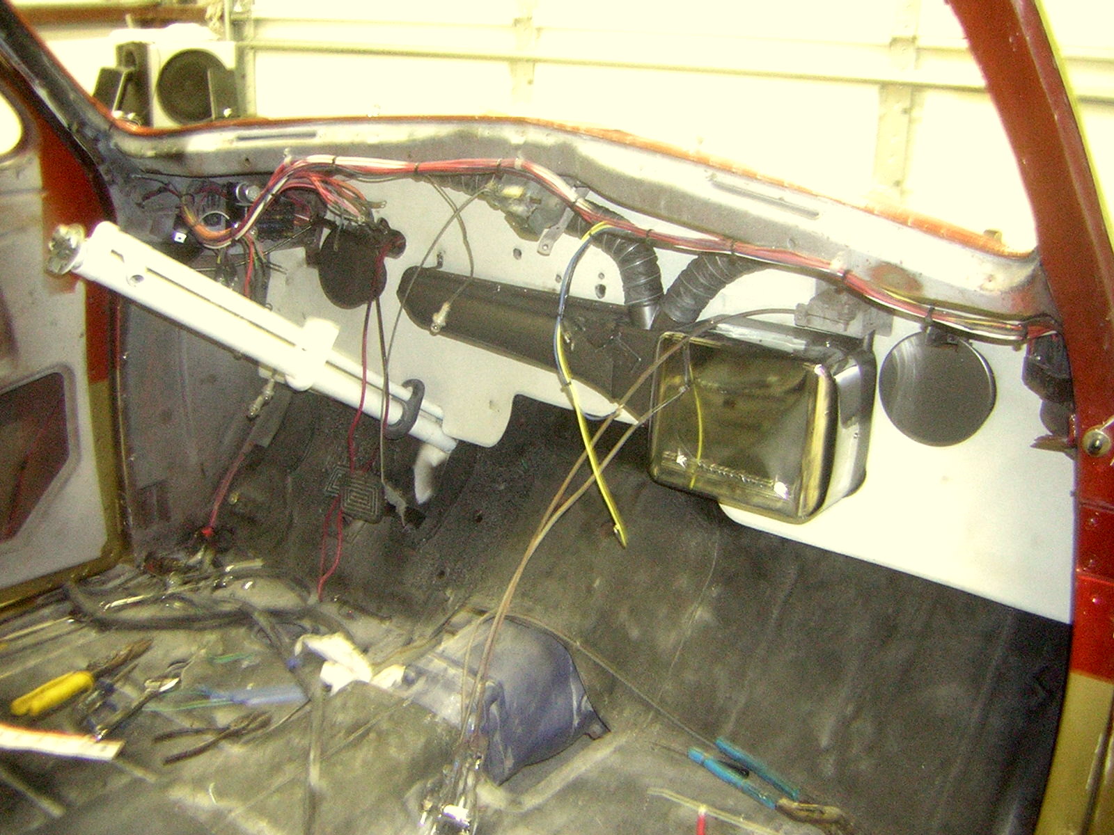

    Almost ready to install with correct bracket. Notice the door poppers at r-l of radio and, trunk popper on l.
  30. paulie_boy13
    Joined: Mar 1, 2005
    Posts: 269
    paulie_boy13
    from NC
    what make/model is the mirror from? I didn't see where it was mentioned.
