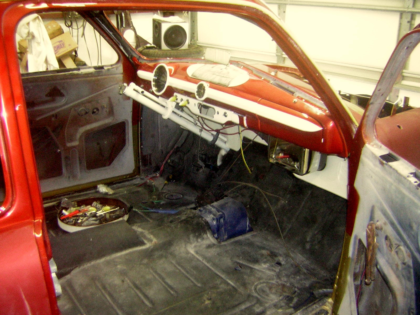

    The dash must be happy now. The mirror is '54 chev..

    Jer,
    Great job recreating an incredibly elusive car! You're doing an amazing job.
    I have just a couple questions, as I'm doing an early-'50s-style shoebox myself. Mainly: how are you handling dash instrumentation? I know you're going 12-volt, but what are you doing for a headlight switch and an ignition switch?
    I want to use my original switches 'cause I like the way they look--the ignition in particular--but I'm a little concerned about reliability. Just wondering how you're handling it.
    Thanks!

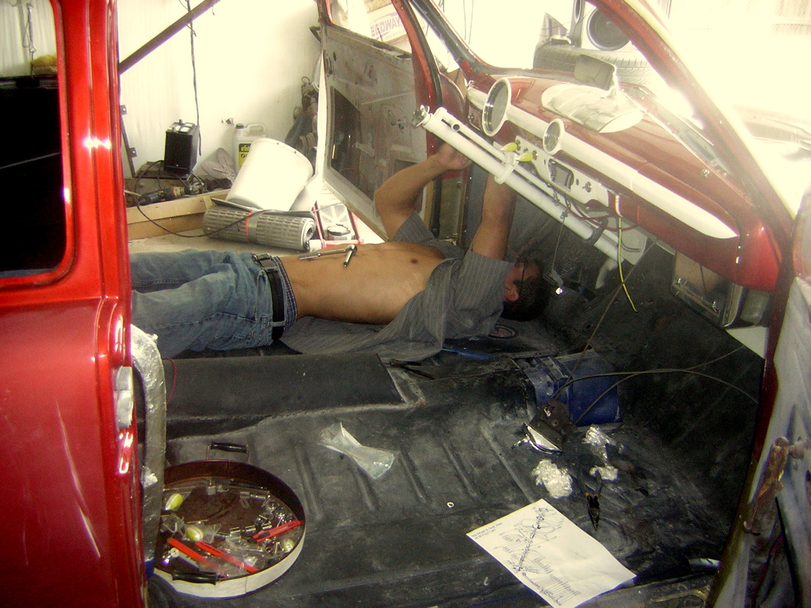

    Theo, these switch's were functioning when I got this car. I just hooked em back up with the new harness. I wish I could be more help than this. Sorry.

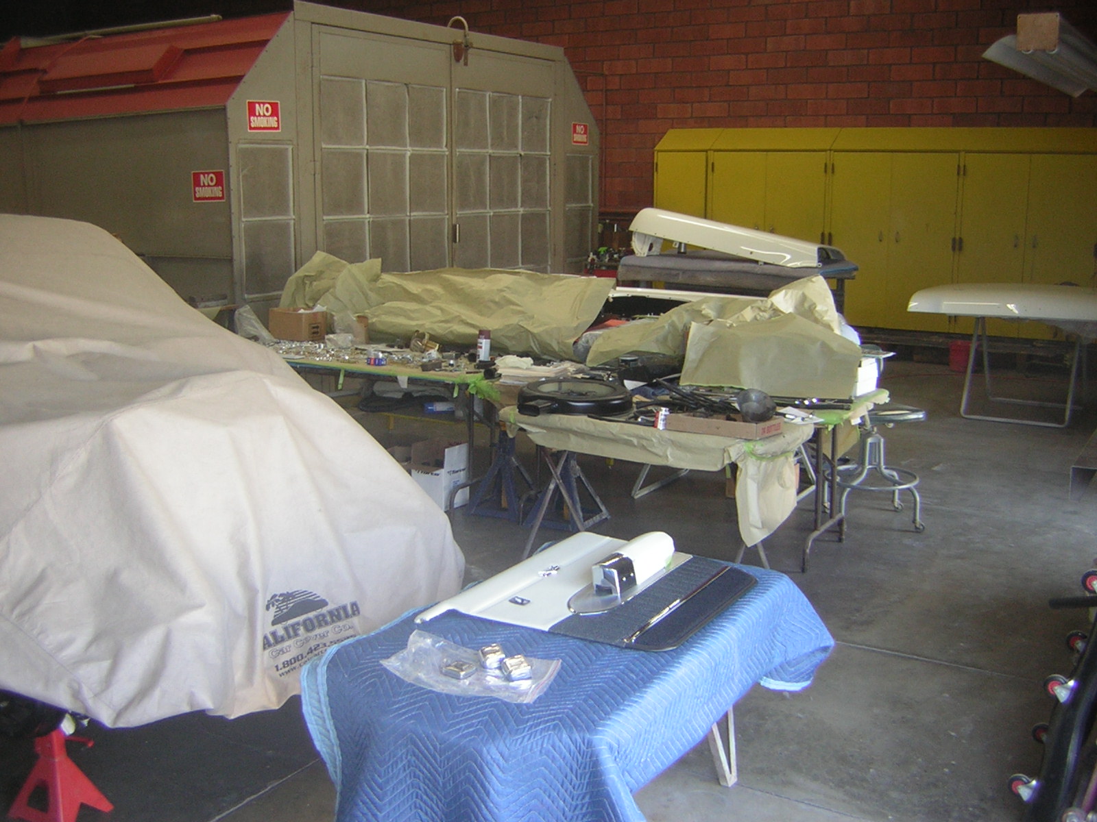

    I'm showing pics from my visit to Jr's shop in Nov. and a portion of the new cut and buff. Oh, and the pic of me and Jr? I AM SMILING, just a little awestruck.

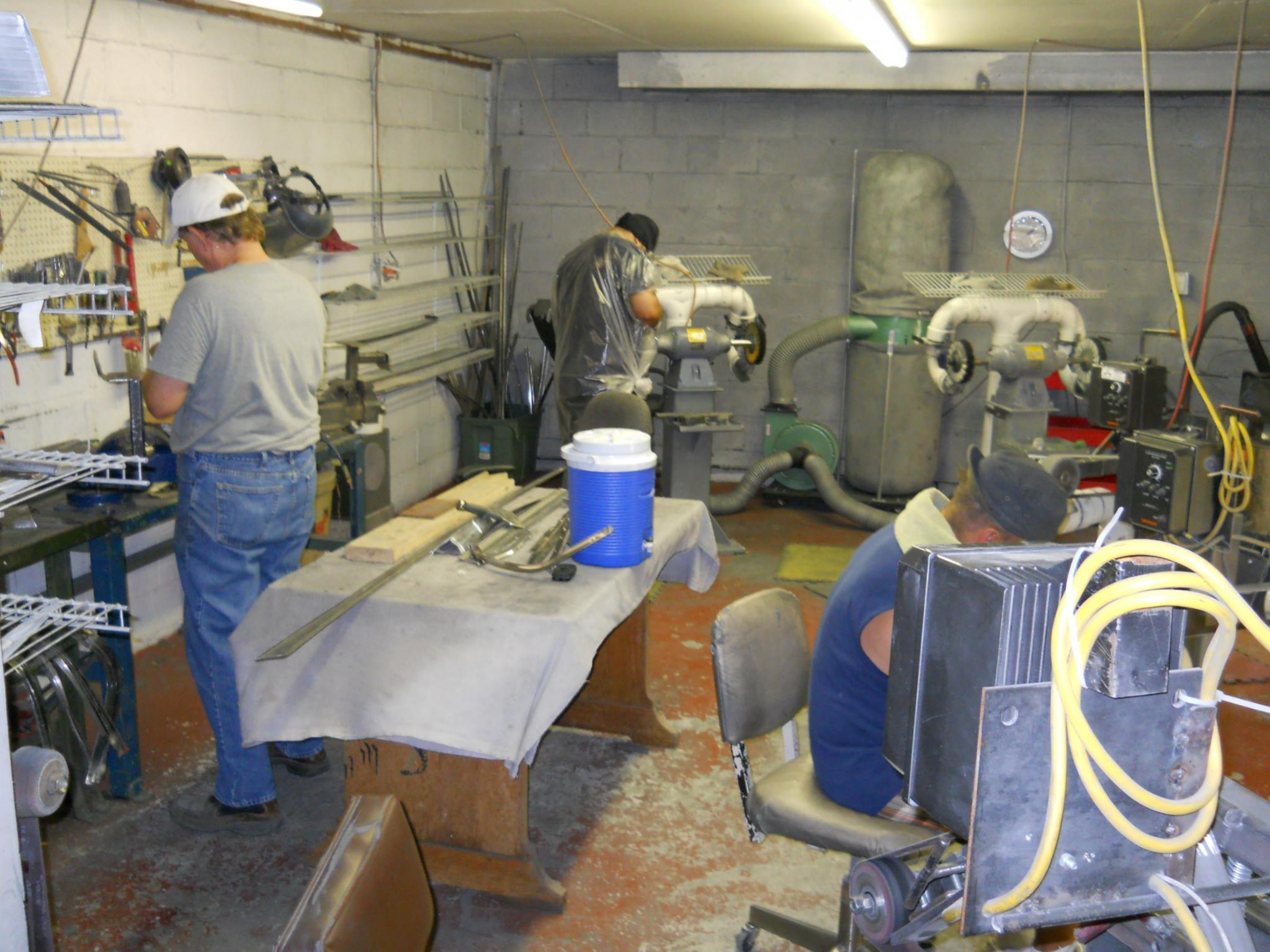

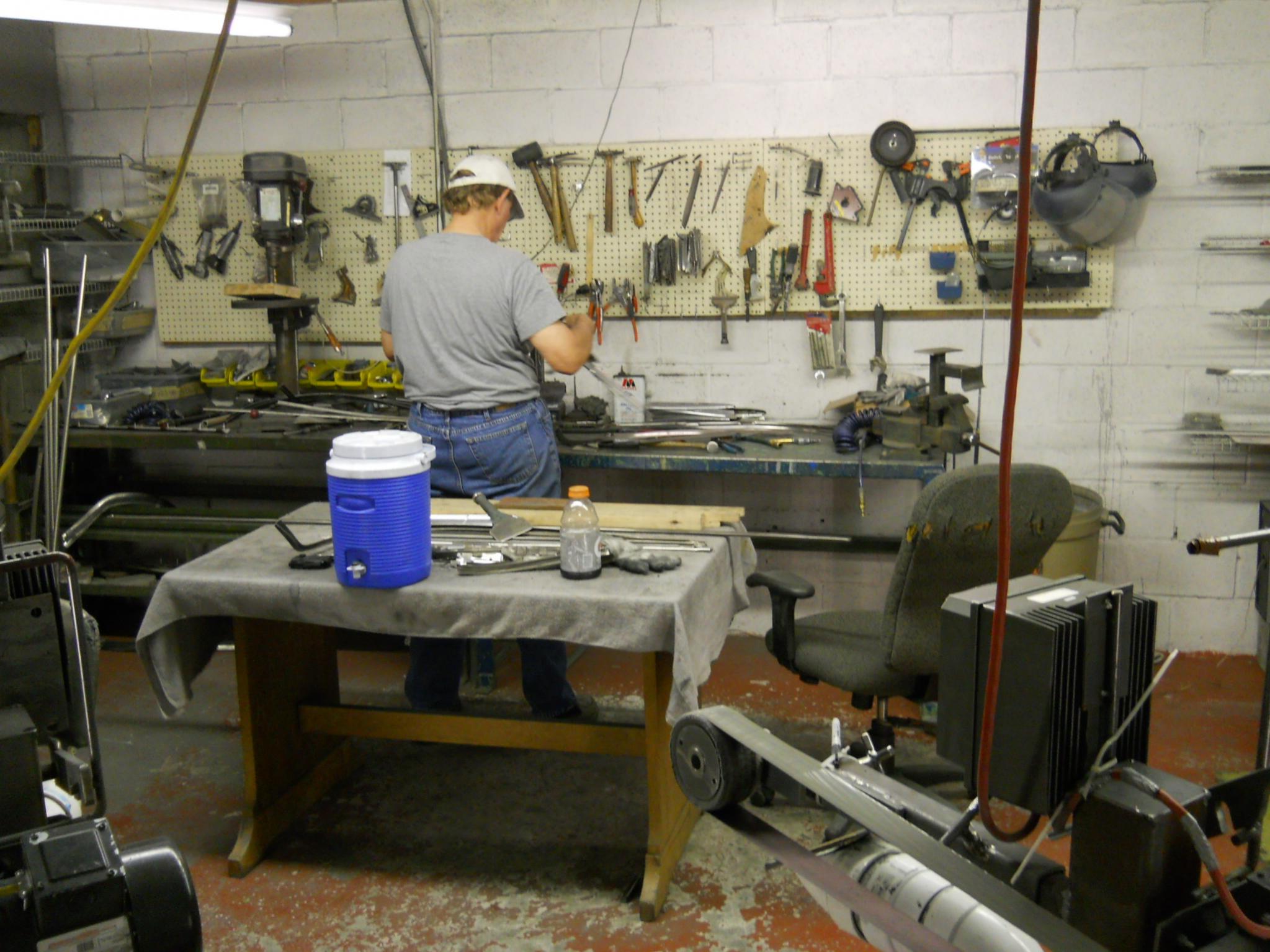

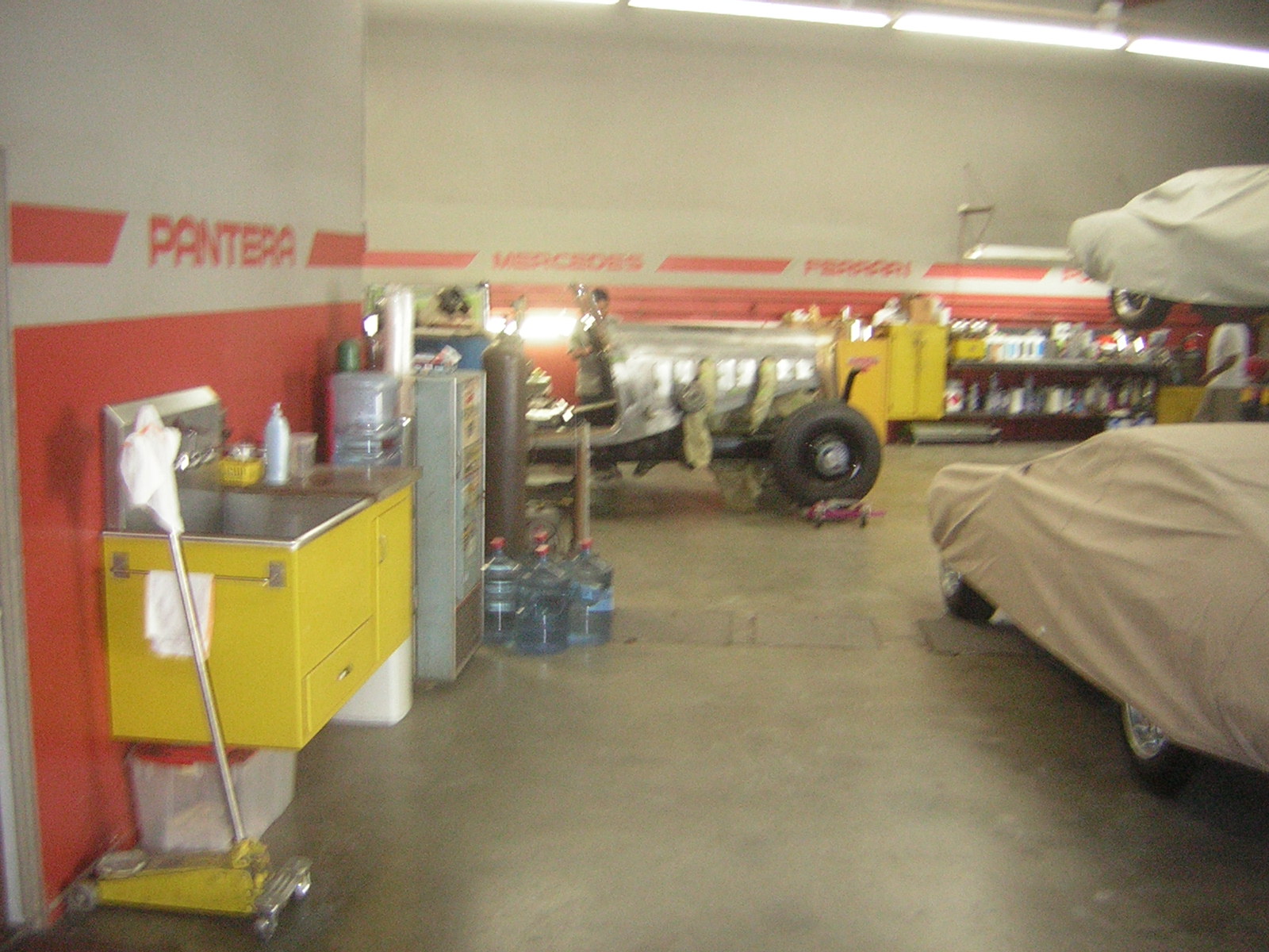

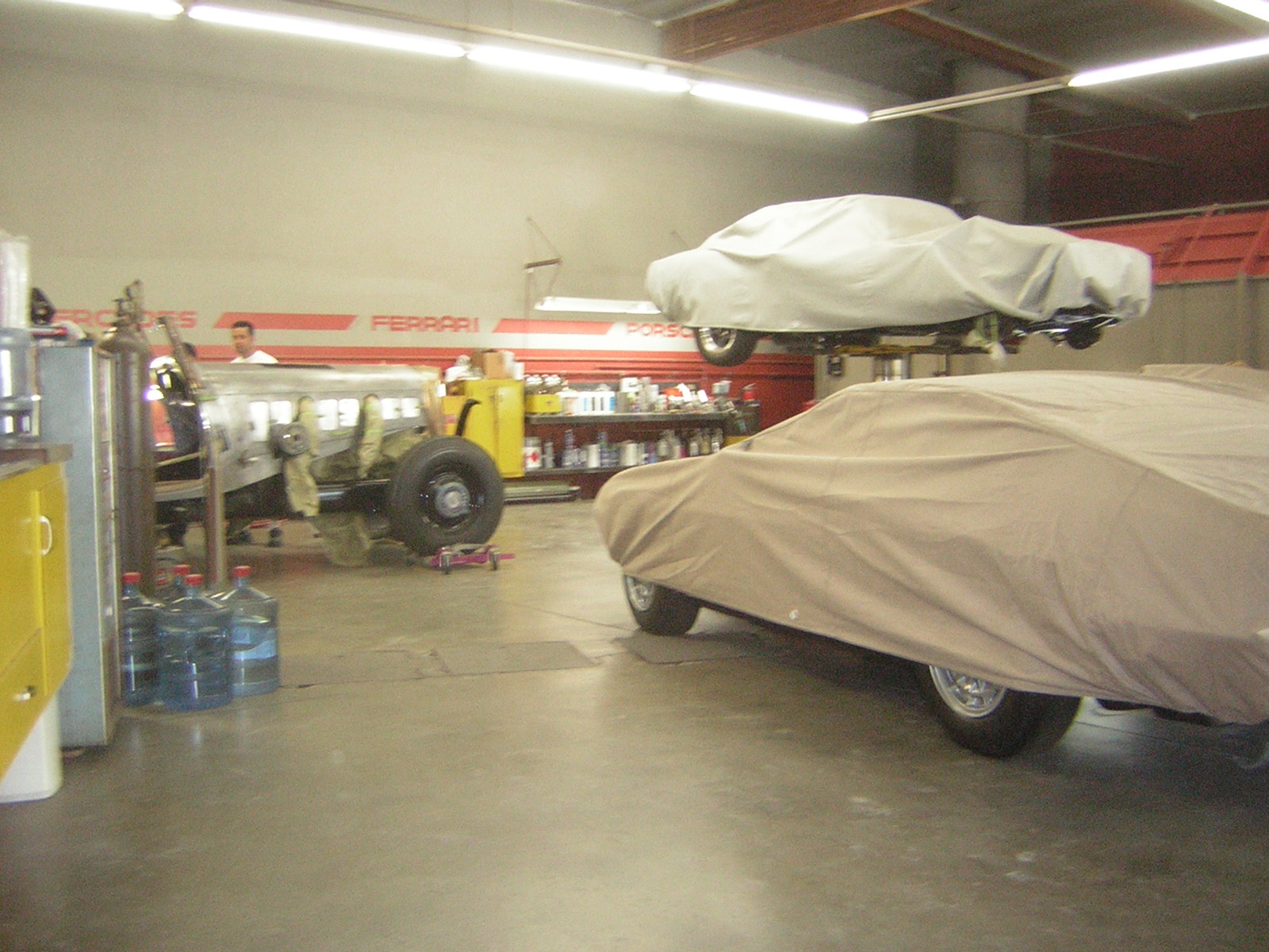

    This is another pic that I should have posted with the rest. This shows the side of his shop that has the booth. These are the front end and interior parts of the 59 Cadillac sedan deville that we're standing in front of. This is the car that I examined the most. This would be an example of a non cl***ic that I mentioned in the last post. If I have this story straight this car belongs to one of his cl***ic car customers wives. This was her dads car that she ended up with. She remembers riding in the back seat. She wanted it restored , so Jr gets the job. Iv'e been told (not by Jr) that the bill on this car is multiple hundreds of thousands of dollars. This is at $75.00 an hour and if you remove a fender its just as nice under it as the fender itself. So you see these components go from fenders (in this case) to works of art with many hours on each one. BE CAREFUL WITH THAT!!!
    The old car in the pics is a 38 Mercedes Benz military (Nazi) command car. Jr is looking to win Pebble Beach with it. The other cars under the covers are Ferrari's and Porsche's etc.

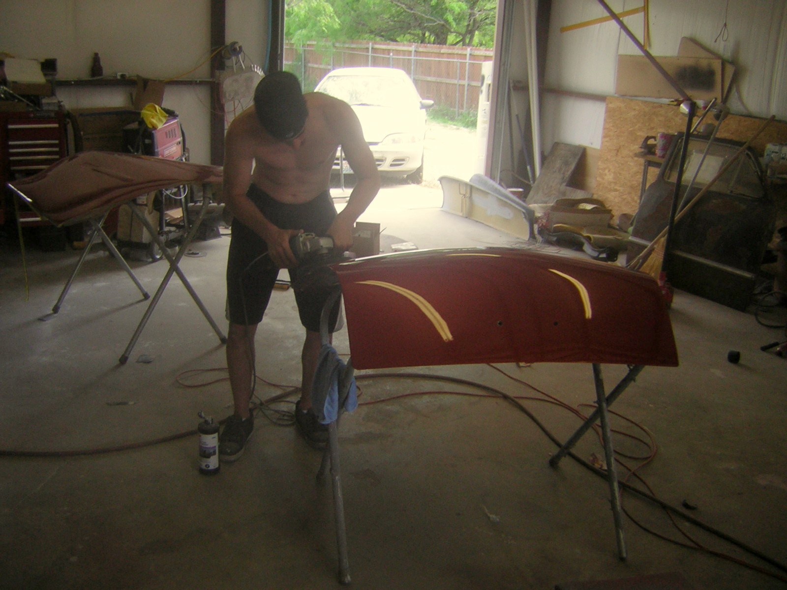

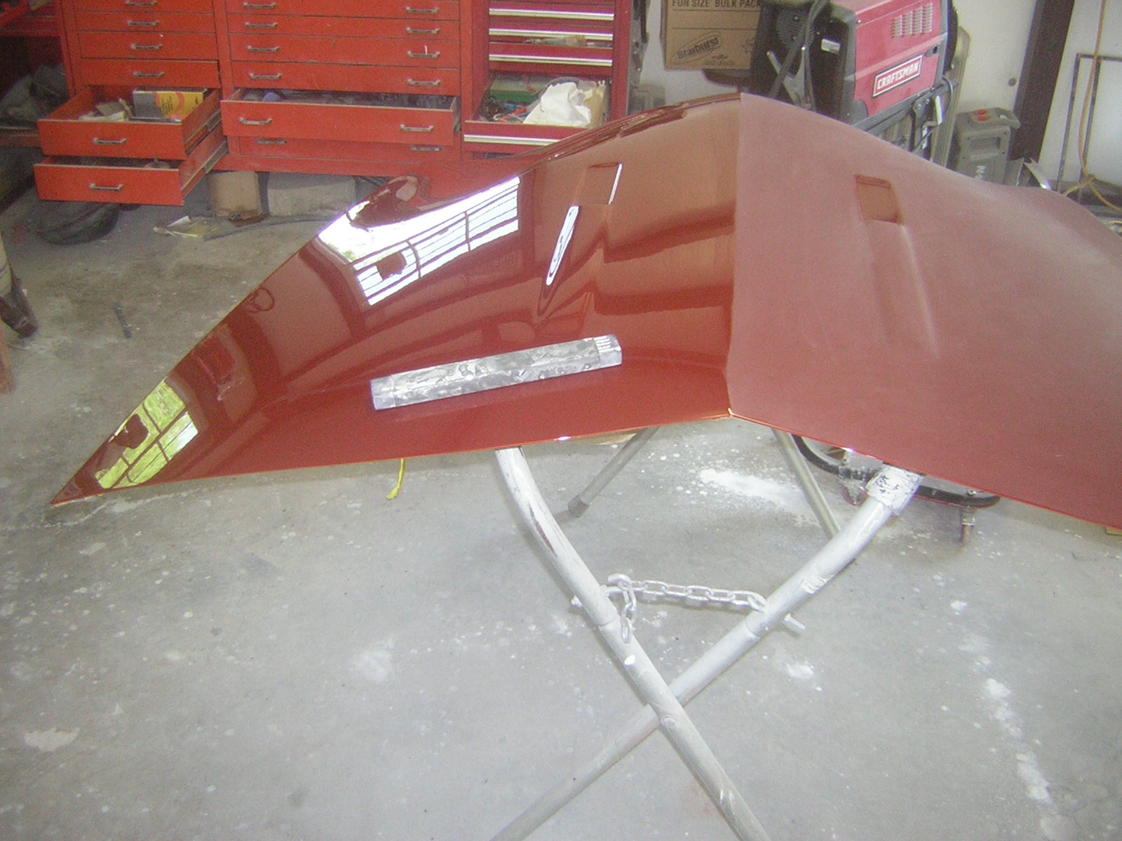

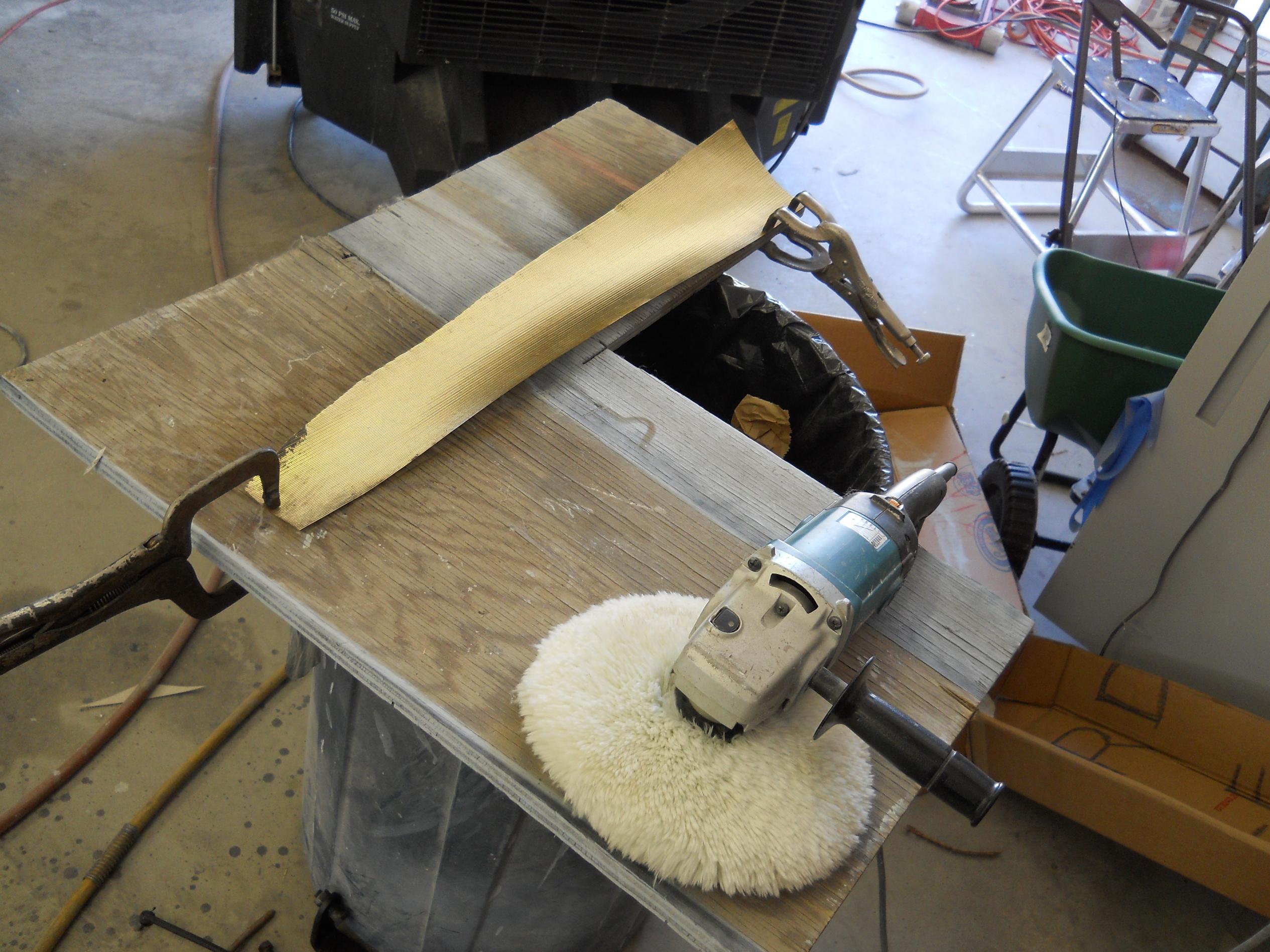

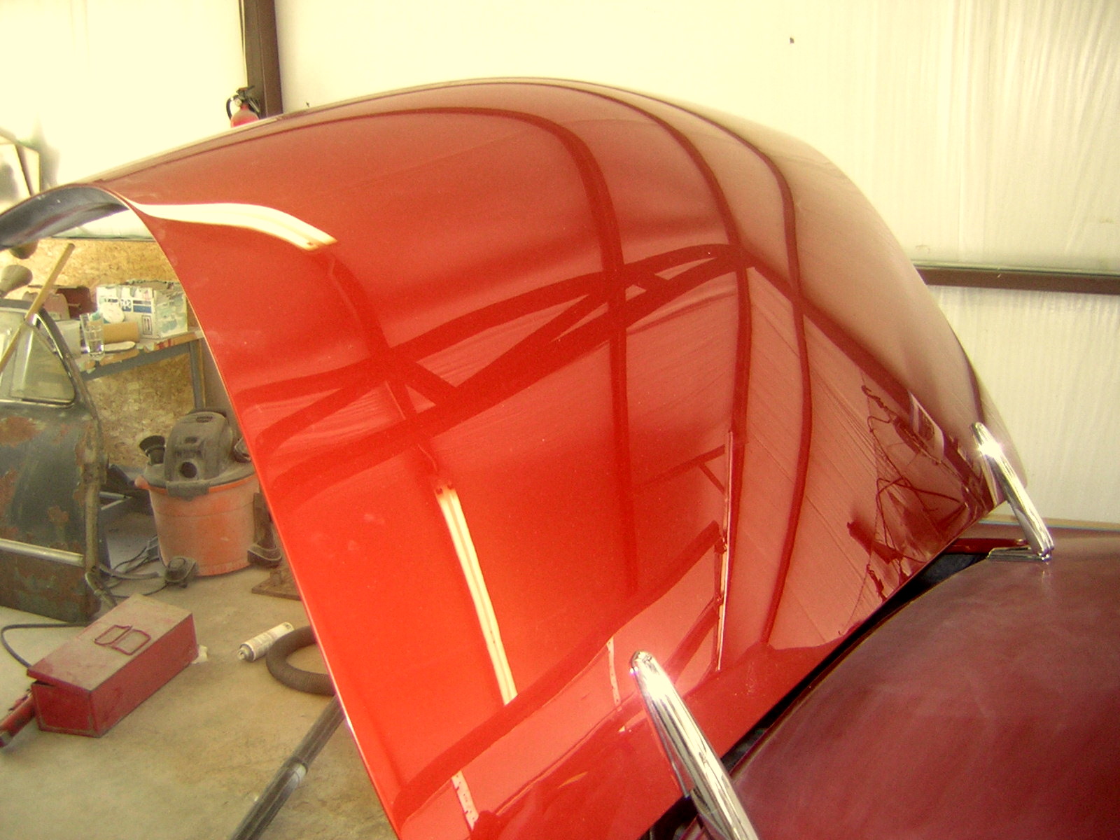

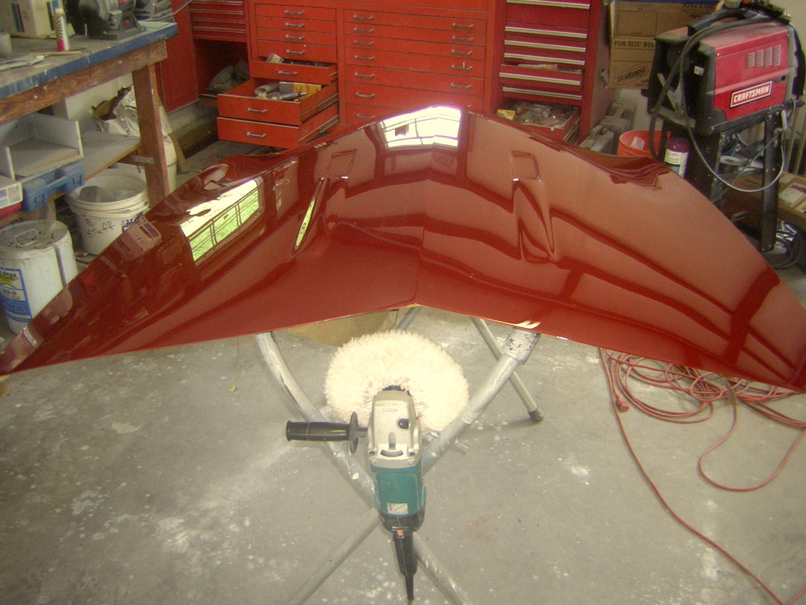

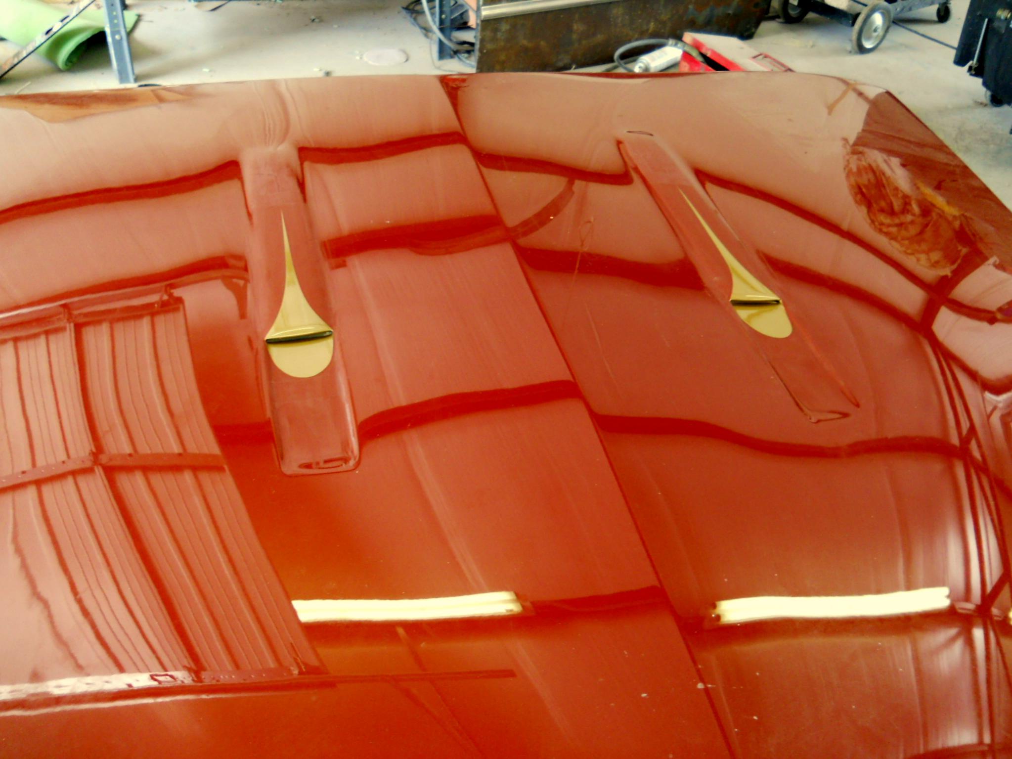

    Here's a couple shots of the block/rub process. Hard to see the difference. I can see it but I know what to look for. The paint is now hard as a rock. The bad? Difficult to make any progress with buffer. Takes a lot of time. The good? Hard to rub through and it's not going to change (shrink back).

    Lookin damn good!!!! The harder the clear is, the better the outcome will be after you buff it. The **** part is it takes forever as I'm sure you know!!

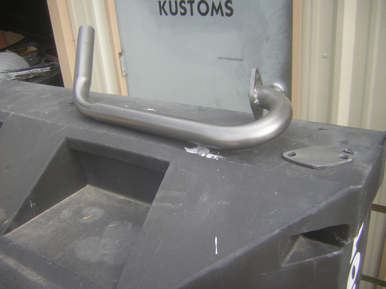

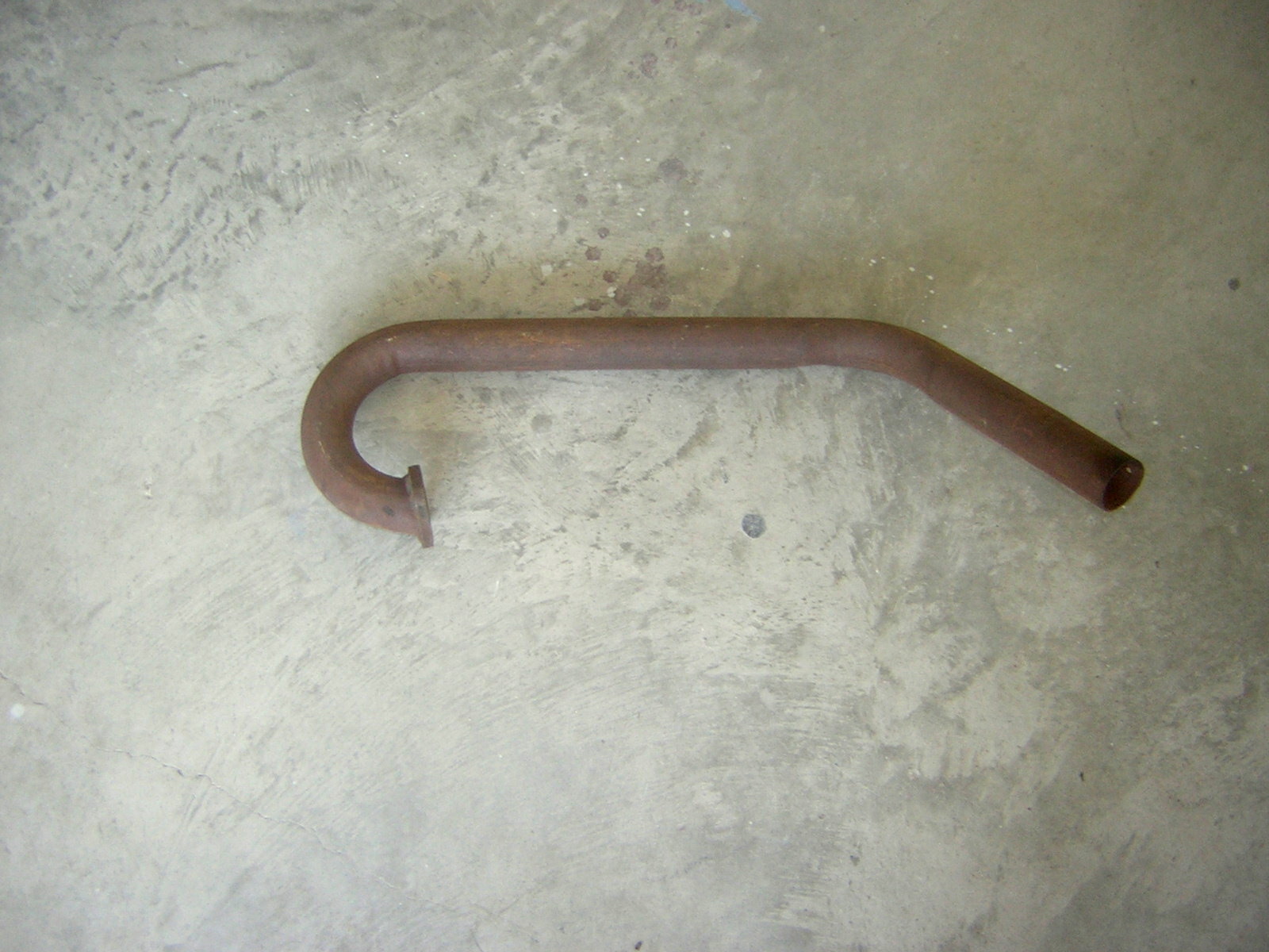

    Hey! look what the mail man brought me. This is a nos dual exhaust conversion pipe out of a dealers inventory. What I been lookin for.

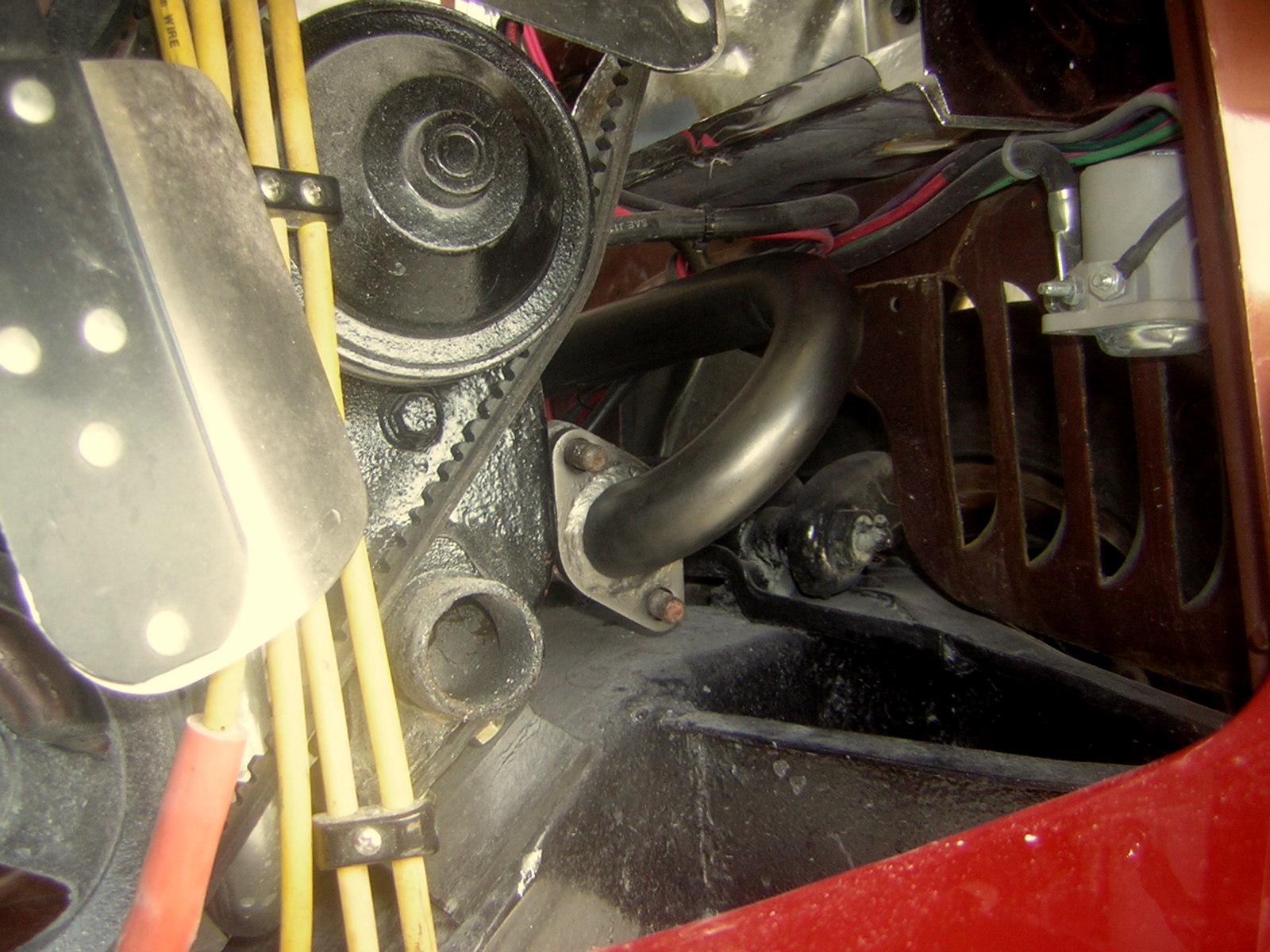

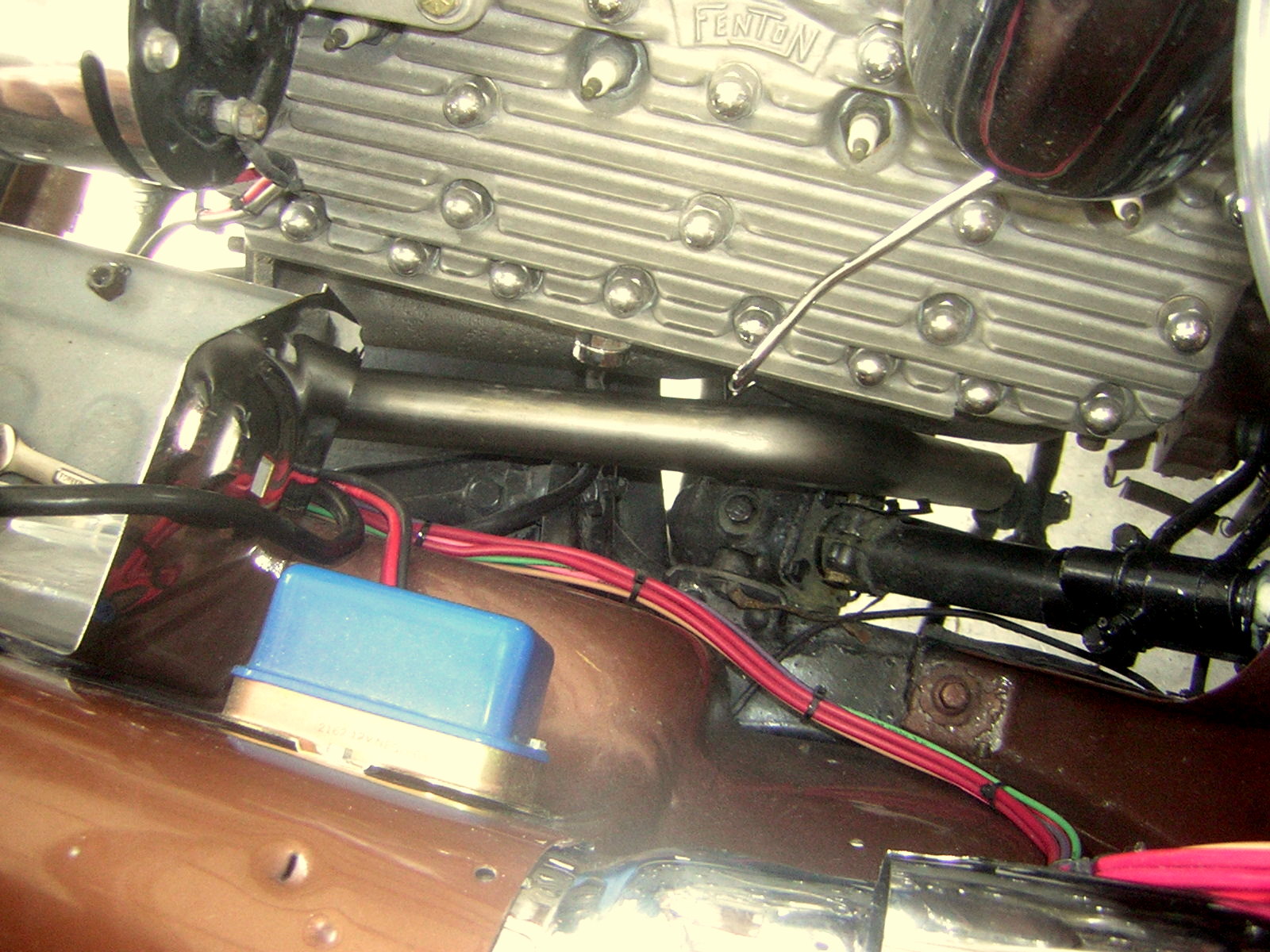

    We sandblasted the surface rust off and put Eastwoods manifold dressing on it to match the manifolds that are supposed to be on the car. This is a great place to be in that we have the exhaust issue dealt with. The rest of the exhaust should be a piece of cake.

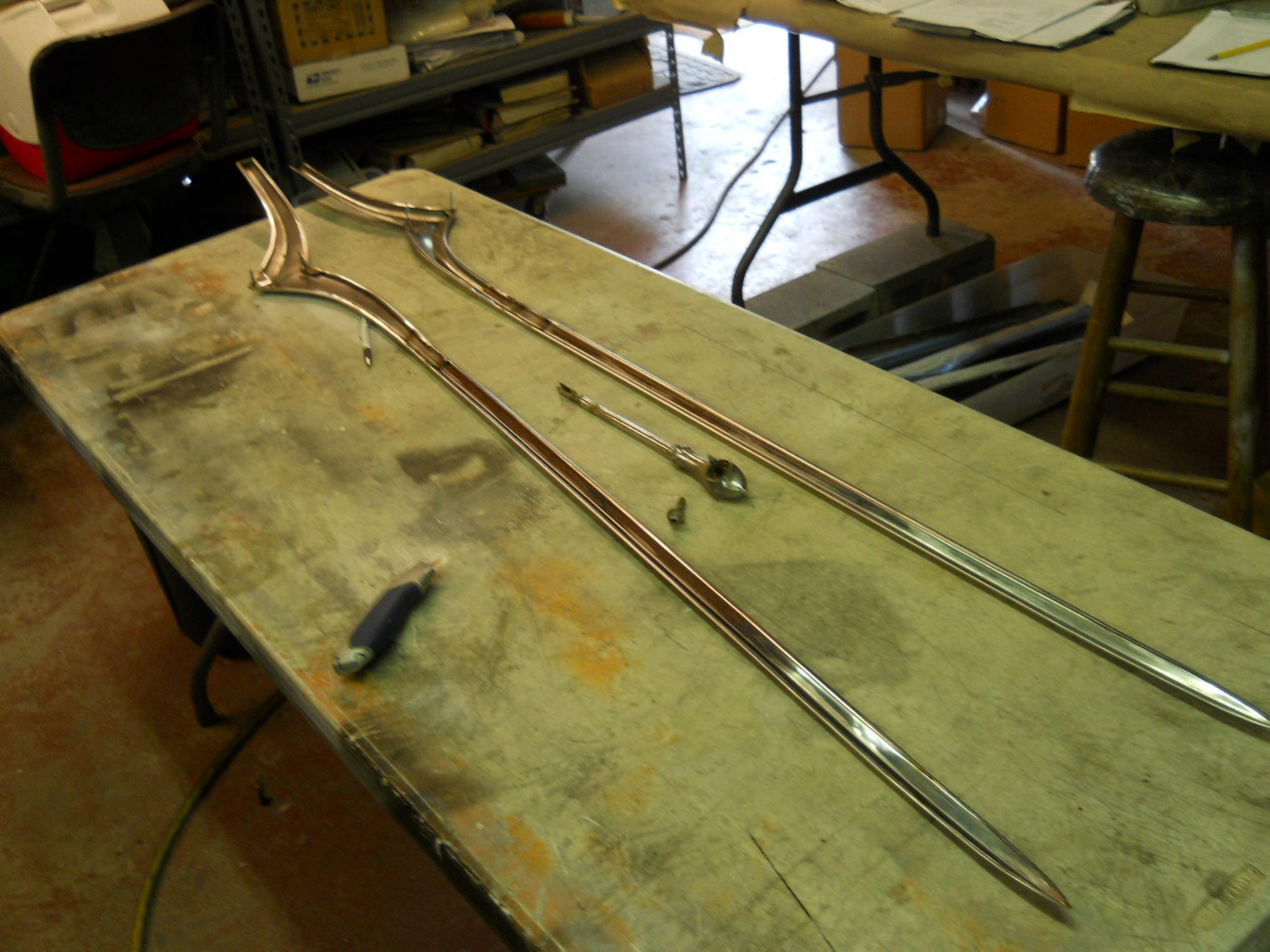

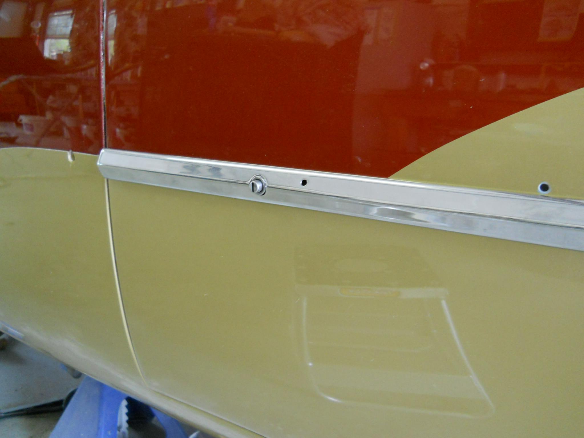

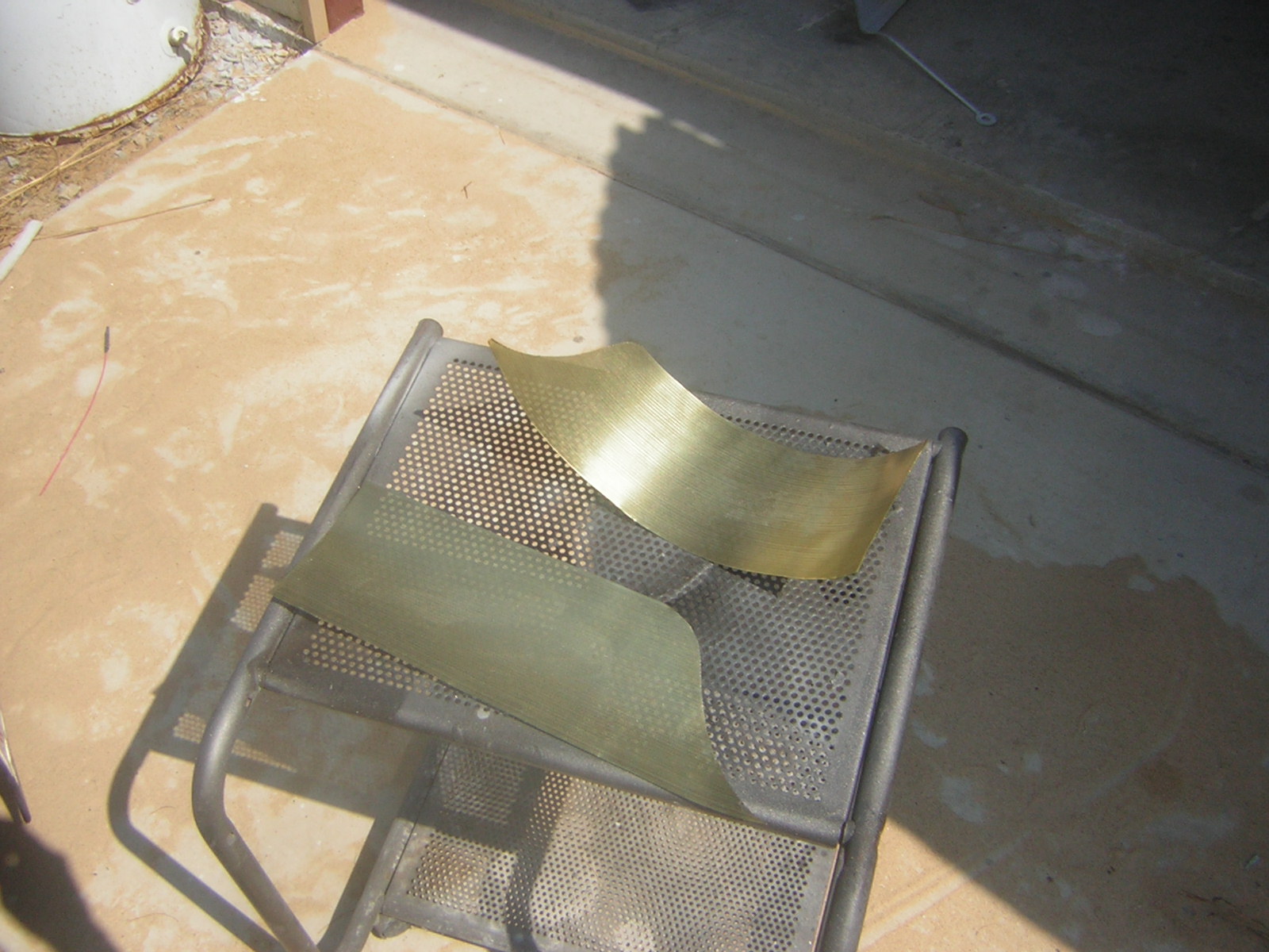

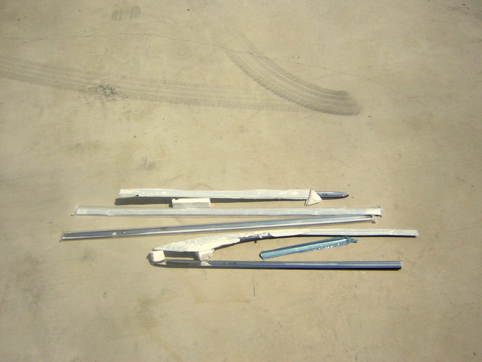

    OK, wer'e going to tackle these mldgs (or they're going to tackle us). The '54 Dodge mldgs are curved and need to be straightened to fit and the '55 Ford mldgs are straight and need to be curved. The first pic shows some of the mldgs. The next pic shows the br*** sheet insert templates.

    The various tasks that have to be done and the skills involved to do this continue to amaze. The br*** sheet that I got is supposed to be the last on earth. When I took it out of the box it had some major (black) corrosion on the bottom where it had been sitting in a warehouse for (?). I had to become an expert on br*** etch. The attempts to polish it worked great on the face but you could see all the polish in the holes when it was held vertically. Plus, its very stiff and resists attempts to lay it out flat. Fortunately the pic on post #275 gives a hint at how difficult it was/is to work with. The pic on post #153 shows that problem (looking down the side of the car). Eventually it was ketchup (a thin film) on both sides dried out in the sun that made it nice and bright (but it was blotchy). This was fixed by burnishing it with a cotton pad (nothing on it) on the buffer and clear lacquer to encapsulate it. Hey, aint this a hoot??? (um…not sure)

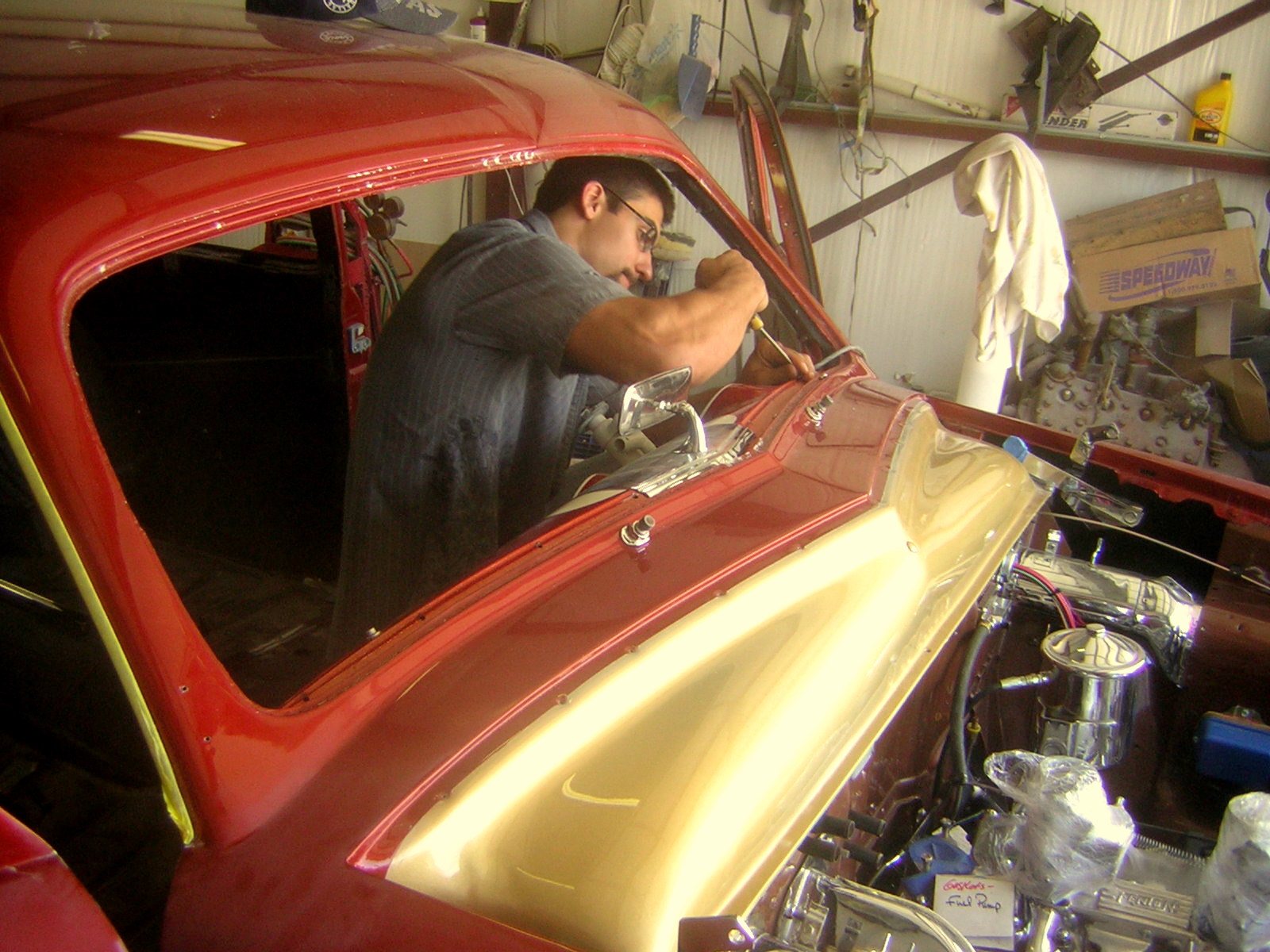

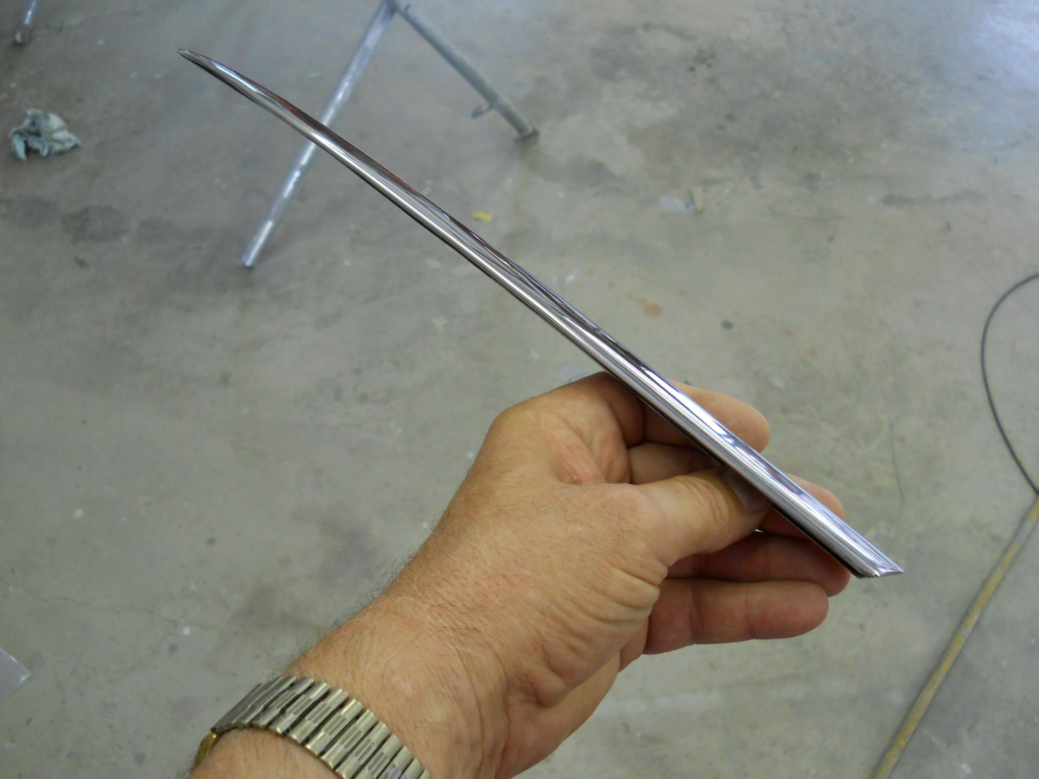

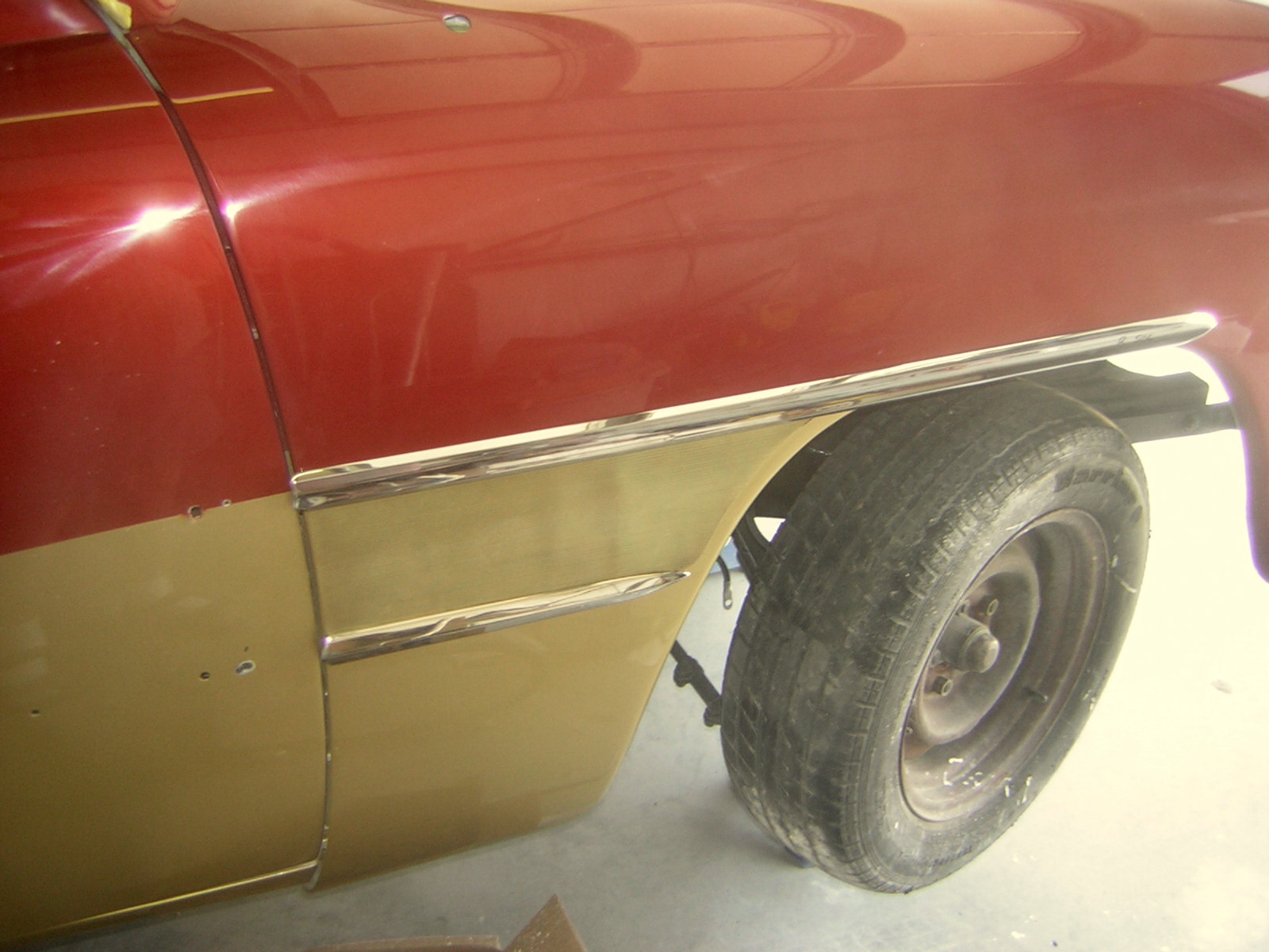

    The use of non stock mldgs translates into numerous trial fits that reveal what needs to be shaped, reshaped, etc..
    Two years ago I went to my first Texas custom car show. There was a late model chev truck there that had cut down 57 chev side trim on it. I left a note with my phone # on it. This eventually led me to Cl***ic Stainless in Fort Worth. It turns out that they're about 5 miles from where I live. They focus on the tri-five chevs. They fab mldgs and mldg retainers. They have a former jeweler on staff that helps with the welding/fabrication and detail work. I went over and talked to Ken Young that owns the shop. I brought all my car info to be able to show him what I was doing, and my area of need that potentially included him. After spending about a half hour laying out the what, why, and who with this project I asked this tri-five guy if he was my guy. He looked up with a look that said it all and replied yes. So, Cl***ic Stainless has put the pieces together and we're in the fit process as far as contour goes. I'm glad that I'm able to go back and forth easily.
    Along with the mldg pics I'm including some of the Cl***ic Stainless team at work. The mldg in my hand is a formerly straight ford piece. That last pic has some mldgs that looks familiar.

    Geo. helped Jr with the mldgs but Jr did the fitting/filing and attachment. There was no welding involved. Geo had worked out a way to cut the visible ends so that they could be shaped and folded into themselves. This gave a tapered end that would move into the door opening when the door was opened. If you looked closely you could see this. The ¼ mldgs (55 ford) were two sections mounted (****ed up together) in such a way that they looked like one piece. The splices were where the factory designed ends were encountered. The two pieces were pushed/fitted together over a sleeve that was fabricated. The fender mldgs were left open as they extended over the door opening. This is one of the cases where this info was obtained late in the process and what we have will remain.

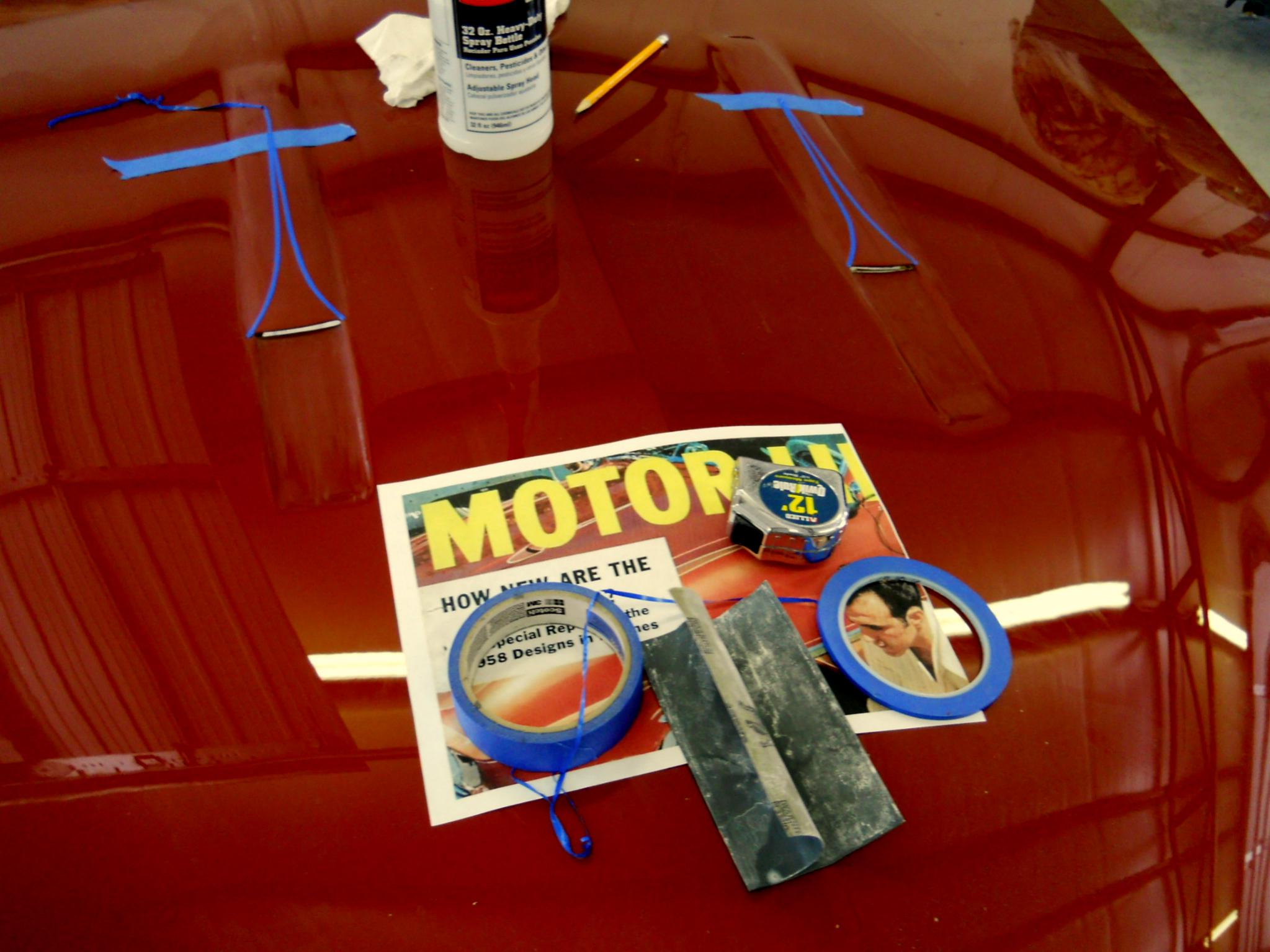

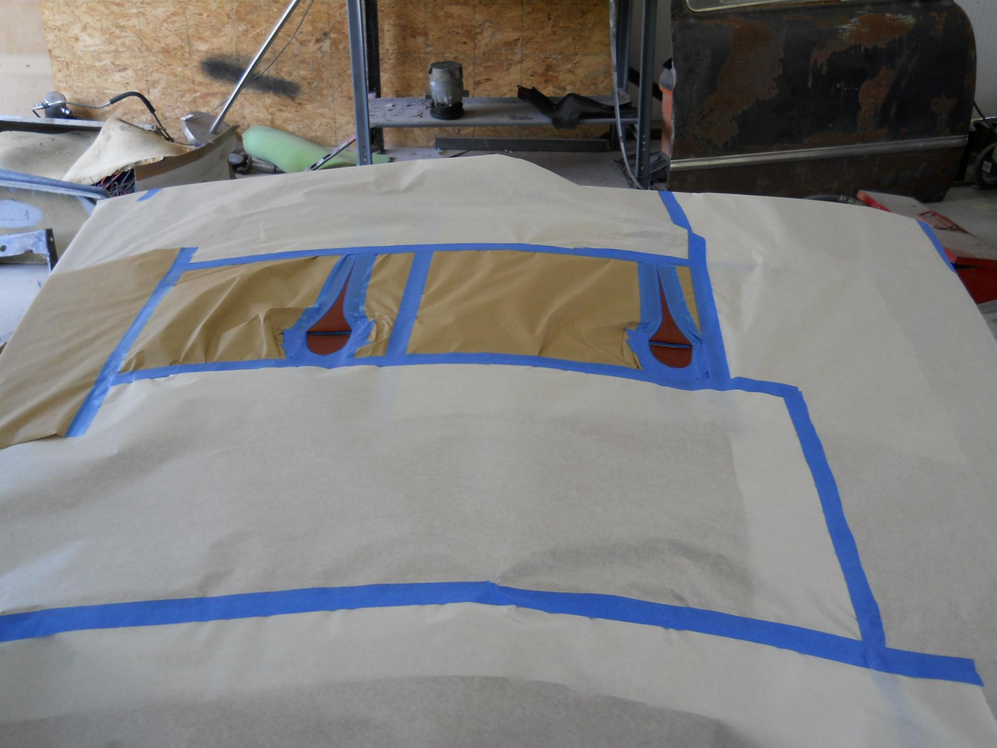

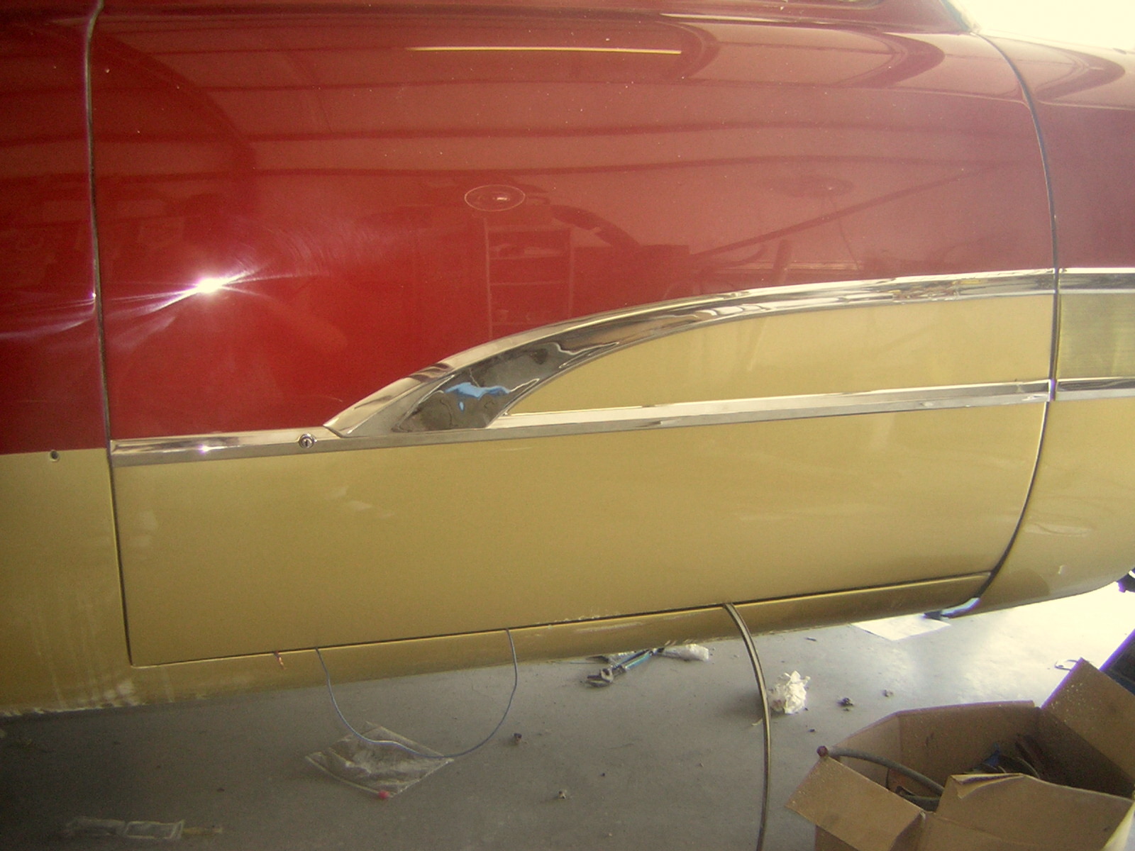

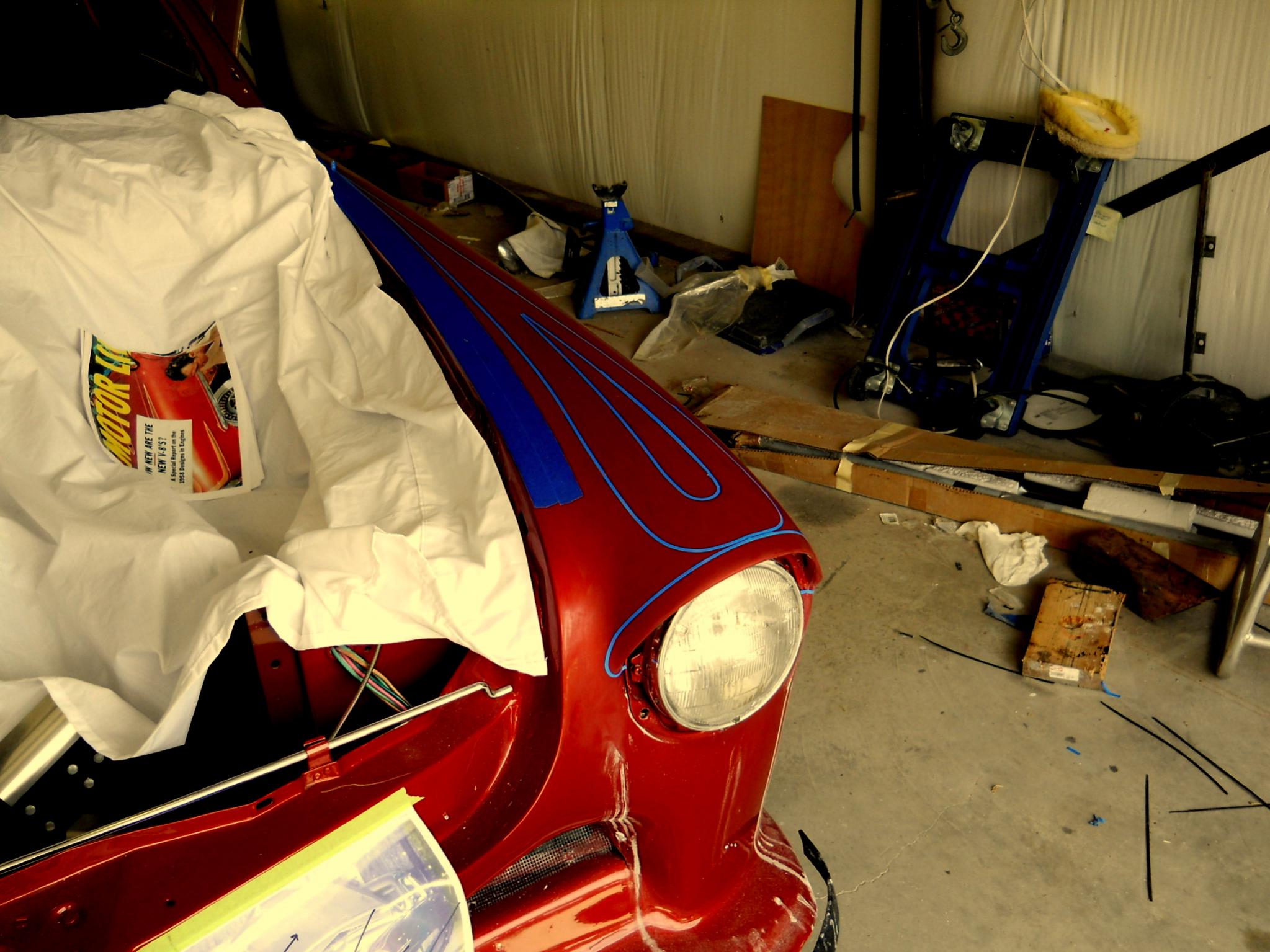

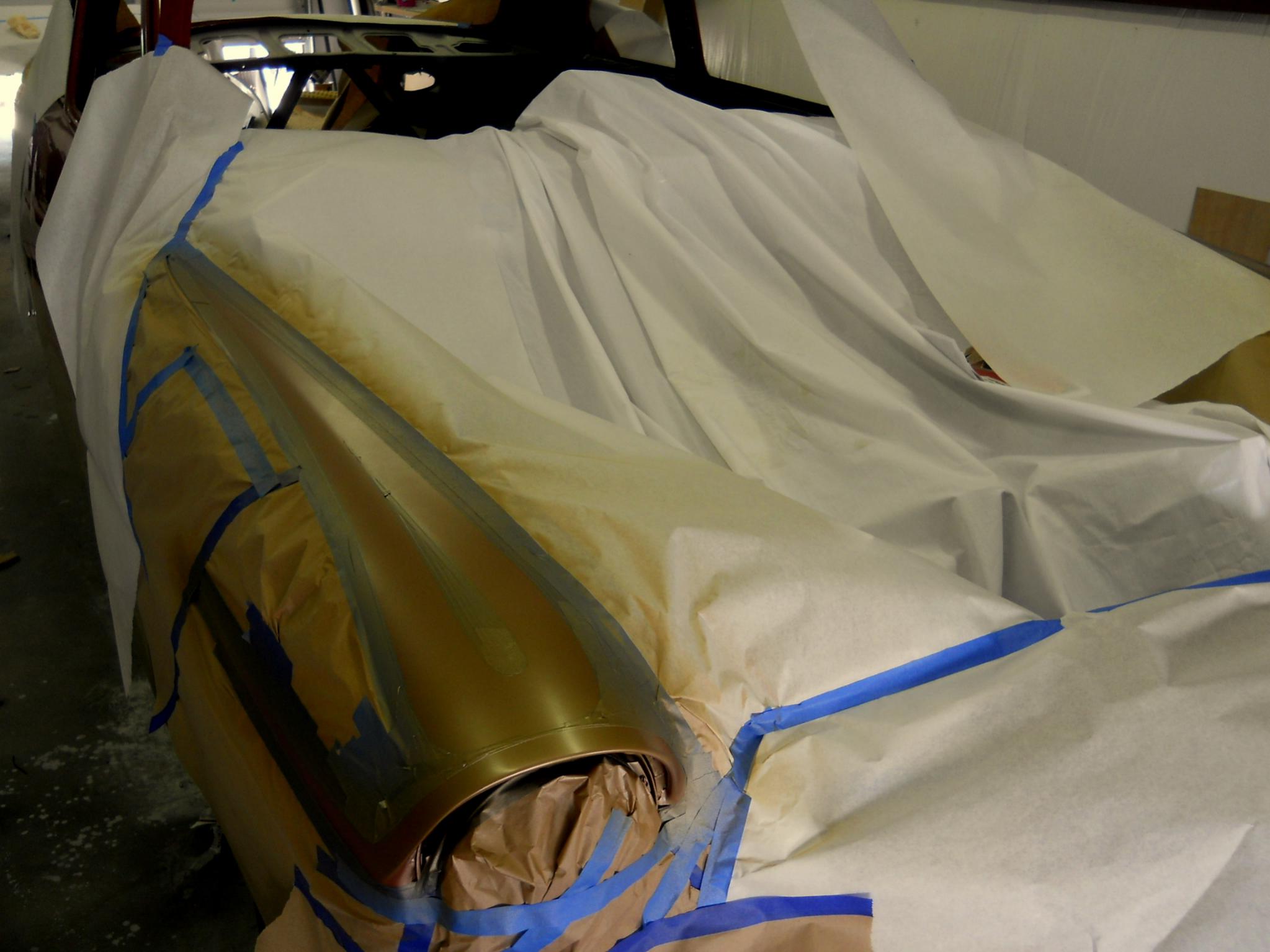

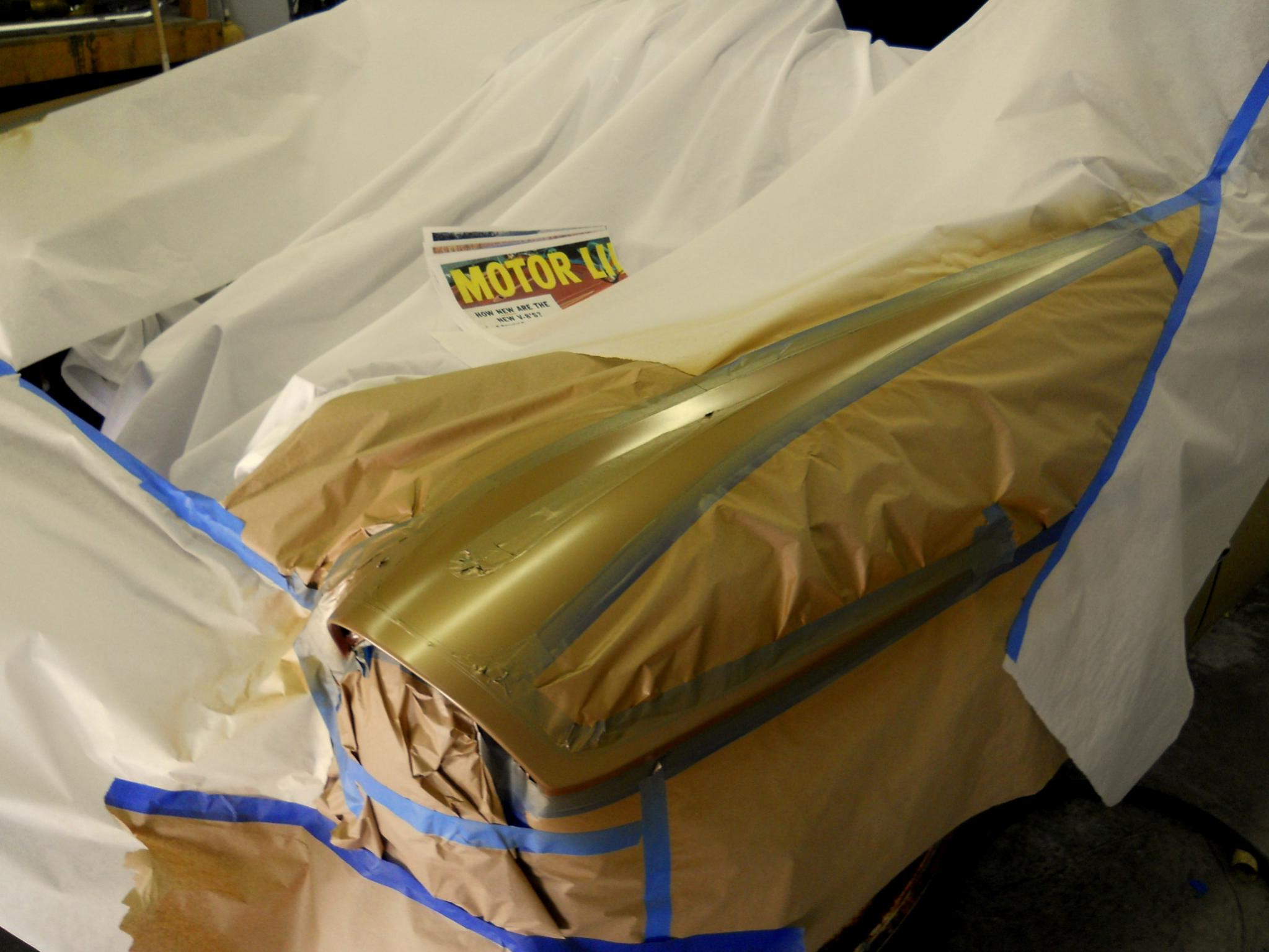

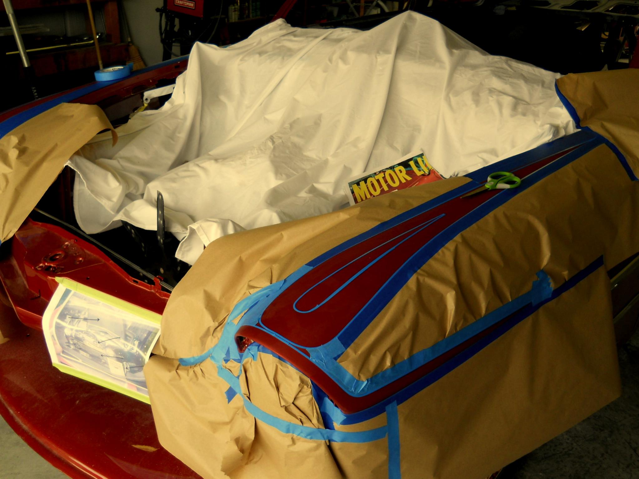

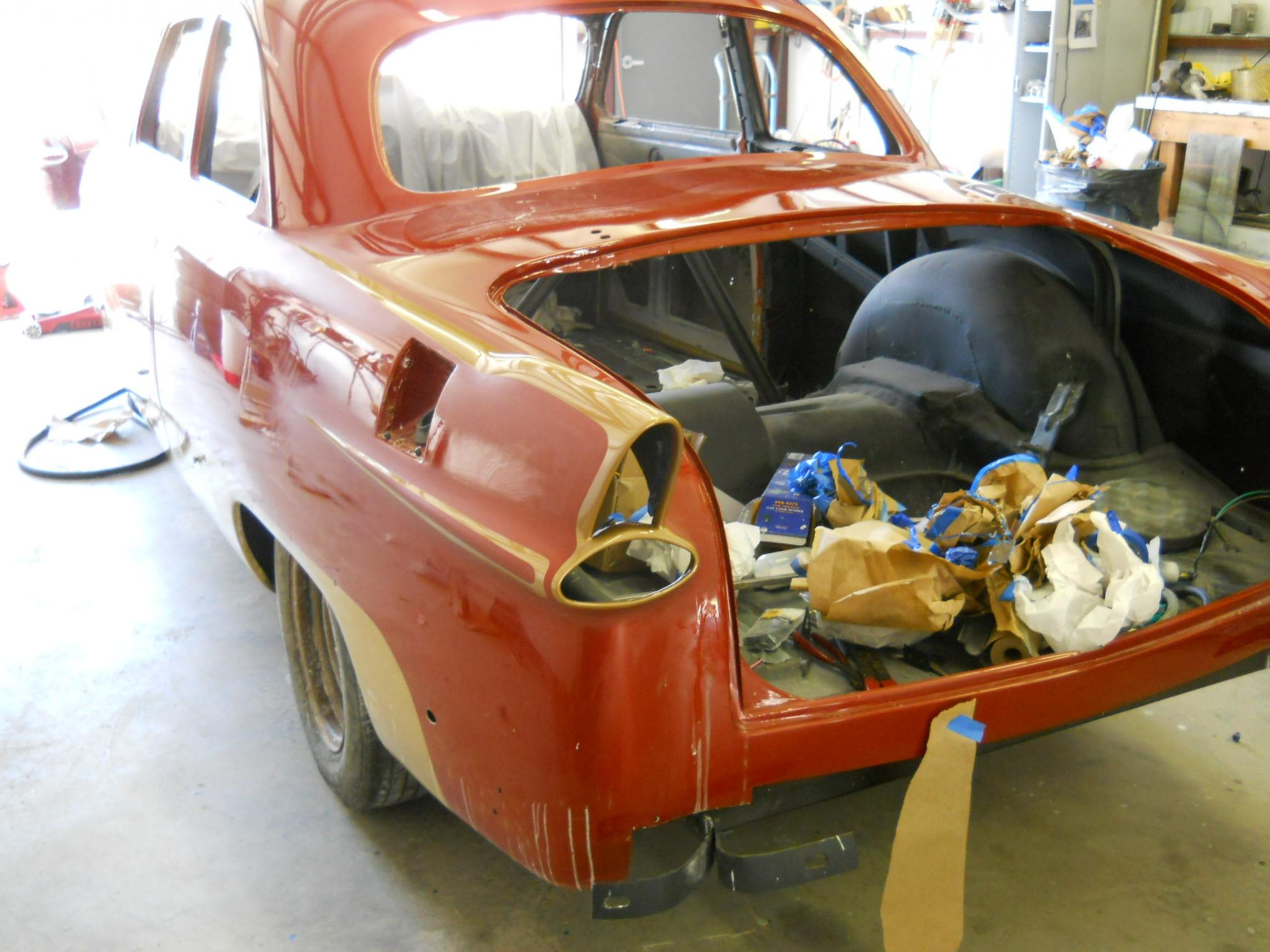

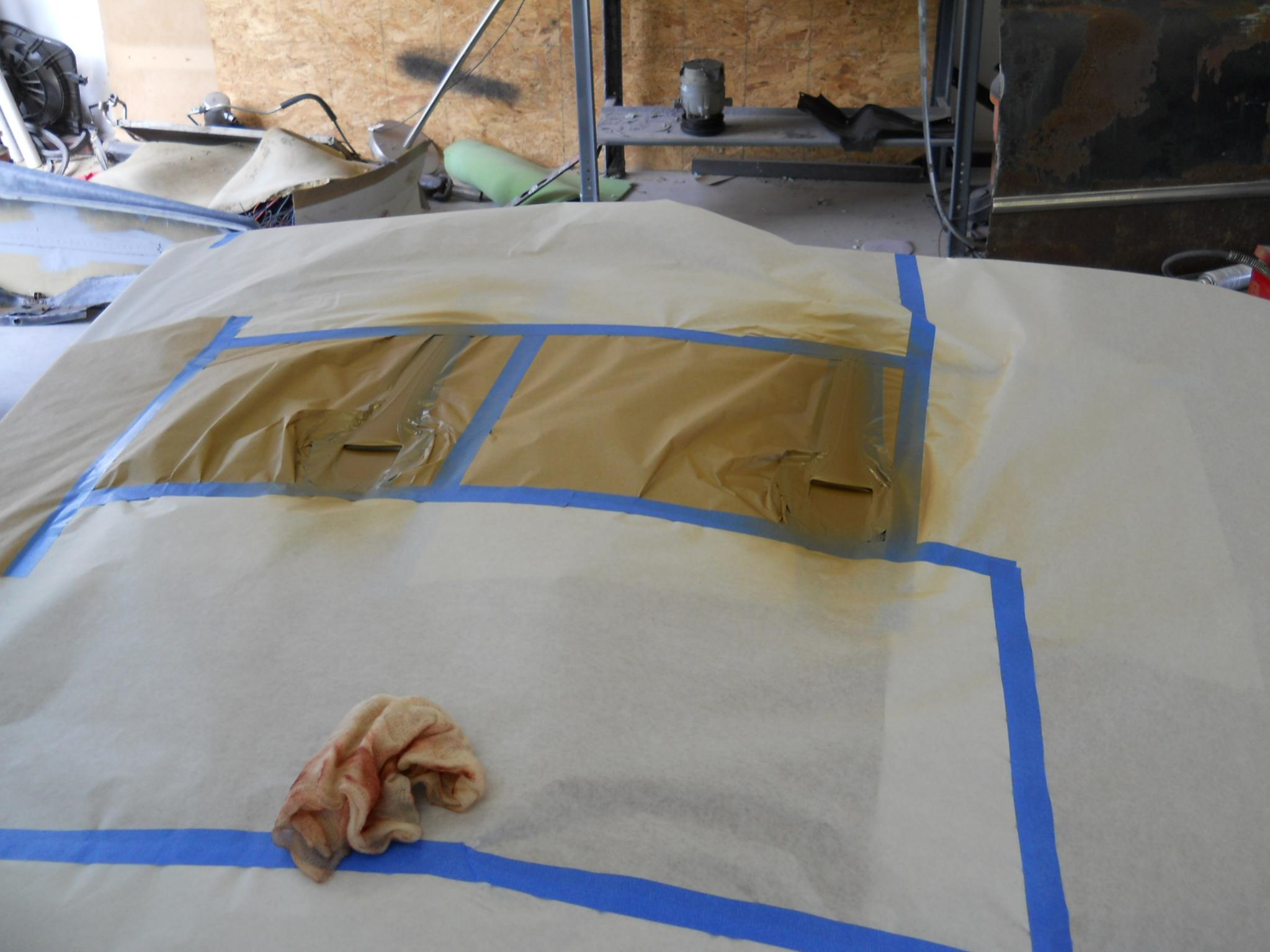

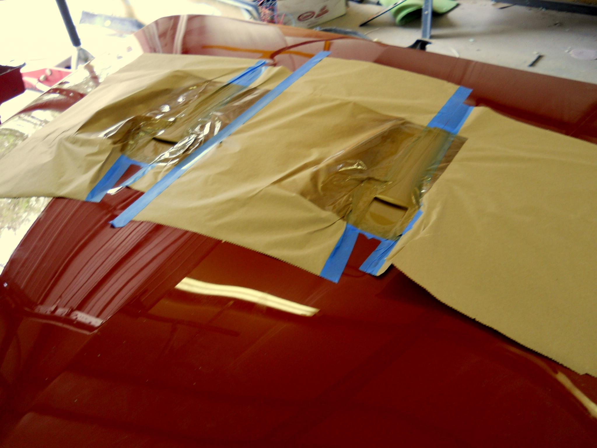

    OK, while wer'e waiting on some of the stainless trim lets do the scallops. They will have to be done before the upholstery because the rear lights will have to be in place before the trunk can be done. We'll start with the hood. Iv'e sanded (1500) around the areas that will get the scallops so that adhesion will not be a problem.
  25. jivin jer
    Joined: Sep 14, 2008
    Posts: 3,495
    jivin jer

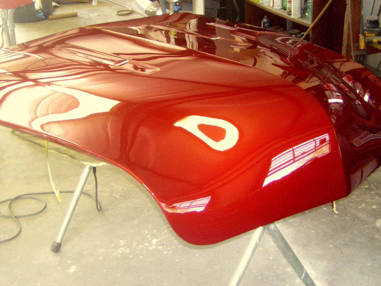

    Base/Clear. This is original color on the lower portion of the car. Jr later added (this car was a constant work in process) the gold/bronze powder to the lower when he did the inner wheel wells (front) and the front suspension. The part that you could see at the front lower area (under the bumper).

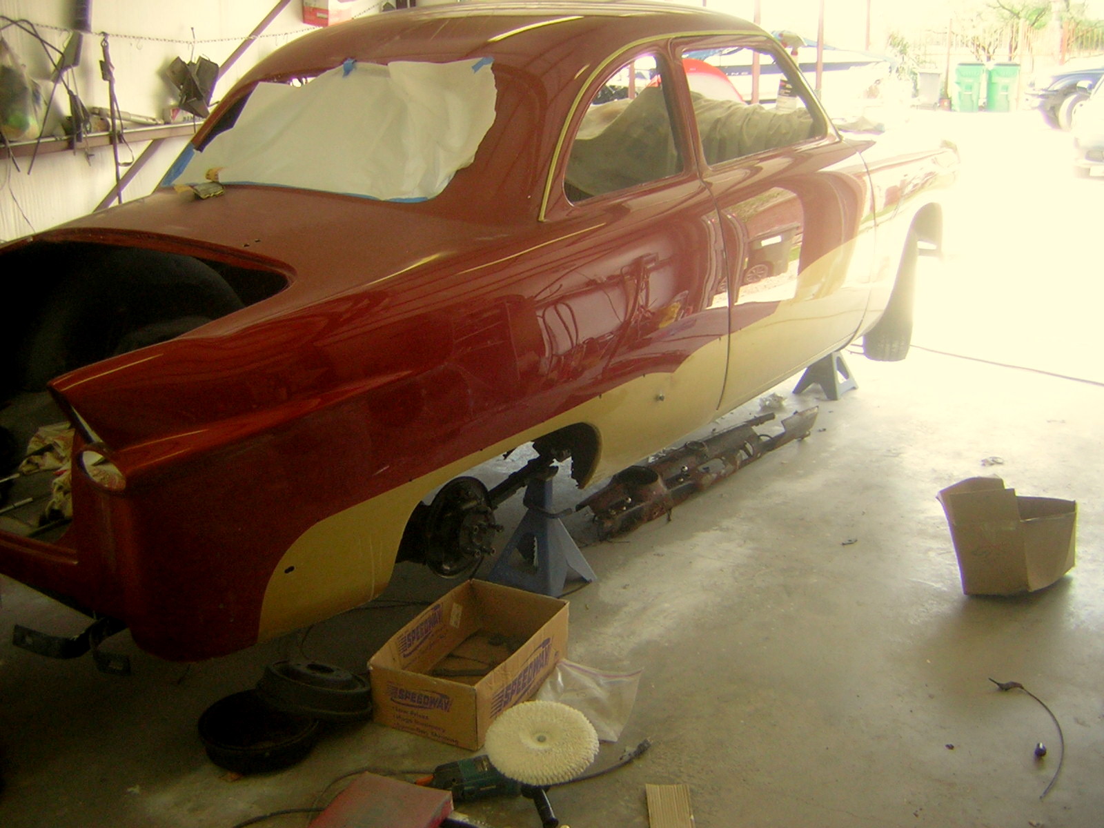

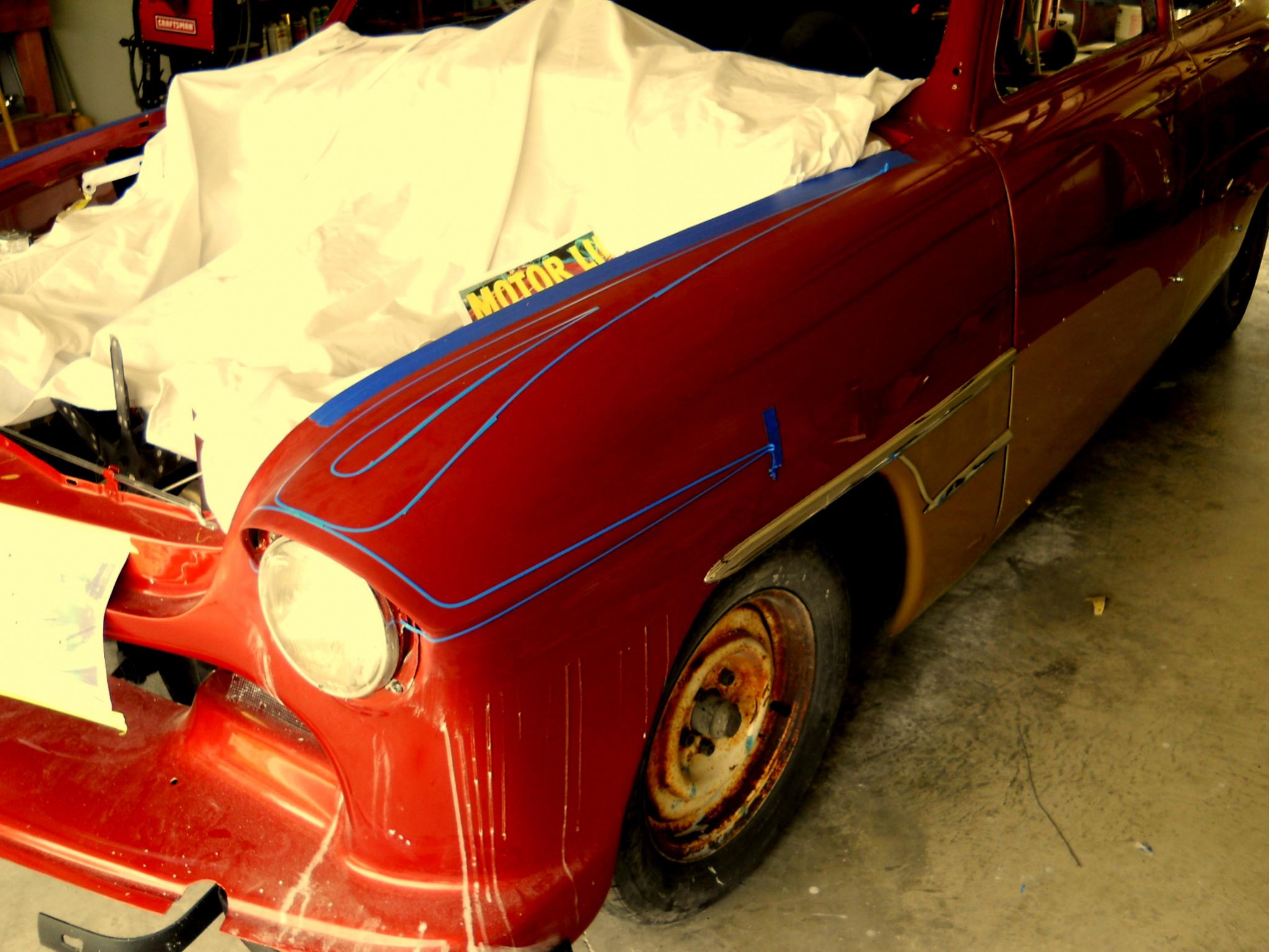

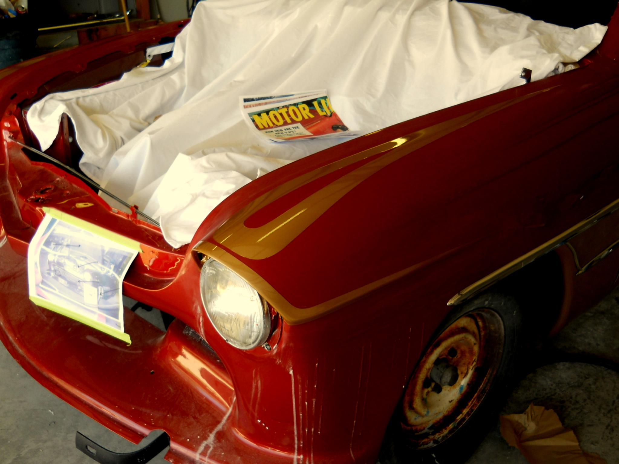

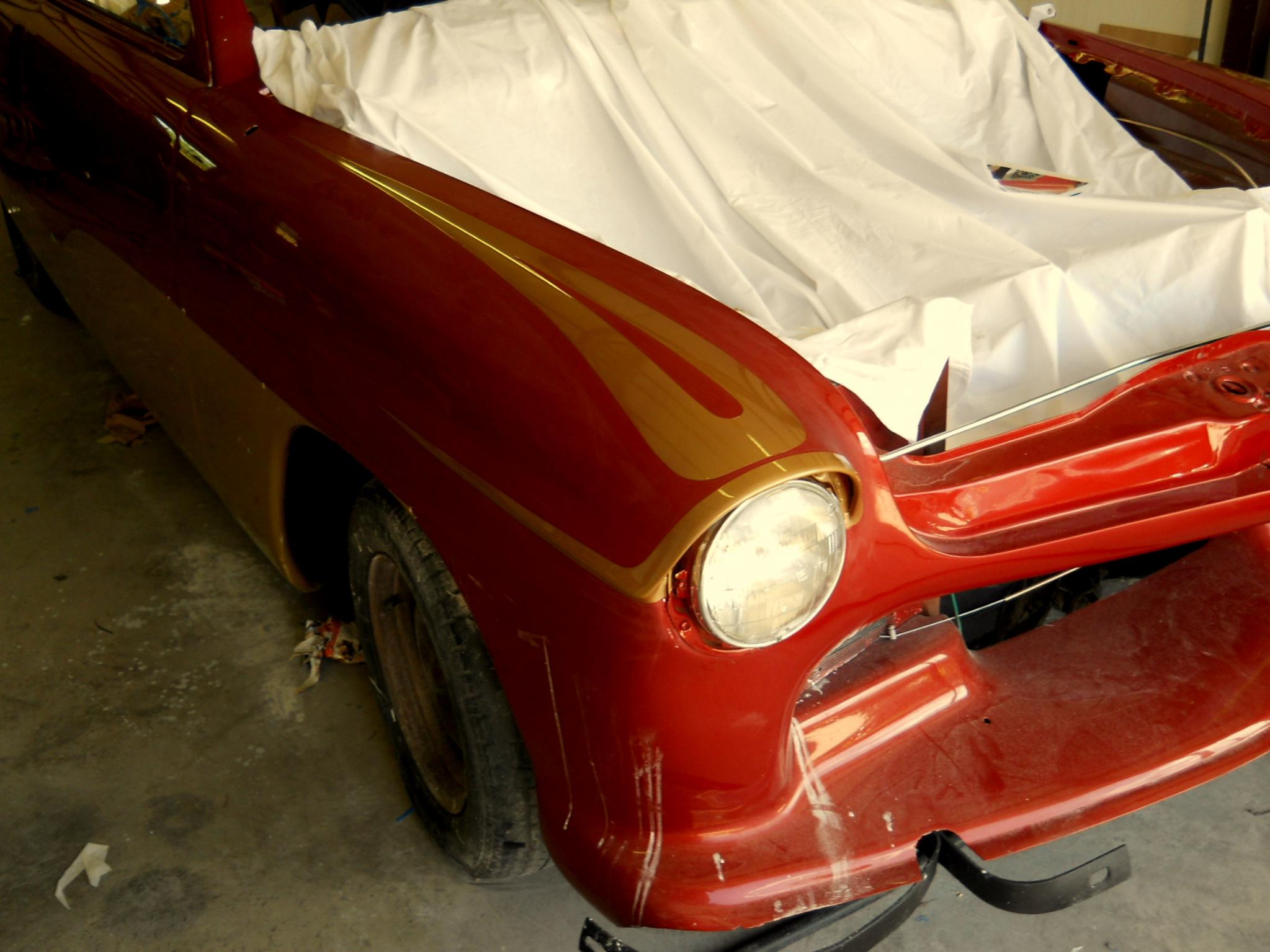

    We move to the front fenders.
  28. jivin jer
    Posts: 3,495

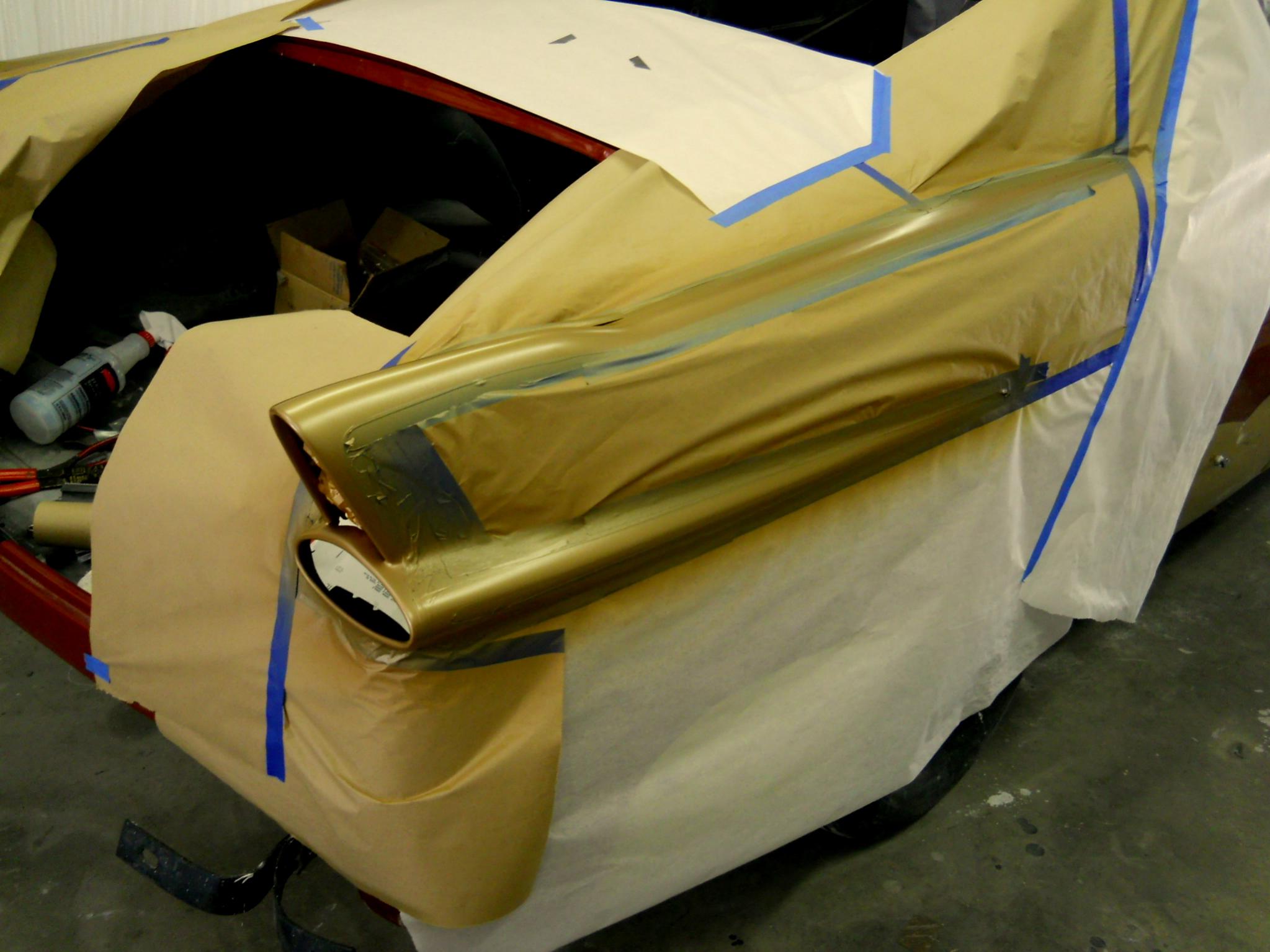

    jivin jer

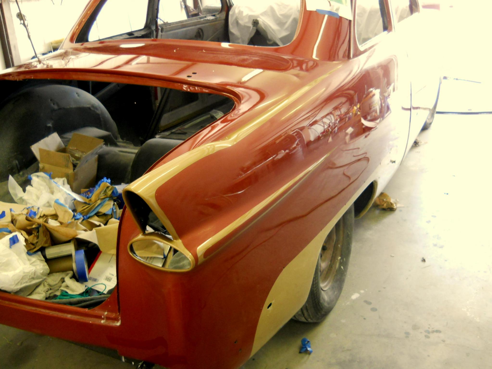

    And we finish up with the rear.
