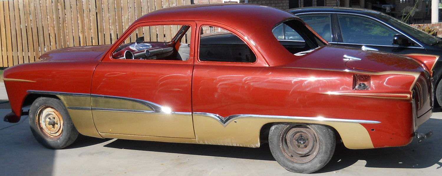

    Hey guys, I need some help id ing these wheels. How do I accurately describe these, to buy the correct ones? Remember this is 1957.
  3. missysdad1
    Joined: Dec 9, 2008
    Posts: 3,307
    missysdad1
    They look like early OEM Ford wheels which have been split apart, chromed, reversed and re***embled. The bevel on the shell identifies them as pre-disc brake style wheels.
    The windows look like the Ford shape and the caps are definately Ford.
    Try wheelkid here on the HAMB. (Rally America - An Alliance vendor) I understand they can custom-build chrome reverse wheels to your exact specs. Not much chance you'll find visually identical wheels any other way.
    You'll probably have to supply the centers and shells, unless they've got some in their inventory. I've got a couple kicking around here if you need them for parts or whatever.

    I think rikster has the hubcap nailed - stock with bullet, not Merc.
    Here are the wheels I have. I'm virtually certain they are the ones you need from which to have authentic chrome reversed wheels made.
    Center is the right shape and will take stock '49/'50 hubcap, which is available reproduction.
    Shell is beveled like in the photo, center is rivited into place. Easy to reverse.
    I've got several behind the shop in the bushes. Come an get 'em.
    I've got at least five of these, and you're welcome to them for your project.

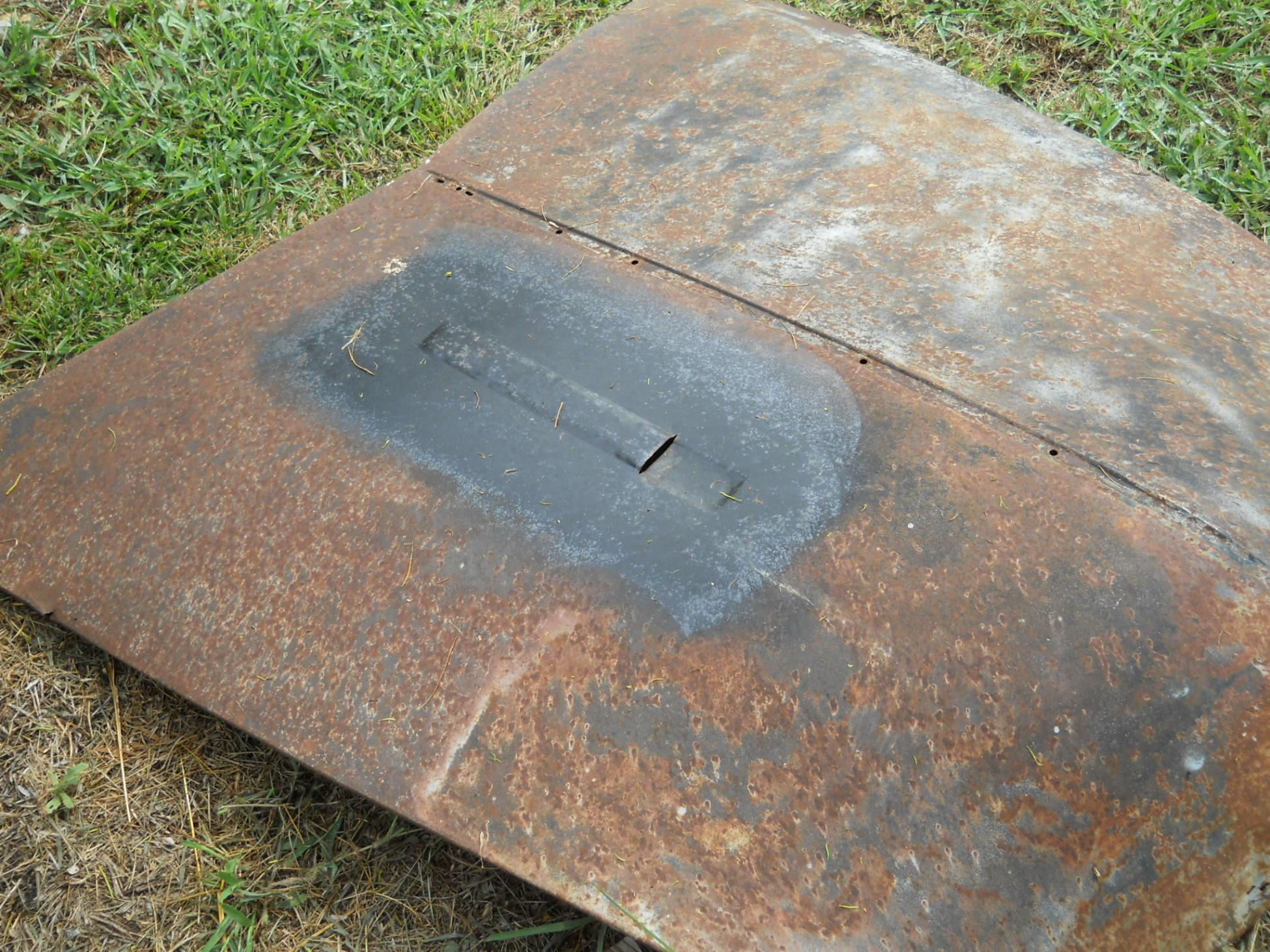

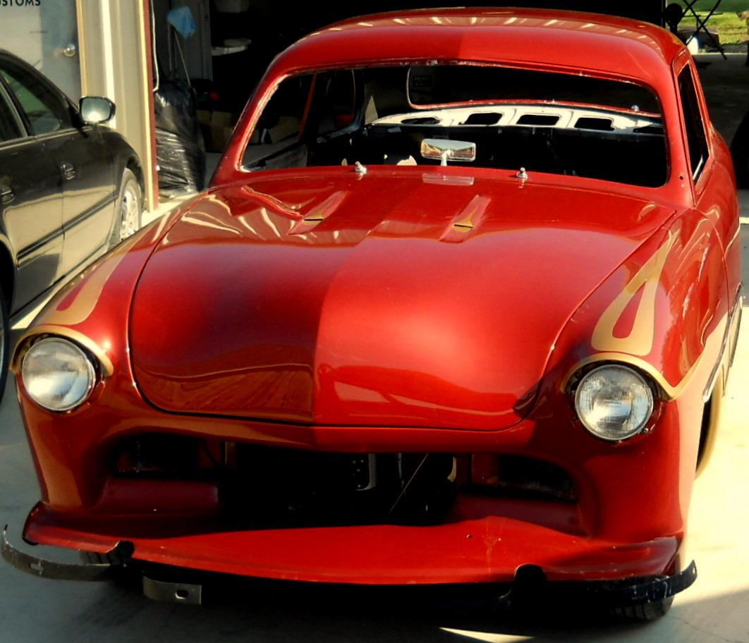

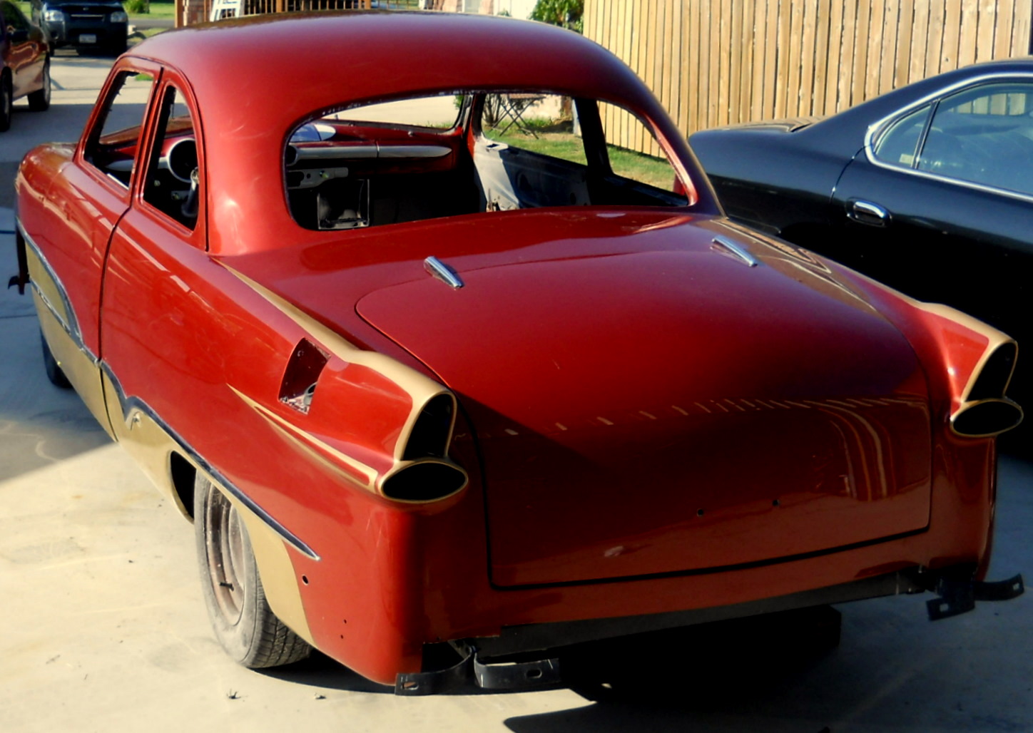

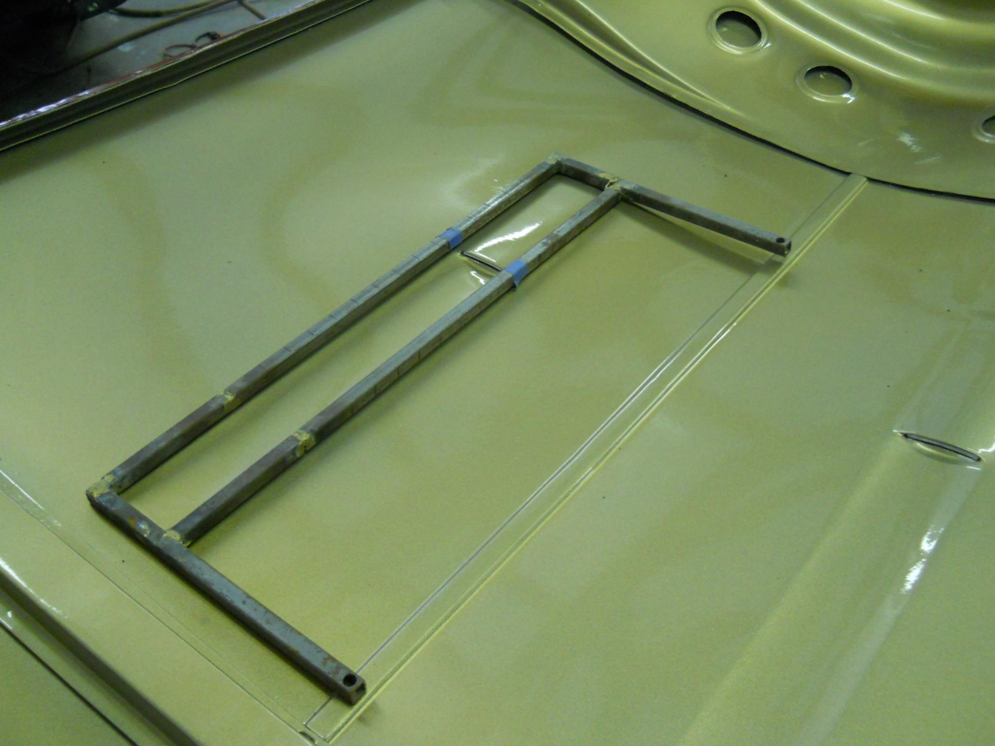

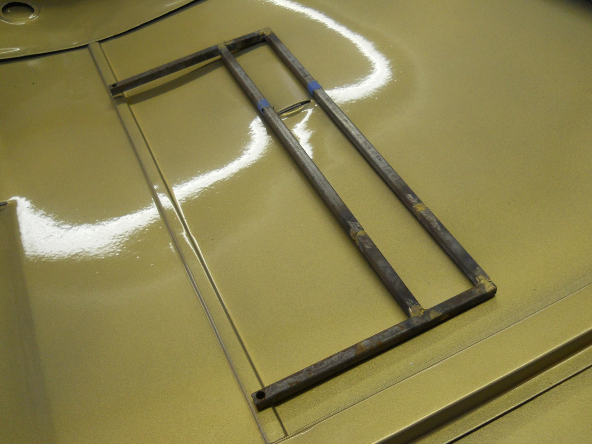

    Well, after seeing the Car Craft (Mar.58) article on the hood scoops I thought it might be instructive to show how I did the ones on this car. This would be in the spirit of the HAMB, everybody chairs man (Cheech & Chong). This is the part of this build that I was totally intimidated by. I had a spare hood located just in case I ruined this one.
    I hadn't done any body work since '88 because my expanding business required me to be up front in the office. It was a heart breaker because I love to work with my hands. And the realization that this had gone from a body shop to a business didn't sit too well. I would come to work early so that I could get a couple of hours in before the phones started to ring. So, I was comfortable around all the tools. Hammer, dolly, oxy/acet welder etc.. But I was definitely sweatin doin these scoops out in the vast expanse of metal on this hood.
    So I thought and thought about this, and I put together a technique I'll call HOOD SCOOPS FOR DUMMIES. It worked amazingly well. The dragon that had me shakin in my boots was left powerless in a quivering m*** on the shop floor.
    I made a frame that outlined the scoops out of ½ square tubing. It had holes in the ends that let me position it in the exact same place on both sides of the hood (inner and outer). I shaved down a hard rubber hammer that fit inside the troughs that outlined the scoops. I located the front part (the opening) and cut a slot with my die grinder. The next part was gently stretching inside the troughs up or down with the rubber hammer. This was helped along with the body hammer (sparingly). I made sure that everything was done on a solid foundation by having a sand filled leather bag underneath everything that was worked. After you have the scoops looking like you want them remove, the frame and shape the dome (upper) and the trough (lower) with the hammer and dolly. In this case you want the back to fade away towards the back of the hood. This technique gives you the straight, crisp out lines and keeps the tendency to warp under control.

    I need to add that I welded welding rod to the upper leading edge of the scoop. I left the bottom as it was, as per Jr's instructions. It was finished with a scim coat of filler. This took the better part of a day to do. My practice sessions made me completely comfortable about what to do and not do.
    So Iv'e removed the mystery and excuses about this and what that means for you is to get some s**** panels and get goin' NOW!

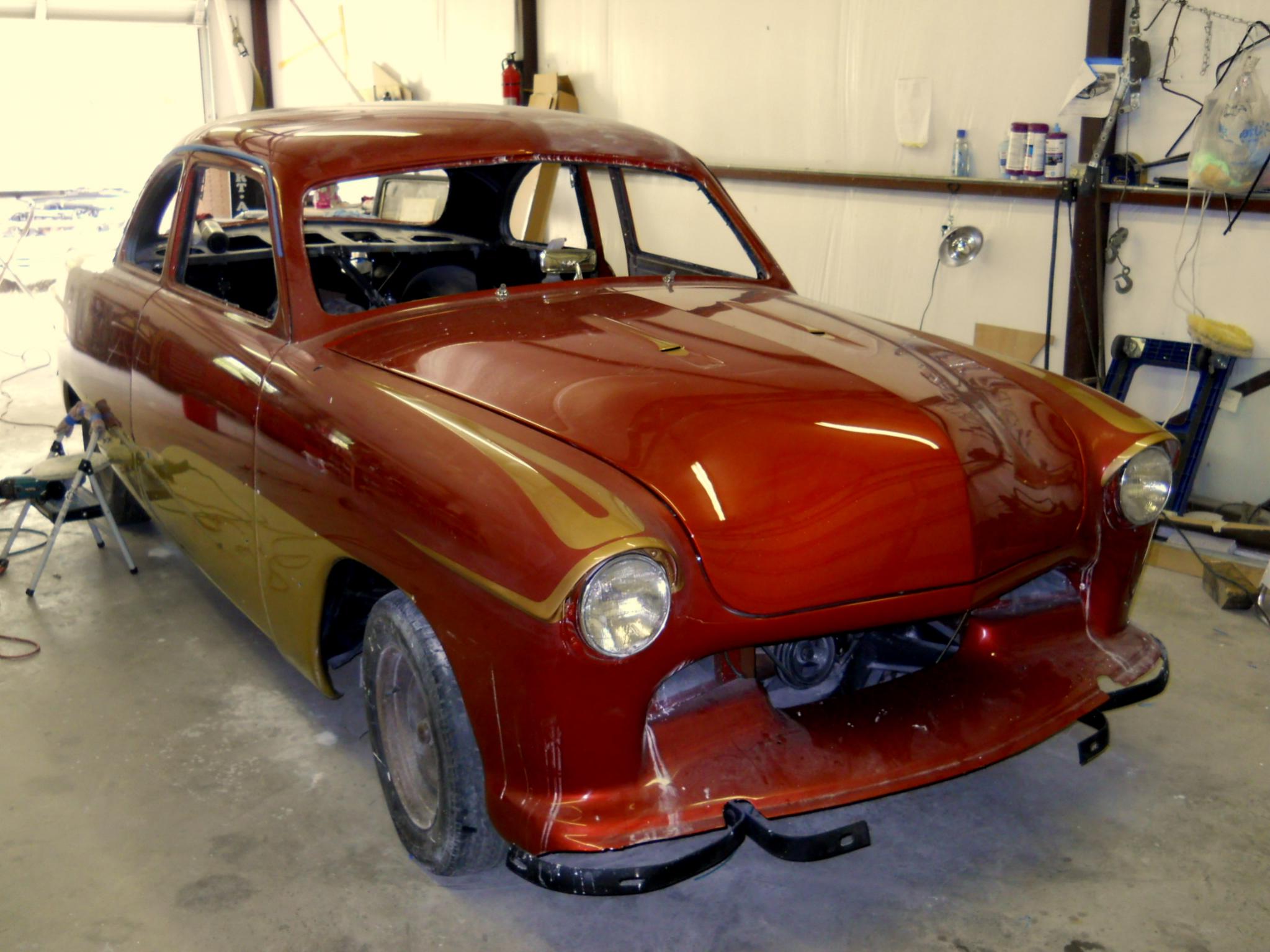

    The hood and trunk lid should be on for the last time.

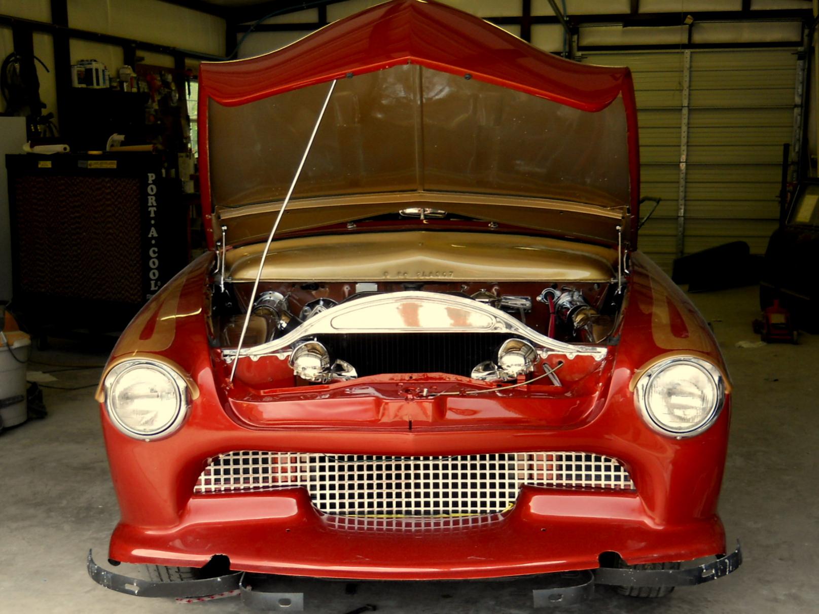

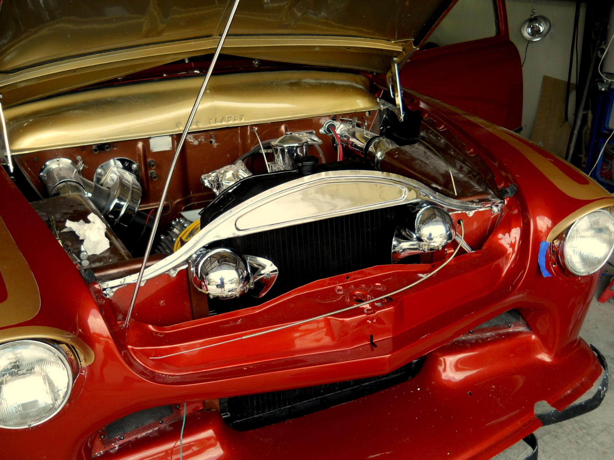

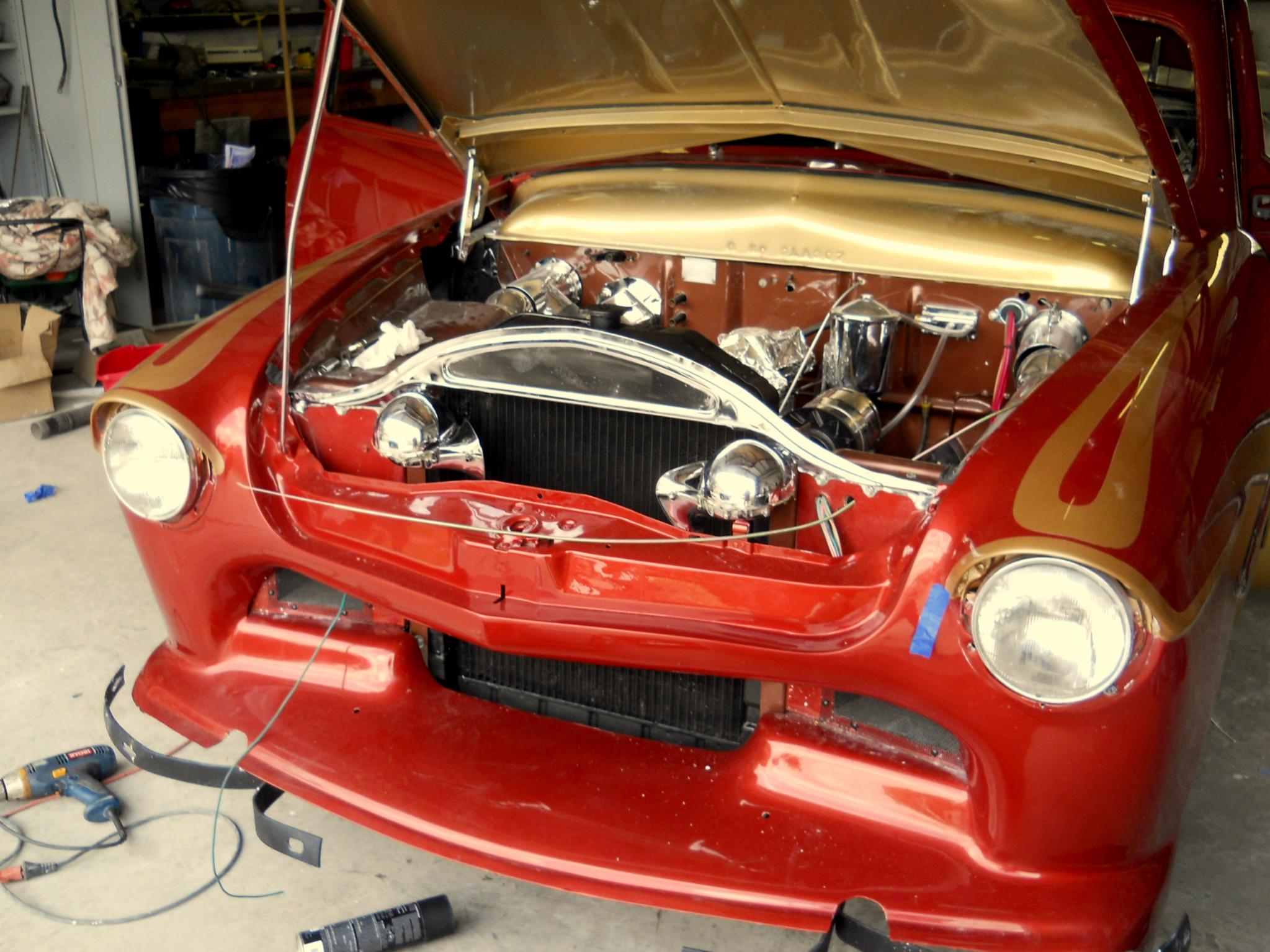

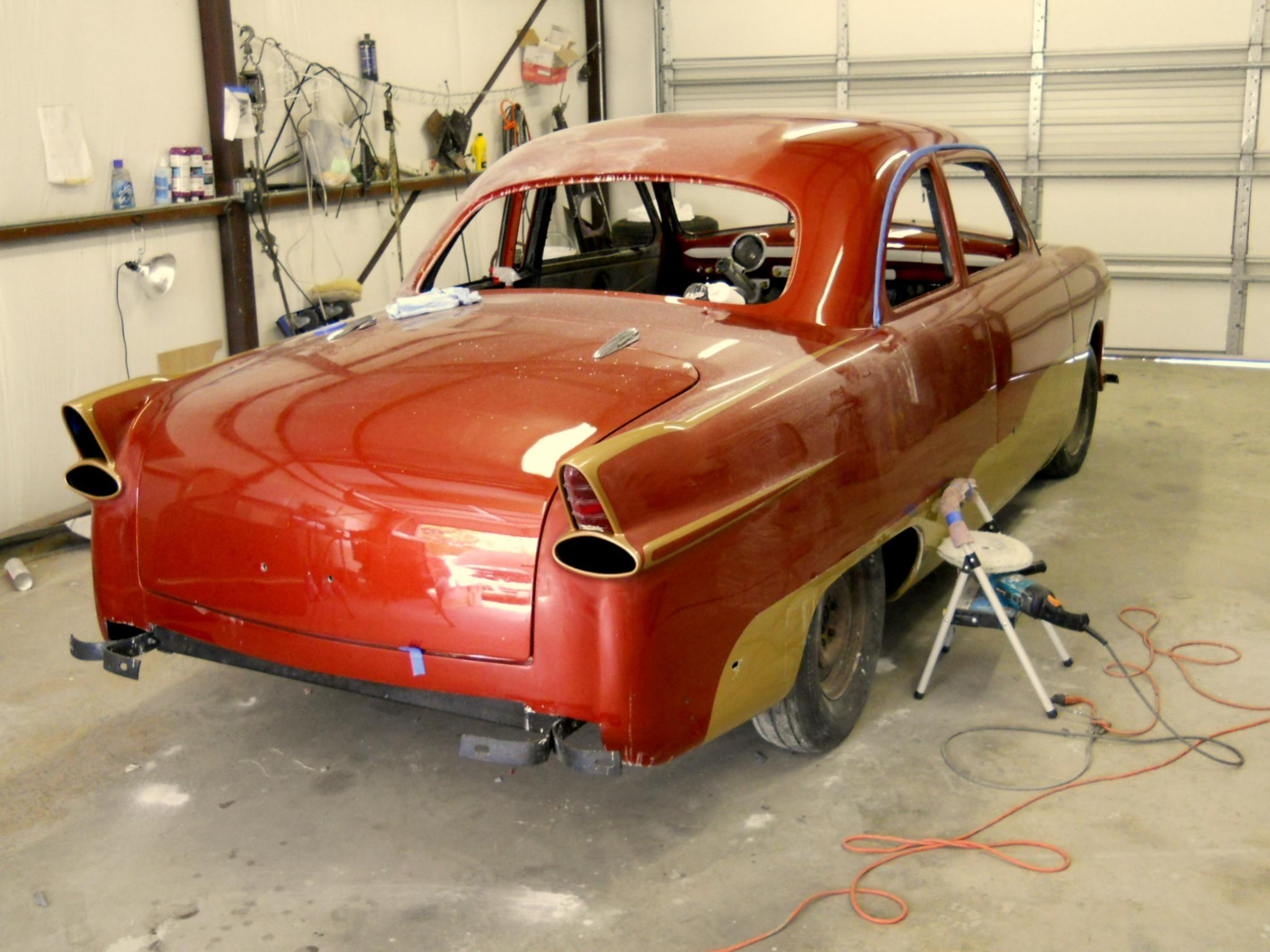

    She's comin' along. The brakes need to be bled. The doors and trunk poppers need to be hooked up (ele.). It could then go to the upholstery shop. I'm going to call on the chrome to see if its done. I'm tempted to wait if its close to being done. The hood needs to be adjusted.

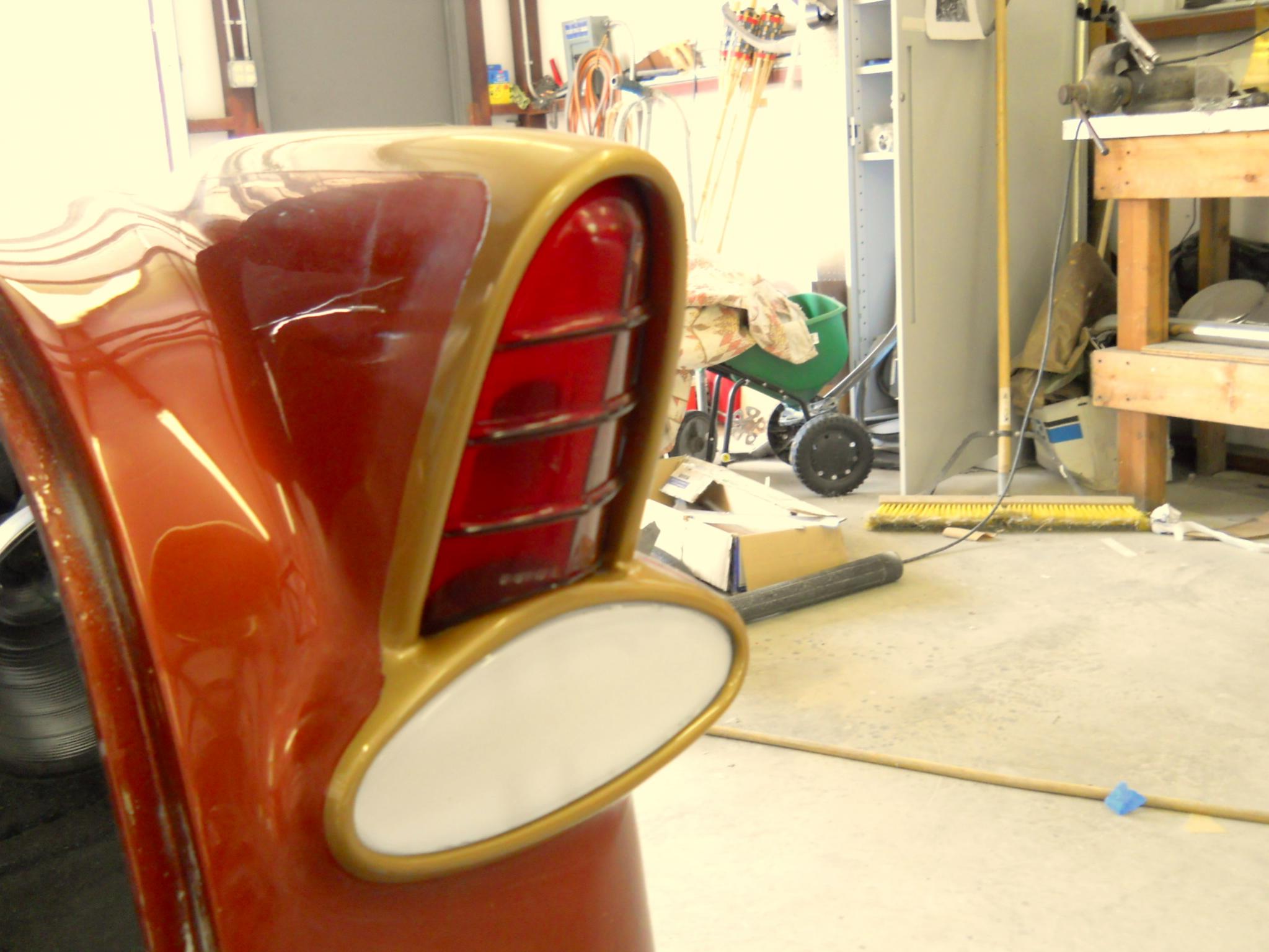

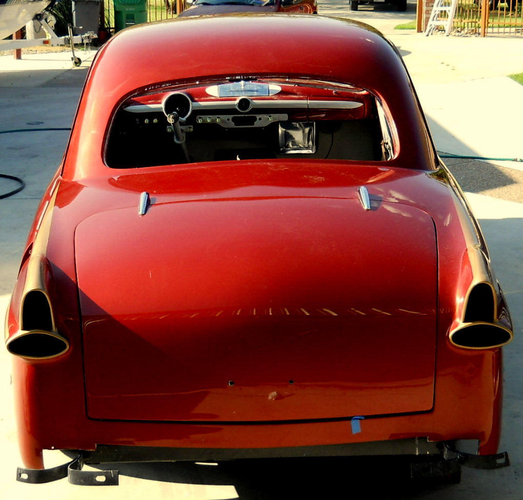

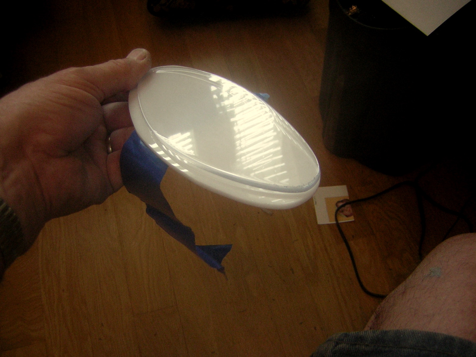

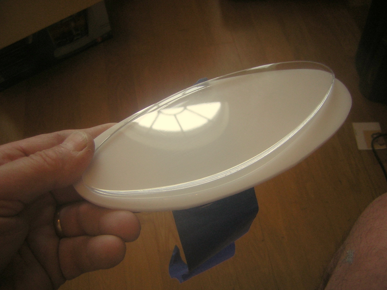

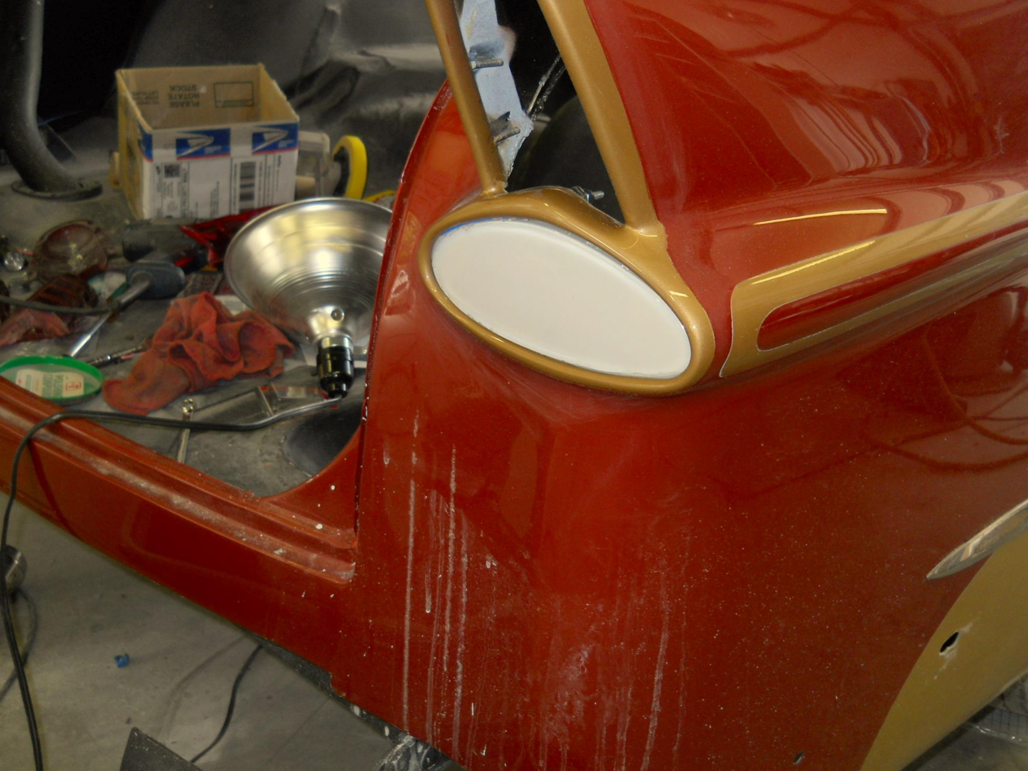

    The fake back up lights were white lexan with beveled clear lenses. We will get them ready to install along with the '55 buick t/l lenses.
  19. jivin jer
    Joined: Sep 14, 2008
    Posts: 3,494
    jivin jer

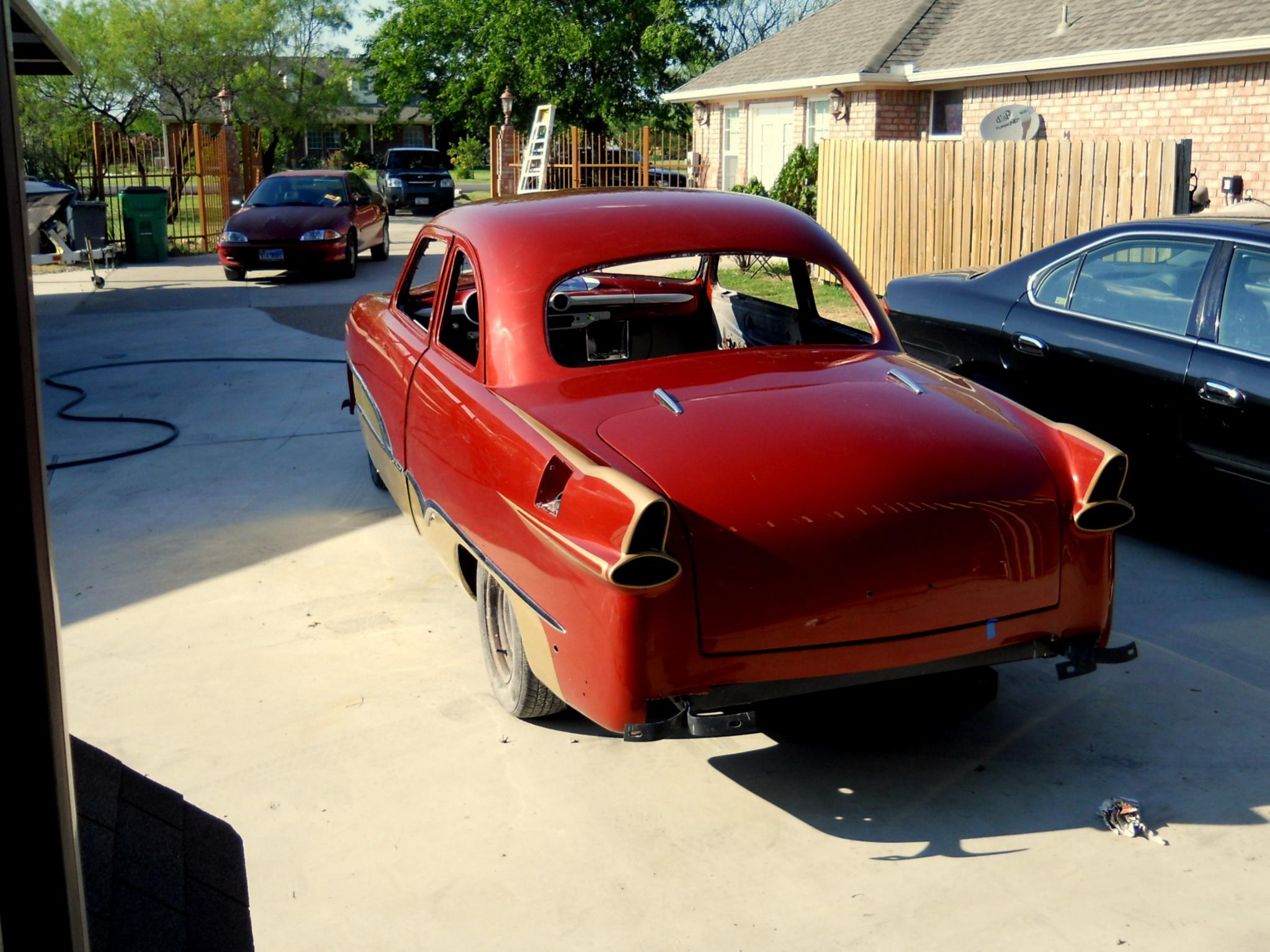

    Bit by bit.

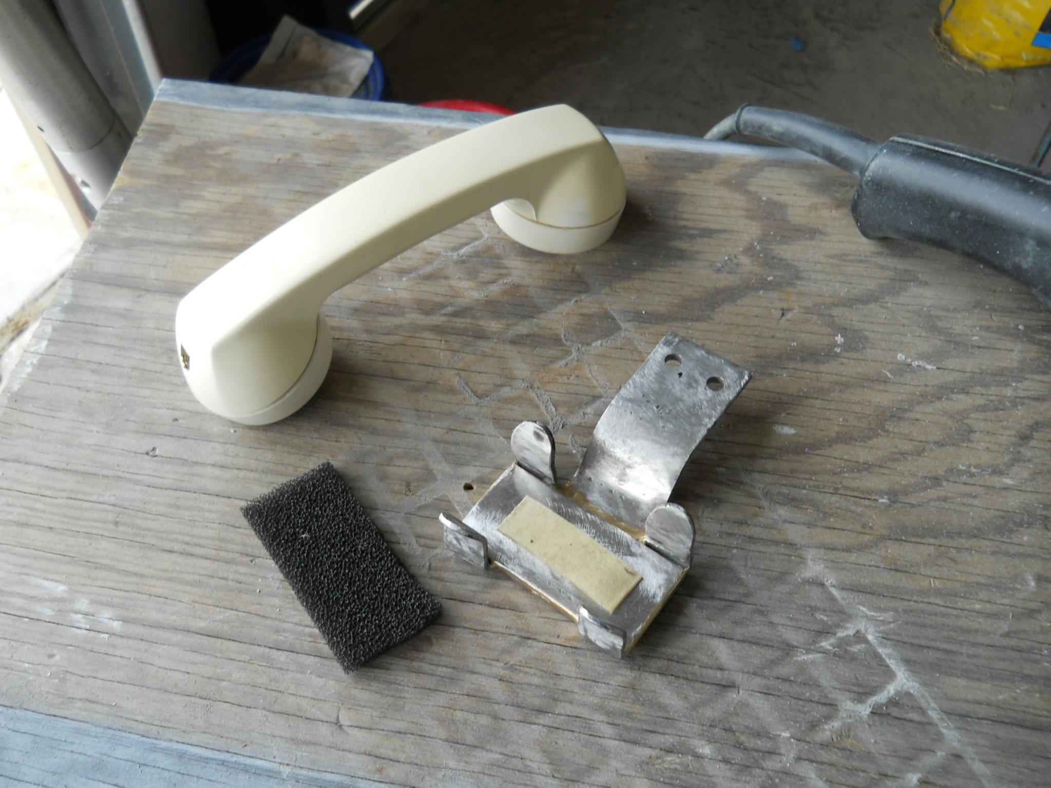

    I bought a wall phone and thought that it had a bracket that could be used. I asked Jr to make one for me when he told me that this one was incorrect. He said that without a car he couldn't do it. However he did say that **** Jackson is doing a 49 and he would be a better resource for this. I asked **** and he said sure. **** said that he was the first person to put a dummy phone in a car back in the day. Jr sent both of us the pic of the dash that shows the phone mounted (post #355). I just got this bracket in the mail. It mounts right in front of the radio. Thanks ****!

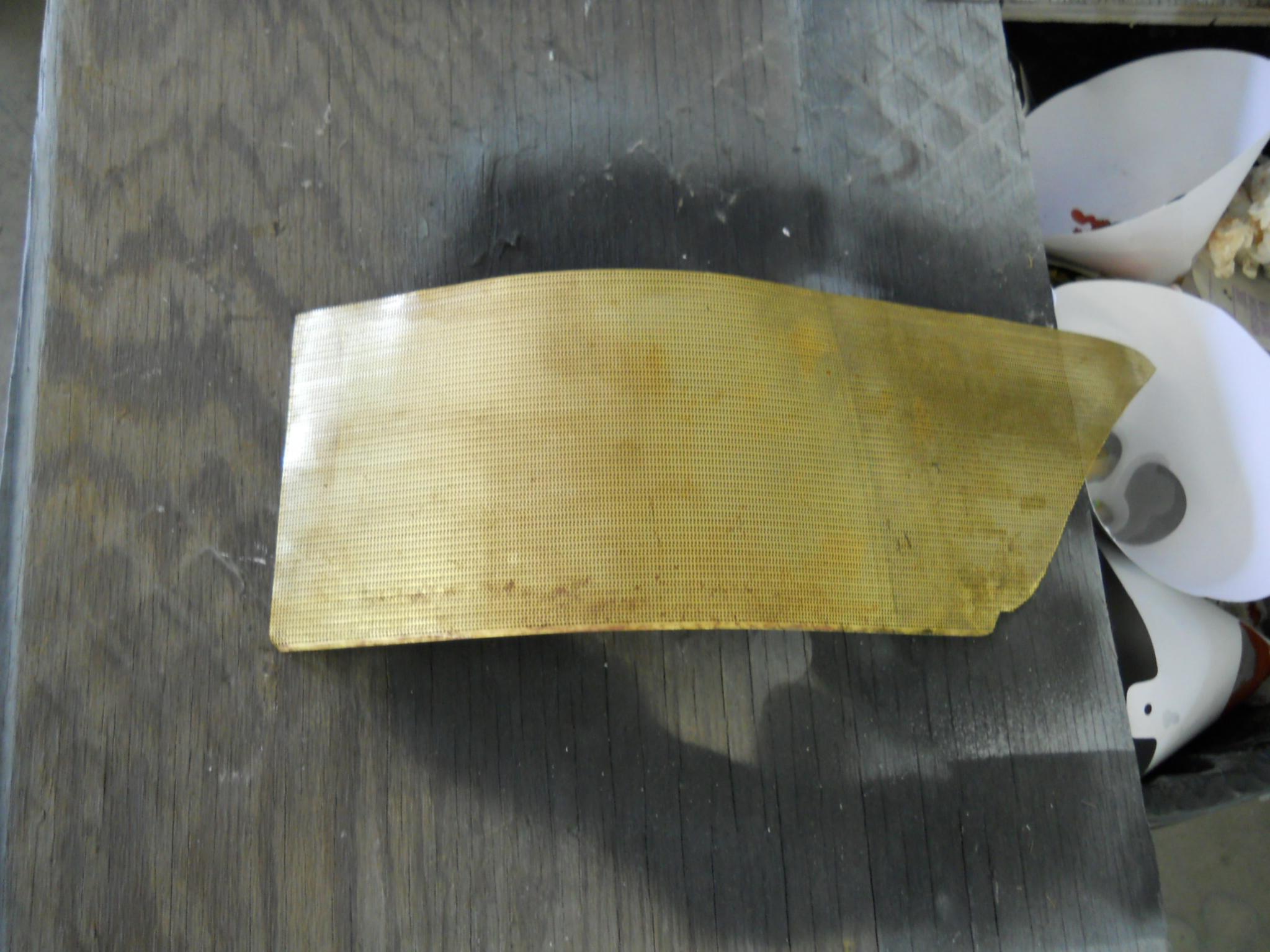

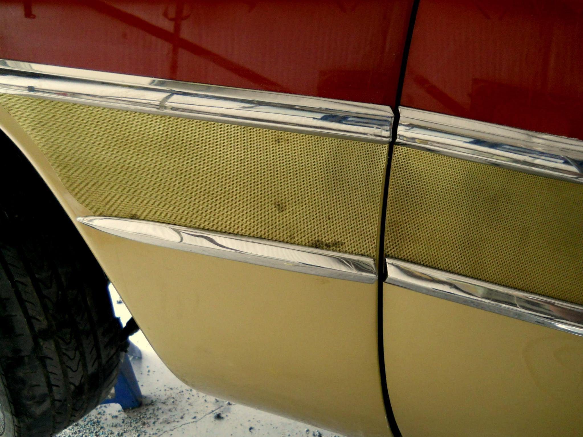

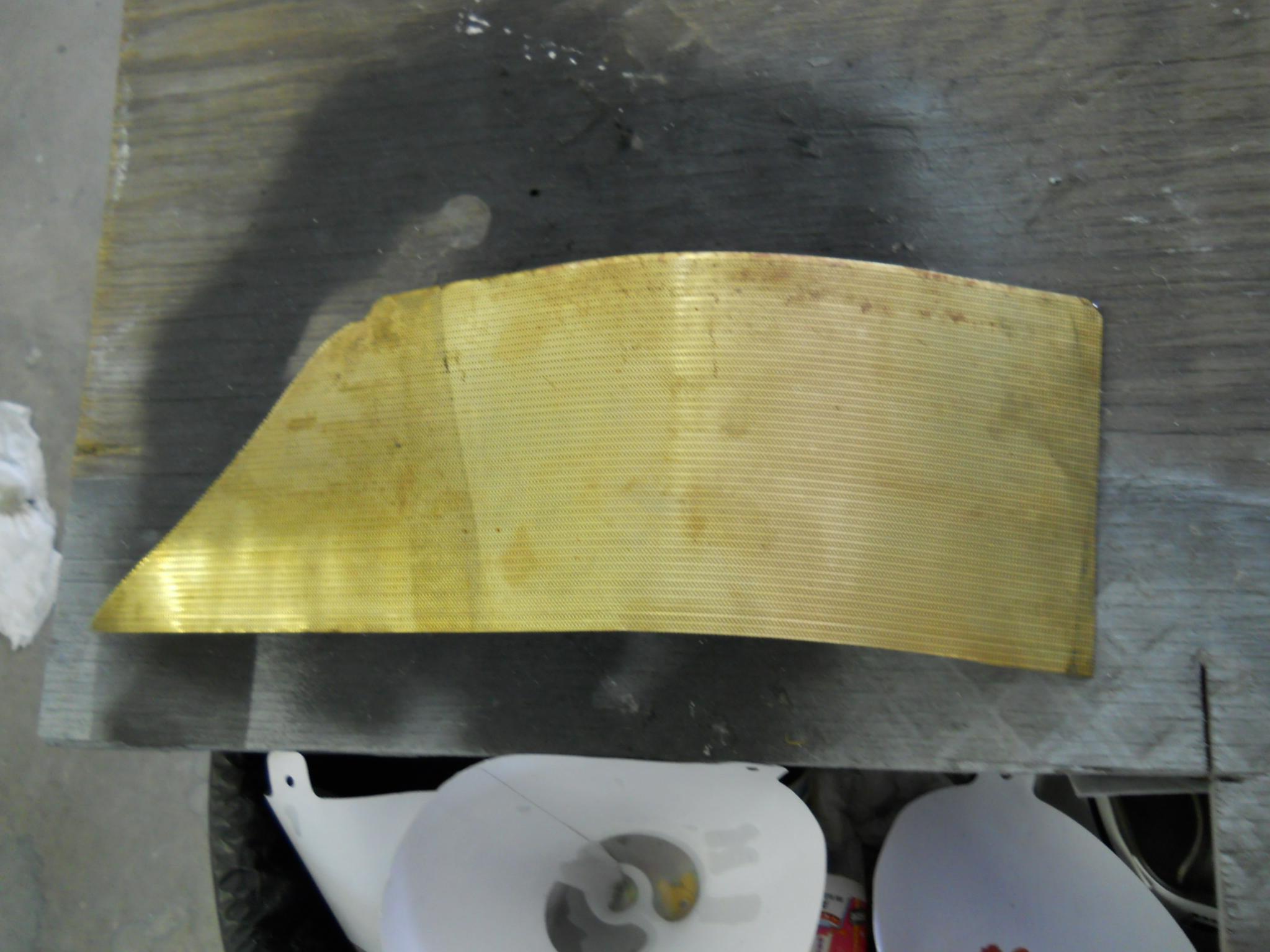

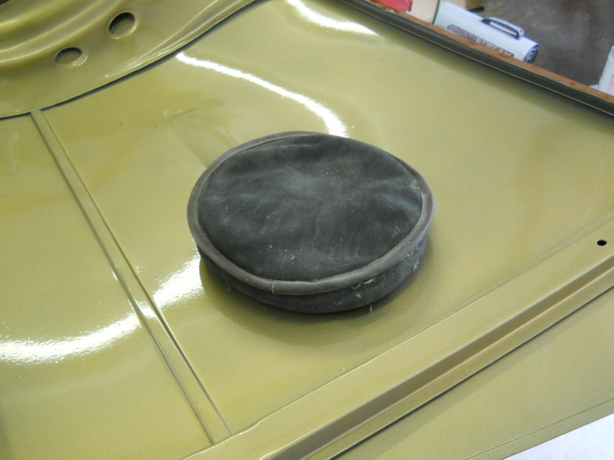

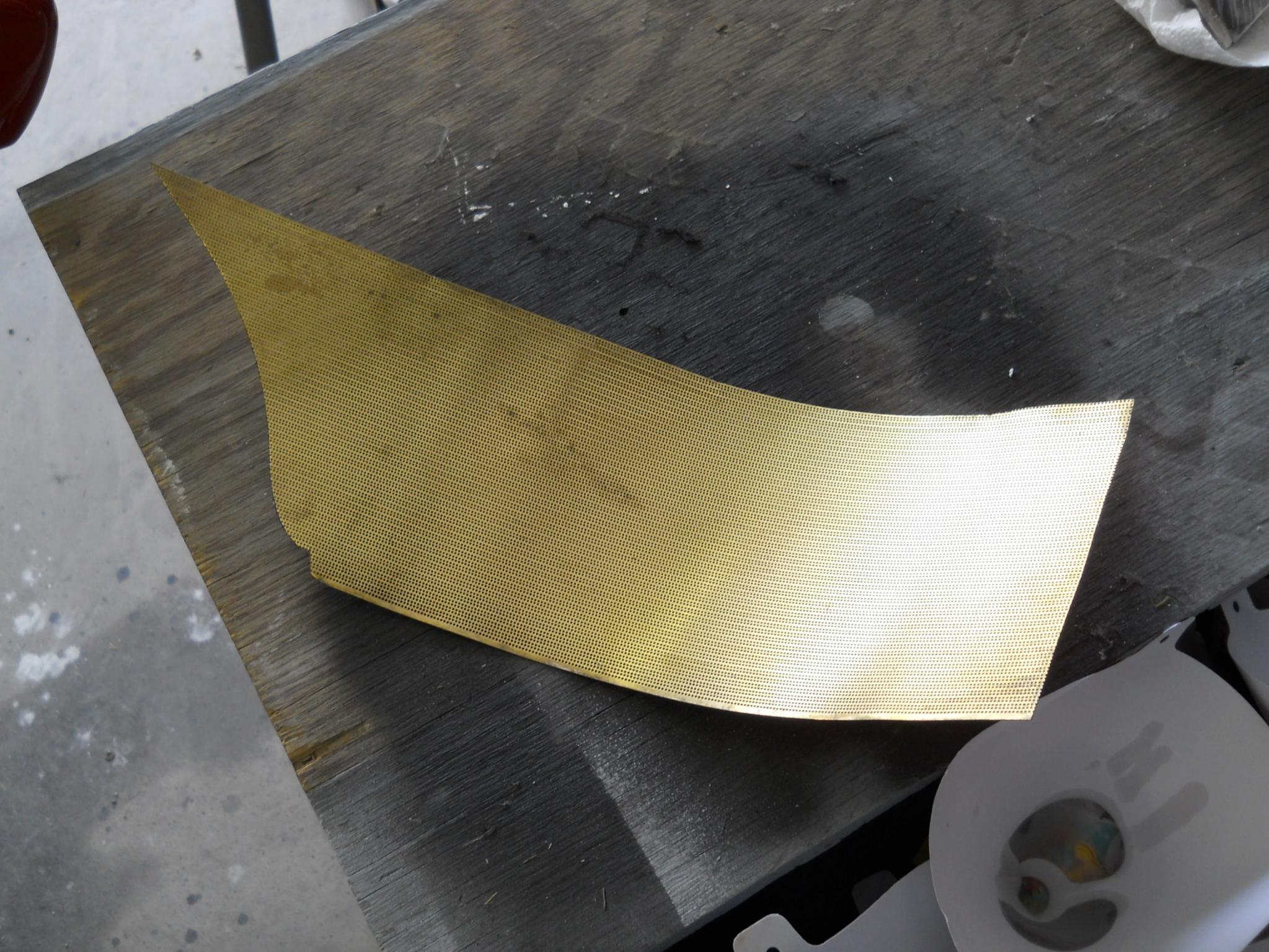

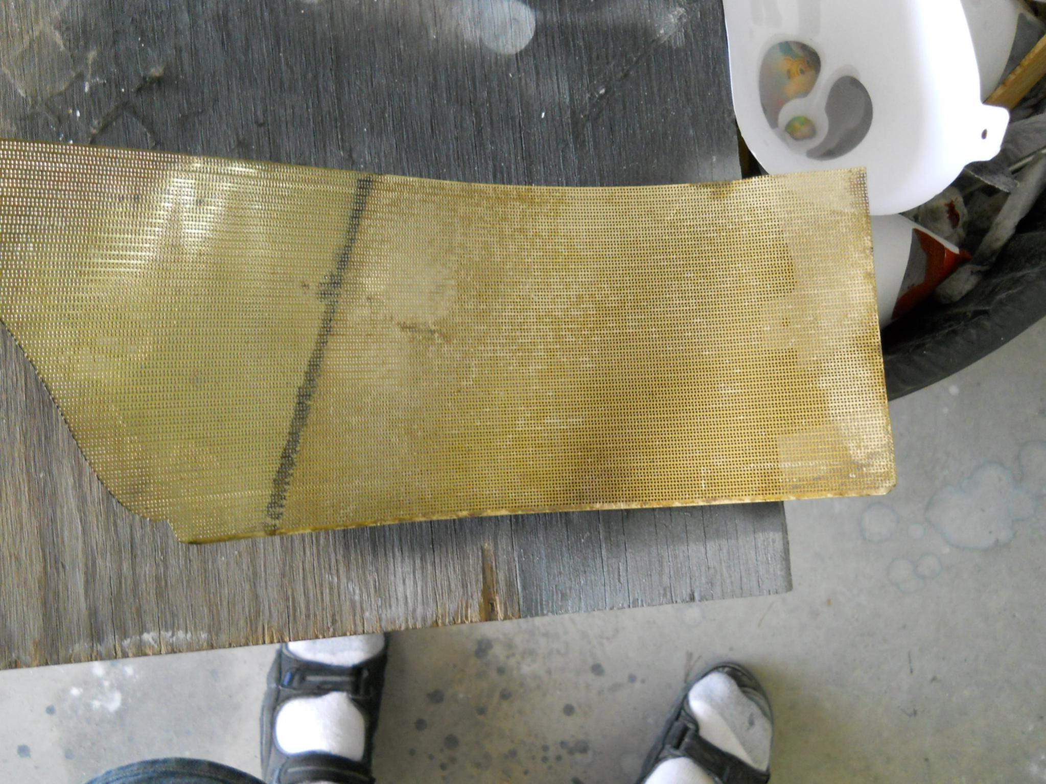

    Well, this is another one of those times when I'm in need of some counsel (knowing that there is lots of talent out there).
    After all the efforts to make this br*** sheet work I'm facing a dilemma that has to be dealt with. I've tried multiple times to clean it and those efforts will work for a while but eventually the tendency to corrode reveals itself. Right now your looking at the results of etching, burnishing, and clear lacquer. It just wants/needs to corrode. I do have some rattle can bright gold that looks ok, but it doesn't have the glow of the burnished br***. I'm thinking about anodized gold on these things.
    Jr says that the br*** sheet he used was bright and clean. The only problem he had was that the clear wore off over time.
    This br*** that I got is probably from the same era. It was severely corroded at the lower part of the roll that was in the box. Your thoughts?
  28. missysdad1
    Joined: Dec 9, 2008
    Posts: 3,307
    missysdad1
    It's a long shot, Jerry, but br*** is used on salt water boats for fasteners and hardware. That's about as corrosive an environment as there is. Surely a marine supply specialty house would have materials to deep-clean the br***.
    But...the spots on the mesh almost look like chemical contamination of some sort, not the overall grayish patena that naturally forms on exposed br***. Who knows what might have been spilled on it over the years.
    Hell, it might be rat piss. Not joking. That stuff will eat through anything given enough time and is difficult as the ****ens to remove. And it will cause spots to reappear like yours if it has not been diluted thoroughly.
    You might try carb dip or Tarn-X on a small sample where the spotting is worst and see what happens. Perhaps vinegar? Diluted pool acid? MetalPrep? Mol***es? Detergent and hot water?
    EDIT: I got it! Ammonia diluted with water! That's what I use to clean used br*** rifle cartridge cases! Works great and doesn't hurt the br***, but it will etch the surface so you'll need to re-polish it. Try this first!
    You can soak the br*** mesh for a few minutes, then rinse with water and check progress. Don't leave it too long, and be sure to rinse thoroughly with water before drying.
    Good luck!
  29. jivin jer
    Posts: 3,494
    jivin jer
    All right Eric. I have some large pieces that are the most corroded. I'll give this a try tomorrow. The problem has been that it looks good at first ( maybe a couple of weeks) and then starts to corrode.
    If any body else has a contribution Iv'e got enough to have several tests going at once. Thanks Eric.

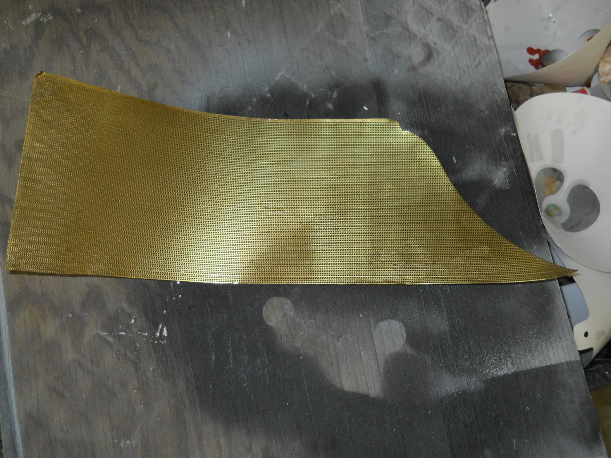

  30. jivin jer
    Posts: 3,494
    jivin jer

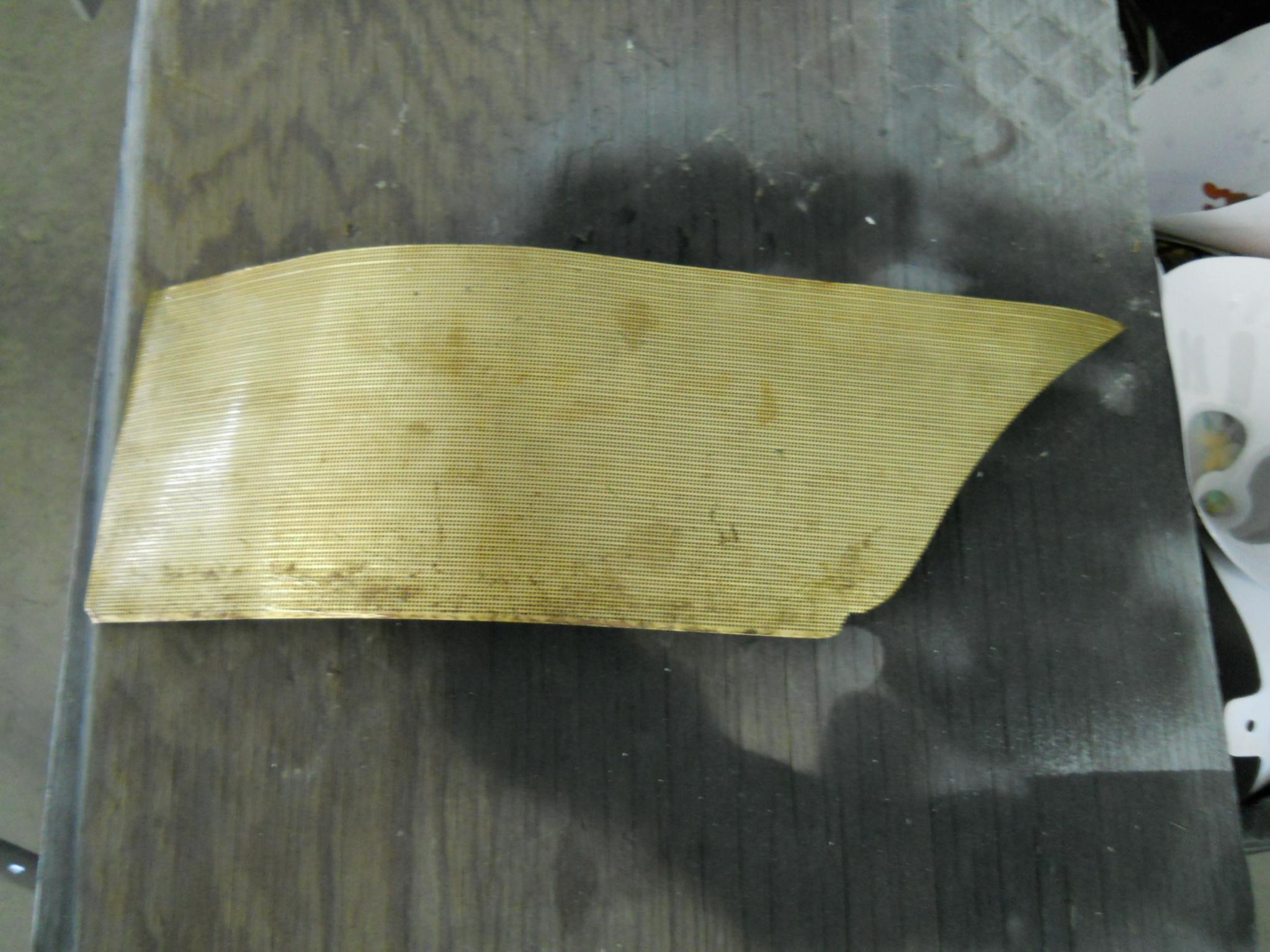

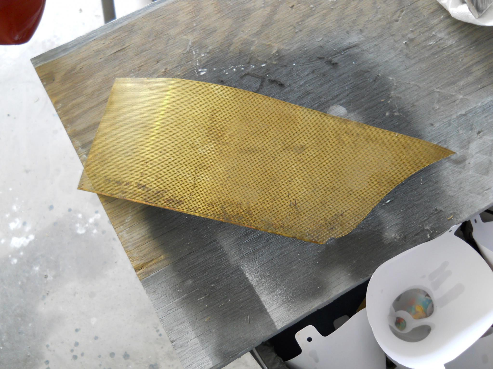

    Well, here are the results of the cleaning/etching attempt. I'm using a 30 percent ammonia solution in water. The first two pics show the surplus piece (front/back) before the test. The second two show results after 5 min. The last three are ½ hr, 1 hr, 3 + hrs. There is chronic blotchiness that shows through out the pieces. As the solution continued its work it eventually ate off a top layer that revealed an underside that is bright.
    I think I have a defective batch of br*** sheet that has been ruined by age. Hopefully my chrome will be done next week. When I go up north to pick it up I'll take a sample of this br*** with me. I'm thinking that there is a coating that can make this look right. Whether that's anodizing or a bright gold powder coat I'm not sure. The holes are quite small and close together. I don't know if they would be filled in the process (they can't be) or not. Oh, what fun.
