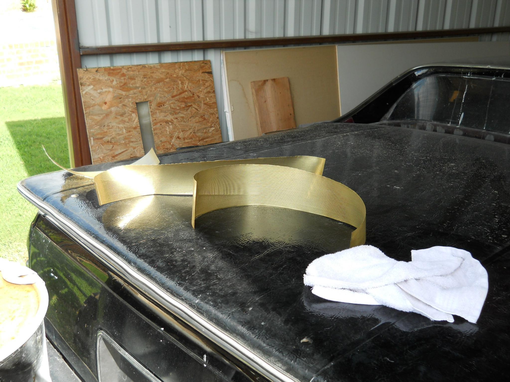

    The br*** is at the plater. Every time I attempted to explain what else I've tried it was met with "I CAN". So we'll see. He is just going to clean and polish.
    I told him that I wanted to spray some clear eurthane on it myself. As you know the issue is with corrosion that keeps creeping back. What would you do?

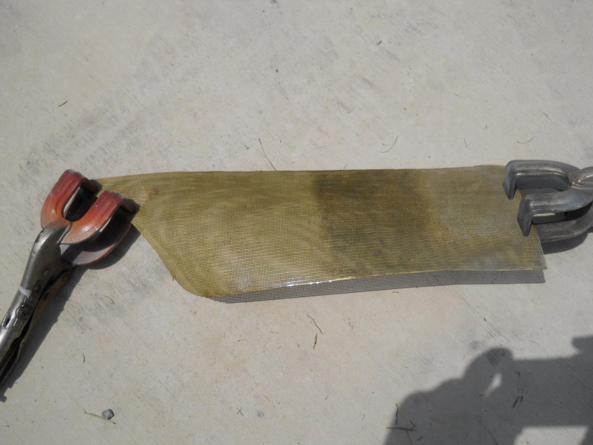

    This sounds exactly like the experiance I'm having with this stuff. It just came to me that I might have some success lightly sand blasting the back (rough) side to remove the corrosion, and then polishing the front (smooth) side and clear coating both sides.
    Do you think that would work? I do have some remnants that I could experiment with. If successful I would retrieve my pieces from the plater and do them.
    Regarding the finish-an aggressive polishing with fine steel wool gives the desired appearance. Its mounted by sandwiching between the upper and lower mldgs.

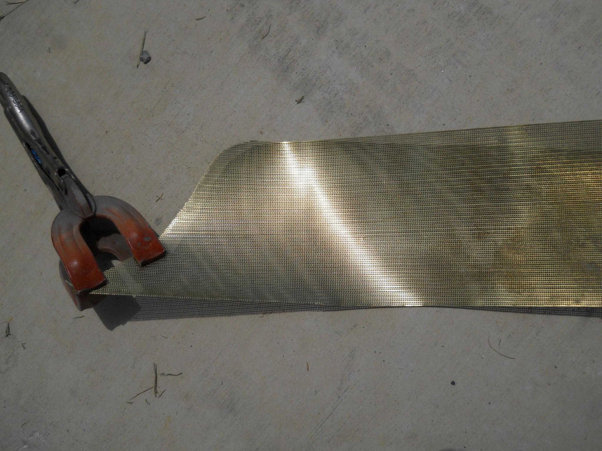

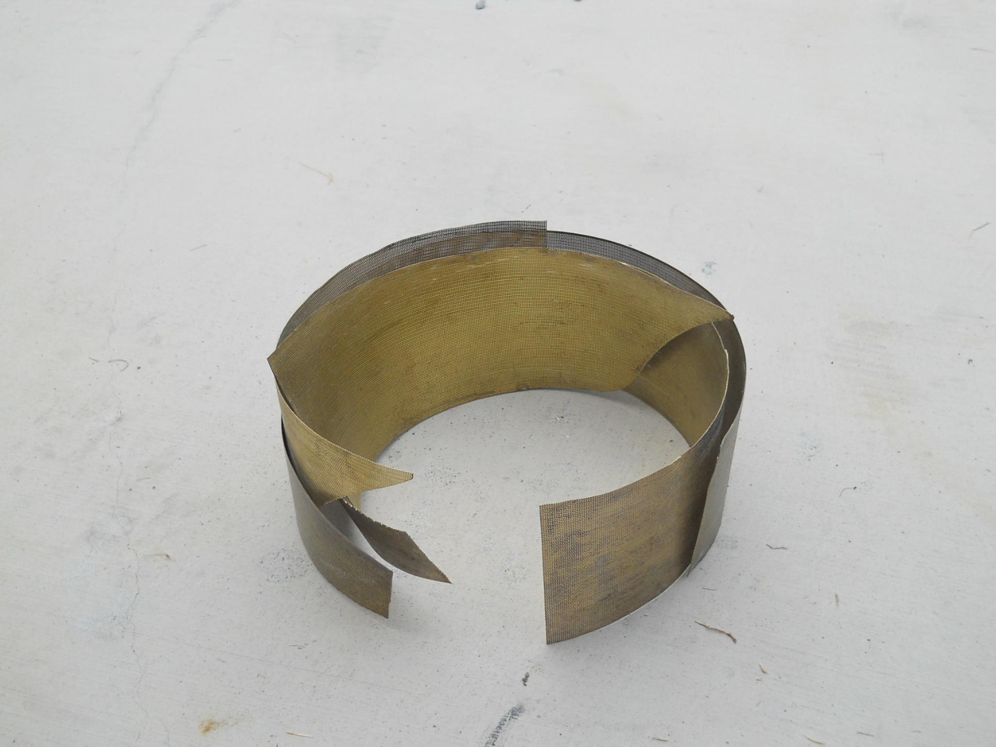

    Nofin thanks for gettin involved. I'm showing a pic (#1) of the back side (partially) sandblasted. The next pic is of the front burnished with both sides clear coated. If it would stay like this it would work. Historically it hasn't. But Iv'e never done anything other than try to chemical clean it. What do you think?
    Once everything is mounted it would be separated from the other painted surfaces by the mldgs.I'm well aware of the polish in the holes issue. there wouldn't be any polish near them. They would just be "dusted".

    Chemically cleaning will mostly effect the surface, and needs to be rinsed thoroughly to stop the chemical process before protective coating, but will not solve the underlying problem.
    If that is the finish you want and it stays like that you are in! The clearcoat should seal it off from potential problems. You can get specific application br*** lacquers (try marine supplies shops).
    The problem with lacquered br*** is that most lacquers/ clearcoats etc only have a limited lifespan. They will usually last for a year or so then will need to be redone because of temperature/atmosphere/scratches etc, which is why I suggested bonding to a backing plate. But if that is the finish you want and don't mind re-doing it from time to time then that's fine.

    Jr said that the clear (lacquer) wore off over time. This is eurethane. I'm hoping that will make a big differance. I've been at this point before except for the cleaning process that i'm hopefull about.

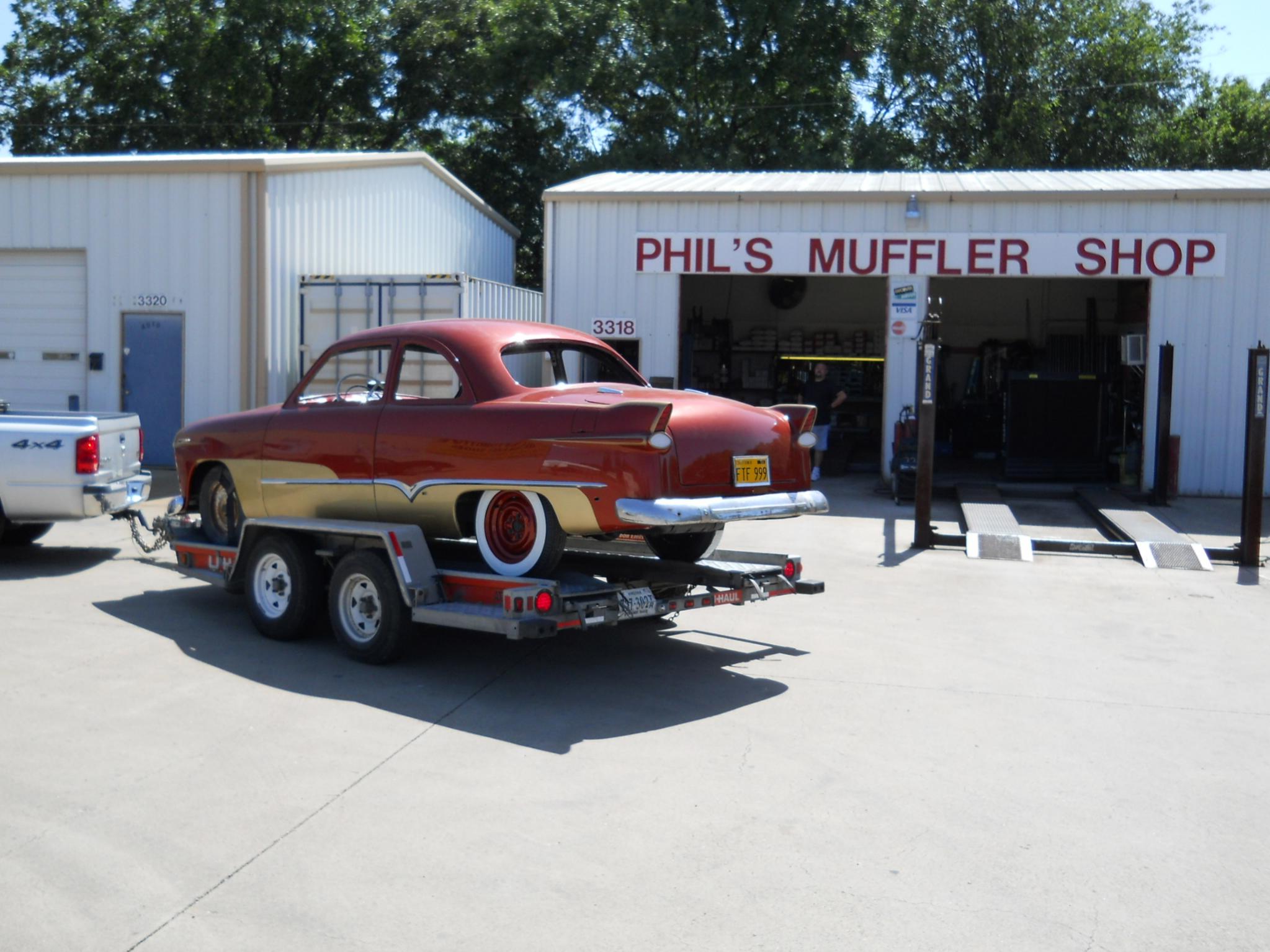

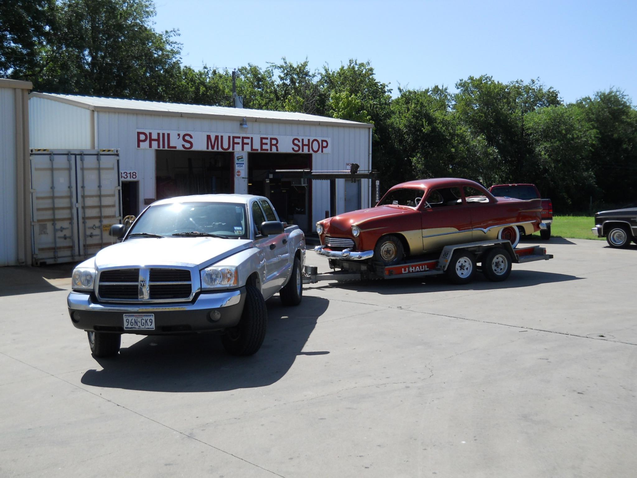

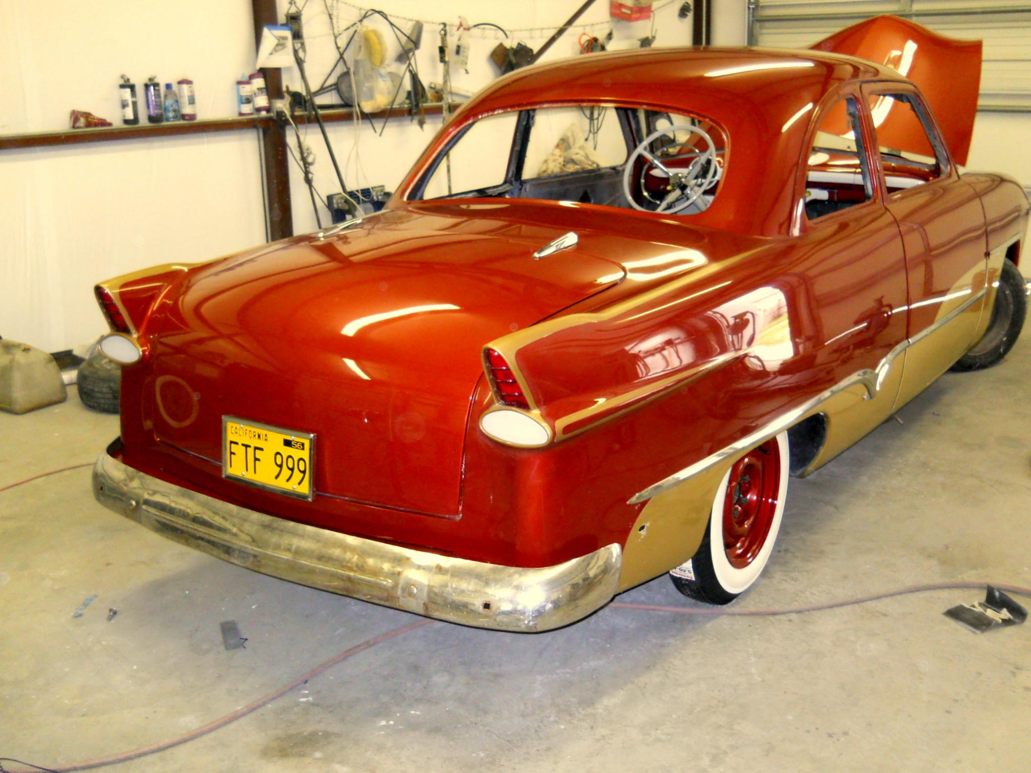

    We're gettin ready for the first big outing since gettin it painted. We're goin to the muffler shop tomorrow and gettin an exhaust system.
    The ragged rear bumper will help locate the tips.

    We were unable to make the muffler shop today because of transportation so its on for tomorrow. I got the br*** back from the plater and for the first time I feel confident about it.

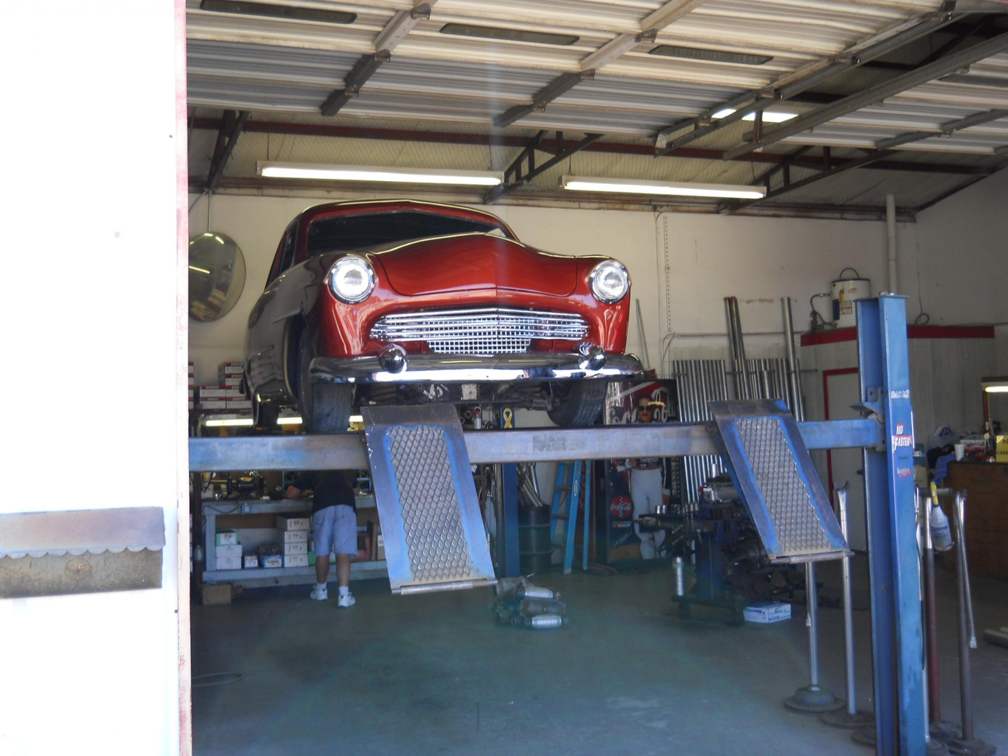

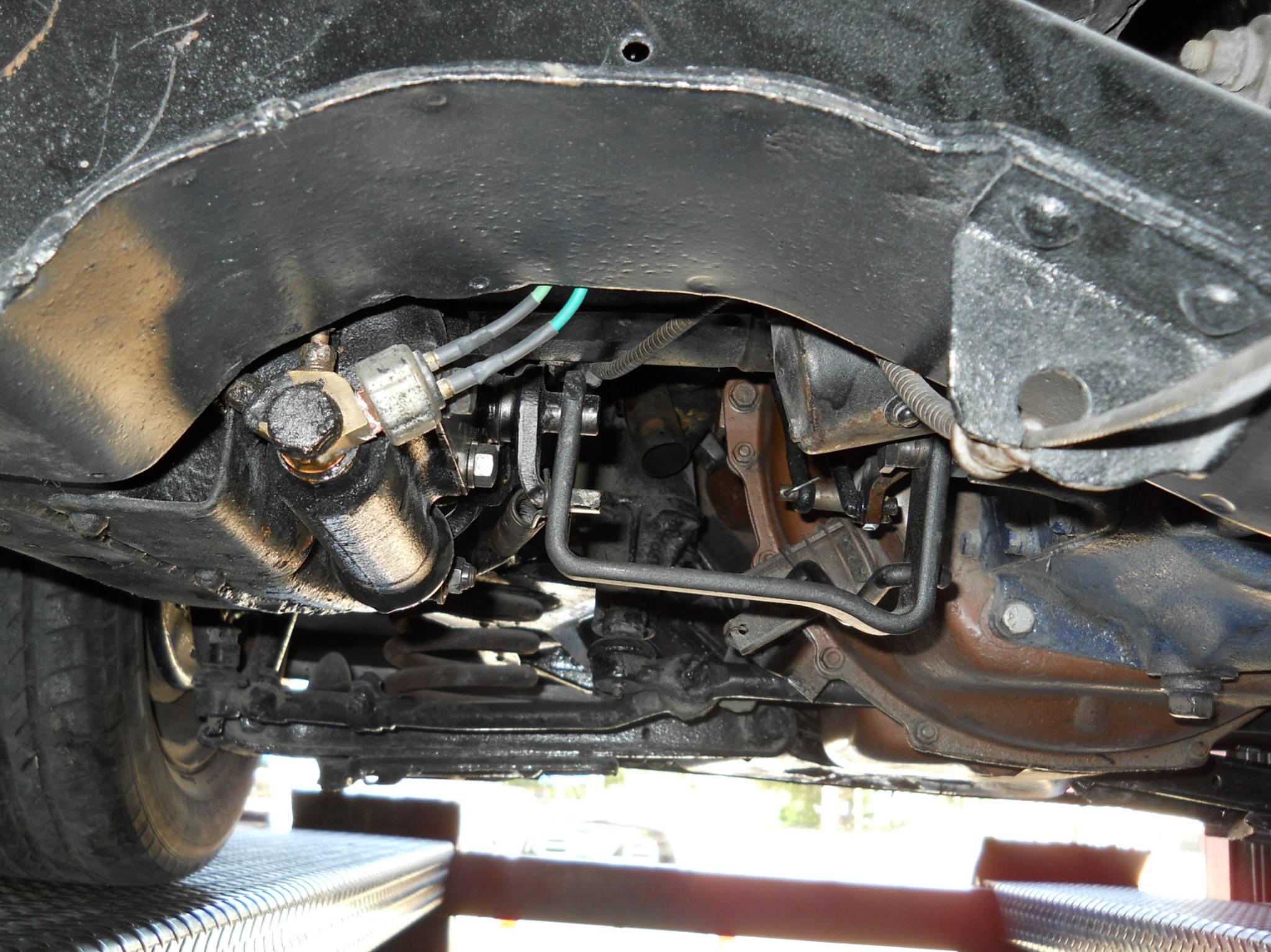

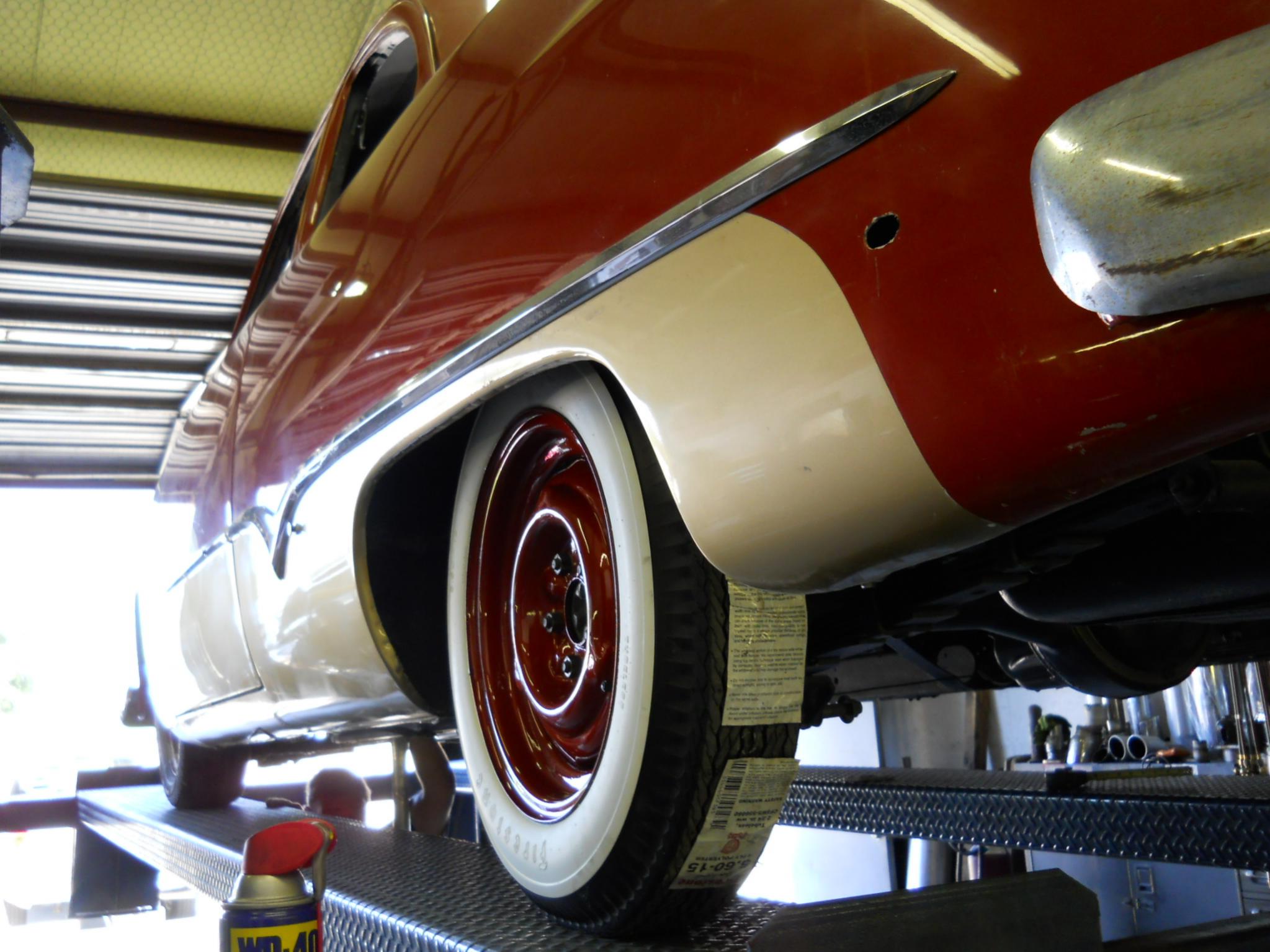

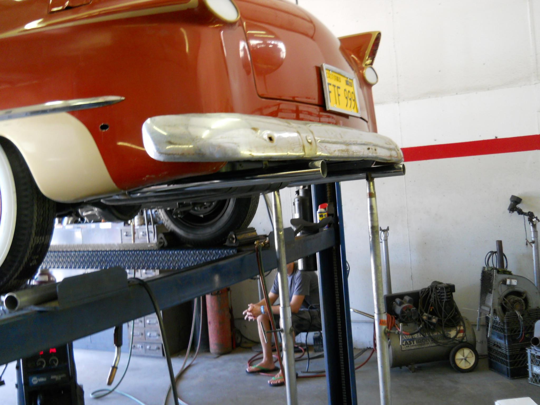

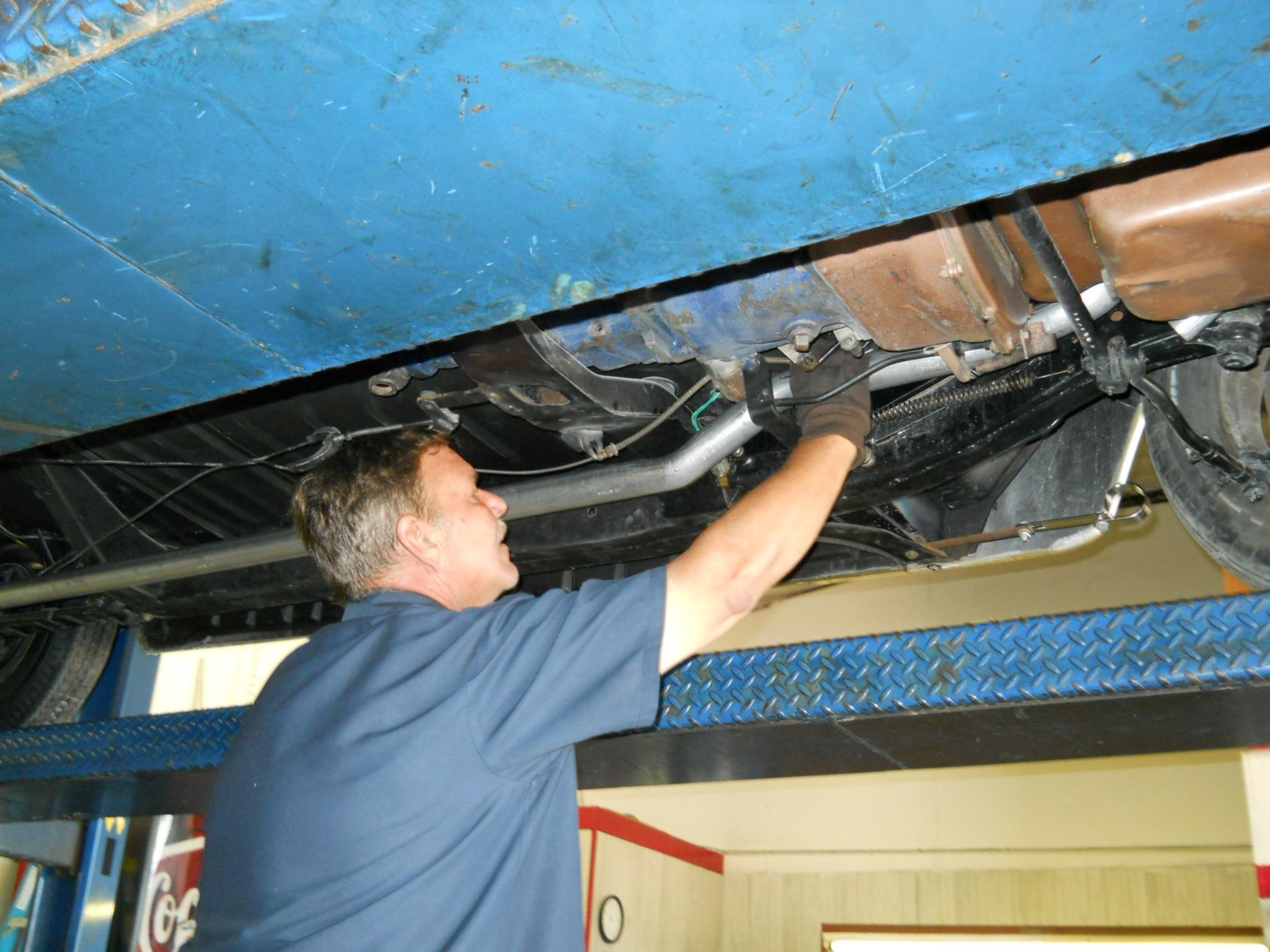

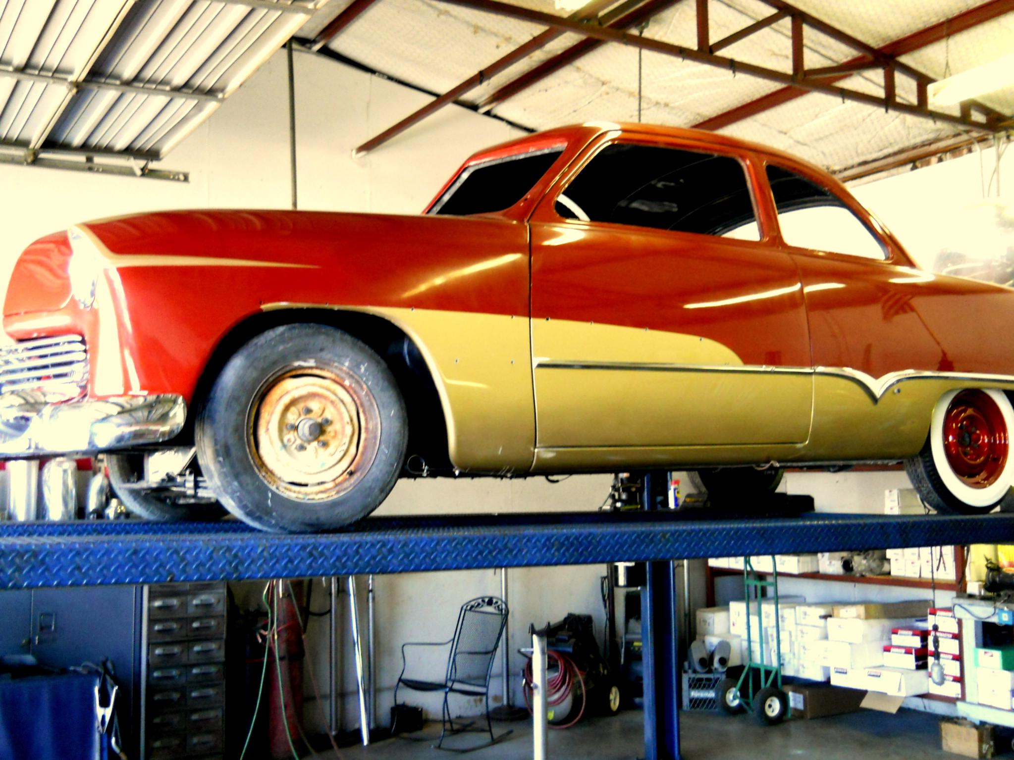

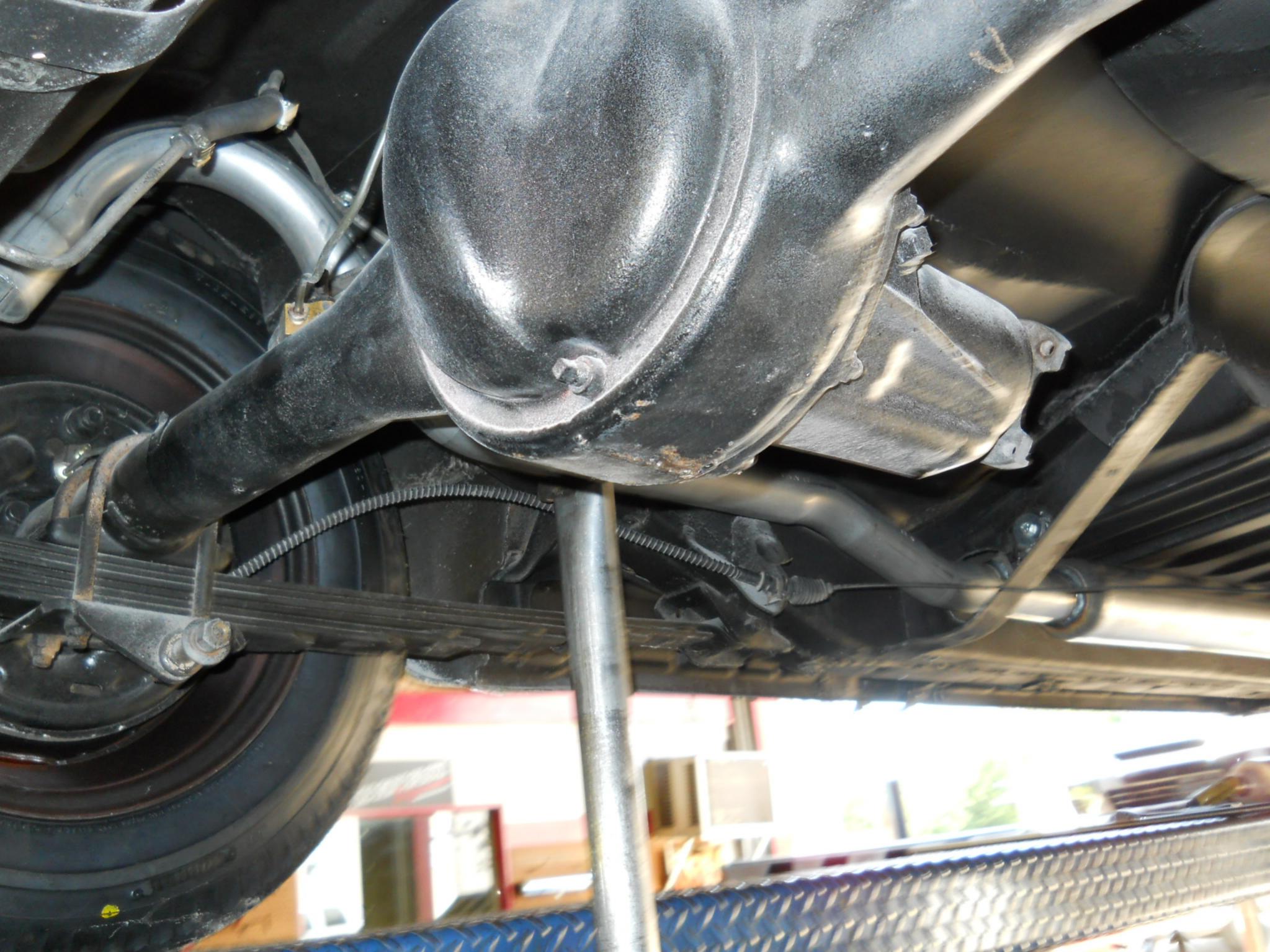

    All lowered cars have special challenges. If you prepare for them during the build life becomes a bit easier.
    The goal is to keep the pipes/mufflers tucked up level with the frame rails because of the clearance issues. The normal muffler shop reacts to a job like this by locking the doors when they see you drive up. Phil not only welcomed the work, he made it look easy. Everything was friendly, including the price.
    These shots show the car on the lift and, yes we have to go through there

    Phil cleaned up the muffler work on my Buick and did a wonderful job.
    The previous owner had run the left pipe underneath the frame rail to get clearance around the master cylinder! It hung 'way down below the car and was smashed nearly flat from being high-centered on speed bumps, driveways, etc. It was a disaster.
    Phil took one look at it, cringed, cut it off and set about building a new pipe in one piece that snaked around the master cylinder in a way that neatly mirrored the opposet side. The new pipe was tucked up tight, ran smooth and looked really, really neat.
    You picked the right guy to build your exhaust. Phil is a master craftsman...and, like you said, is affordable as well. Good choice!

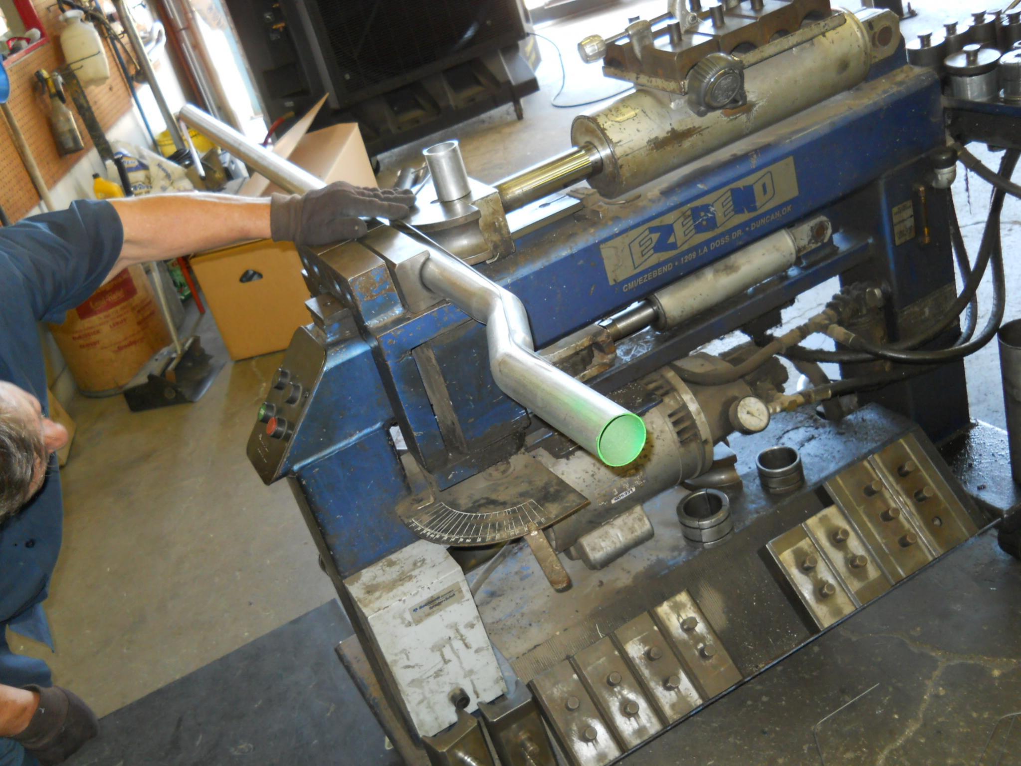

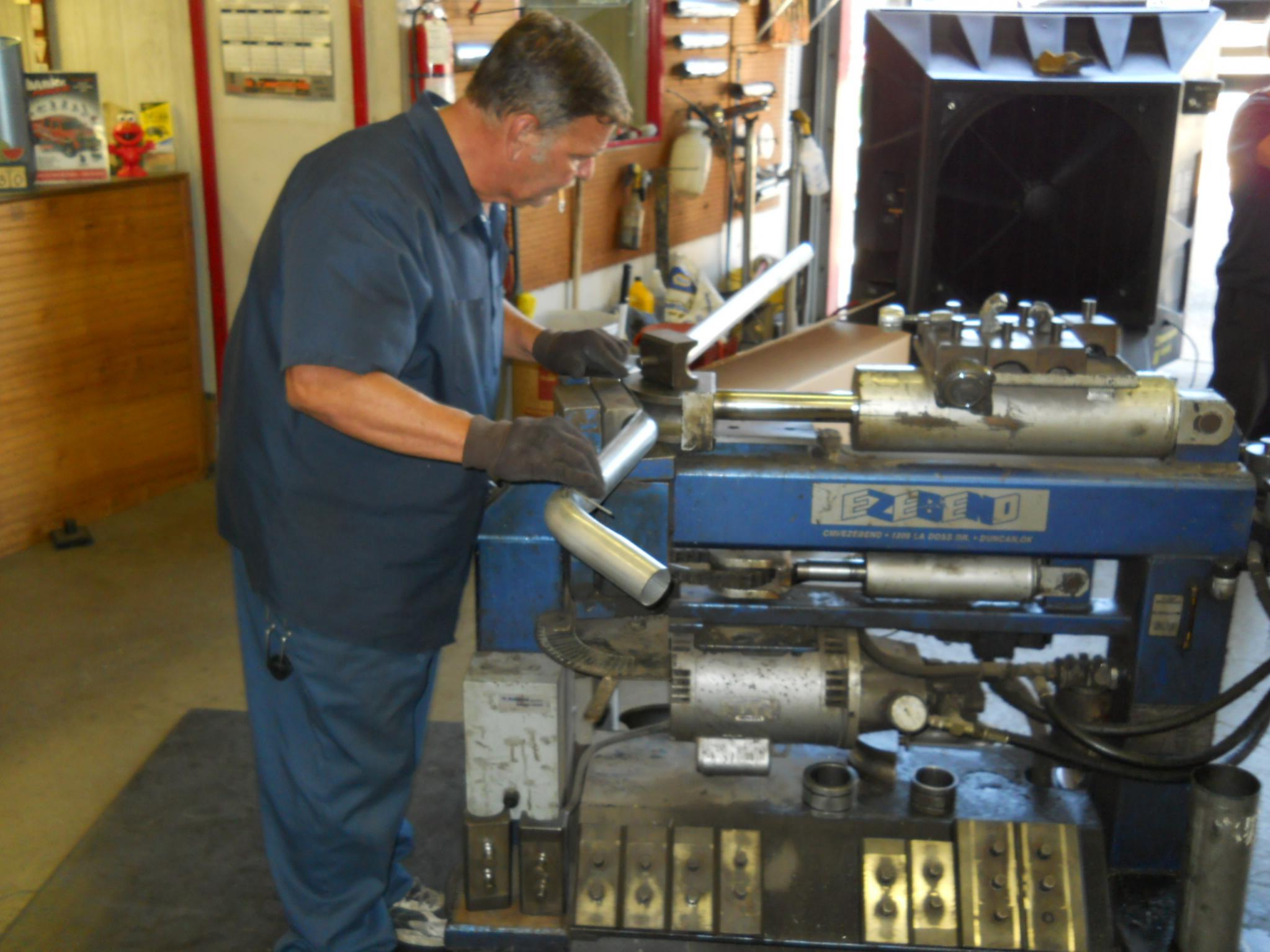

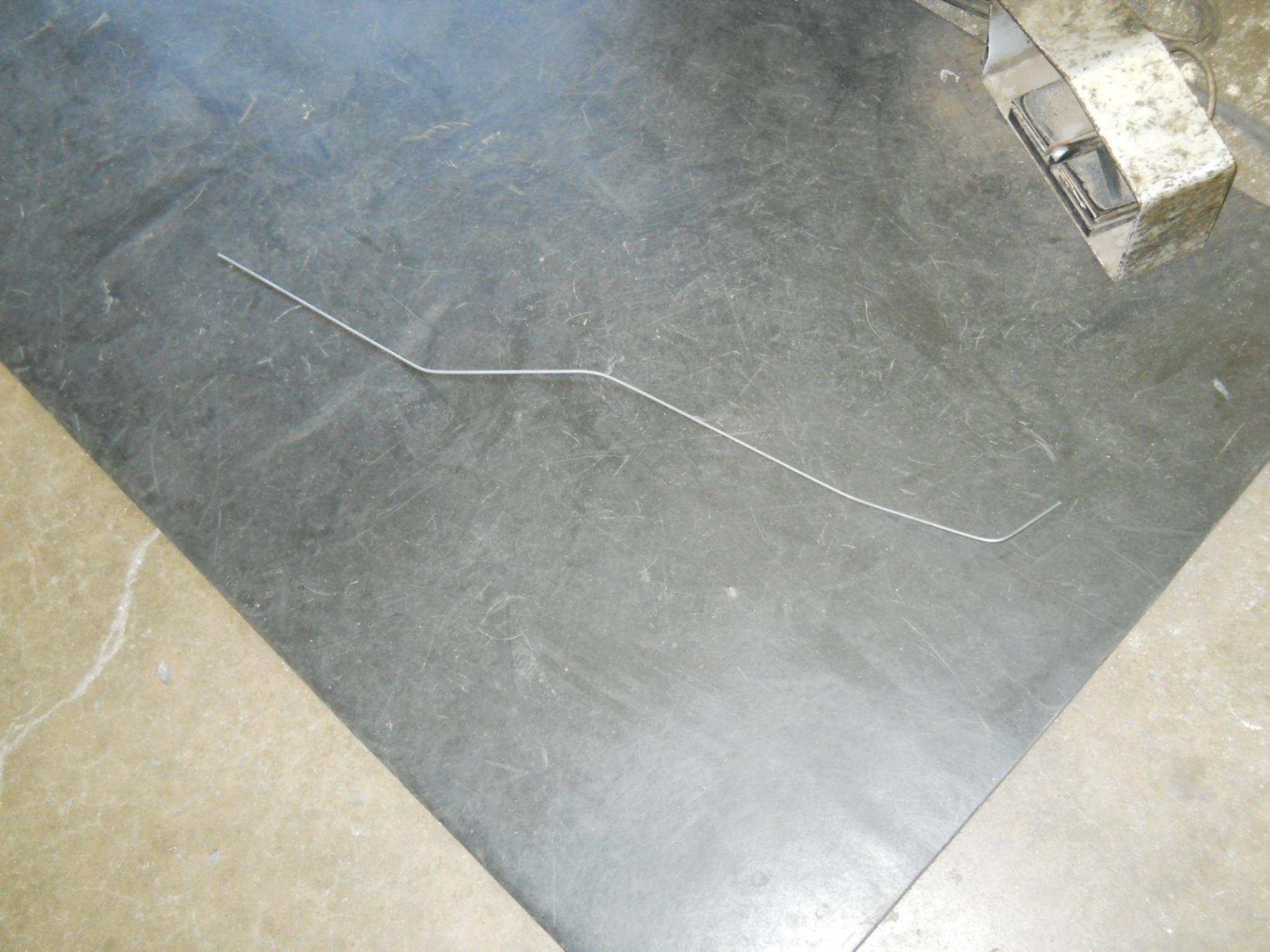

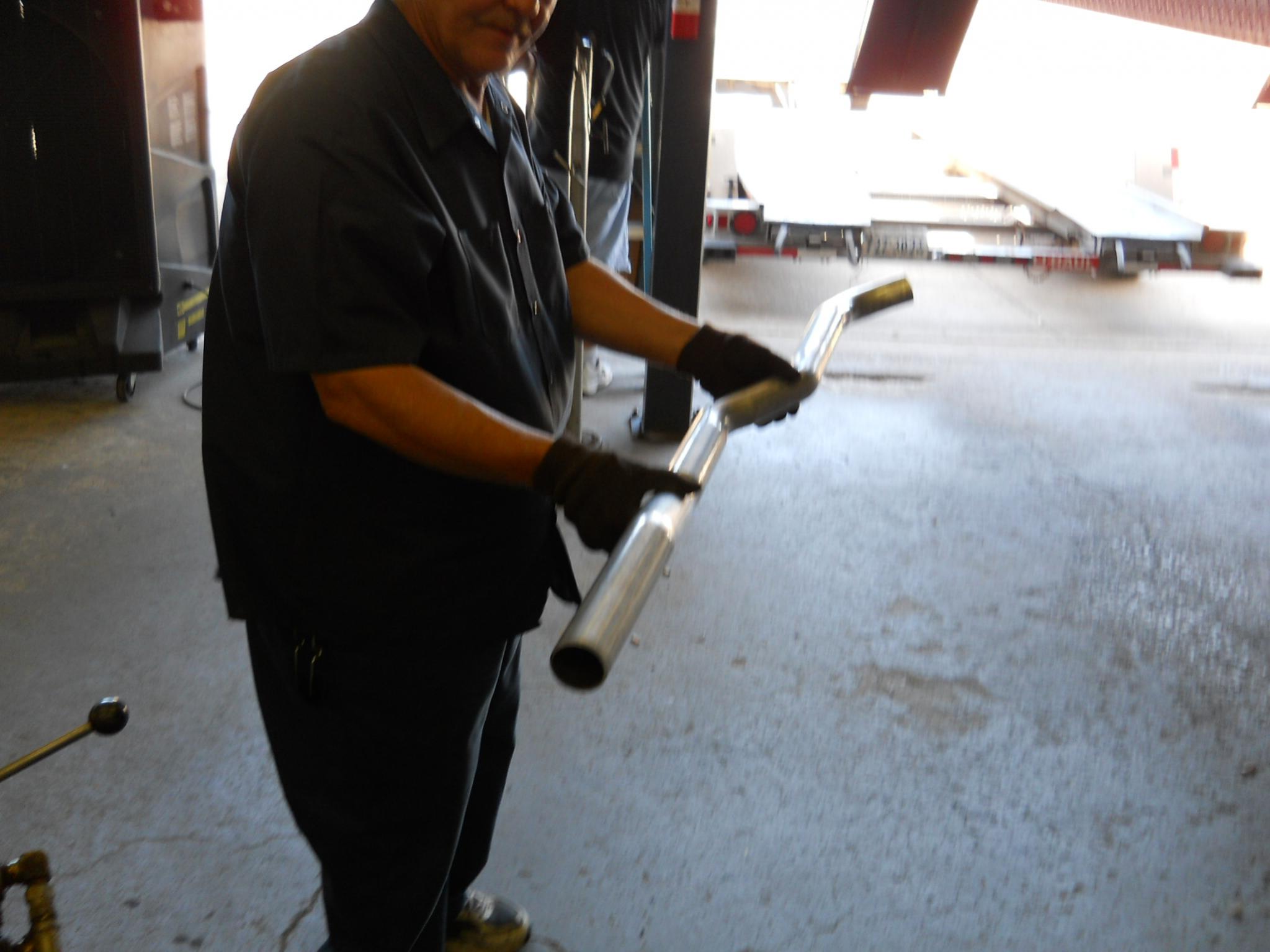

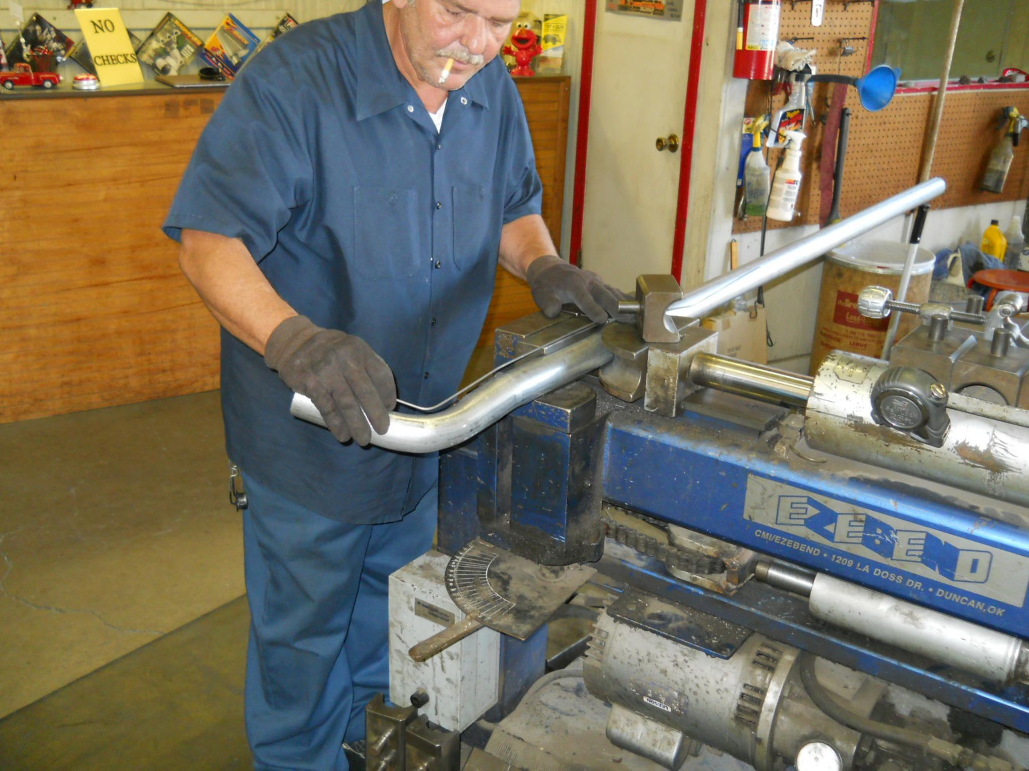

    Phil uses a welding rod to make the shape (pathway) of the exhaust pipe. Then transfers that shape to a piece of pipe on the bender. If you look close you'll always see that rod (template) with a pipe on the bender. He'll go over and fit the pipe and come back and tweek it a little on the bender and fit it again.
    If you have someone like this in your neighborhood there's no good reason to be trying to do this at home. Unless of course your vehicle isn't transportable. It's too cheap to do this at home.
