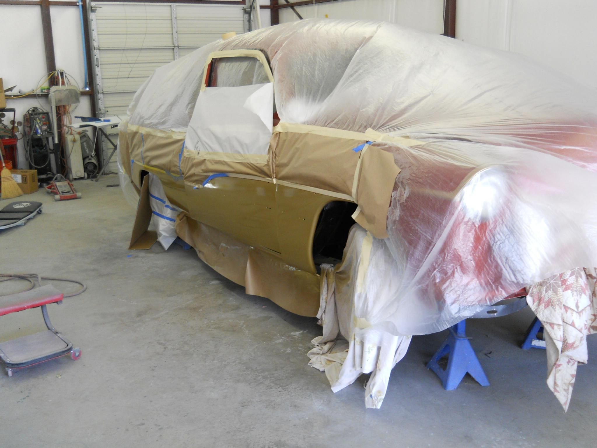

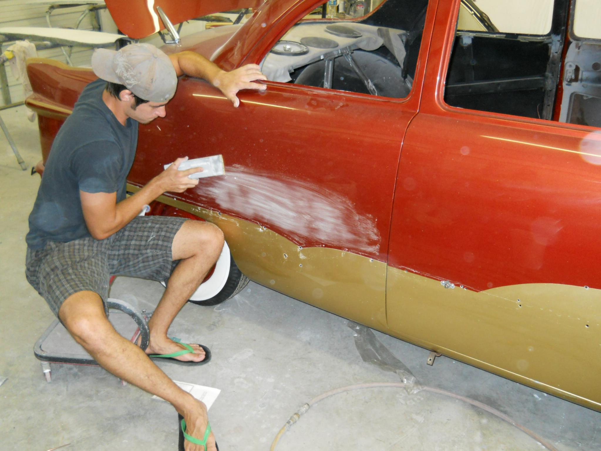

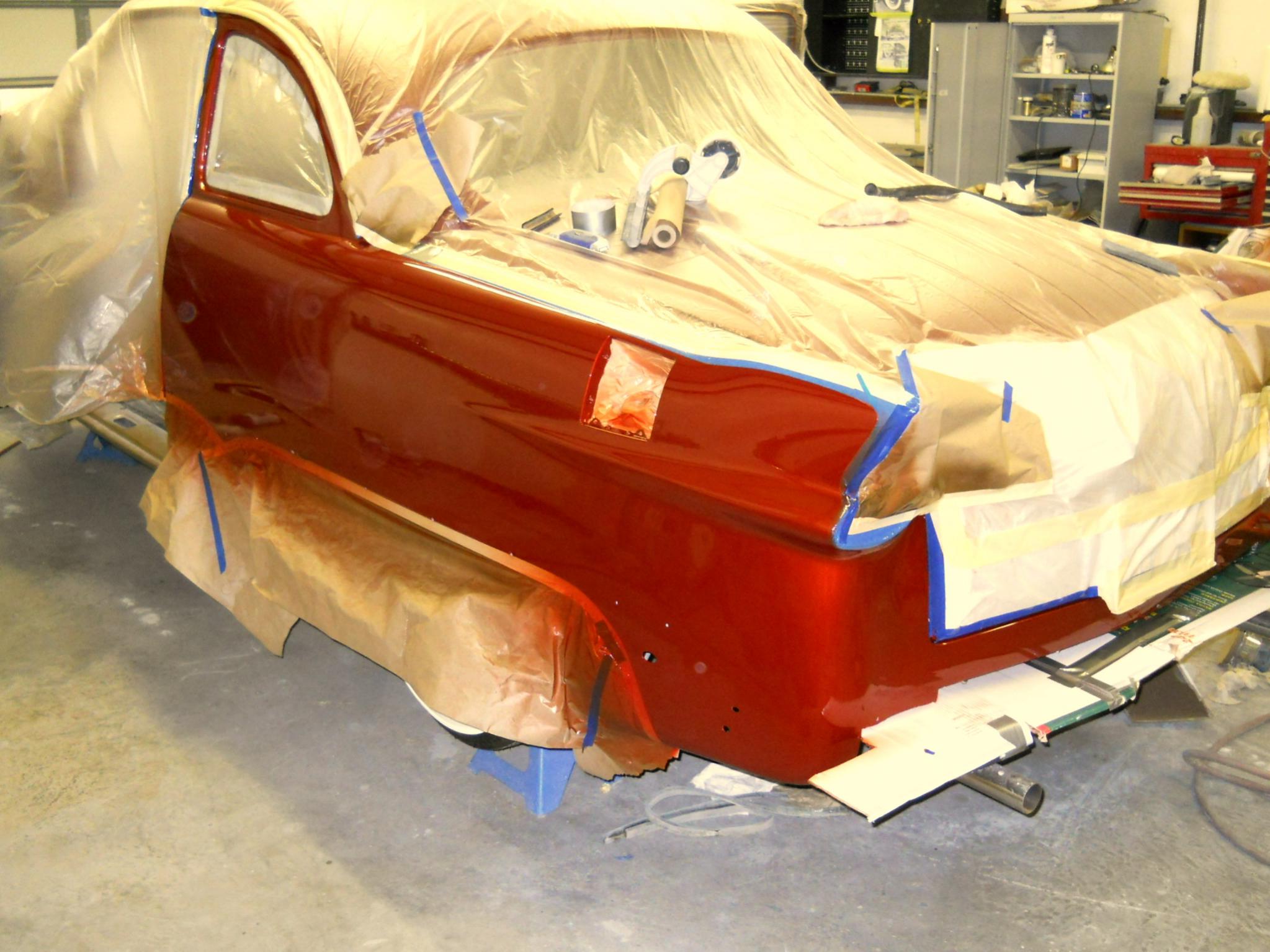

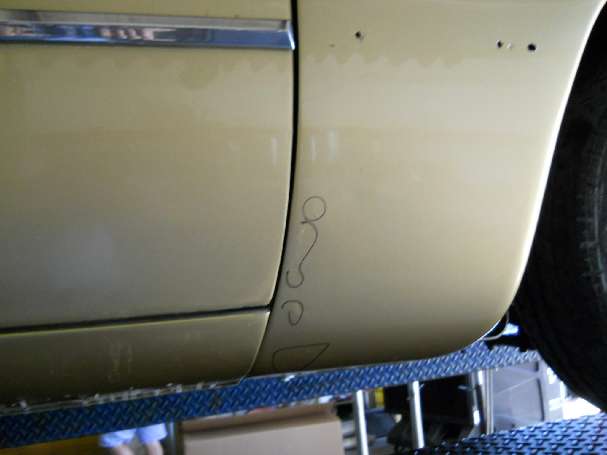

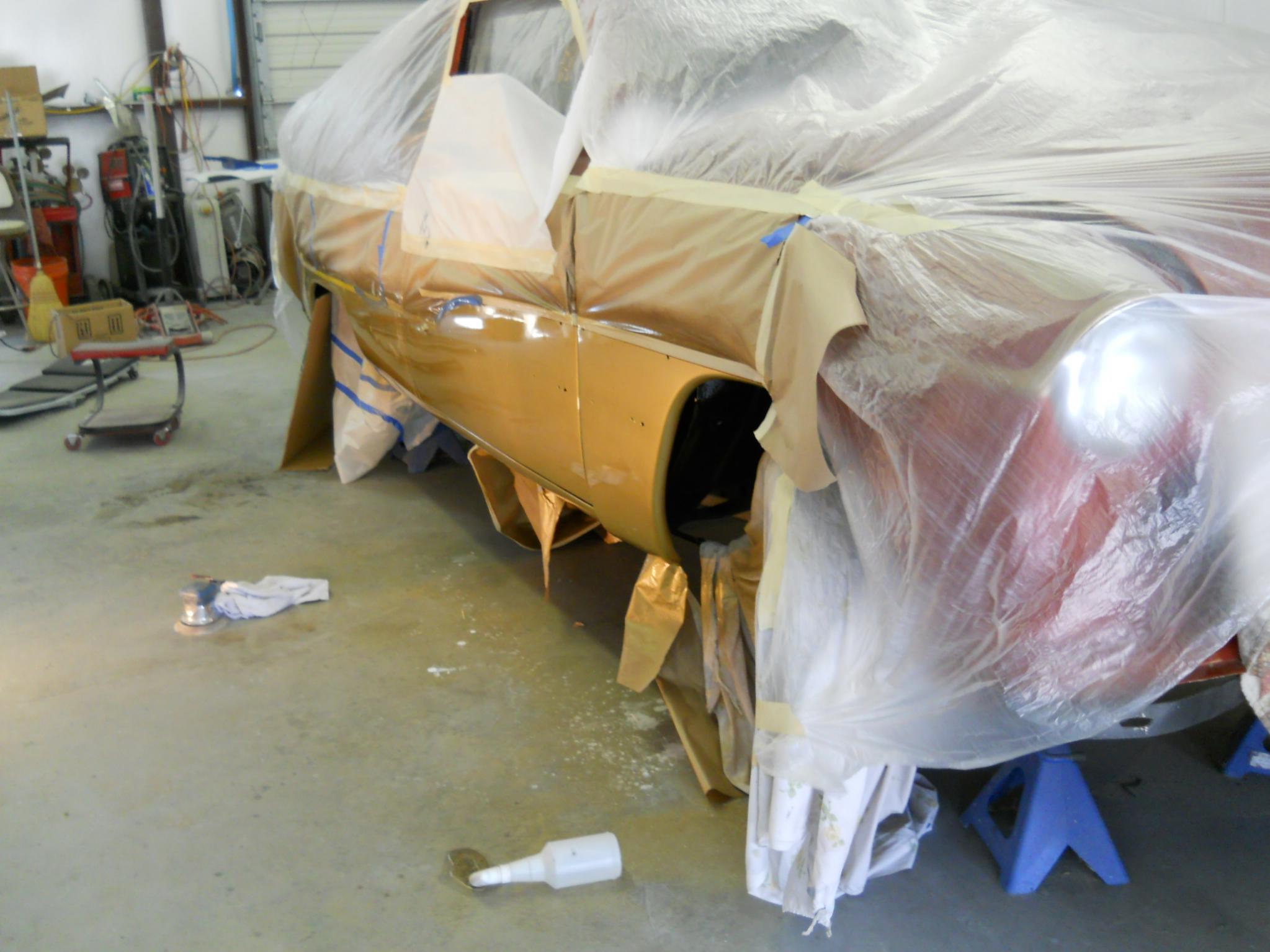

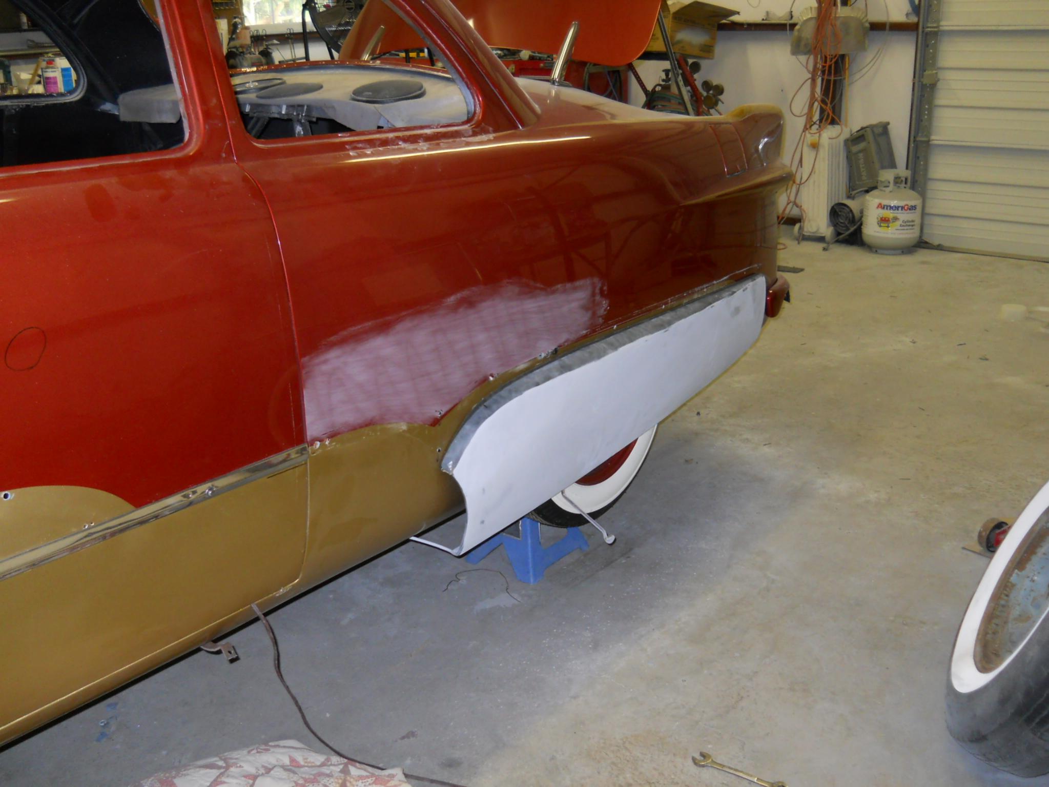

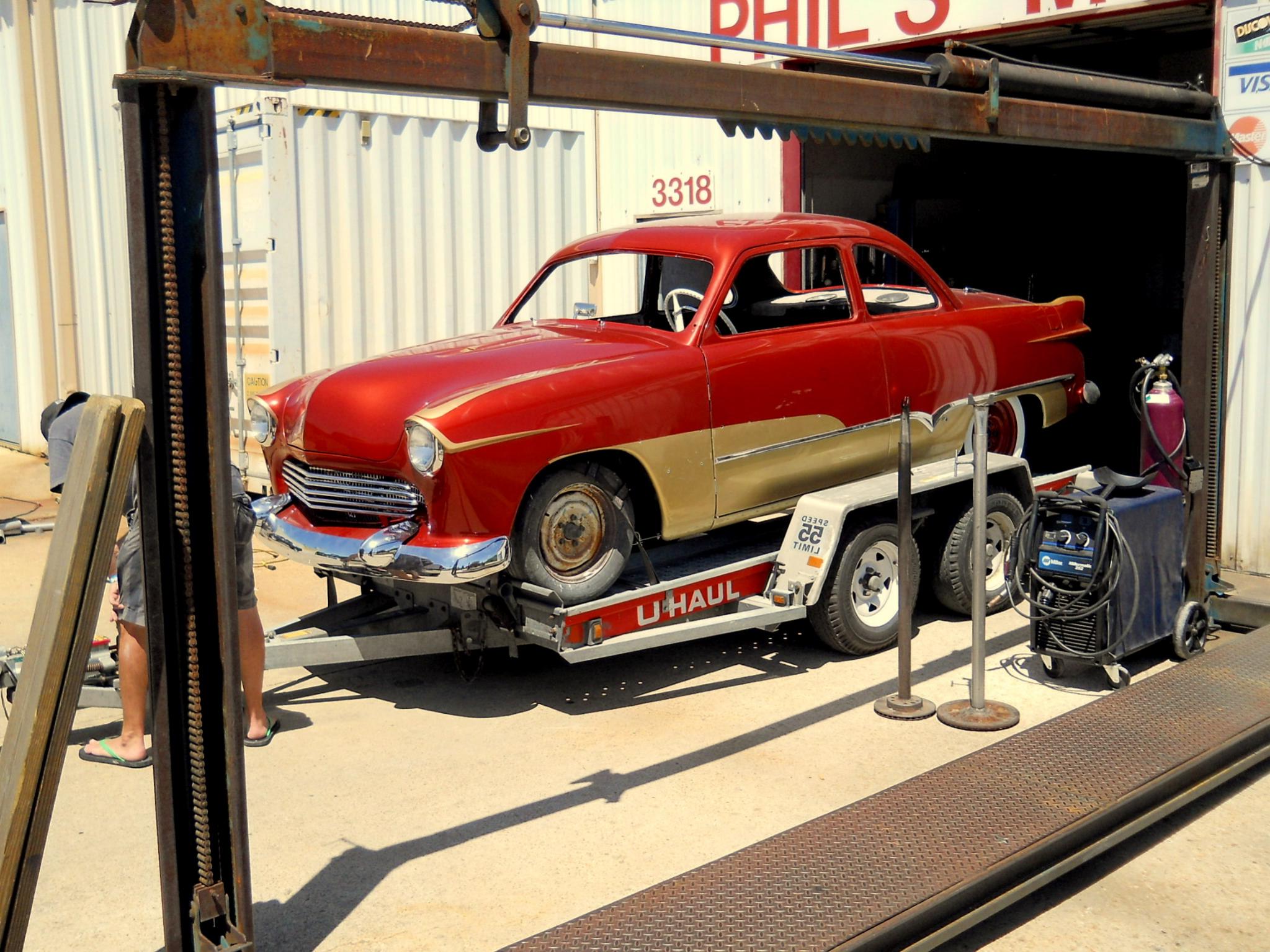

    There's a lot going on right now. We might be at a crossroads of sorts. Son Dan is very frustrated with the problems/progress at the moment. Iv'e had to explain to him that what we're involved with is very different than the structured/production environment that he (and I) are used to. We've only been at this for about 9 months. These projects can (and do) take years. All the unknowns and the unreliable people that you try to depend on. The parts gathering (and reconditioning) that's another world away from collision repair on late model cars.
    Having the car up in the air like it was revealed some issues that have to be dealt with. The last trip to the paint booth did more damage than we originally thought. We just initially saw the damage to the front gravel shield at the bumper brackets. The crazy driving and the gyrations that the car went through and the flawed tie down method that was used has caused damage to the ¼ panels. I think there was some flex to the body during the coming and going. Once again the car photo's well. As with all pics of cars on the H.A.M.B. seeing pics and seeing the car in person are two very different things.
    Kurt McCormick has told me that all the damage to his cars has occurred during the transportation (towing) process. That's why he's set up his cars to drive. I have to say that I thoroughly understand. I told you I don't like this part.
    The ¼'s need to be blocked and probably repainted. There will be things that can be attributed to 57 tech but, not stuff like this. I suppose there could be some that would say oh, come on lets get this done, but I doubt that. There is a previous repair (last owner) on the r. fender that we thought was good that has failed. That has to be fixed also.

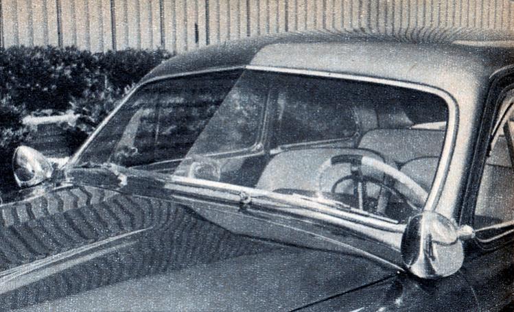

    I'm realizing that upholstery is out of the question until the spot light part of this build is finished. The templates that I got put the lights in the wrong place. The A pillars will have to be welded up and redrilled. How do I know this? The latest close up of the windshield (RikHovingKustoms.com) reveals this. The pic shows the handles pointed towards the r/view mirror (not down). I'm happy to report I just found and purchased a beautiful set of 552's, the correct type, from Ron Mullane (Slo Pok).

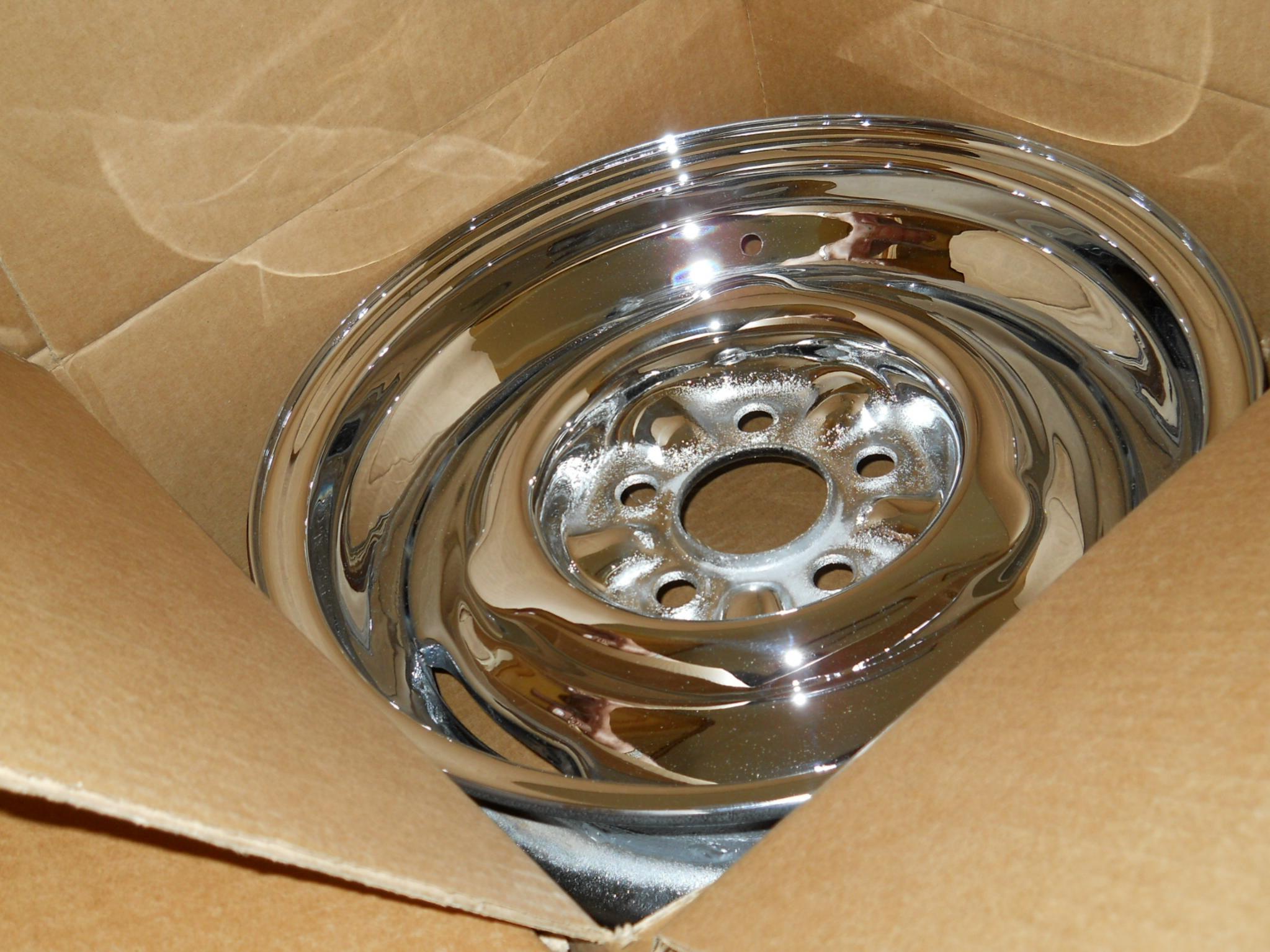

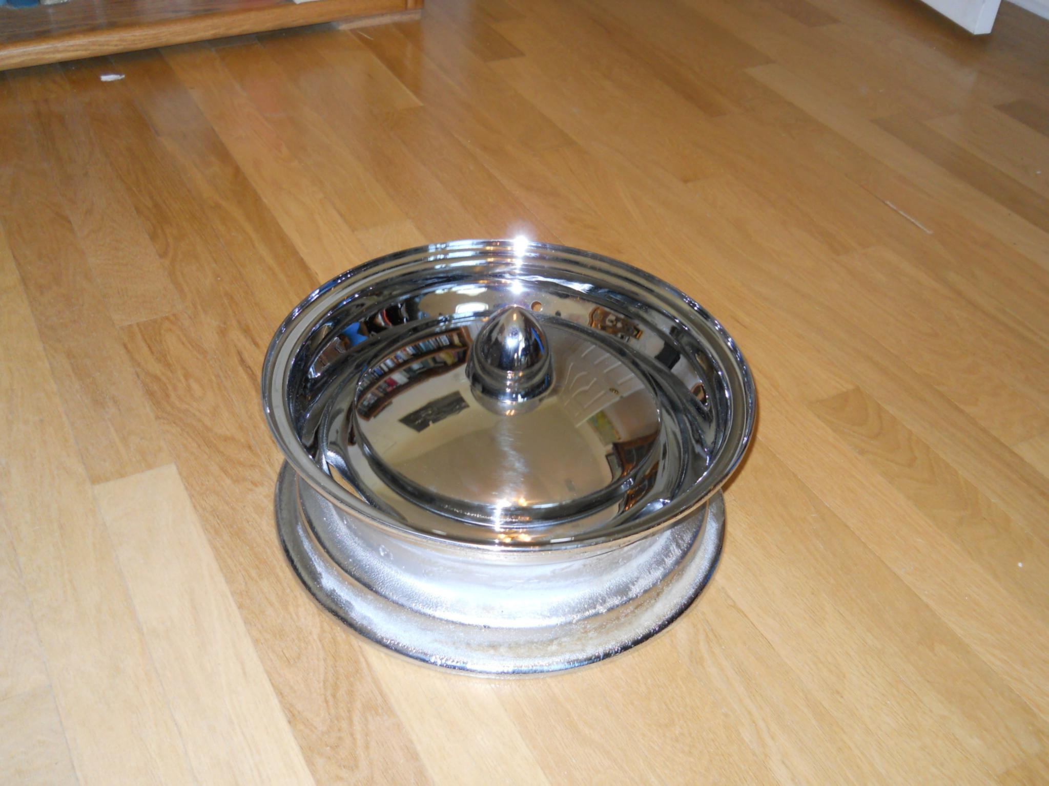

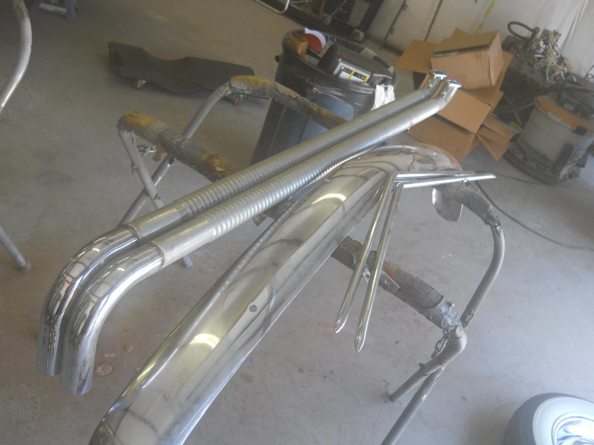

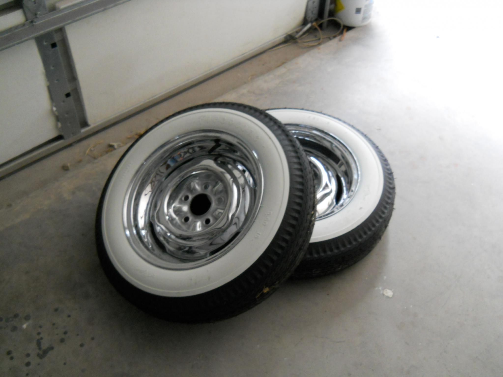

    They are the stock 15" rims taken apart, chromed, reversed and re***embled. See post #400. Jr's continued quest for "modern" made this happen. They are said to be the first set done like this.

    Joined: Aug 22, 2004
    Posts: 1,367
    thesupersized
    were the valve stem holes welded shut and redilled on the other side? or do you now fill it up on the backside of the wheel?
  16. jivin jer
    Joined: Sep 14, 2008
    Posts: 3,495
    jivin jer
    They were welded up and redrilled. Iv'e put tubes in all four tires as a safety measure.

    Ok, we're going to start the spotlight install/correction. You have to check out post #209 to see what I received from **** Jackson. I thought this was correct (as he did). I was cloning Jr's car and **** was showing me how he's always done these. I thought everything was cool until Rik posted the windshield close up pic. That forced me to go back and look again at all the pics that were available. I noticed that the pic of the hood open had a look at the spotlights that I had not paid attention to earlier. It shows the handles pointed towards the rear view mirror more than down, just like the w/s pic. A closer look at the interior shot (with Jr on the phone) also shows this. We were always puzzled by the red (above the glove box) thing in that pic. Jr confirmed that he had painted the handles the body color. Everything is falling into place (starting to make sense) now. So, do I have to change this? Yes. Does this ****? Yes. Should we have been more careful? Yes. The next clone we build (ha!) will benefit from this experience. But I do consider this kind of stuff critical on this build. I can't shake the feeling that we are on holy ground. So that makes this ok. Thanks for hangin with us

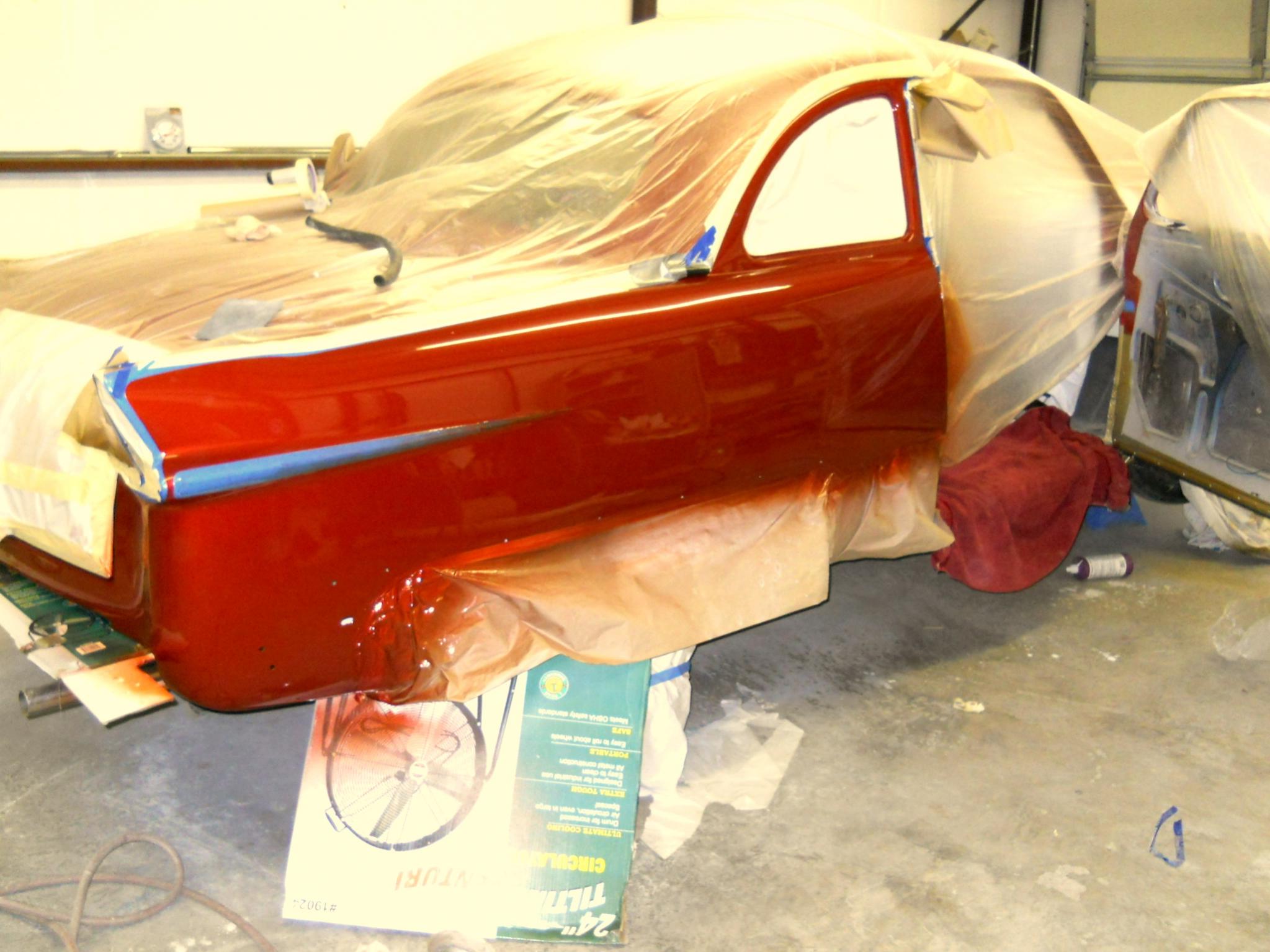

    It's good to be on the other side of this. The skirts have felt like second cl*** citizens for some time.
  22. I have a strong su****ion that the pictures don't do the paint justice...looks like gl***!
  23. What color is the paint? Is it custom mixed or a stock color? Thanks, Todd
  24. jivin jer
    Posts: 3,495
    jivin jer
    It's a modified stock GM formula. The Mica (pearl) is replaced with metallic to retain the traditional look and keep it correct for the era that these (metallic) custom colors were mixed in. This is the time frame before pearls, candies, etc..

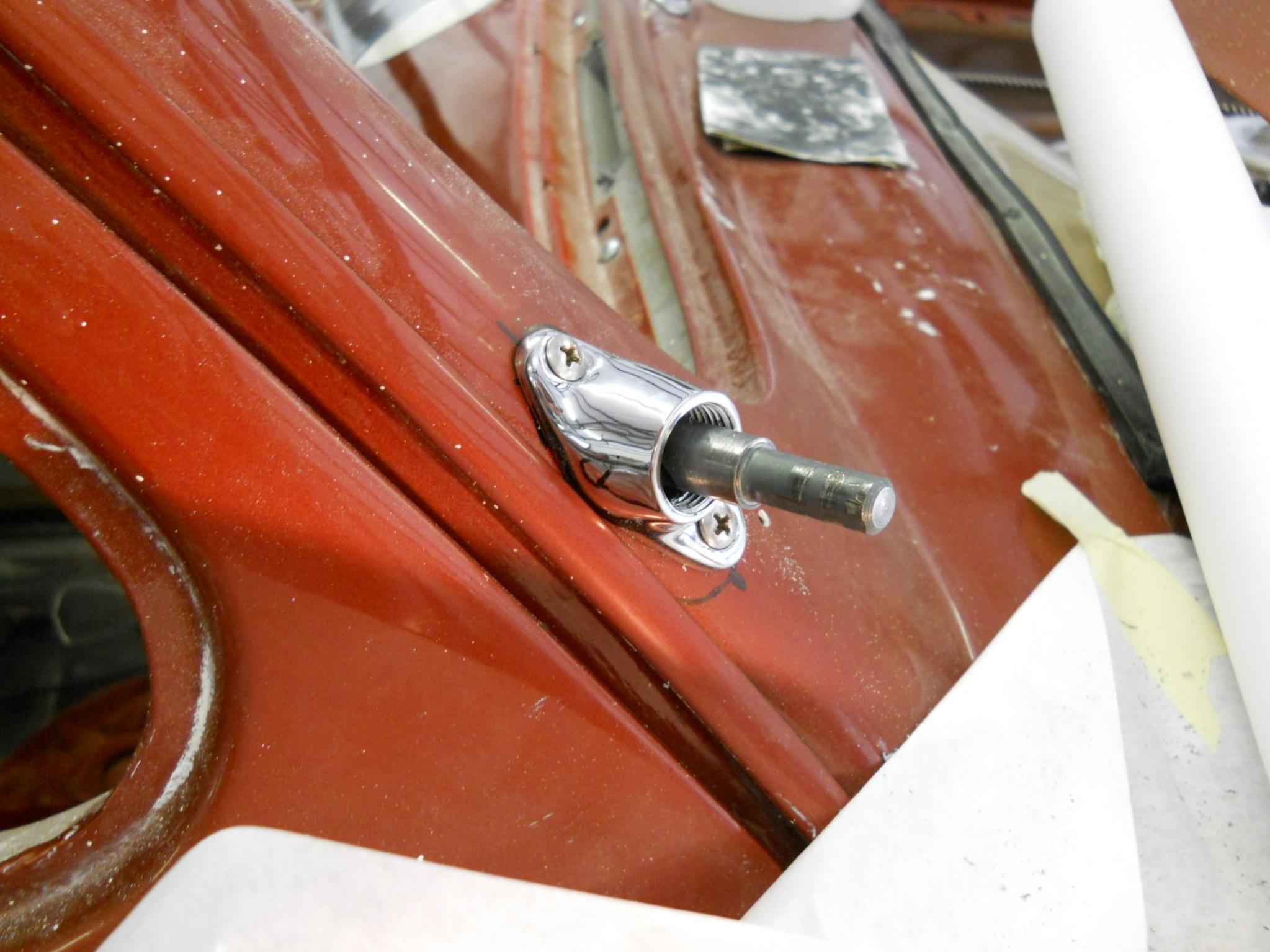

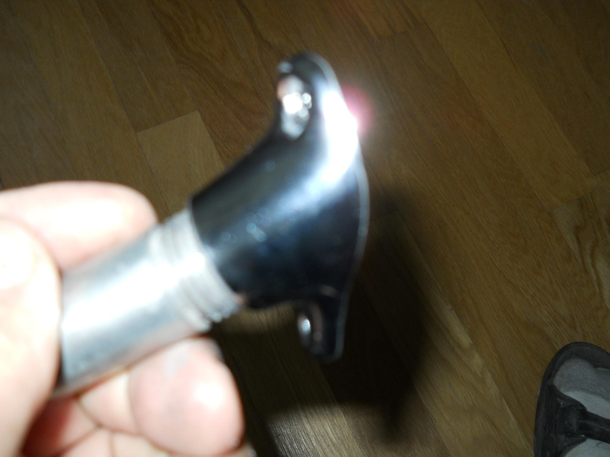

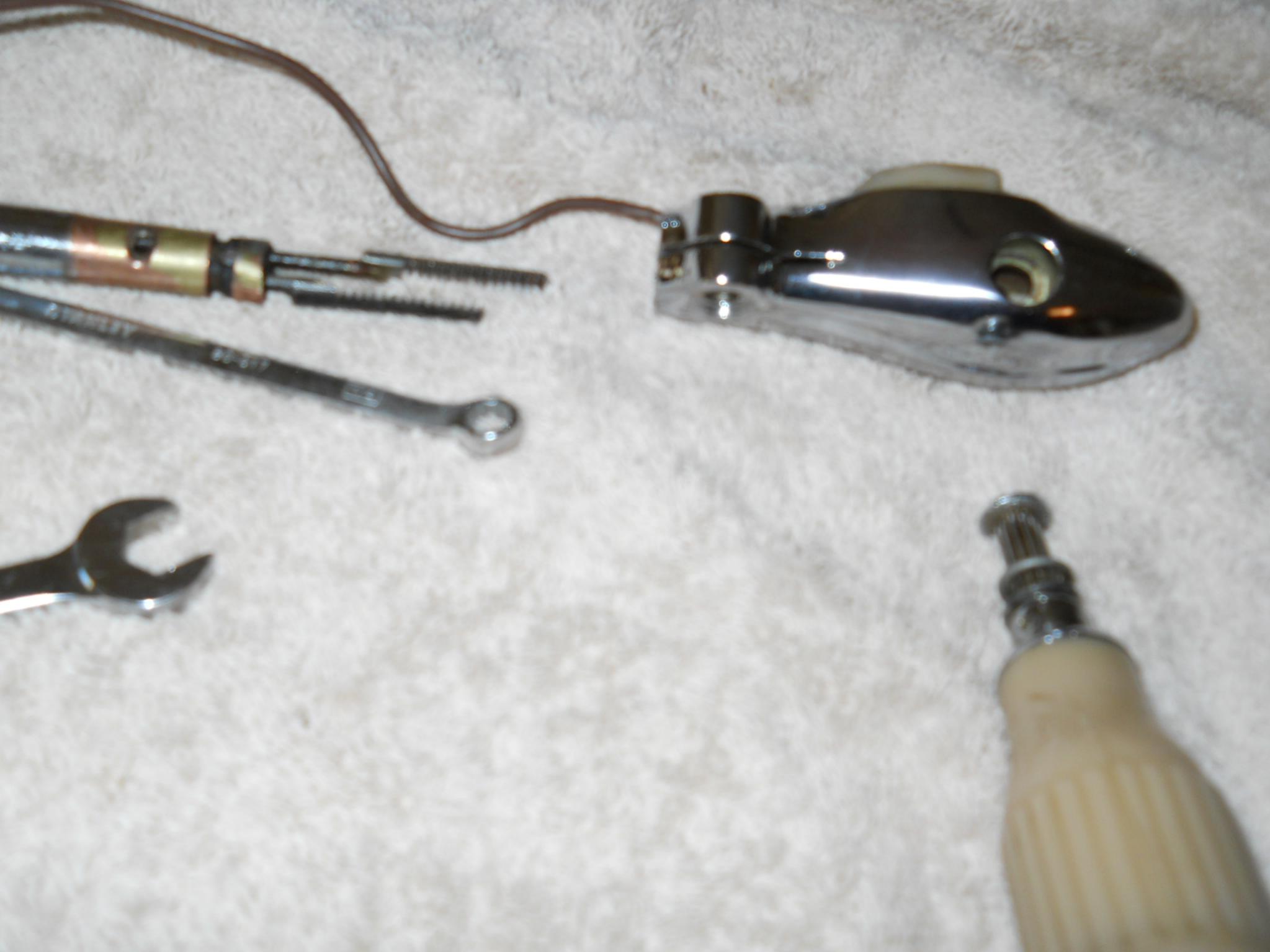

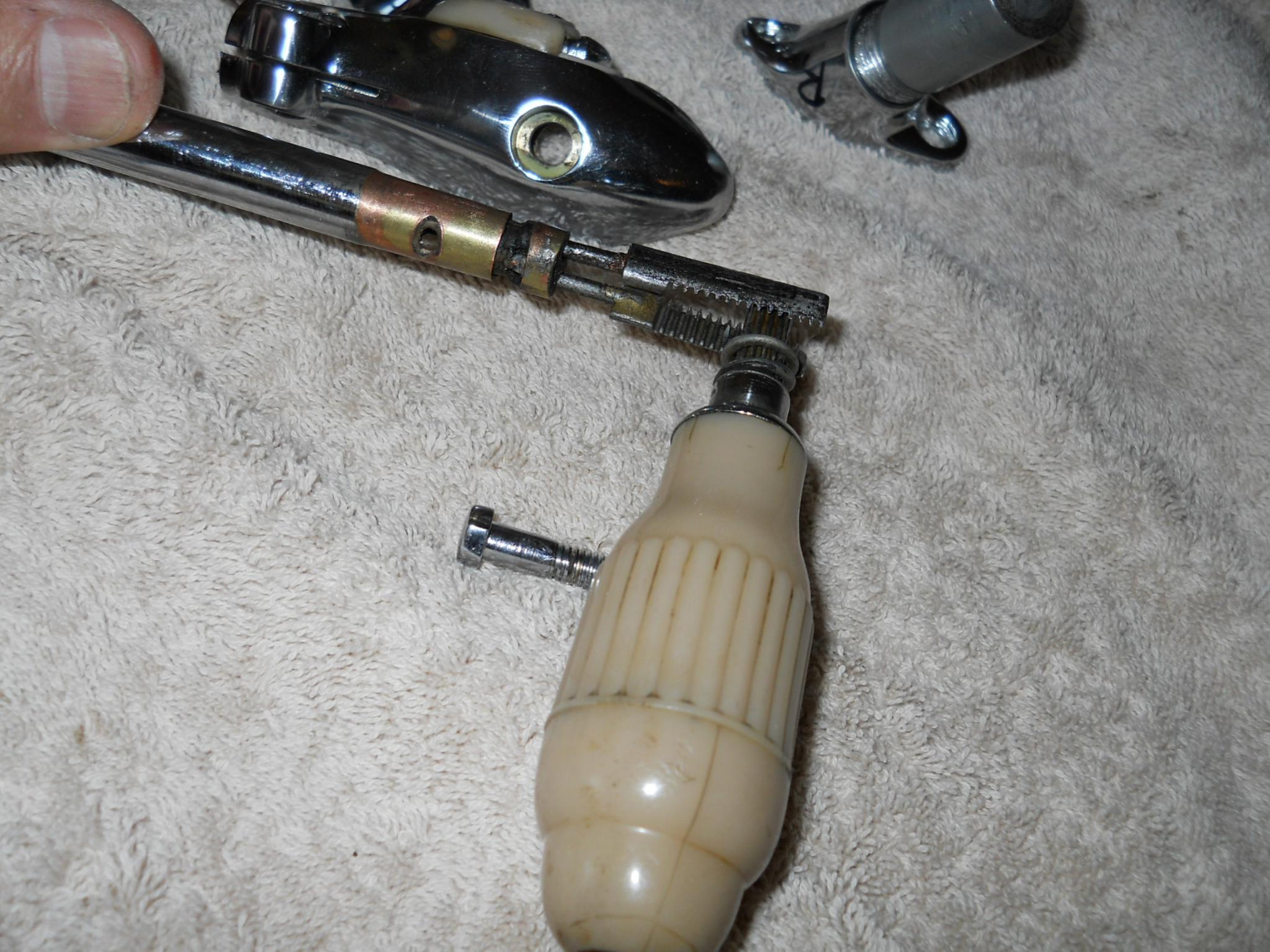

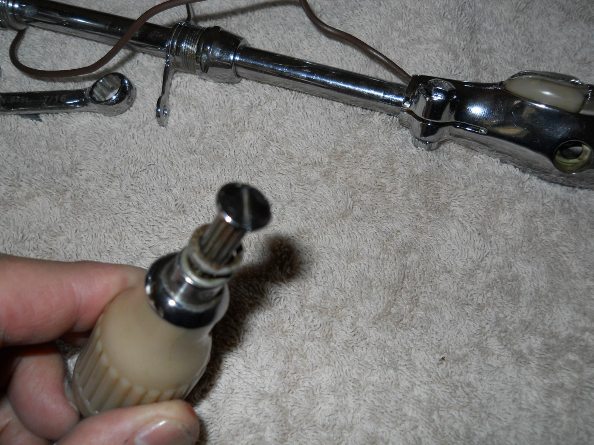

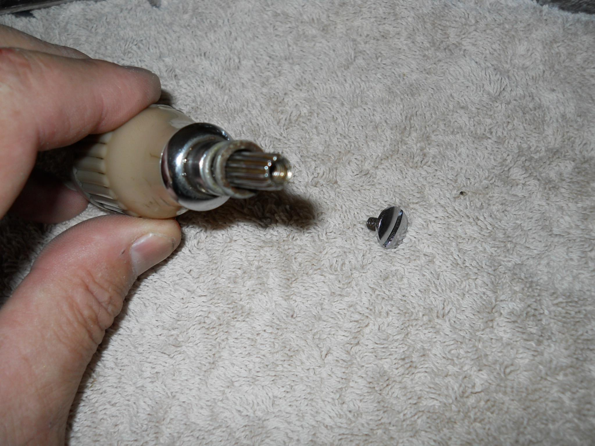

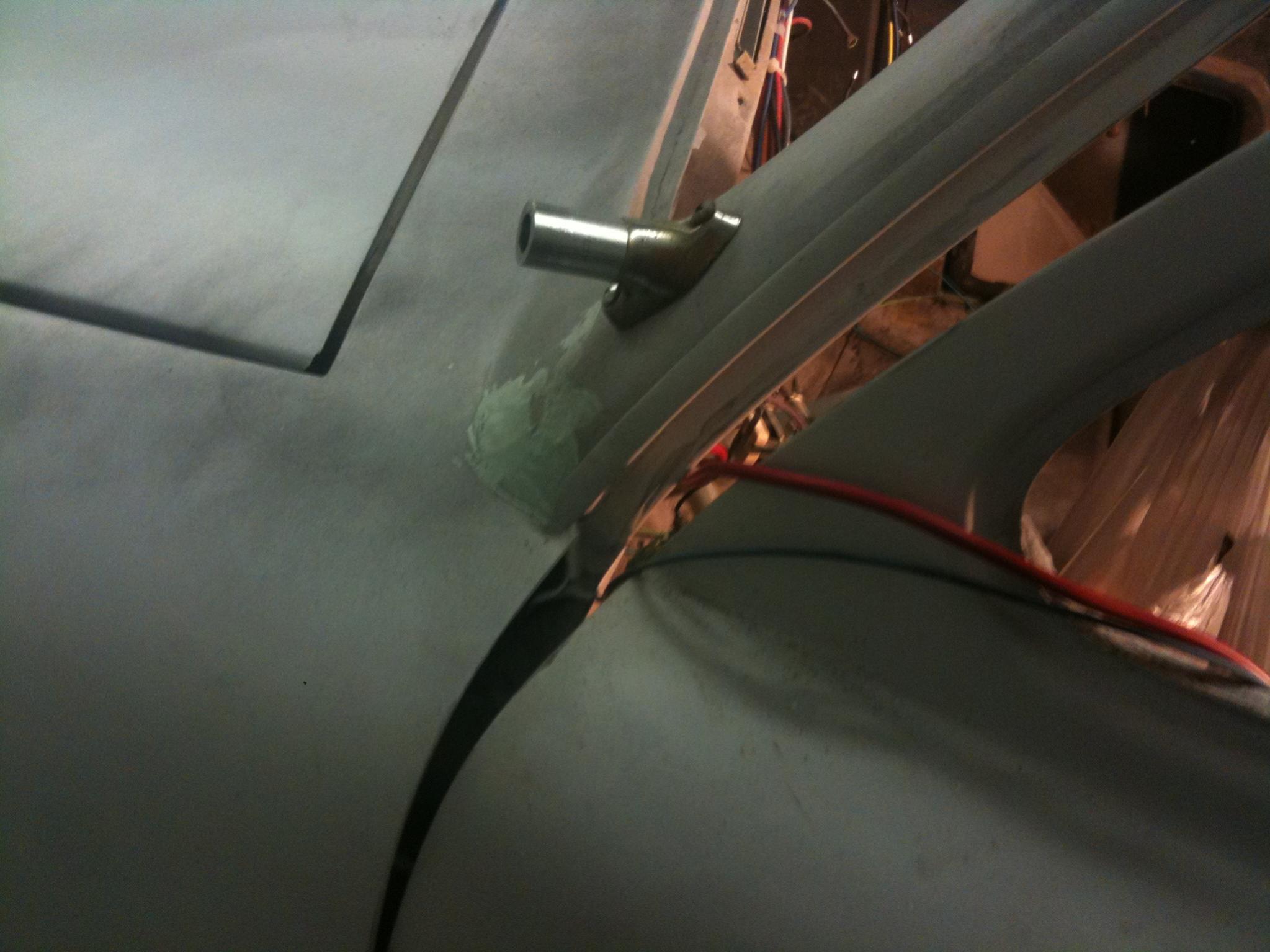

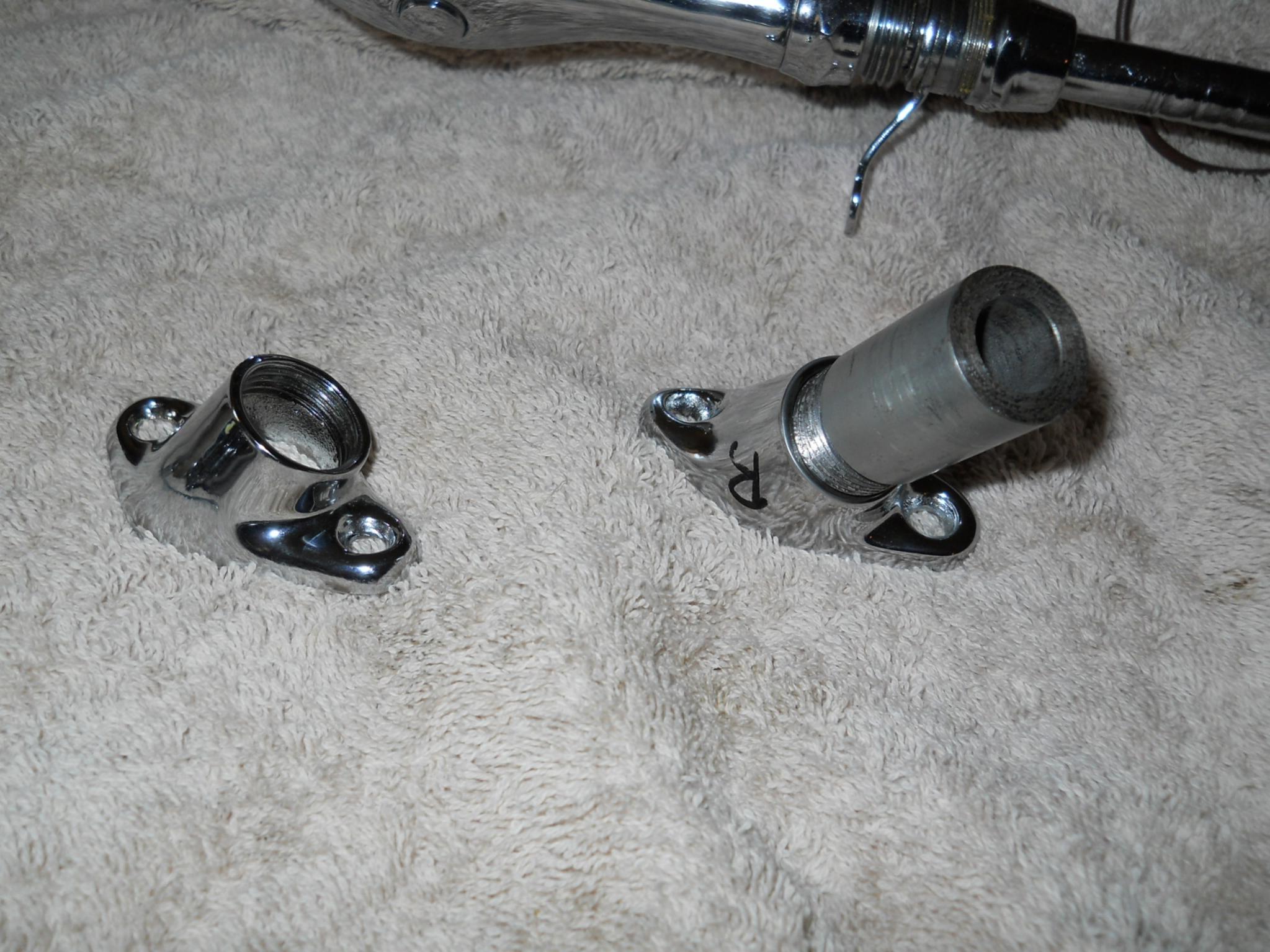

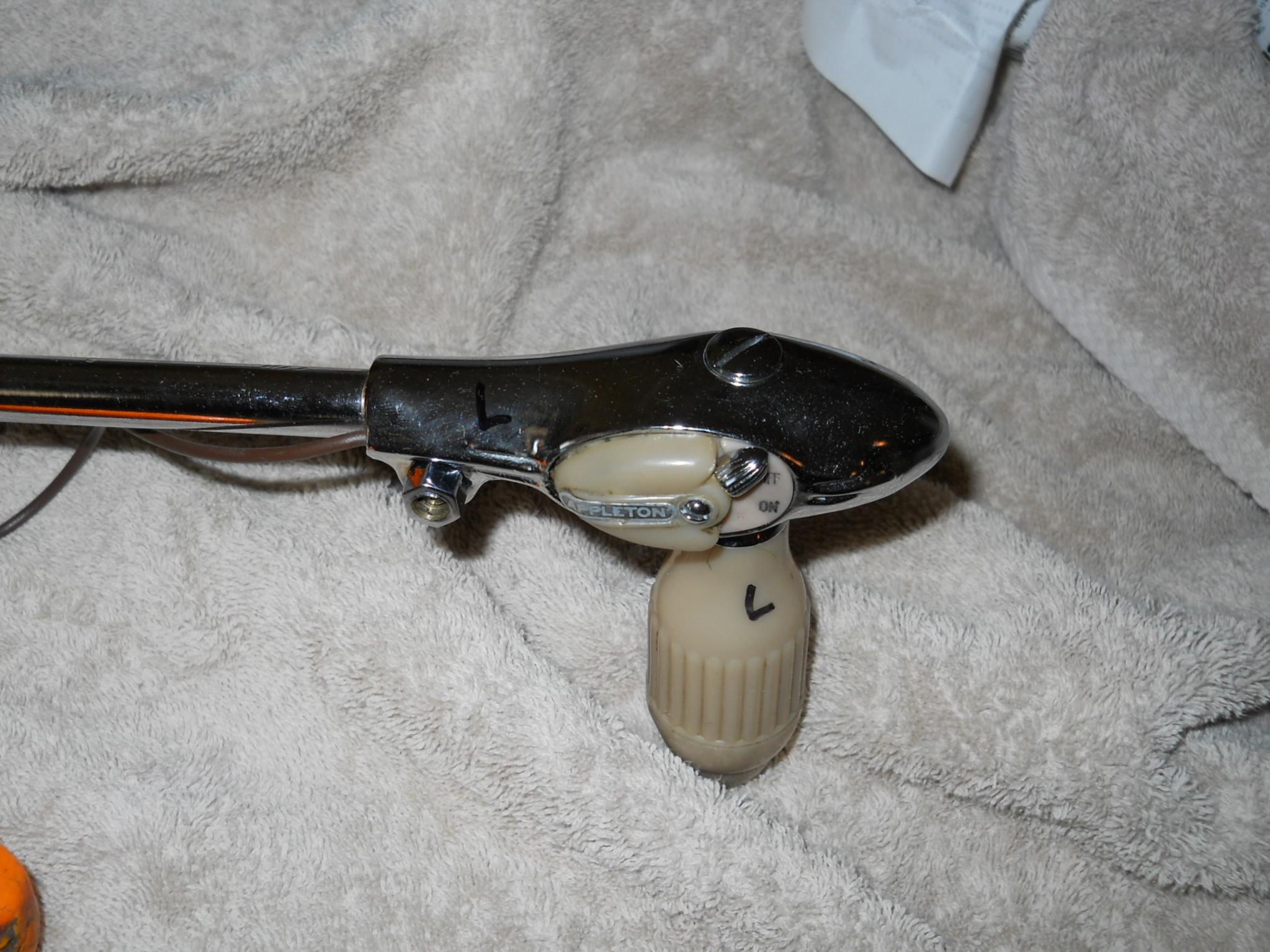

    Here's a look at the process for those not familiar with installing Appletons (Iv'e never done this before). The handle must be removed from the housing (top screw). The shaft must be pulled out of the housing. The grooves on the handle shaft make the bell (bulb housing) move by meshing with the grooves in the shaft. The shaft will be inserted through the outer bracket (on the A pillar) after its correctly positioned. The bracket is located, the guide (shown) installed, and drilled with a ½" drill bit.

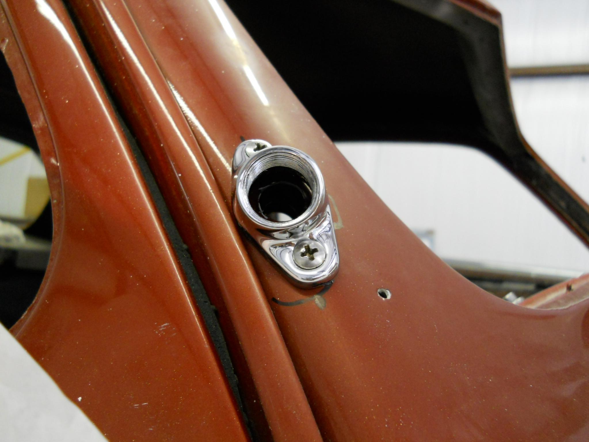

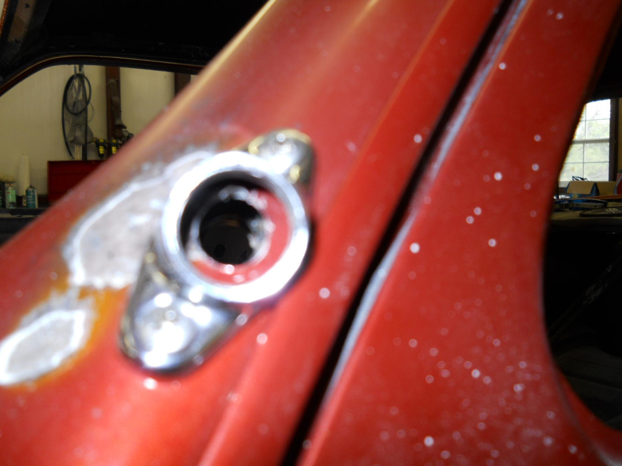

    Ok, you can see where the bracket was located prior to this redo. I had to blow up a side shot to get a feel for the correct height on the repositioned bracket. The bracket seats itself to the A pillar because of the shape that fits very good. The bracket #'s are L-975 and L-976.

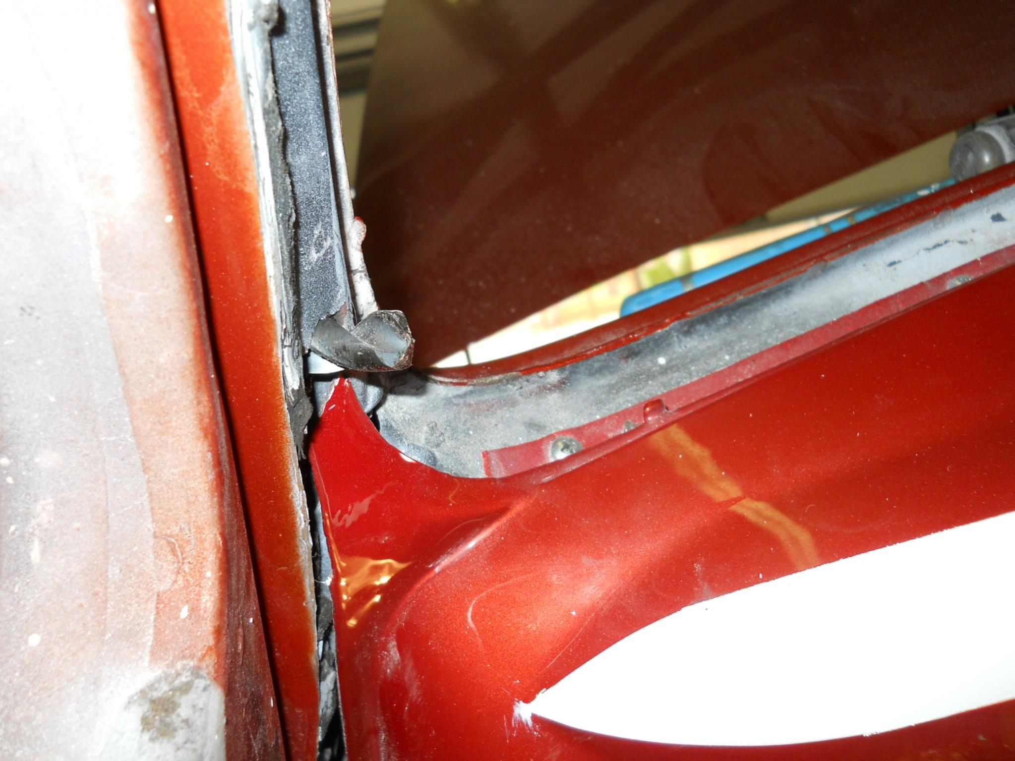

    Ive' got the brackets located and mounted and the 1/2" holes drilled. The chrome windshield mldgs (inner) may need to be notched. I'm not purposely drawing this out. It's sandwiched in between other things that need to be done.
