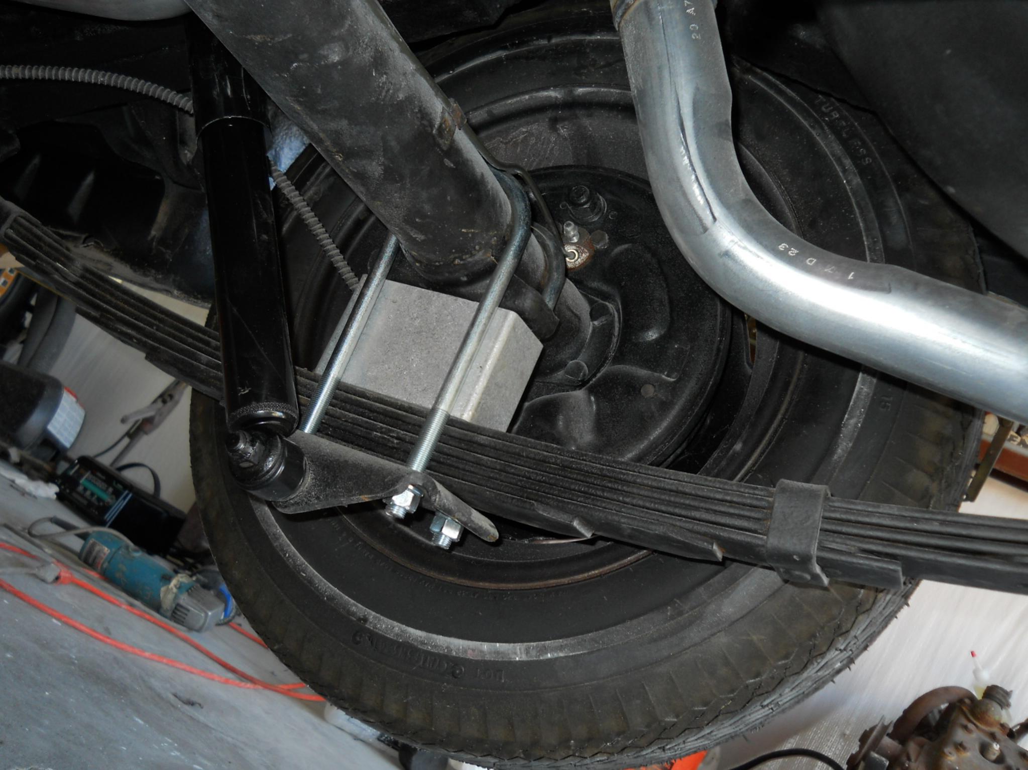

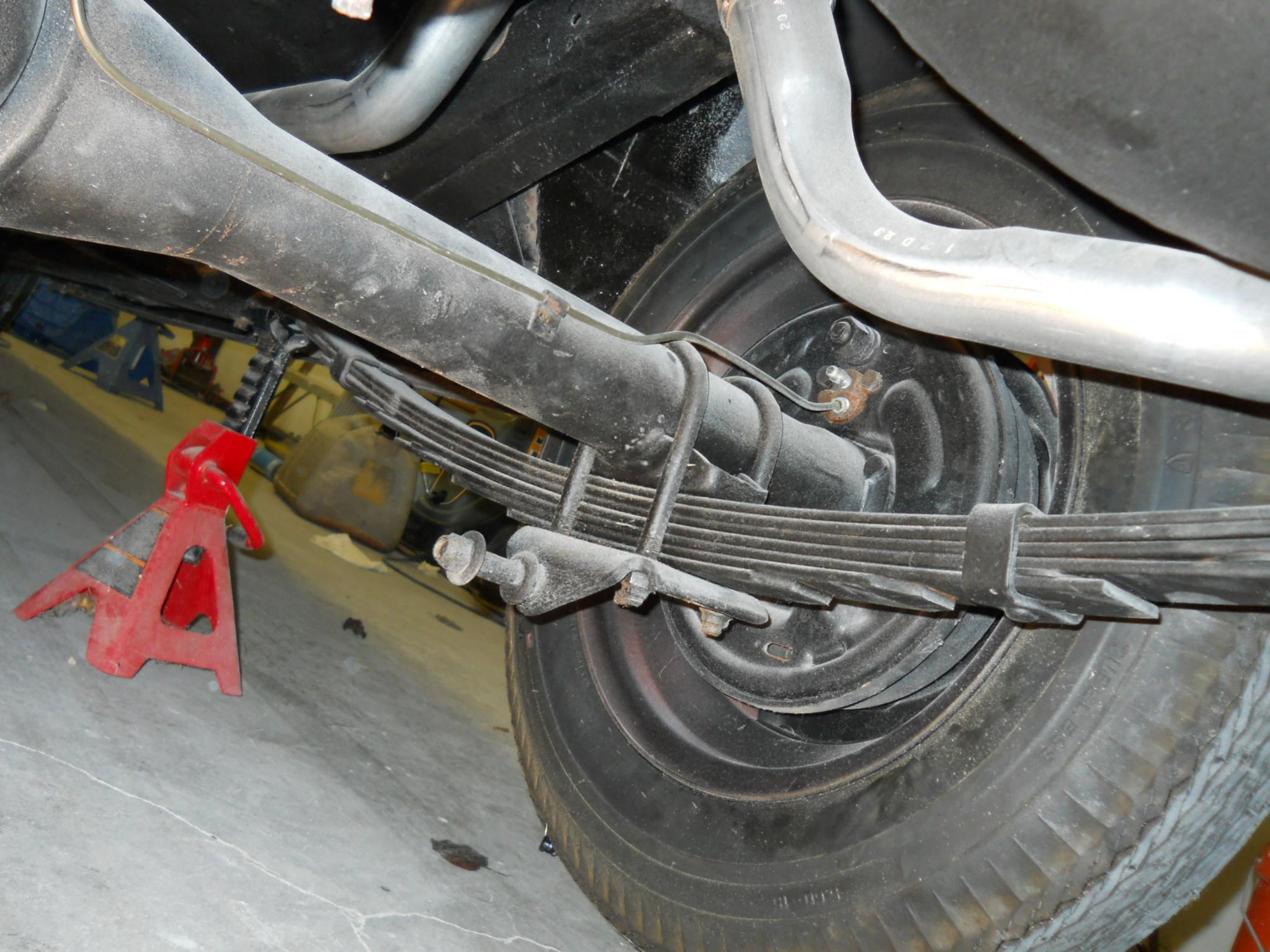

    The stock set with dearched leaf springs.

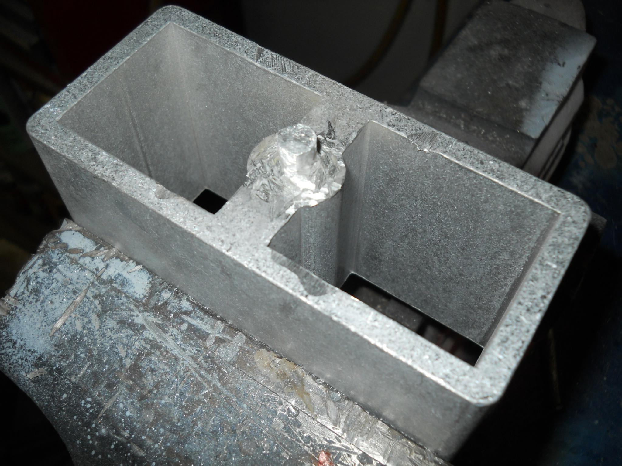

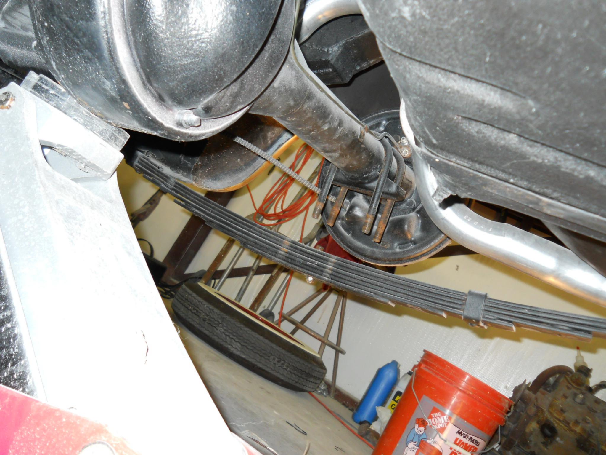

    More process (for the young n's). The 3" block needed the locator pin whittled down to fit in the rear housing.
      317.2 KB
      233
      330.2 KB
      194

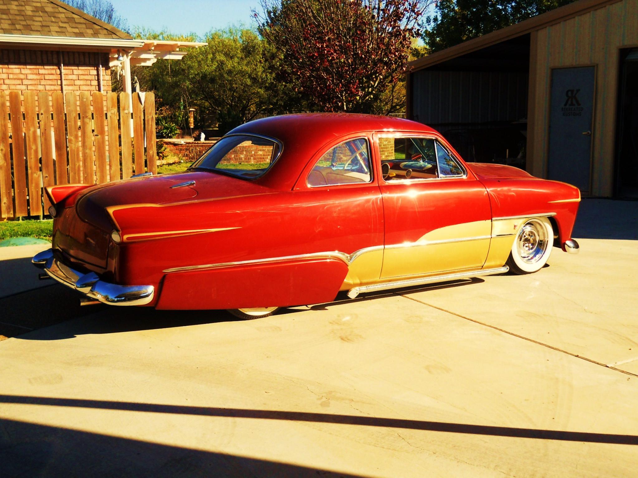

    Ok, Ok you mean sumthin like this? There's a brake line and exhaust pipe in the way of the l side shock. If I'm not going to drive it (?) do I need both shocks?
