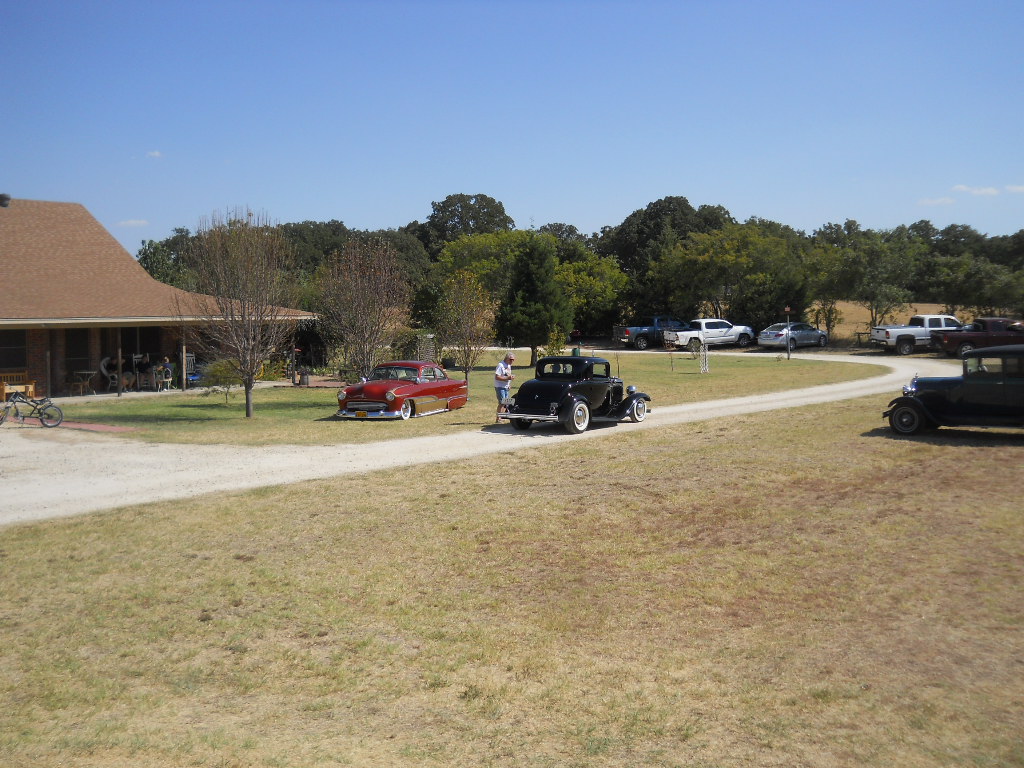

    Bill's driveway is about an 8th of a mile long and gravel. We were late because our GPS was malfunctioning. We pulled up in the trailer and asked Bill were he wanted the car. He said "right there". Unloading in front of God and everybody else was not an endearing moment.

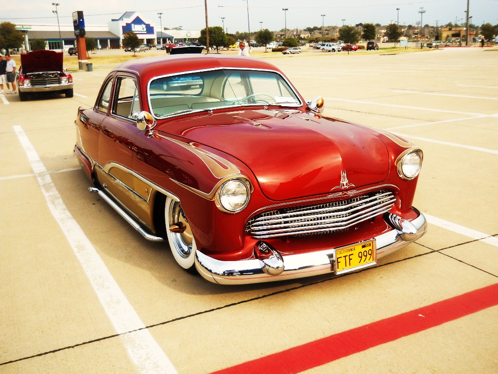

    OK, H.S. parking lot show.

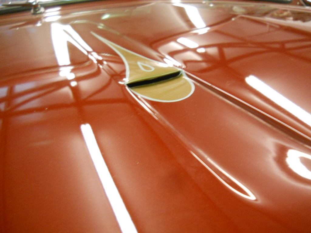

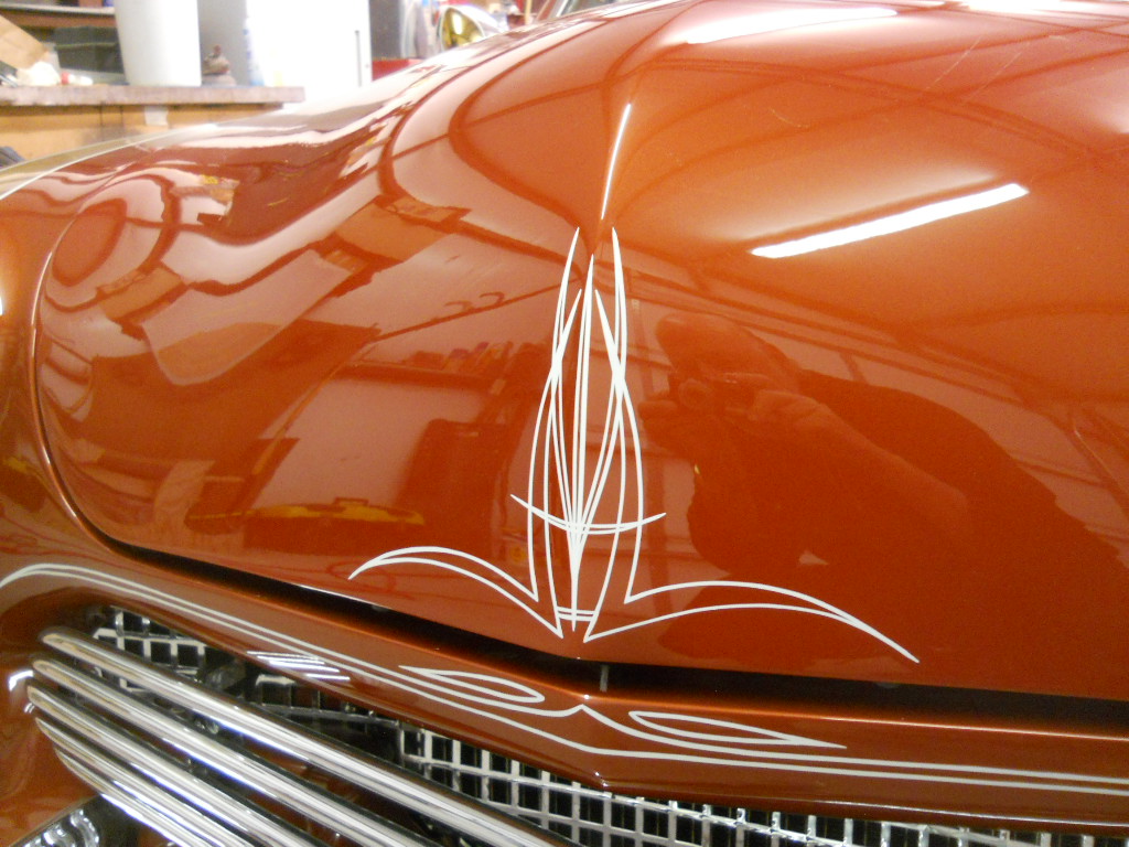

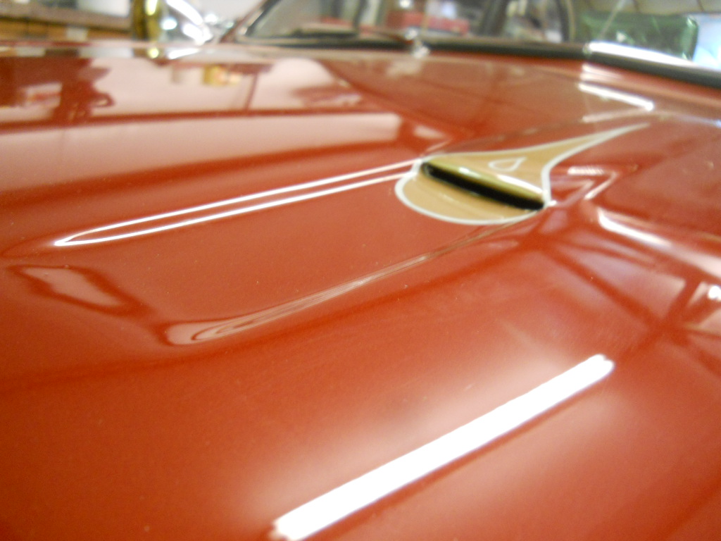

    Well, I've redone this hood for the third (and hopefully last ) time. I wanted to get a pic of the pin striper doin' this hood and now he's gone and I forgot to get it. Damn!
    The problems I was having were bubbles at the scoops. My theory is that the stretching that happened to the crisp outlines (with the rubber hammer) made the stressed metal act like a sponge anytime there was water present (wet sanding). That water was ****ed up, primed, and painted over. Later in the heat these areas would start to rust and blister.
    This time I cut all the material build up off with a DA and a straight line sander. There wasn't any water used until I had all the base/clear on it. I then cut it with 1500 wet paper, flooded it with clear and lots of pressure with my clear gun. It looked almost flat. Very little 3000 wet action after that.
    This should do it. No problems around all the reworked/welded/modified areas, just the hood. Any way, a pic of the hood being re-striped would have been cool. Sorry.

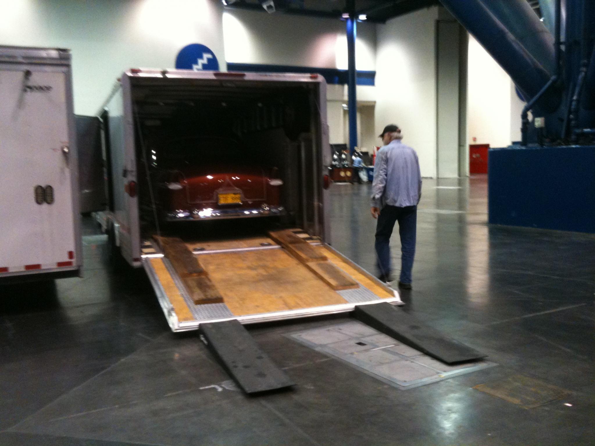

    Well, we finally arrived in Houston tuesday about 5:00. We unloaded and went to the hotel to rest. I'm using moms phone camera because I've reconfigured my little digital sure shot to take larger pictures at higher resolution to find that they won't upload here.
