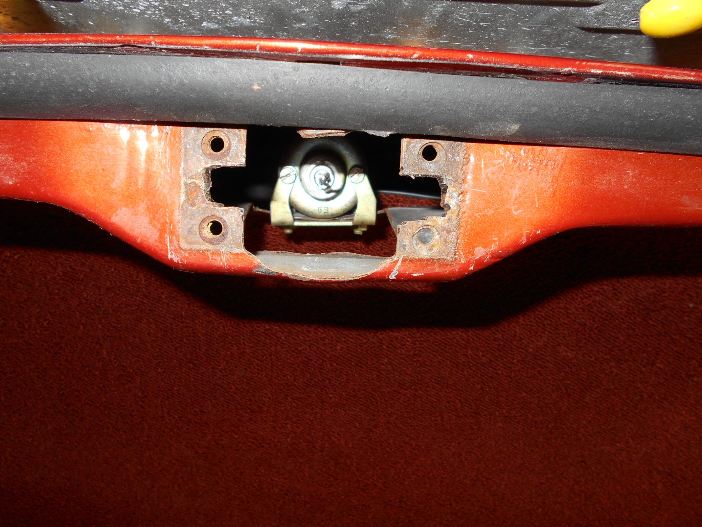

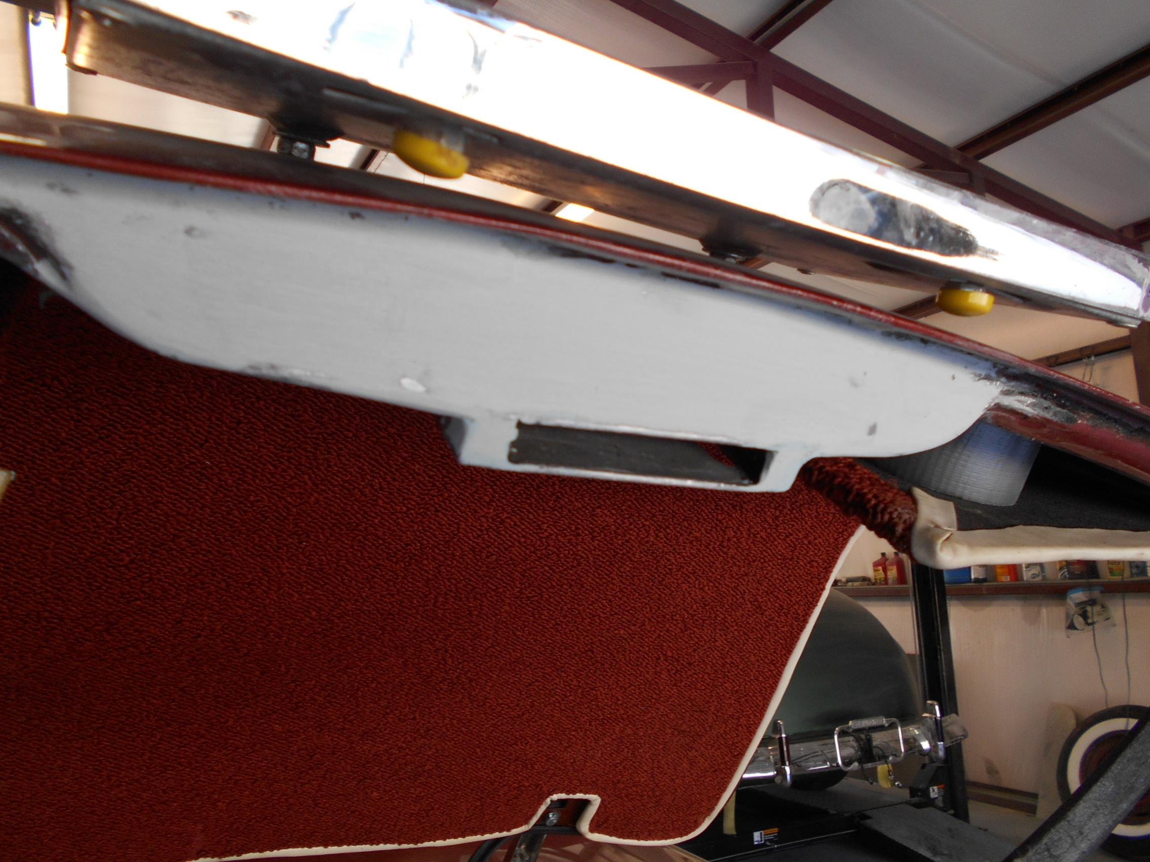

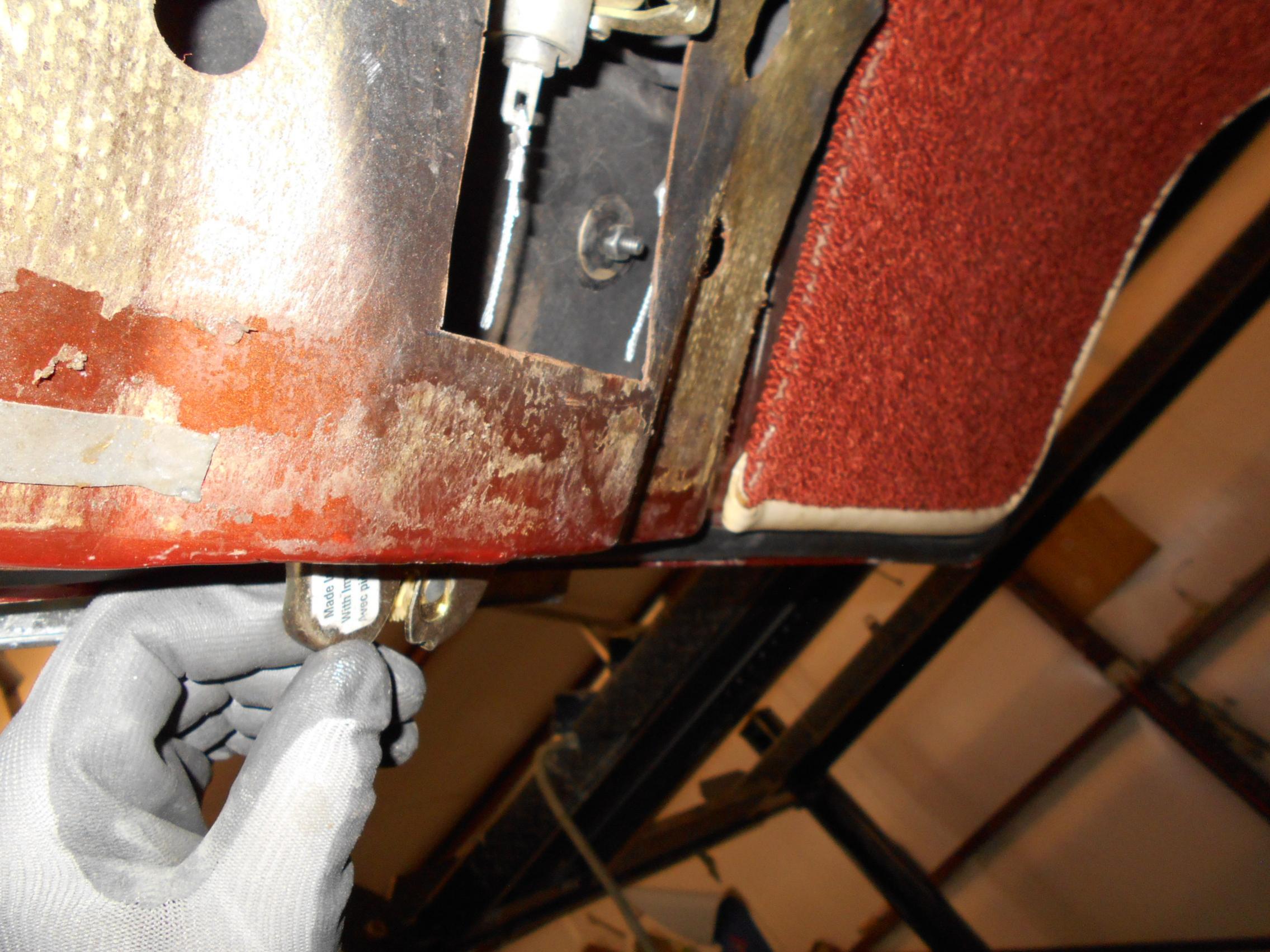

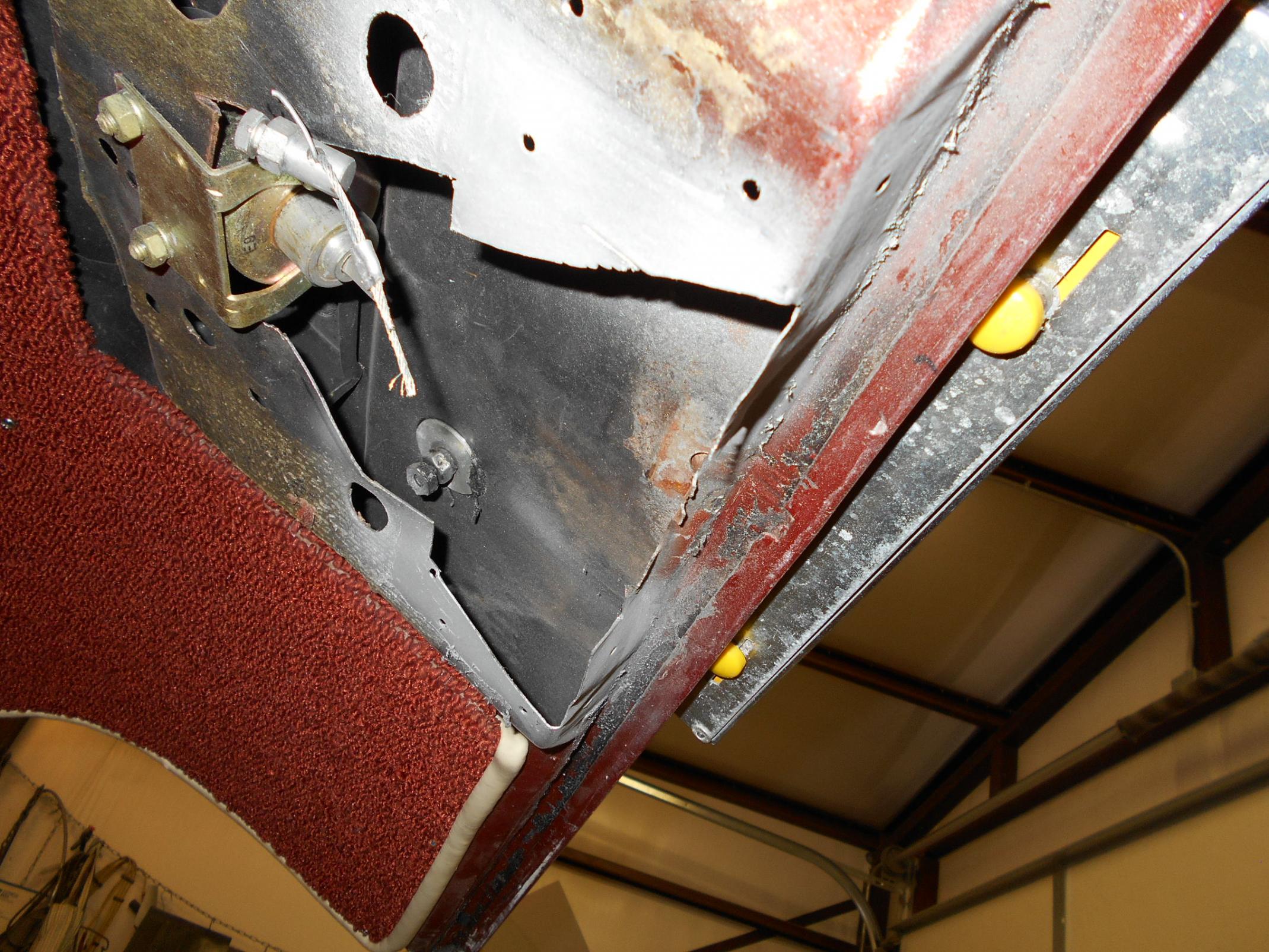

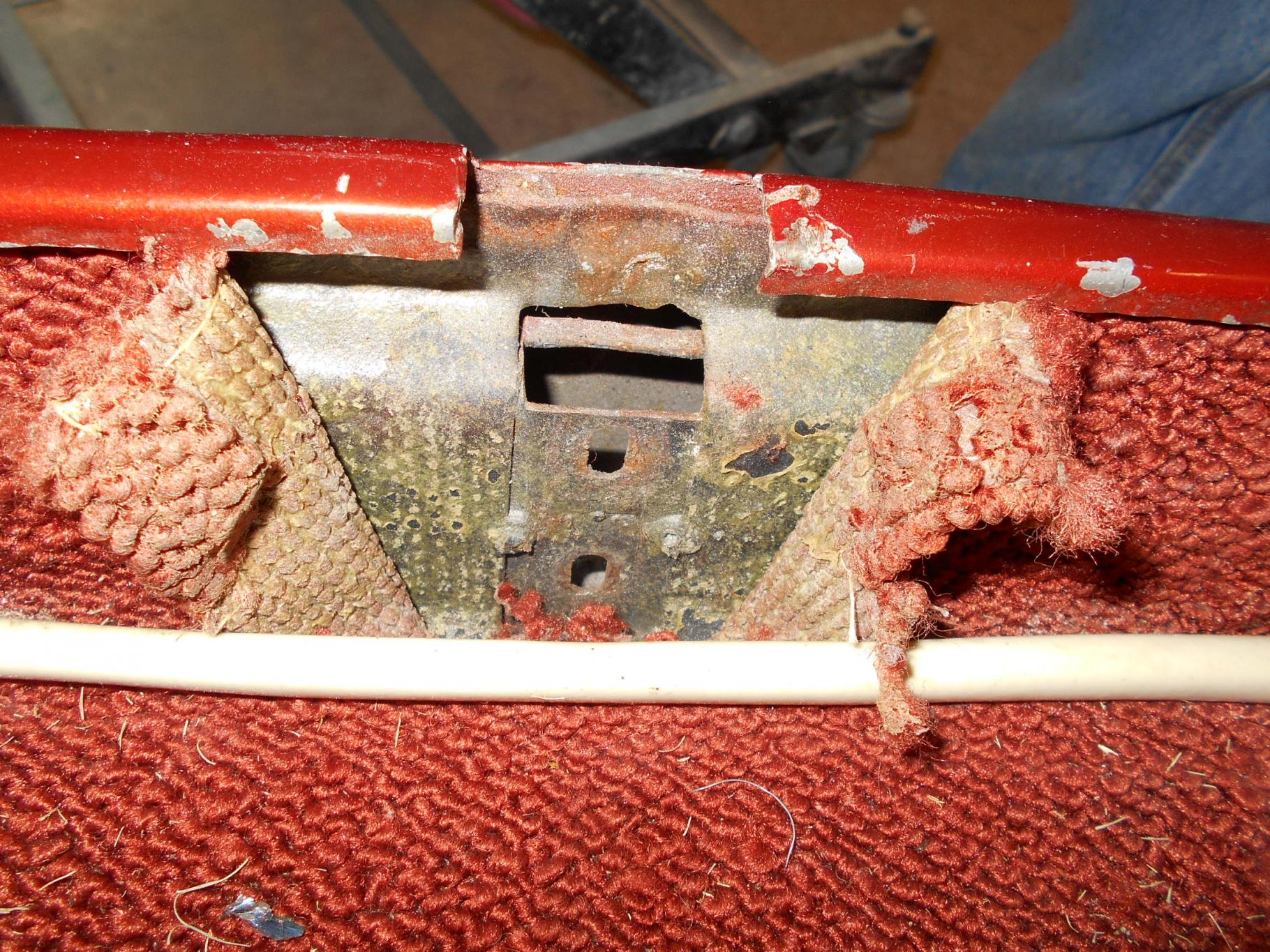

    I need to make a template of the new latch's shape. I'll move it around to find the correct position for it. I have to do something about the original hole for the OEM latch.
  2. jivin jer
    Joined: Sep 14, 2008
    Posts: 3,491
    jivin jer

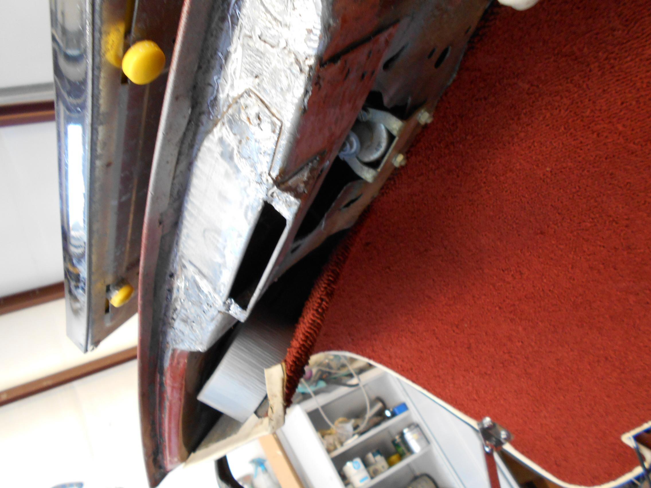

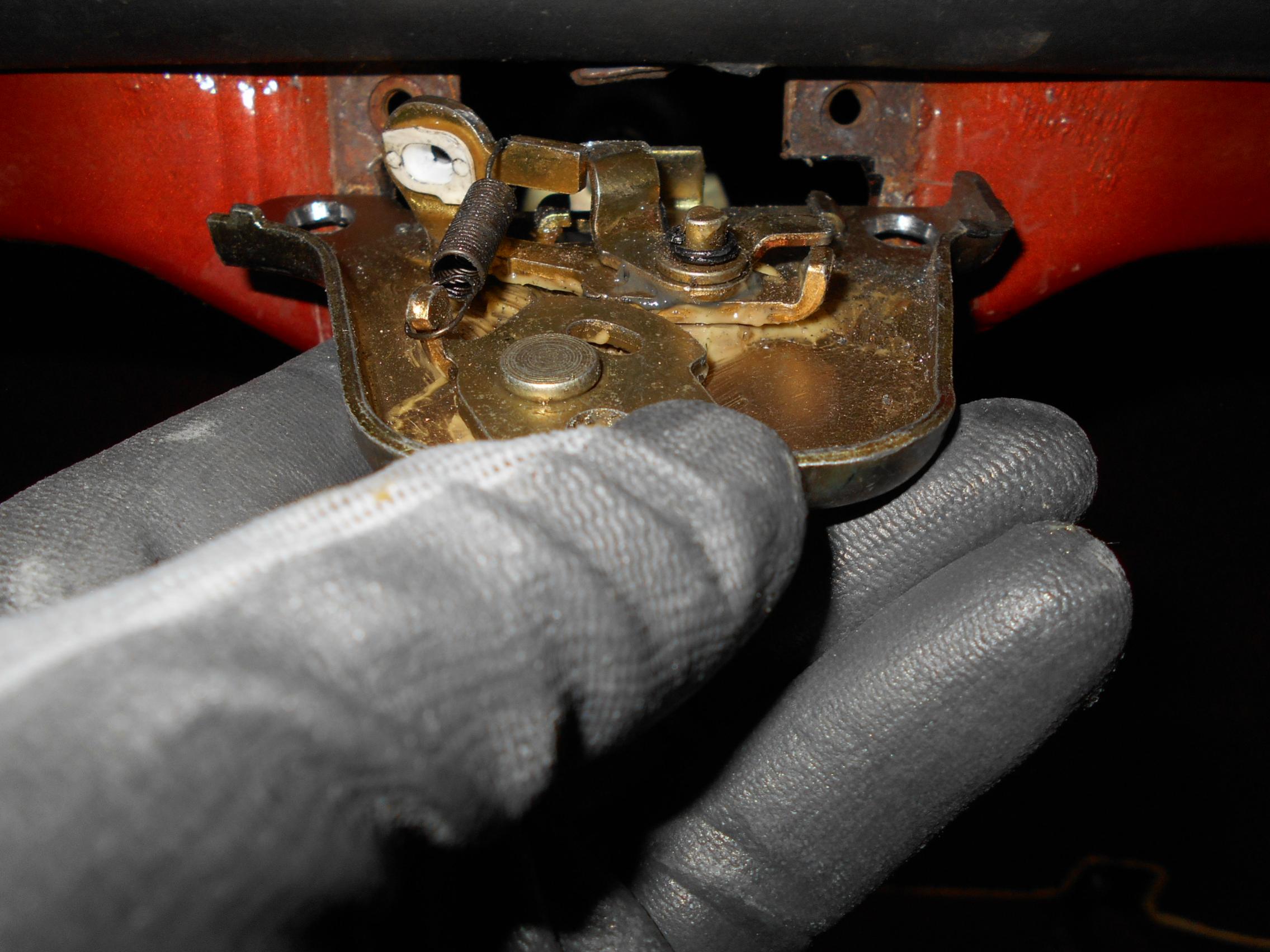

    Here is the OEM stricker removed. The latch is ideal because of it's size and, the upward action of the release mech.
  3. jivin jer
    Posts: 3,491
    jivin jer
    What are we going to have to do to make this work?

    Well, after trying to buy a correct striker and thinking its coming, we find that its no longer in stock and, no one told us. So, we have to make our own.

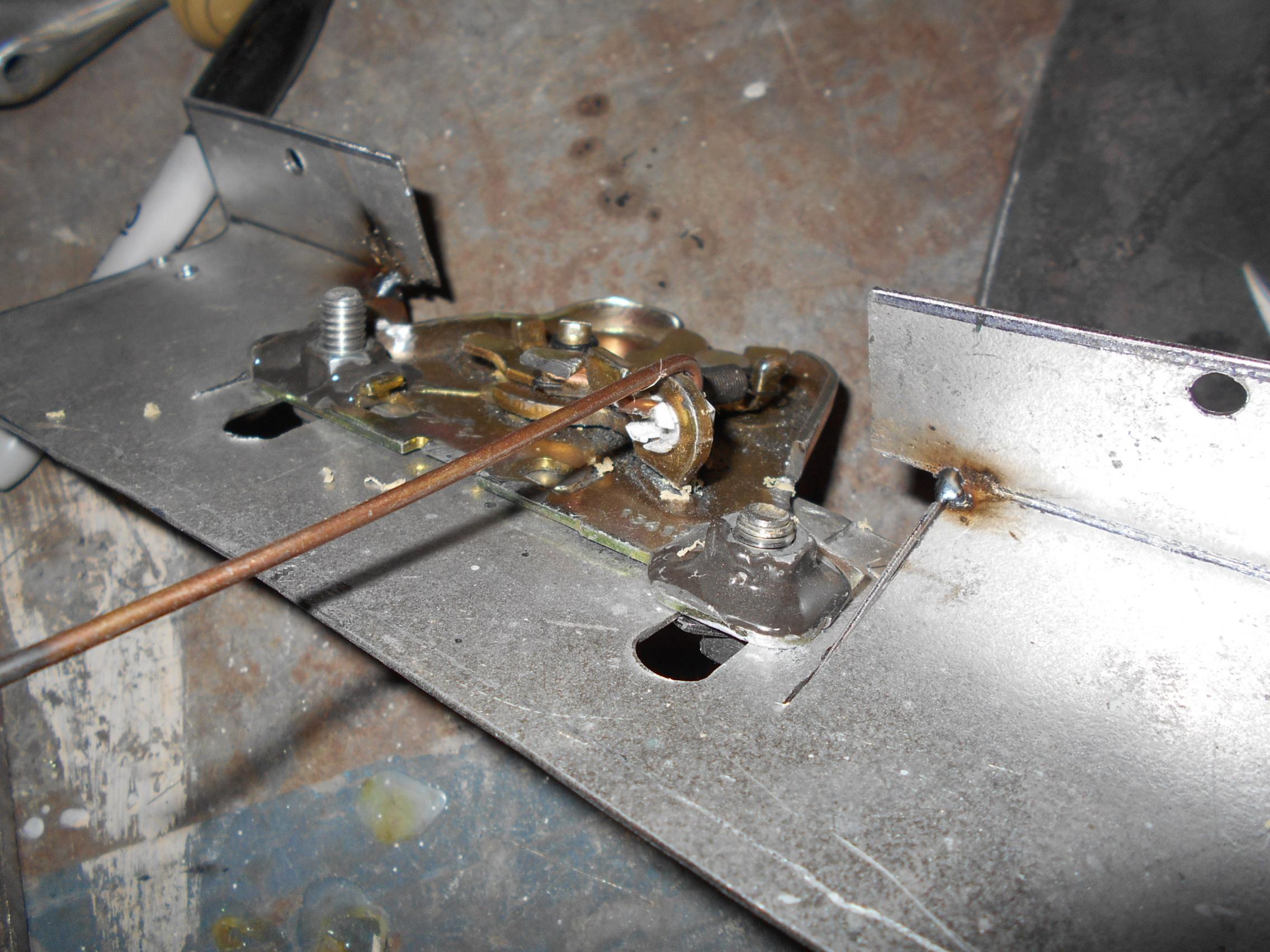

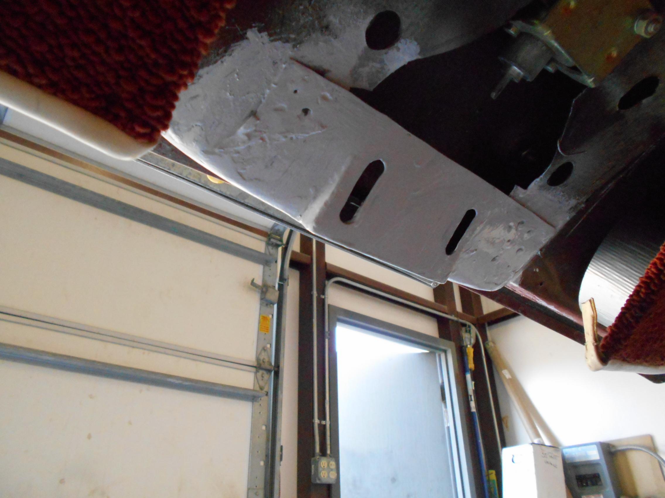

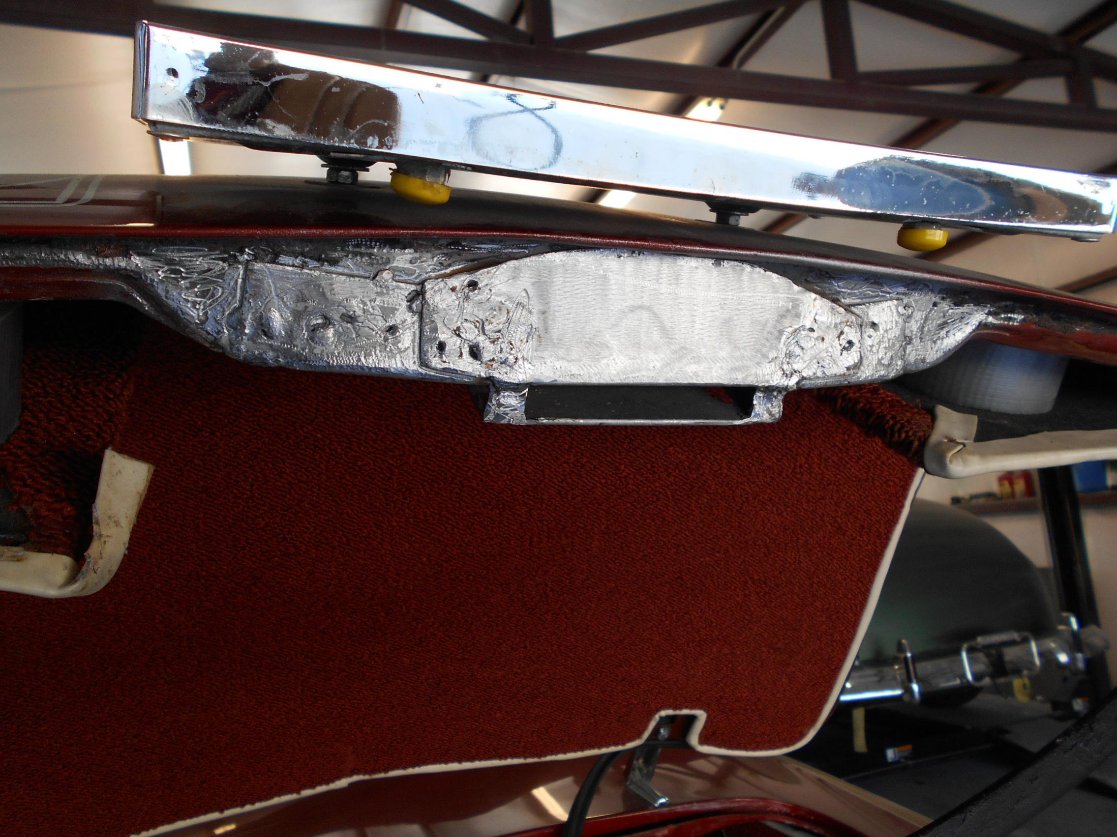

    I start with some heavy paper and the latch and start to make a template for the latch panel.
  6. jivin jer
    Posts: 3,491
    jivin jer
    The template translates into a metal panel that will fit and provide the latch a place to bolt too. The latch area needs to be tipped inward (toward the front) to have the correct angle as it makes contact with the striker.

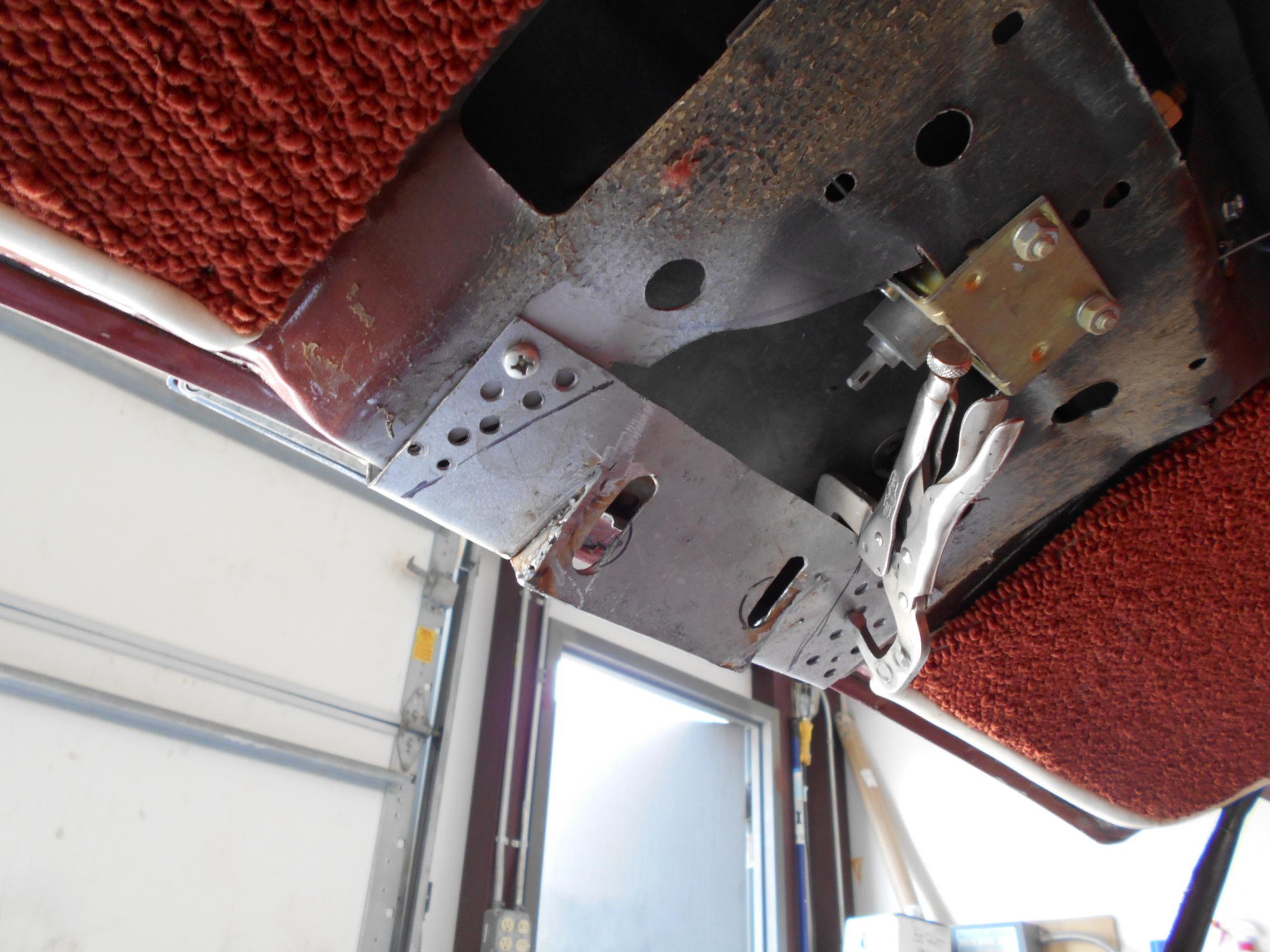

    When I am happy how it fits, and works, I drill spot weld holes. Weld thru primer.
  9. jivin jer
    Posts: 3,491
    jivin jer
    clamped in place, ready to spot weld. Lets protect the carpet.
  10. jivin jer
    Posts: 3,491
    jivin jer
    spot welded in place.

    I added a plate to make things look a little better.

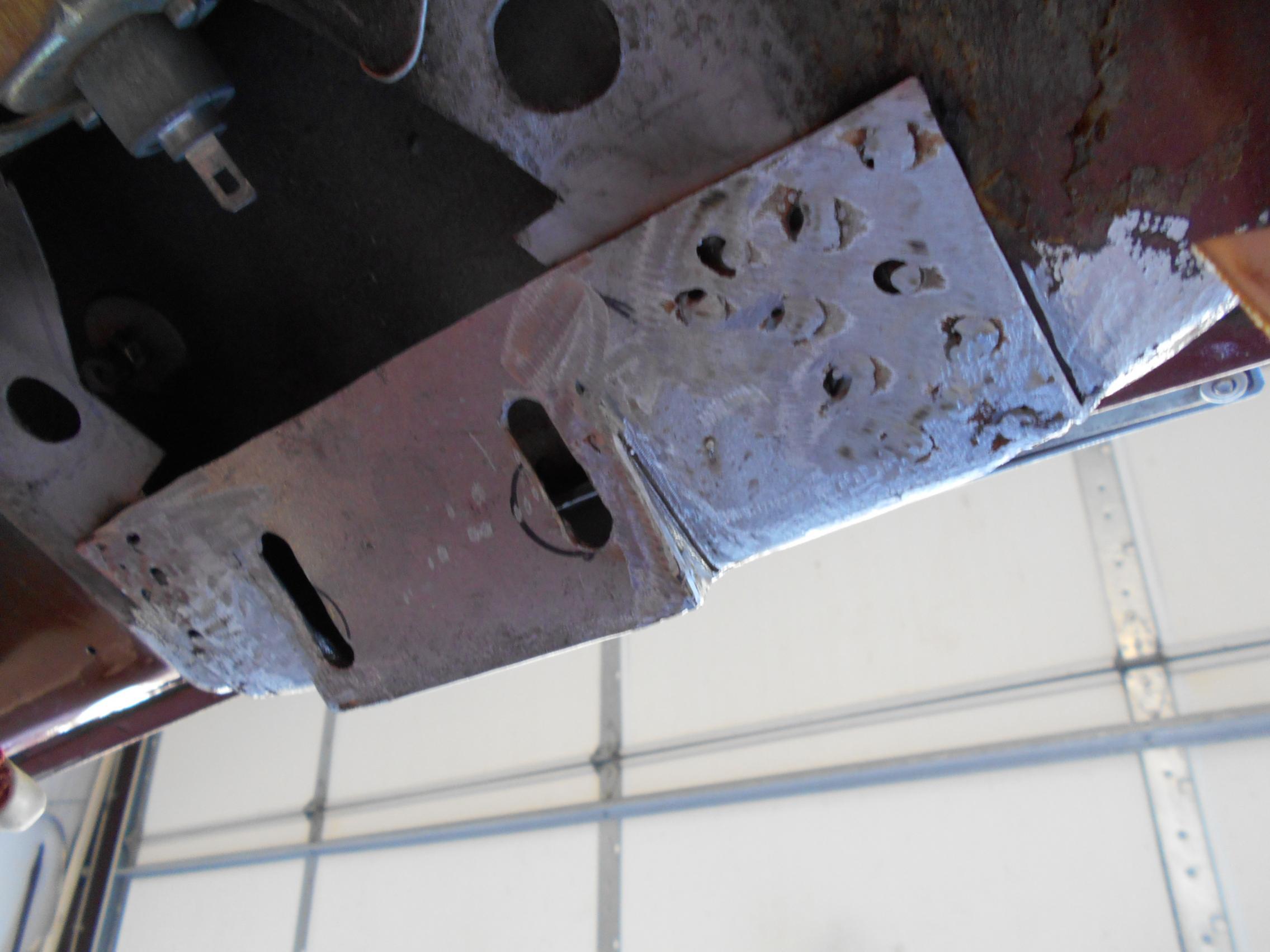

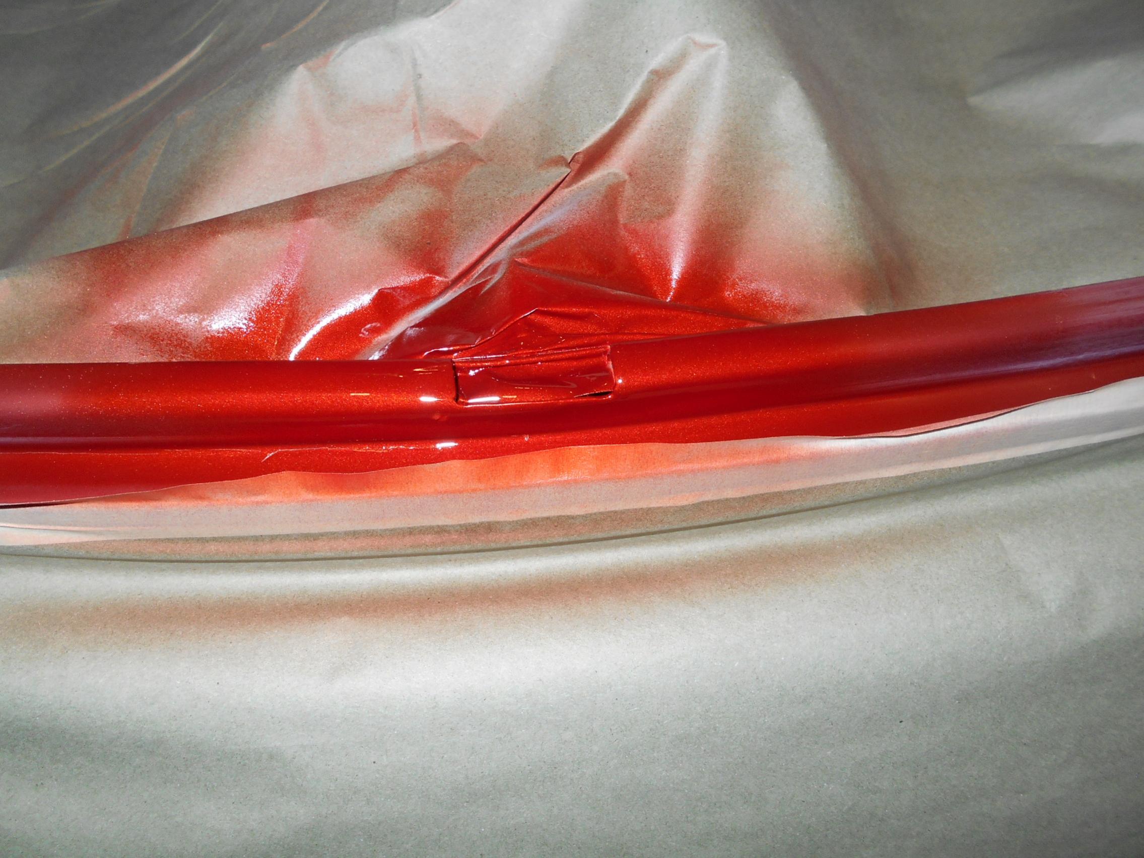

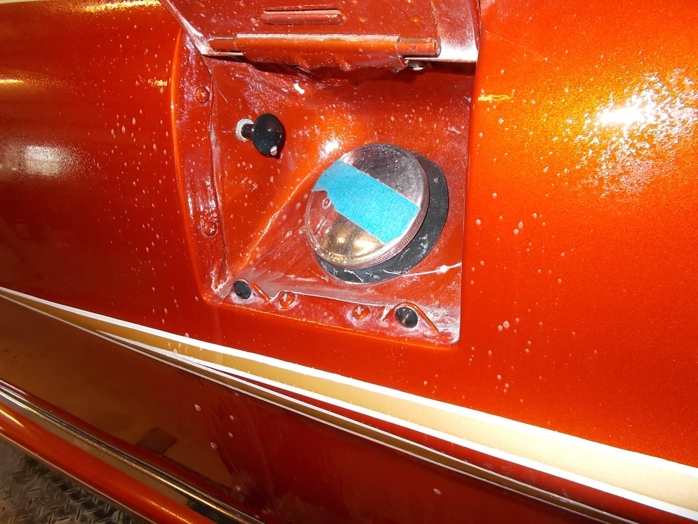

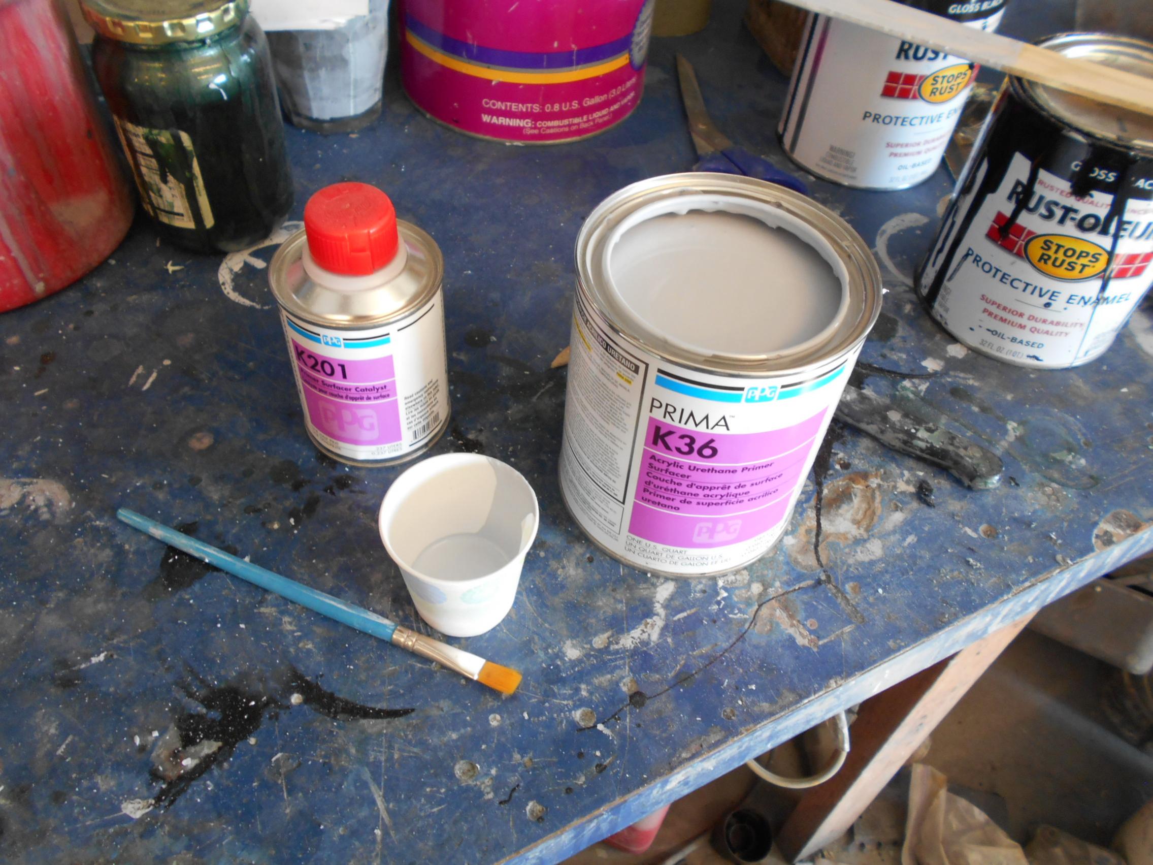

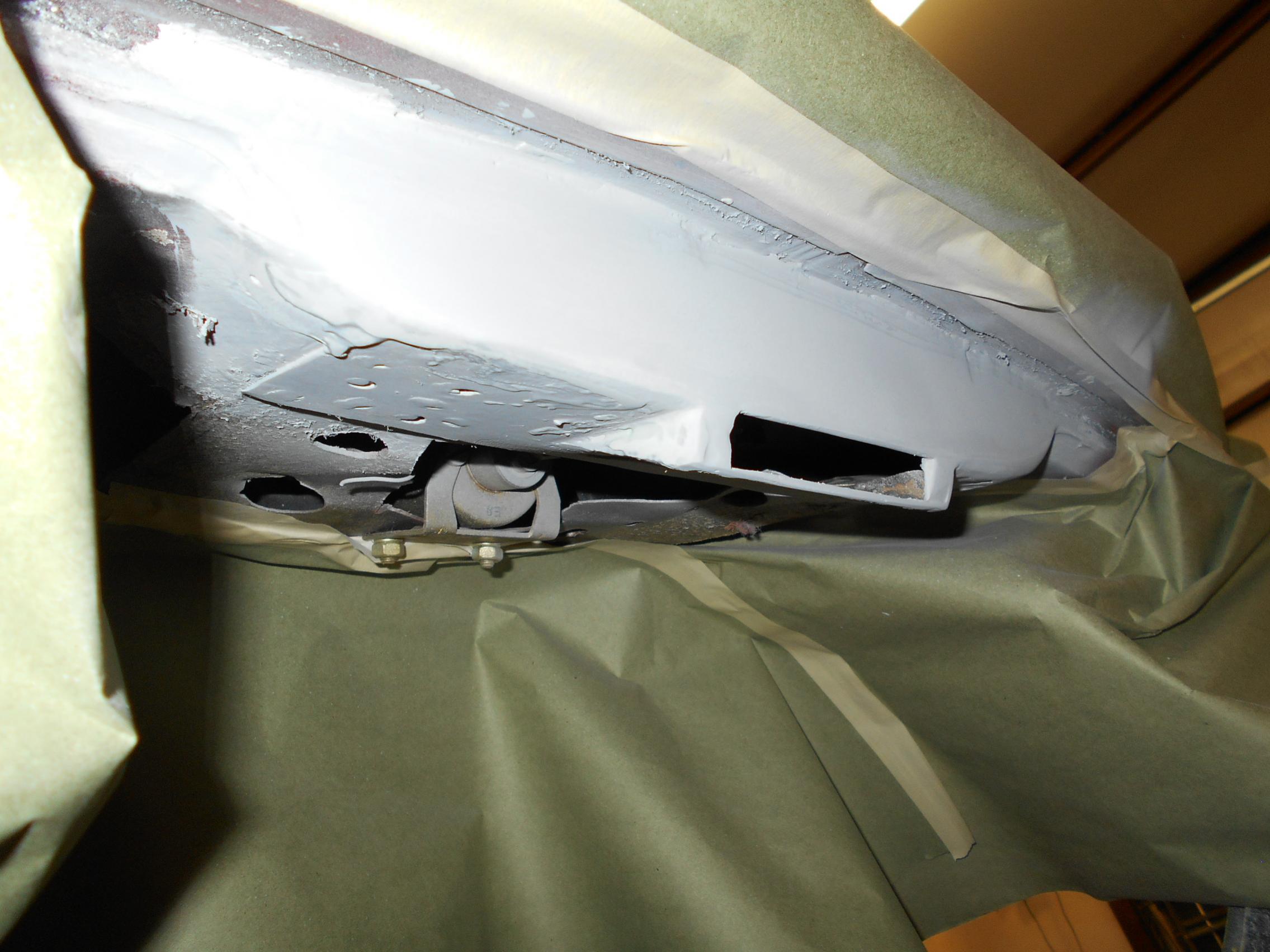

    A "swipe" of bondo and some K-36.
      366.9 KB
      581
      239.9 KB
      466
      397.1 KB
      502
      287.1 KB
      524
  13. jivin jer
    Posts: 3,491
    jivin jer

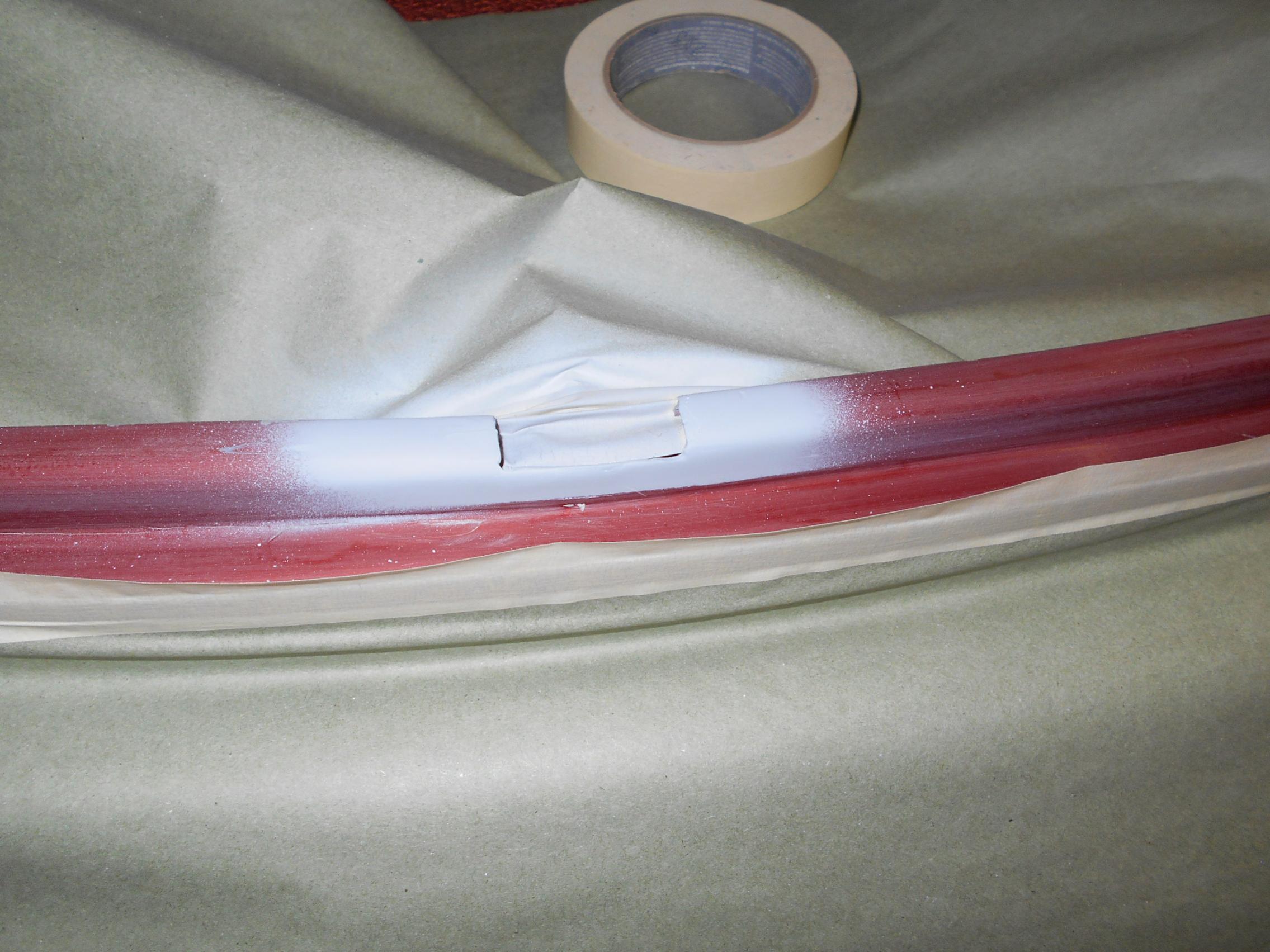

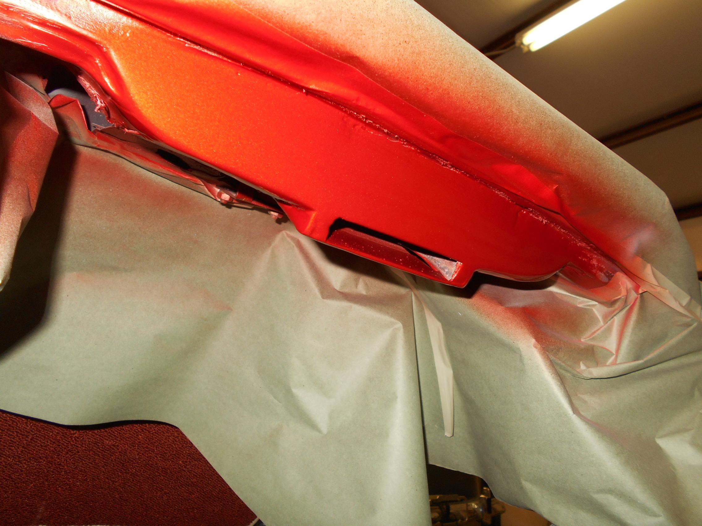

    I want to follow up the bondo with a quality glaze coat to deal with any deep scratch's.
      365.1 KB
      378
      332.6 KB
      367
  14. jivin jer
    Posts: 3,491
    jivin jer

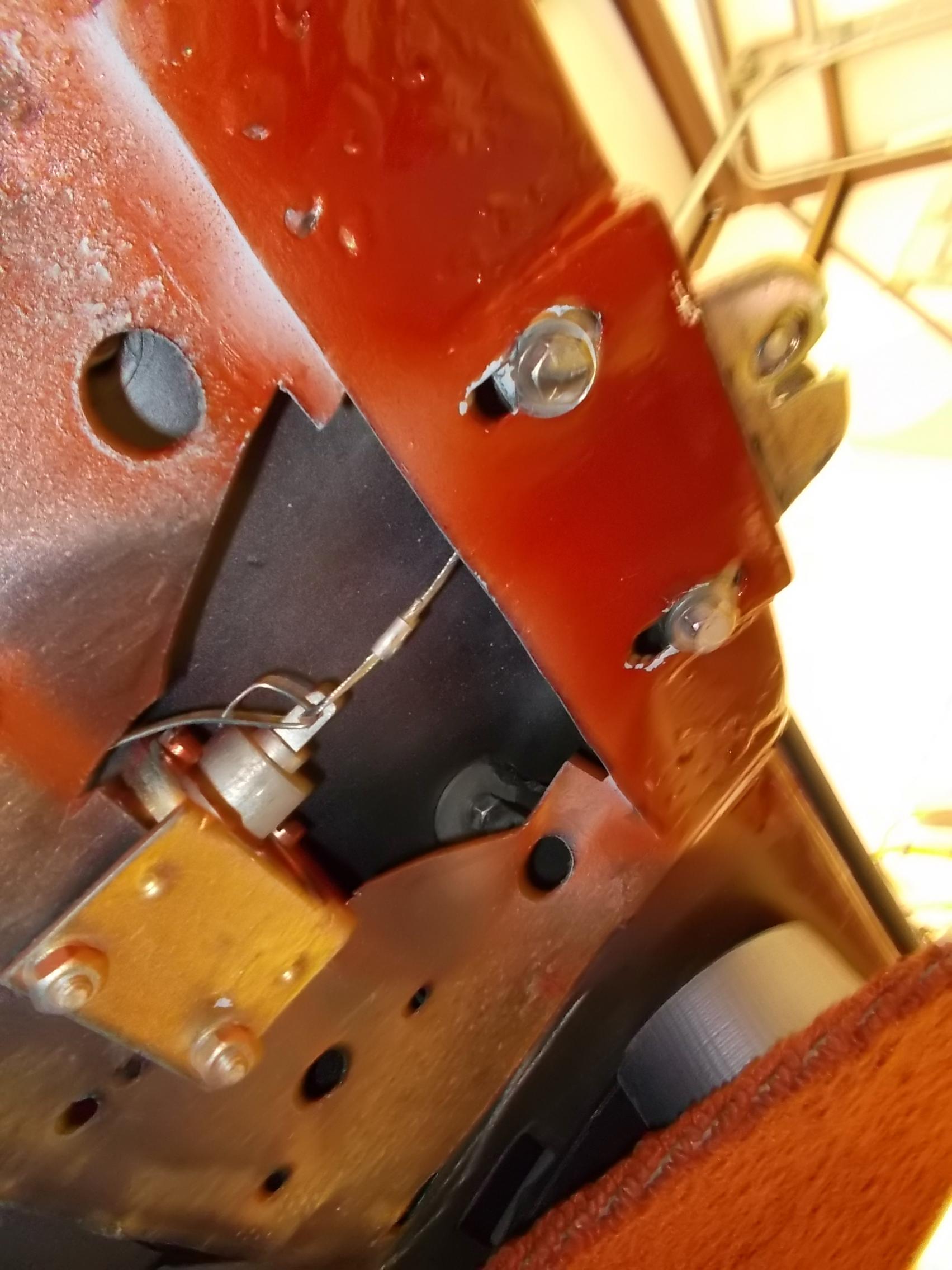

    I finish off the glaze with 320 grit and spray it with Rustoleum rattle can primer/sealer. We might as well do the lower area.
  15. jivin jer
    Posts: 3,491
    jivin jer
    Base/clear.

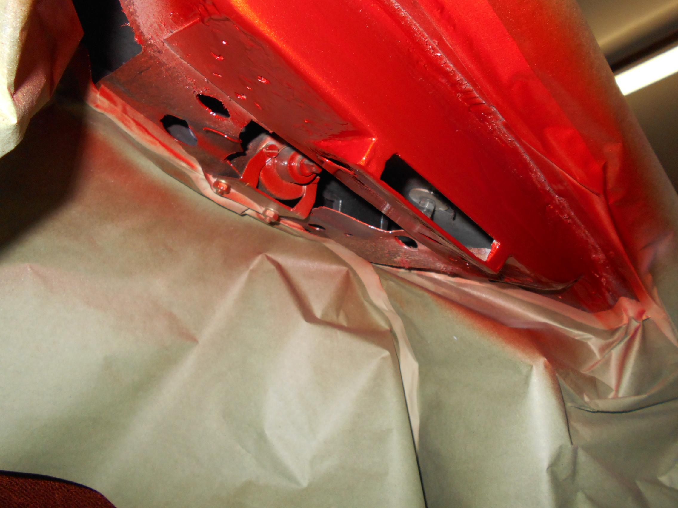

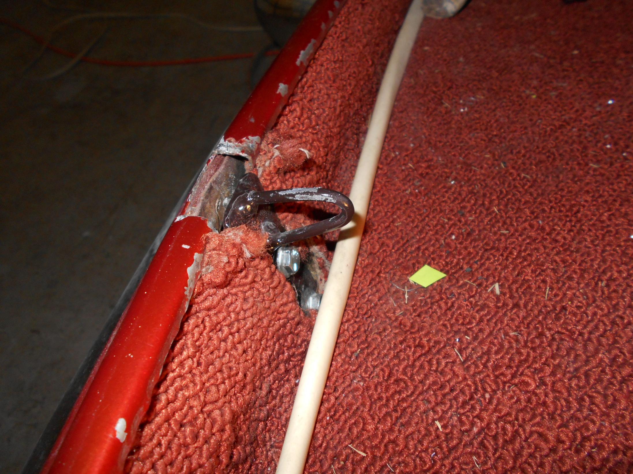

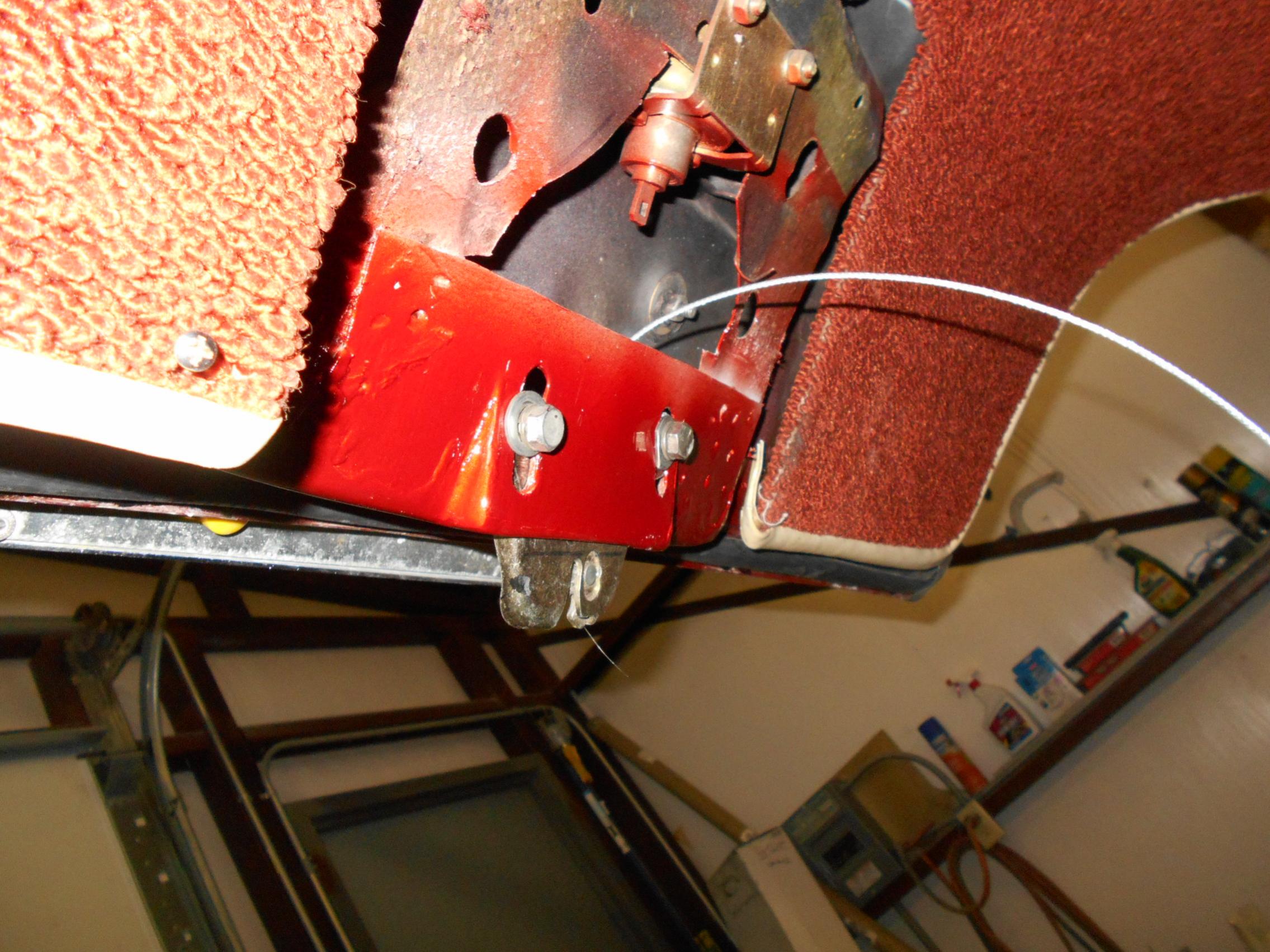

    OK, we're done. First pic shows linkage. That wire is an emergency cable if there is no power. All*****oned up.

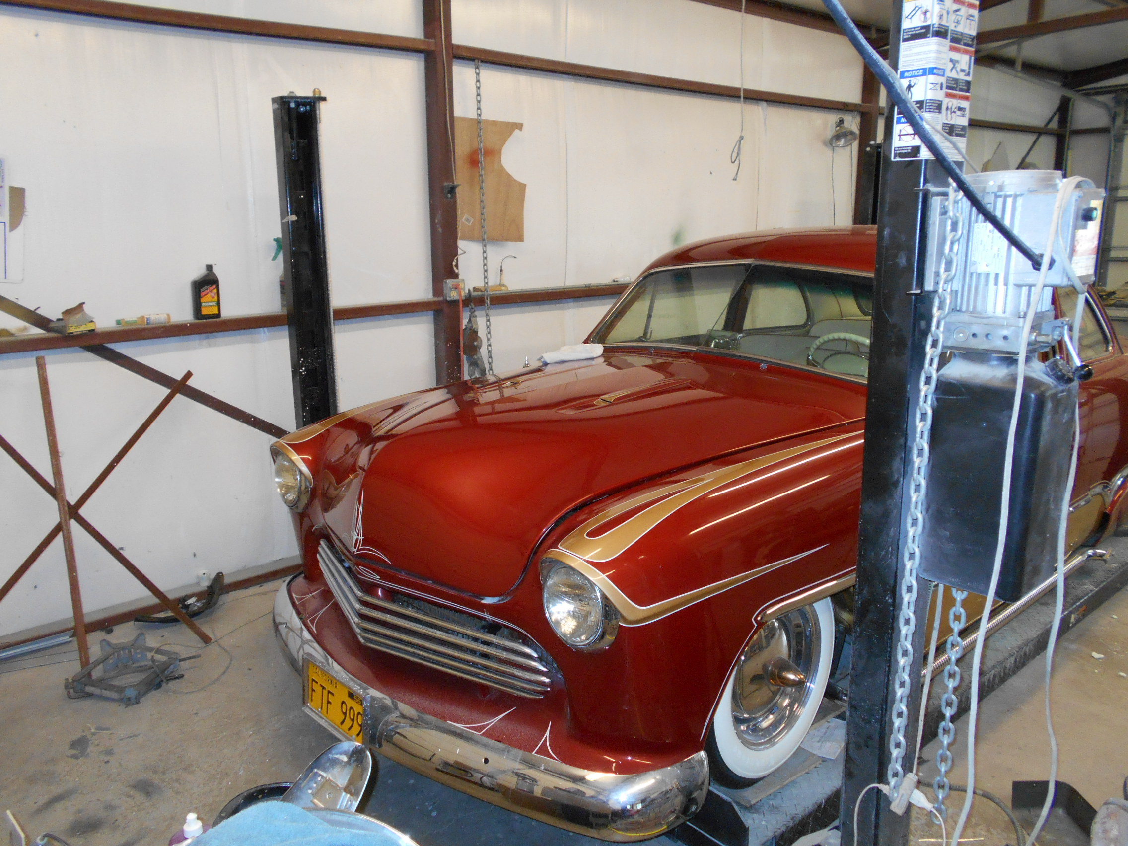

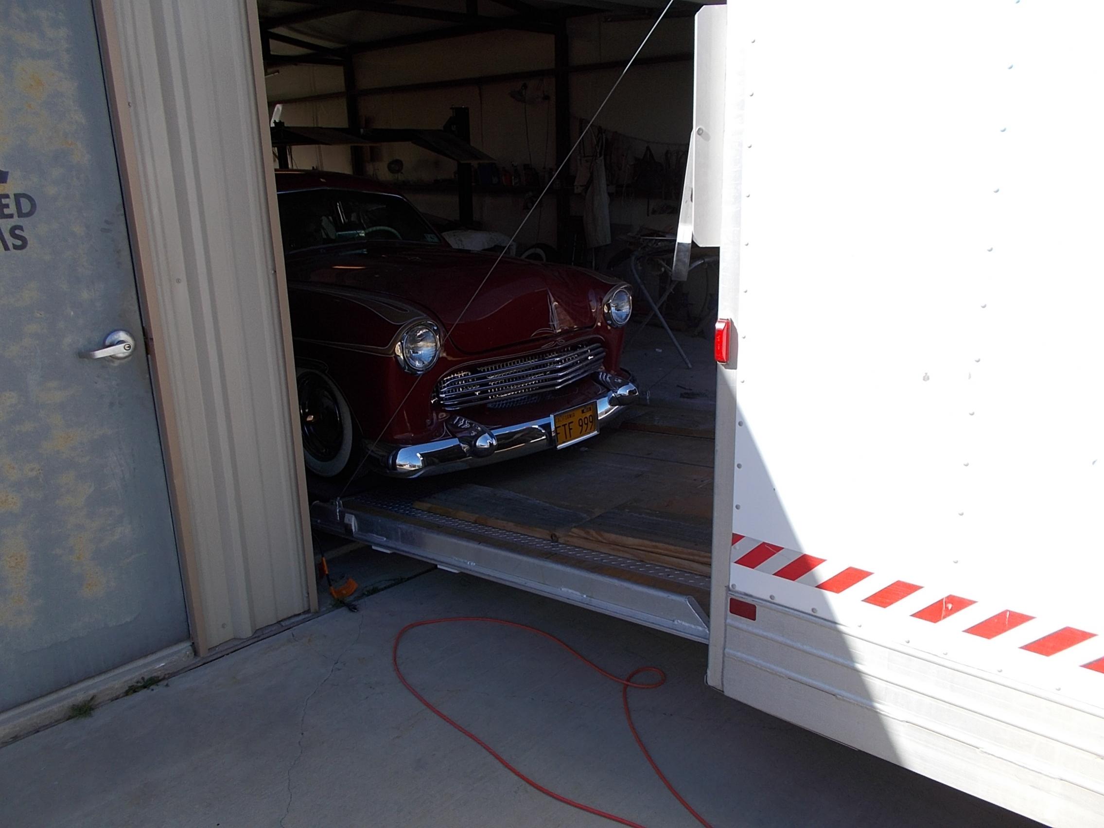

    OK, here we are at Mike Millers shop for that clutch.

    In process.

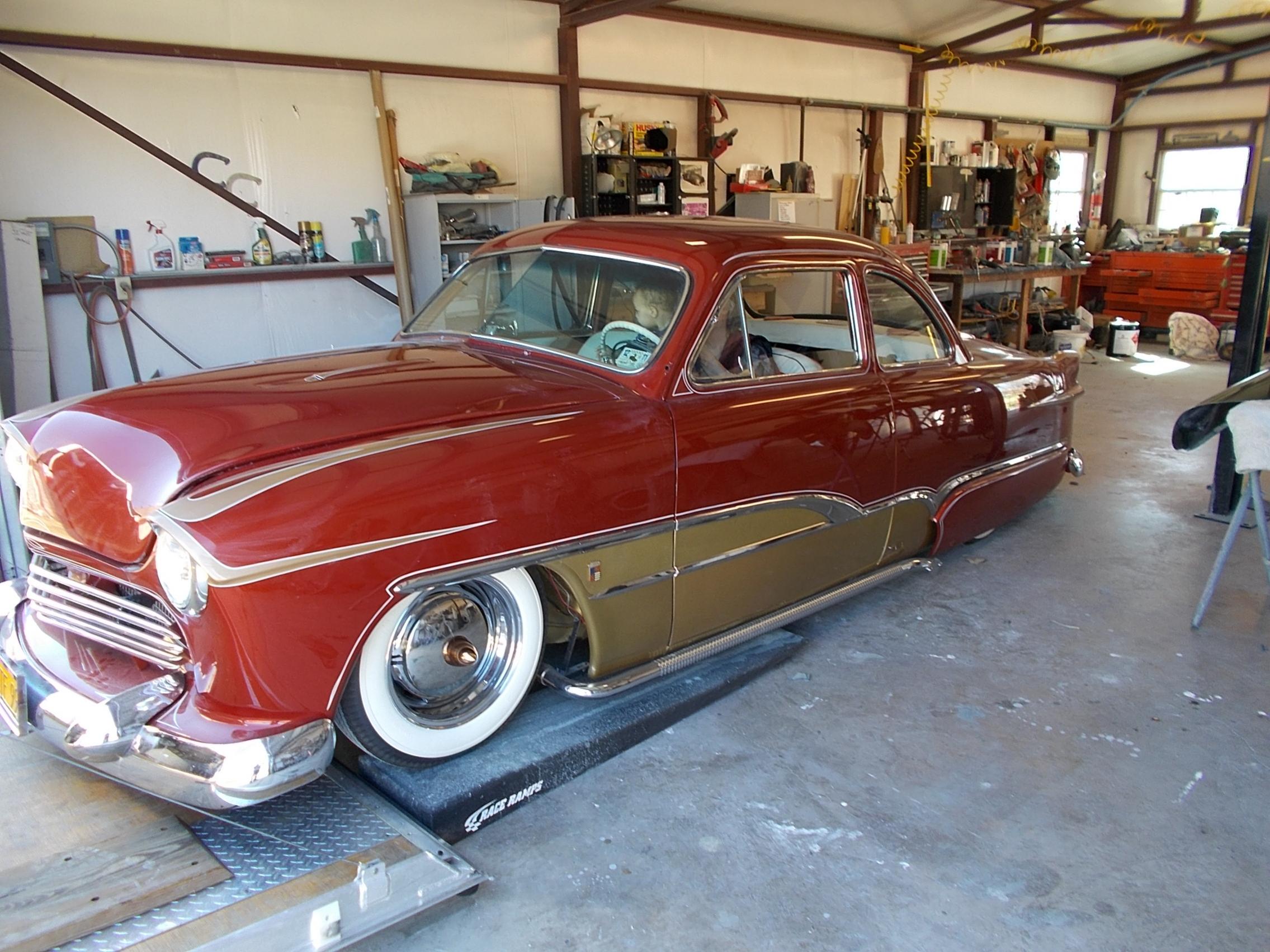

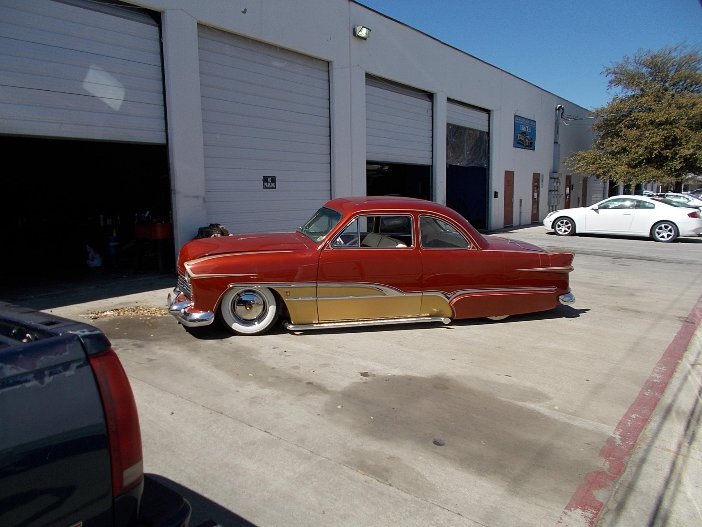

    I've been asked to bring junior's car to my church's car show that they're going to have this Saturday. This will help in getting this thing detailed after the paint job awhile back.
  29. Peanut 1959
    Joined: Oct 11, 2008
    Posts: 2,187
    Peanut 1959
    Haha, you said "Junior's car"! :)
  30. jivin jer
    Posts: 3,491
    jivin jer
