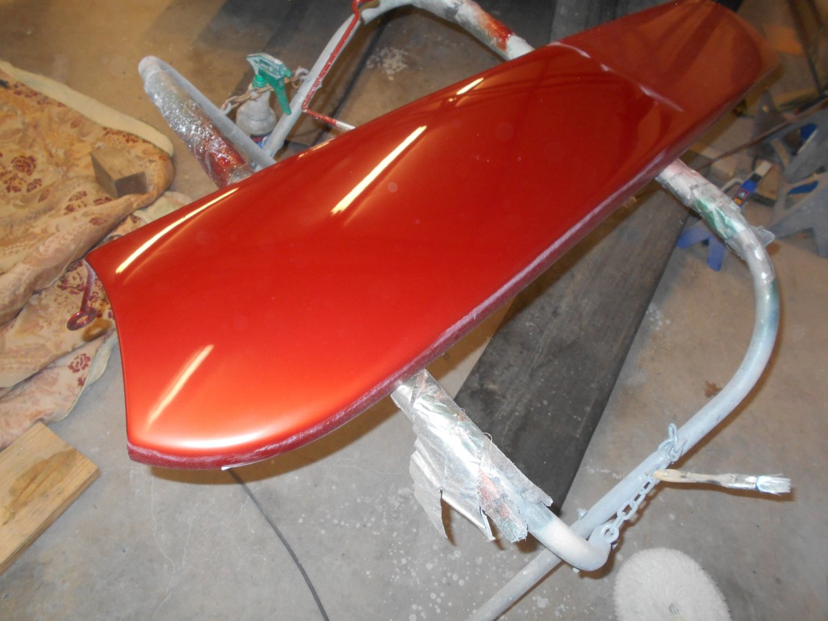

    Sorry, I've been neglecting this thread. A little repair work on one of the skirts. 1002.JPG

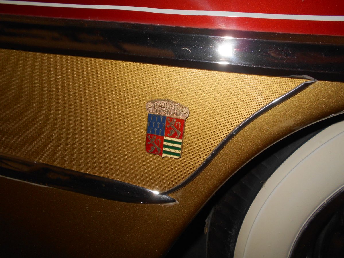

    Ok, for those that have read this entire thread, you will remember the terrible experience. I had trying to make the perforated br*** sheet work in between the moldings. I could'nt get it to stop corroding, no matter what I did, after time, it would corrode. I finally painted the br*** with br*** spray artists paint, and clear coated everything with eurethane clear. This has held up very well, but isn't exactly what the original car looked like.
    Well, as We're getting this car ready, I'm playing with it again. I''ve actually got a quote to have them gold plated.
    It was way out there, but in this process I've discovered that POR-15 now has a clear. I thought that with the well known corrosive resistant properties of thi z1.JPG s product that I would call them up. They said that they did have this product, but it wouldn't work in this application because it doesn't have a UV screen, and would deteriorate exposed to the sun. I got some and cleaned up the surplus br*** that I have laying around. I sprayed the POR-15 on it, and followed that with some eurethane clear (both sides) for the UV screen problem.
    The first pic shows the surplus br*** after being outside in a hot/humid/dry environment. The little circles mark the excisting marks that were there to start with. After about two+ weeks I might be seeing a few very small spots (corrosion) on the back of this panel.
    The second pic shows the painted panels that are on the car now. I don't know what to make of this yet, but I'm VERY reluctant to dis***emble the moldings, strip off the paint, and roll the dice again. We'll see what happens.

    I love your attention to details Jer but if it were me I would leave it alone.
    You may find that the new way turns out worse in the long run.
    Much like the issue you are having with the plexi rear window on the Lopez coupe being replaced by real gl*** these panels staying the way that they are in no way diminish the quality of your reproduction.
    If you didn't point them out you would be the only one that knew.
    Just my 2 cents.........
    Torchie
  16. BrerHair
    Joined: Jan 30, 2007
    Posts: 5,117
    BrerHair
    I'm with Torchie on this one Jerry. Unless Junior gets a big kick out of it, then maybe it's worth it.

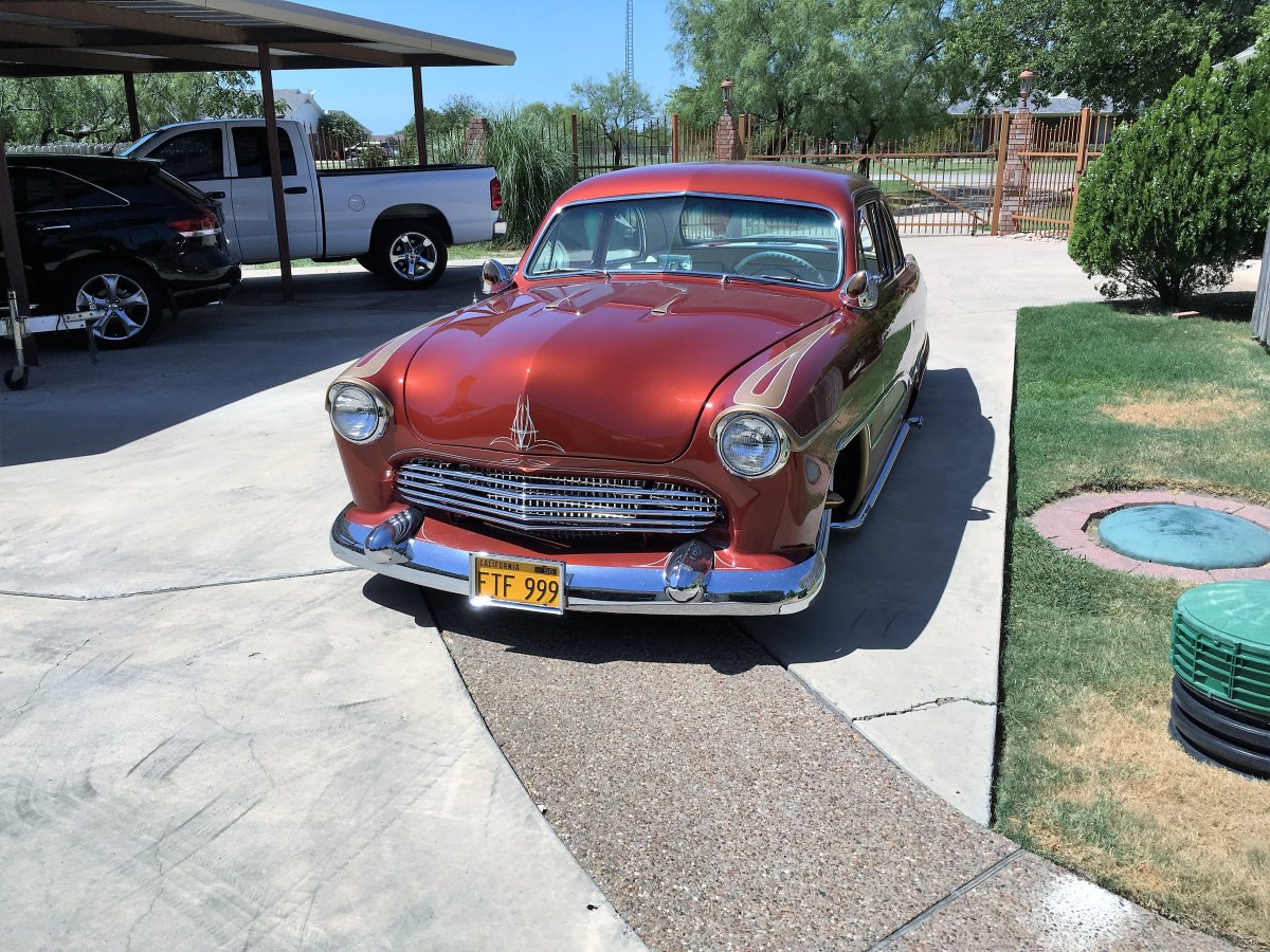

    Well I've lost my help, and I don't do as well as I used to in the heat, however I've 0.JPG 00.JPG almost got this one "put away".

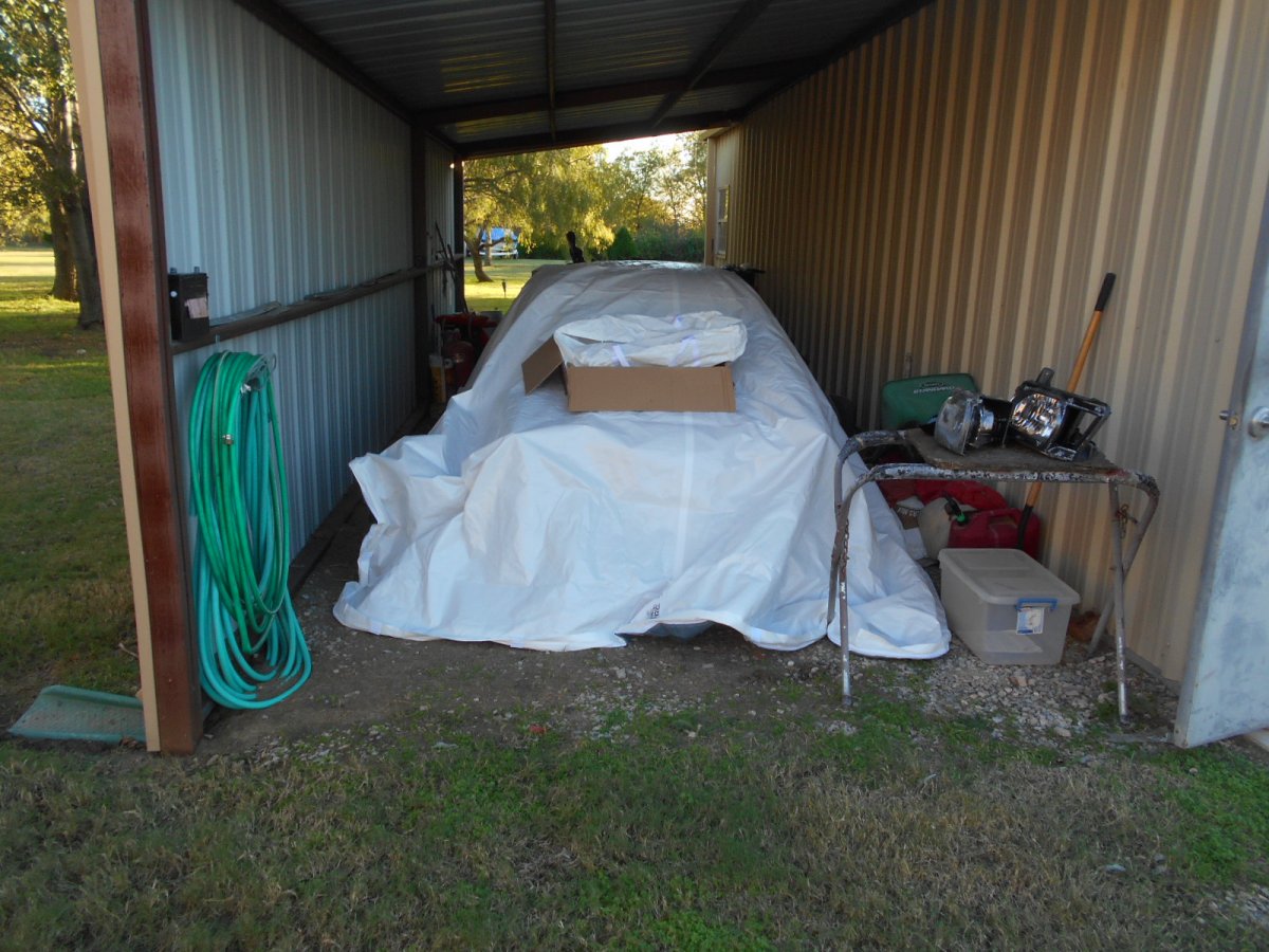

    001 (4).JPG 001.JPG 001.JPG Nighty night.
