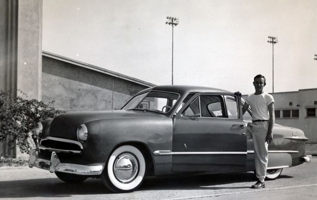

    IMG_0969.jpg This is the last pic of this type.

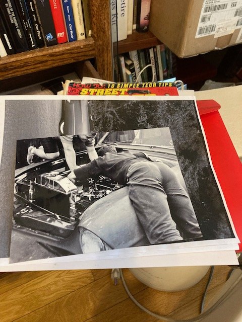

    We're back into some stuff that Junior let me take home. These two pics show two "movie stars" of the day, in and around his "tear drop" Kustom. The male is Richard Beymer who had a leading role in "west side story". I can't ID the chick, although she looks very familiar.

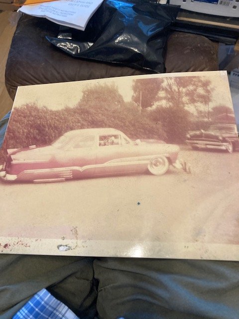

    This is a fuzzy p IMG_0987 (1).jpg ic of Juniors car and his brother Herbs '54 Merc.

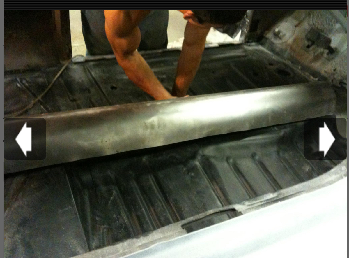

    I’m curious about the driveshaft tunnel mod. How low requires this? I would think you need C-notches before the driveshaft is going to hit. IMG_7097.jpeg
  29. jivin jer
    Joined: Sep 14, 2008
    Posts: 3,492
    jivin jer
    I have a lift and a four" X six" X five' beam in my shop. I use that beam for all kinds of things. Juniors' car specs were pretty simple, it was as low as he could get it and still be able to drive on L.A. streets. He told me that he did "take" the pan off of the car once while driving it. This was probably the way he realized it needed to come up a bit. He also said that if a car came into his "neighborhood" that was lower than his he felt that there had to be an immediate response to it.
    So, it's pretty simple, if you have to replicate Juniors car you are "on the ground." If you actually want to go places you put your car on that lift, remove the bolts that keep that rear end secured to the springs, remove the bolts that secure the shocks, stand that beam up under the rear axle housing and carefully/slowly bring that lift down which raises the axle****embly to where you want it to be. Do you need to notch that frame? do you need to raise that floor to keep the drive shaft from making contact? How much height do the lowering blocks need to have? This exercise will reveal what it will take to make everything work.
    I need to add that this is by far the easiest, and fastest way to determine just what you're getting yourself into before you start cuttin stuff up.
