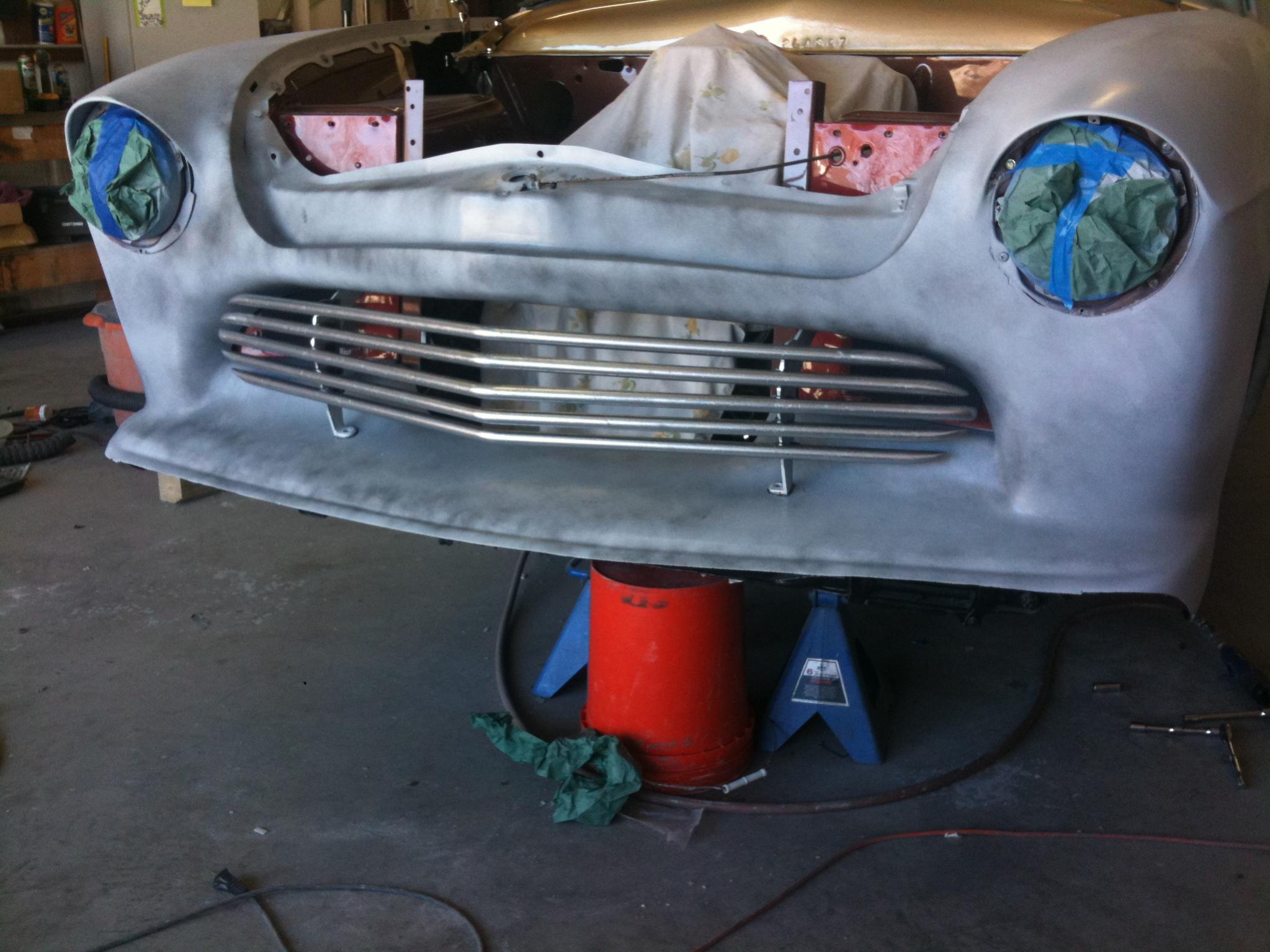

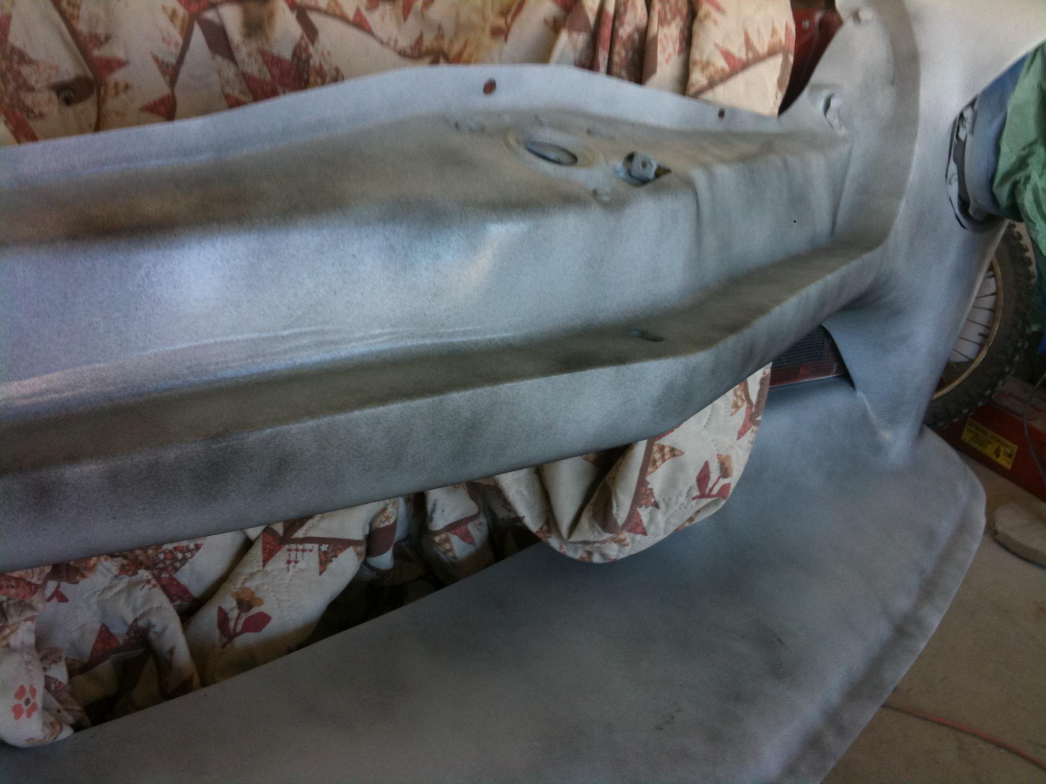

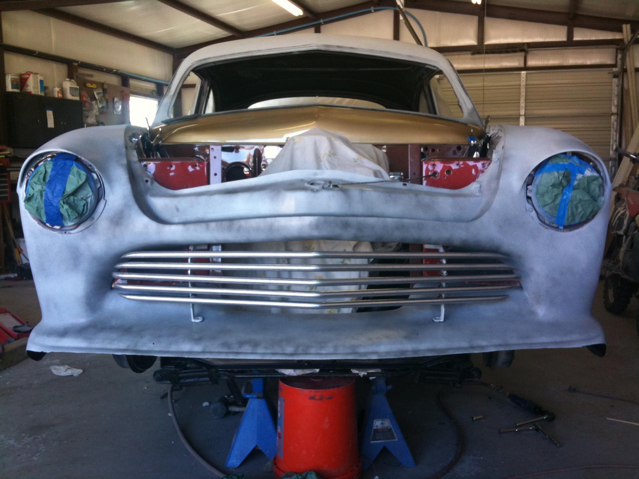

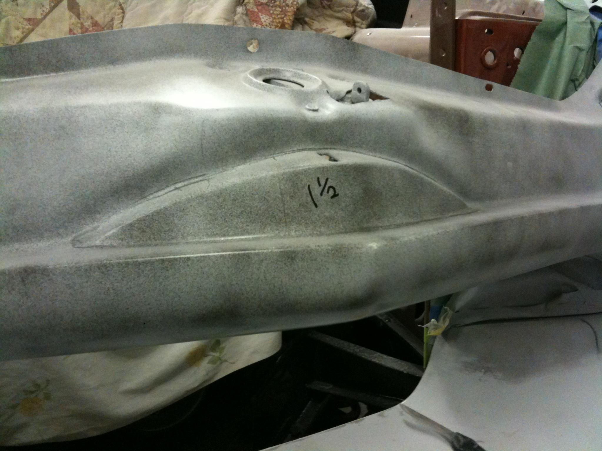

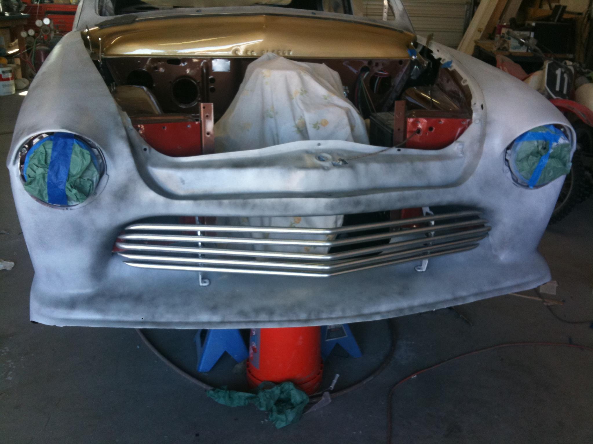

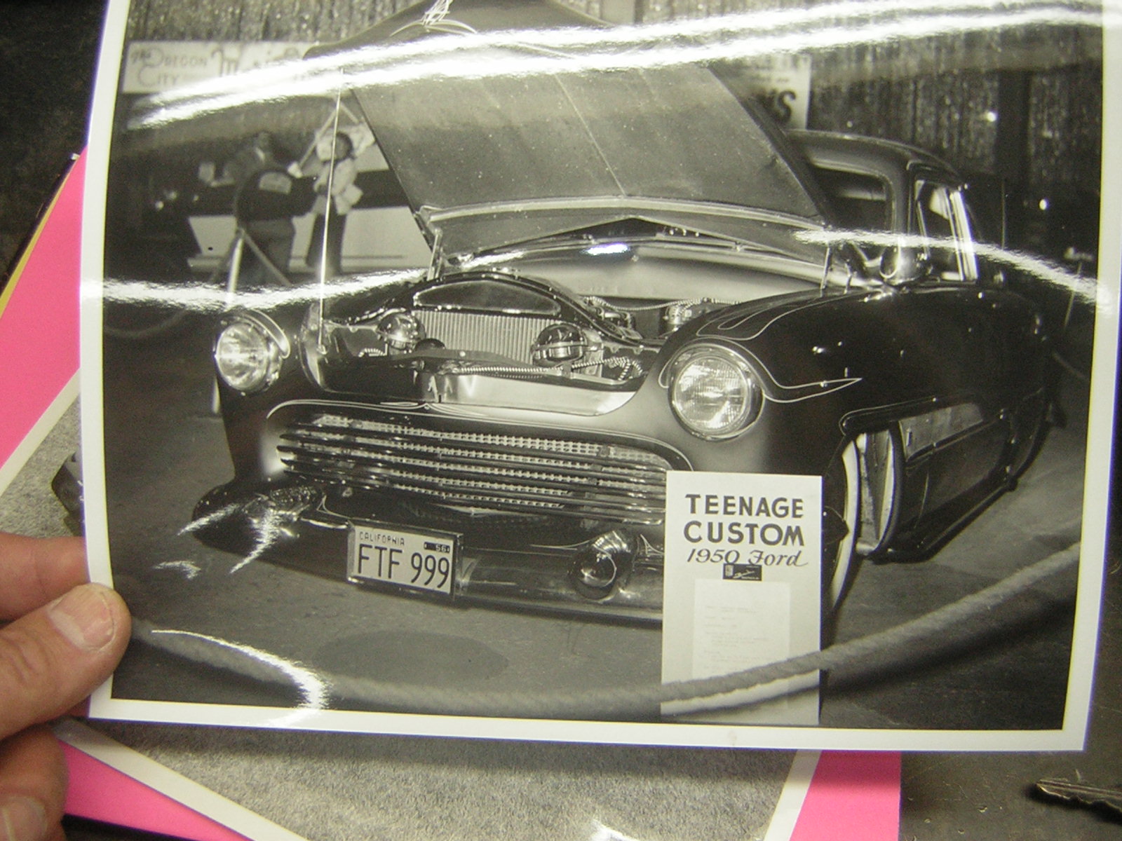

    This is the redone hood latch panel. The first pic shows the incorrect configuration. The second pic shows why it had to be redone. I got this pic from Jr's private stash after my visit with him in Nov.. I had already done the nose. The third pic shows the corrected,redone panel. There is one pic that I hadn't seen before that was devastating. We'll get into that a little later.
    As is becoming apparent building a clone is way different than a cool custom that you've got some ideas about. There will be some concessions in this process. I will try to keep my cards face up, as we go. They will be minimal.

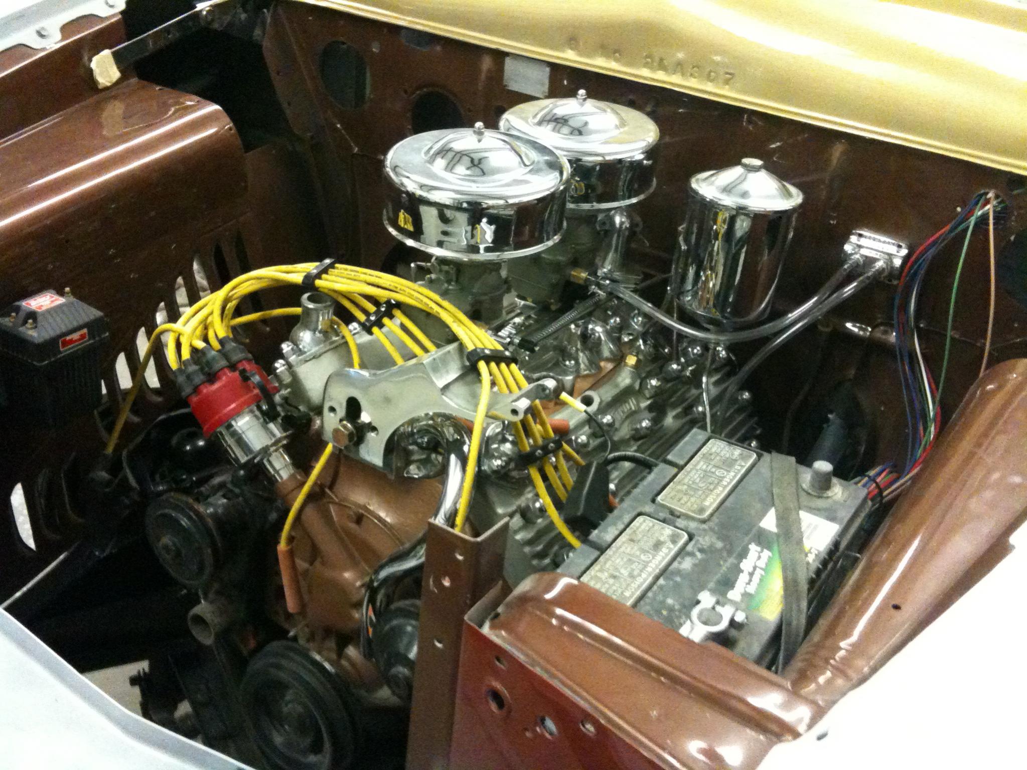

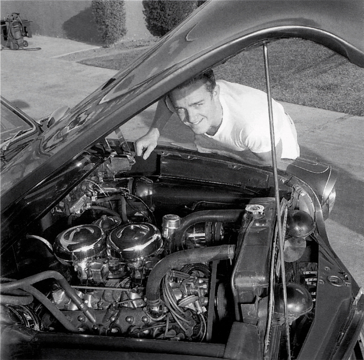

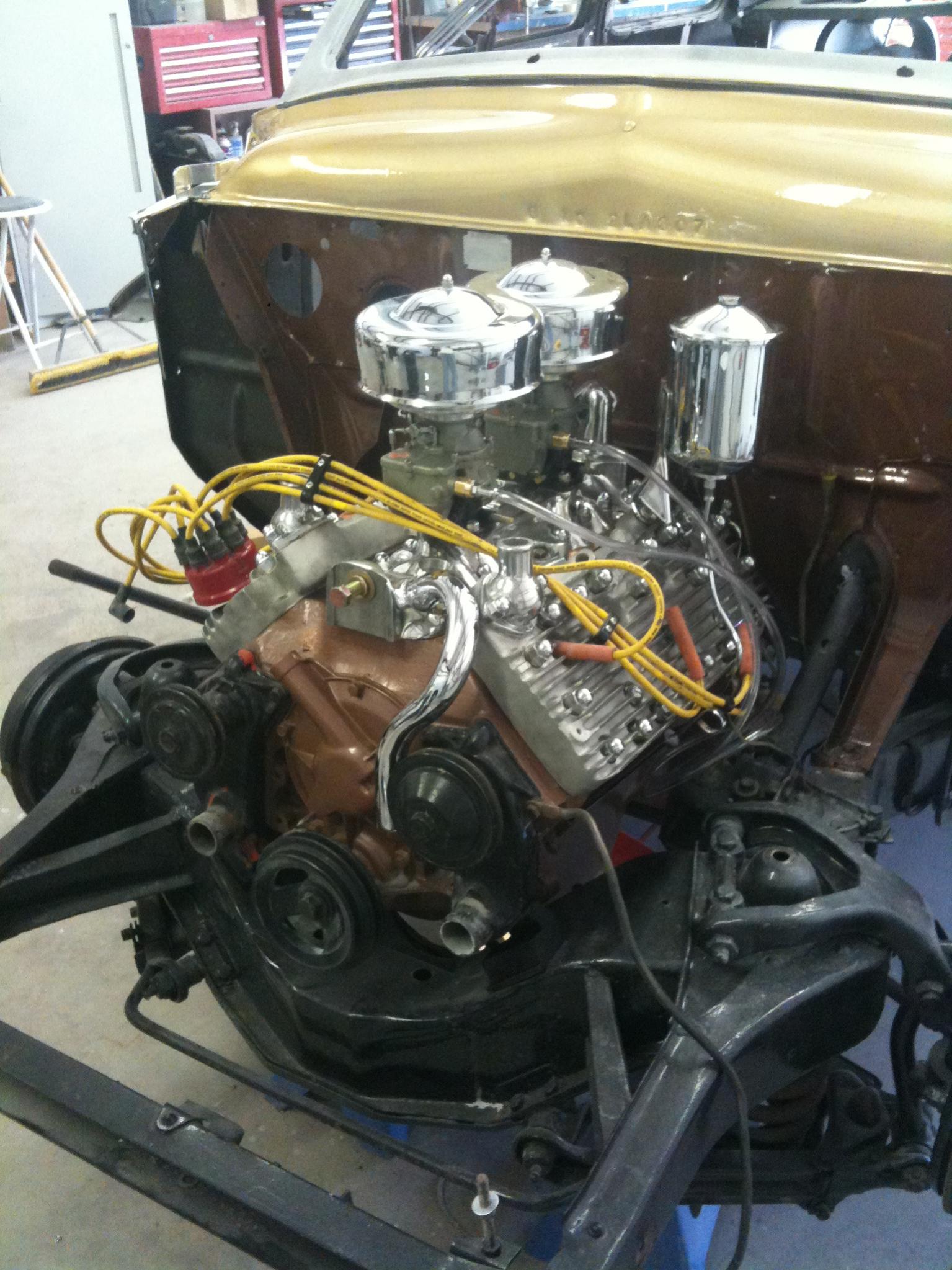

    With these pics we expose the engine process of this build. One of the reasons that I bought this car was because it had good mechanics. You can go back to the posts that deal with the engine and see that it had Offenhauser heads and a four barrel carb.The pic that showed what was needed was an early pic of the underhood area with Jr. on the lf fender. That is the third pic. What this pic revealed was some unique air cleaners that I was able to find (after a long search) at Wolk Design LLC that they had to modify to fit the 97's. Thanks David.The underside of the hood remained a work in progress after the exterior was done and the car was being driven (Jr's only mode of transportation). Although I could have stopped right here at this pic (Hey, that's the way it was!) ,the appeal of a dressed up flathead couldn't let that happen. The correct Fenton heads and dual carb. intake were found. Thanks Ebay. They were polished and installed. Close inspection revealed that Jr had a three carb fuel block on the firewall with the inside outlet blocked off. I've been unable to find a three carb fuel block so a two holer will have to work for now.
    The big issue that wev'e had is with the location of the generator. If you look closely at this (third) pic you'll see that it is on the outside of the l head water inlet hose. I thought that the simple solution would be to buy a Speedway offset generator mount. If you look closely (second pic) you'll see that that mount puts the generator right on top of that inlet. I think we are closing in on a solution with help from Chris at ShoeBoxFord.com. and the H.A.M.B. guys.. What is needed is an early flathead (59A) mount with the stud kit. It mounts the generator to the head. That should be arriving shortly. Isn't this like a forensic investigation? The donor car came converted over to 12V.We replaced the alternator with a generator that was reworked for 12V from 6V. So one of the concessions is keeping the 12V system. While making an effort to disguise it somewhat.
    At this point we're considering keeping the fuel pump in the stock location on the the intake manifold. We've discovered that when you remove the push rod for the pump you lose oil pressure if you don't do some machining at the push rod hole (in the block). It sure will enhance the looks with the polished fuel pump and fuel pump stand. But for the person that's paying attention (you can see the fuel pump block off plate) it's not correct. Another concession.
    The correct exhaust system was stock with a set of duals installed (old style). The last pic shows the stock manifolds in correct relationship to each other. With the stock system there was a cross over pipe (shown) that went across the front of the engine. This connected the two and directed the exhaust forward and then around and out the r side. I'm saying all this because I'm looking for the duals conversion pipe that directs the l side exhaust forward and underneath the engine in front. I actually saw a genuine set in the original box on Ebay and missed it. I hope this makes sense and doesn't bore everybody.

    I ABSOLUTELY REFUSE to consider the subtle inferences that I am coming unhinged (hinge?, whats wrong with the hinge?). I'm realizing that when you use pics only for references regarding body work there is a built in problem. There is a tendency for them to be distorted in some way. The photogs can chime in on this. There has been a big (real or conceived) problem with how the grille fits in its opening. After looking at ALL the pics available (Thanks Rik) and comparing them, from all the angles, with the grille that's now re-installed (and painted chrome) I'm satisfied that we're ok. Now, you'll have to excuse me, I'm sure that there's a template or something that needs to be made.

    This picture was really distorted [post 96]so I straightened it out a little. Hope it can be of some use with the front end look. Keep up the good work!
    John
