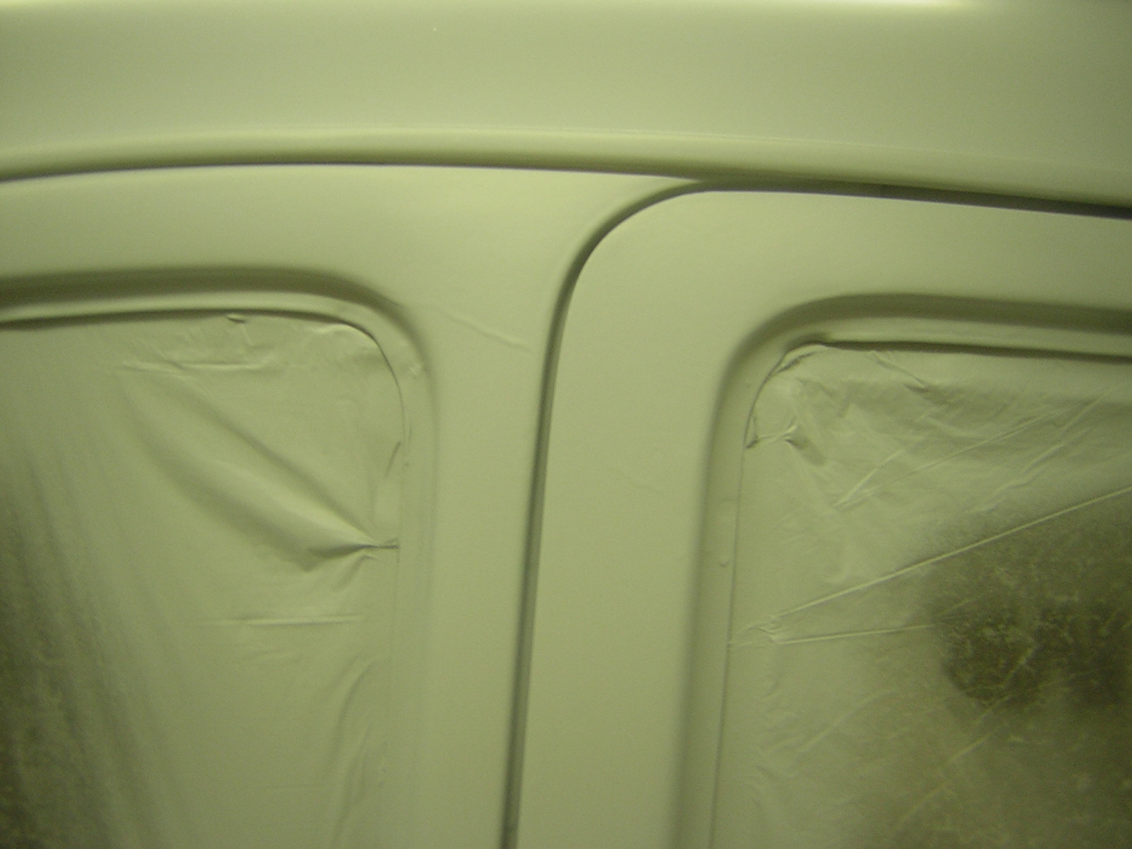

    Son Tom fit's the template for the w/shield. The two pieces need to be extra wide to pick up the space where the divider bar was.

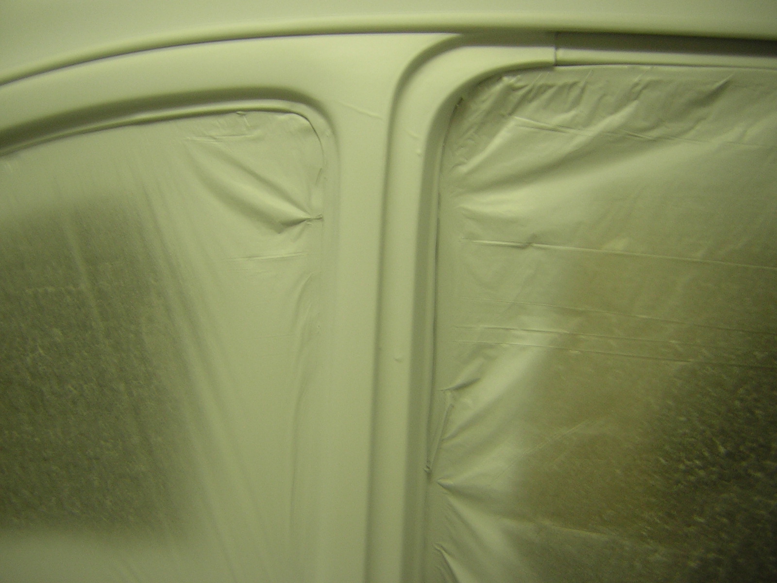

    Here are the rounded door tops. Took ¼ rod and put it in the slot.

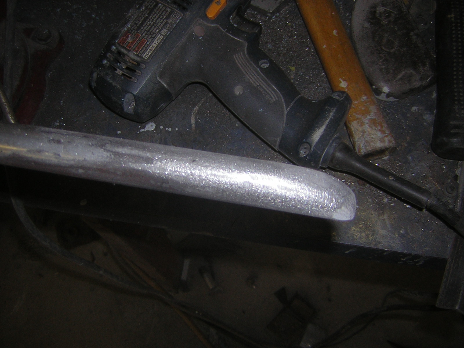

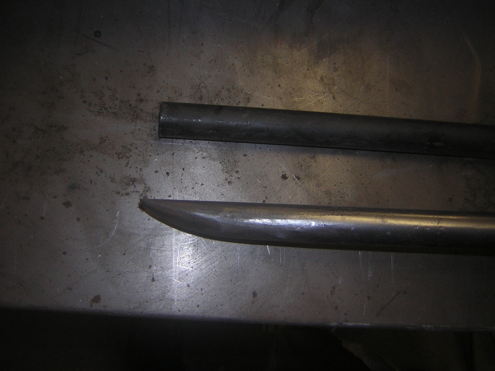

    I'm starting to put the final (?) chrome pieces together for the plater. First pic shows the raw ¾' grille bar and the shaped lower bar. Very aggressive grinder.
    Second pic shows middle bar with the big gouges taken out with a 120 grit
    disc on the grinder.
    The last pic shows same bar after 80 grit with the DA sander. All this work makes things easier for the plater.
    Bill Carr (The Aztec) and George (Barris) built this grille.

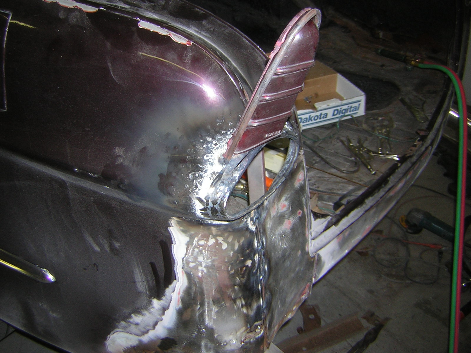

    Well we've got a lot of balls in the air right now. The hood latch panel hasn't arrived yet. The generator issue has been solved. The particulars have to be worked out before I can post a report. The wiring needs to be finished up before I can consider installing the dash and some of the components on the inner firewall. The seats have been dropped off at the upholstery shop. I would like to paint the car before the minor interior trim and other items are installed. Just to remove the dirt and overspray issues would be a tremendous accomplishment at this time. So I think we'll move to the rear of the car and look things over.

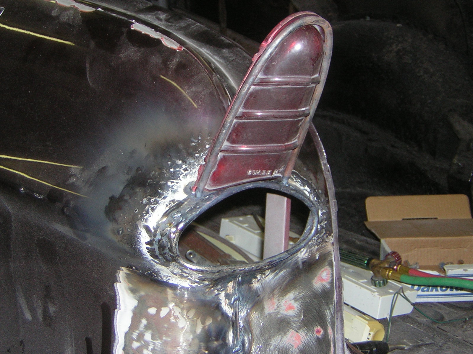

    The t/lites, hood scoops, paint etc. were all done in a two week period leading up to a big car show in late 56. There were four cars that Geo. wanted to be there. Jr's Ford, Tom Hockers 40 cpe, Mandy Holders Merc conv. And another car that Jr can't remember. Geo. Wanted to do well in this show. He was able to motivate his guys to put in the hours for things like this. Perhaps it was a precersor to American Hot Rod without the drama.
    The t/lites (55 Buick lens's) came right out of Geo.'s head (remember the lower openings were already there). I think Jr says that Geo. pulled an all/niter and when the crew came to work in the morning the t/lites were all welded up. Jr helped with the lead filing.

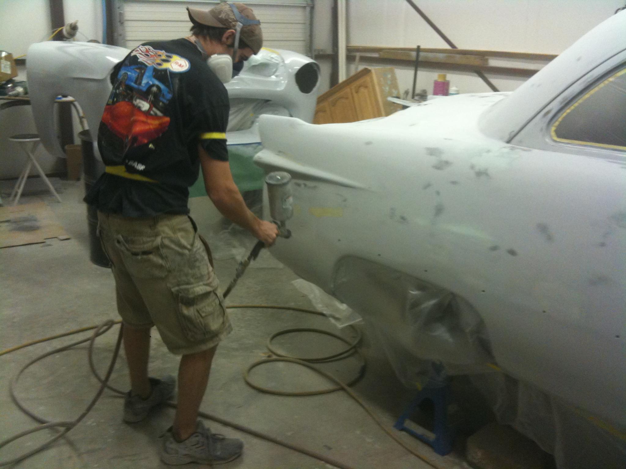

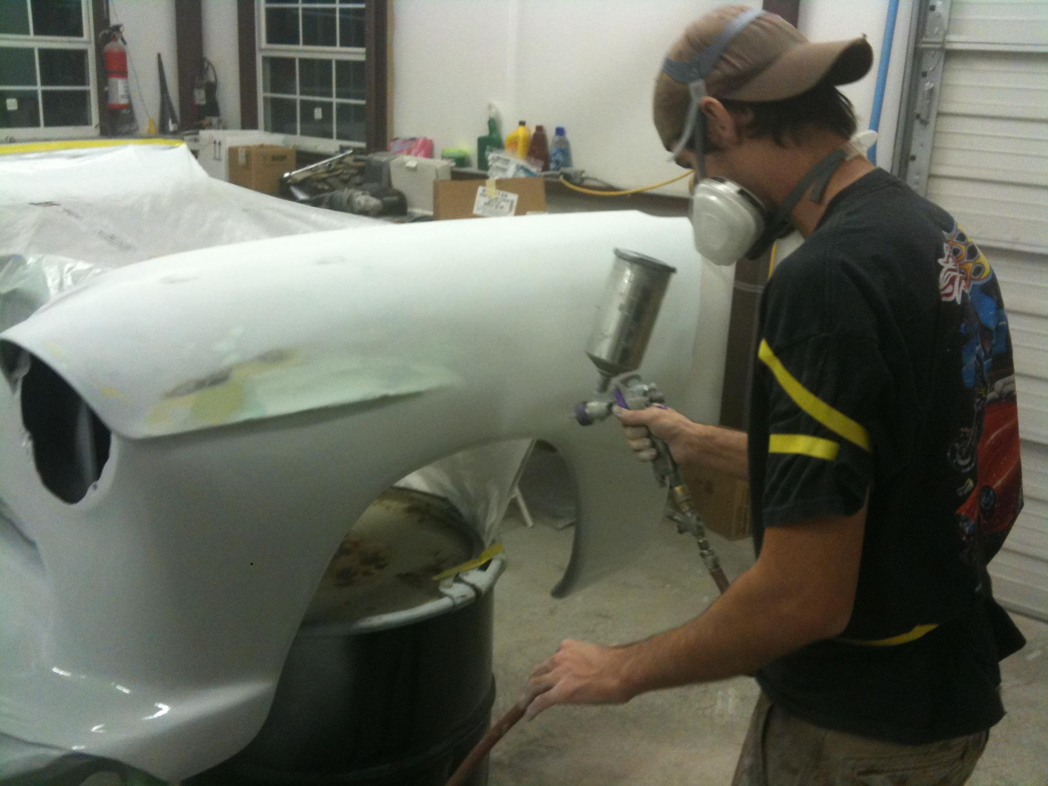

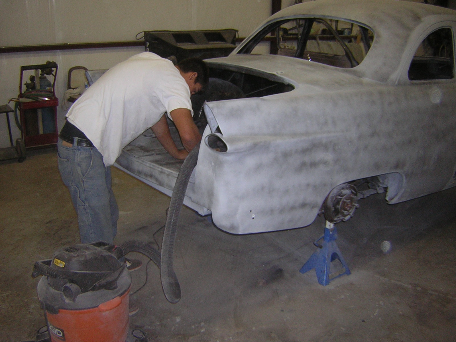

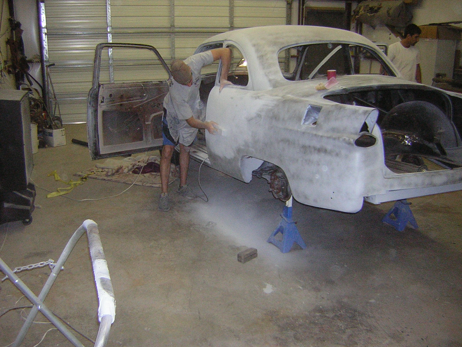

    Of my 4 sons only 1 has followed me into my chosen trade. Tom is studying to become a personal trainer. Dan is the second auto painter in the family. He is the one who keeps me up on the latest products etc. So now that we are at this point in the build we will be seeing more of him.

    It's not a run Dad , its a flow check ....

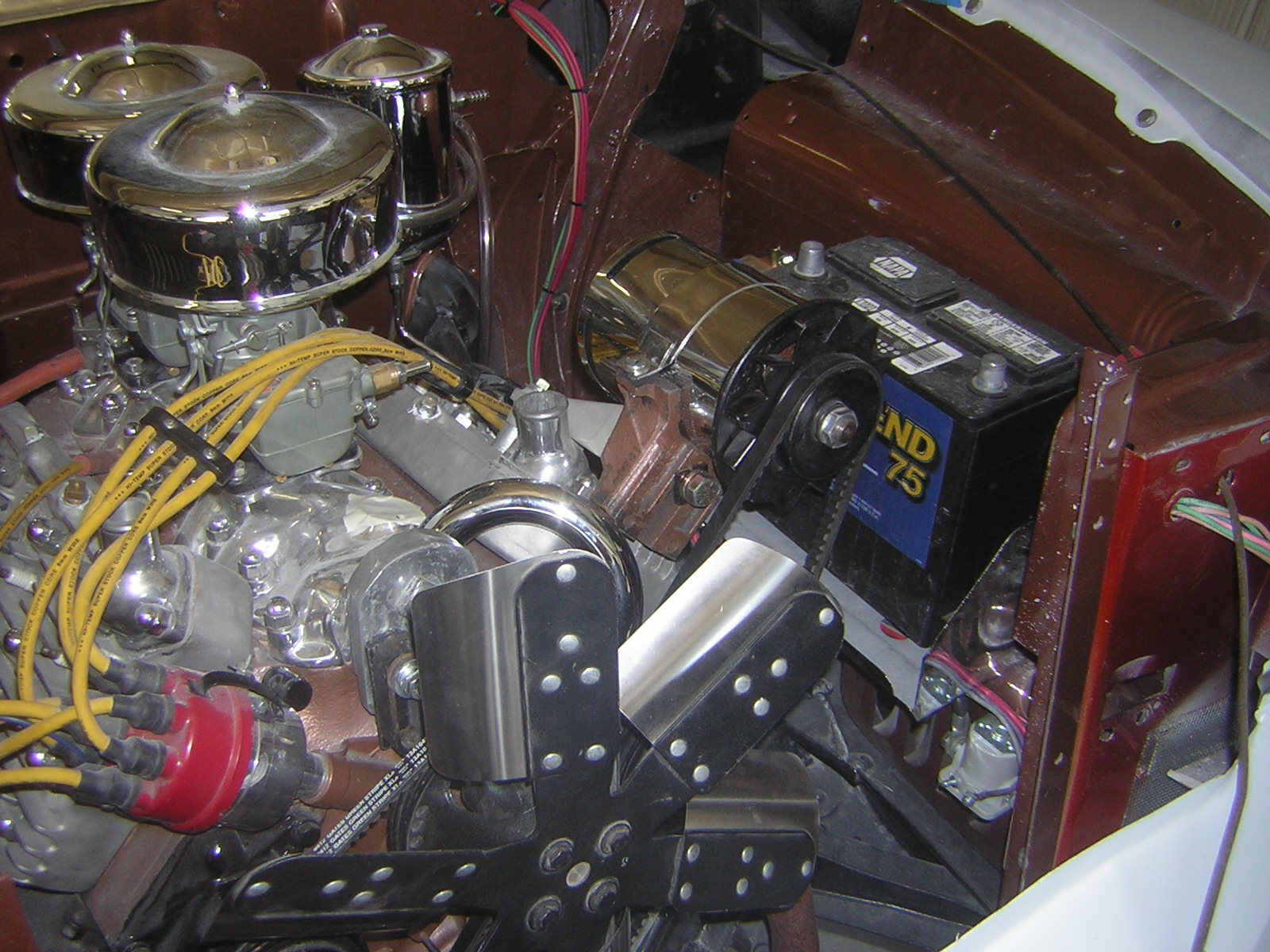

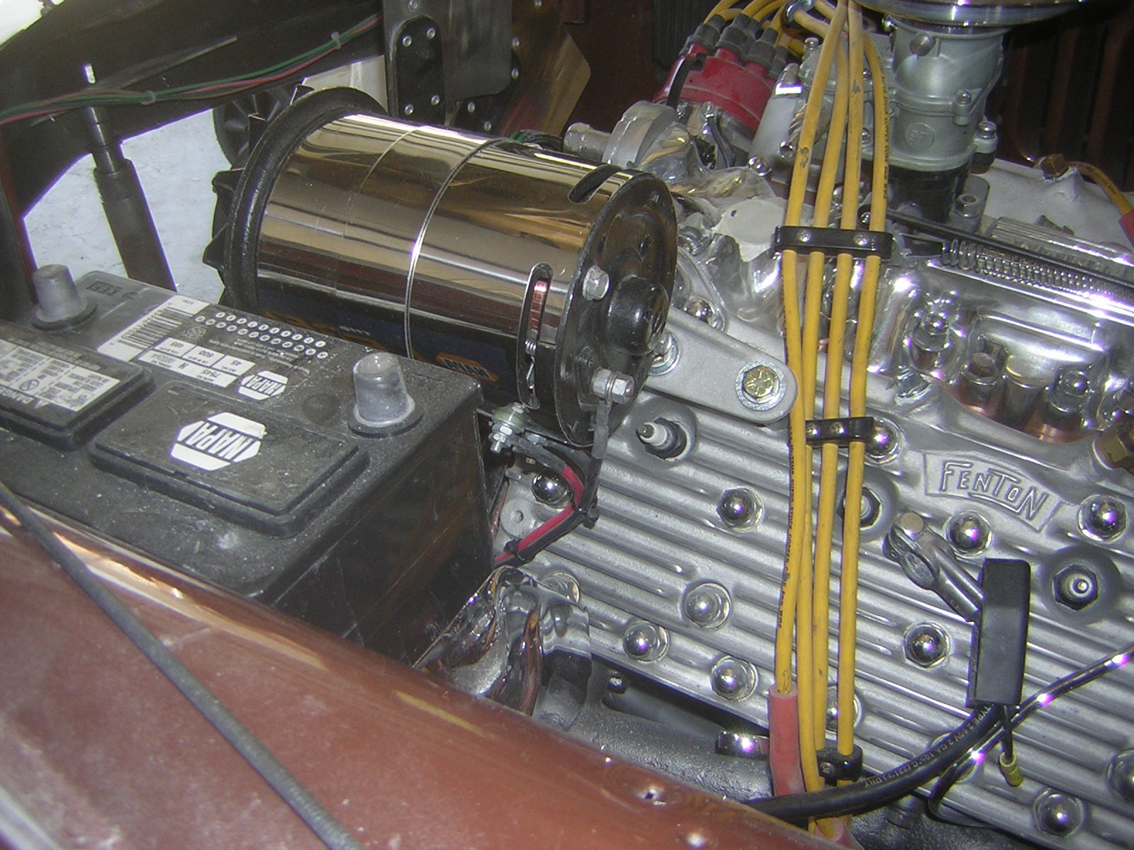

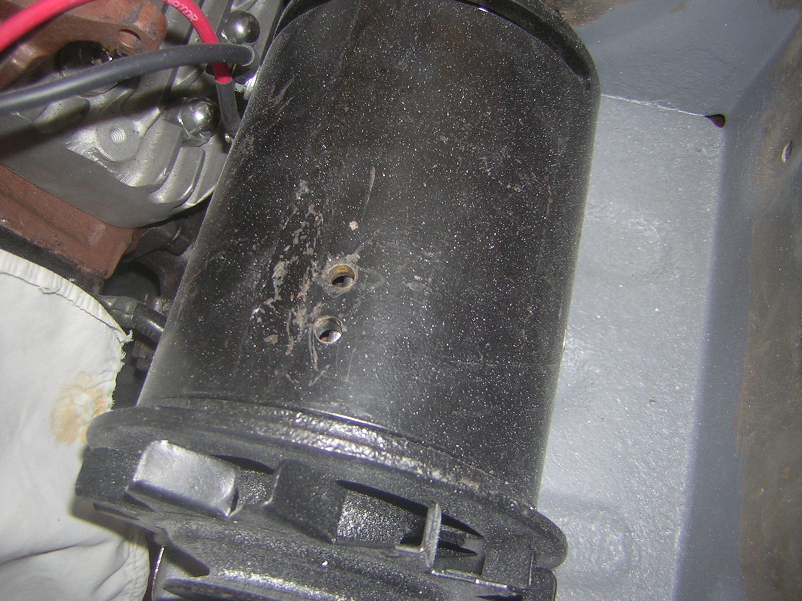

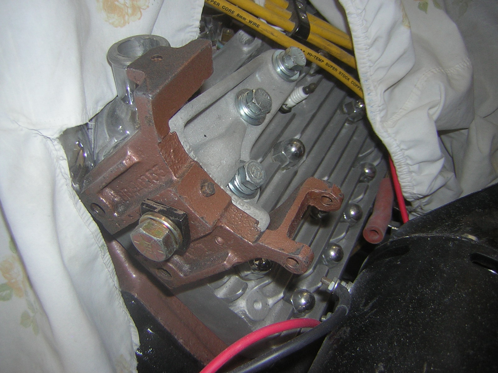

    Just to finish up the generator issue. First pic shows locator holes in generator. If you look closely you can see the center punch hole for the new hole that will put the generator forward to line up the belt. Second pic shows locator on bracket. Last pics show generator in place with everything hooked up. I appreciate the input (that was correct) about this. It helped.

    so that's how it's done, simple but elusive........ great job guys !

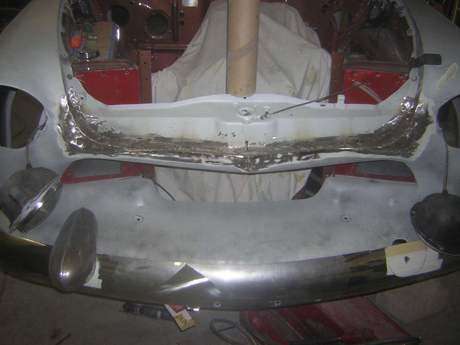

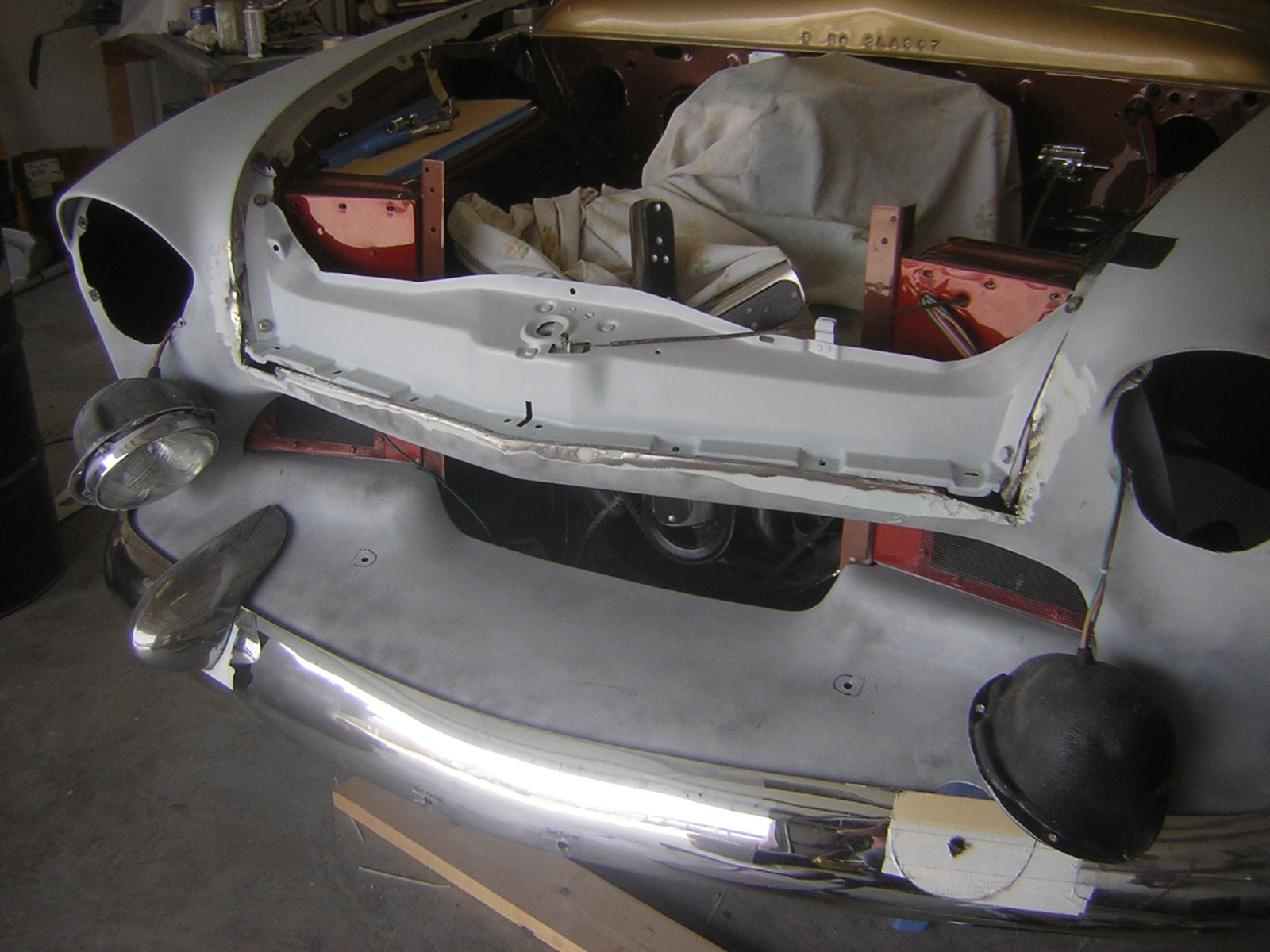

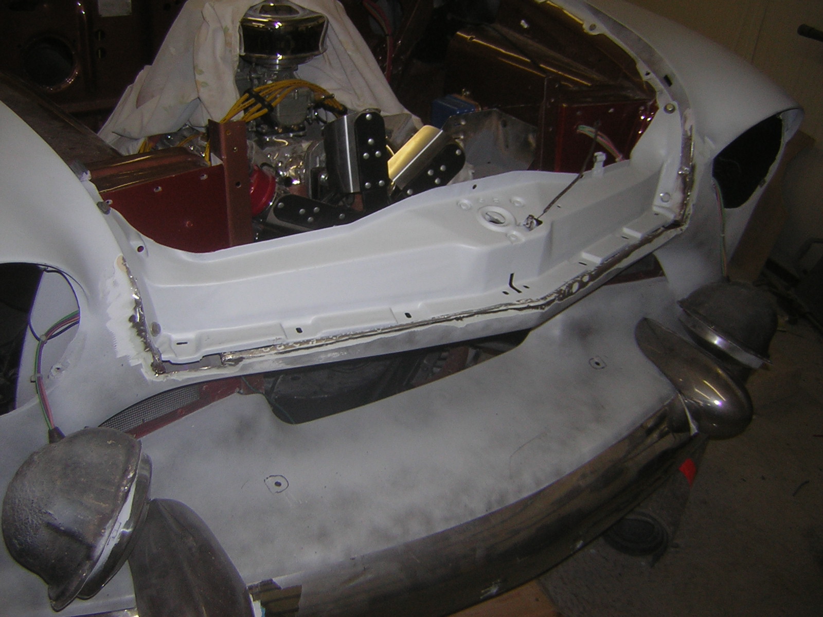

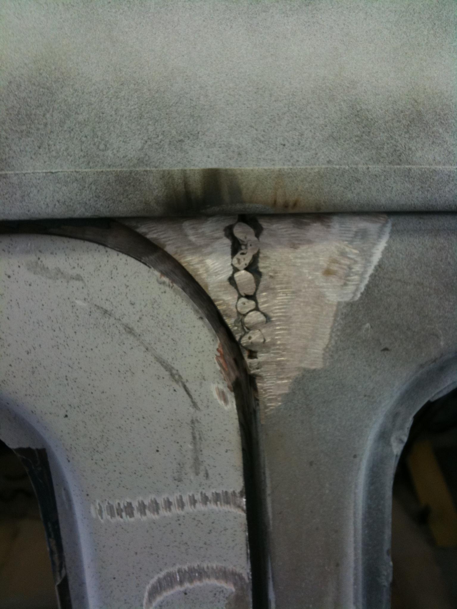

    Wer'e showing the new hood latch panel being replaced. This seemingly negative has actually turned quite positive. This panel gives the look that will stand up to scrutiny and its made the inner panels of the forward portion of the hood (underside) suddenly function better. Now I'm able to screw in the hood plunger (?) and be comfortable that its secure. A lot of good stuff dressed up in negative clothing.
    The first pic shows the old panel. The next two show the new panel in place. The last two show the new one welded up.

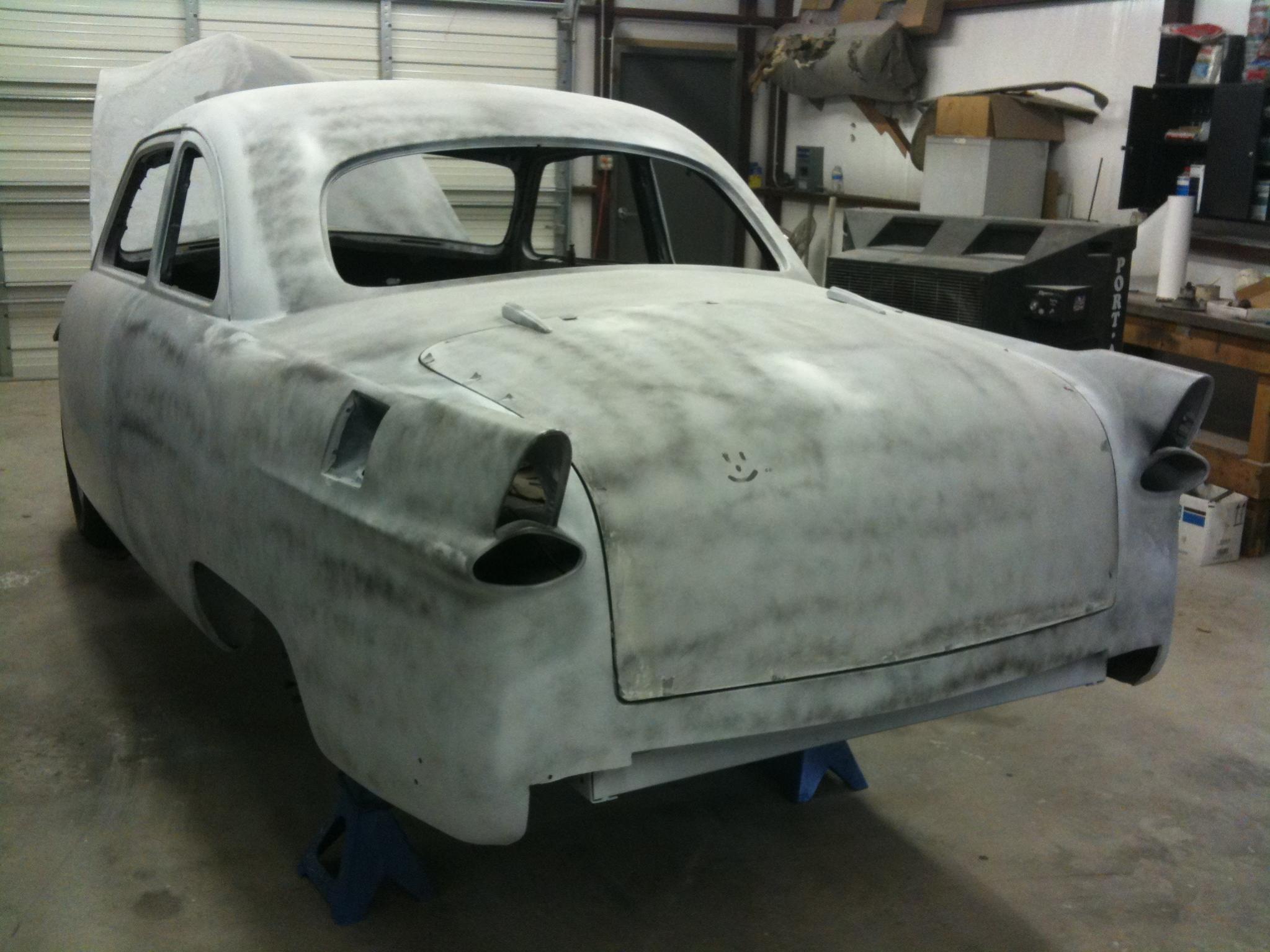

    Onward!

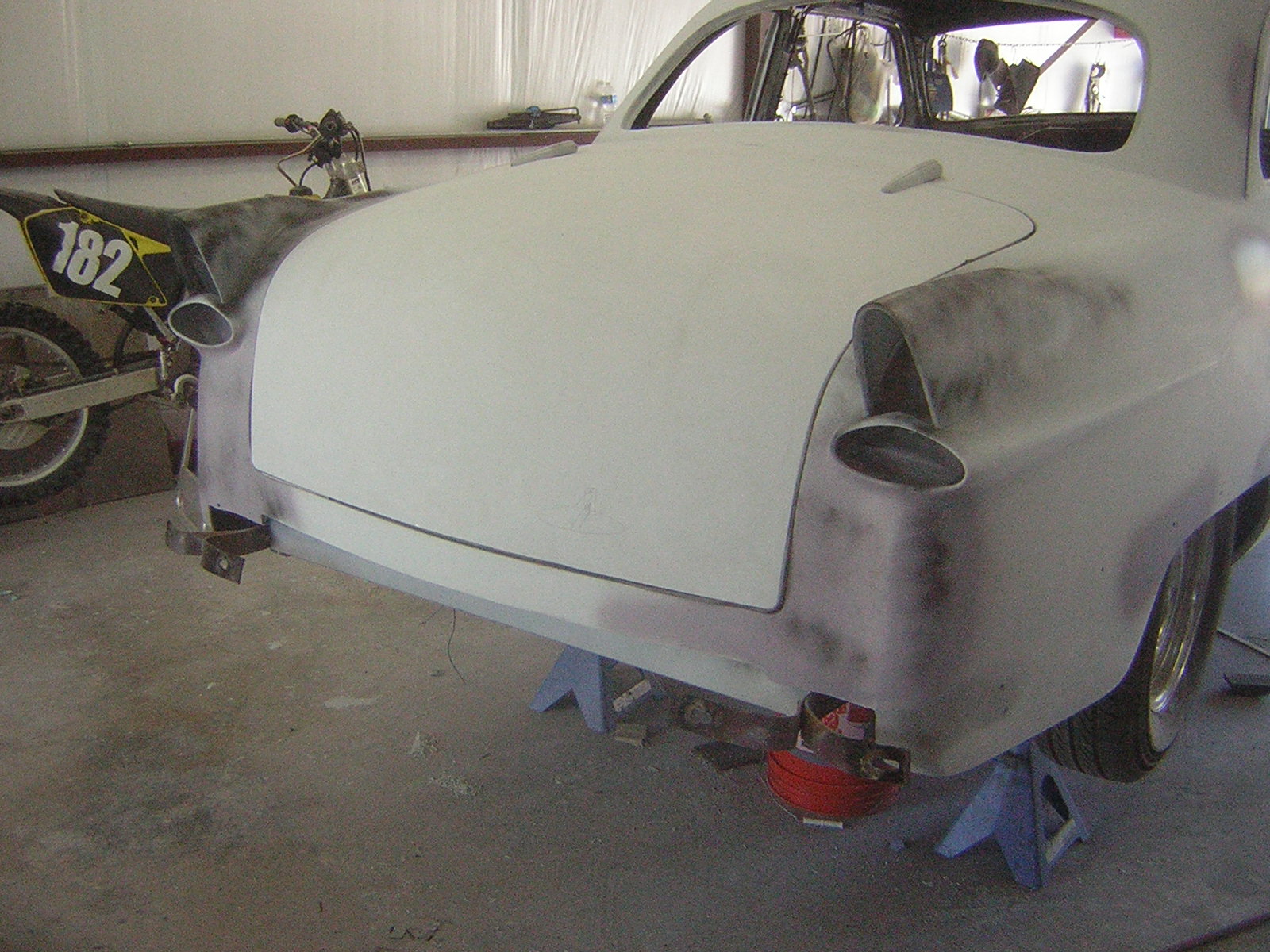

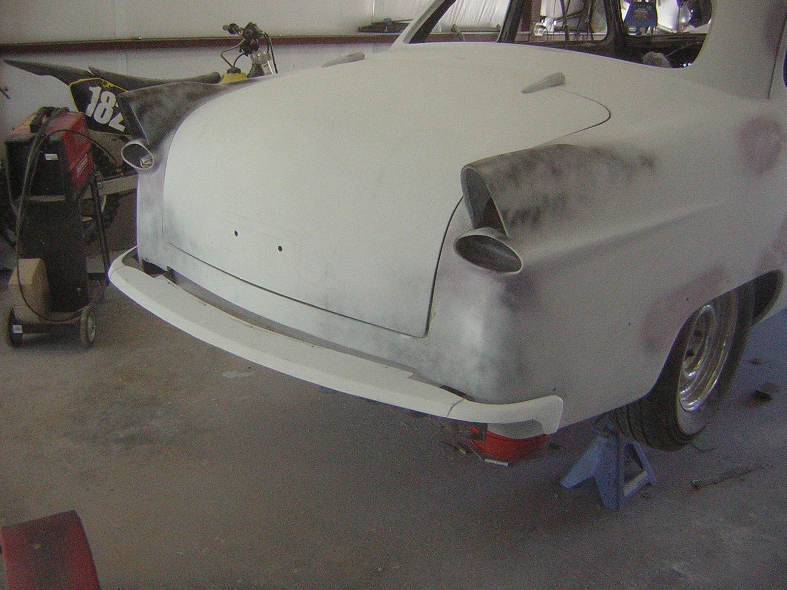

    The rear gravel shield was originally to be molded to the body like the front shield. The crush to get this car ready for the show in late '56 did not allow that to happen.
