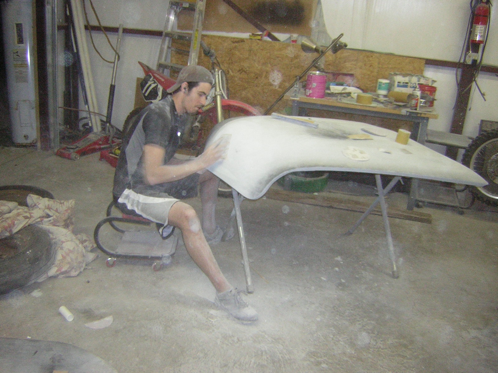

    More.

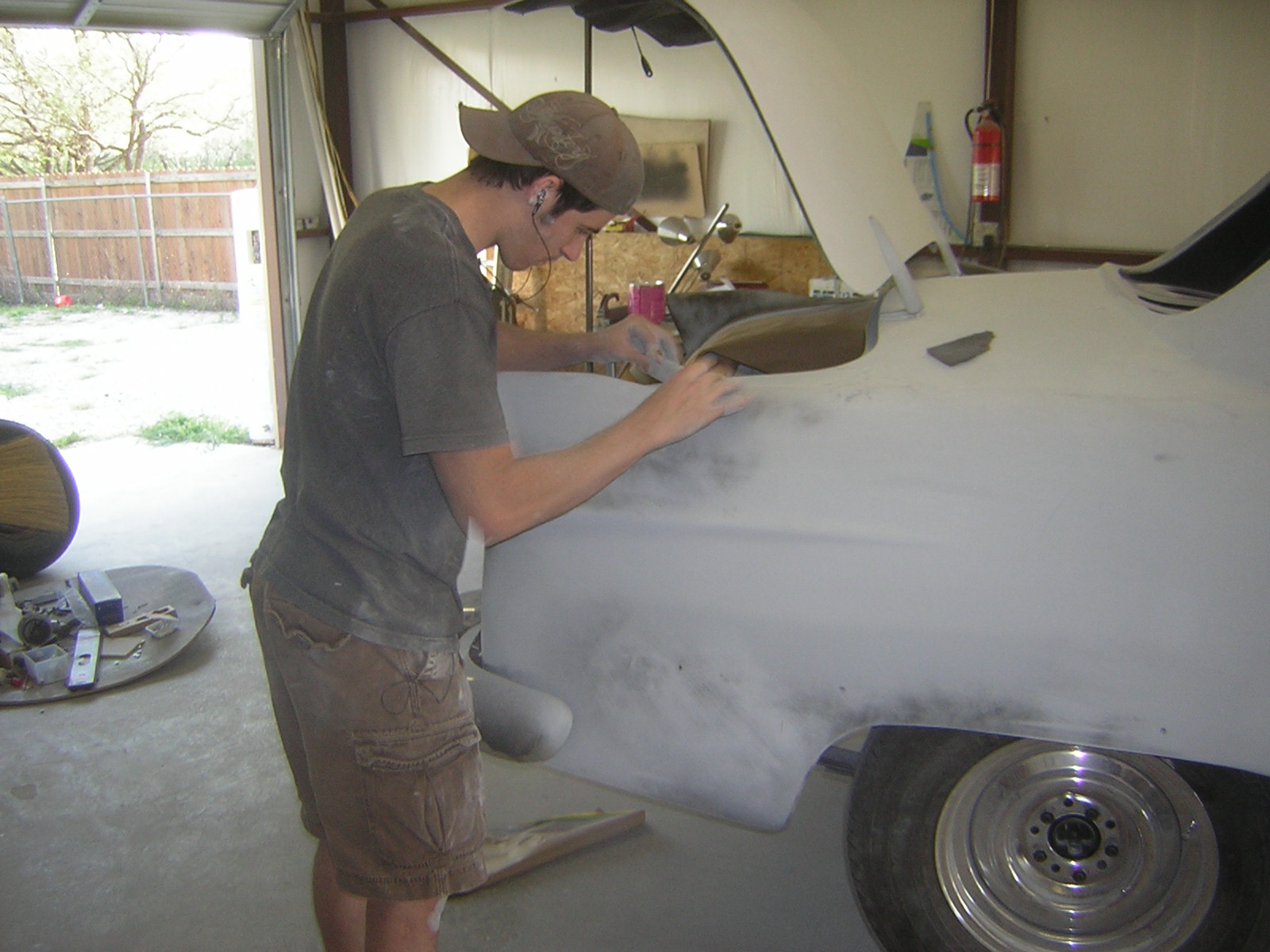

    Details.

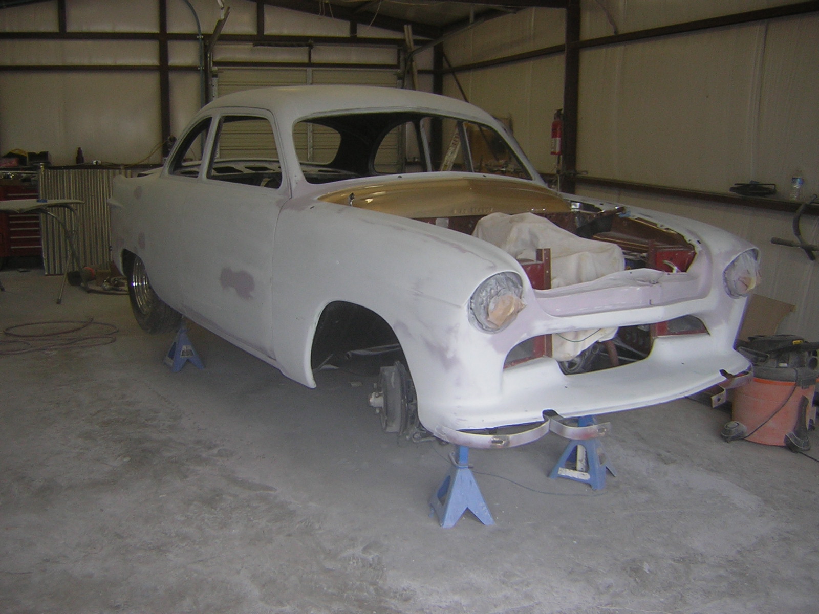

    Wer'e closin in.

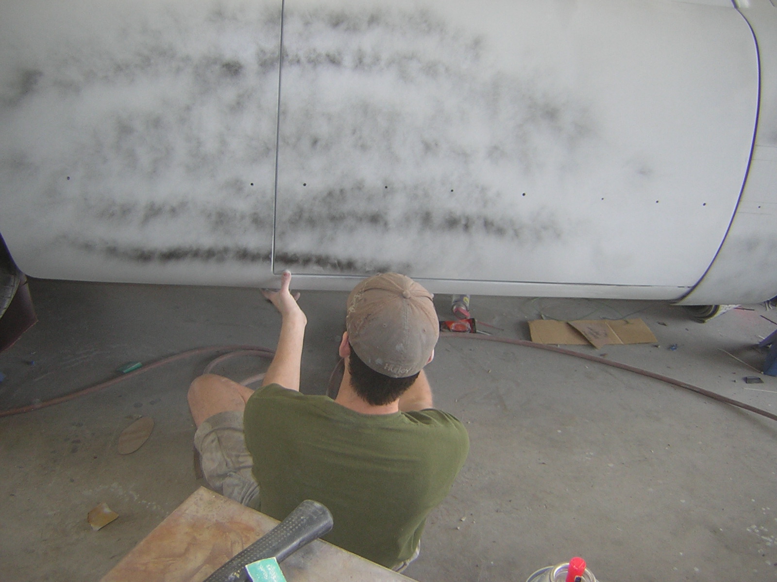

    More details.

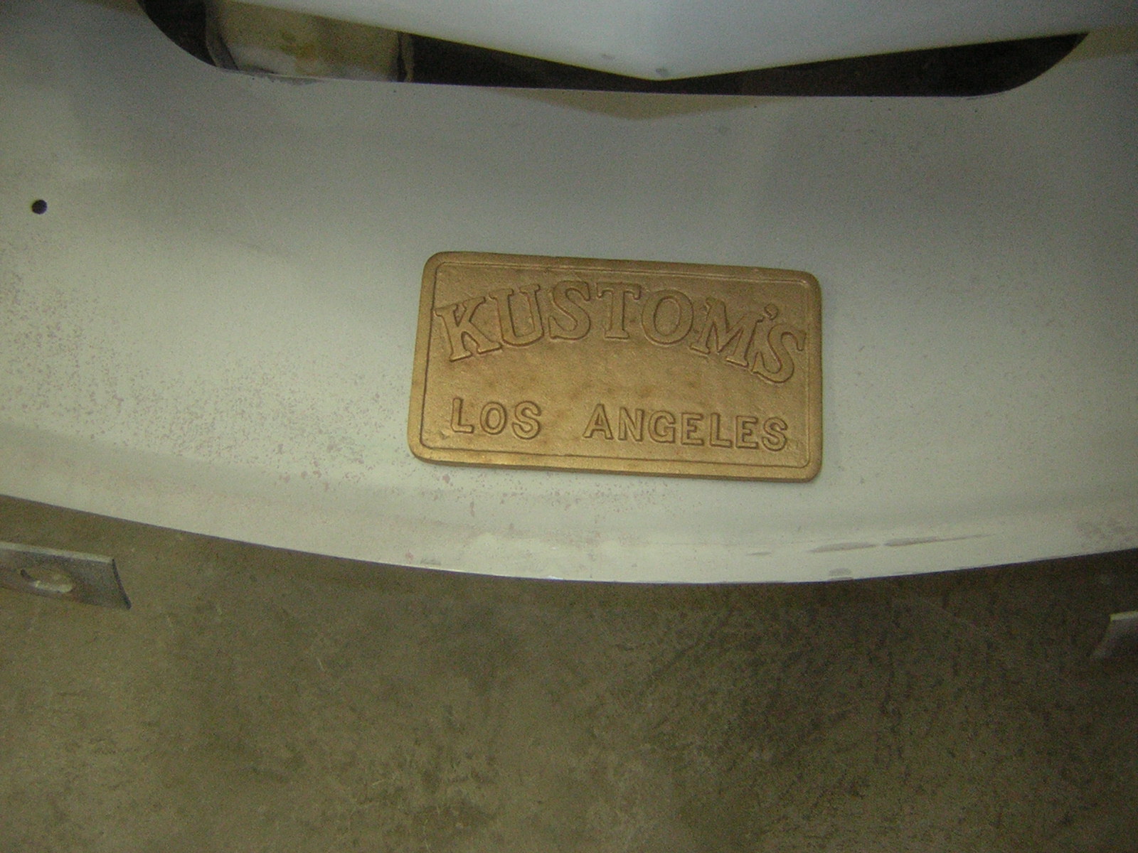

    Is that an original plaque? If so. wow!

    I asked Mazdaslam (post #157) for his and he turned me on to Kurt McCormick that makes em from an original.

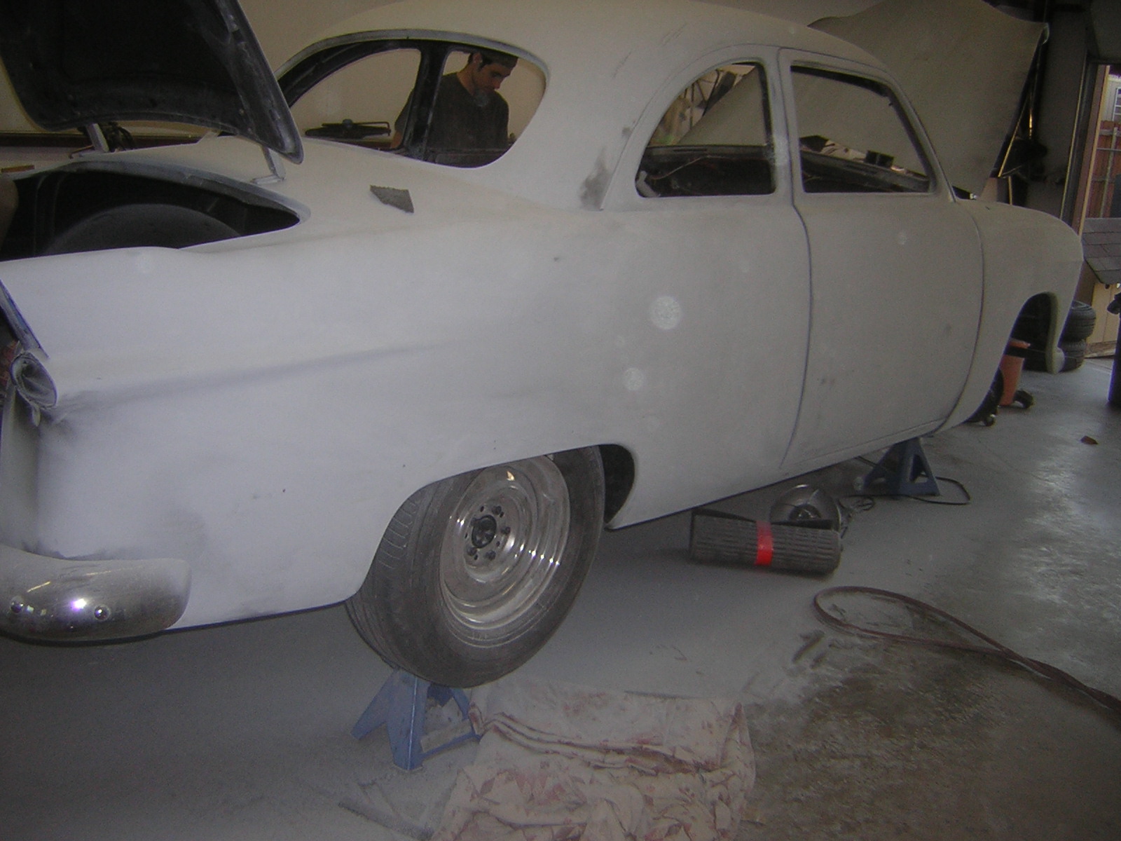

    As you can see wer'e getting close to paint on this build. There are a few loose ends that need to be dealt with. We'll be doing that on these next posts.

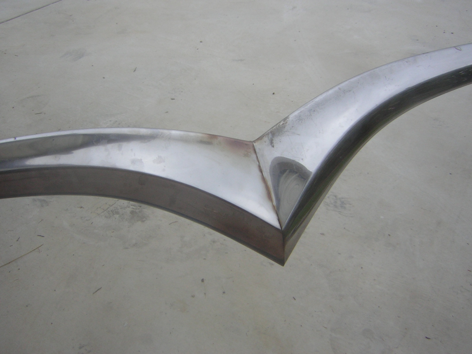

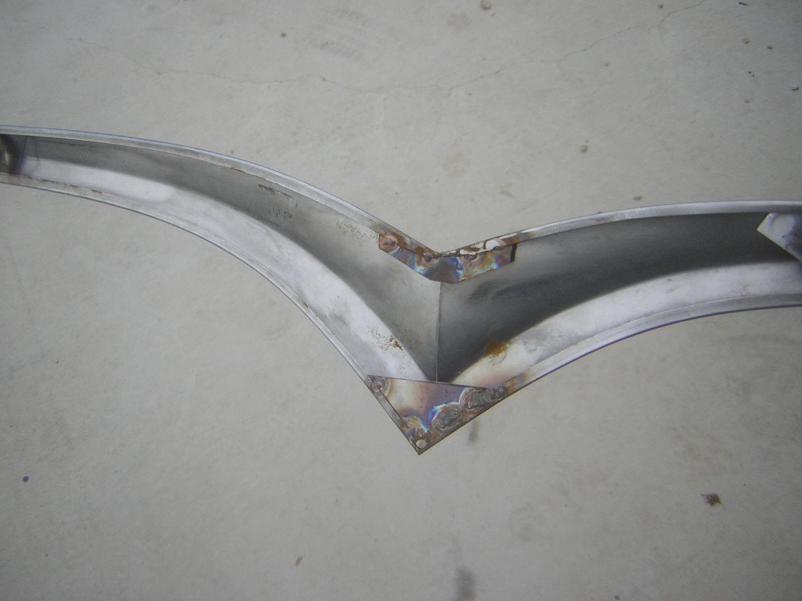

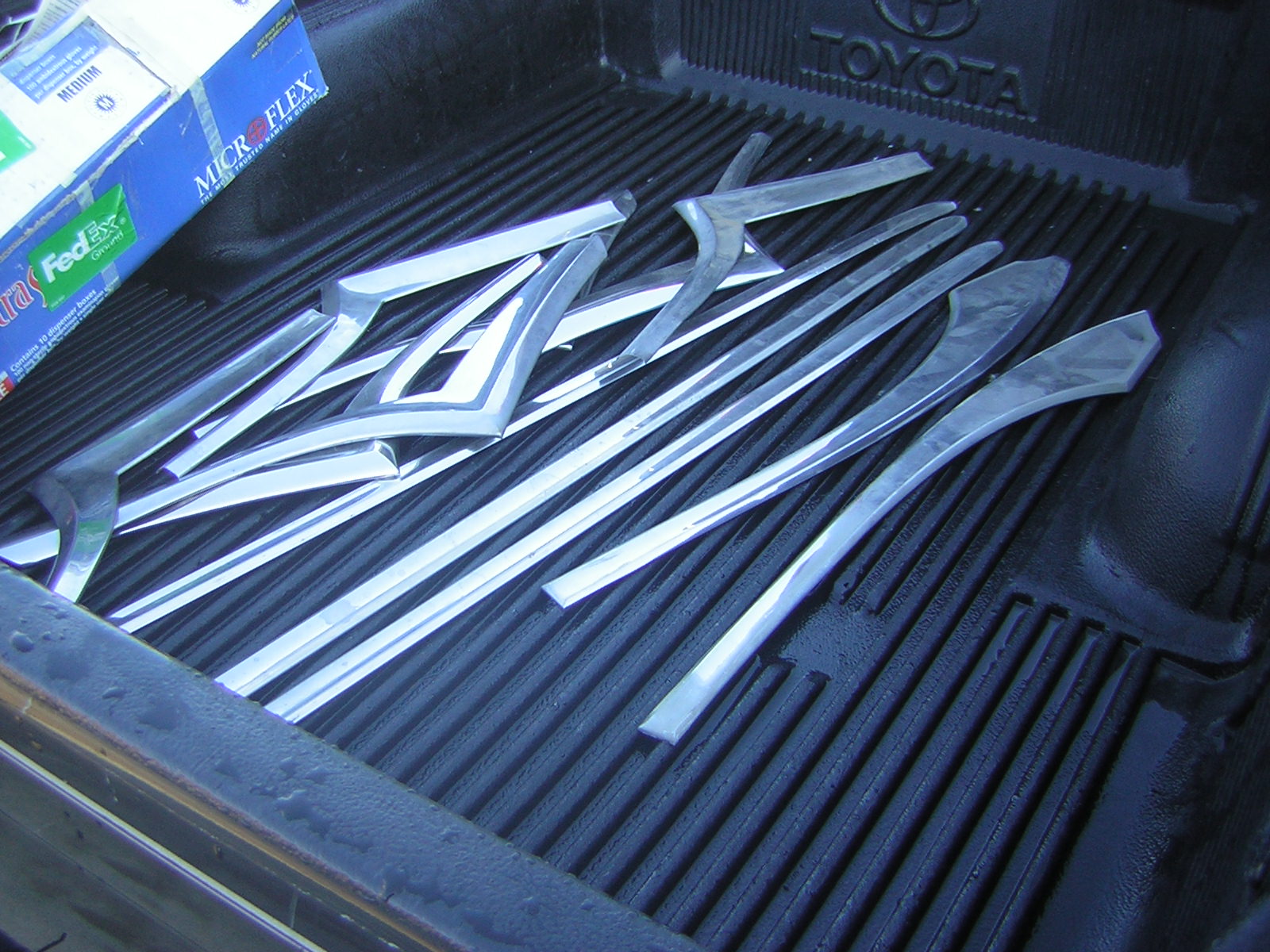

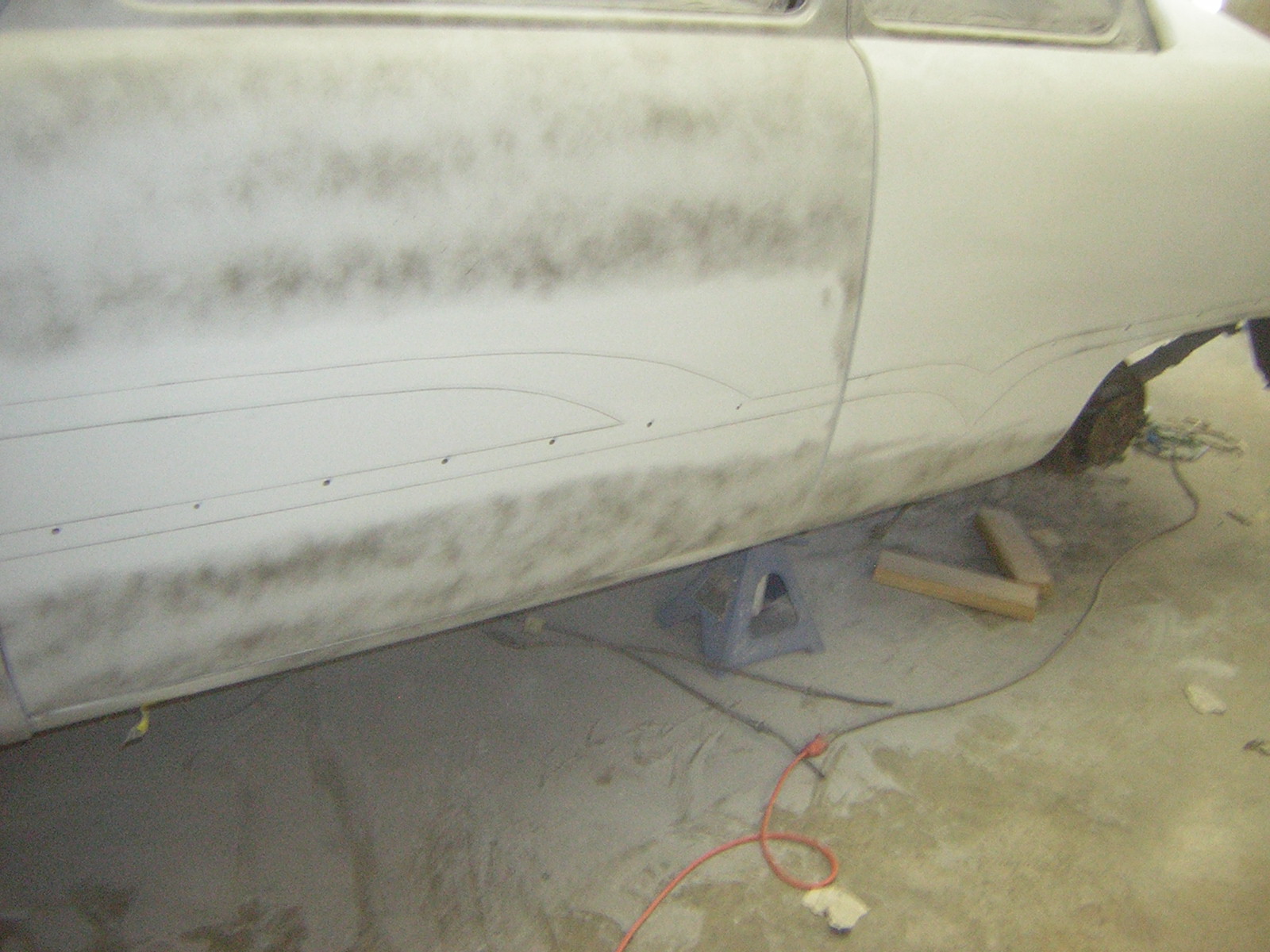

    The theme from the beginning with this build has been authenticity. This carries over to the stainless trim. The lower mldgs are 55 Ford Fairlane 2 door pieces ****ed together. It takes 2 sets to make up the lower configuration. My stainless guy was ready to weld everything up and do the high quality job that he's accustomed to doing. There were great pains taken to continue to communicate to him that what was wanted was something that would represent what was coming out of the Barris shop in the mid 50's. Jr has said that he cut and filed those mldgs to fit perfectly. The welding together idea was not on the table. I'm trying to be careful to also duplicate the splices that are seen in the available pics..
  22. rob-redm
    Joined: Nov 15, 2005
    Posts: 6,557
    rob-redm
    love this build !
  23. jivin jer
    Joined: Sep 14, 2008
    Posts: 3,495
    jivin jer

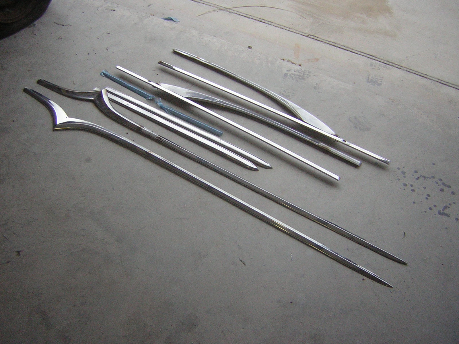

    The first pile is sent to stainless shop. It comes back a little more organized.

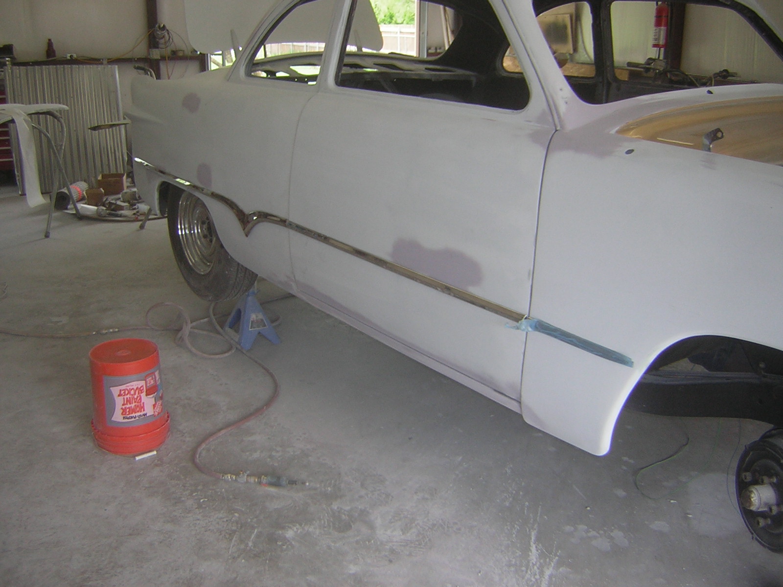

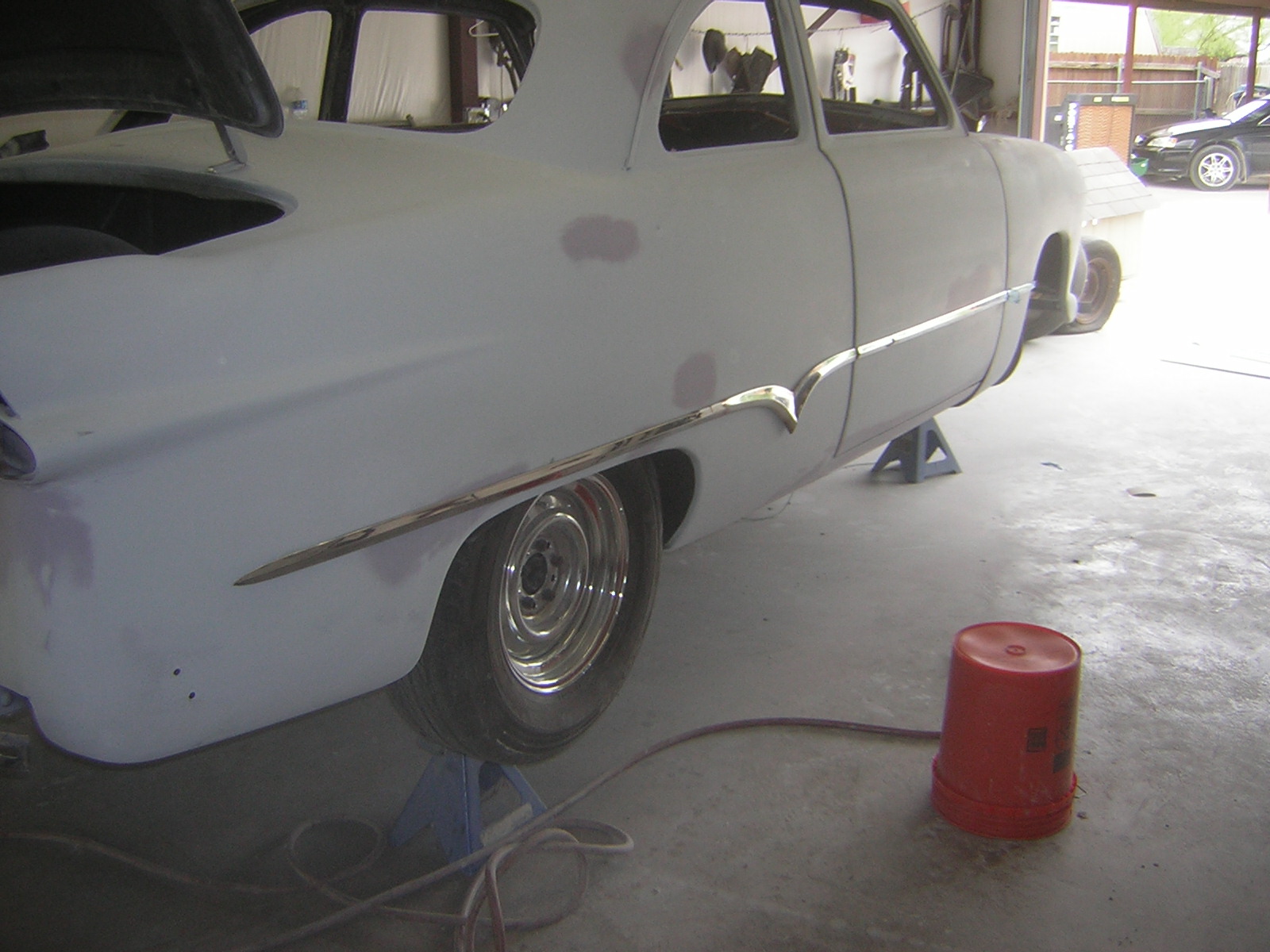

    The lower '55 Ford mldgs attached in the original mldg holes.
  29. jivin jer
    Posts: 3,495
    jivin jer
    This one should have been included with the other.
