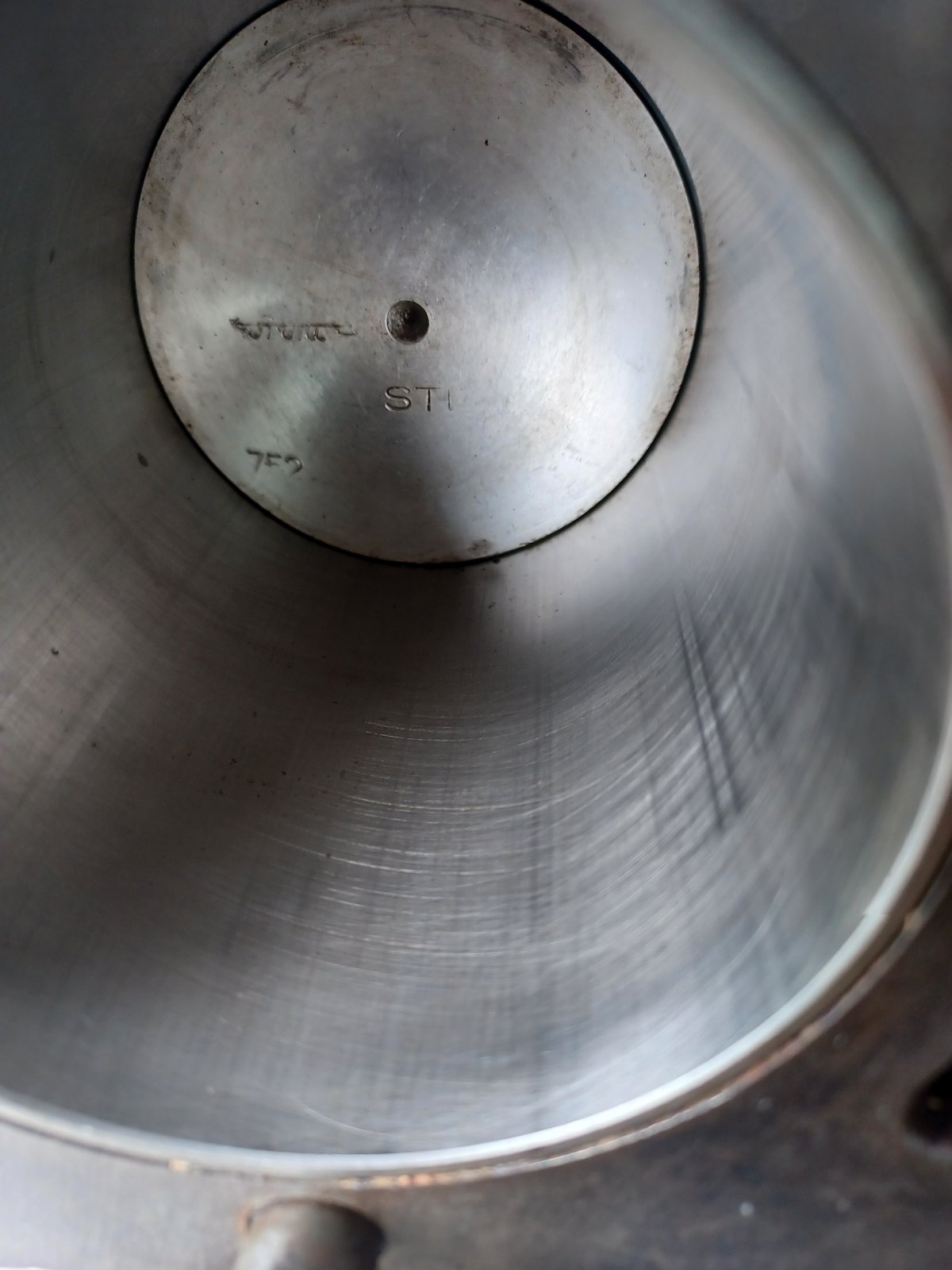

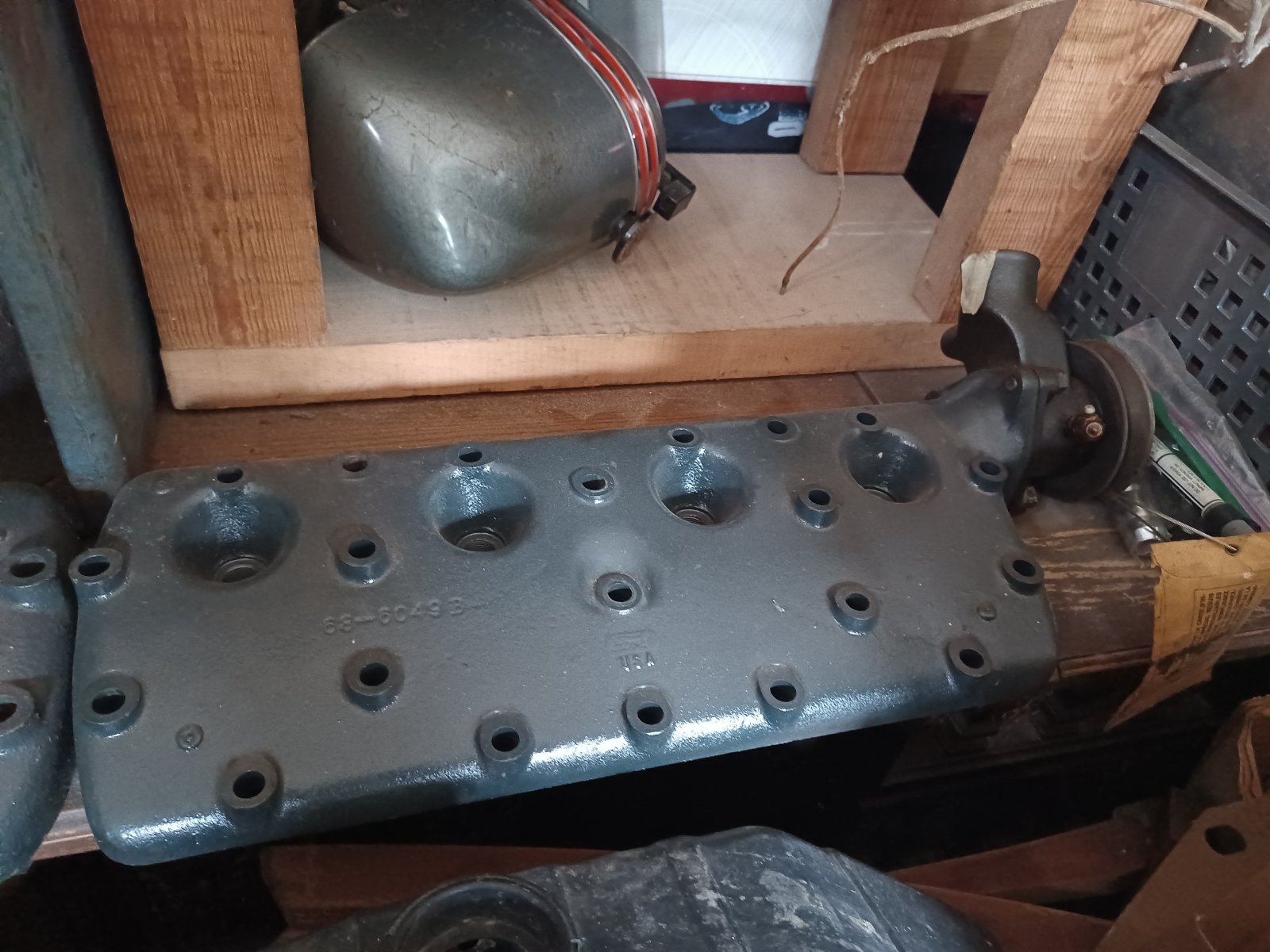

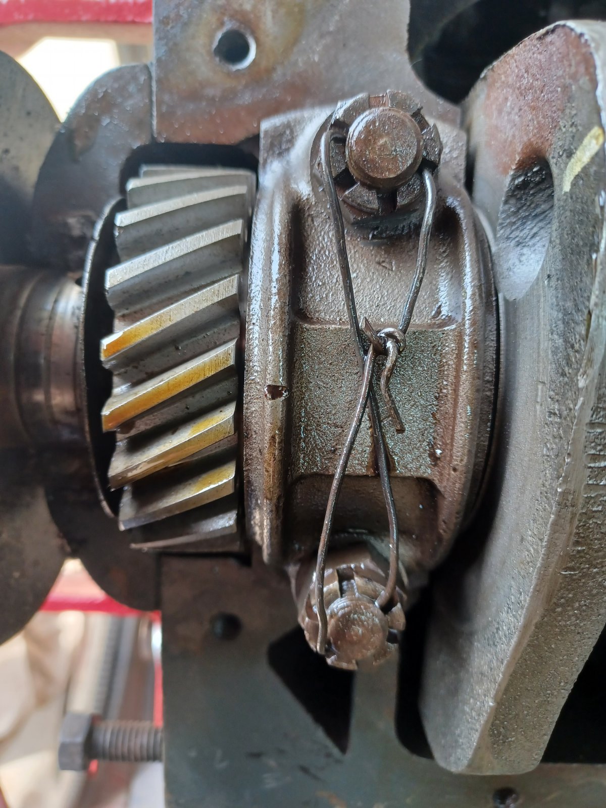

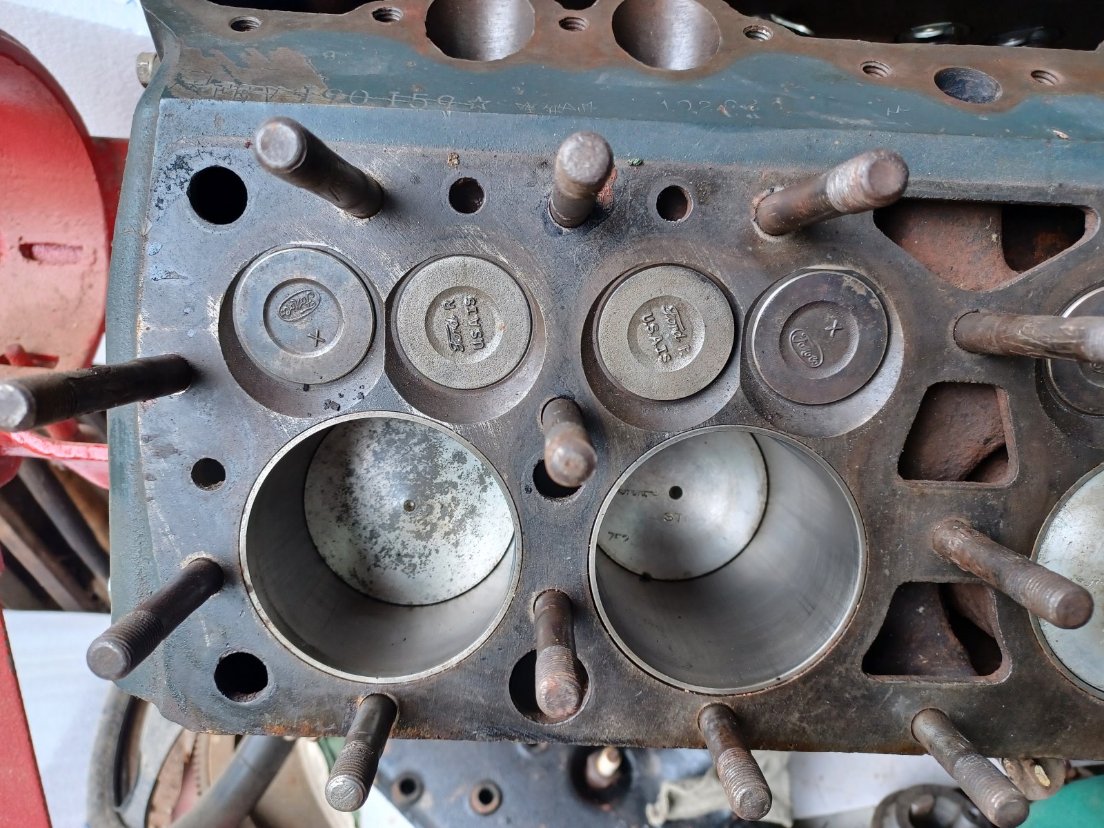

    I'm buying some property and need to sell a few things. I have this 21 stud fresh rebuild I got from a friend's estate a couple years ago. The engine is a fresh rebuild. I'm thinking $3000.00 is a fair price. What's y'alls feelings on this? 20220523_125554.jpg 20220523_125548.jpg 20220523_125446.jpg 20220523_125436.jpg 20220523_125429.jpg 20220523_125423.jpg

    You say fresh rebuild? I think of a fresh rebuilt as just assembled and not run
    in a vehicle or maybe just a run in on a stand. Why are the heads off
    the motor? I observe scuffing in the cylinder walls and what looks like some small
    carbon deposits starting to form. while it does look like it may low mileage I
    would consider that a used motor. I am not an expert, Just an observation.

    The heads are off because they have never been bolted down the cylinder walls look to be new sleeves with hone makes. This engine has not been fired since the build.

    Looks obvious it’s been run for a while, I’d have to question why it’s apart, it’s very clean, at least what we can see, but I would not pay fresh rebuild price. It may be a minor thing, but I’d be looking into it , something’s not right.

  7. Looks like somebody did a quick hone job and maybe re-ring, not a full rebuild

  9. Carbon left on top of the pistons, Std. markings, vertical ring wear that looks like it was just ball honed over. Just doesn't look like it came out of a machine shop.

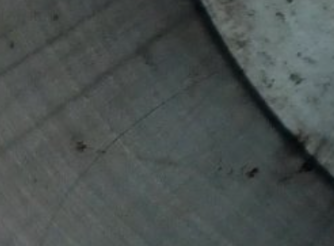

    Probably nothing but have a closer look at this line. I think the price is good, adjustable lifters..

    What cylinder is that and I'll check closer. It looks a lot better than the pictures show.
    VANDENPLAS likes this.
  14. Sometimes pics pick up weird things that are not there
    WTF really likes this.

    To me it looks like the top of the pistons have been cleaned up they look pitted, pitted and scored cylinders with a light hone and STD on the top of the pistons tells me it was just a rering at best not rebuilt.

    It will probably be a good engine, but most likely not done at a shop. I’ve never seen cotter pins in place of safety wire, but who knows?
    If I was guessing, I’d guess a clean up, brush hone and rings and bearings.
    Go ahead a pull a rod cap or two and the main caps, get a look at the bearings and the crank.
    Also the heads looked to have been wire wheeled off, not surfaced.

  20. It was obviously sleeved back to standard bore (which is fine) based on availability of replacement pistons. Still a good idea to pull bearing caps. Continue taking pictures (hope they have a date stamp) to show prospective buyers.

  24. My current project involves a’34 flathead that was reman back in the day yes they had cotter pins on the rods and safety wire on the mains
    Judging by the intake I say this has insert bearings
    Yes the pistons are used but looks like the thin walled sleeves (8n tractor style)
    One has a crack but is dry sleeve so no problem
    Looks like it has valve seat inserts (mine does)
    Has later dome pistons and heads instead of flat tops

    And the safety wiring on the mains sets of alarm bells for me
