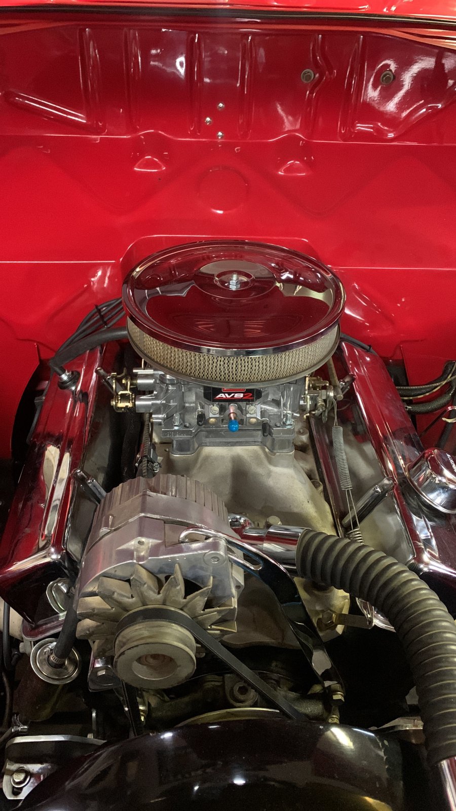

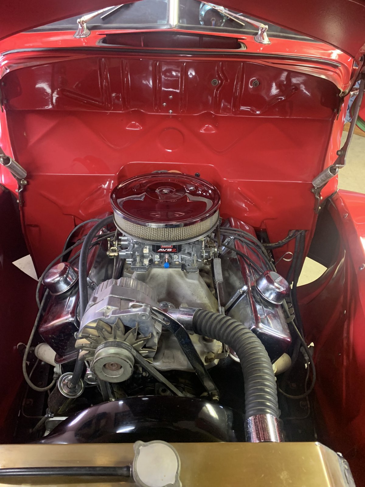

  8. Huckster59
    Joined: Aug 21, 2008
    Posts: 574
    Huckster59
  9. Huckster59
    Posts: 574
    Huckster59
    i have 62 corvette 327. eddy carb.
  10. Huckster59
    Posts: 574
    Huckster59
    this is how it is now. pcv p*** vented oil cap on drivers side
