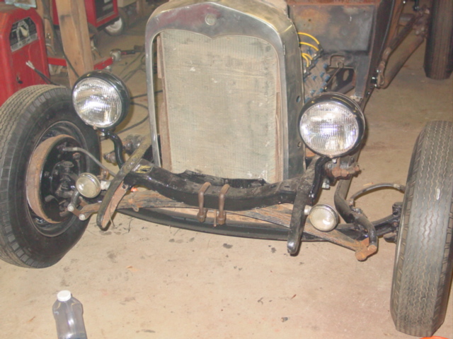

  5. would you still need a pan hard with the bones mounted under the frame similar to unsplit bones? below is a picture of what i am talking about.
    i am building a 32 truck with 33/34 bones 4"drop axle and i entended to use a 40 steering box set up with crosssteer but i do not want a pan hard. i like the way the frame in the picture is set up, but is it going to be enough?

    Panhard bars were not necessary on pre-42 Ford Passenger cars and pickups even with split wishbones IF the spring is mounted in tension as Ford designed it to be. Cross-steering was stock on Fords without Panhard bars from 1935-41.
    If you have wishbone interference try modifying the steering arms up or down or hooking up the drag link to the tie rod inside the wishbone area.

    "Think about it....", the steering box ISN'T pushing sideways on the AXLE. It's pushing / pulling on the spindle arms which rotate about the ends of the axle on the greased kingpins. Henry didn't have any problem making this system work from '35 on. Just how many "traditional", or stock for that matter, '35-'40 Fords can you count that have, or need, panhard rods? My raggedy ol' '40 goes on down the road just fine (pretty nicely, as a matter of fact) without one, thank you. DD

    My jalopy fits that criteria and it drives like a dream. Have an F1 box and started to go that way and didn't like the concept. Used 37 axles, tie rod & drag link and box and a joint to make the steering wheel come in the right spot. Never any hint of wobble, shimmy, or whatever, and tires were never balanced.
    If you have stock leingth shackles with proper pre-load, no need for panhard. Later (postwar) cars had 4" shackles, had to have panhard & sway bar.
