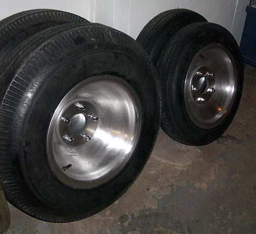

    I've been shopping for tires for my Halibrand Smoothies, and I've been having no luck with finding a nice matching set in 15" size.
    The rims are 15" x 4.5" up front and 15" x 8" for the rears, and will be going on my roadster project.
    I'm looking for sort and norrow tire for the front and tall and wide for the rear. They also need to be bias-plys and black walls. I'm not sure to go with ribbed or smooth side walls.
    Any feedback and pictures would be appreciated!

    I had about the same wheel on my car , sold wheels / tires but kept car.Tires are Firestone from Coker.Fronts are 6.40-15 , rears are 8.90-15.Rears this size only come in whitewall,I turned it in and painted it out.Rears are the greatest overall dia. that Firestone makes at 31".On my car a smaller tire size looked wrong ,front and rear. If your after a '40's , early '50's look as I was , remember that the smallest 15" tires in the early '50's were not what many use today.Smaller tires really weren't available until the VW got popular in the mid '50's............

    I'm thinking of going with B.F. Goodrich Silverstones, 5.00 and 8.20's.
    Anyone have a good picture of these being used!
    Tubes or no tubes? That is the question!

    An 8.90 is perfect on an 8" wheel. The cross section is 8.8" the tread is 5" wide and the height is 31" that's as tall as you can get.
    http://store.coker.com/890-15-firestone-5-ww.html
    Firestone Indy tires didn't get popular 'til the late 60's into the 70's. Those tires are too low and too wide.

    I finaly got the BFG Silvertown from cooker and had them mounted at Norm's Tire today.
    They look better than I expected. I can't wait to put them on this spring!
    :D
  29. Perfect choice ! and unlike the the ribbed fronts and dirt trackers there DOT legal.
  30. Looks good.
    Do the wheels have the SCTA mandated back-up plate on them?
    If so, are they mild steel, plated, stainless?
