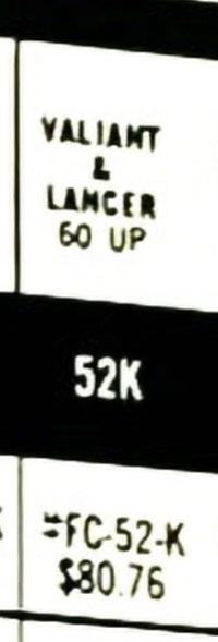

    Saw this on Ebay, I am ***uming it is for Early Hemi, but can't figure
    out what transmission it might fit, either originally or with the plate that
    looks to have been added...
    ANYONE GOT AN IDEA ????? THANKS

    Sorry to seem thick, but to confirm, if you have the early powerglide adapter piece, you can bolt this to a small block
    Chevy and then hook up a stock Chrysler Stick ****** ?????

    that is what I said. Yes, it's confusing, don't feel bad.

    Les...thats a real oddball piece. You have to have the cast iron starter plate and it looks like it's for Valiant/Lancer manual trans...the steel bracket is what the "K" is in the part number. It's original to that adapter.

  8. I wasn’t sure on the part number,,,,but .
    I knew it wasn’t for a Mopar,,,,,,the bulge for the starter nose was on the wrong side .
