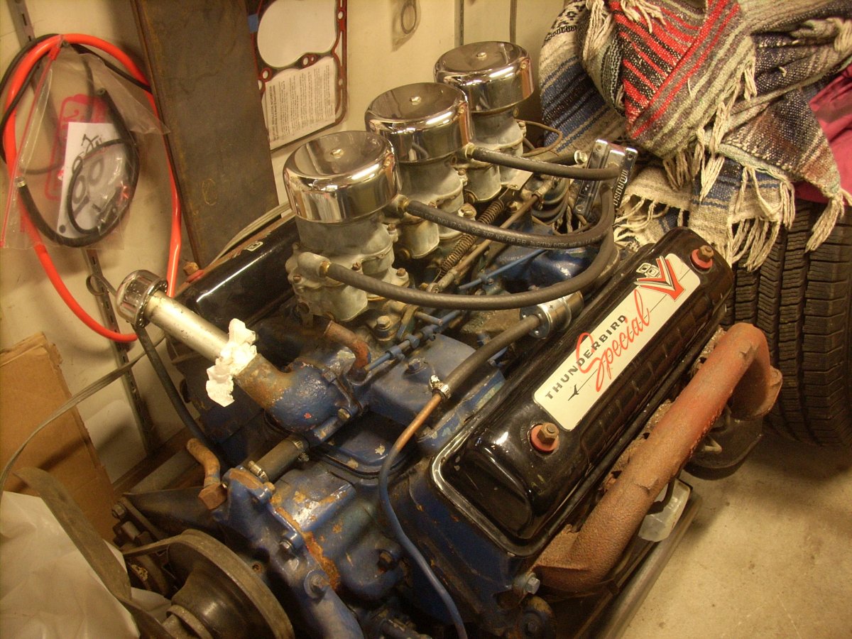

    Y***uh, Boss! Costs a little more for parts than that motor everyone else has, but you can get a 302 HO Mustang motor that'll do what you want. I've had 2 of them; one set up with an auto. ****** (C-4), and one 4 spd. ( and the distributor is in the FRONT!! What a brilliant idea!!)
