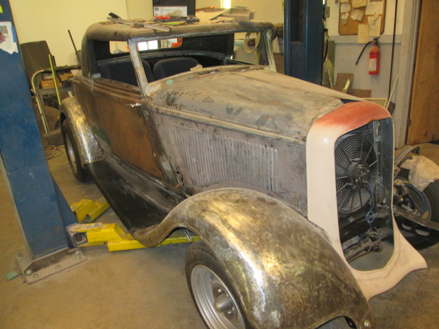

  1. been doing a little sheet metal work on a friends 33 Plymouth. thought I would share. photo (11).JPG photo (8).JPG photo (10).JPG photo (15).JPG photo (15).JPG photo (14).JPG

  6. im going to try to post more pics soon. I have a bunch on fabing the wheel wells, lower qtrs. and cowl and rear qtr extensions. It still has a bunch of metal finishing to go. It will have a rumble seat and bumpers but we need a front one. The motor is a 354 with a 904 trans. The original seat and column are being used as well. Hopefully the floor will be completed this week. The rear spare tire holes and side mount spare fender recess are next to be filled. I refuse to fill the roof insert! It will use the hood top only for now but I have some ideas on shaping the louvers on the side panels into a "bubble" to clear the valve covers.

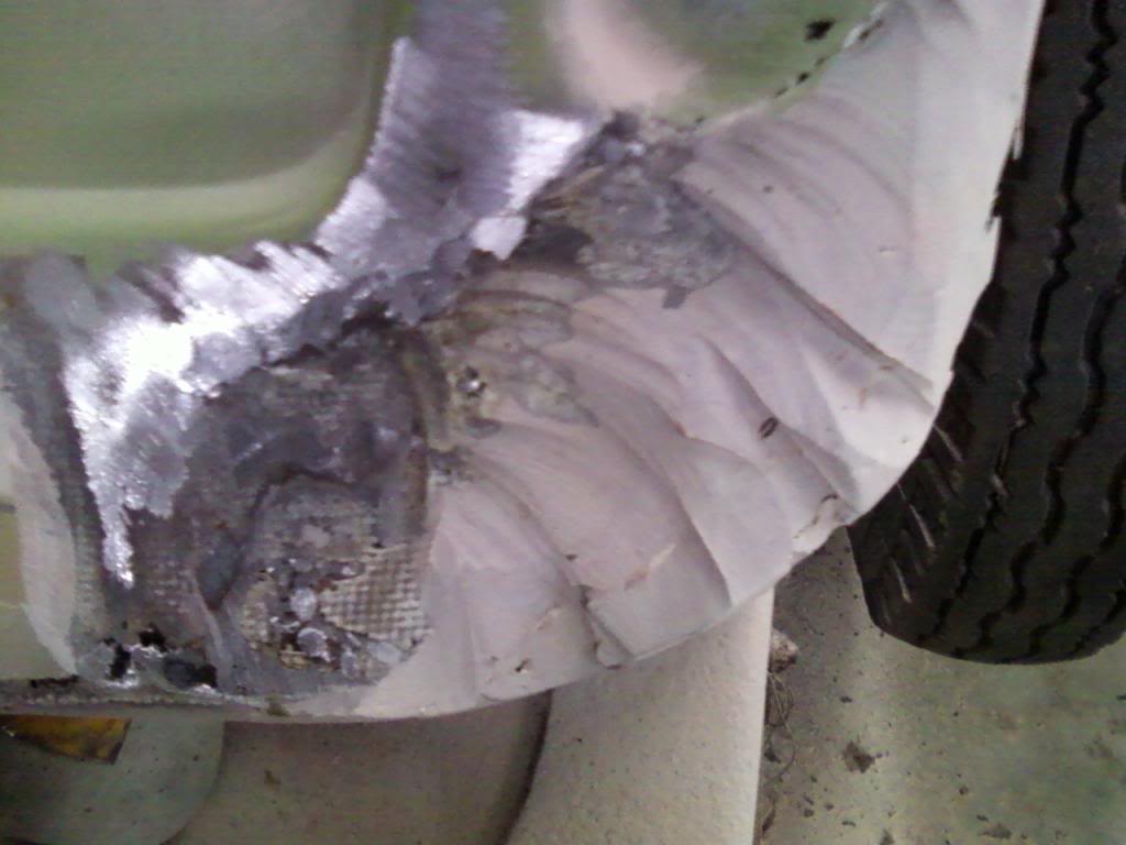

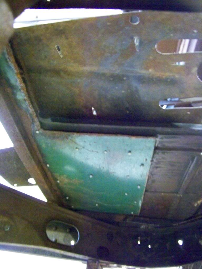

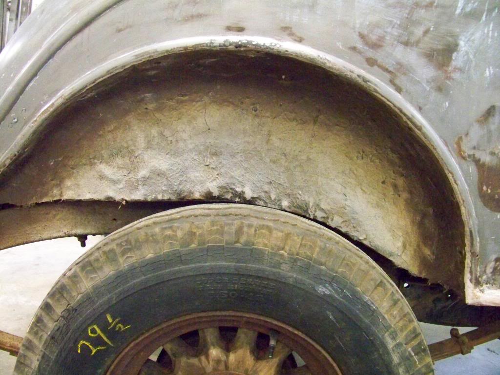

  8. hope these pics come thru, still learning how to do this. any way here are some before and a little fab pics. My favorite is the dumpster floor material.

  13. got some floor work done, just have to fit the brake pedal and finish welding

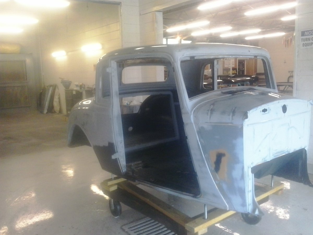

  17. in the booth

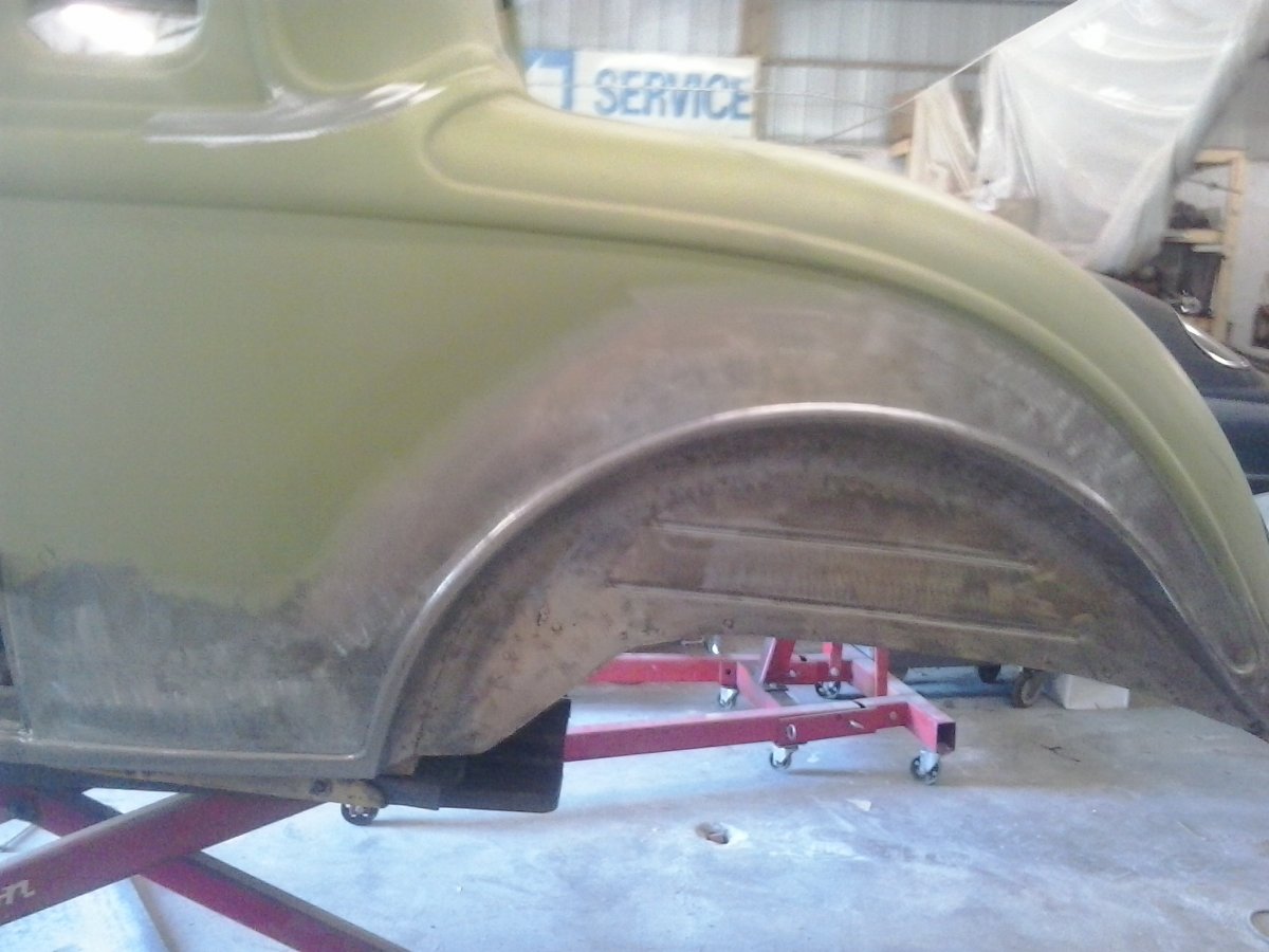

  18. found some lost build pictures cleaning out the phone
    here is one of the new wider wheel houses

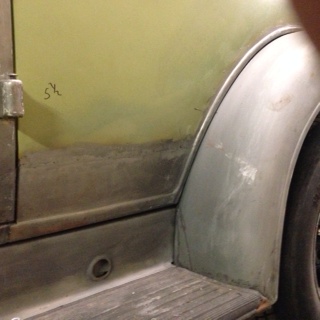

  19. some lower QTR love

    Ugh. I remember all that rust in all the same places. Mine still has some of that rust. Beautiful work on this one though! I like the floor and wheel well work. I'm inspired. I don't know how these cars got so passed over by the aftermarket. Rust repair is a challenge as so few parts are available. Show more!

  23. thanks, there are rear bodys and most of the lower patch panels available, but I like making my own
    they are not very hard to make
    the wheelhouses were made the old school way, tuck shrinking and a hammer and acetylene bottle cap that is welded to my bench. they are 1 3/4 inches wider than stock and have the same shape and contours of the originals
    the lower qtr piece was hammer and dolly only with a little shrinking
    the floor was the simplest, just some good patterns and my modified harbor freight bead roller
    the time consuming part was fitting them together, all the exterior sheet metal is file fit and but welded

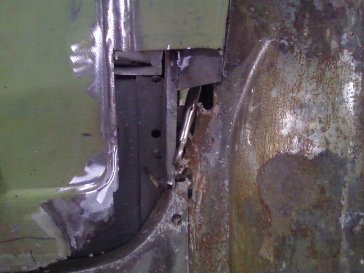

  27. found a couple of more pictures
    here is the wheel house tig welded to the qtr in the center of the bead

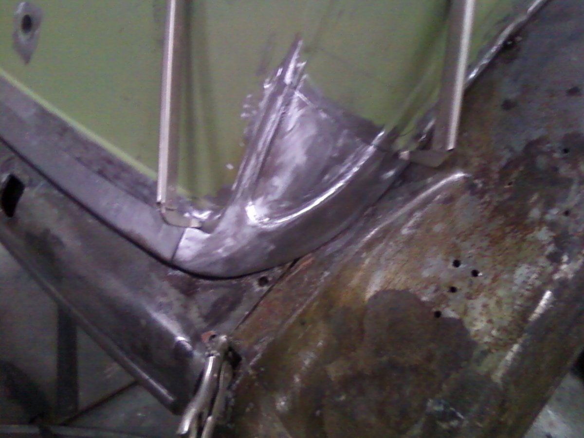

  28. here is the lower QTR welded just before metal finishing
