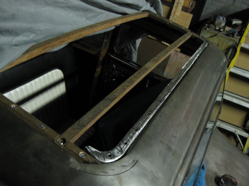

    I measured the hole in my roof, and cut the center of the roof out a little wider so that I could trim it to size later. I also cut it waaay longer than it needed to be so I could match it up where it fit the '29 the best. The easiest way to keep everything centered is to mark a centerline down the roof, and measure off of that. You want to be sure that you are keeping the crown of the roof centered.
    Here's the trial fit after hacking it apart.
    That's where the crown seemed to match the best, judging from the fit of the roof to the wood top bows looking from the inside of the car.
    After t******* it to size, and rounding the corners, it's starting to look better.
    Some of my top wood was sticking up above the sheetmetal, so I had to shave it down to get the insert to sit flush down on the body.
    I made this piece to attach the front of the insert so I wouldn't have to drill through the body. It also helped to strengthen the header of the car a lot. If you look at the wood that runs from front to back, you can see where I have already drilled and countersunk the wood for 10-24 countersunk screws...these get welded to the insert.

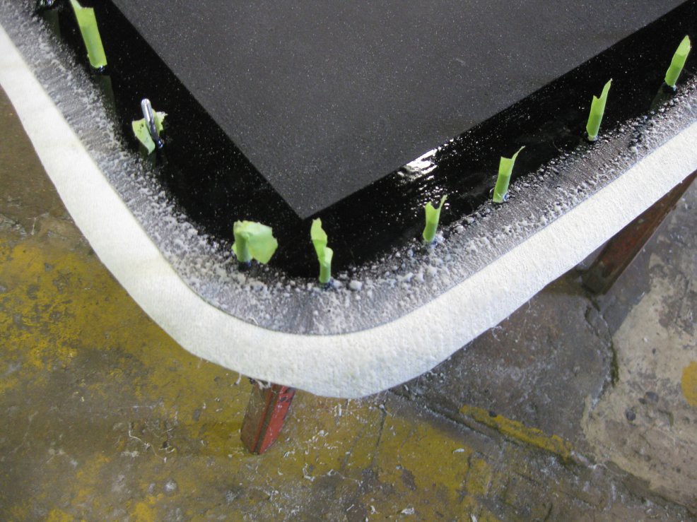

    The next step was to pull the insert off and paint it. I covered both sides with POR-15, and then rolled "Lizard Skin" on the bottom of the insert. I wanted to insulate the bottom somehow to keep it from radiating heat through the eventual headliner, and this stuff seemed to be the best option. It took five coats to get the recommended thickness.
    After letting it sit overnight, I flipped it over and glued the **** out of the top side with industrial cement. Then I attached 1/8" closed-cell foam. I didn't want there to be a tall edge where the insert met the body, so I feathered the edge of the foam inward with an 80 grit disc on my DA (on spin). Then I finish-sanded by hand with 80 grit on a block.
    If you are planning on trying this yourself, be sure to scuff both sides of the foam before glueing to keep it from seperating later.
    So with that done, it was time for the material. I thought about using the short-grained vinyl that is commonly used on Early Fords, but I don't particularly like the pattern that the grain has....so I found something I liked better. It's just a heavy grain vinyl that comes in late model Fords...not too shiny, and no pattern in the grain.
    Here is the material after t******* it up a bit.
    This shows how the glue looks after spraying it on. I let it sit about 5-10 minutes before sticking it together.

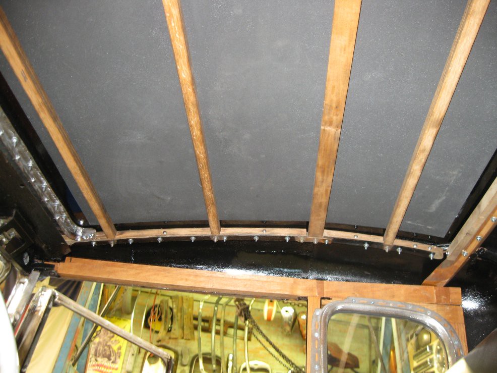

    Once installed, this is what it looks like from the inside. There are 50 screws holding it on. You can also see how tight the insert is to the wood bows....the Lizard Skin helps here to keep the wood of the metal. I didn't want any squeeks once the headliner goes in.
