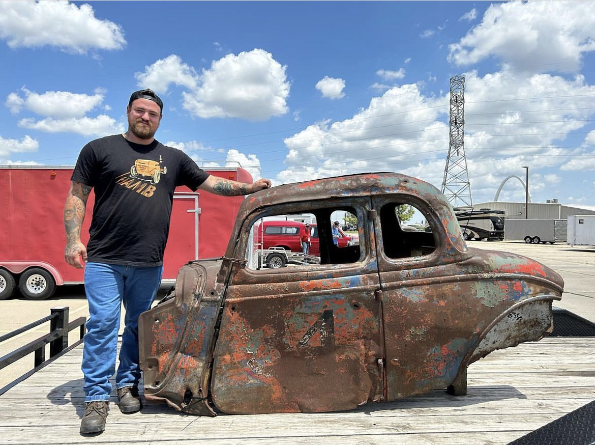

    It finally happened fellas, I got my 34 Ford.. Seen an ad on the internet one day on break and decided to see if the fella would split up the bundle he had listed and sure enough he would. so I sent him 500$ to hold it till next weekend and I made a plan and sold a buncha stalled projects and engines and got the rest together and went on my way with a good buddy to the speedway museum. Turns out I bought it from the curator! Tim Matthews. stand up guy jus as nice as could be! But it doesn't end there.... 34 coming home.jpg

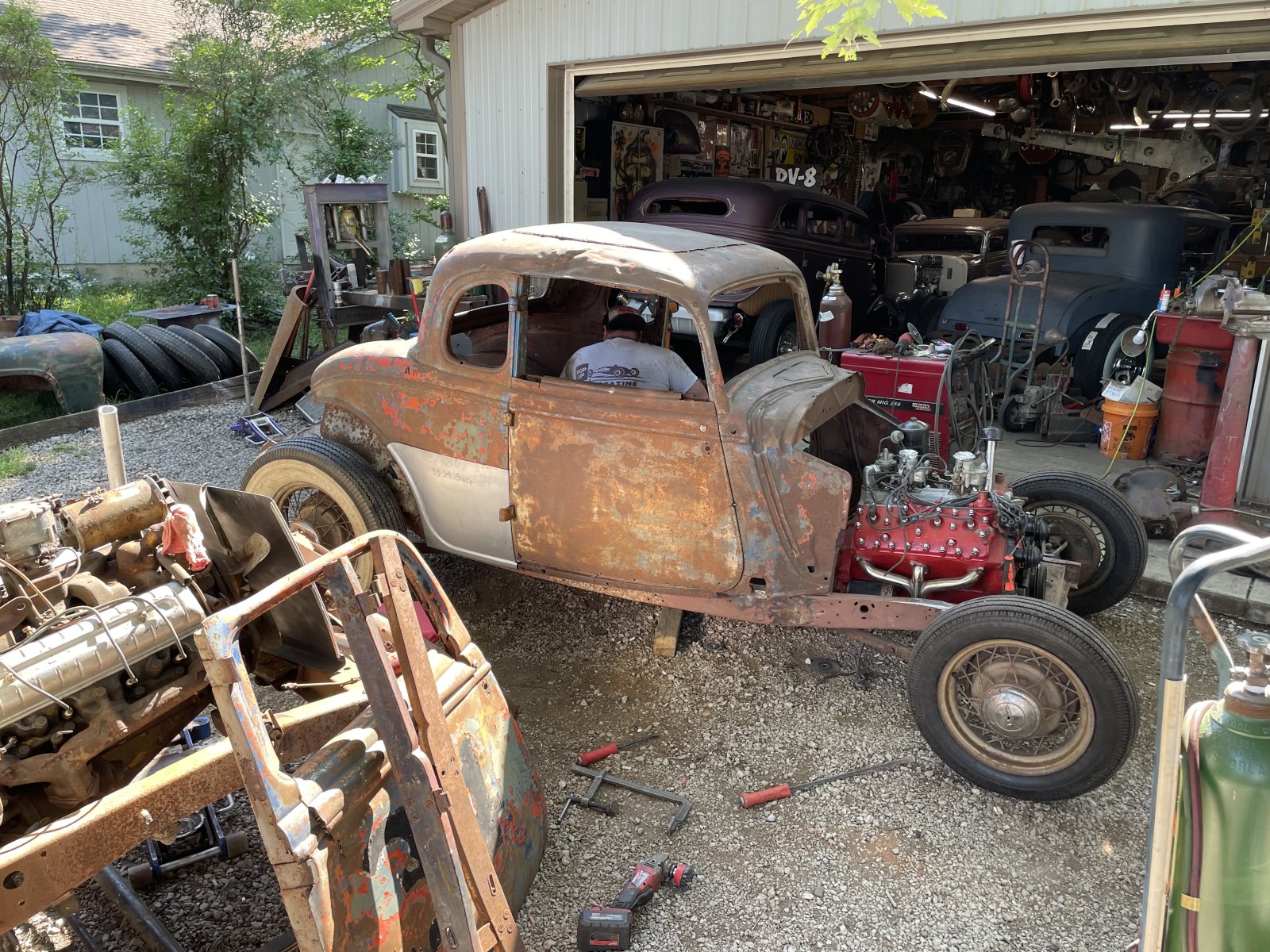

    now it gets good body on frame fellas

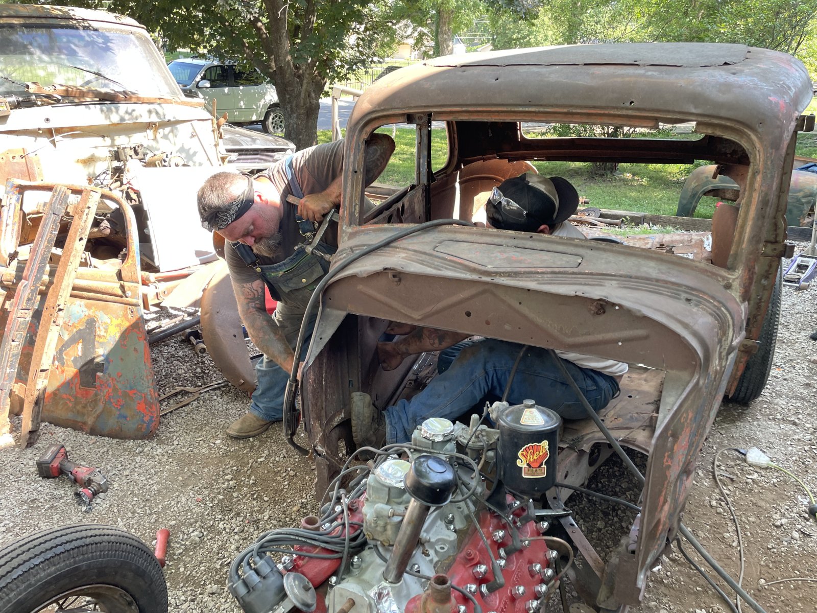

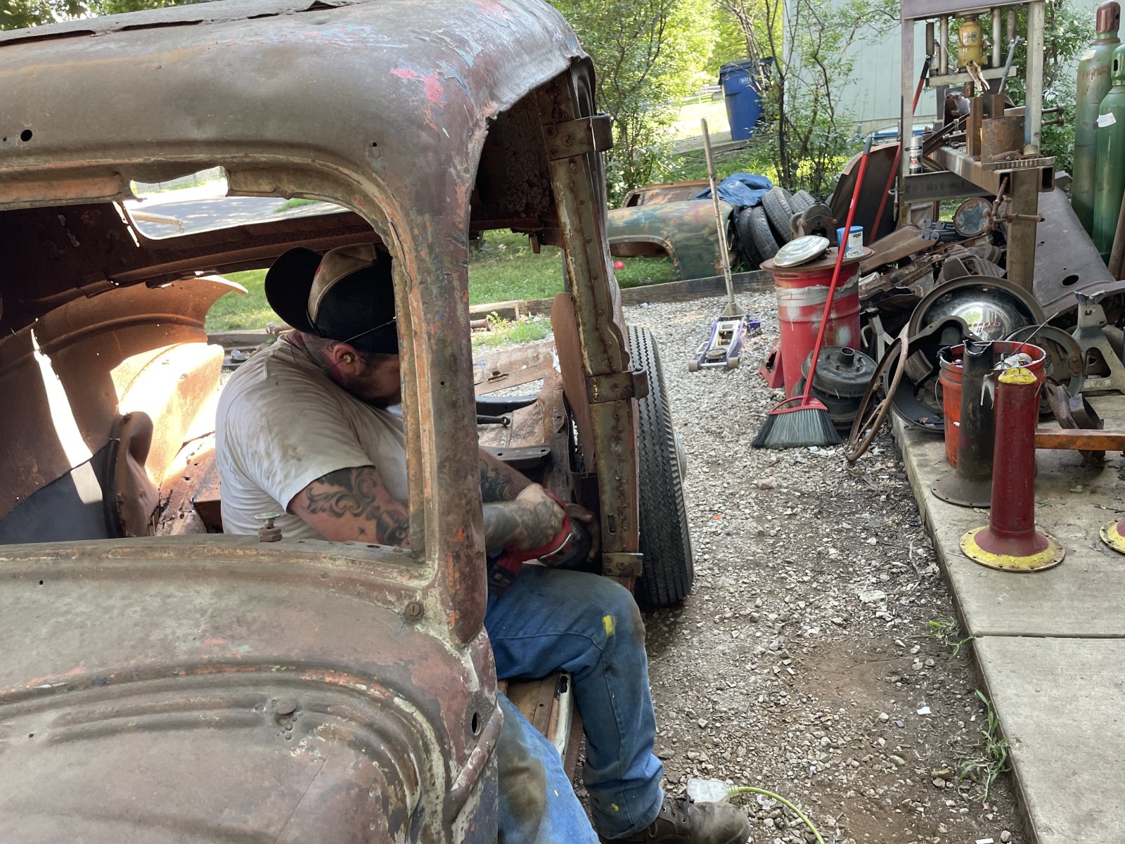

    Had to cut the fire wall out to move back about an inch, and cut out the C pillar support on the floor as it came out of a sedan.

    IMG_7523.jpeg For what’s there is extremely solid. For what’s not there. Well as he showed it ain’t there! A pretty dang good gutted track car it’s got a ton of character and good vibes in person. IMG_8114.jpeg this is FOUR work days of progress.
    Major frame repairs and straightening. Jimmy and Austin seem a dream match, Jimmys got the recipe down and Austin is as hard of worker as you’ll find outside of a John Henry poster. I wish I could have been more help but
    The jump in and cut that **** out and replace it with no hesitation was really fun to watch. IMG_8108.jpeg new floor, new sill plate rockers, new spliced B pillars new door halves, cut the door off the car and hang it back with hinges that wasn’t even all of one day. This things gonna kick major *** and it’s all 100% old ford IMG_8105.jpeg powered by his grandpas flathead he’s sure to make the gathering at the roc. Come give him a pat on the back as he crawls out of this Tom fritz painting in Oklahoma and be sure to stay tuned! He’s got some awesomeness in store!
