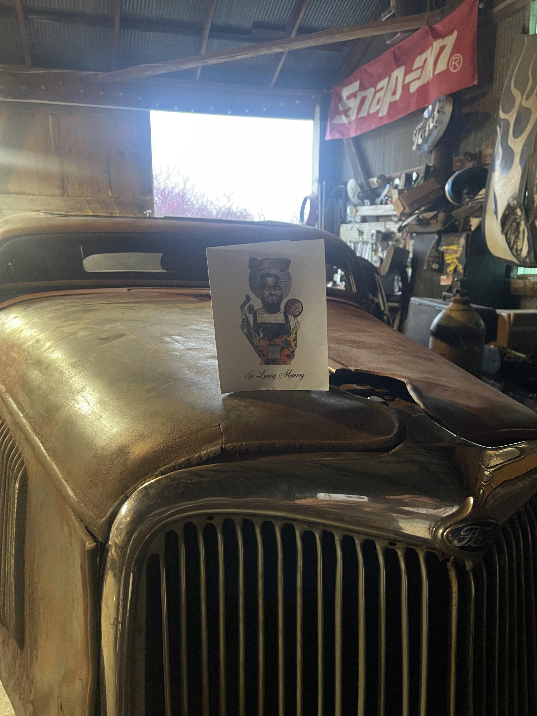

    Well it wouldn’t feel right to not add one last Jimmy comment to my thread here being he was such a huge part in making this jalopy happen. Rip my friend IMG_6497.jpeg

    my condolences man...I labor away at this hobby without any car guy friends at all wishing every once in a while for someone to lend a hand, or shoot the **** with in the shop, or even to understand my stories or the nerdy facts I've collected...those friends are few and far between ...maybe his memory will be a motivator...RIP
