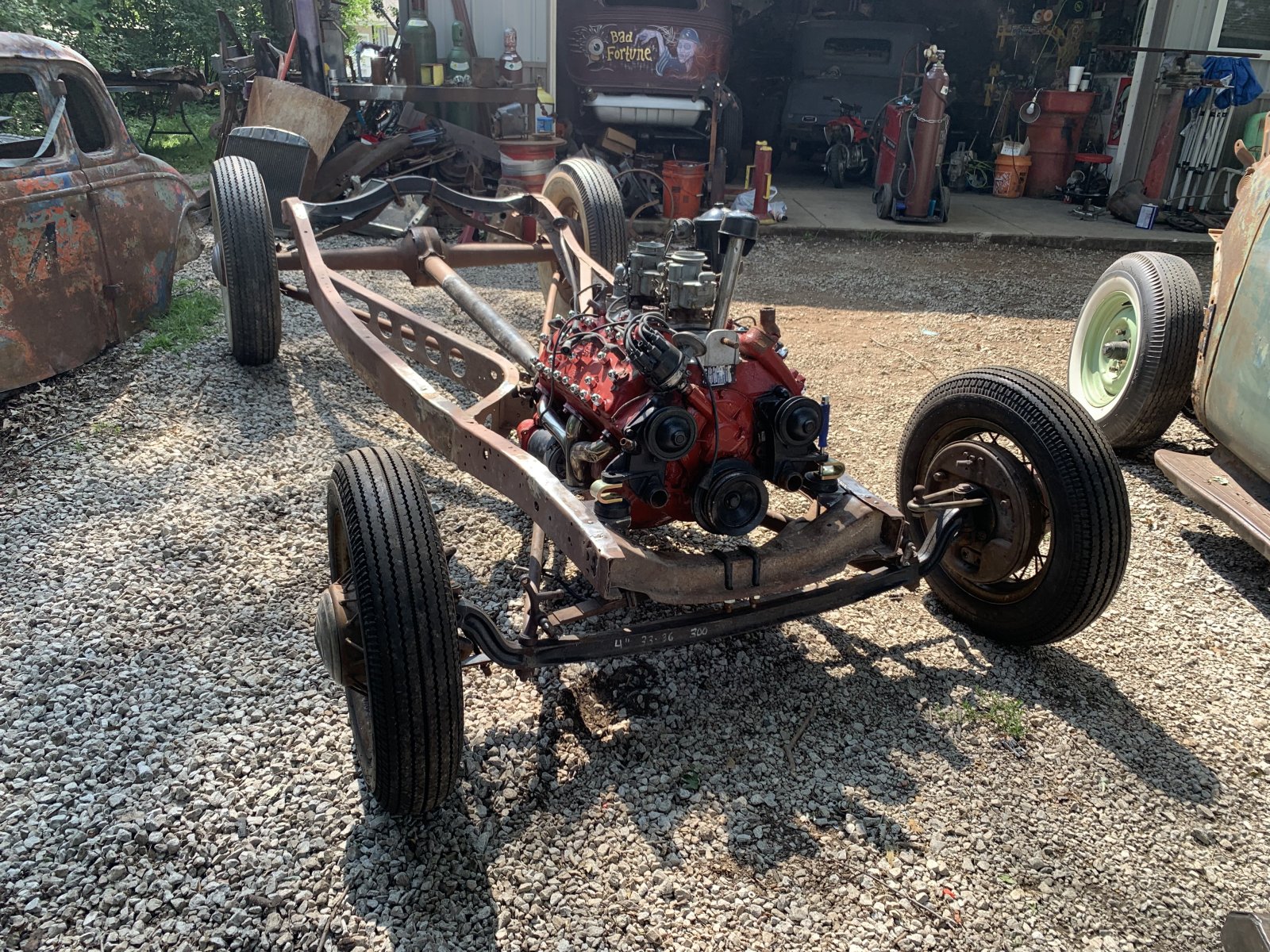

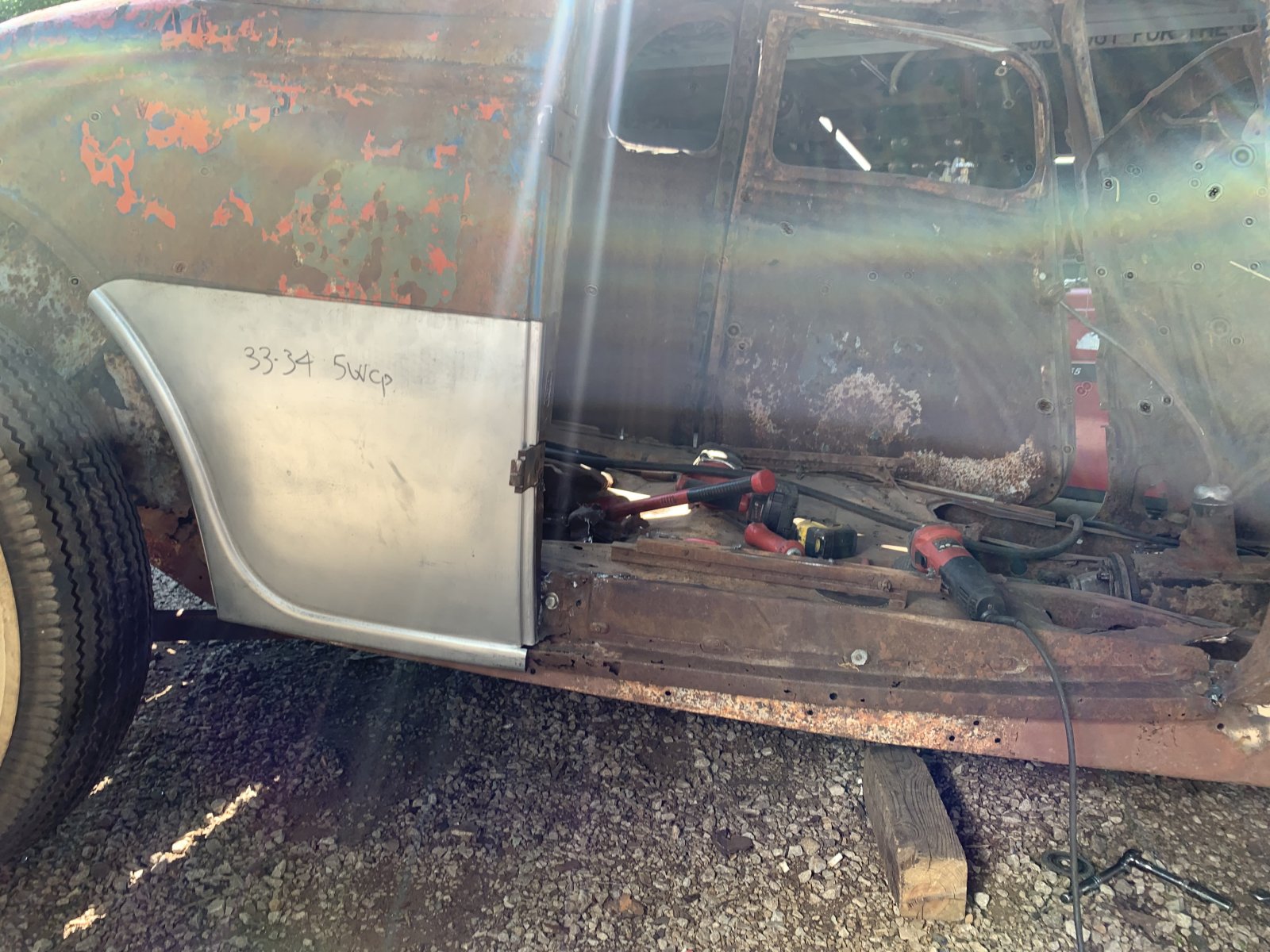

    Glad to see everyone chiming in! Ive got big plans for this and already put alot of it into action. Once these pesky B Pillars get squared away ill post detailed pics of the chop. Gonna get her way down there. Ive got a couple months togo until the Roc but if I can keep this pace itll happen!

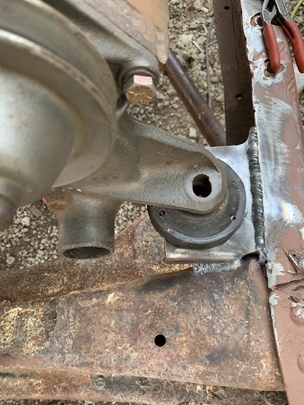

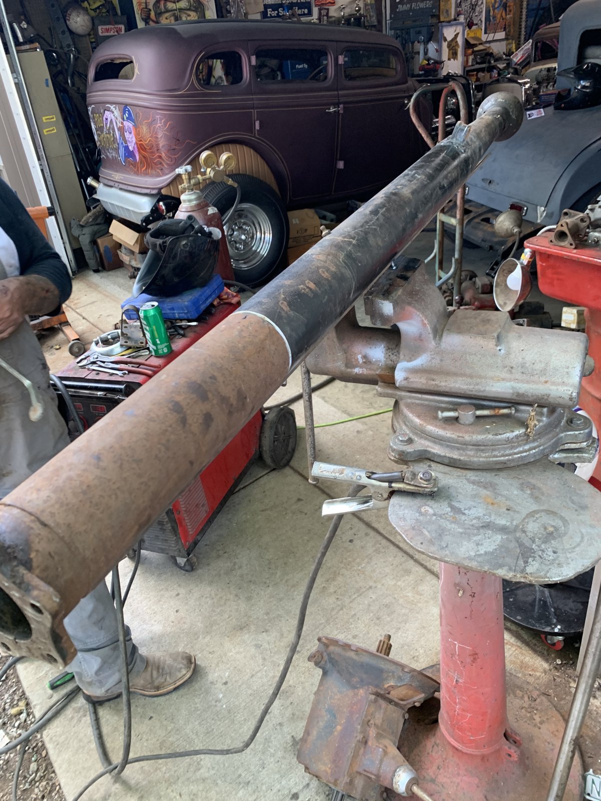

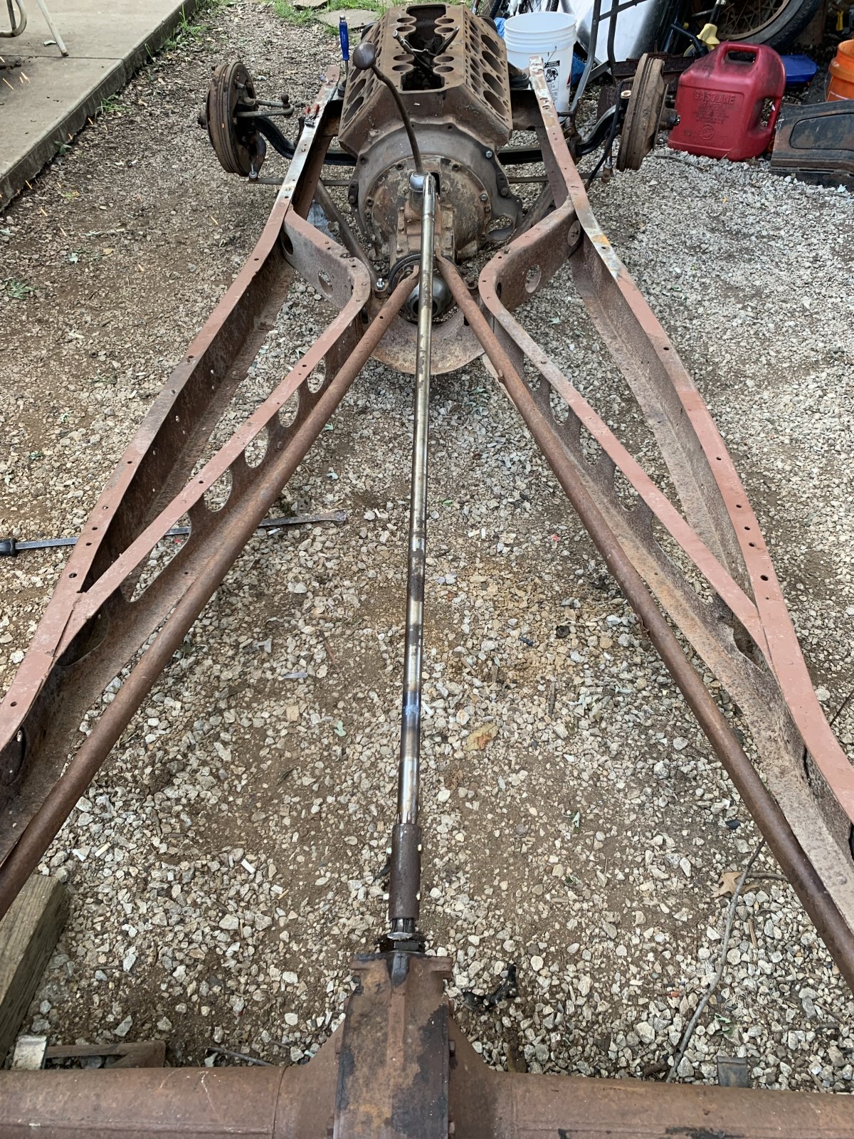

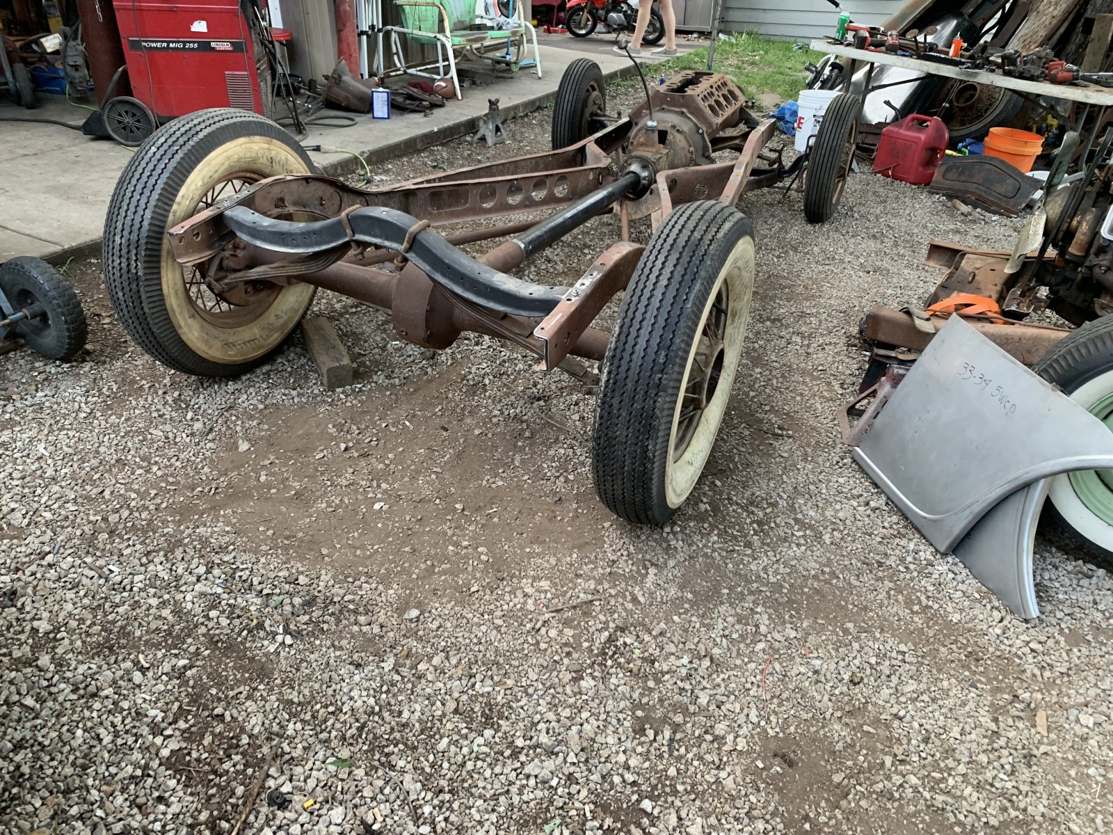

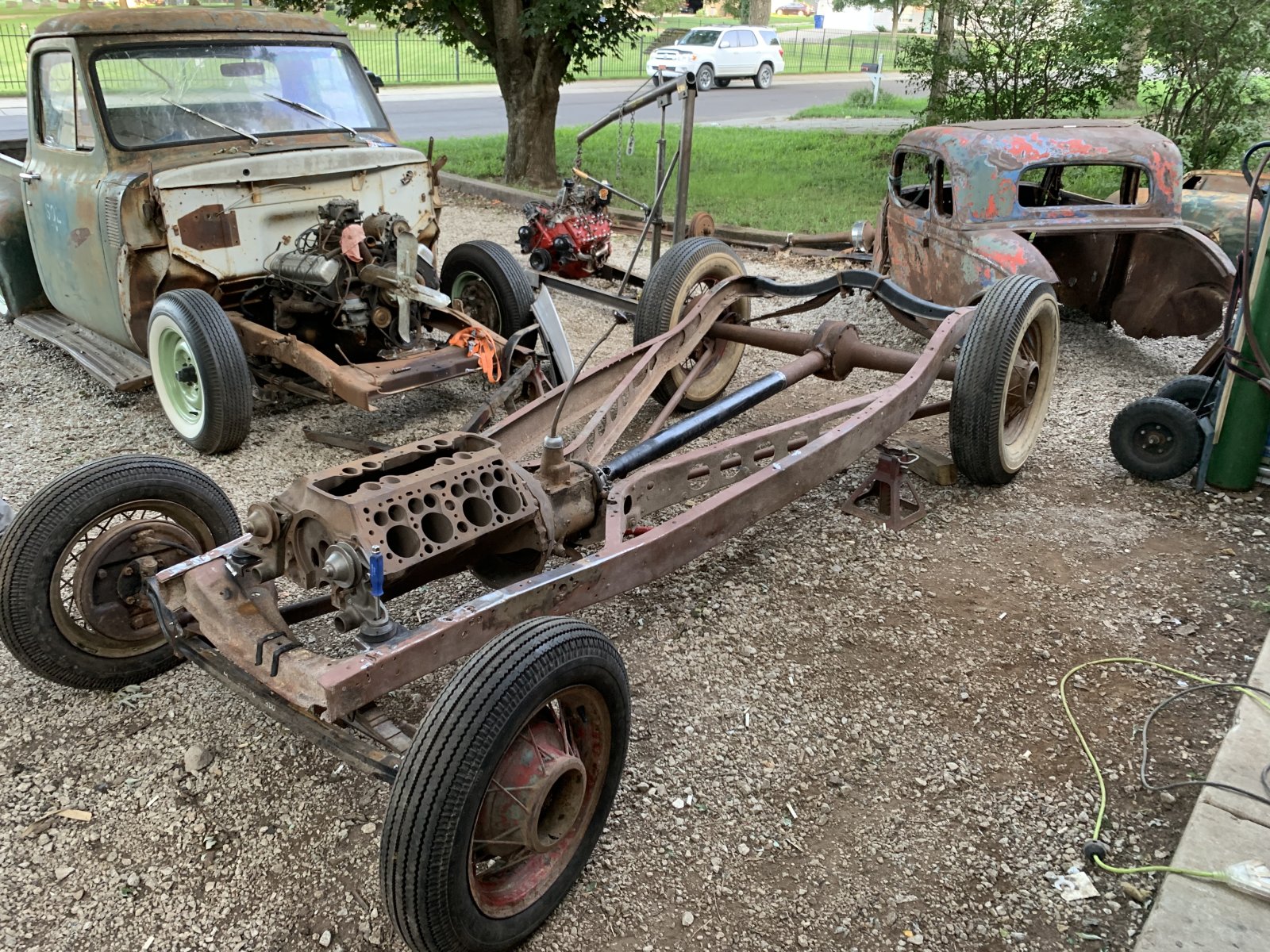

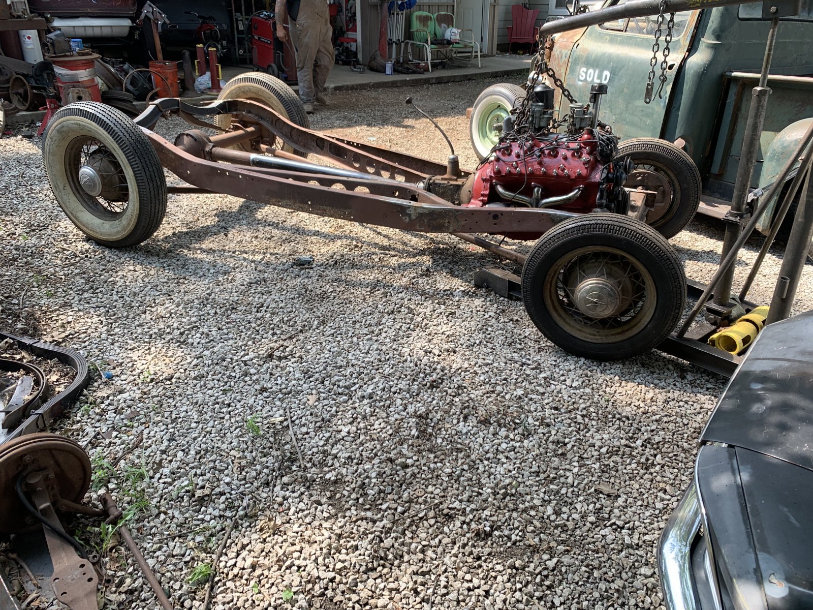

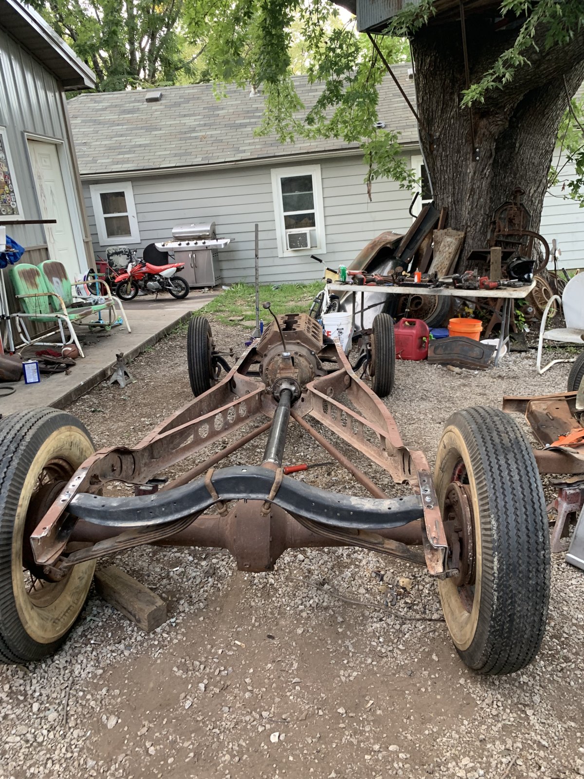

    Think my photos got ****y uploading fellas so here’s another wack at a few of the highlights B0D3BD0D-26B3-4DA9-AE0B-BD40891D7734.jpeg B0D3BD0D-26B3-4DA9-AE0B-BD40891D7734.jpeg 7A4191B6-9830-4701-8E66-C7931F047A16.jpeg B99FDEA8-8C85-417E-960B-C3E38B629B9C.jpeg

    @Austin kays the photos loaded up better this time!
