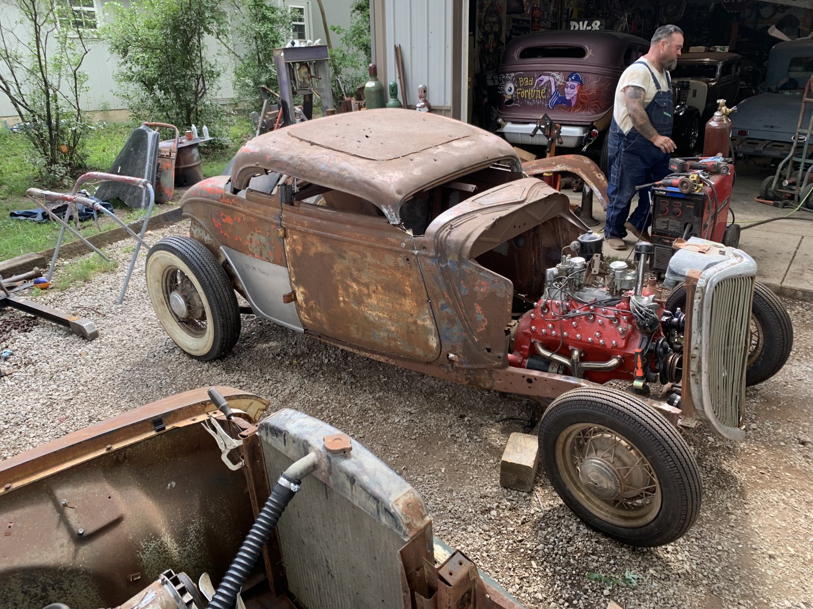

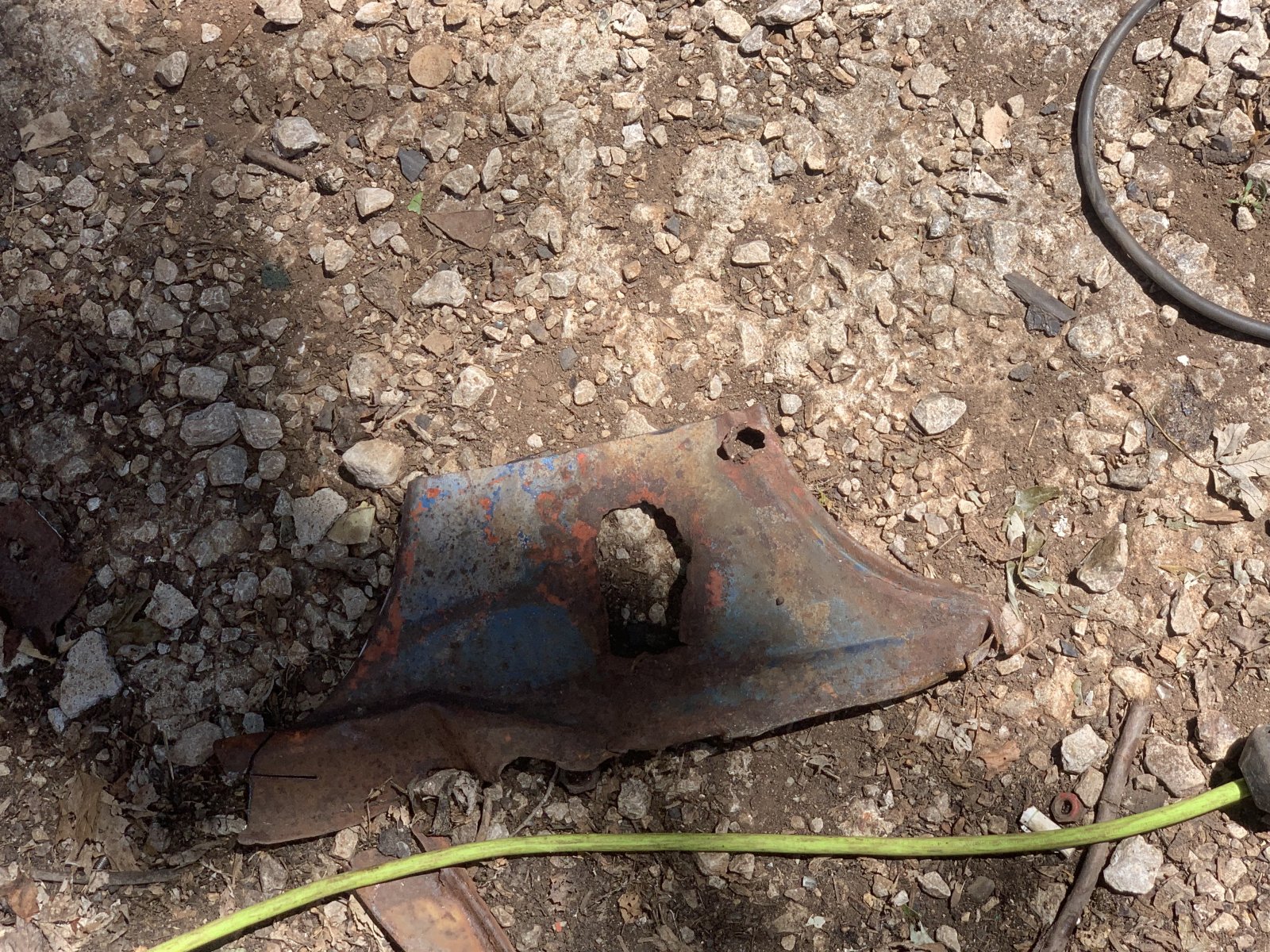

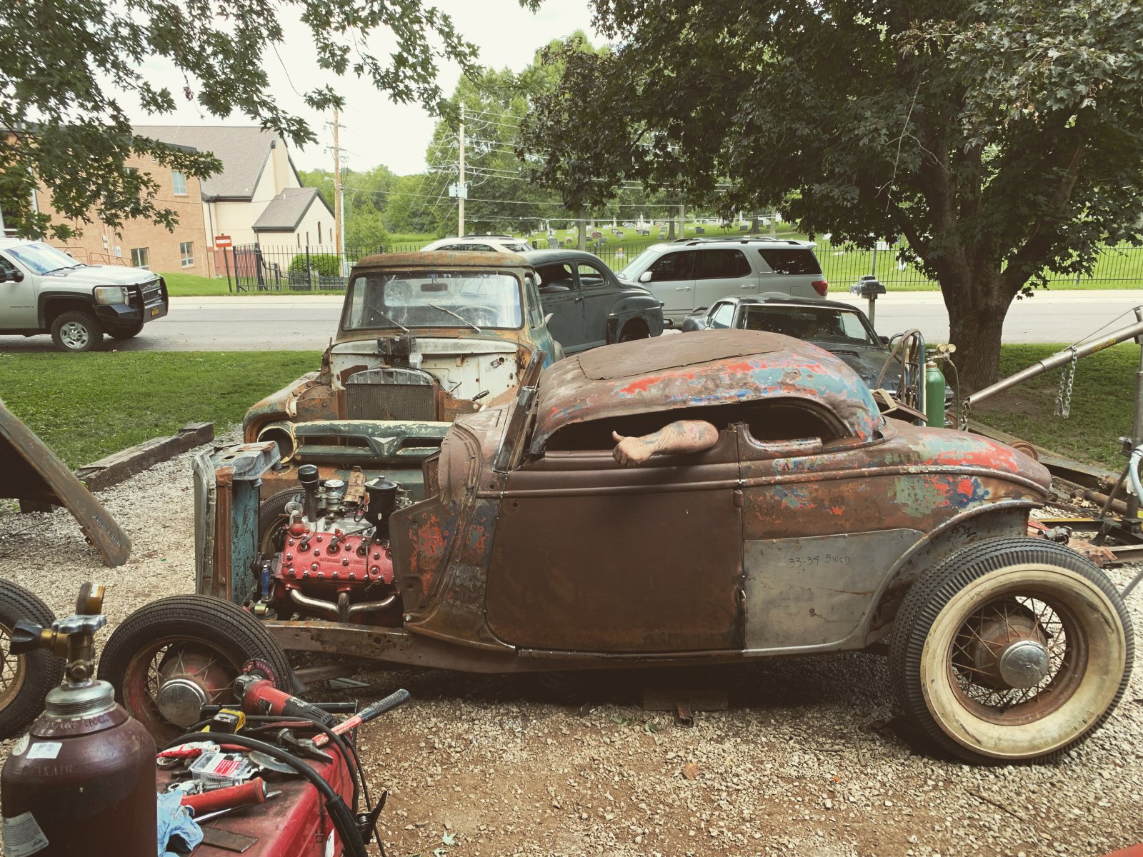

    Well day started great and ended better got the cowl patches and the **** off and the other one of Dons panels on, then it got ****ing fun, we started in on the chop.. got a little wild but I’m gonna add maybe an inch back in and lay the windshield down and make it more then a mock up but we ran outta steam today, it’s not everyone’s flavor but it is a rough tough Ford hotrod there’s no arguing that. Got a lot of love for the south Omaha car and the Pierson, Chrisman cars and their wild chops. Calling this one the nine pound hammer coupe. Jus like John Henry used to swing not for everyone only the baddest of the bad. hehe

    Pretty wild! Need to get those two lined up! @tdog 42C98A9C-F5AC-48B2-837D-1FFFB8FE6ABA.jpeg

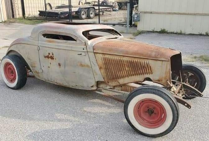

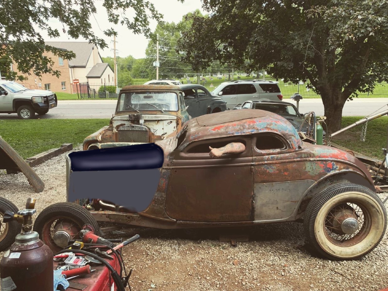

    Spent a little time talking with Austin and did this rendering of what it should look like with
    The chop finished and a hood etc. it’s hard for
    Some to “see it “ when it hasn’t gone back together yet Untitled_Artwork.jpeg gonna be awesome

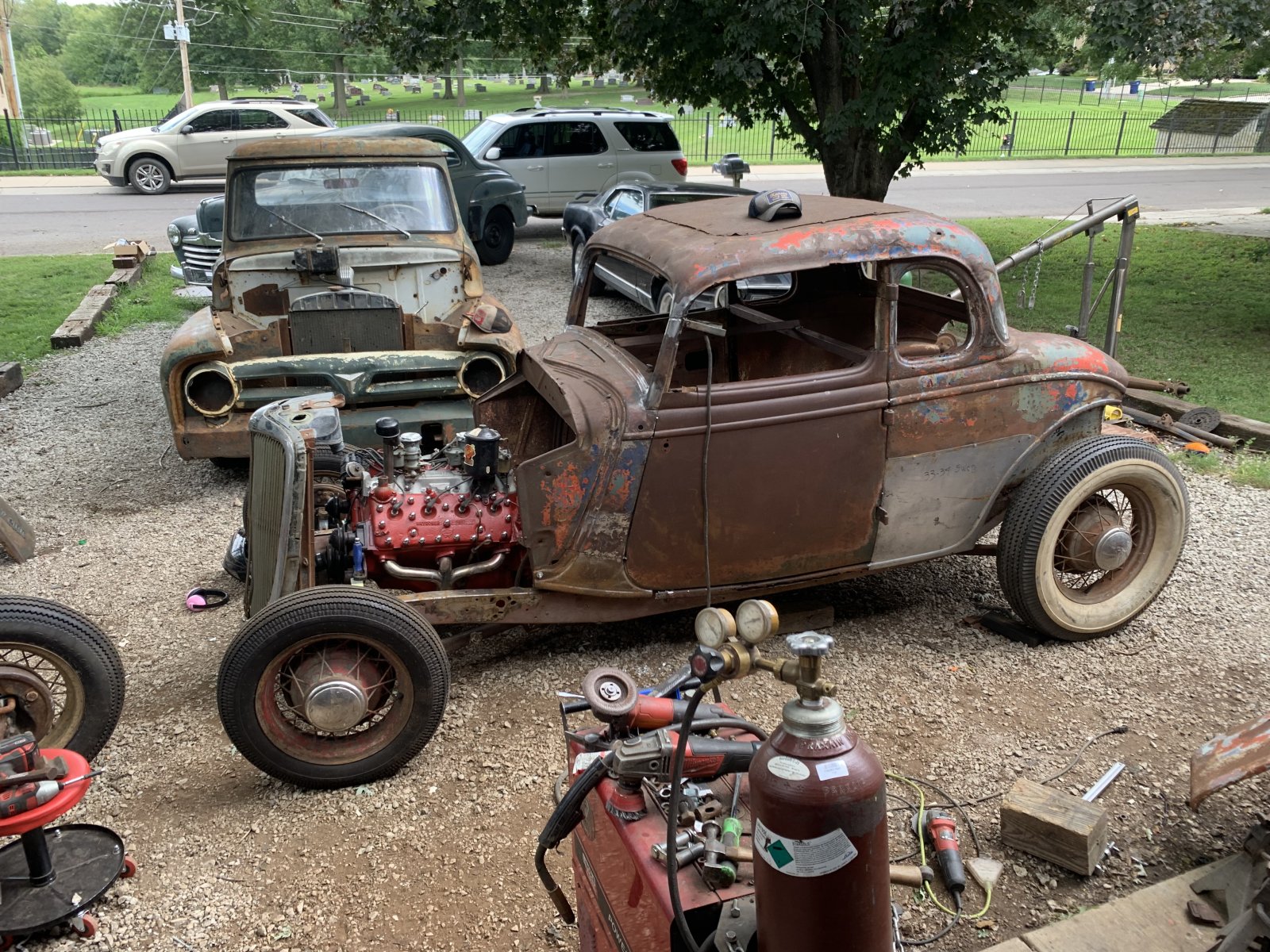

    Thought I’d share our first photo mock up and the last. With about a million different ones in between it’s kinda wild to see how close it’s landing to the first one!

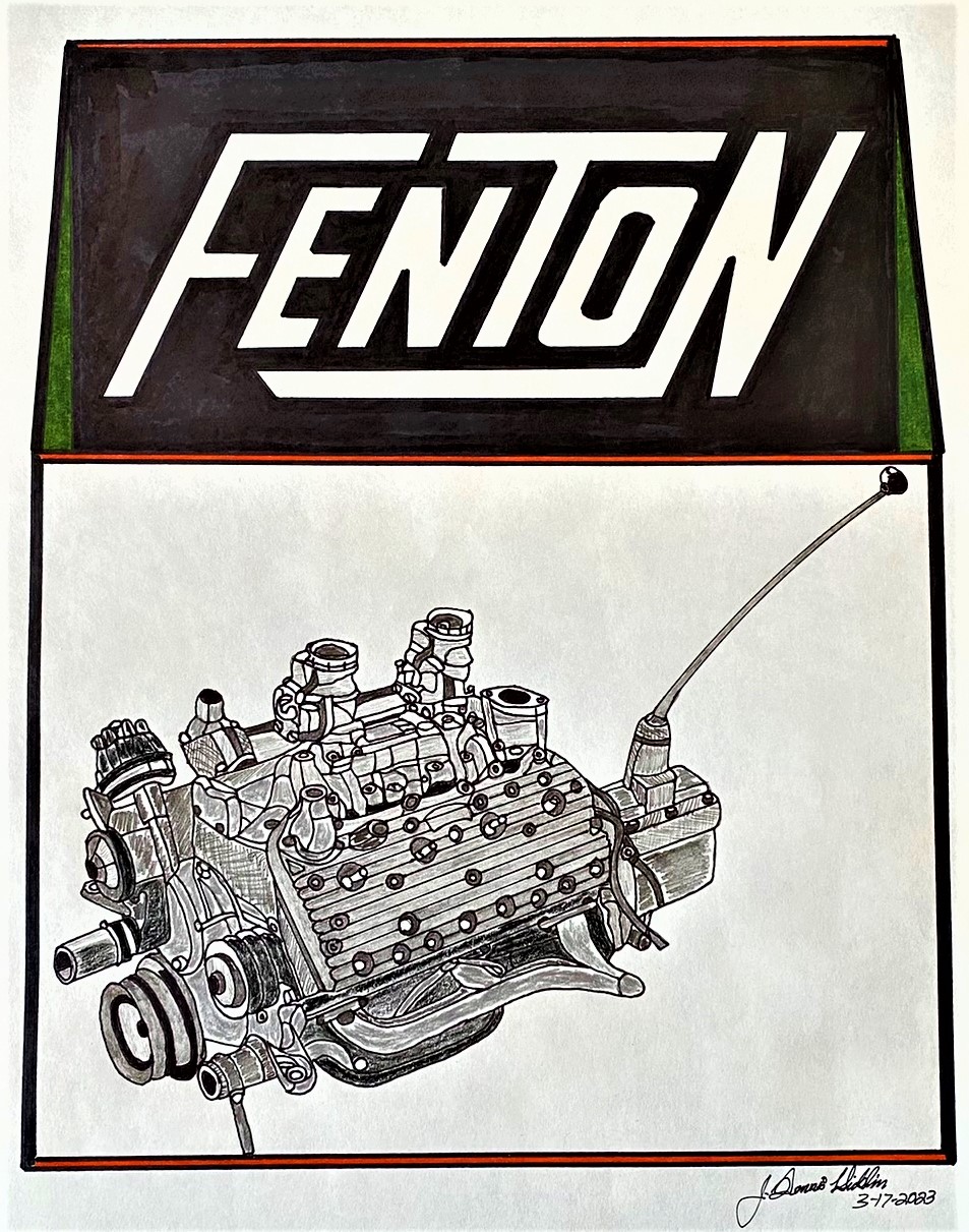

    Its got a rebuilt 8RT out of my grandpas old 1952 firetruck bored .060,Johnson adjustable lifters, fenton race intake 2x2, and a set of cheap y headers. Think the old girl should run well enough for me, Id like a set of neat heads for it but figure ill get the car put together first.

    "FENTON" stuff is very cool !

    hey that looks familiar!! haha and yes it is!!

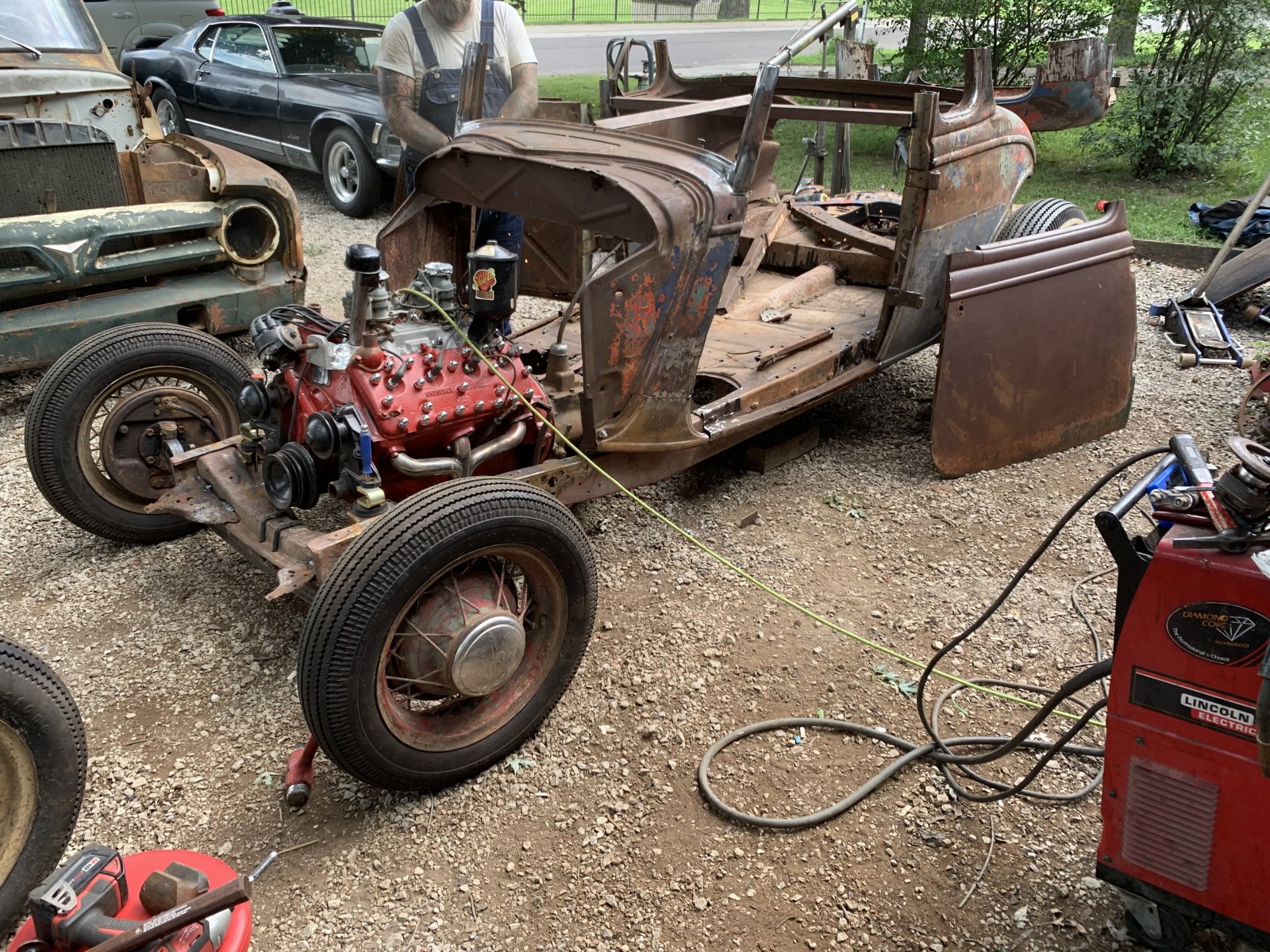

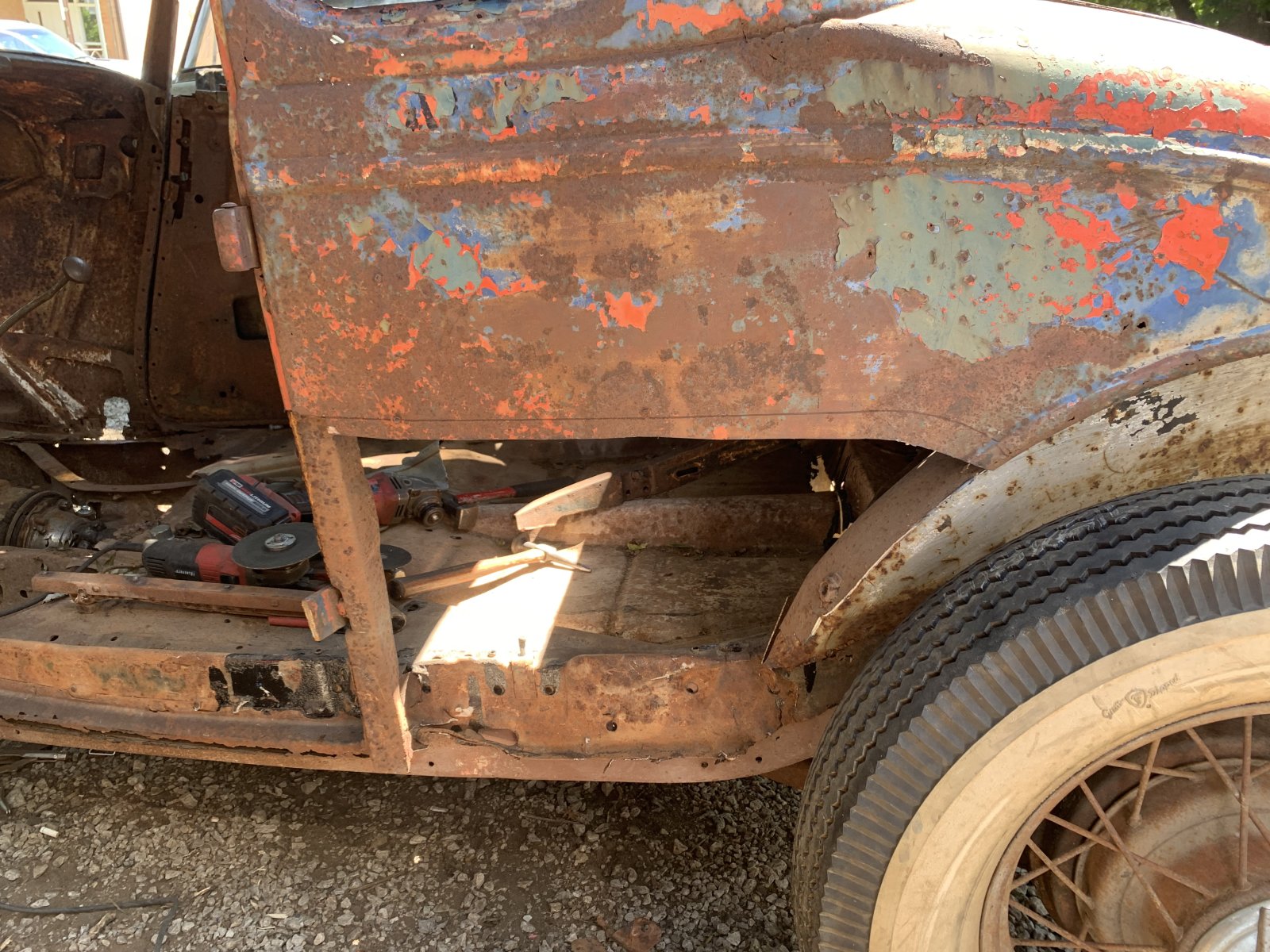

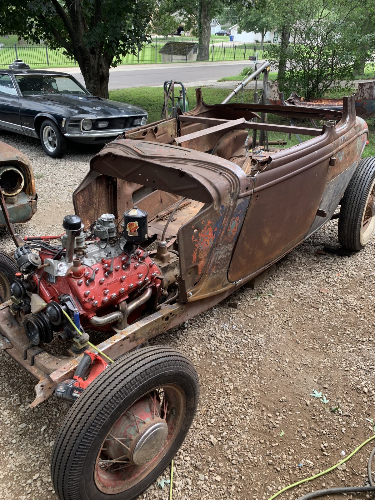

    We got the windshield cut out and back in then started shaping the B and C pillars and ran out of welding gas darn it! 33F26AE0-95B6-4C38-81C7-E813BF7CB693.jpeg 3E9E3697-B09C-477A-B112-C2DDBA3E3EEB.jpeg 427419A3-4BE1-4420-9D4C-16BA54FC27B2.jpeg
