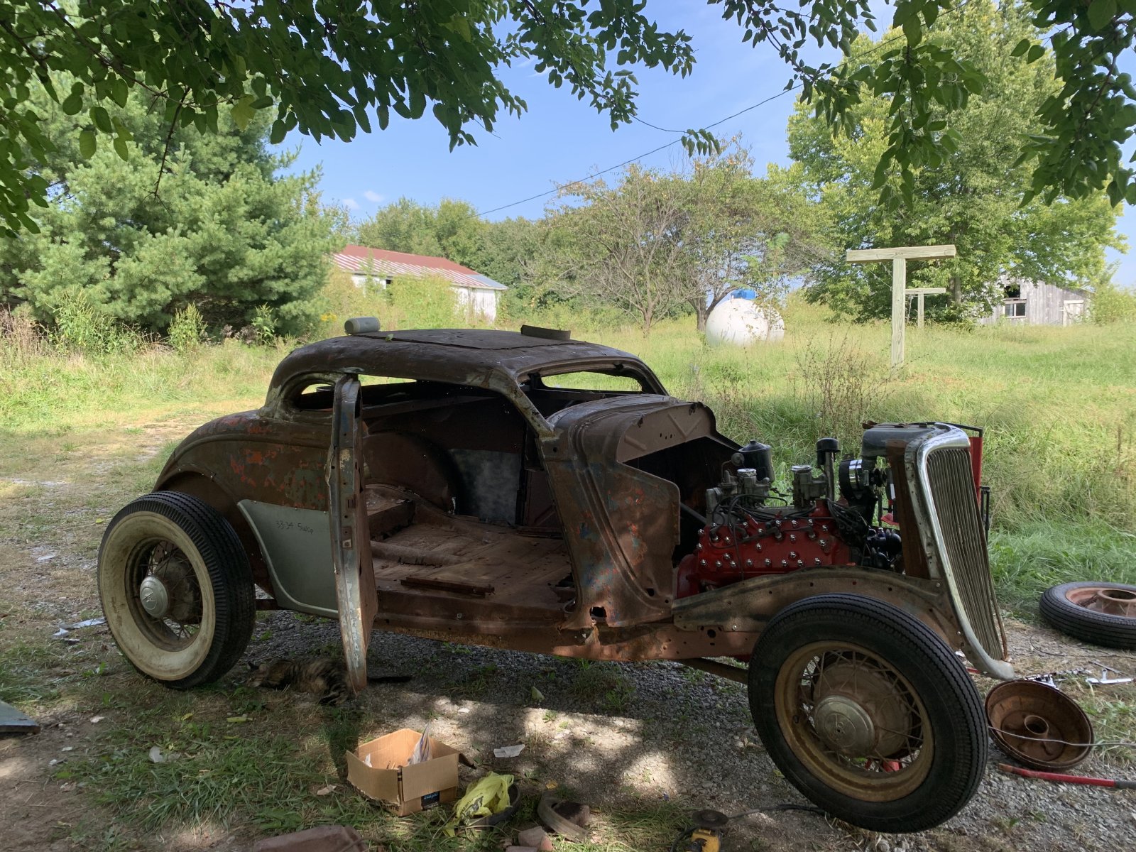

    heres some of the parts Don has made me getting very close 366730742_1465421374218253_7864559869891005282_n.jpg 366753924_858160172695385_8508414871790167259_n.jpg

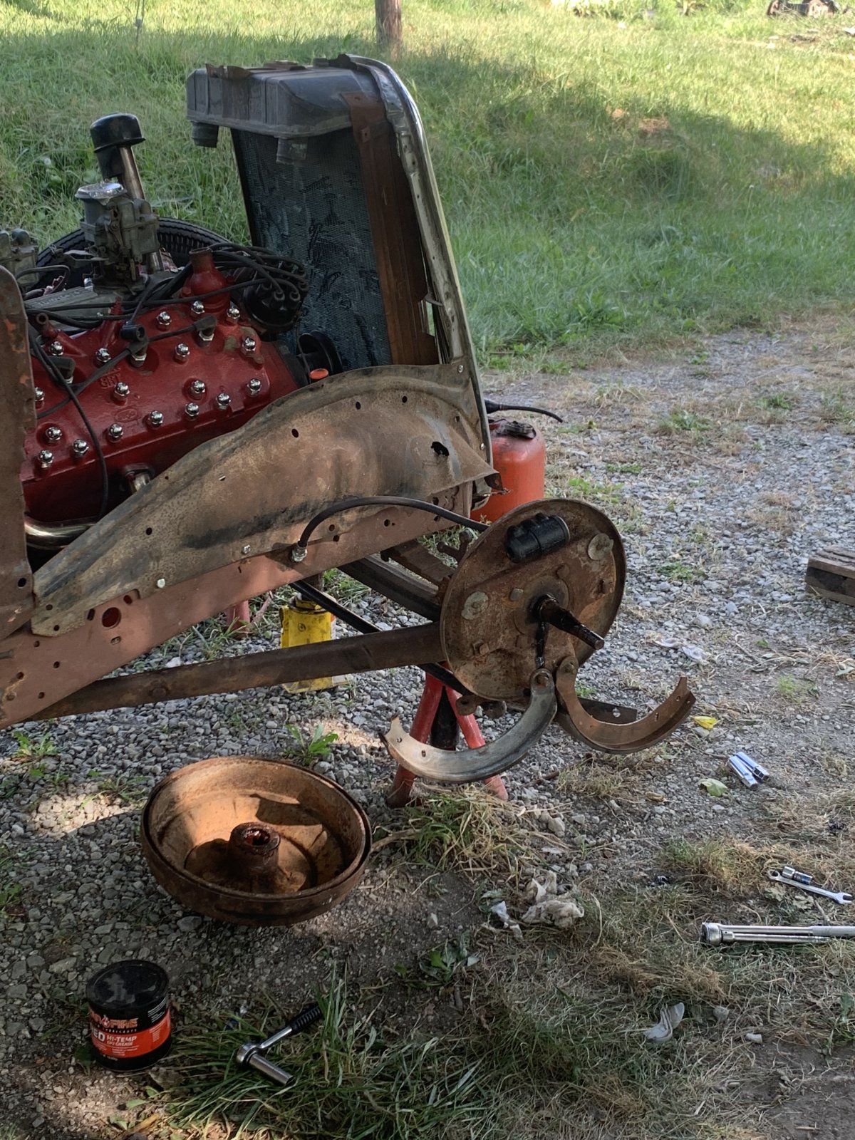

    Well all the windows got their shape today, we are getting closer everyday! And Dons workin on the RH panel now so the plan is coming together! We jus may make the Roc get boys! Master cylinder came in yesterday got the wheel cylinders built last week got the bell crank free moving now. The list is getting shorter! 7AEF7BB8-83B8-45C1-870A-6F3842F4F36D.jpeg CDC2CC83-7A59-4EC8-8710-B669BB1F2064.jpeg 6553D1C3-F666-4420-B249-D65F159A0B65.jpeg

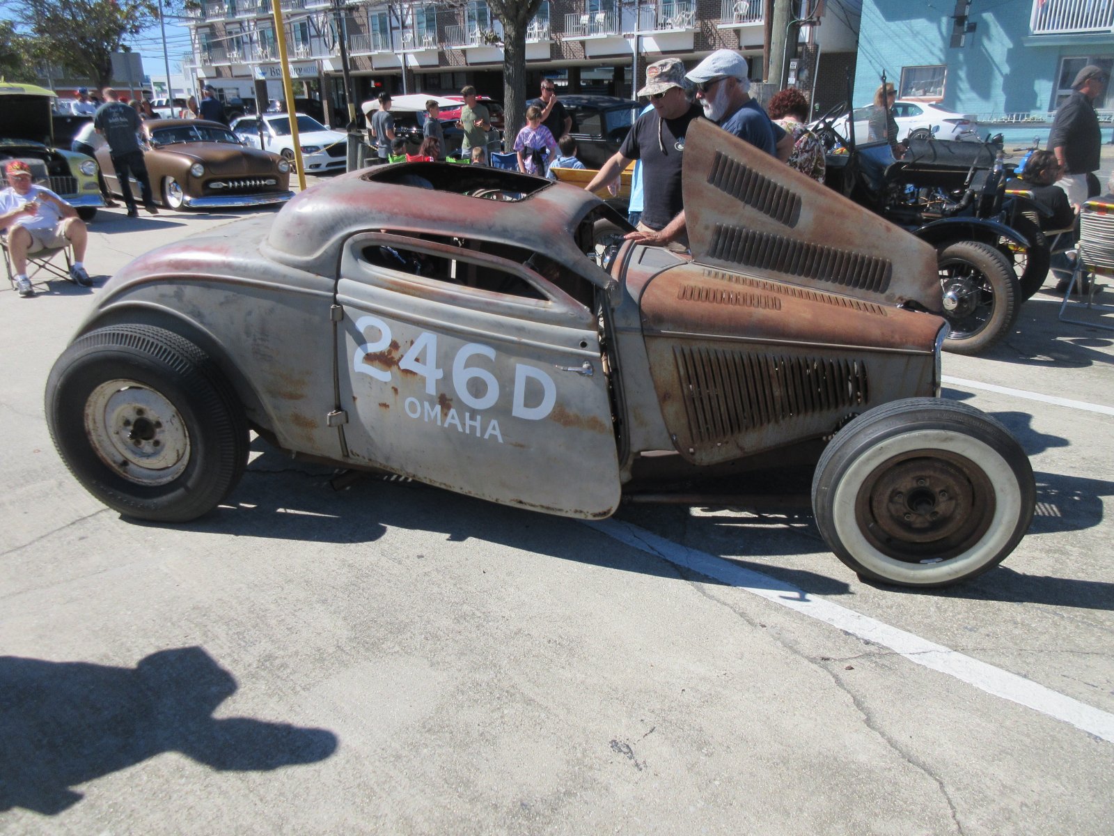

    Cool project! Mine also started out as an old jalopy racer....My buddy, Tom has the Omaha coupe with a big chop on it. tomchopped34atTROG21.JPG 34americans3.jpg

    BOTH AWSOME CARS!! the omaha car has been a huuuuuggee inspiration

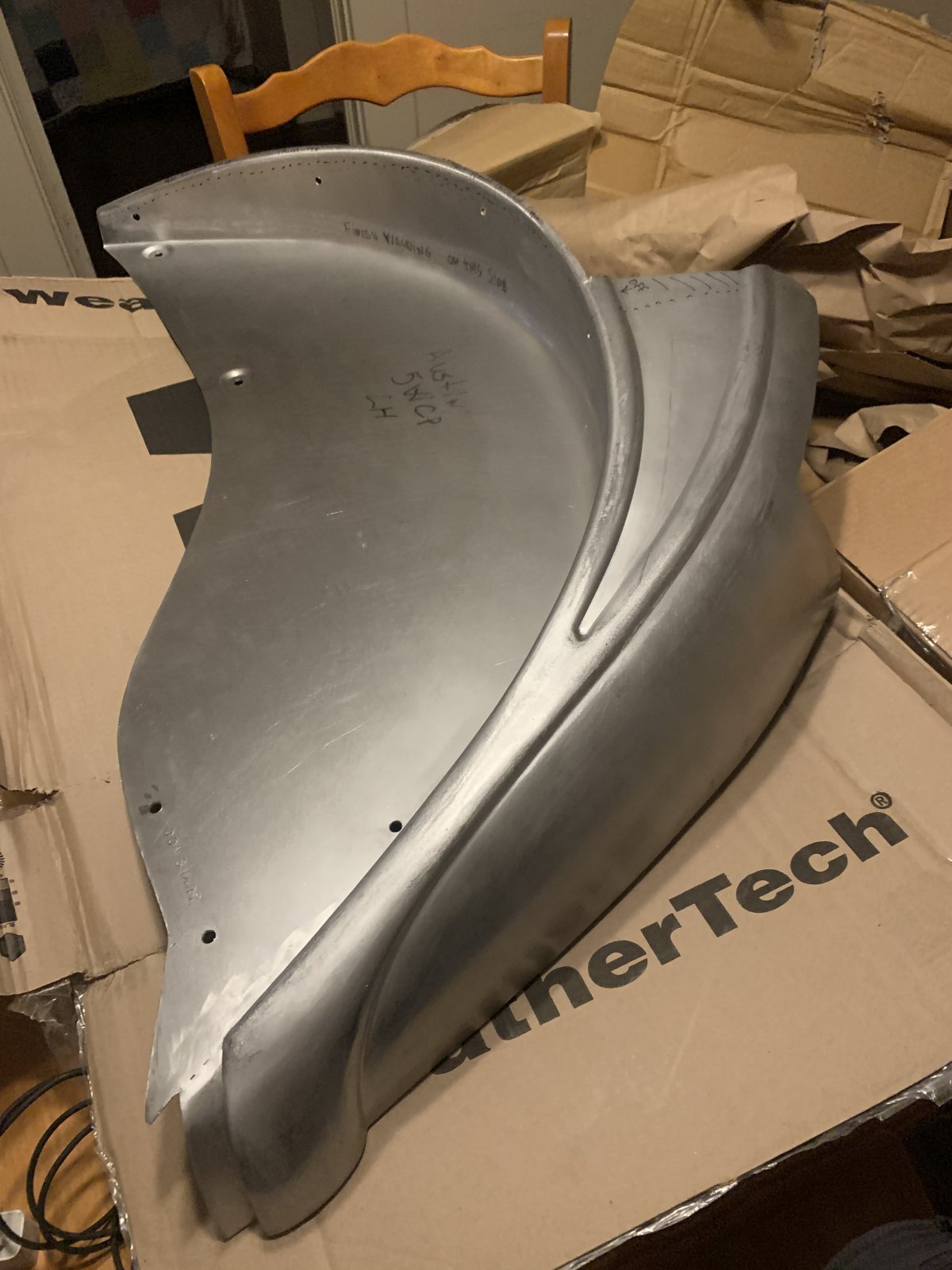

    Well did close to 13 hour last push to get the car all a car and now I’m on too wiring and brakes and fuel and all that fun stuff that never seems to end I shortened the tie rod, heated and bent the little steering arms to accommodate the 4 inch drop axle, got a 2 tooth model a box and drag link on, and my 37 dash in place, Jimmy can weld aluminum at the shop so he made me a column drop out of one of my old roundy round engine’s aluminum rods, lot more to do but I’m thinking I’ll make it to the Roc, the rear quarter tip isn’t gonna stay it’s jus there to see what it’ll look like till my new ones get here. F9F77476-FFDF-44A6-94B5-773EF168D3D2.jpeg 4C8D946C-8B1C-4E59-847F-705321D9D955.jpeg 2B0A50AE-4C38-4FD9-849A-7A89046E1F17.jpeg 3CC9AA08-9854-4FBE-B300-87486476A4F9.jpeg AD29AF7E-6549-4C70-BE8B-42E0DCBF3BAA.jpeg 3B0D41E9-6D3F-41CD-8276-D2BFC64F0722.jpeg 38EE2C75-74D5-4981-B1B8-D74D8B3D5C01.jpeg C668E65C-F265-4FBE-ADD5-52DF034D396E.jpeg 73D21FDE-191A-4CA0-AF14-A95F078D05FE.jpeg

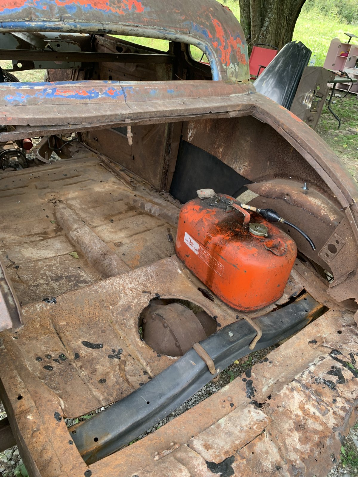

    Well working on front brakes and getting the doors operational, gonna wire and fire this week/weekend and do the clutch linkage, and hopefully finish up the other brake side I seem to have lost a few important parts along the way, and my Don smart panel came in, lots of people have a lot to say about him both ways but he’s a good dude in my book and makes the best damn Model 40 parts anywhere also got this old boat tank from the @porkn****** years ago for the model a and I think it found a home in my 34 :)
