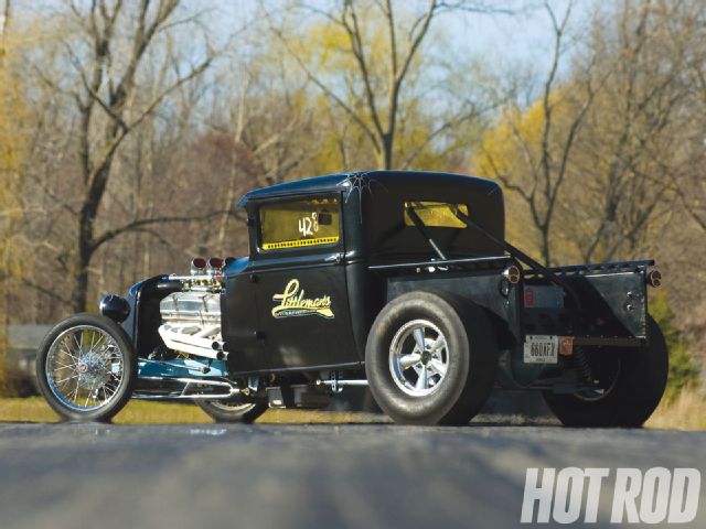

    Littleman-Dave Lohr had them on his Truck…Too busy at the moment to grab them from the Ol HD…..

    Littleman's truck:

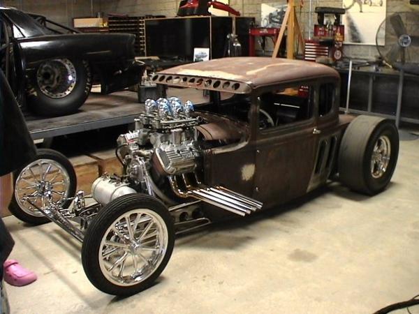

    ... and his "Deaths Doorstep" coupe:
    Death's Door Step @ SoCal Speed Shop.jpg Dave Lohr's Death's Door Step '30 Coupe.jpg
