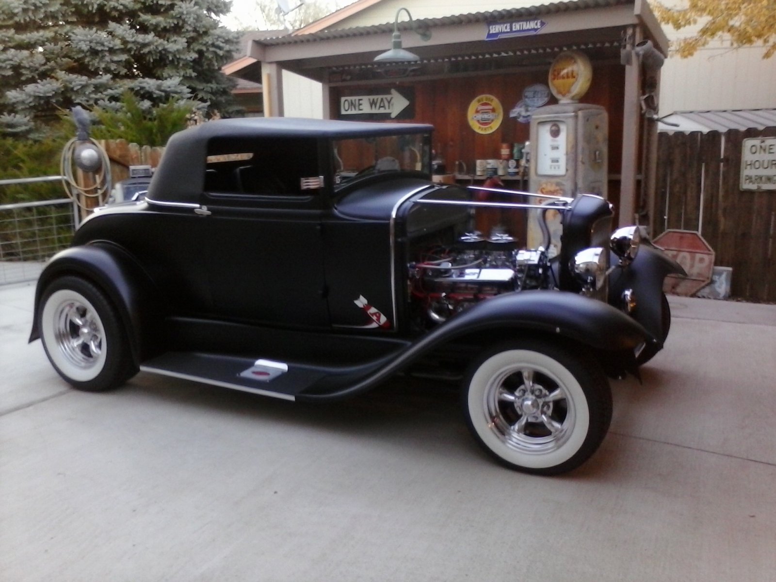

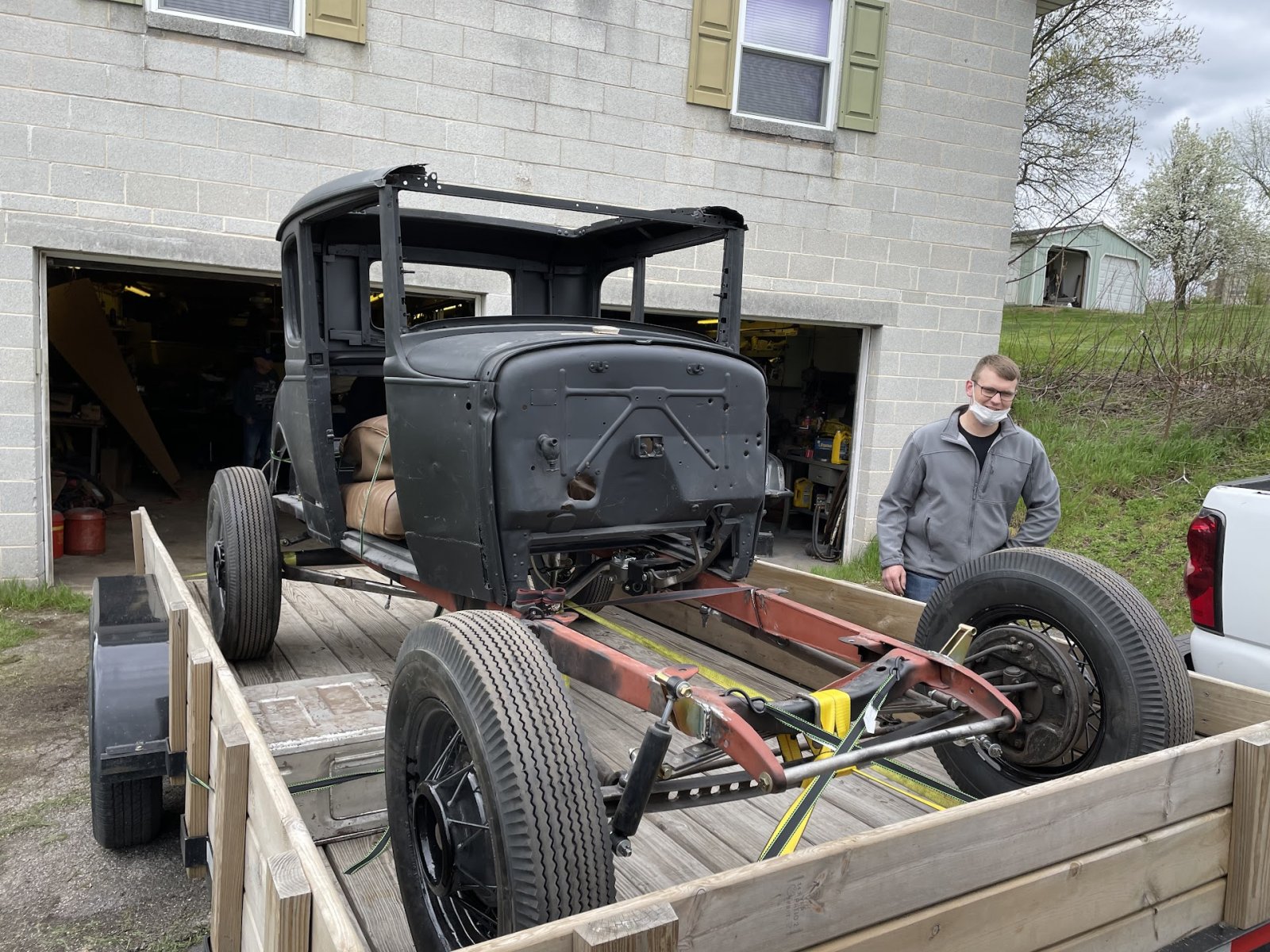

    I’ve been planning a Model A build for a while now, collecting cool miscellaneous parts here and there when the price was right. My plan is a late 50’s period car; it’s definitely not “reinventing the wheel”. Last spring I acquired a ’31 Model A Coupe thanks to Clark Bates. A while back I was given a beautiful 283 short block, although I have not fully committed to running an SBC. Limey Kid gave me a Model A frame which I plan to box. I have a Ford 9” for the rear end which will be supported with ’35-36 bones. The front will be a dropped A axle with ’32 bones. Model A grill shell, T5 transmission (overdrive is a wonderful thing), fenderless (of course), ford steel 16”x4 wheels with big and littles… just the right bits. Then lastly the 3” chop. Definitely pulled a lot of inspiration from the HAMB.
    My goal is a complete build thread in hopes holding myself a little more accountable as well as finding a little solace. So here we go.

  4. atch
    Joined: Sep 3, 2002
    Posts: 6,516
    atch
    The 3" chop sounds good. This post shows several.
    It looks like you have better parts than a lot of hot rods started with.
    Congrats on the daughter. Every day will bring you a new surprise. Enjoy her every minute.

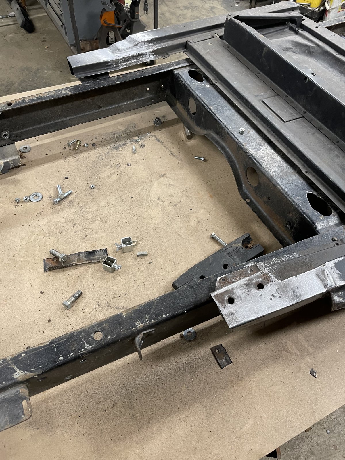

    Last night I was able to get an evening in the garage. The front ends of my subrails have some Swiss cheese. I began working on some replacement patch pieces. DCF50171-35BF-401E-B723-733AEEAF1F62.jpeg

    Well last night I had a few more hours working on subrails. The the fronts under the extensions were in rough shape. One had to be completely rebuilt and the other needed a patch. The front of the subrails are nearly done, just needs a little finish grinding and some t*******. Next I need to remake the cross member behind the seat which will decide how I will repair the rear of the rail. Slow and steady… E85D8E38-8380-4D1B-BBC4-38632088F7C6.jpeg 29A8C06A-E318-4B35-8662-9052B502792A.jpeg

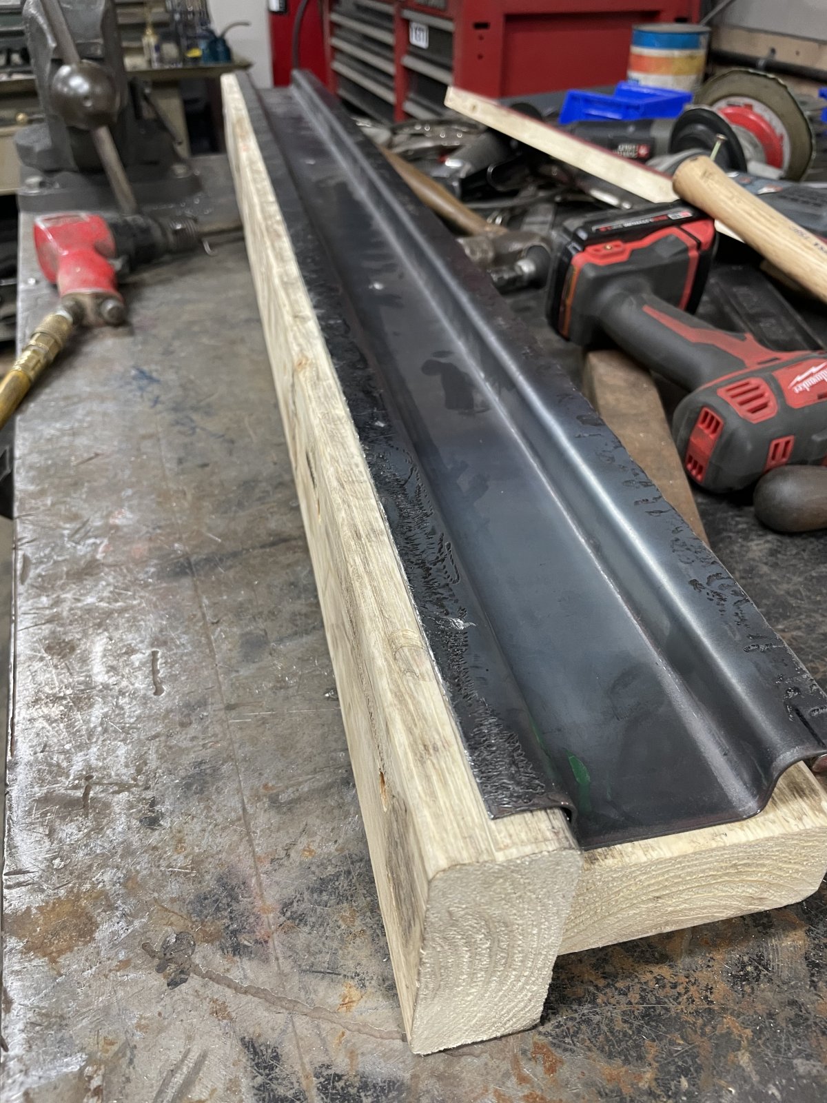

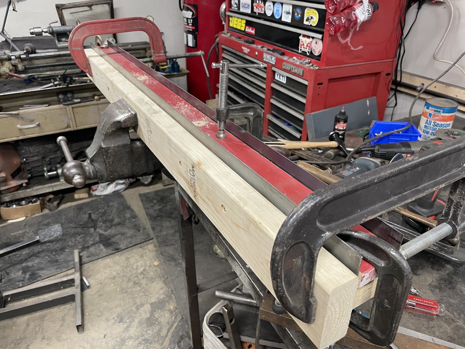

    So I had to make a subrail cross member. The brake I have access to was not capable of doing the bends I wanted so I had to improvise with some lumber, a ball peen, and a touch of air hammer. After all, necessity is the mother of all invention.
    25109314-7F9C-40CE-BF47-A58143EF83DC.jpeg 83A71768-527D-4485-BAF0-8B68E18A5B5D.jpeg
    I was happy with the final product.

  30. Kinda think that's a '30, not 31... Well at least the firewall is a '30
