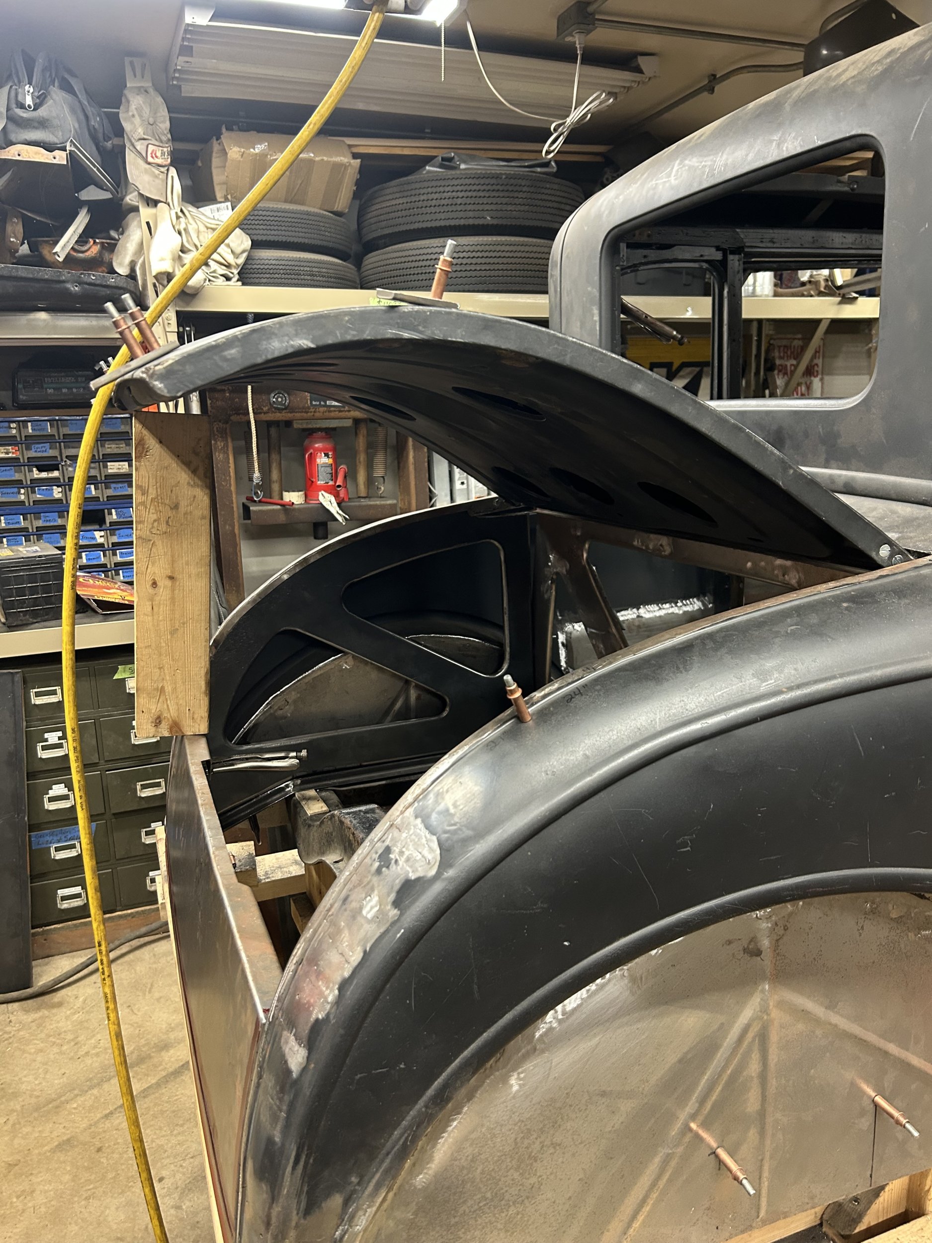

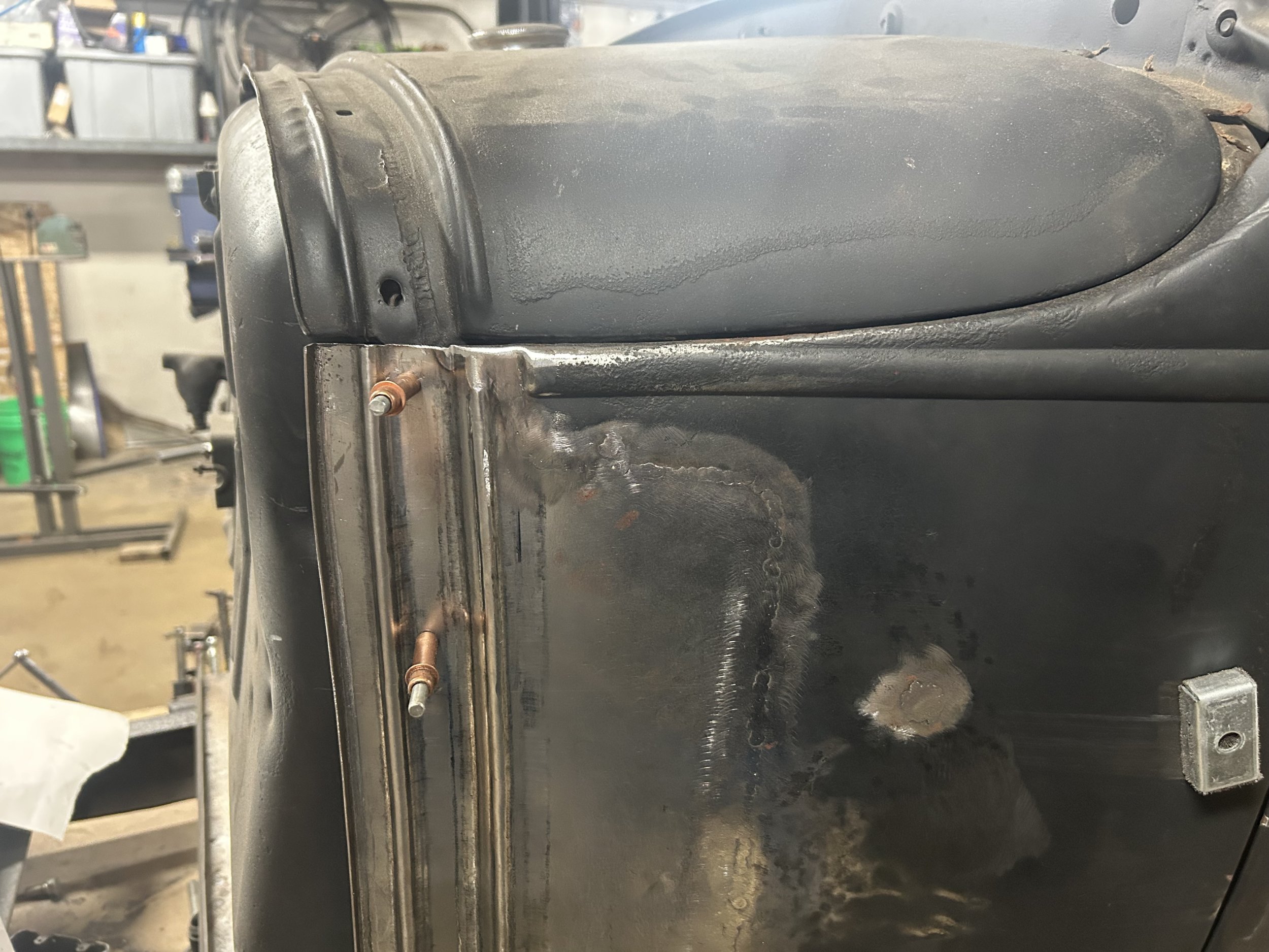

    I haven’t posted in a bit. Project car time has been limited between work, house projects, and taking care of family. Still have to ****on up the lower quarters and remake the lower trunk pan. Slowly but surely we are getting there.

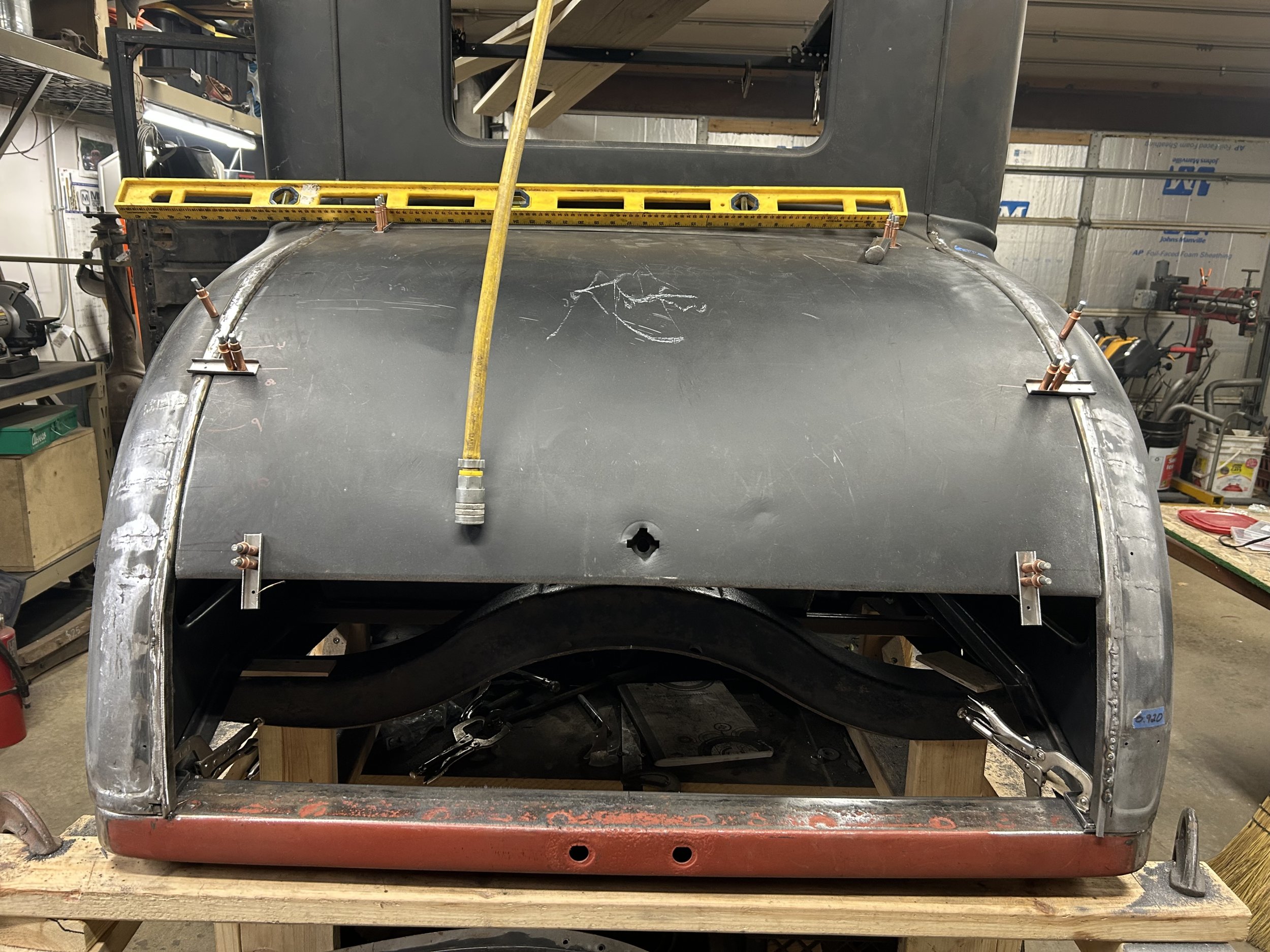

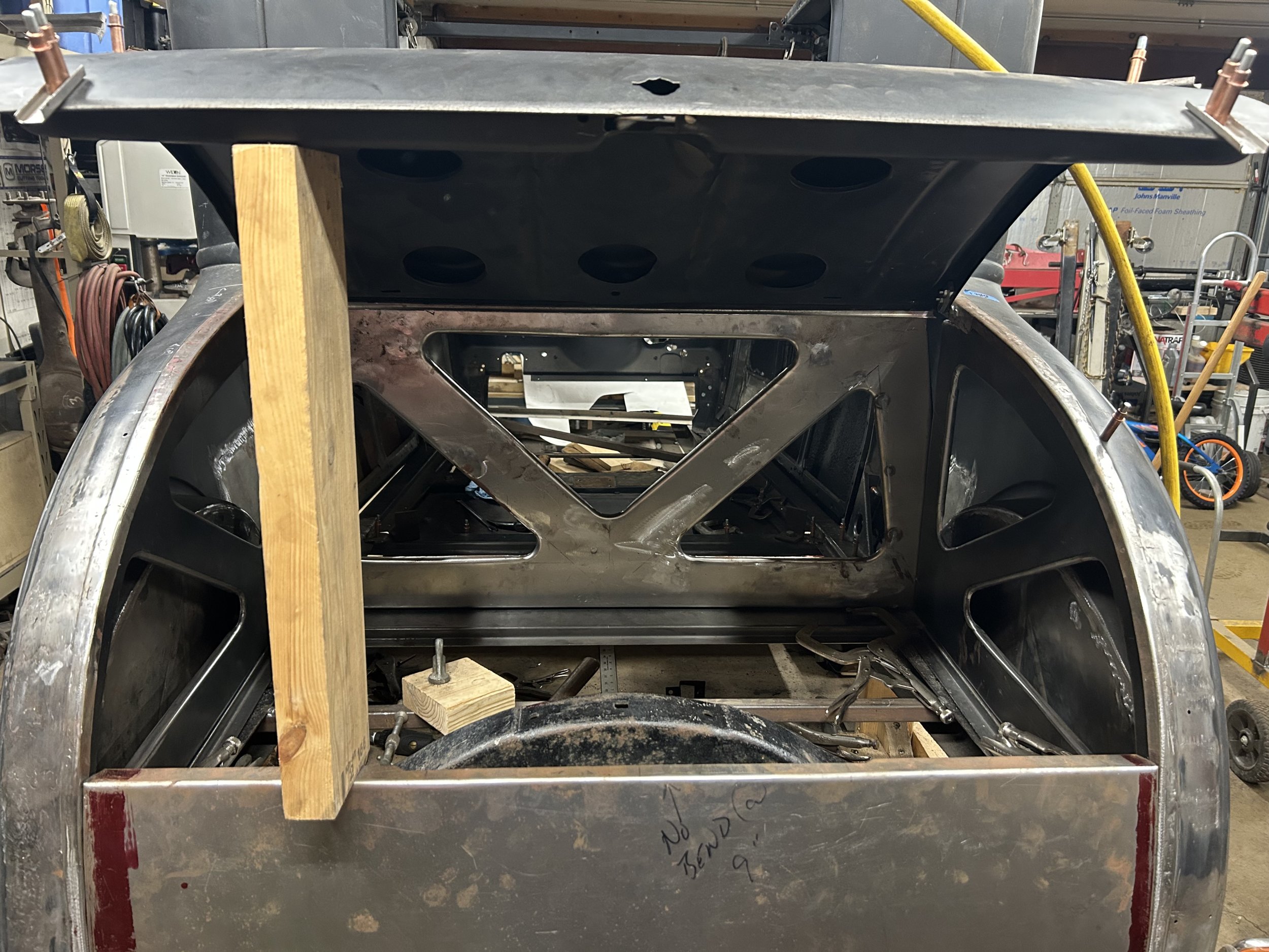

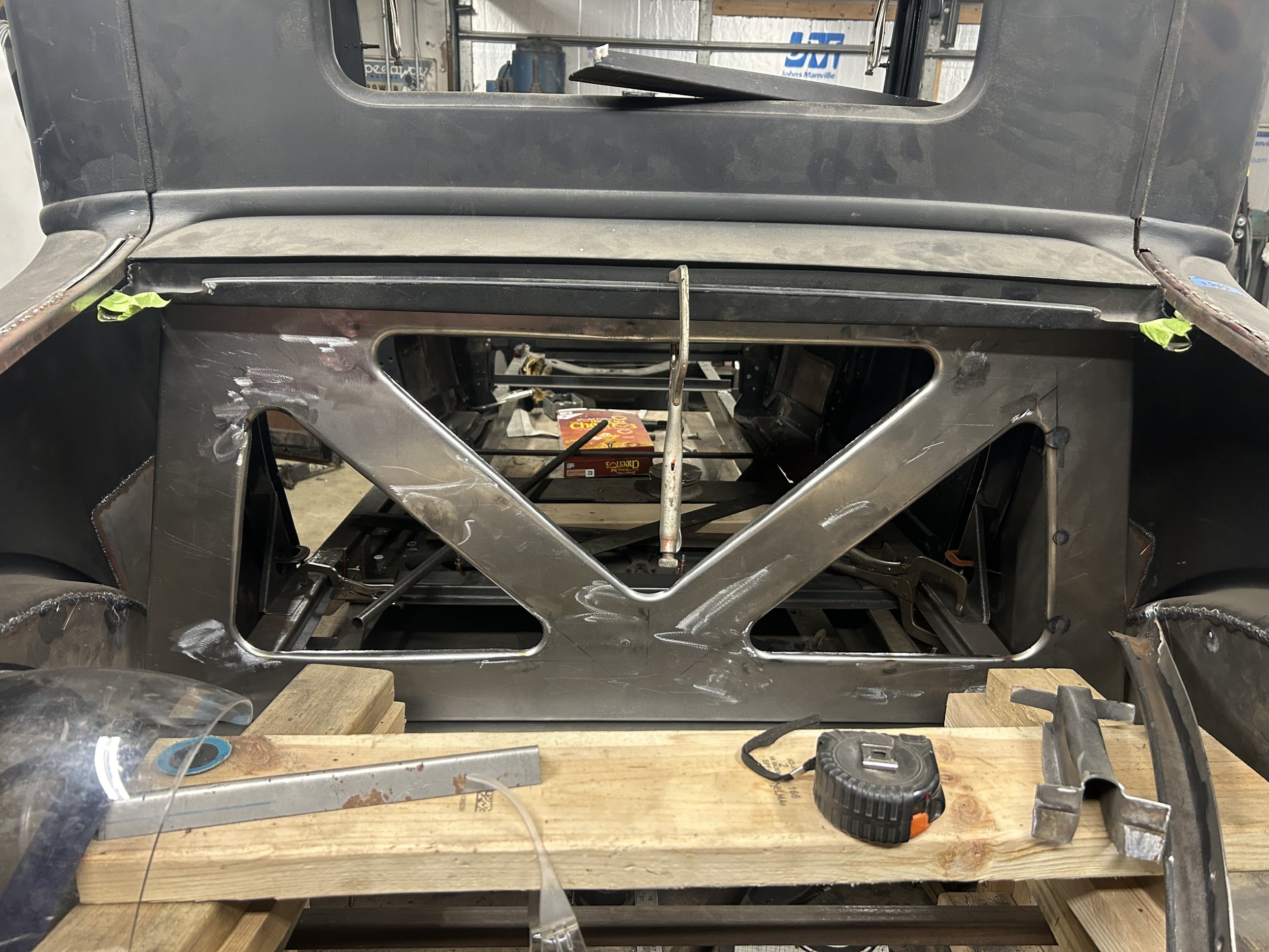

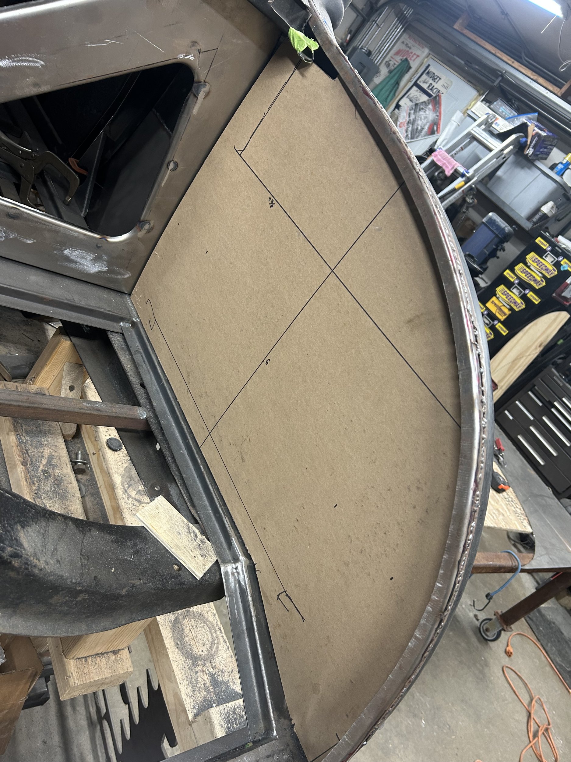

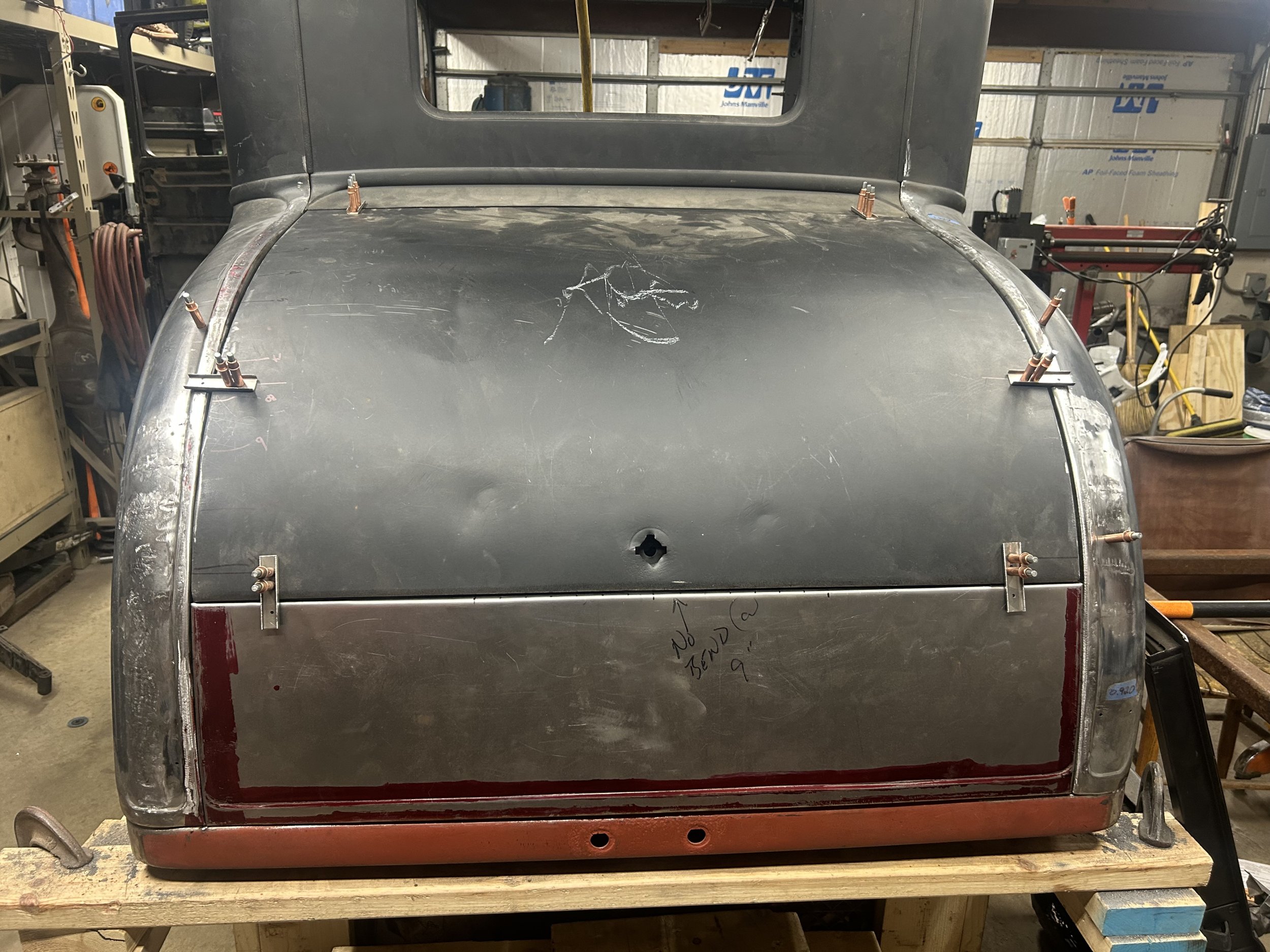

  7. Hot Rod Apprentice
    Joined: Feb 28, 2012
    Posts: 142
    Hot Rod Apprentice

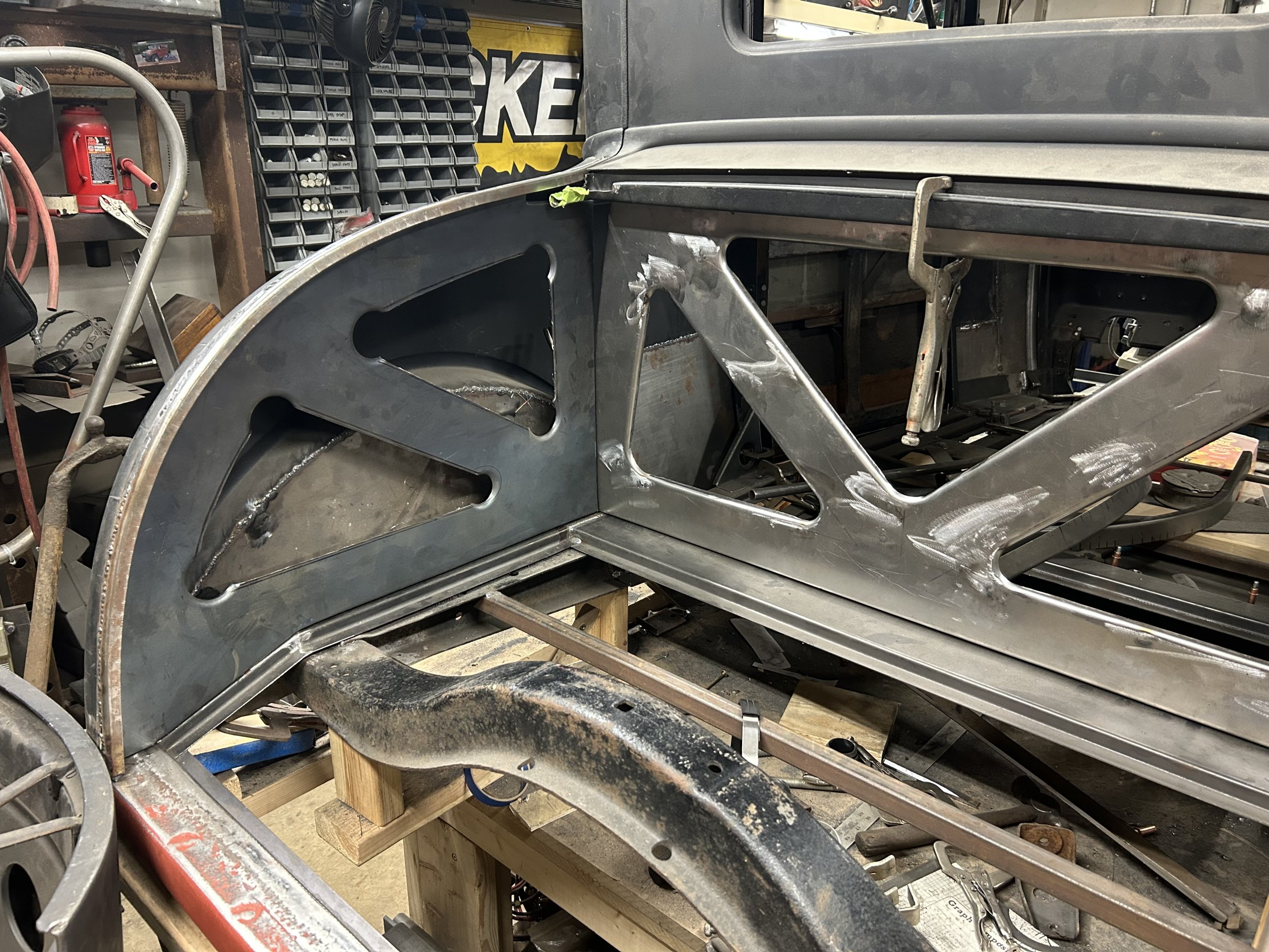

    IMG_6558.jpeg IMG_6559.jpeg IMG_7104.jpeg IMG_7111.jpeg IMG_7574.jpeg IMG_8062.jpeg IMG_8072.jpeg IMG_8070.jpeg IMG_8096.jpeg IMG_8097.jpeg
    Here is my past due photo dump. I haven’t posted much in the past year. It’s been one of those situations where toys often have to be put on the back burner. Family, work, and home ownership can often cut into “garage time”. Progress has been slow but my ‘31 has continued moving forward. In fact, so much so that I am now finally attaching body panels to the subrails. I had a buddy over to check my work and give me a
    second set of eyes before I locked everything down. Then I had my little inspector come out and share her thoughts. She just said “it needs to be loud”.
    I am very excited to move away from body work for a little bit and begin some ch***is work.
    My goal for the summer is to have a tack welded rolling ch***is come its end. I think I am right on par for end of August.

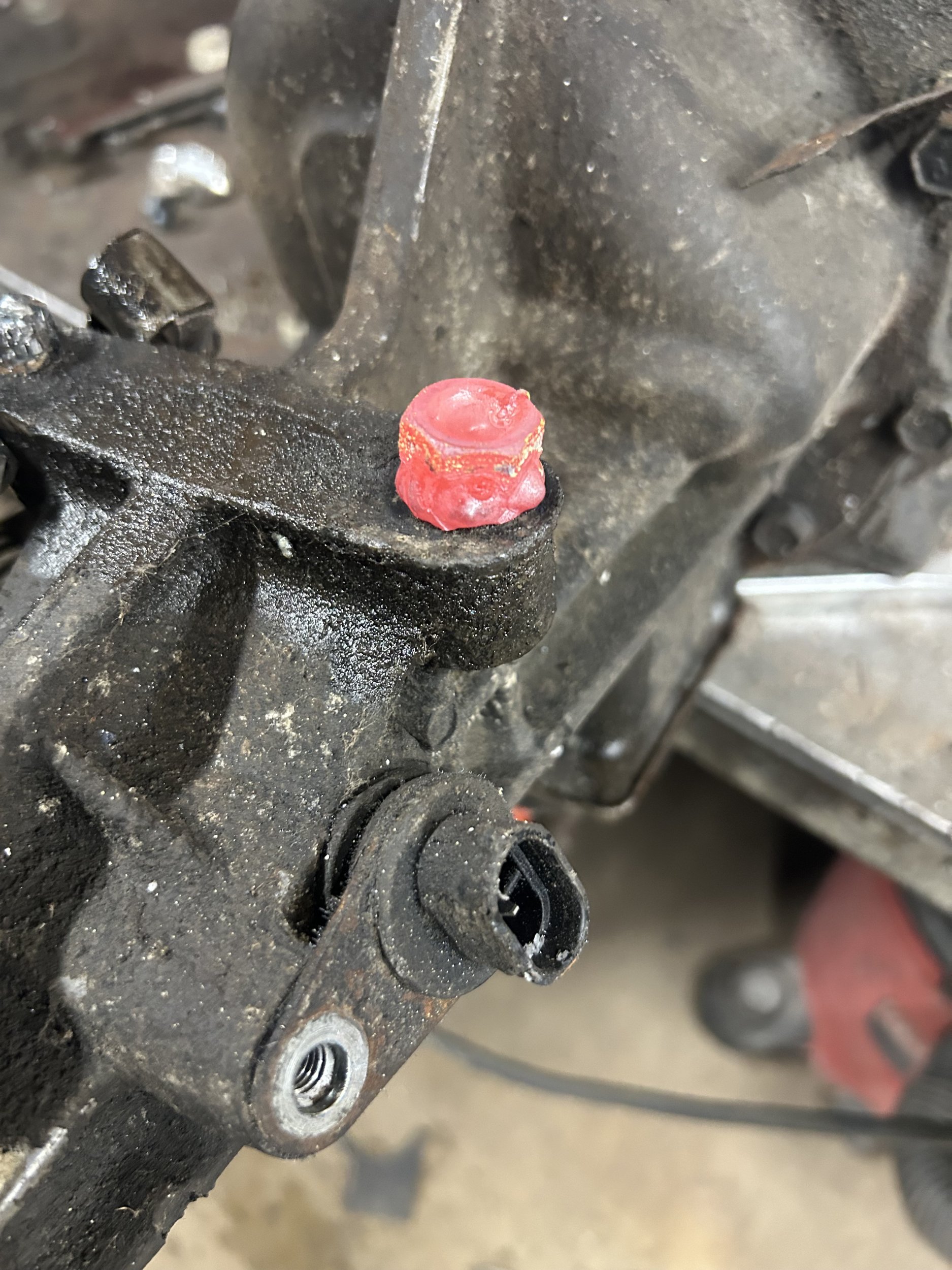

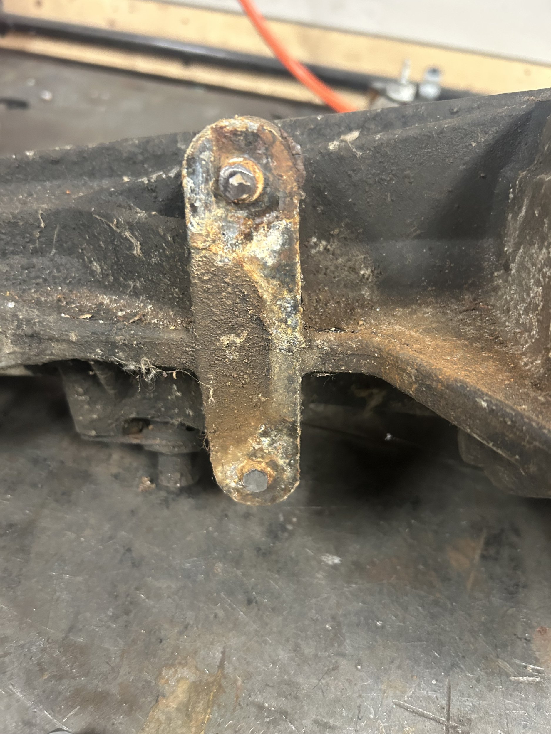

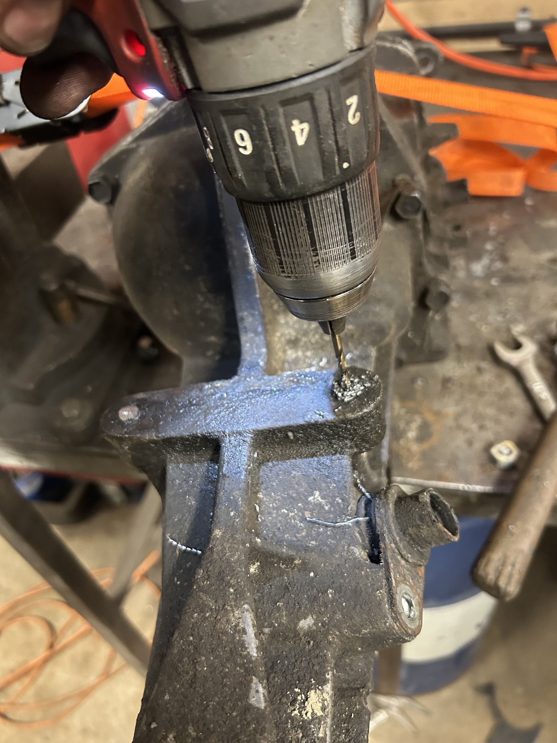

    Got it off the table a few days ago and mocked the axle in place.
    Today was three hours to remove two bolts. They were teasing me through the whole process. But my ‘63 Chevy 283 is mocked together with my S10 T5. Tomorrow we start on the front Hurst motor mount. IMG_8166.jpeg IMG_8169.jpeg IMG_8171.jpeg IMG_8173.jpeg
    Needless to say the 10mmx1.5 bolts are now 7/16NC.
