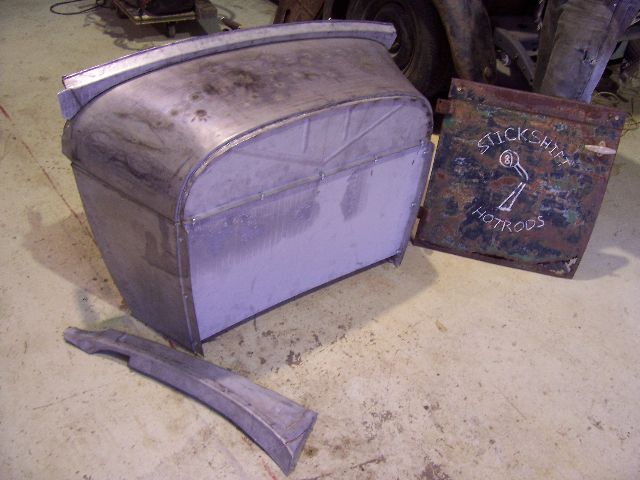

    after building my last car, a 25 dodge roadster, and having to do some major rust repairs to the body, i thought it would be great to build a car with nice new panels.
    so, me and a mate have started to make our own A model roadster pickup from scratch.
    because we want to build one each and i also want to build one for my son we have made all the hammer forms out of steel so they will last.
    so far we have the cowl done, and the door posts.
    am working on the roadster doors at the moment, will post some picks of these when i get a bit further

    we also watched the covell videos and they gave us a few ideas.
    first of all i borrowed some original A panels from a mate and pulled them apart with the intention of making each panel the same as henry did them, but with out the huge presses and using hammerforms instead.
    the cowl looked the hardest as it has the curves going in 2 directions.
    first i cut out the rusty fuel tank and cleaned up the inside so it looke like a single skin cowl top.
    then i ran some 5 mm by 30 flat bar through a large roller to get the approximate inside shape of the skin.
    i cut and bent to hoops for the front and back of the cowl.
    basically i welded up the whole structure inside the cowl and them had to pry the skin off. then it was just a matter of filling in a lot of gaps and bracing it up really well. this buck takes 2 guys to lift.
    then you clamp the 1mm sheet onto the buck using shitloads of clamps and start bending and hammering till you get the shape close. the outside edges sorta pucker up so we used a little bit of shrinking with a torch then a bit of wheeling to get rid of the wrinkles
    craig

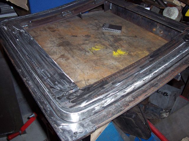

  16. fc ute
    Joined: Mar 7, 2001
    Posts: 166
    fc ute
    the firewall is easy as its flat, just add the swage lines to the top half.
    the cowl side are also pretty easy as the can be folde up on a bender then english wheeled to get the right curve.
    the door posts are a bit harder.
    the buck for these are made from 10mm steel run through the roller to get the right curve, 25mm flat bar welded on to represent the swage line.
    again you just clamp the steel on, using as many clamps as you can find and you start hammering. i find a piece of 400mm by 6mm aluminium flat bar is a good drift to hammer into the swage edges to get a nice sharp edge.
    at the end of the day you have forearms like popeye
    craig
  17. fc ute
    Joined: Mar 7, 2001
    Posts: 166
    fc ute

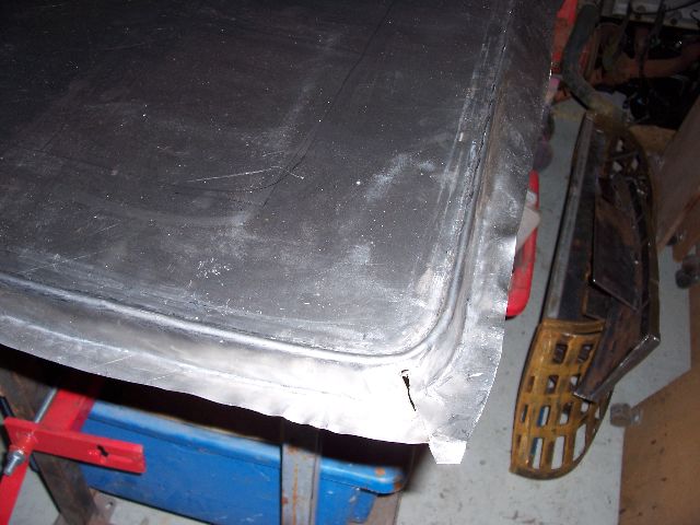

    the inner doors skins are a little bit harder.
    split a door open so you get to see exactly how it goes together
    i wanted the doors to be 75mm longer so allow that in your measurements.
    again the buck is made up from really heavy steel with a 6mm round rod welde around the edge to replicate the original panel wich has this to hide the edge of a door panel if used.
    i am not putting any holes in the panel, just a swage pattern which should be added before you start hammering
    the inside of the buck is open so that the swage lines dont interfere with the sheet being clamped down
  18. fc ute
    Joined: Mar 7, 2001
    Posts: 166
    fc ute
    the inner skins have rounded corners at the bottom and you end up with an excess of material once you start hammering.
    i used snips to cut close to the corner so both pieces would overlap.
    hammer a bit more and then you have the problem of 2 thicknesses of metal so i run a 1mm cutting blade right up to the corner, this allows us to weld a small section which will be right at the bottom of the door
